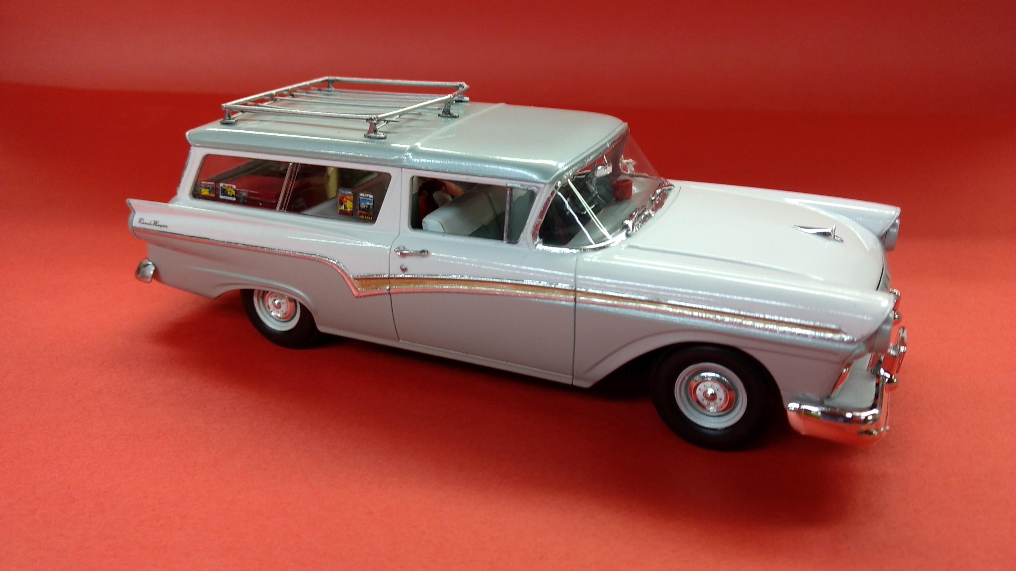

As to the AS-5 paint you are using, it is perfect. If you did want a pearlescent finish, I suggest a light coat of Testors White Lightning. It is the exact paint combo I used on my 57 Ford wagon. It has a nice way of "pearlizing" the flat finish. Although I do like the flat finish on your build. I look forward to seeing how your build turns out.

That is a really neat Ford wagon!
