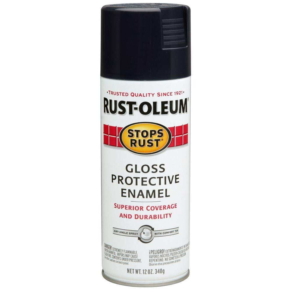

StevenGuthmiller Posted August 20, 2020 Posted August 20, 2020 On a side note, I just wanted to add that the cheap Rustoleum glass black paint that you can find in most home improvement stores, among other places, makes an excellent base for Alclad chrome paint. It dries so absolutely glossy that your chrome will turn out beautifully! My most recent evidence of this is this radiator cap. Steve

gman Posted August 20, 2020 Posted August 20, 2020 On 8/20/2020 at 6:42 PM, StevenGuthmiller said: On a side note, I just wanted to add that the cheap Rustoleum glass black paint that you can find in most home improvement stores, among other places, makes an excellent base for Alclad chrome paint. It dries so absolutely glossy that your chrome will turn out beautifully! My most recent evidence of this is this radiator cap. Steve Expand Good to know. I'll have to look for some of that. ^^ is this the stuff?
StevenGuthmiller Posted August 20, 2020 Posted August 20, 2020 On 8/20/2020 at 7:19 PM, gman said: Good to know. I'll have to look for some of that. ^^ is this the stuff? Expand Yes sir. Not exactly the best paint or spray nozzle that you will ever work with, but it will give you a super shiny finish. Steve
gman Posted August 20, 2020 Posted August 20, 2020 Thanks, will keep that in mind for the next time I break out the Alclad.

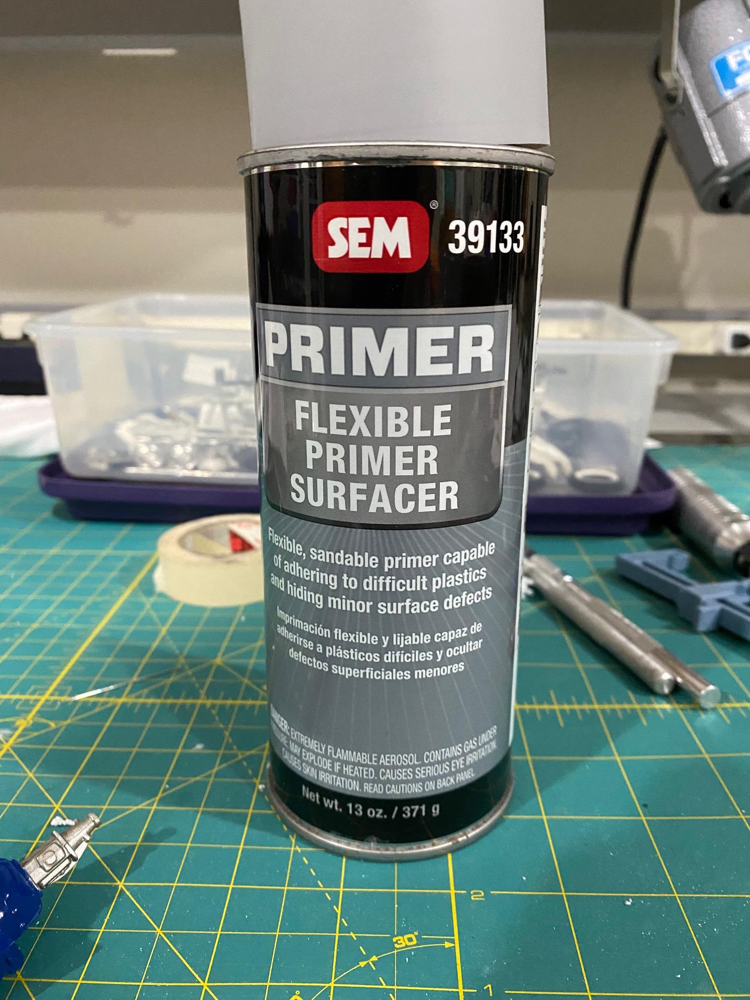

Kromolly Posted January 25, 2021 Posted January 25, 2021 On 8/19/2020 at 10:05 PM, martinfan5 said: Be careful with SEM, I use their chassis grey for all my current NASCAR builds because it accurate and it has a weird reaction to the plastic , it doesnt craze , I don't know to explain it, so I am not sure if the primer will do the same thing. Decanting and air brushing it seems to solve the issue if I recall. *shooting it straight to bare plastic The best thing you can do is use Tamiya Primer, its Tamiya Like Quality for reason, its worth the money. Expand I had a similar experience with this SEM primer. Hard to describe, but it looked like the primer shrunk as it dried leaving cracks and voids. I was able to strip it in brake fluid and the model is fine, it didn't melt the plastic. I just shot it too heavy. I tried again on a scrap body and it seems fine in light mist coats. Haven't tried to sand it yet, but I've used this on a 1:1 project and it is nice primer for that purpose and sands nice (that's why I had it on the shelf). I used to have a trick little paint booth that I had made, but several moves later I have no idea where it ended up. I need to build a new one and then go back to air brushing all of my primers.
