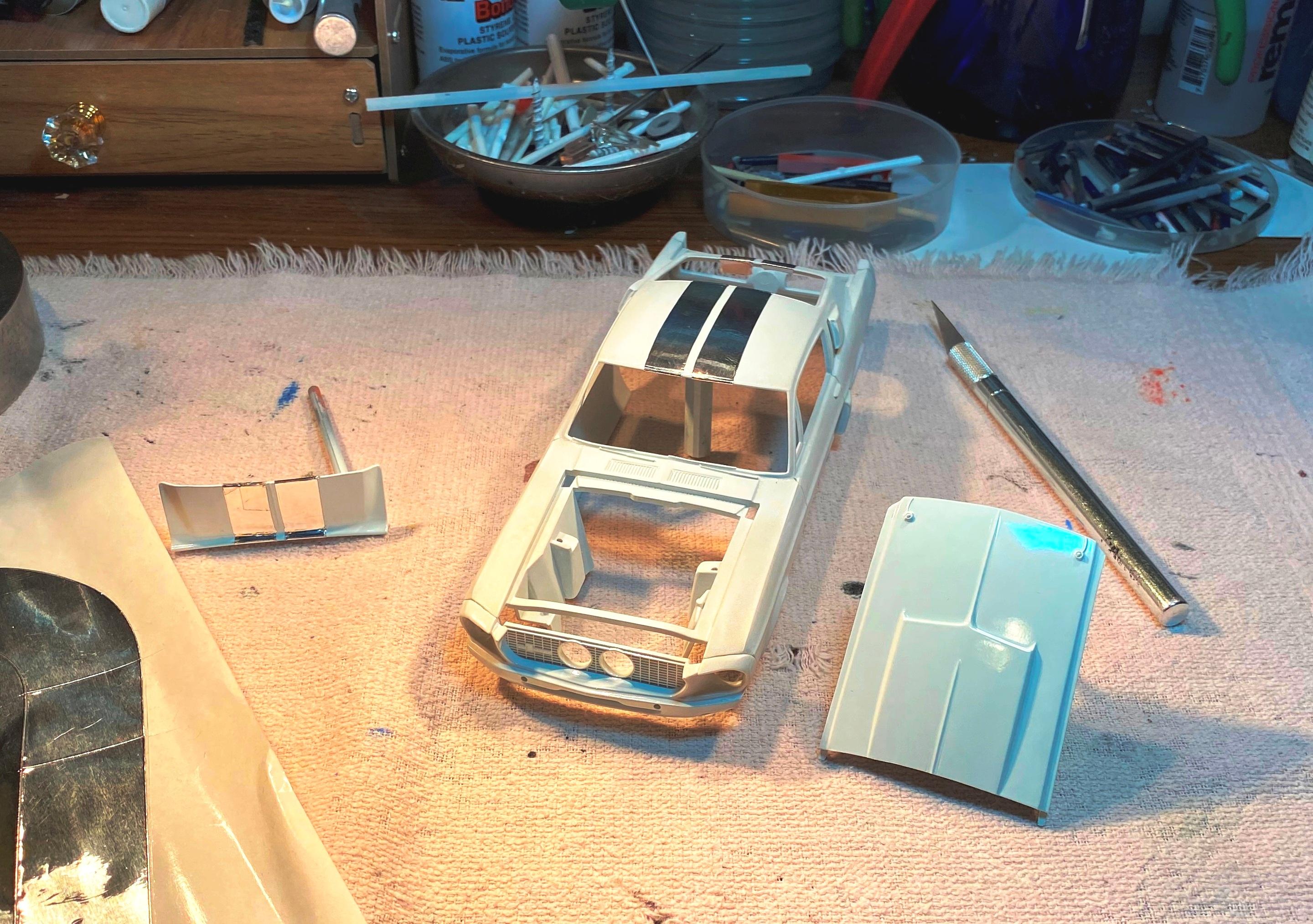

Bills72sj Posted May 1, 2022 Author Posted May 1, 2022 (edited) The white has cured long enough to mask the stripes. I found a printout of the dimensions of the stripes which actually taper in places. I used some BMF type material from a leftover project at work. The adhesive is amazing. Supper strong but does not leave residue when removed. Works way better than any tape I have ever used including Tamiya. The Chrome stripes on white look pretty cool but this one is going to be white over dark blue. Edited May 16, 2022 by Bills72sj Added pic 1

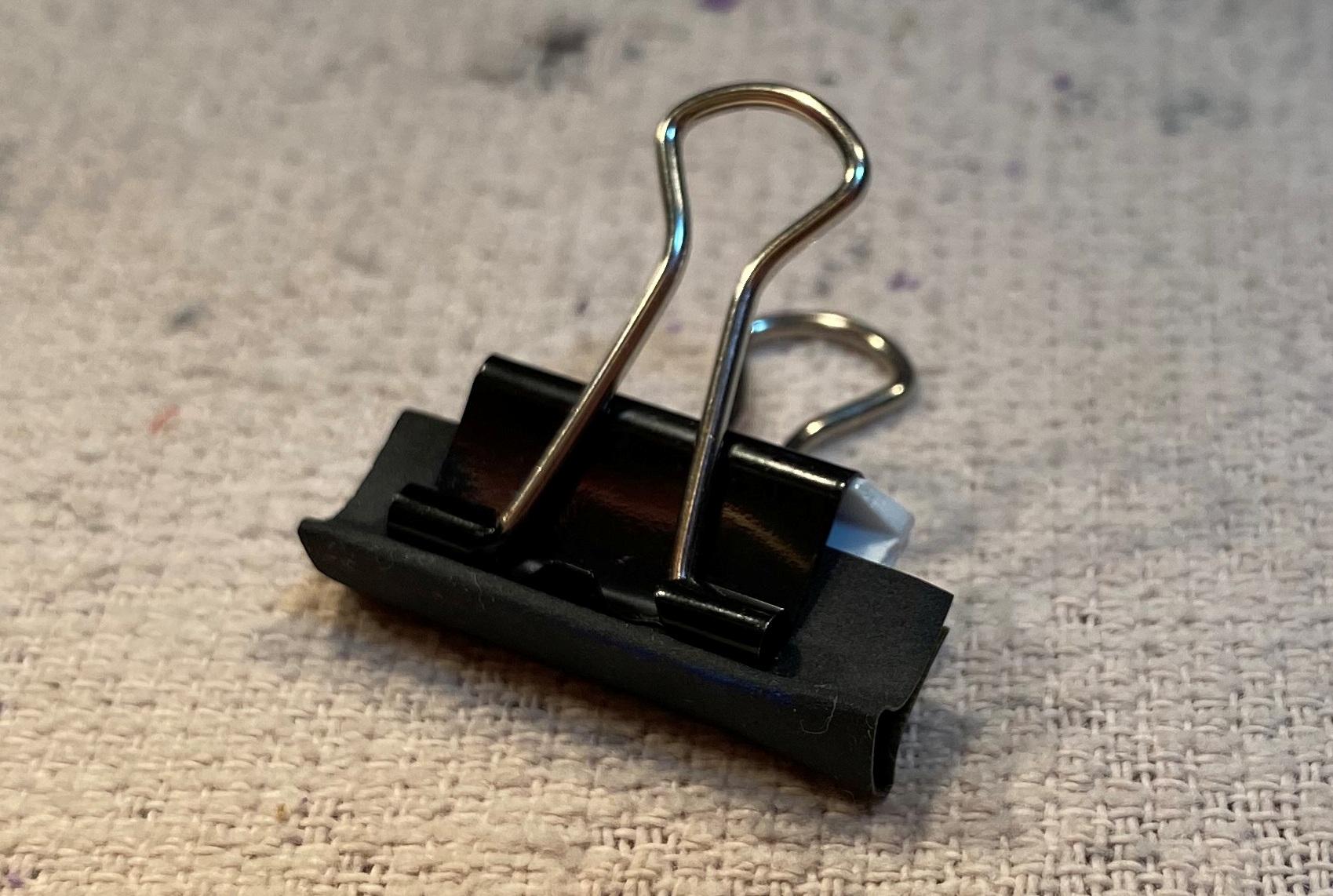

Bills72sj Posted November 13, 2022 Author Posted November 13, 2022 I could say that I have been letting the paint cure the last 6 months but, in reality, other things have taken priority. However, now that I am on my "Big Girls" project, I need some bench space to work on the all of them. With 4 new builds and 3 unintended long term projects, I need to do some clean up. I have been hesitant to sand down the ridges on the roof on each side of the white stripes. I generally do not have the patience for sanding and I did not have an appropriate tool for accomplishing the task. What I needed is a 1:25 long-board sander that can be operated by 1:1 fingers for knocking the ridges down without messing up the surrounding areas. I finally figured out the perfect little sanding block. I cut 1" of Plastruct I-beam then wrapped it with 1 sq in of sandpaper held by a mini binder clamp. It provides a narrow 1/8" x 1" of sand paper and plenty of "handle" to guide it. The real benefit is it requires zero muscle tension to keep the little bitty sandpaper square in place, even if you set it aside. It works great at the sink for wet sanding too. Maybe the Shelby will actually get done this year.

Bills72sj Posted November 14, 2022 Author Posted November 14, 2022 14 hours ago, Slotto said: Nice job on the stripes. Love that blue Steve, Thank you. Reviewing the kit directions has you laying decals last after you have installed things in the way like windows and bumpers. The pics show the blue to be a bit more vibrant than reality. It is the nice shade of dark blue I was looking for. 10 hours ago, bytownshaker said: Your Shelby is looking great! Neat idea for your sanding block. Edgar, Thanks. Sanding is one of my most feared tasks. I would rather do someone elses BMF if they would do my sanding. My new little sanding block gives me really good control of what gets sanded without the unsupervised edges messing something else up.
