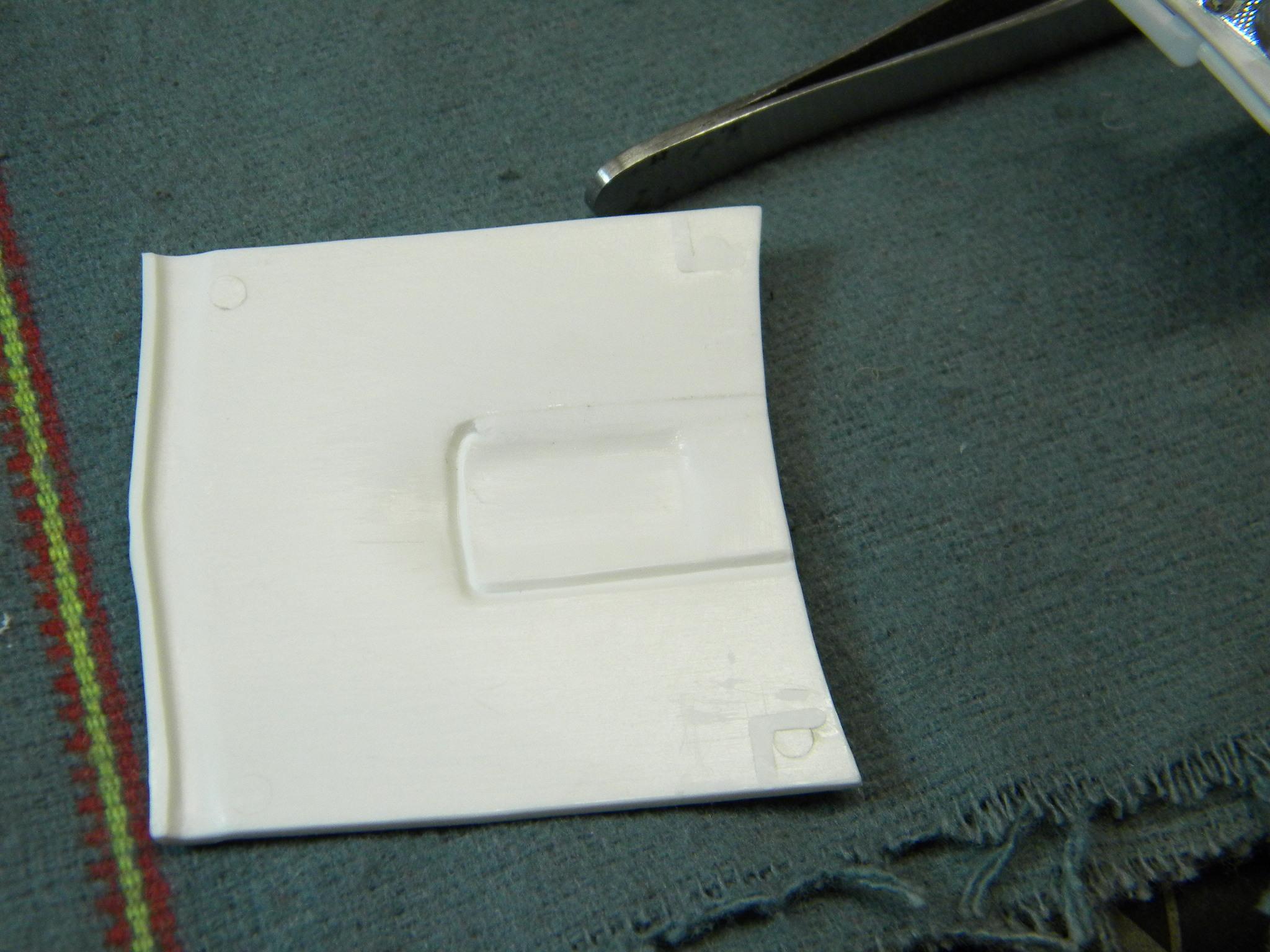

Well, it's a little time consuming, but the first of the scratch built door panels is pretty much finished.
The detail is more pronounced than the actual 1:1 door card, but I think that I actually prefer that anyway.
It will add more definition to the interior.
Steve

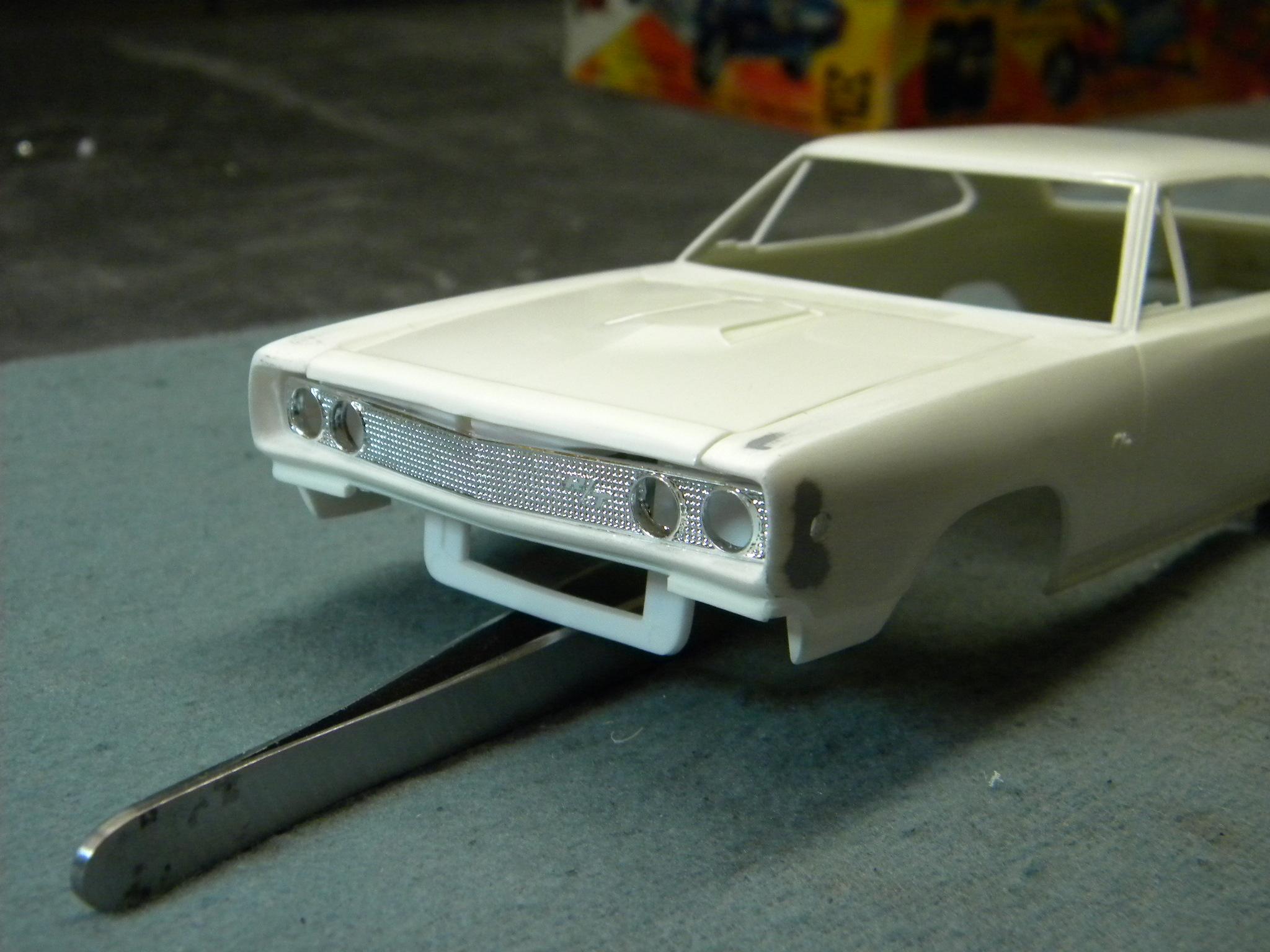

I decided to take a break from the interior modifications and begin a little body work.
I started some preliminary scribing on the body, like defining the trim and deepening and adding some panel lines.
I also decided upon removing the wiper blades for adding separate parts later,
I've never done that before and it took some careful grinding, filing and sanding to maintain the original window trim, but I think it turned out well.
Steve

I've been playing around a little with Greg's (NOBLNG) idea for the marker lights on his '68 Charger to use on this Coronet.
I changed the technique just a little by drilling the holes completely through the body and then cutting and polishing about a quarter inch length of aluminum tubing to slip into the hole.
This way I figure that I can complete the bezel one of two ways.
Either I can add them after all of the painting is finished, (although allowances will need to be considered for paint thickness) or I can install them prior to paint and then reveal them with lacquer thinner in the end as you would a script using the "foil under paint" technique.
I think either will work well.
I'll just have to ruminate on that a bit.
I decided that this was all necessary because there are small sink marks around the front markers that would be difficult to fill and sand with the original markers in place.
Lenses I'm not worried about.
They can be made with clear or colored sprue and added at a later time.

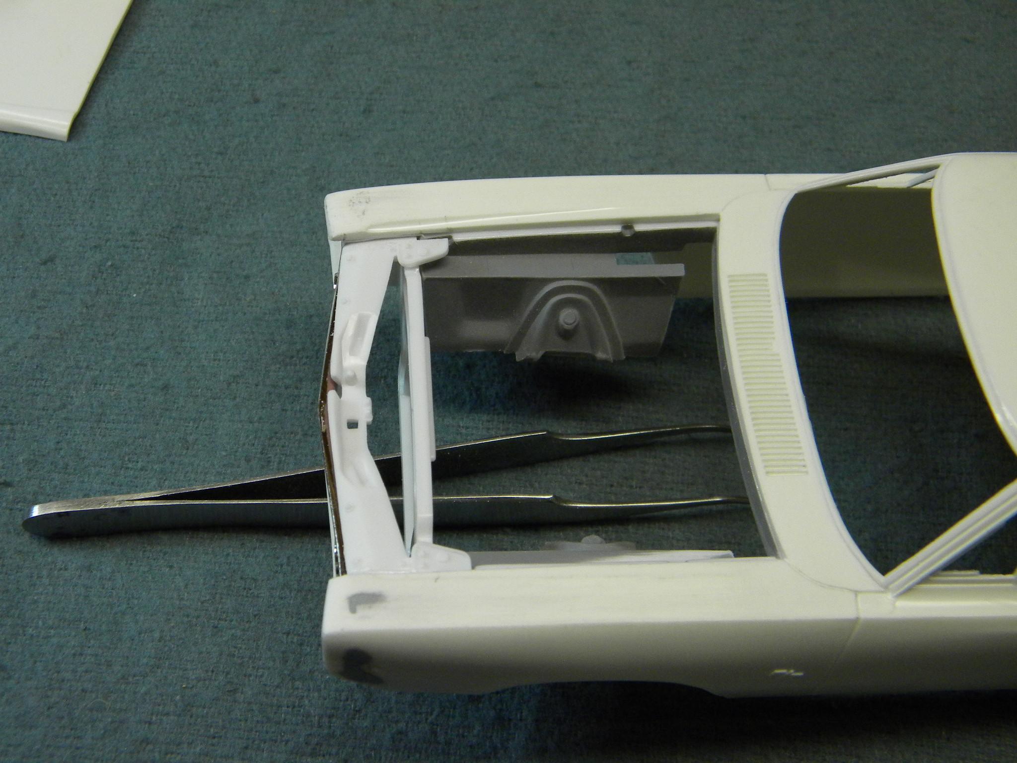

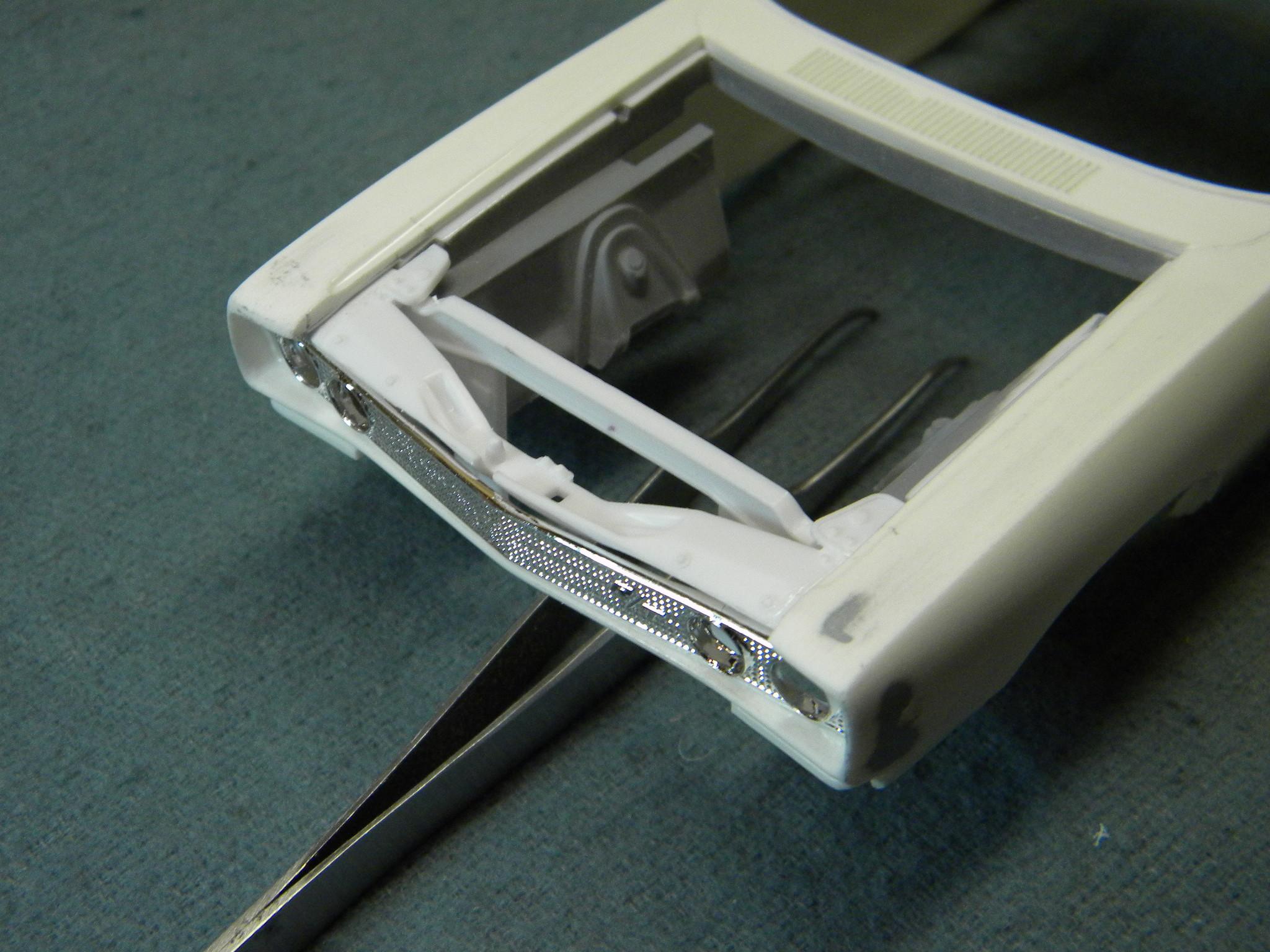

Still working on some engineering to get the Revell Charger parts to fit the Coronet.
Been spending some time modifying engine compartment parts to fit.
It was much more finicky than it might appear, but I'm getting there.
Thought that I would show how I was filling the blower cutout grooves on the underside of the hood as well.
Just a matter of finding plastic pieces that fit into the grooves, gluing them in place, and then grinding them down.
Steve

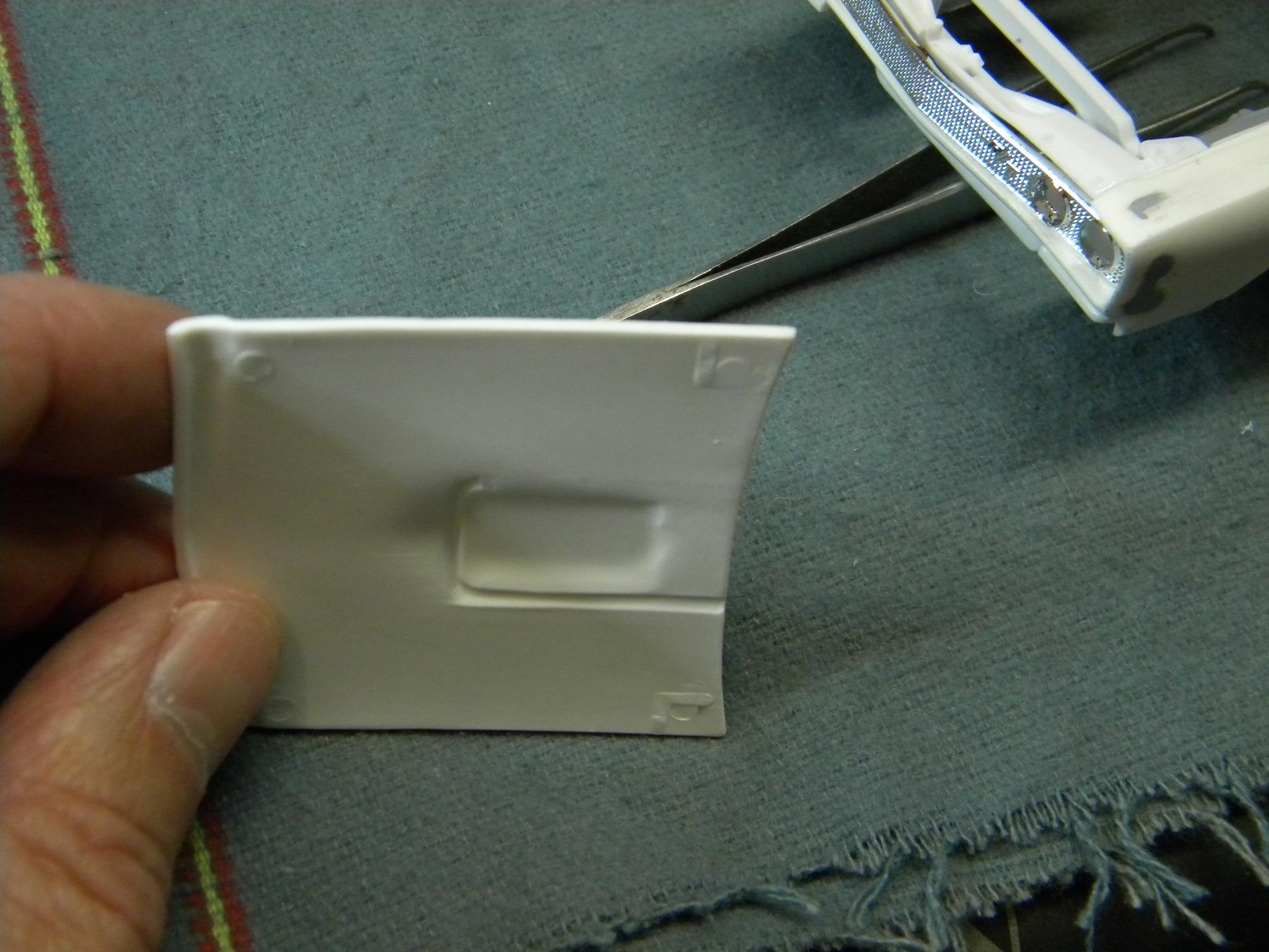

I have also re-done the door panel that I had previously finished.
The panel "cupped" somewhat from a little too liberal use of liquid cement, and I wasn't particularly happy with the "finned" portion of the panel anyway, so I purchased a sheet of Evergreen #2545 "Metal Siding" to replace it with and re-built the panel completely.
I'm liking it better.
The real test will be in a little while when I prime it. :)
