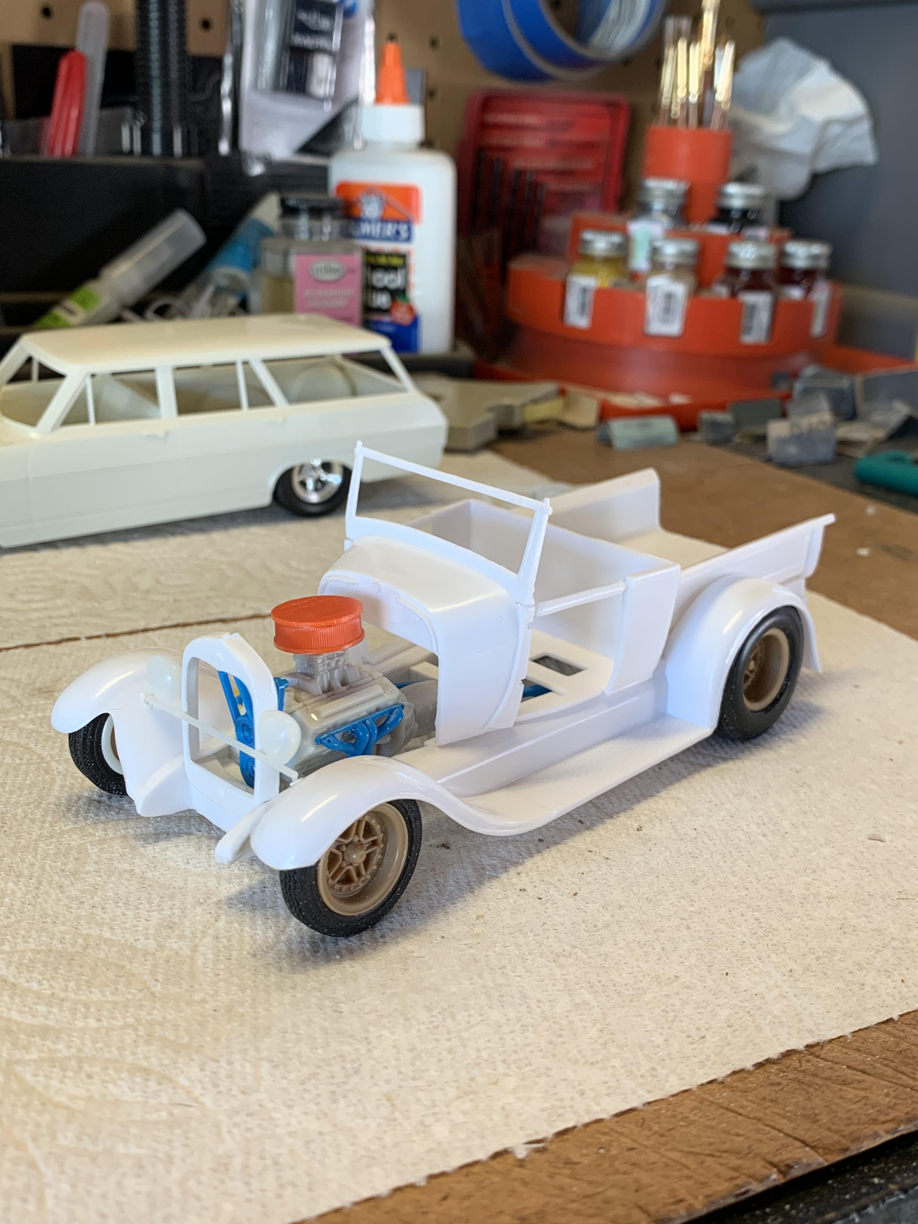

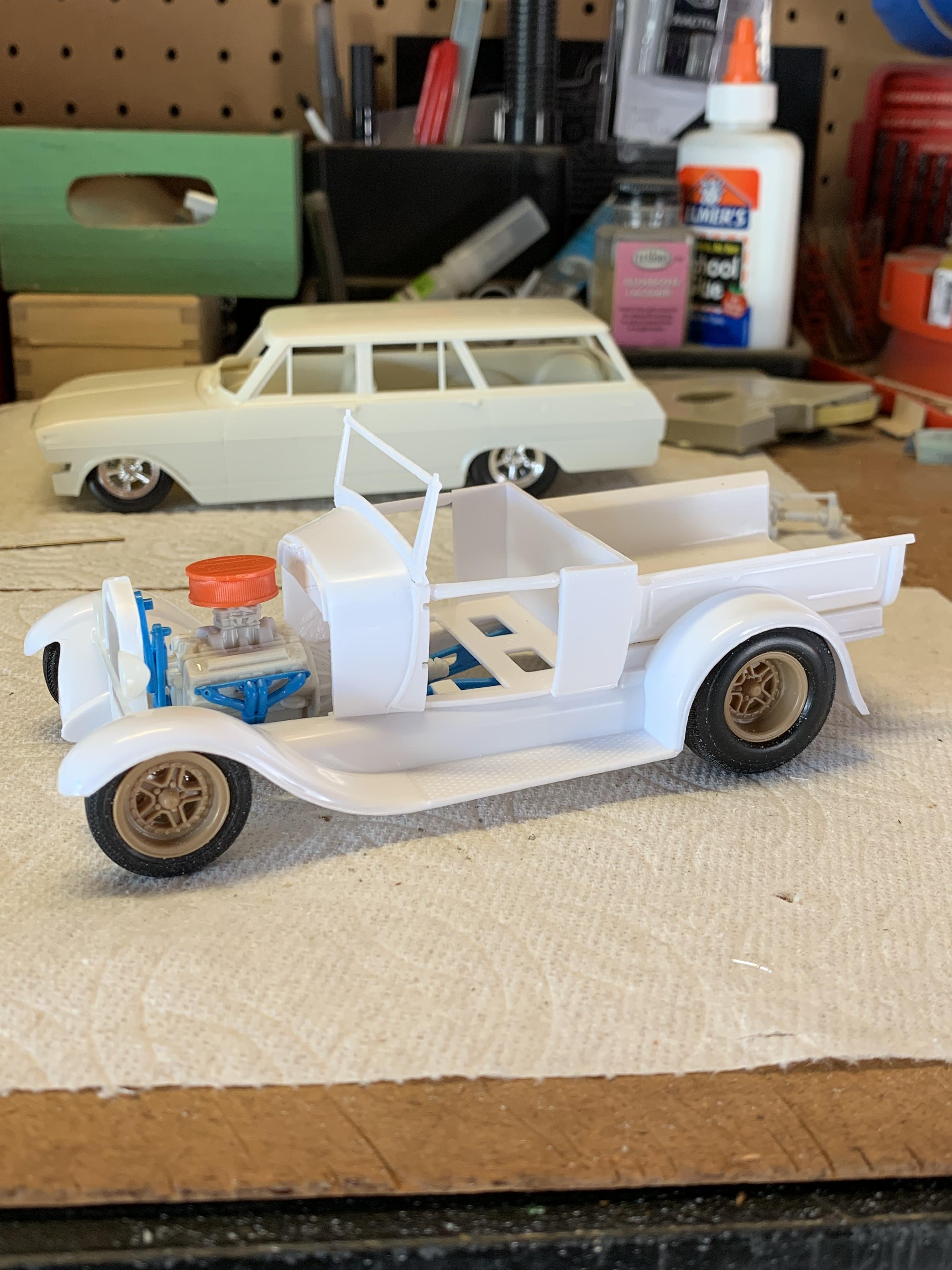

Kit Karson Posted June 7, 2021 Posted June 7, 2021 A little square stock to fill a couple of openings between the cab firewall and the roadster floorboard. Cut off the excess... Floorboard matches up with the firewall right where it belongs! Taking out the bow in the back of the roadster seat... and, sanding it square to the floorboard was a must... is going to make it fit the cab so much better! So happy with the fit! Trying to get to the point where I will have to deal with the doors. I know the door panels are going to really give the interior the finishing detail this kit has always missed! OK! You've been really patient with me and I've been holding back pictures of the mock-up! So, what do you think? -KK 1

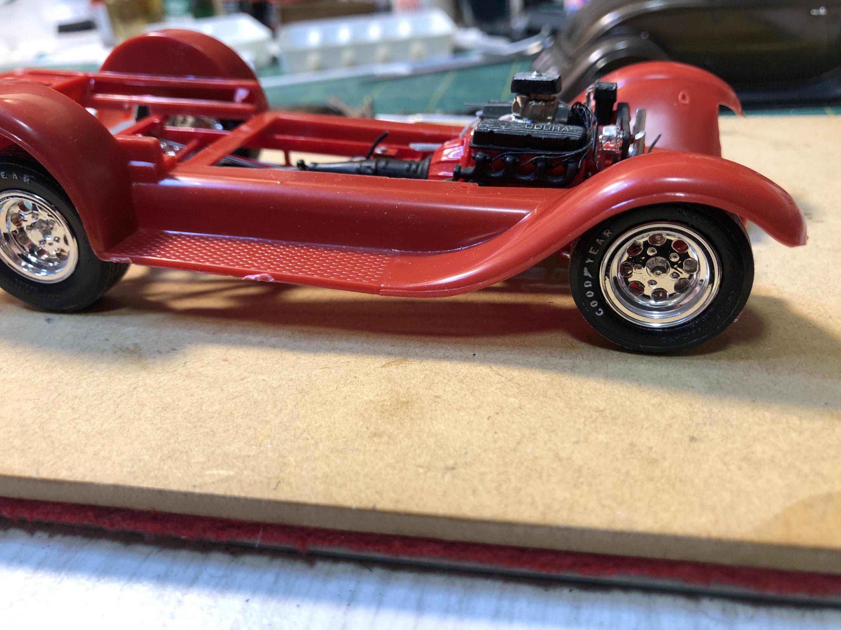

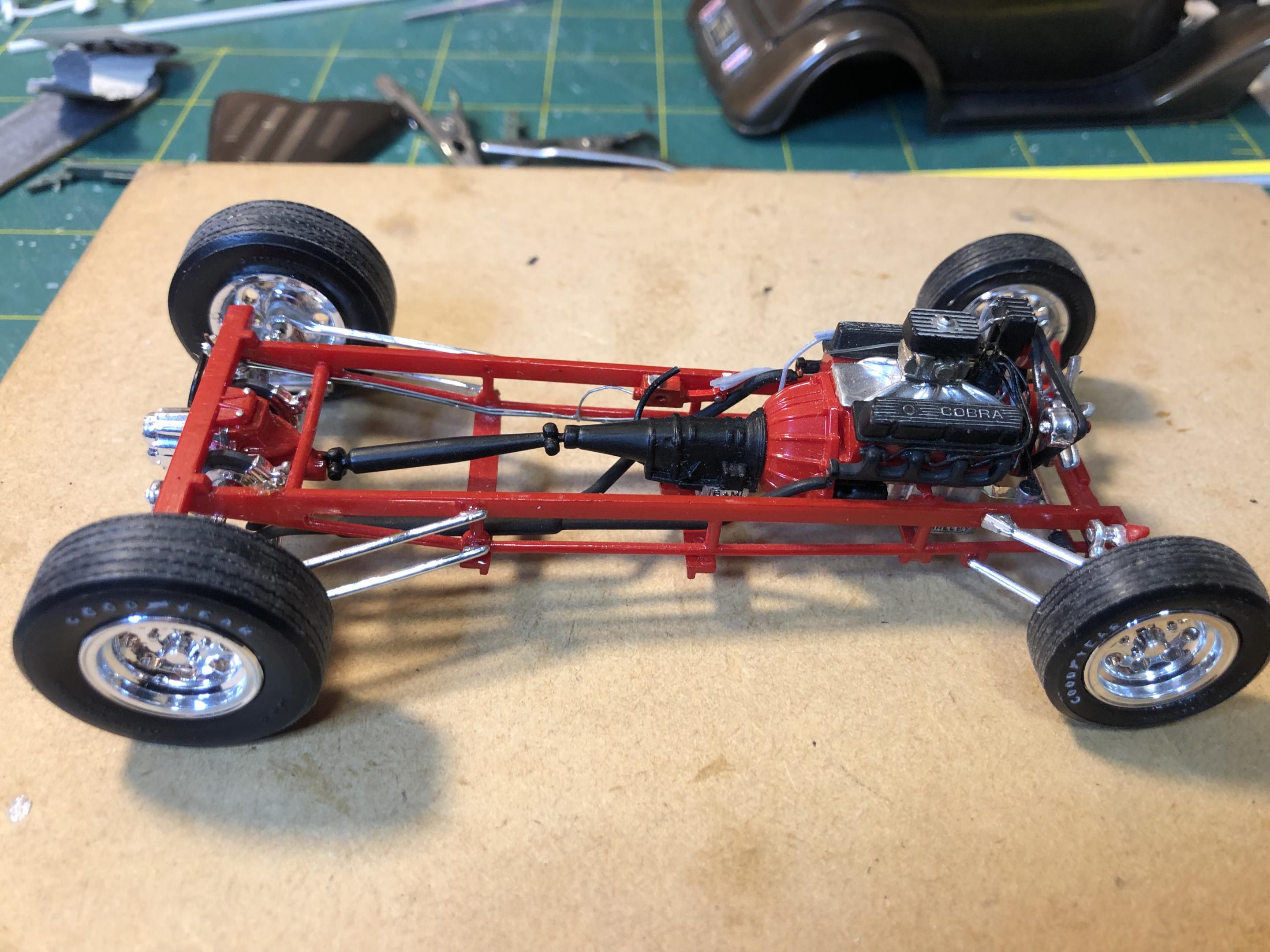

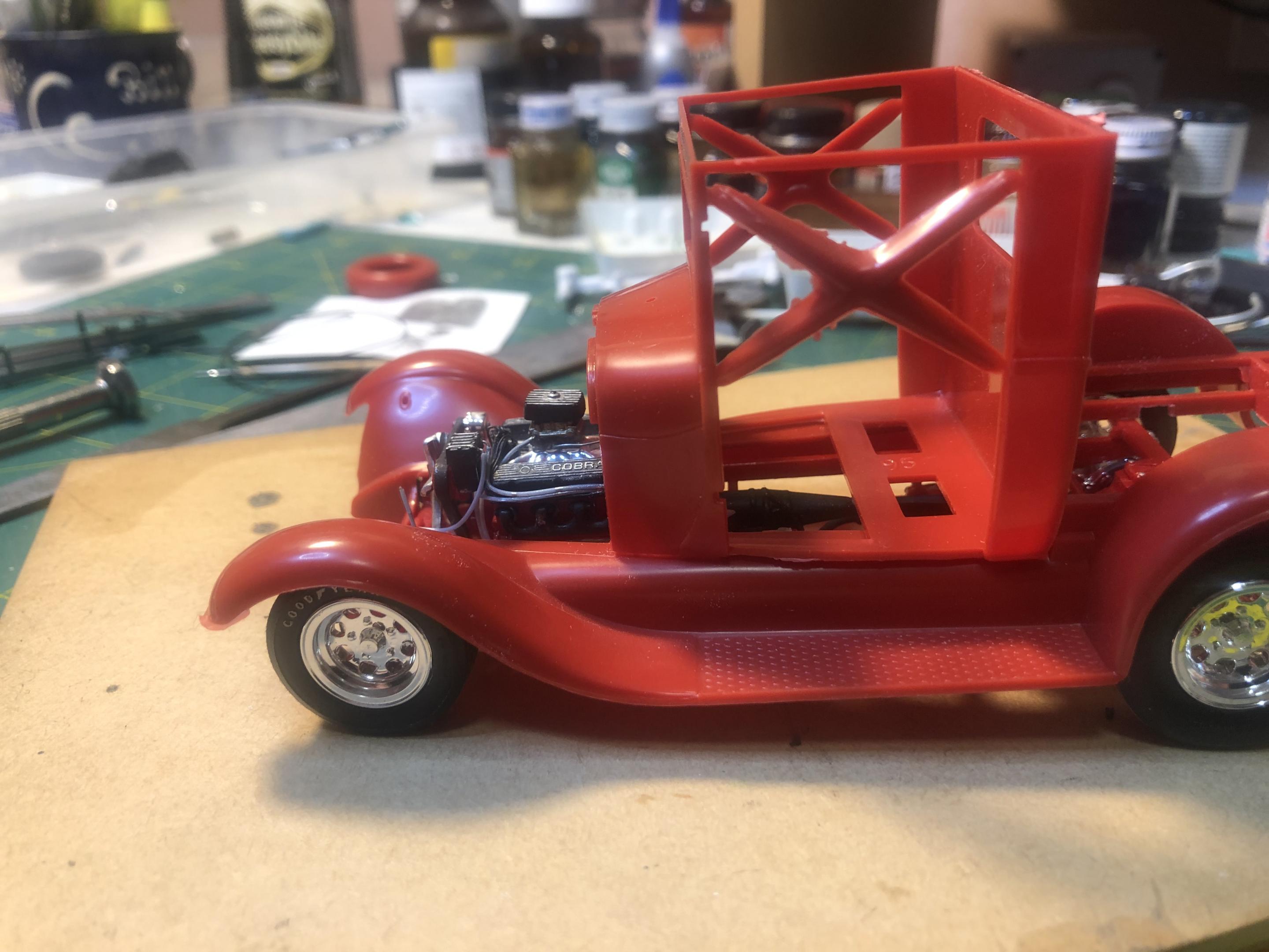

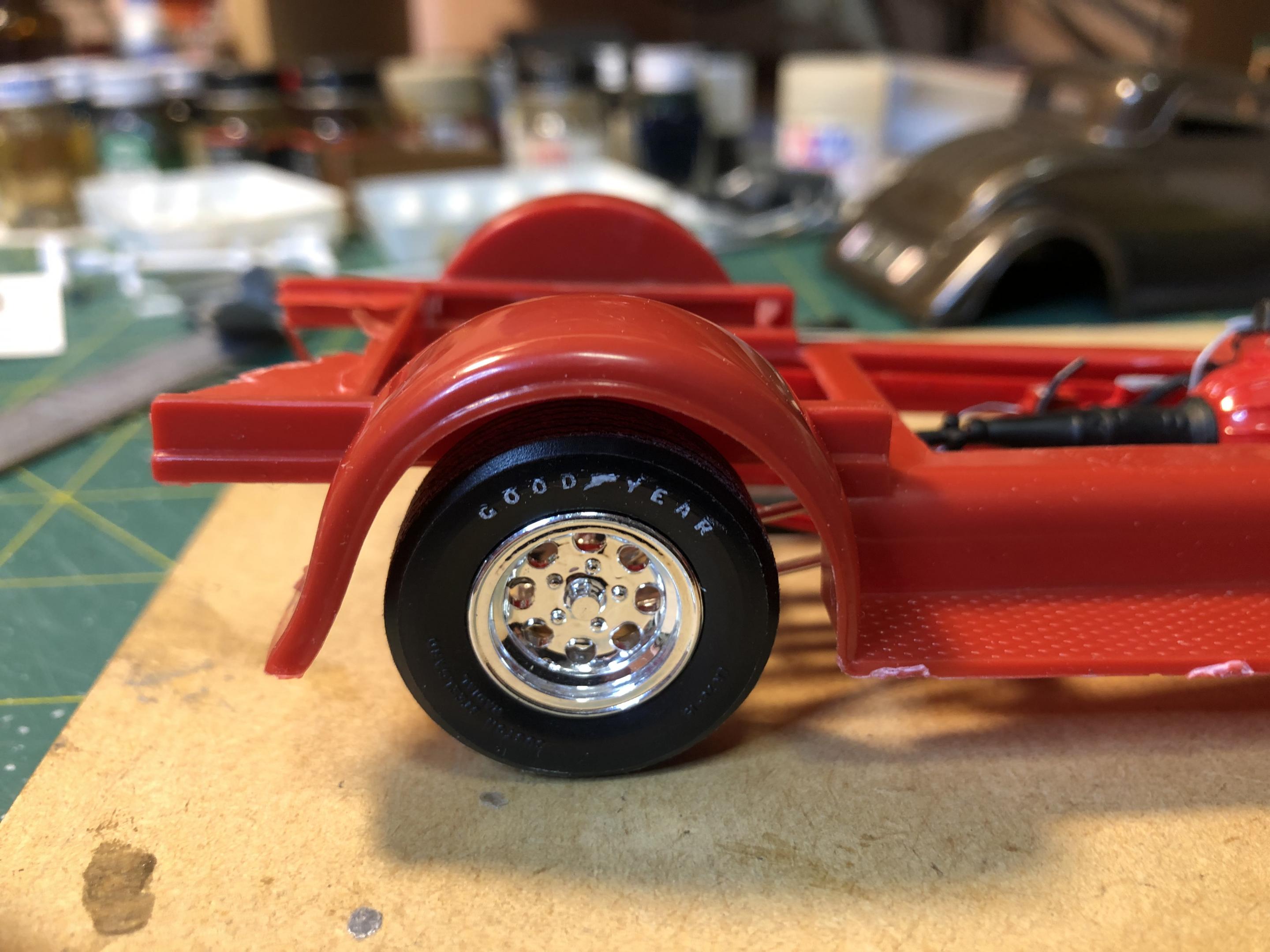

bill-e-boy Posted June 23, 2021 Posted June 23, 2021 For my rendition I am looking at the Lil John Buttera T chassis. I pulled the chassis from under the 34 I built years ago - what a struggle. I seem to remember that it was a mission to get the body mated to the chassis when I built it originally. The idea is to eyeball the chassis under the guards to see what is needed. @tim boyddid one yonks ago as posted earlier in this thread The T chassis as removed The front end looks good but will need to be moved forward a little - needs work around the apron - I may take it out altogether. At the rear I have recessed the rear cross member into the A pickup bed rails but it needs more - about 4.5mm more. The wheel base will need to be extended too. This will be the first mod to the donor chassis - not the red one, a virgin one It could do with some taller tyres in the back so will start hunting out some. The 37 Cabrolet are wider but the same height. Any suggestions? The top suspension locator bars on the front end rub against the guards so some relieving will required. The fire wall will need to be recessed a tad to fit the motor in there. I am just glad that I have access to a built up chassis to see what I will need to change to get it together. Saves a truck load of time of change - test fit - change - test fit ........... 1
alan barton Posted June 24, 2021 Posted June 24, 2021 Hi Bill, Just a few thoughts. I like the idea of extending the front of the frame, and I seem to recall that someone on here, relatively recently, extended the rear of the frame. Me, I must be awkward because when I put this frame under an AMT 29 roadster many years ago, I stretched it in the middle, using a roughly 4mm long piece of flat styrene that, when fitted between the front and rear half, just looked like a heavy duty reinforcing plate for a crossmember or something. Hard to describe so I will get a photo tonight. Maybe not the best engineering of a tube space fame in the world but it did avoid rejigging front or rear end brackets. My favourite hot rod rears are the Monogram radial GT s that came in a lot of their muscle car kits - I recall the Heavy Chevy Chevelle particularly and the Street Stalker Camaro but I am sure there are lots of others. I normally use the larger diameter - they are wonderful, but I just ran out so am using the slightly smaller diameter or my closed cab, which I don't mind on this theme. Hope that helps. Cheers Alan
bill-e-boy Posted June 24, 2021 Posted June 24, 2021 Thanks Alan The rear fenders are huge and need fairly large diameter tyres to fill them. On the Lil John T he must have fabbed new rear fenders to match the tyres he used. They have a smaller radius than the originals I think I have seen a pix of the frame stretch somewhere so will look at that but the rear does need to be lifted up so may end up doing something along the lines of what @tim boyddid. May a combo of the two May be a few days as a "real" project in the "real" workshop has priority on my free time at the moment
