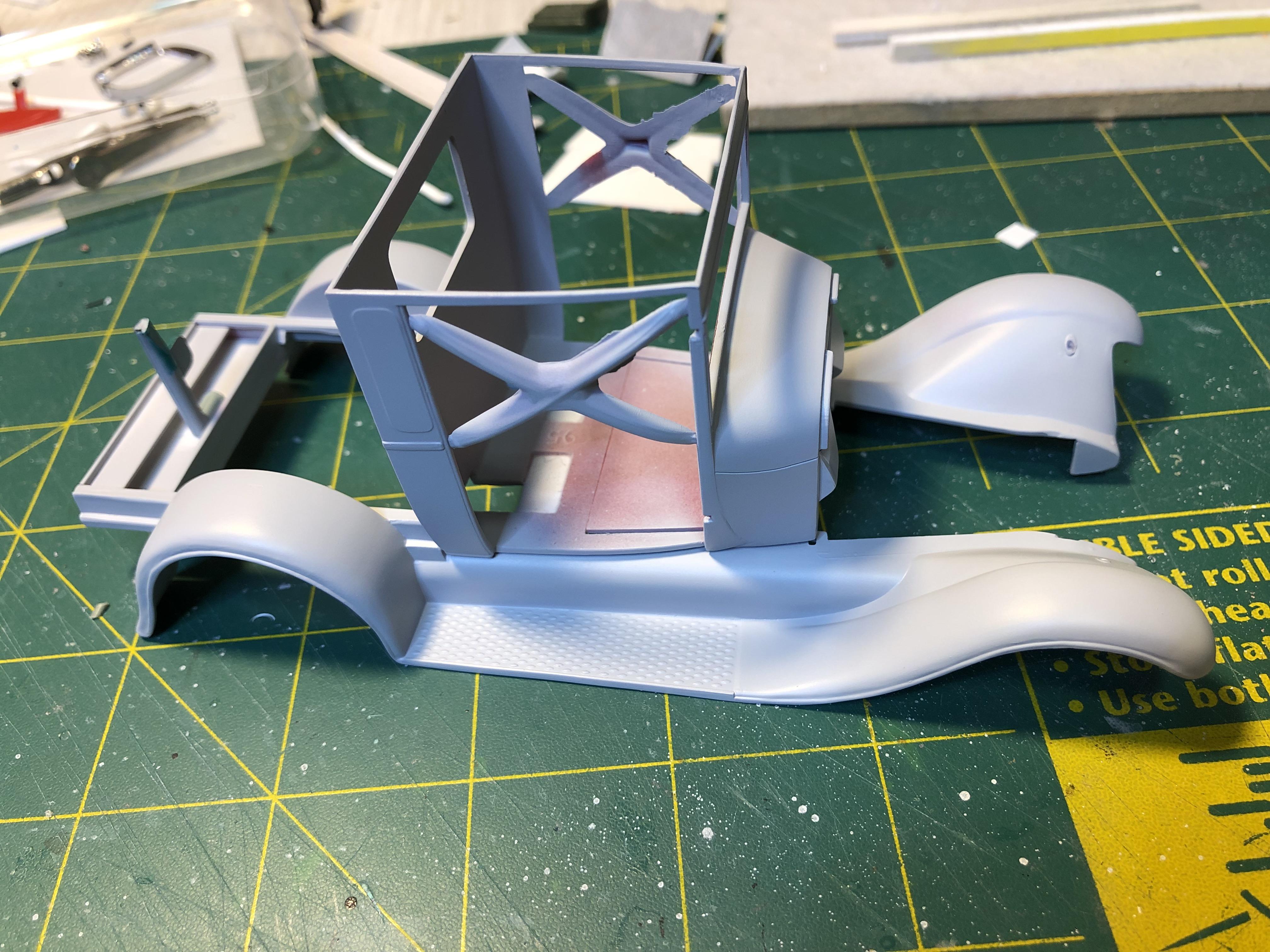

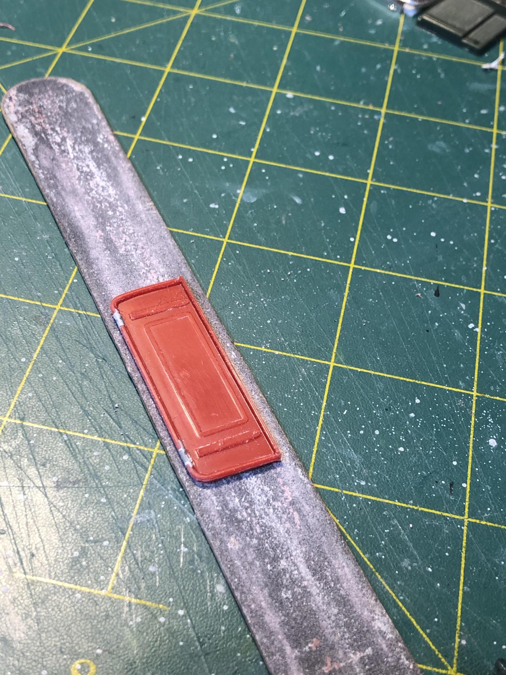

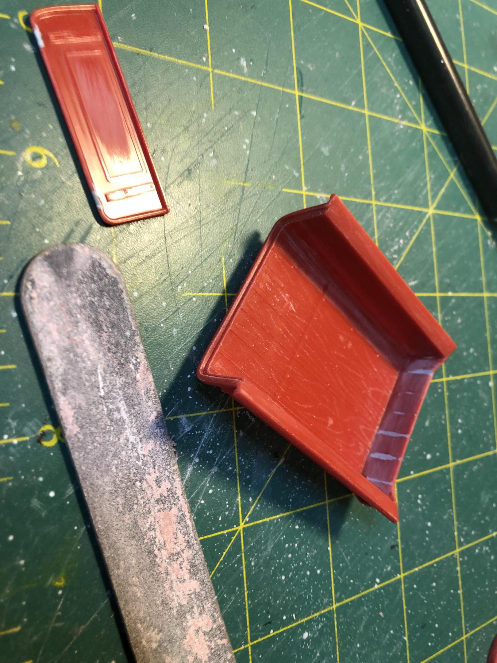

bill-e-boy Posted November 8, 2021 Posted November 8, 2021 Kit - I hope round two of your paint job works out better than the first I have been spending time getting things cleaned up ready for paint I block sanded the inner of the tail gate only to find it is blank on the outside - but at least it is smooth on the inside. Been working on the firewall recess and floor board area, cleaning up the pick up bed. There are lots of shrink holes all over the kit so takes time to sand and fill these areas. Next will be the doors When rummaging around in the bottom of the model boxes I found some bits and just could not help myself We recently went on a mid-week cruise and ended up at a Rodder's place and he had a 32 PU with a banger with OHV conversion - which caused a light bulb moment - PU bed candy So I started with the basis A block, gear box and other bits. The Cragar head is basically just a lump and that was easy to build up by layering plastic sheet to get the ight height. The original water pump bolts up as does the inlet manifold Head needed a little machining to create the spark plug recesses - onto the mill to do that. had to make up a 2mm cutter to do that first The head bolts are on a landed area so drilled out and glued some round stock - just need tidying up The crowning glory is an ally rocker cover I machined up - it was a mission as it is the first rocker cover I have machine so I now have a system that should work in the future So a little side trip to break up the tension with being heavily involved in a one kit build Thanks for looking 2

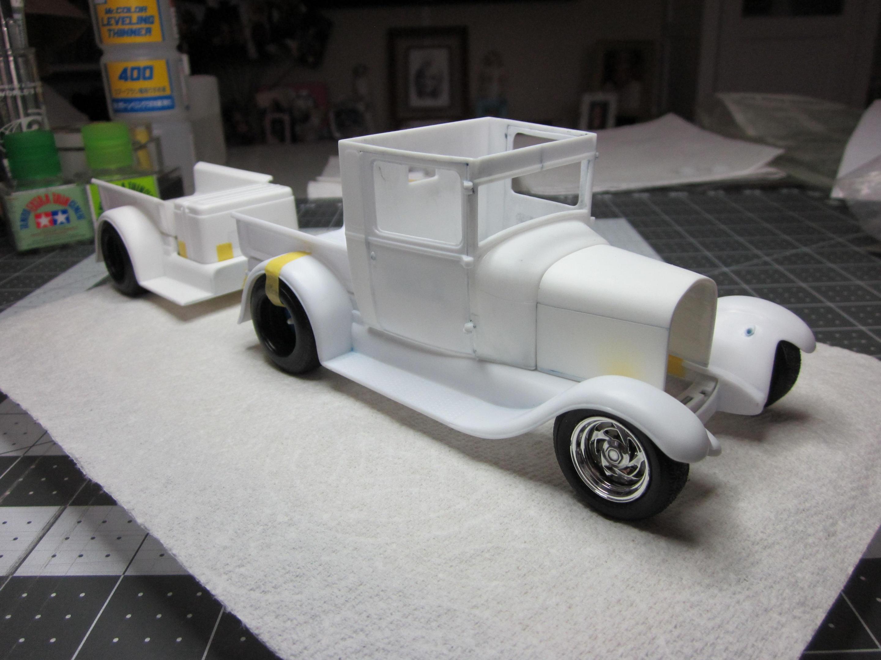

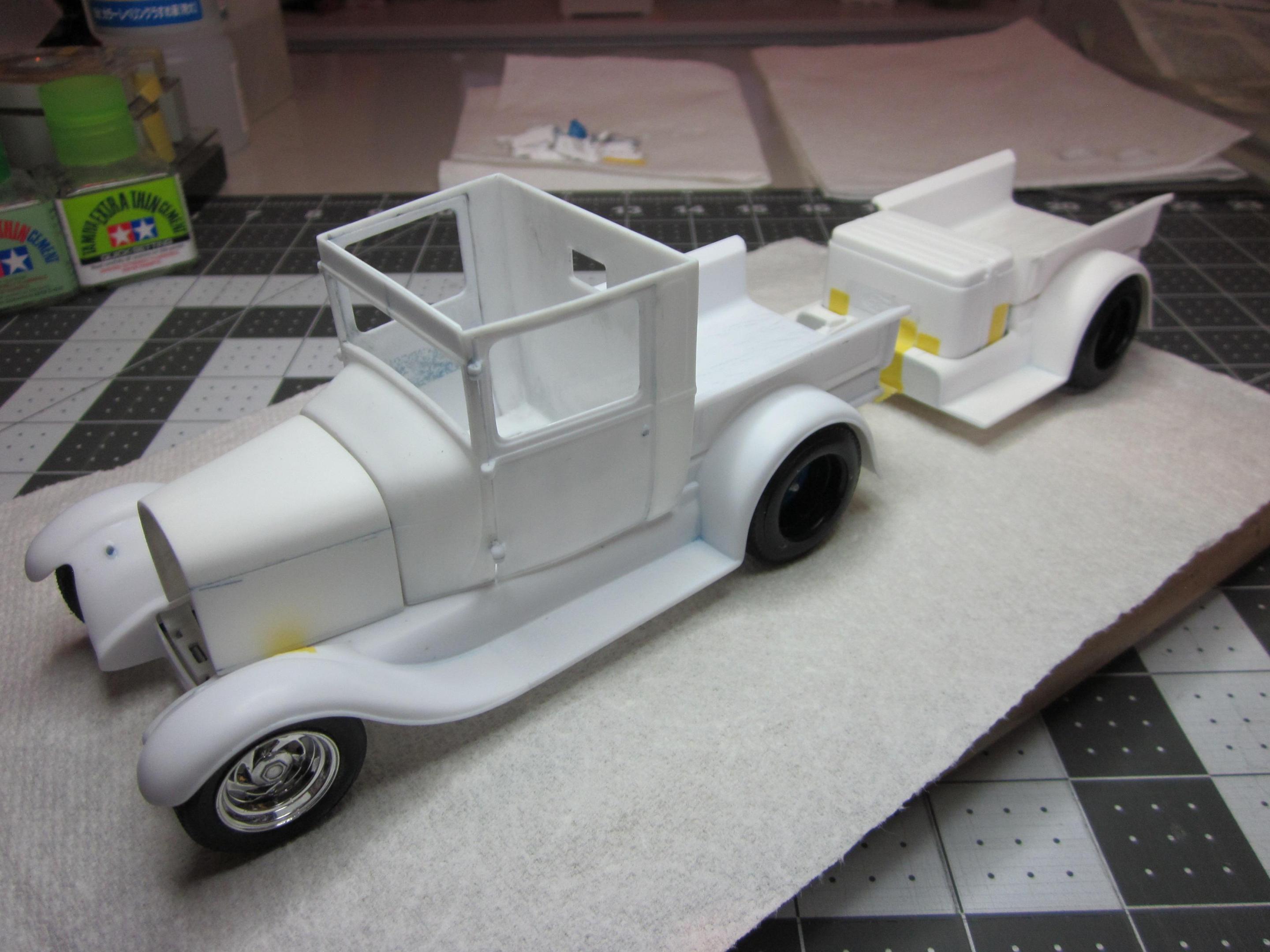

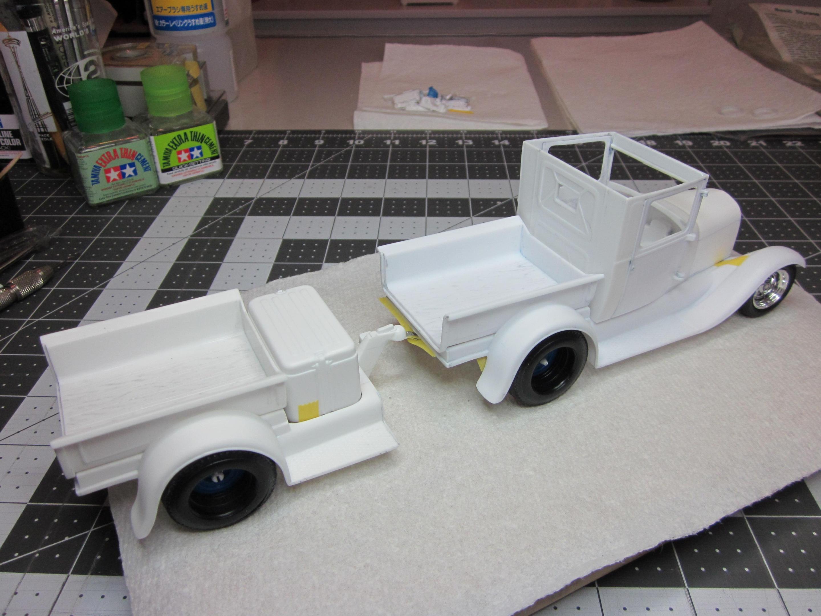

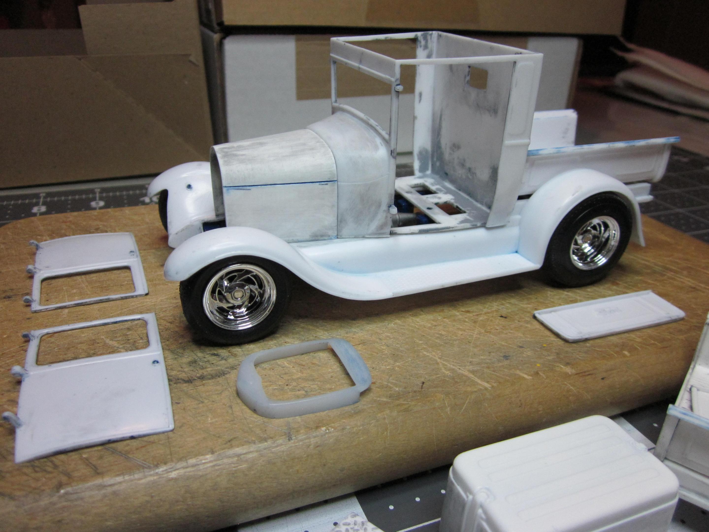

Speedpro Posted November 13, 2021 Posted November 13, 2021 (edited) Before i get going on kit's repaint project, I would like to say that my 4,588 mile round trip from my home in kalispell montana to kit's home as well as attend the Acme Southern Nationals in atlanta was worth every minute of the 70 hours behind the wheel. Thank you kit and your wonderful wife donna for your hospitality brother. I hated leaving! Really miss you both. On to the truck repaint. As you already know, kit has taken care of stripping the paint. After accessing the parts, There is a lot of sanding to be done to get them ready for primer. The frame is also currently in the tank removing the paint as it needs to be redone also. For the most part, Kit did a good job removing the paint so far. I will be test fitting all the parts making sure assembly will be as smooth as possible. Here is a picture of what i brought home with me......... Let the fun begin. I will update progress as i get through this. Sanding will take some time i think...... Speedpro Edited November 13, 2021 by Speedpro

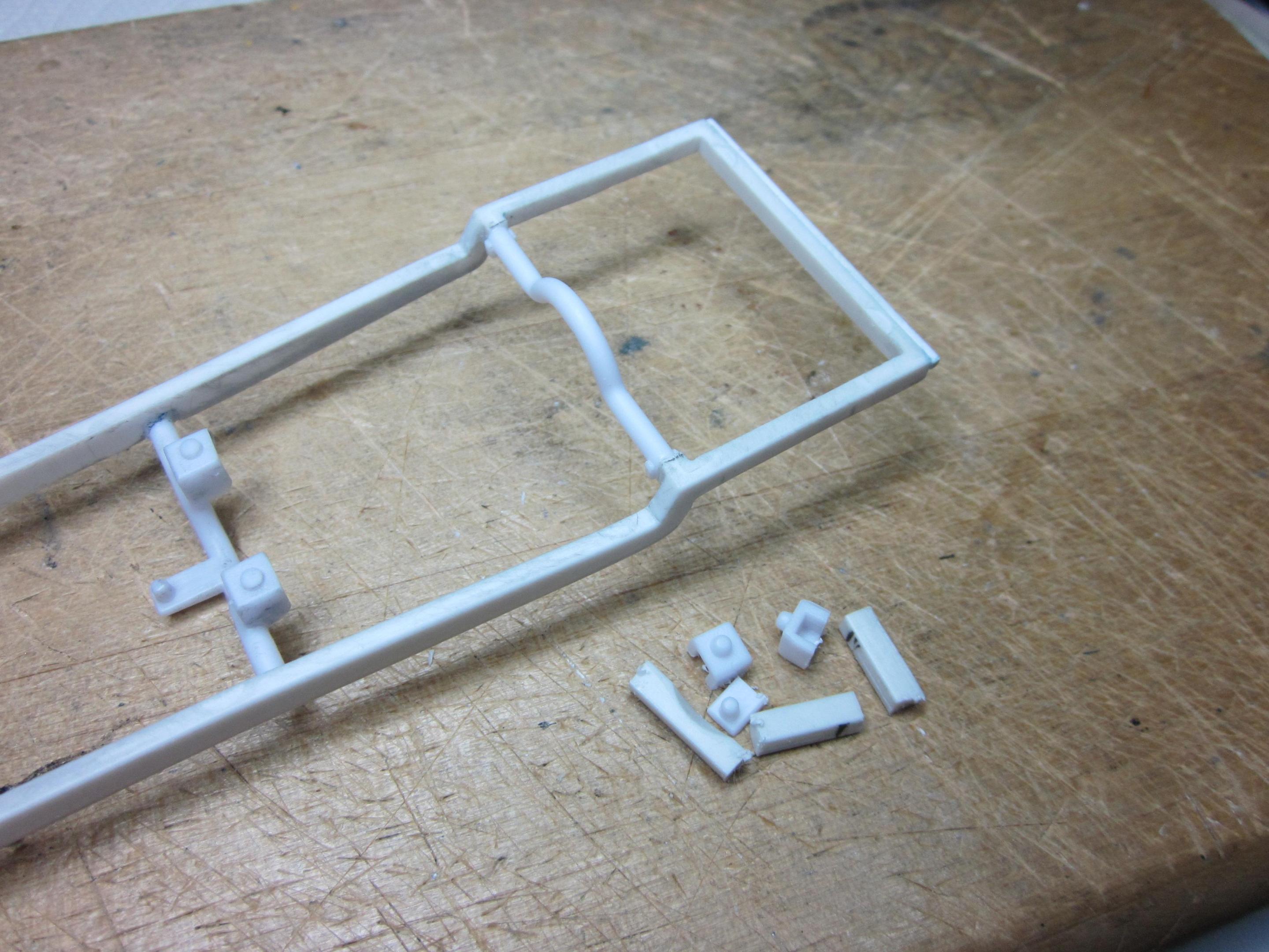

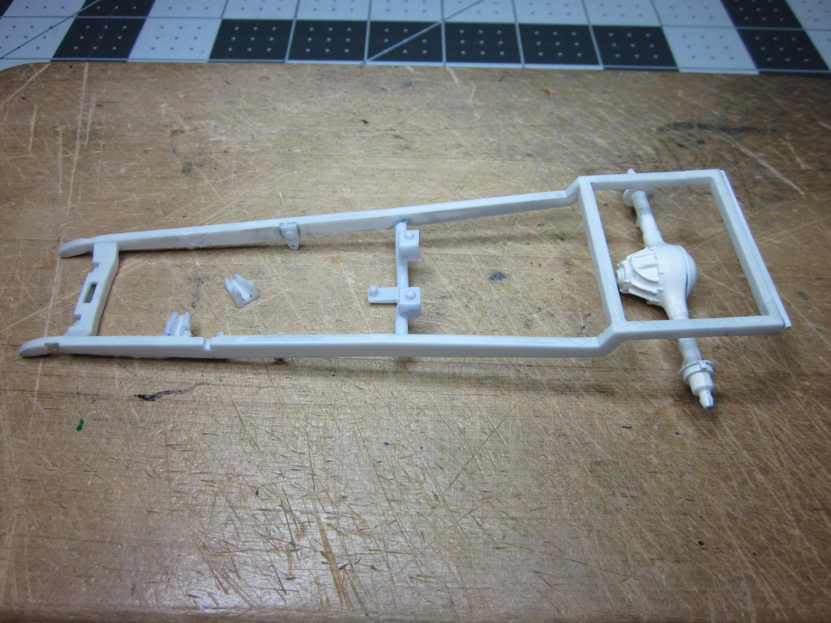

Speedpro Posted November 13, 2021 Posted November 13, 2021 Had the frame for Kits '29 in the tank overnight. Came out very clean and but still needs a going over. One of the motor mounts fell off and needs to be reattached. Stripped the rear end also as the paint was light in some areas. 1
Kit Karson Posted November 14, 2021 Posted November 14, 2021 @Speedpronow that we've talked about some of the deficiencies, I feel confident that the '29 in in the right hands. Handing it off to you wasn't as difficult as watching you leave to go back to Montana! Glad you had a safe return trip, Brother! Keep us up to date on your progress! -KK

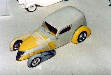

Kit Karson Posted November 15, 2021 Posted November 15, 2021 (edited) 12 hours ago, tim boyd said: OK...so that explains it. I was thinking I must have missed a key point in the thread here. Kit....takes real guts to hand off a project to someone else but will be great for you (and us) to see it finished. Paul....best wishes and best of luck bringing this awesome project home to completion! TIM It's not the first time... over the last three plus decades I've passed several builds off to other great modelers! Any time two or more modelers get to contribute to particular build the best of the contributor always immerges! Case in point: the '37 Ford Fat-O-Fender (above) Paul (@Speedpro) & I built it almost thirty years. @Rocking Rodney Rat(RRR) & I have collaborated on a number of builds and a select few have been passed on to other luminaries in our hobby. Short story... K&R Kustoms+Rods SD 40 de Aire Barn Find It all started with a sketch that Rodney (RRR) brought to my attention: Early development rendered the body: With a little more work... our SD 40 de Aire had more air-miles than most frequent flyers! RRR laid down a fine Candy Orange Flak paint job: (Lost Picture Never Seen 'til NOW!) Fast forward to March of 2019... I had a conversation with a well respected kustom model kar builder and exchanged mailing addresses. RRR had located the missed placed K&R Kustoms+Rods SD 40 de Aire after a brief search and packaged it up and it was on the move a month later. Again, the SD 40 de Aire was stripped, honed, with a new beltline added and a new layer of primer added: And, the new owner, "Chopper" Ted Lear, was caught sharing the K&R Kustoms+Rods SD 40 de Aire prior to the 40th NNL in Toledo in late 2019: This is the last picture he sent me before he passed, R.I.P. Brother! I know where Chopper is, but the whereabouts of the restored SD 40 de Aire is still unknown. -KK Edited November 15, 2021 by Kit Karson Text correction... 1

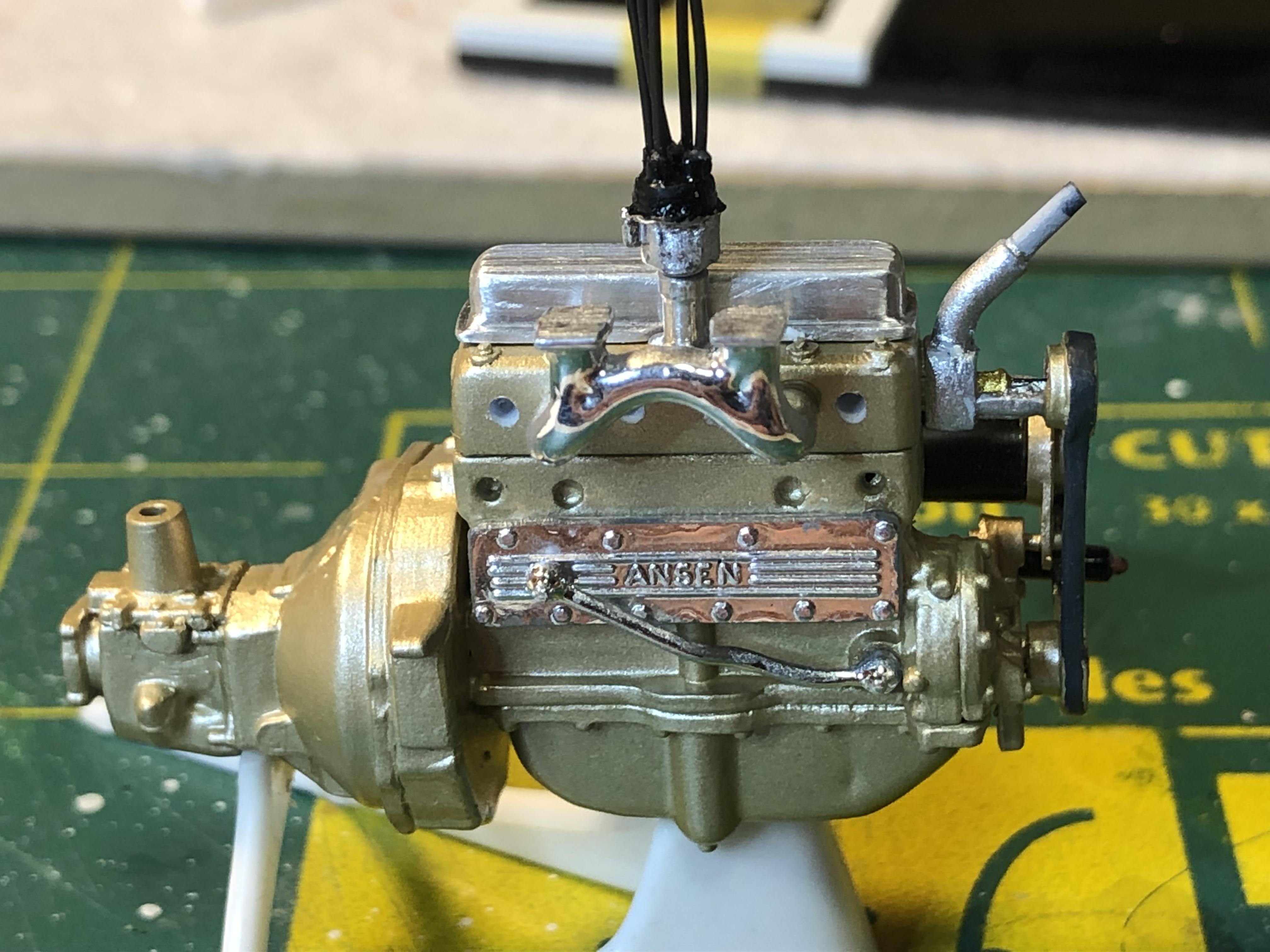

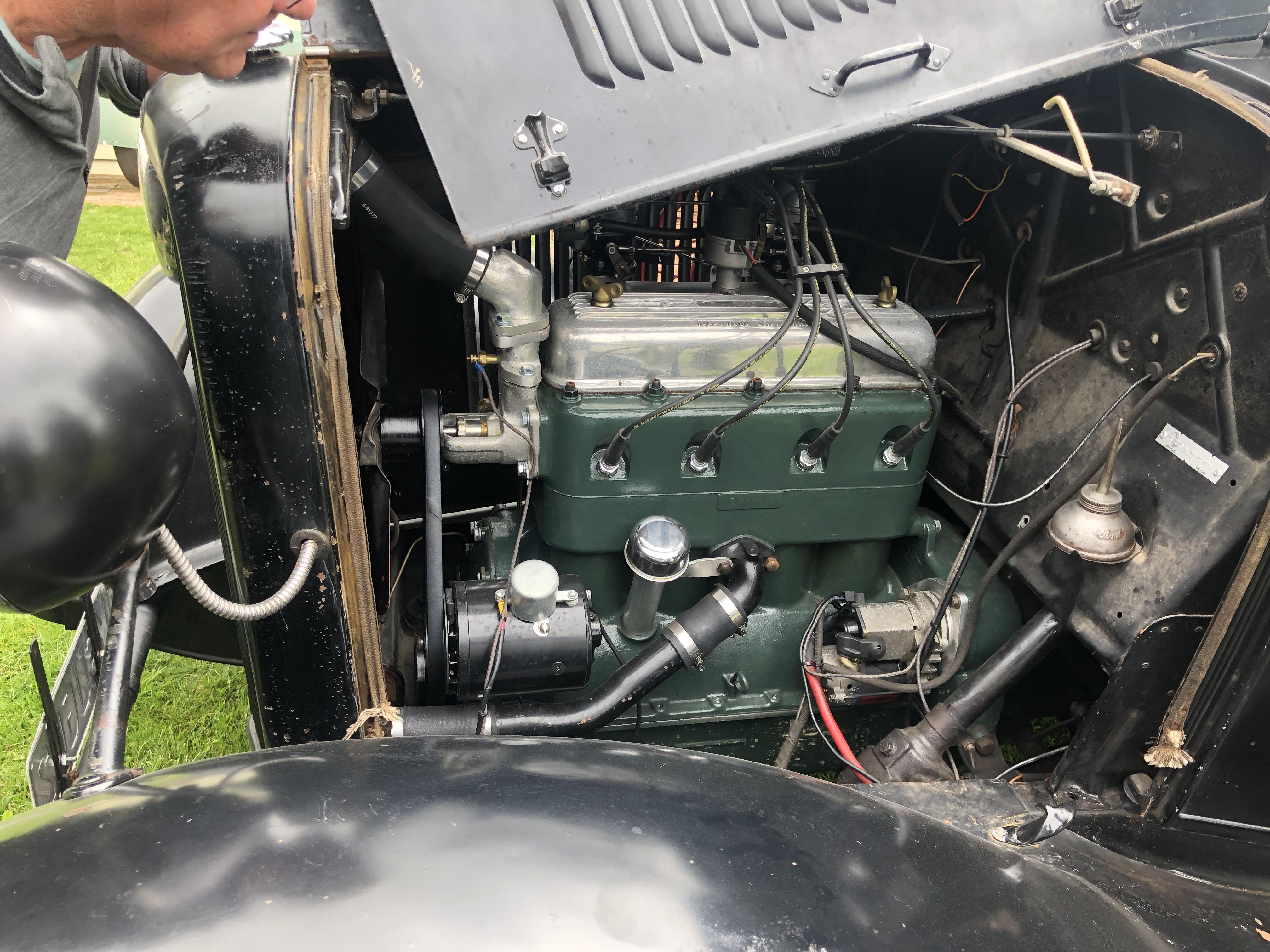

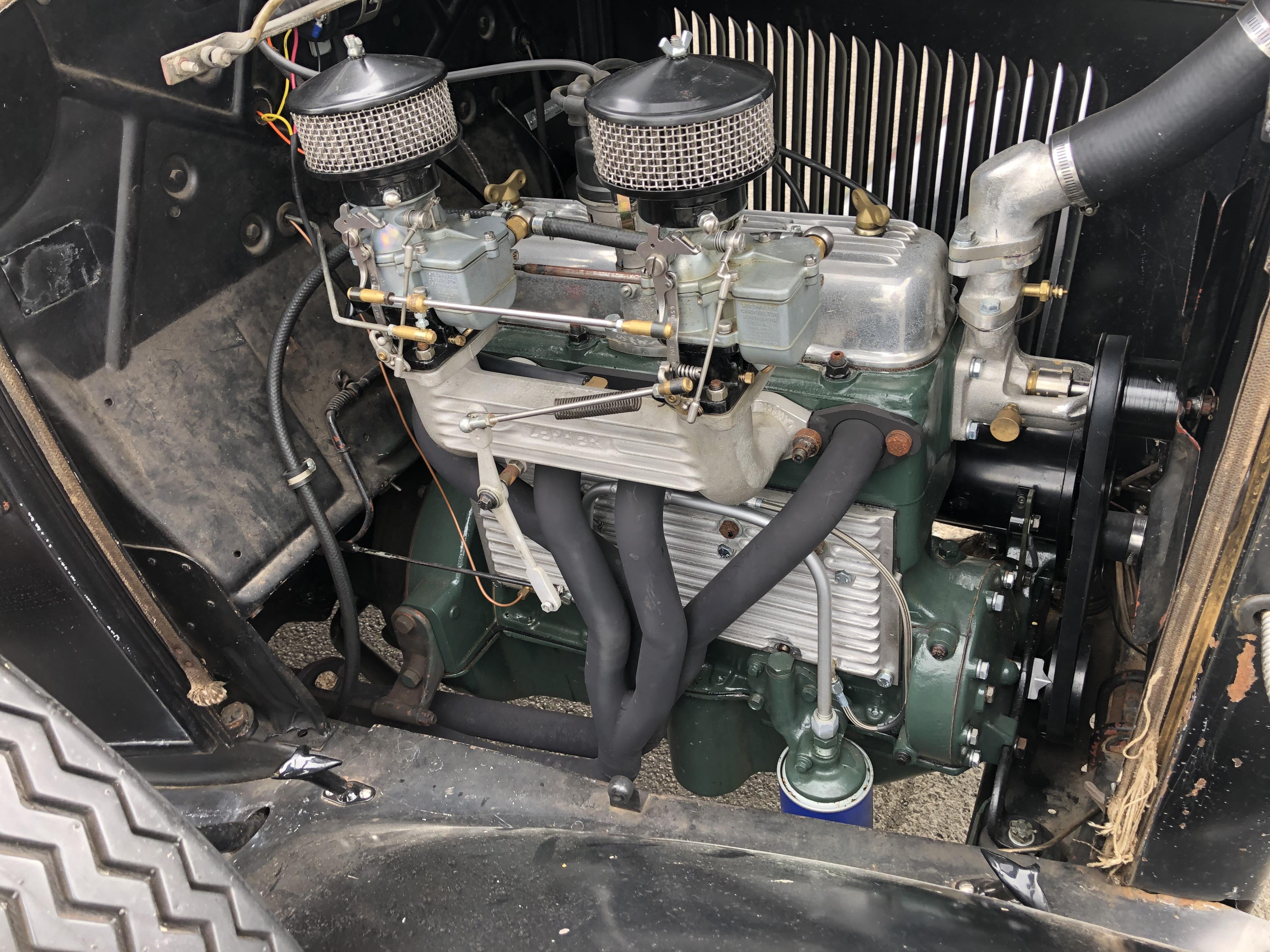

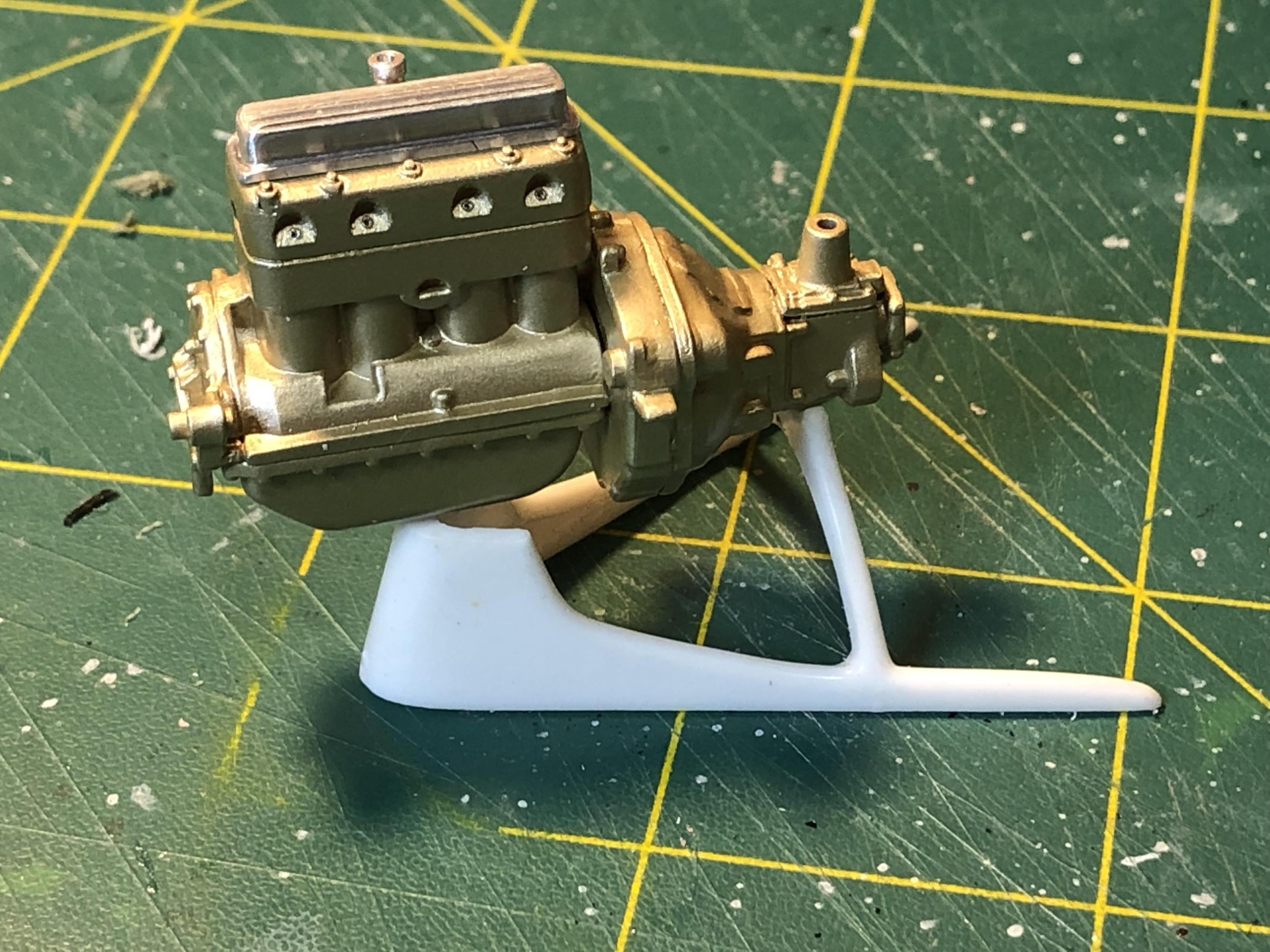

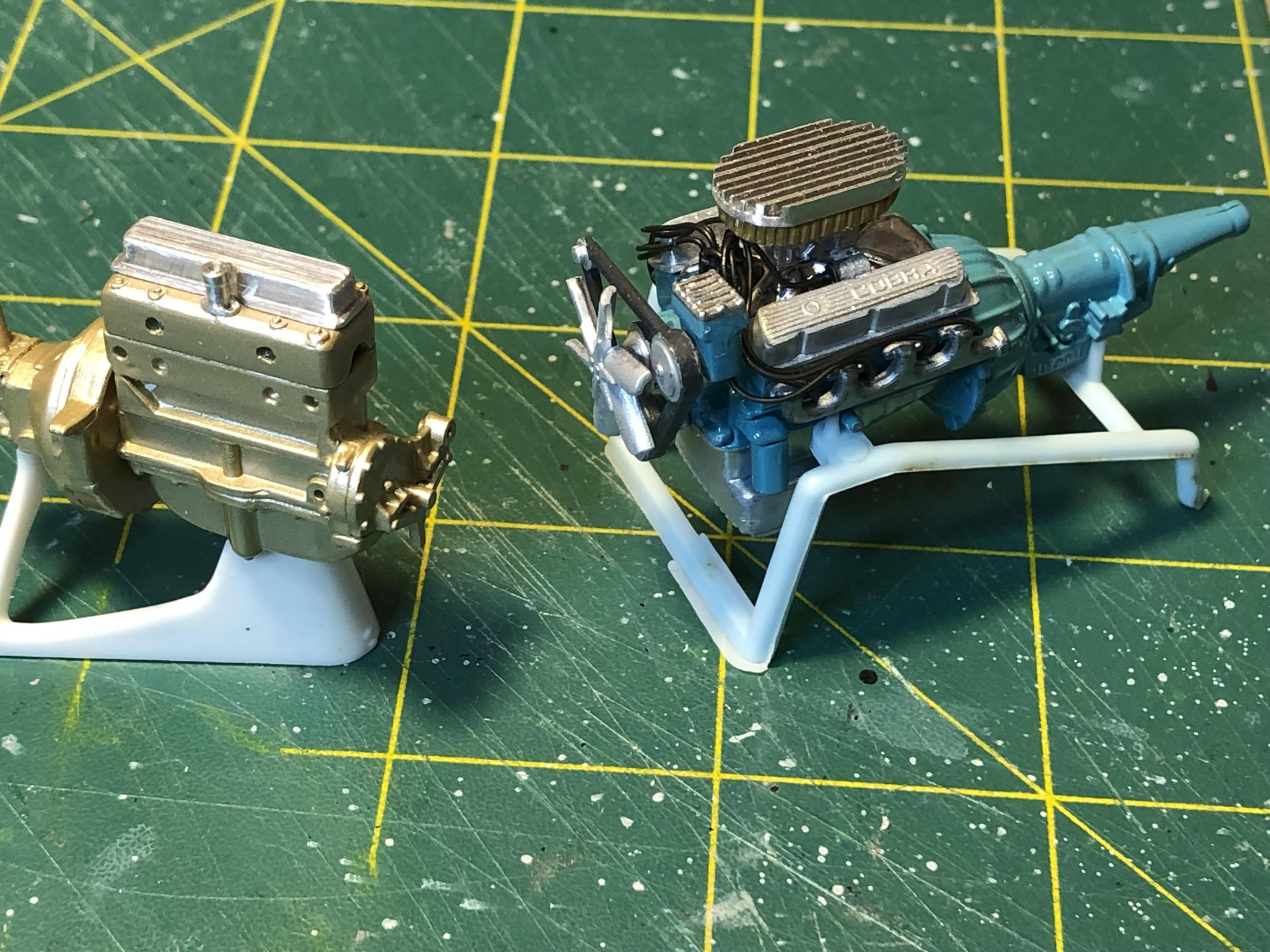

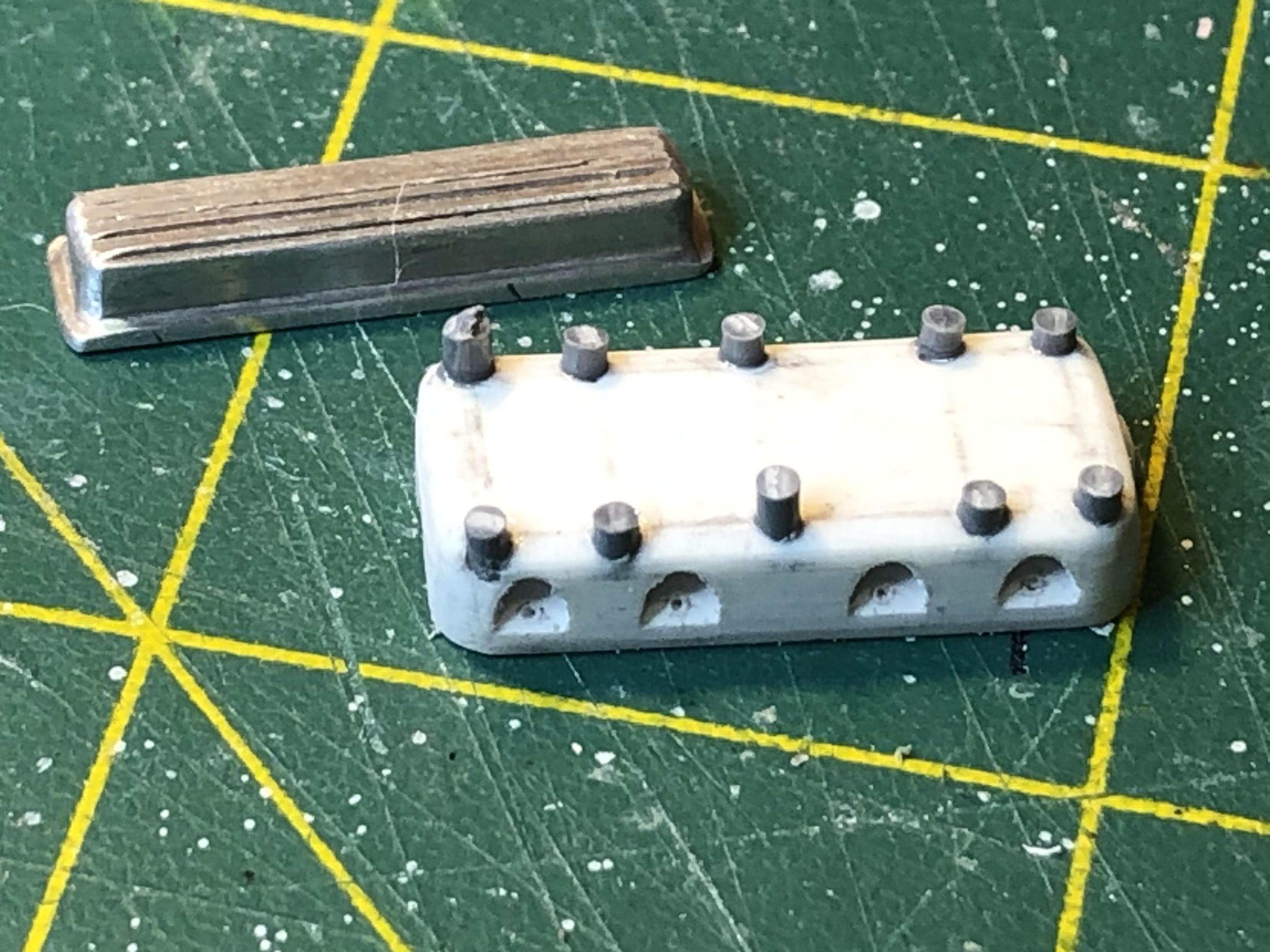

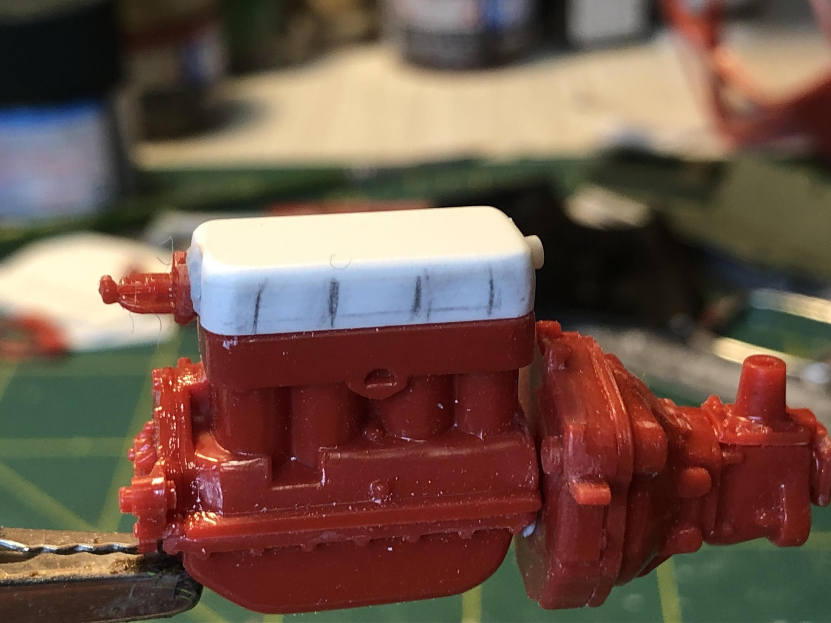

bill-e-boy Posted November 21, 2021 Posted November 21, 2021 I was able to catch up with the owner of the Banger powered 32 Pickup and was able to get some more pix of the other side of the motor I have squirted some colour onto my banger - Tamiya Titanium Gold - and have partly assembled the motor The gold has picked up the green from the work mat A comparison - Banger vs Billet In the background I have been steadily working on parts getting ready for paint and some are in first coat of primer to check that prep work is looking OK. There is an amazing amount of sink marks that need attention on the body parts which I suppose is not surprising giving the age of the kit and the knowledge base that was available back when the kit was designed - injection moulding was fairly new technology in the early 60's Thanks for looking 1

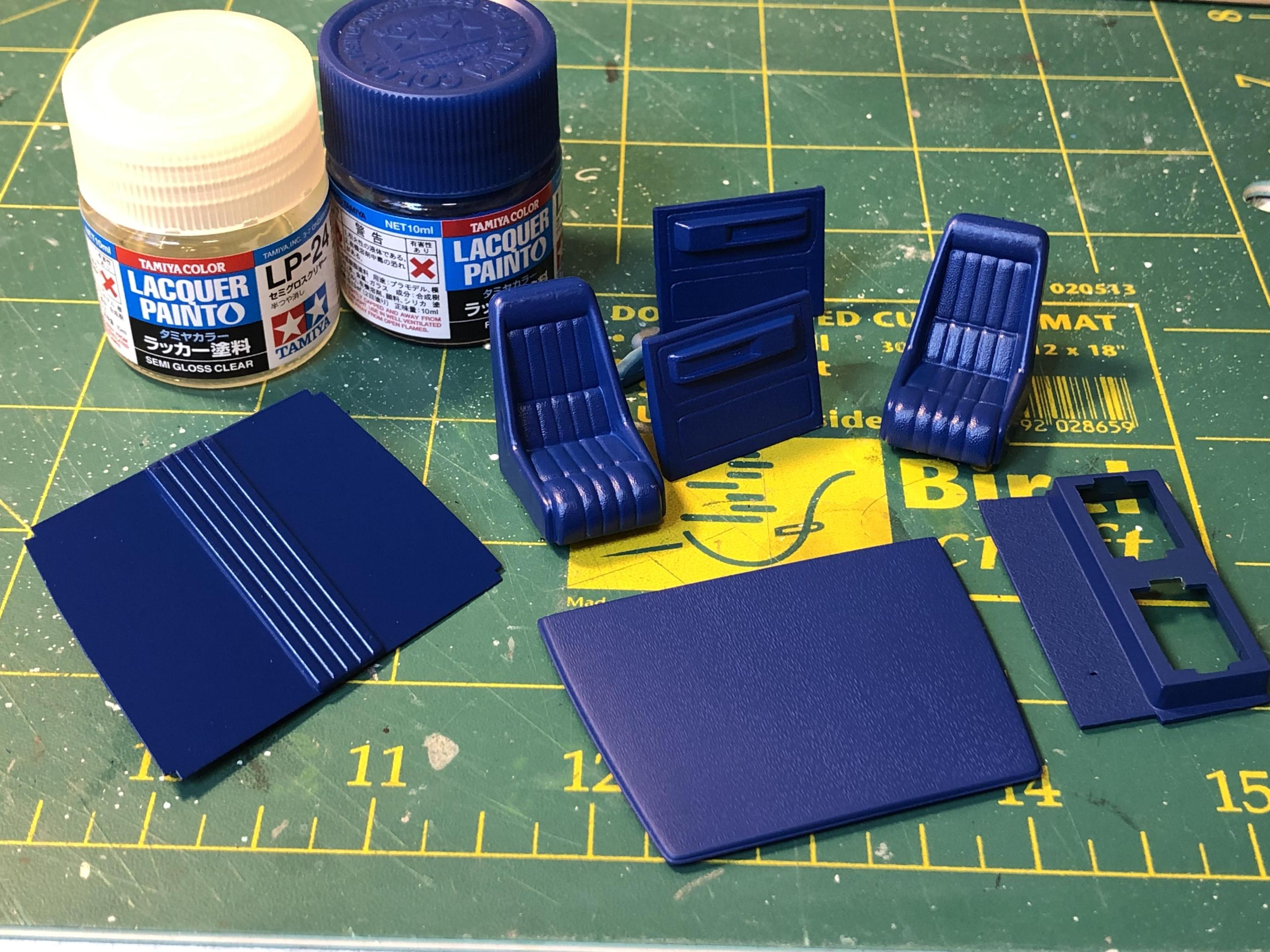

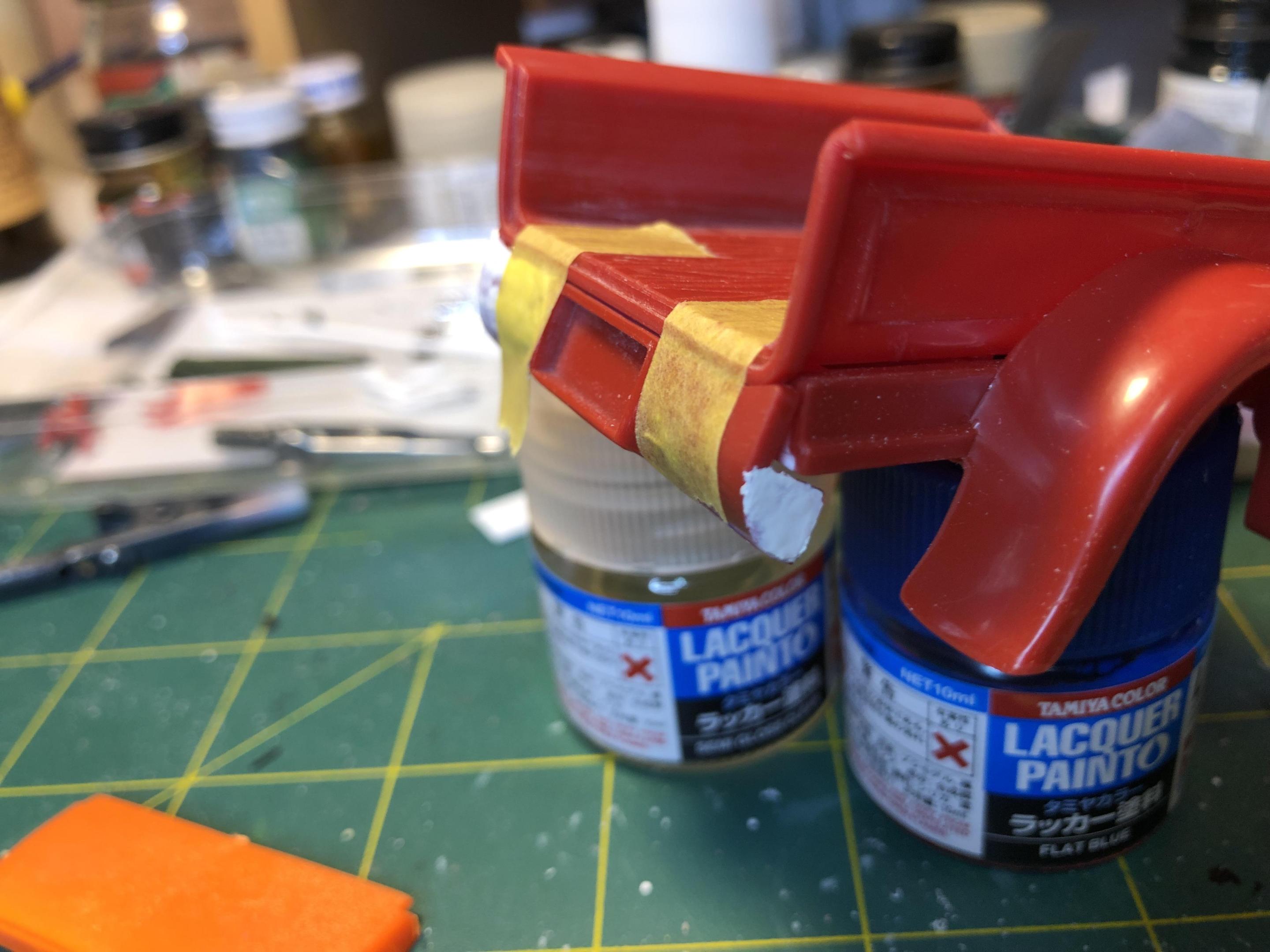

bill-e-boy Posted December 2, 2021 Posted December 2, 2021 Kit - I hope you can get your hands on the SD40 - looks like a cool project with a lot of history I have been spending time on the bed candy - nearly done Got some colour on the interior parts Tamiya flat blue with semigloss on the seats, door cards and headlining - i need to break up the monotony of Pacific Blue that everything else is/will be painted The floor parts and cab roof left in flat - it has a bit more gloss than what I would expect from a flat paint More work to be done on cab alignment, door fitting and hood so will post when I have done a bit more Thanks for looking 1

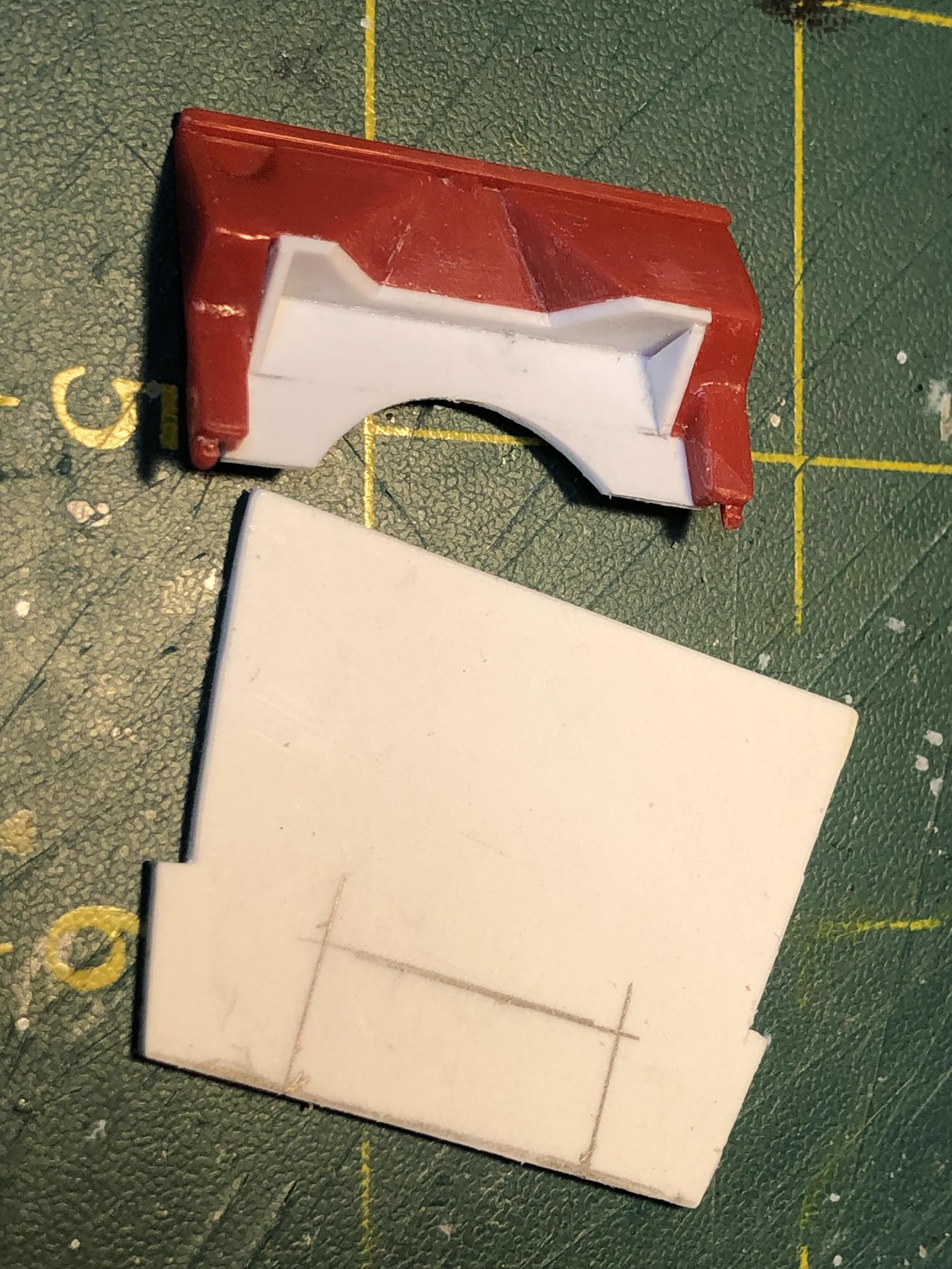

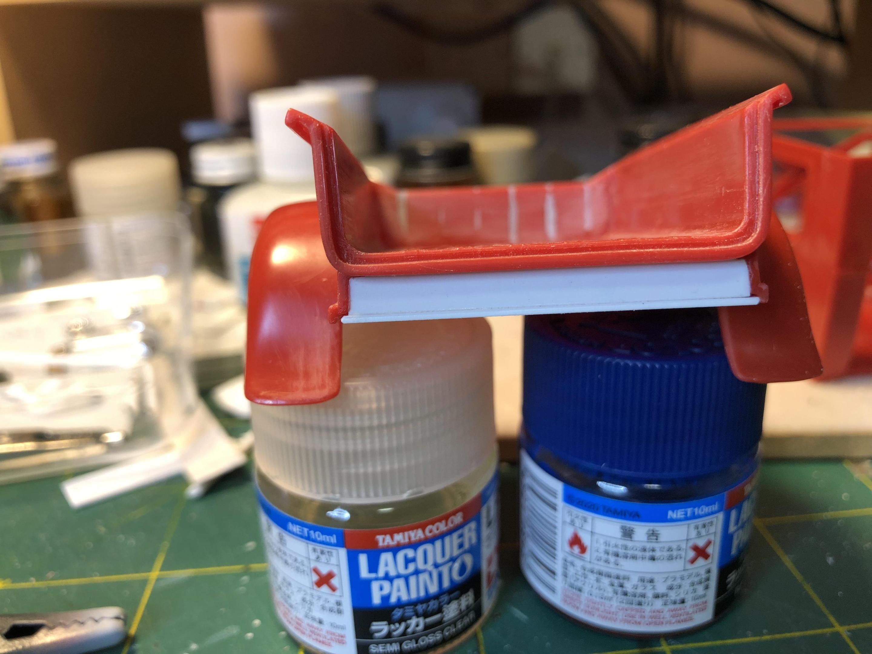

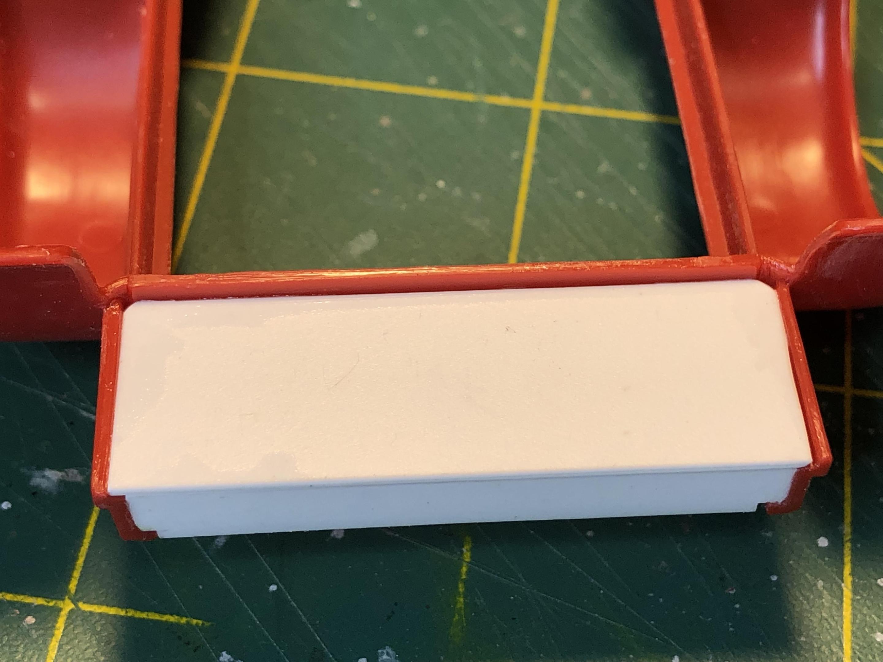

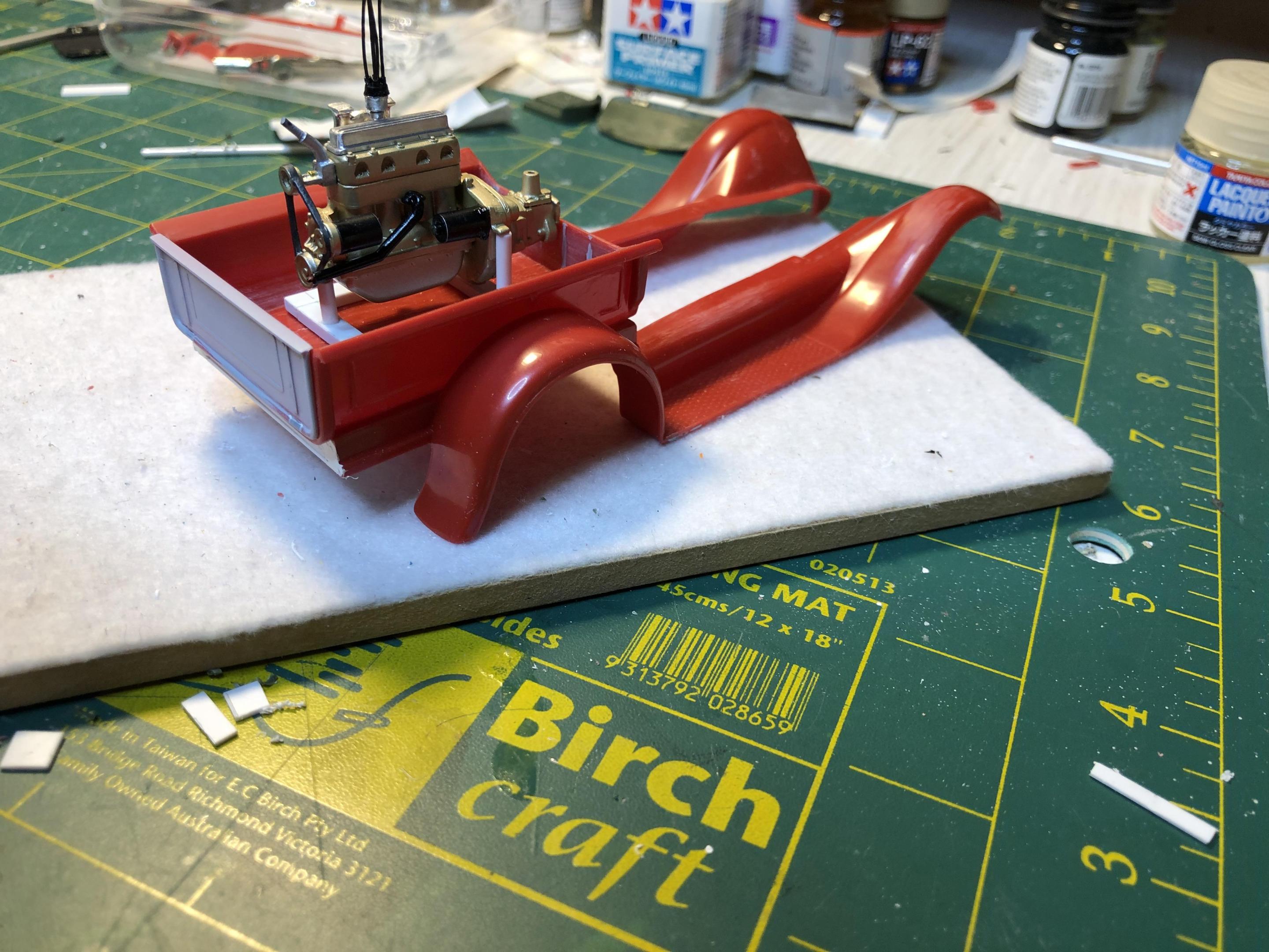

bill-e-boy Posted December 7, 2021 Posted December 7, 2021 I made a stand for the bed candy I was not happy with the bare look to the rear end. I tried the rolled pan that is in the kit but it is a bit blah. I had removed the moulded in tail lights but could see that it was not going to gel with the overall theme. Also it looks like it does not fit very well either and it would be a glue on part later So I have used a simpler approach and filled in the gap between the bed rails. I also filled in the under part too Waiting for the glue to set up I moved on the the cab interior I am using the Lil'John dash so need to fill the steering hole I will replace the blah dash detail with some photo etch More to come Thanks for looking 1

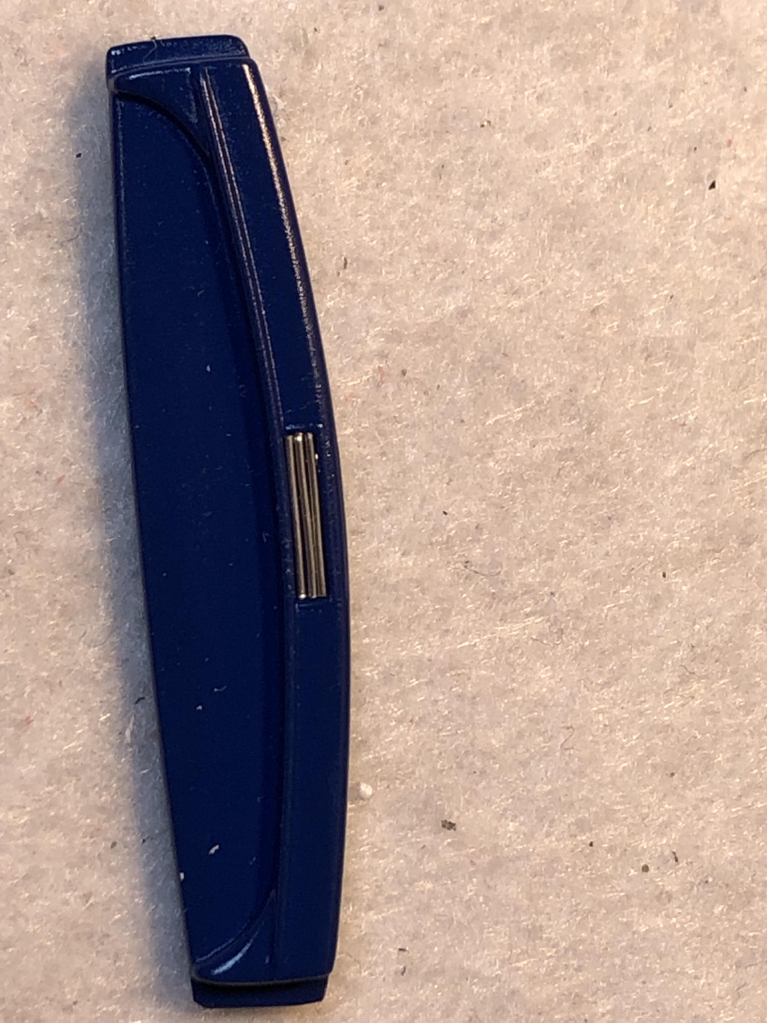

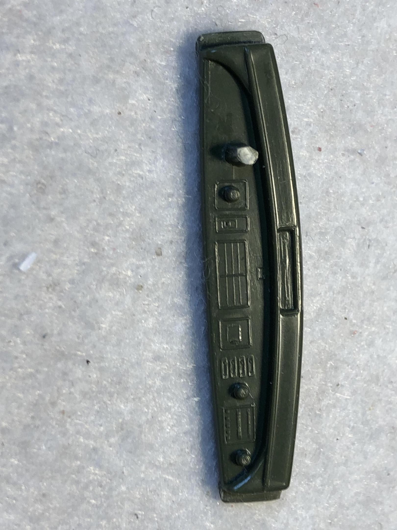

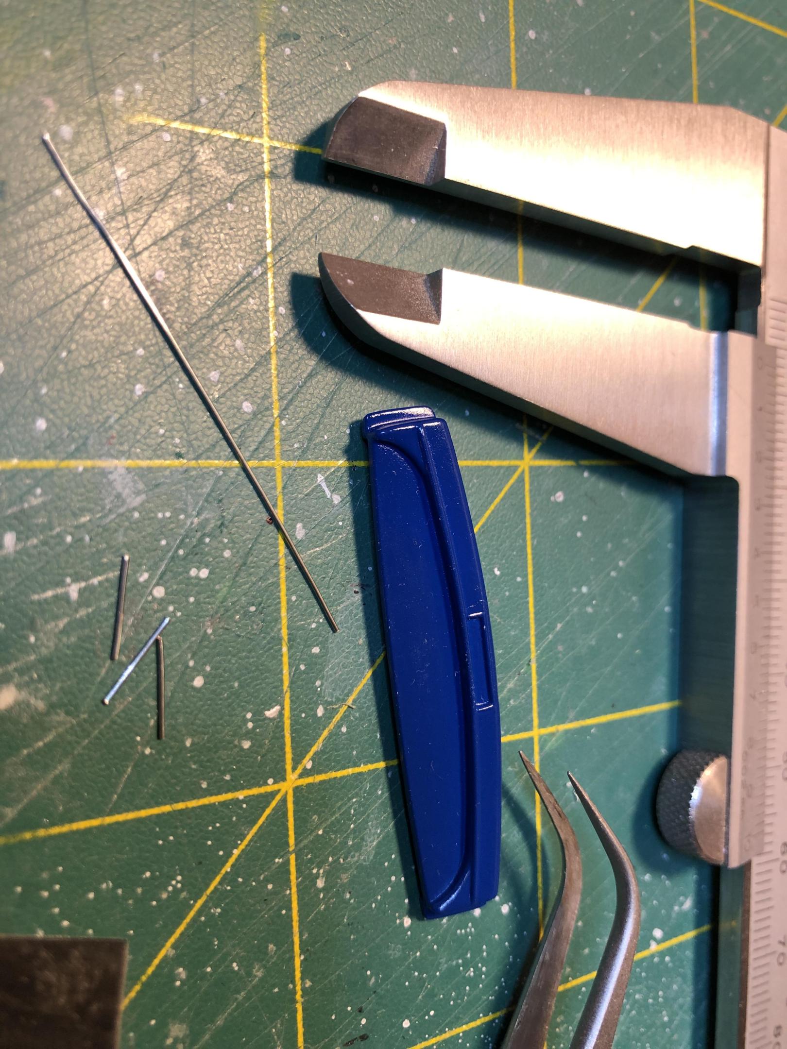

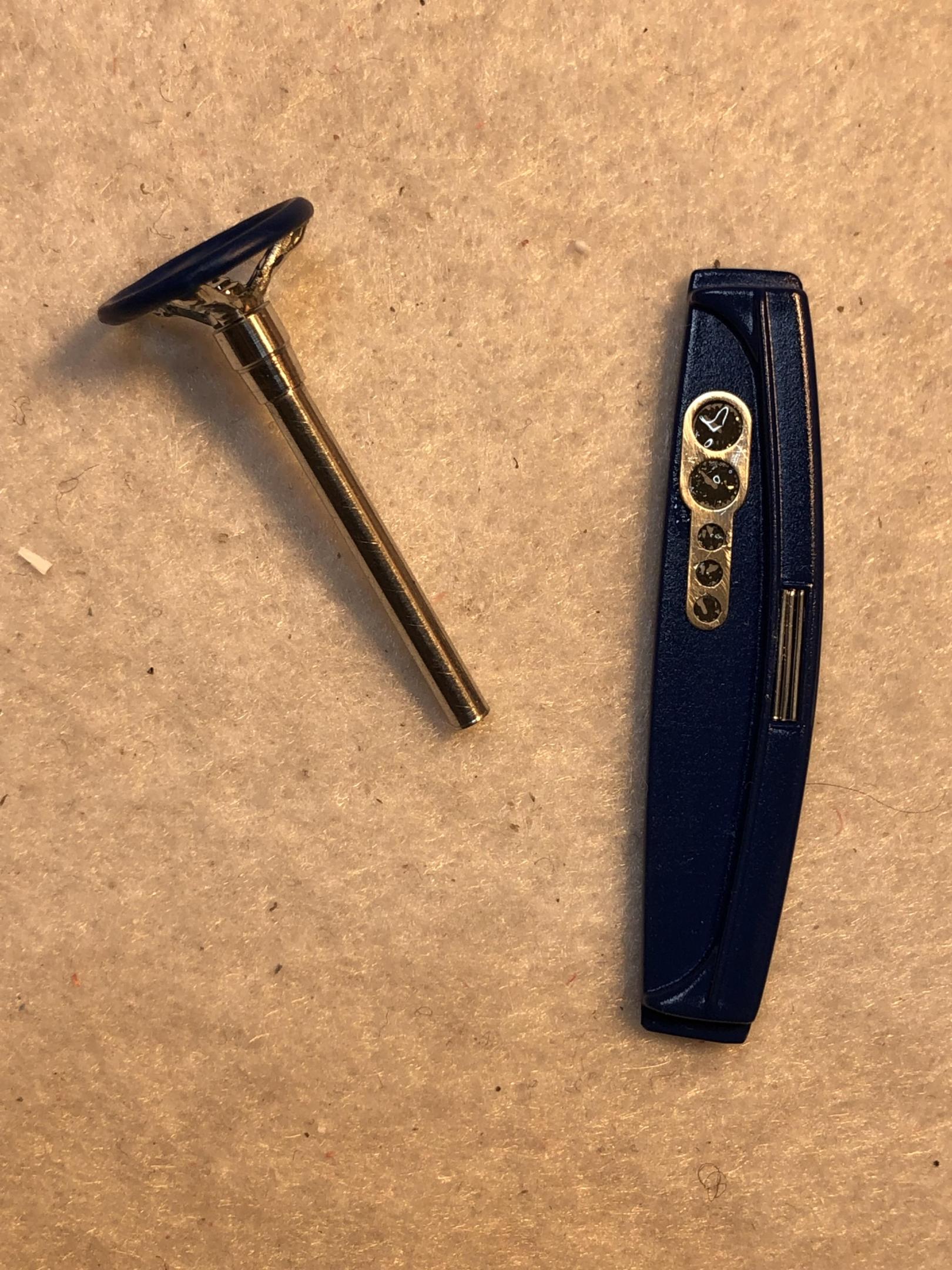

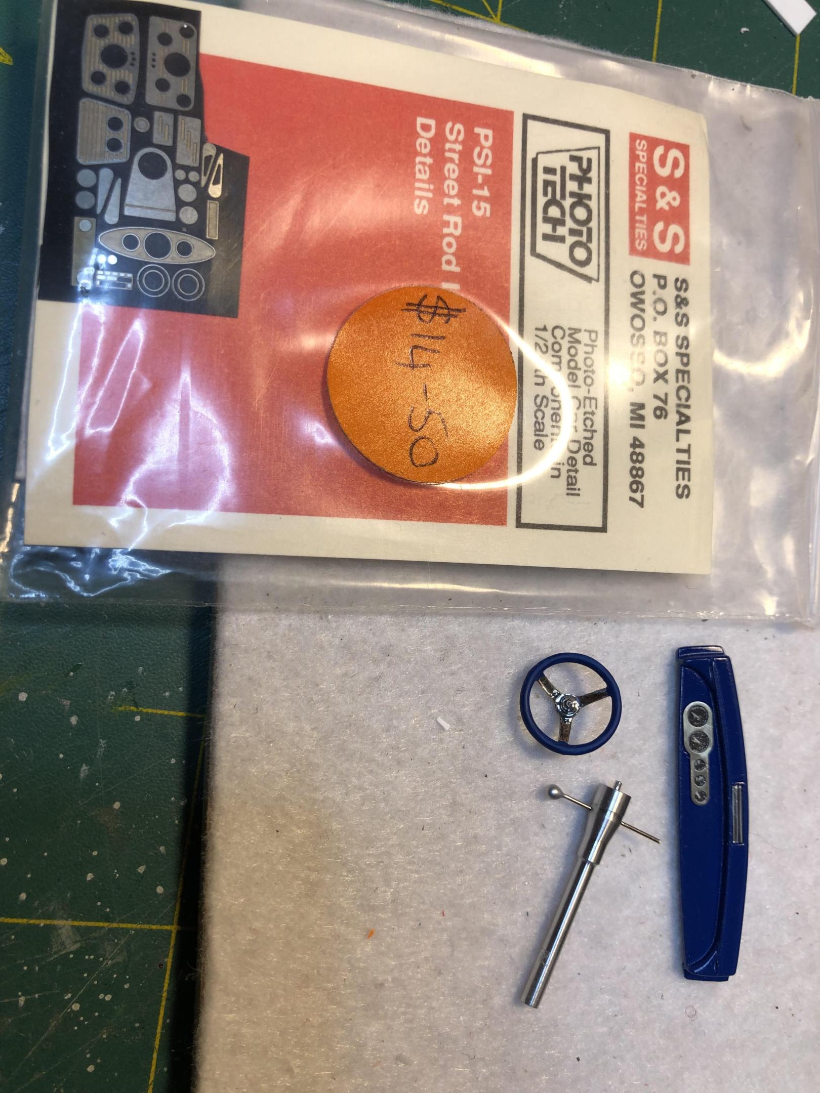

bill-e-boy Posted December 15, 2021 Posted December 15, 2021 Hi All In the last post I filled the hole in the Lil John dash. I was not happy with the shallow engraving on the dash so I smoothed it out for some photo etch I have had for yonks. I painted the dash dark blue flat with semi-gloss clear to match the rest of the interior The slot at the top of the dash looked a bit blah so I cut some silver plated craft wire long enough to fit into the slot - 3 pieces worked OK This is a huge improvement - looks better with less magnification Next up was the steering column. I have an after market one as shown but the hub is too long for this application. The billet dash is a S&S item that I cut the supplied gauge faces and glued to the back. This was glued to the dash with some Tamiya clear which was also used for the gauge glasses For a more suitable column I machined a hub to fit some 2.4mm dia ally tube and fitted to the Lil John steering wheel. I actually machined 2 hubs 1x 3mm dia and the other 3.5mm. I will use the 3mm with a column drop that is waiting for paint 1

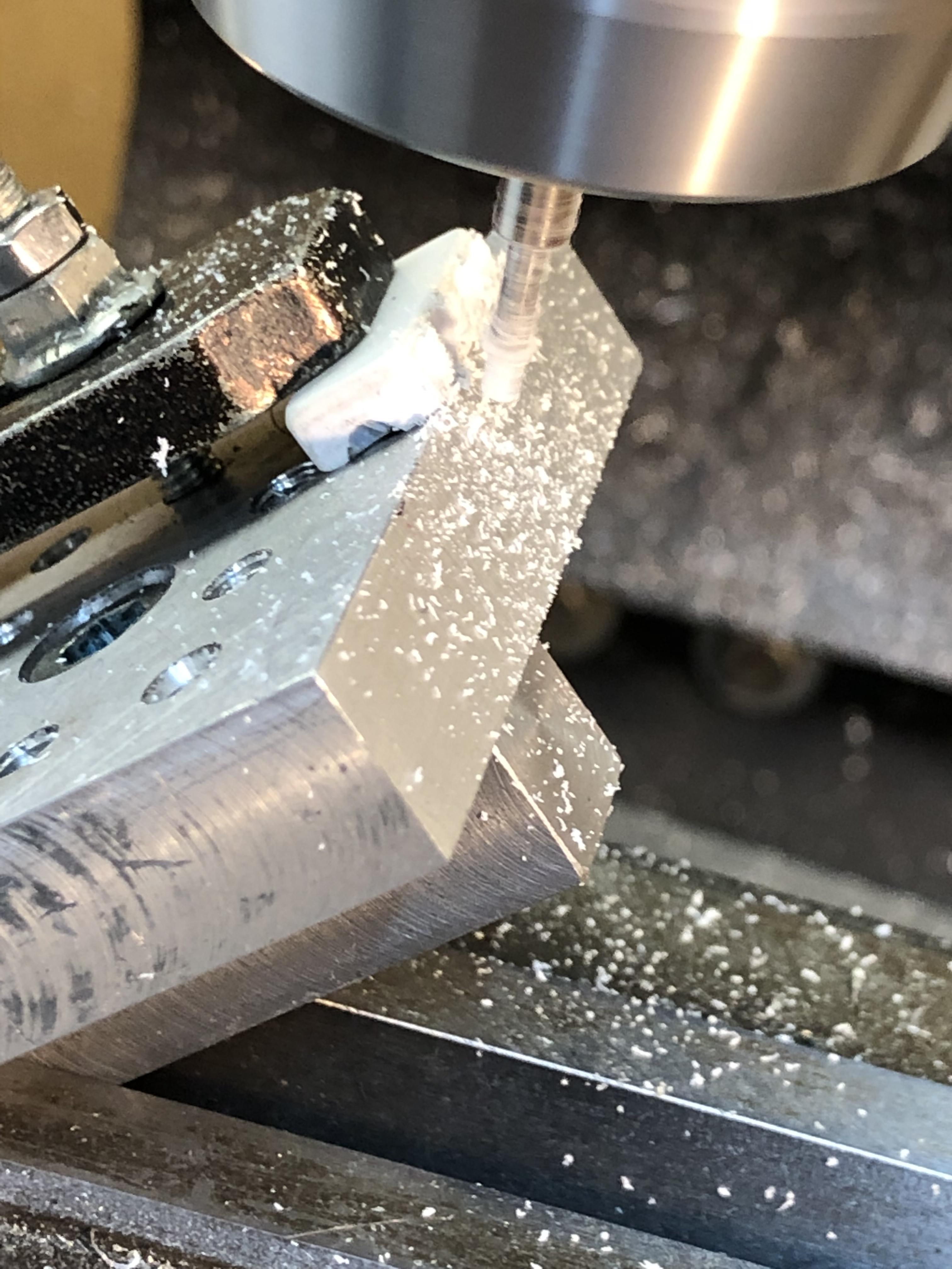

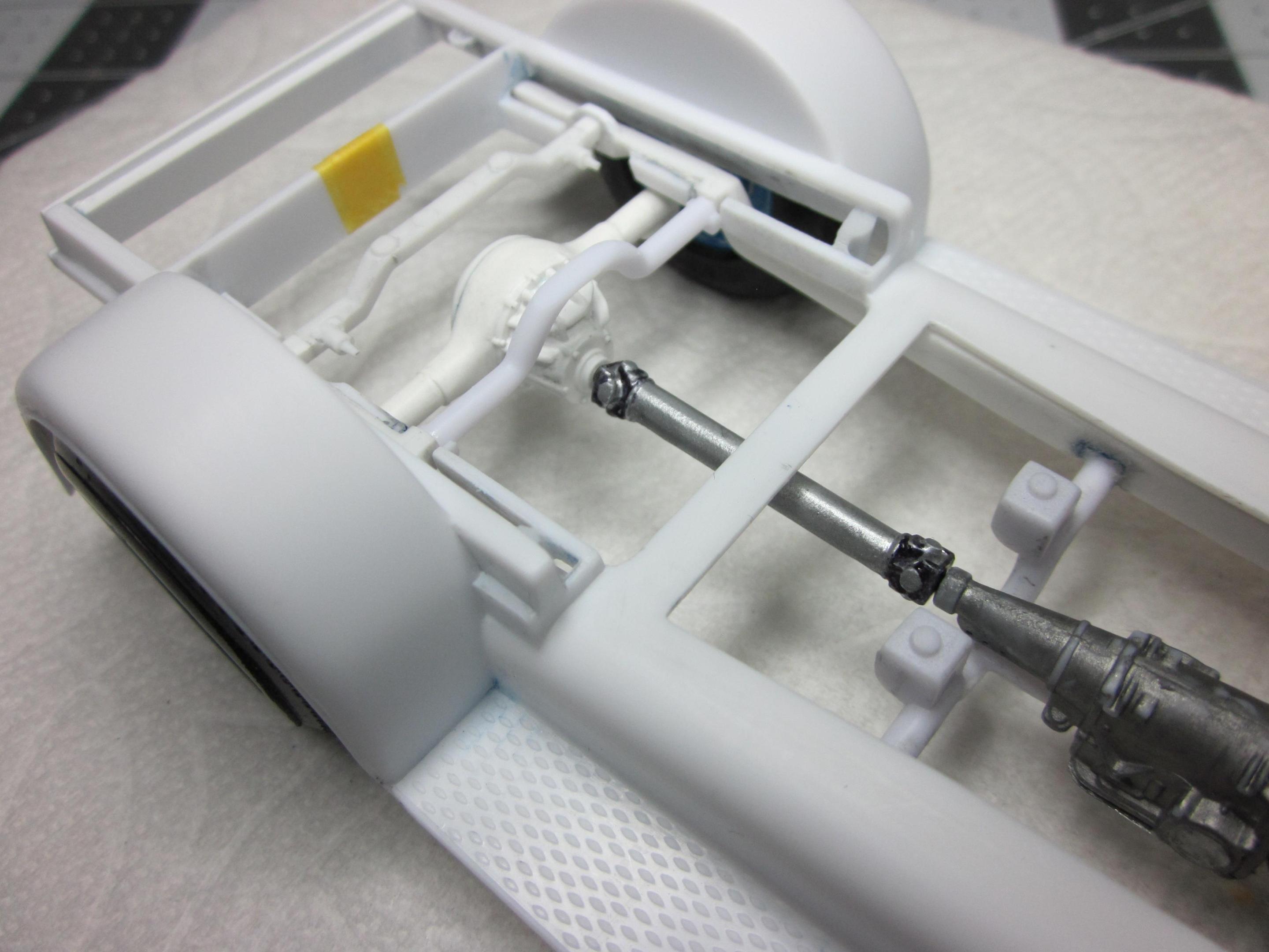

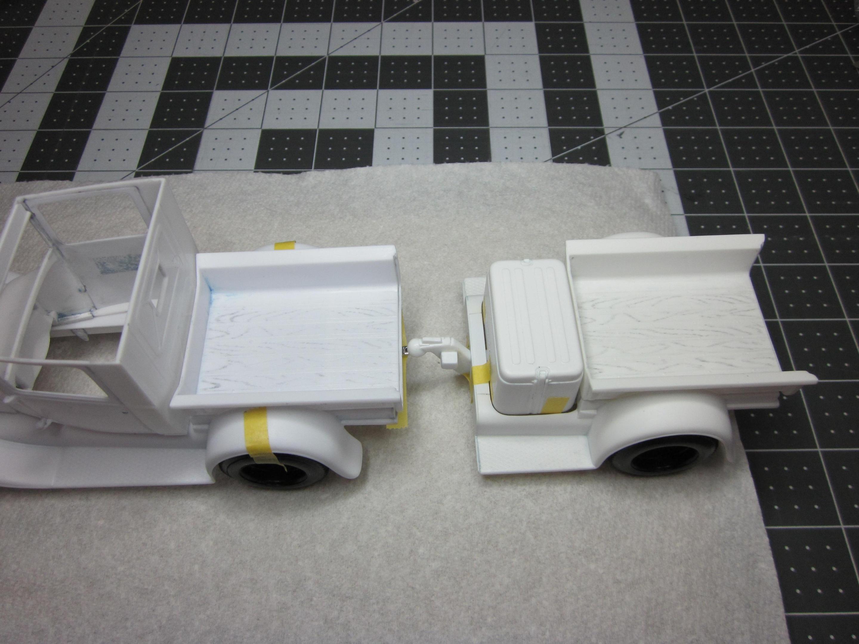

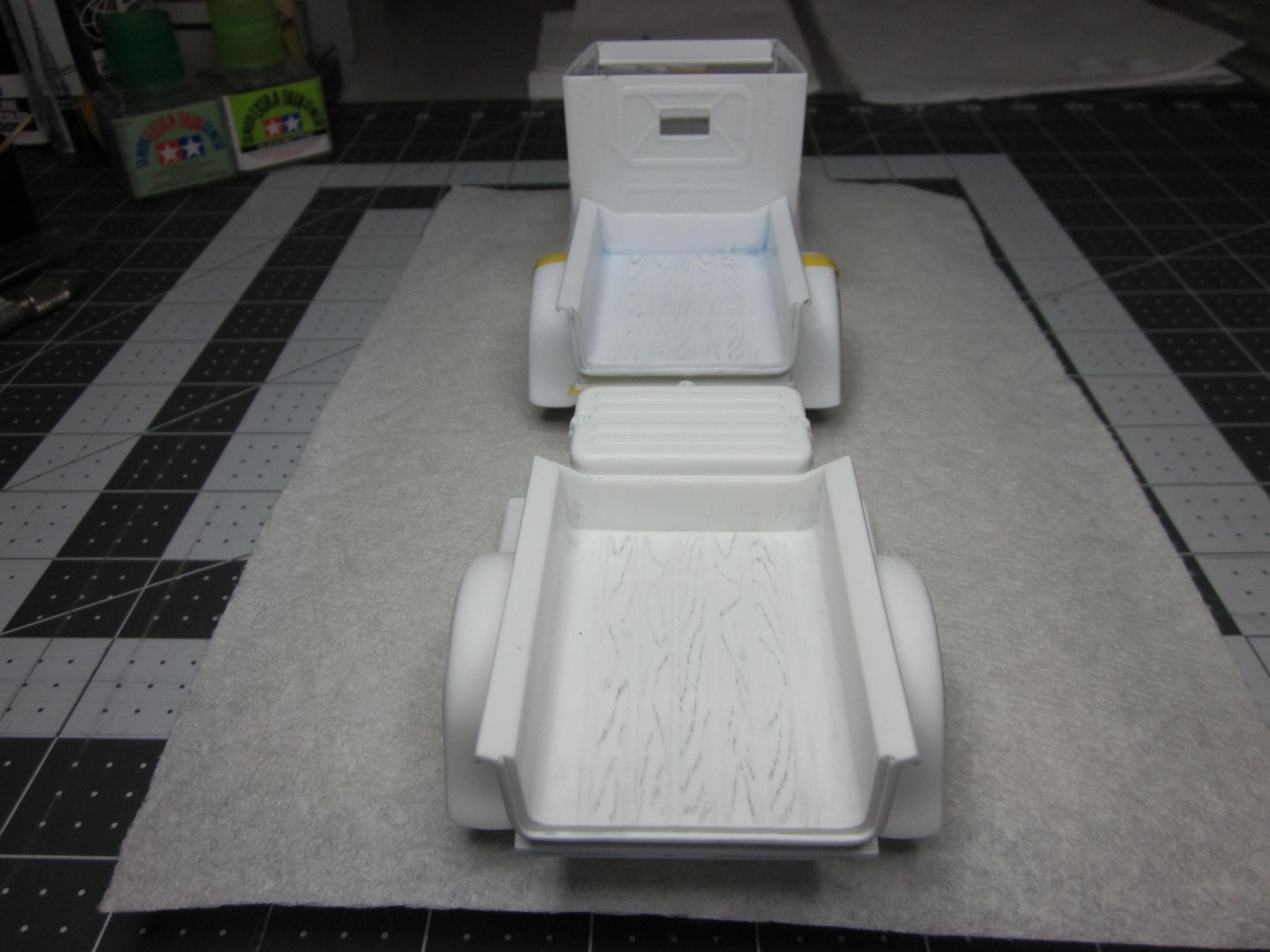

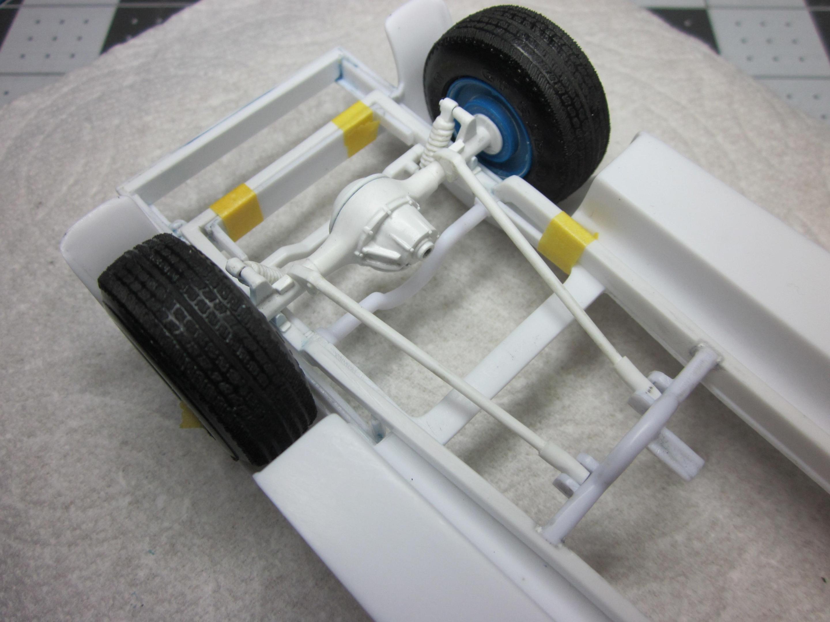

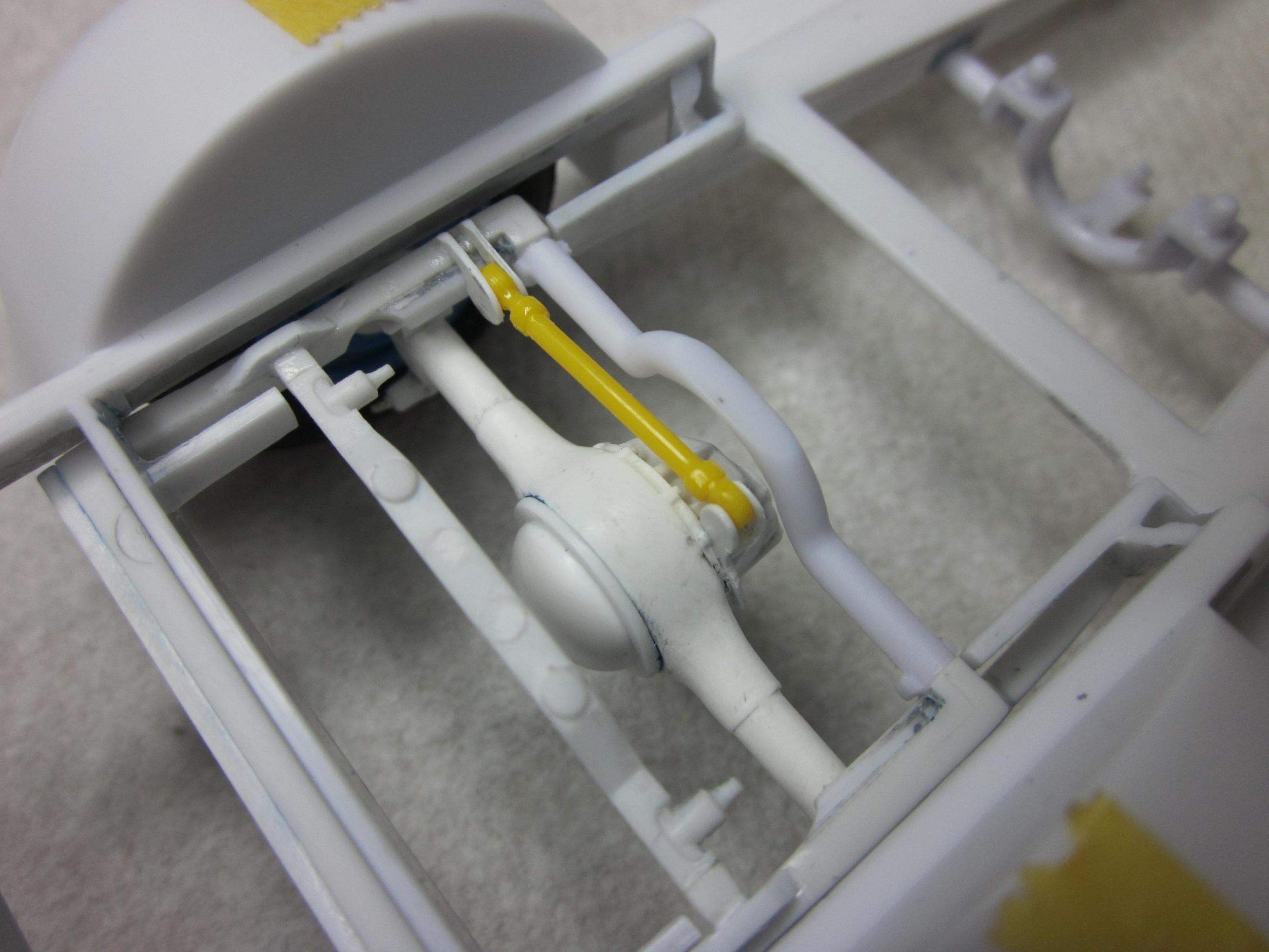

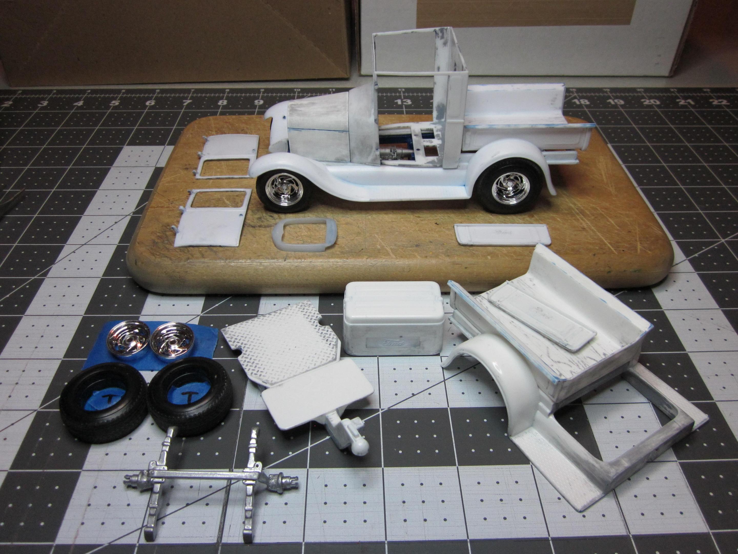

Speedpro Posted December 24, 2021 Posted December 24, 2021 After working on kits 29' ford truck for the last few weeks, It is at a point where it's ready for some primer on all the parts. Bummer is, It's real cold right now here in kalispell and i'm going to wait till it warms up a bit before i try to put down any paint. Don't want to have a paint failure getting in a big hurry. Here is a little of what's got done ............................ Worked on the frame replacing the frame cross member above the rear differential. The replacement cross member used is out of the 29' roadster kit with everything shaved off of it. Added the upper shock mount. Figured the shock length and cut them down to fit. Figured and added a pan hard bar. With the suspension out of the way, Both the body and trailer were completely massaged and any fit issues were taken care of along the way. I just have to say, kit did a amazing job building the trailer. It's a model all in it's self. Also, the engine was taken apart and stripped of paint. It is currently in pieces. All in all, everything looks good. Can't wait to see some color on everything. I'll update when things start moving along again. Speedpro 1
Kit Karson Posted December 24, 2021 Posted December 24, 2021 13 hours ago, Speedpro said: After working on kits 29' ford truck for the last few weeks, It is at a point where it's ready for some primer on all the parts. Bummer is, It's real cold right now here in kalispell and i'm going to wait till it warms up a bit before i try to put down any paint. Don't want to have a paint failure getting in a big hurry. Here is a little of what's got done ............................ Worked on the frame replacing the frame cross member above the rear differential. The replacement cross member used is out of the 29' roadster kit with everything shaved off of it. Added the upper shock mount. Figured the shock length and cut them down to fit. Figured and added a pan hard bar. With the suspension out of the way, Both the body and trailer were completely massaged and any fit issues were taken care of along the way. I just have to say, kit did a amazing job building the trailer. It's a model all in it's self. Also, the engine was taken apart and stripped of paint. It is currently in pieces. All in all, everything looks good. Can't wait to see some color on everything. I'll update when things start moving along again. Speedpro @Speedprothank you for sharing your progress and the kind words. As expected, the changes and work you have put in surpass all of my expectations! I'm with you! And kan't wait to see it in some other color than maker's white!! -KK
Dennis Lacy Posted December 24, 2021 Author Posted December 24, 2021 @Speedpro Nice update! The rear chassis revisions look great, especially the fab work for the panhard. Really looking forward to seeing this back in color. And you’re right, the trailer Kit built really is bitchin. 1
