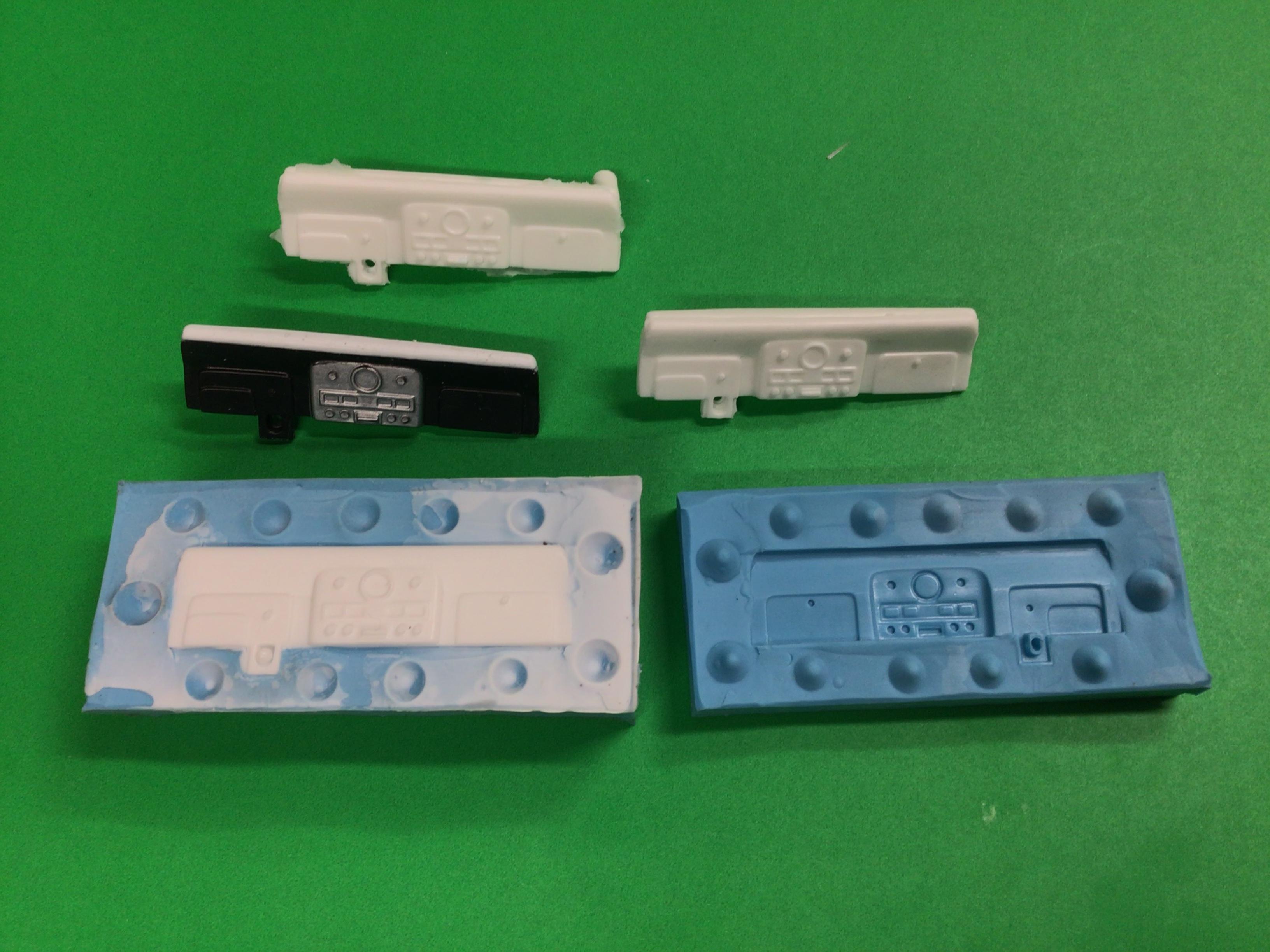

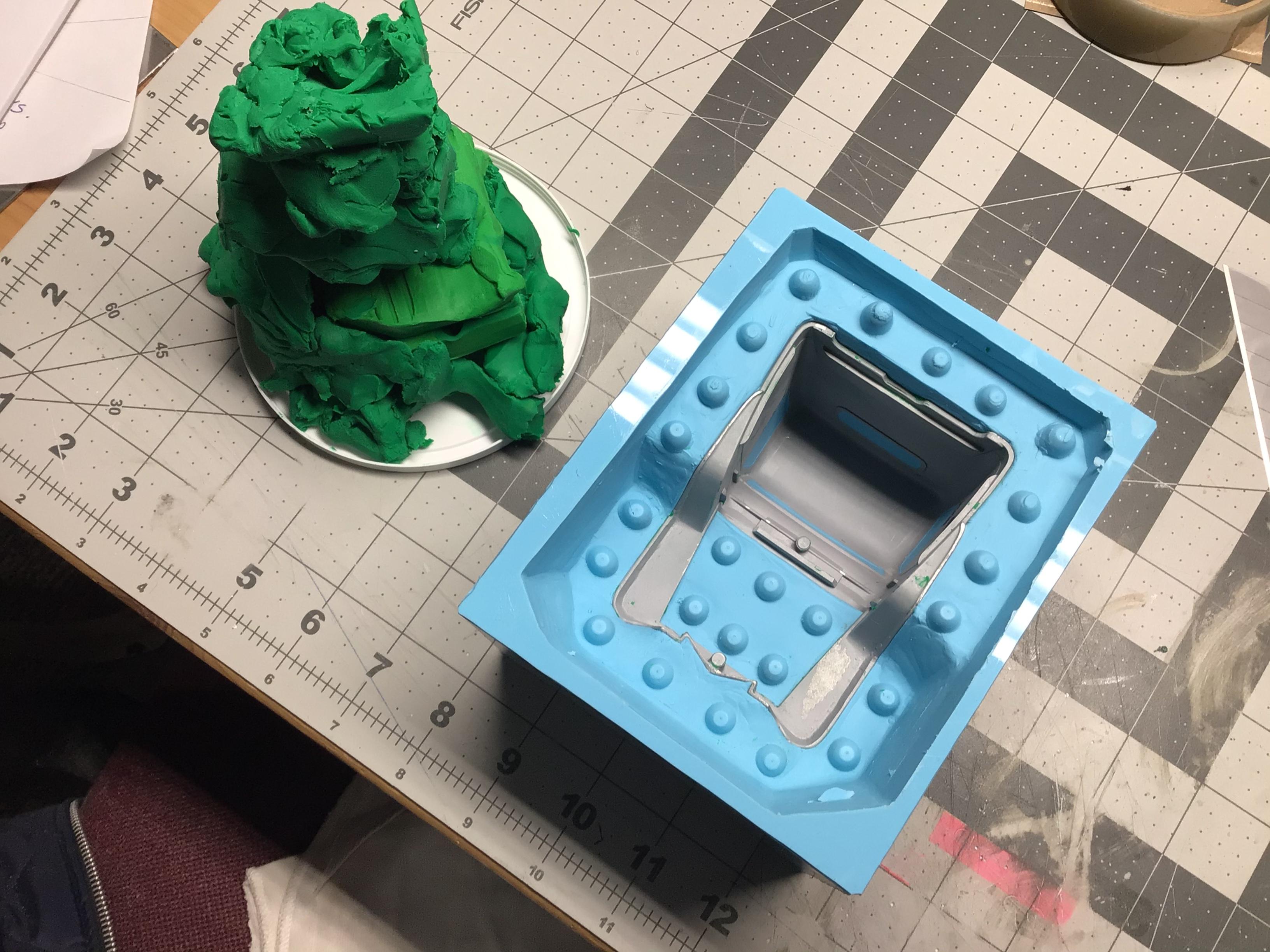

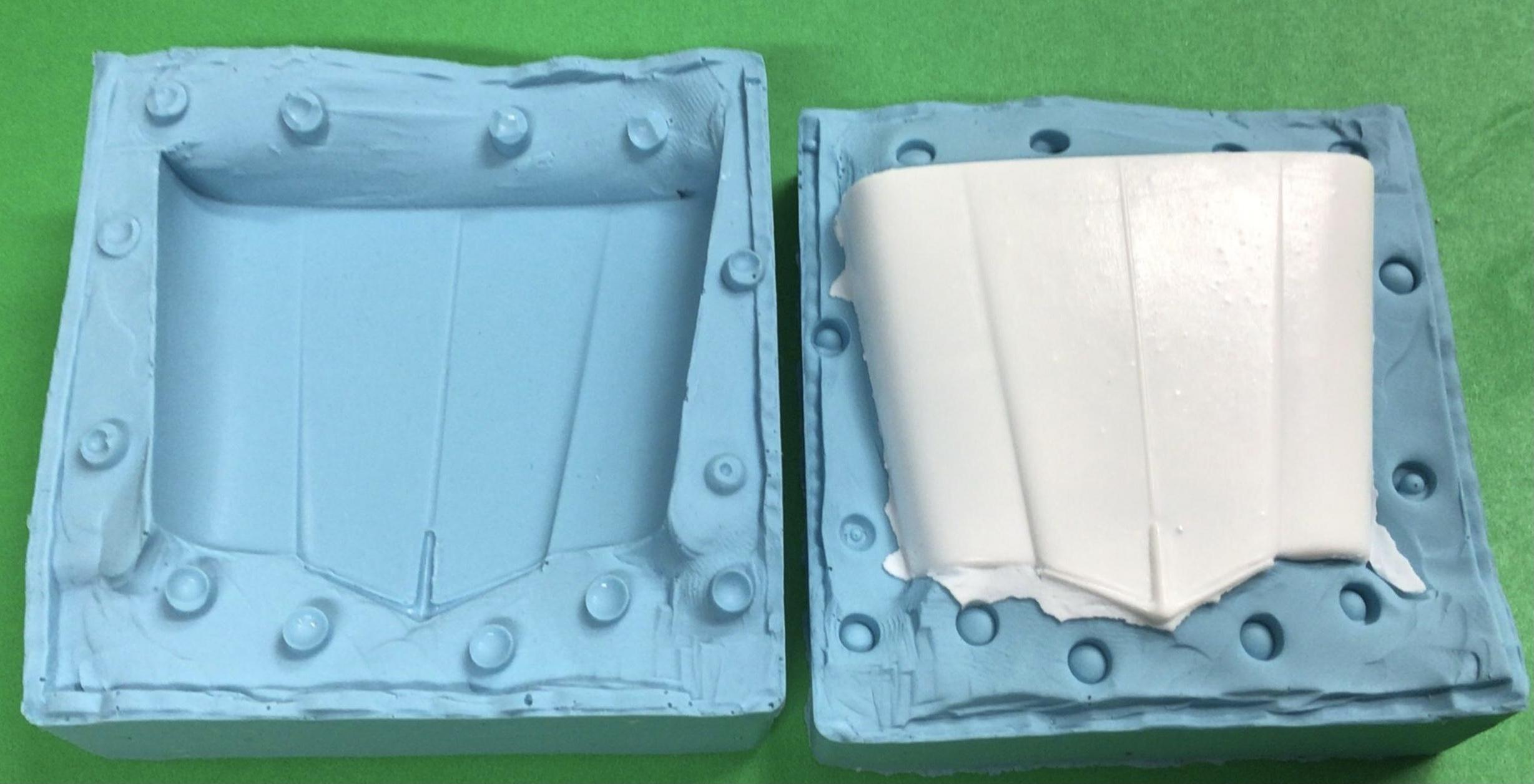

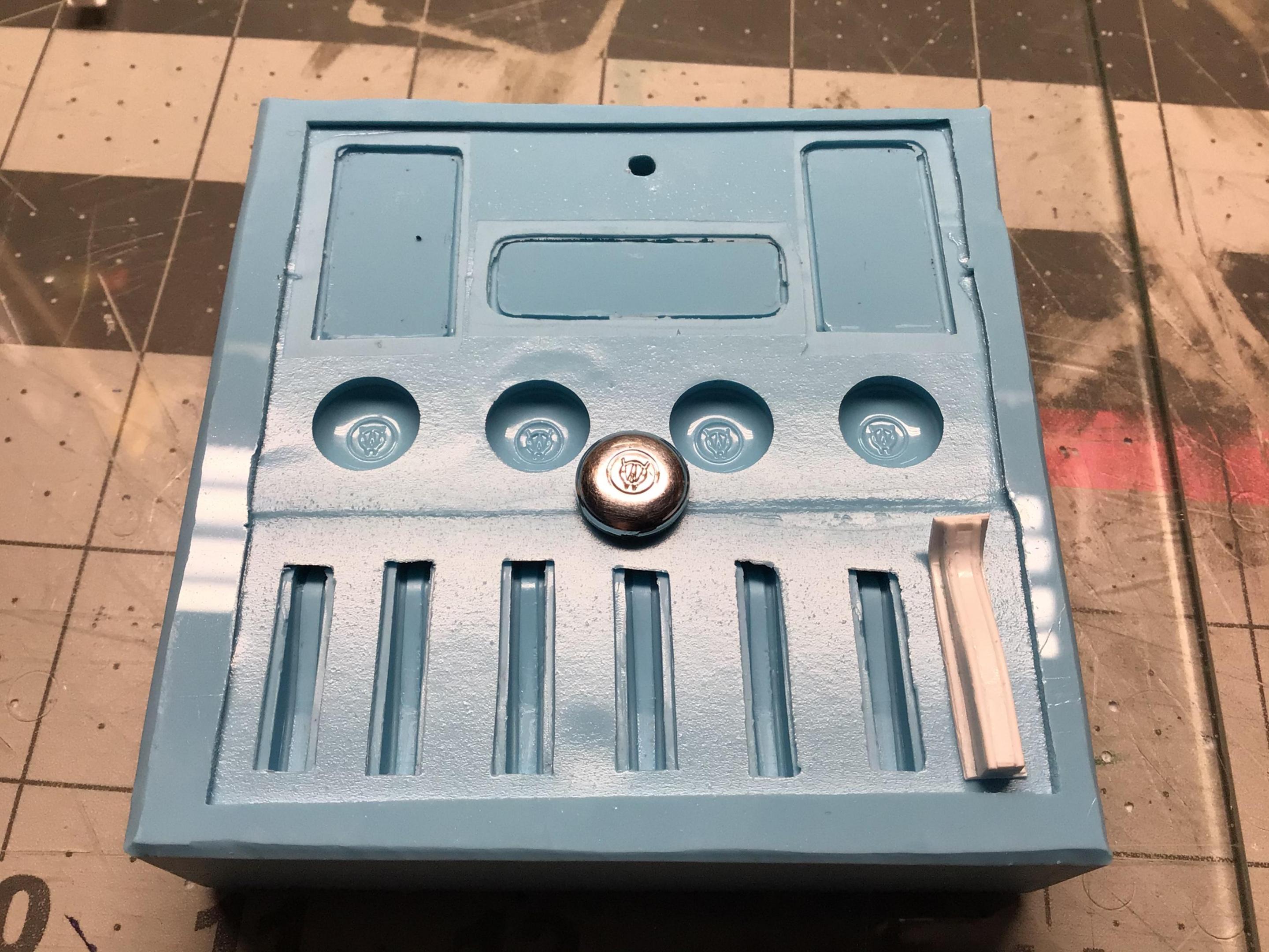

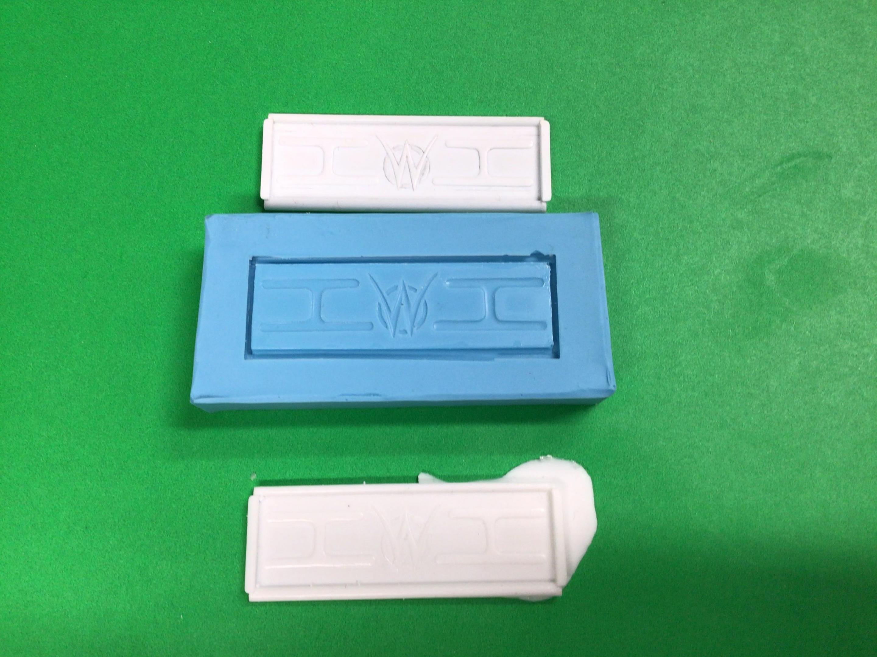

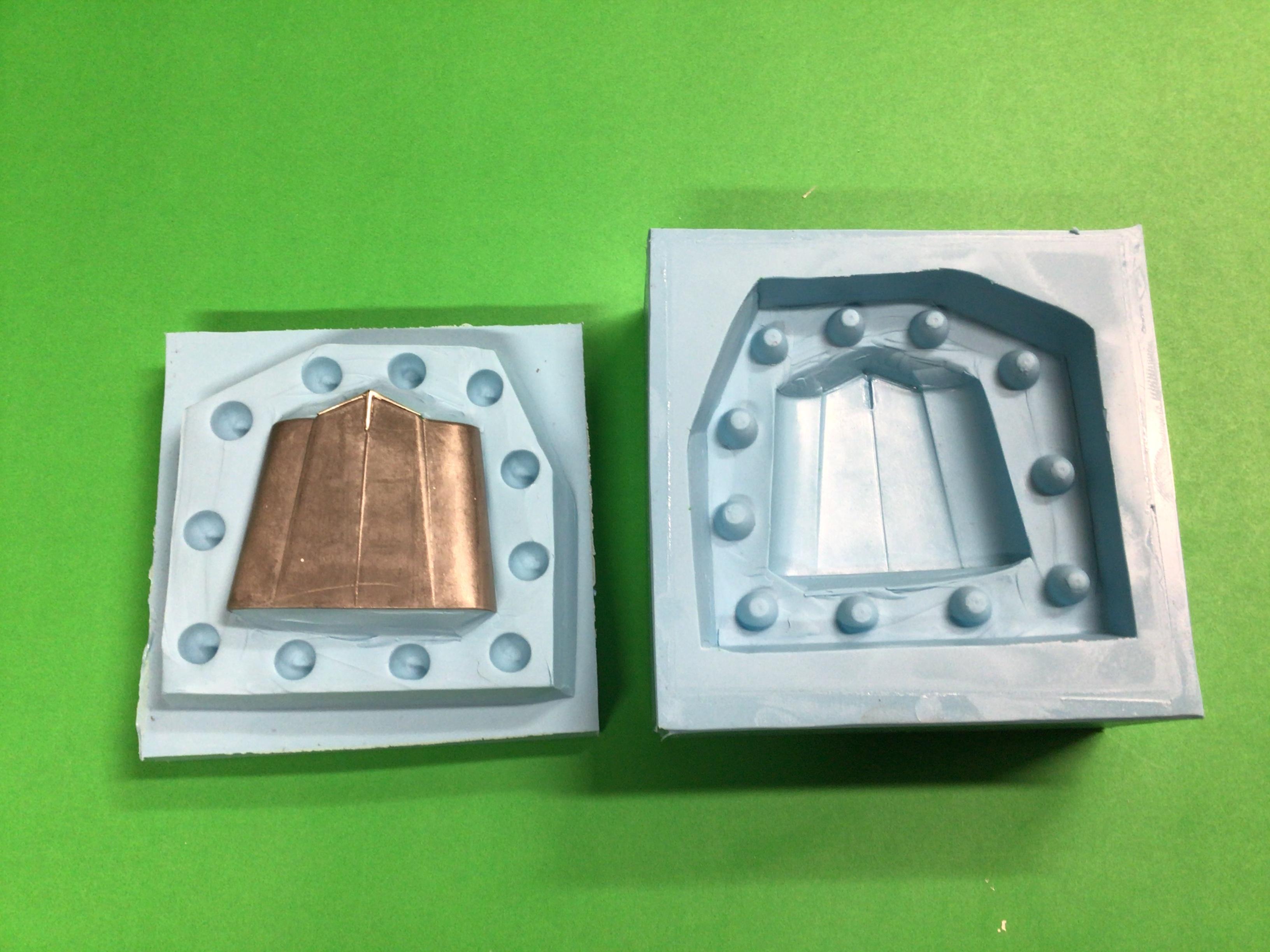

I decided that I want to make more than one of these pickups. I don’t want to have to redo the mods on another diecast so I’ve been busy making molds of some of the parts. The tailgate came out smooth and just needs to have the back sanded down to the proper thickness. I didn’t have a vacuum chamber when I started these so the floor/firewall and hood have lots of tiny air bubbles in the silicone mold. These translate into goosebumps on the resin cast part. They can be sanded off, but any new molds will have the silicone vacuum de-gassed.
Edited by NOBLNG

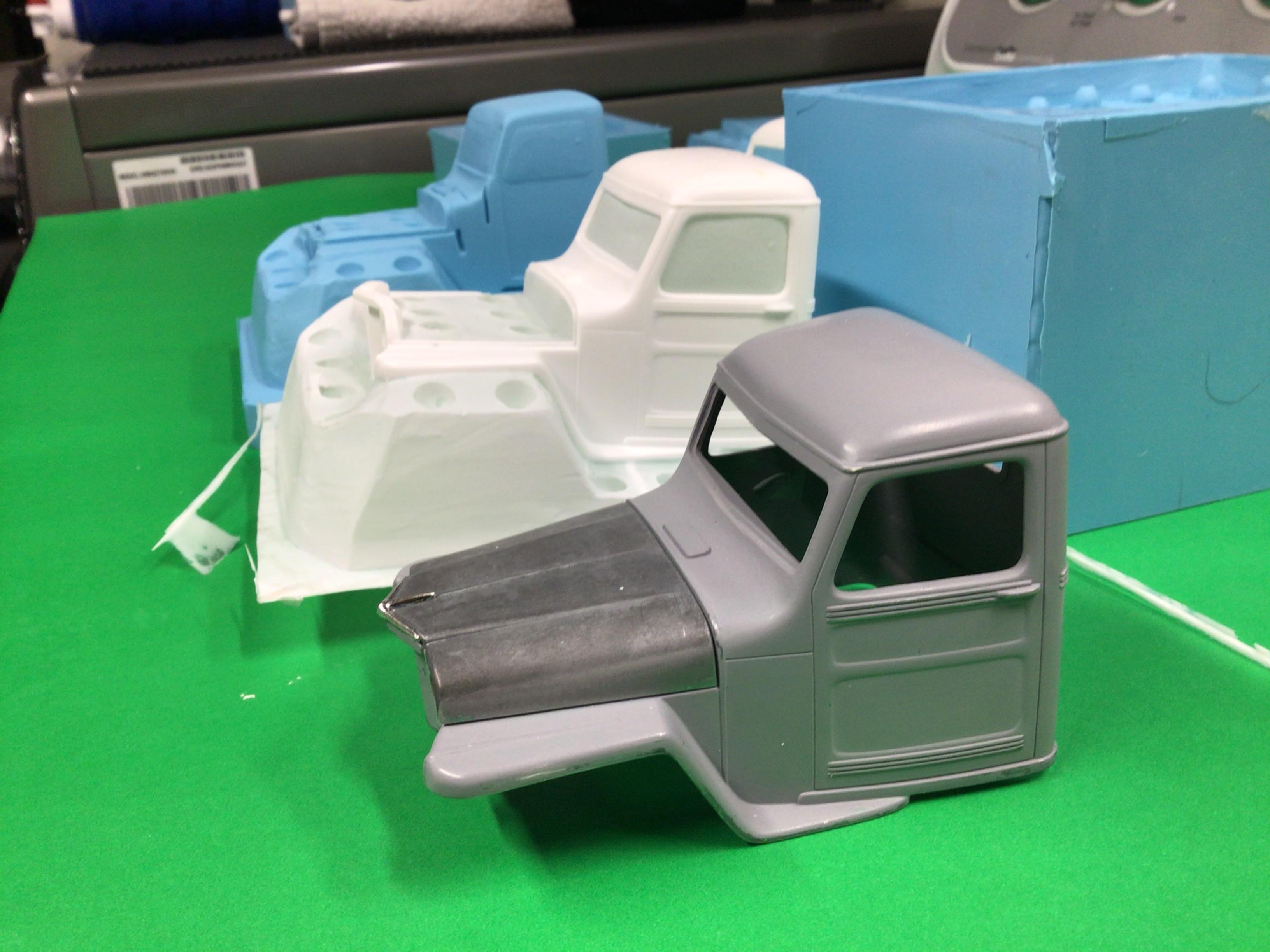

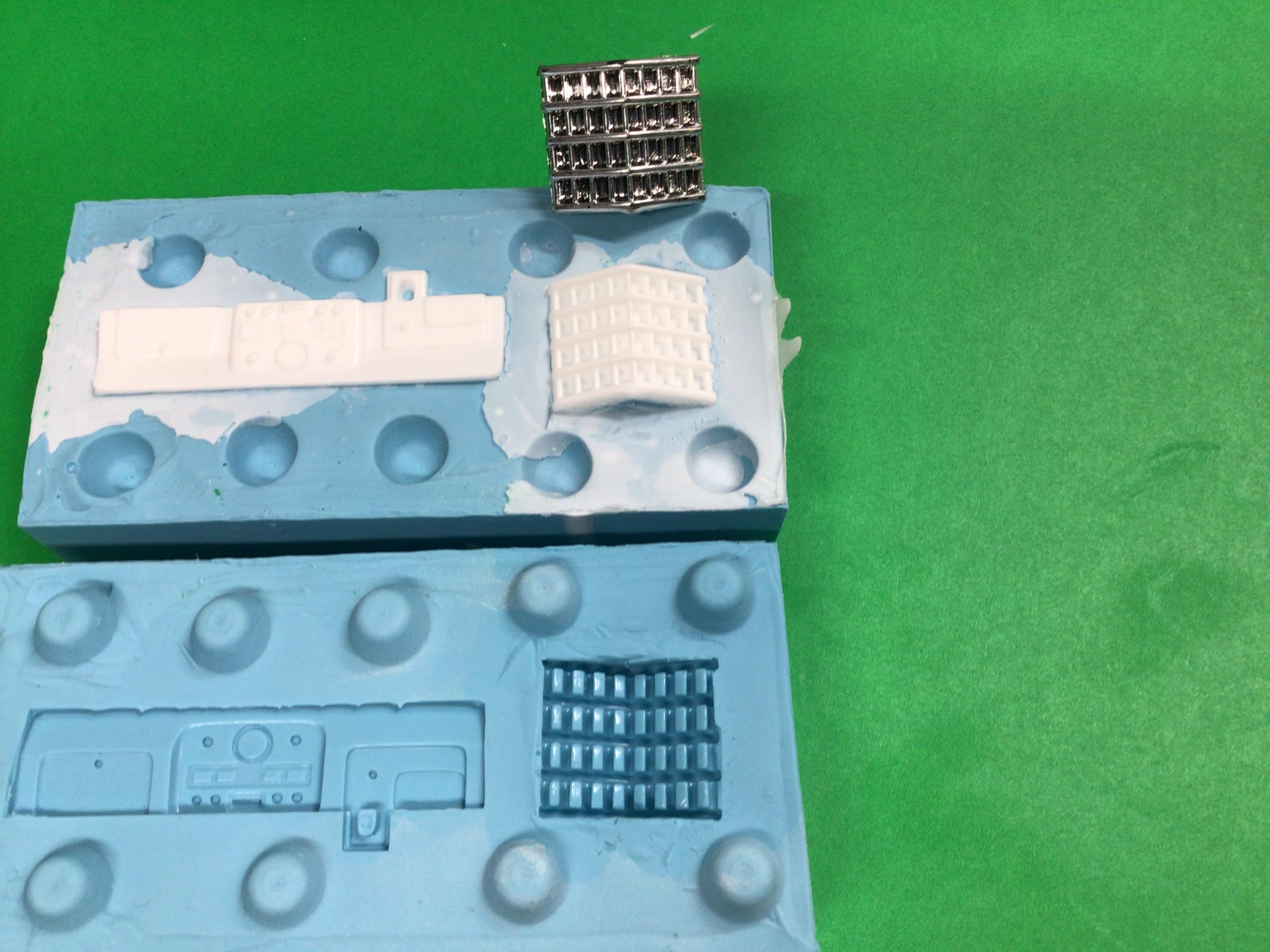

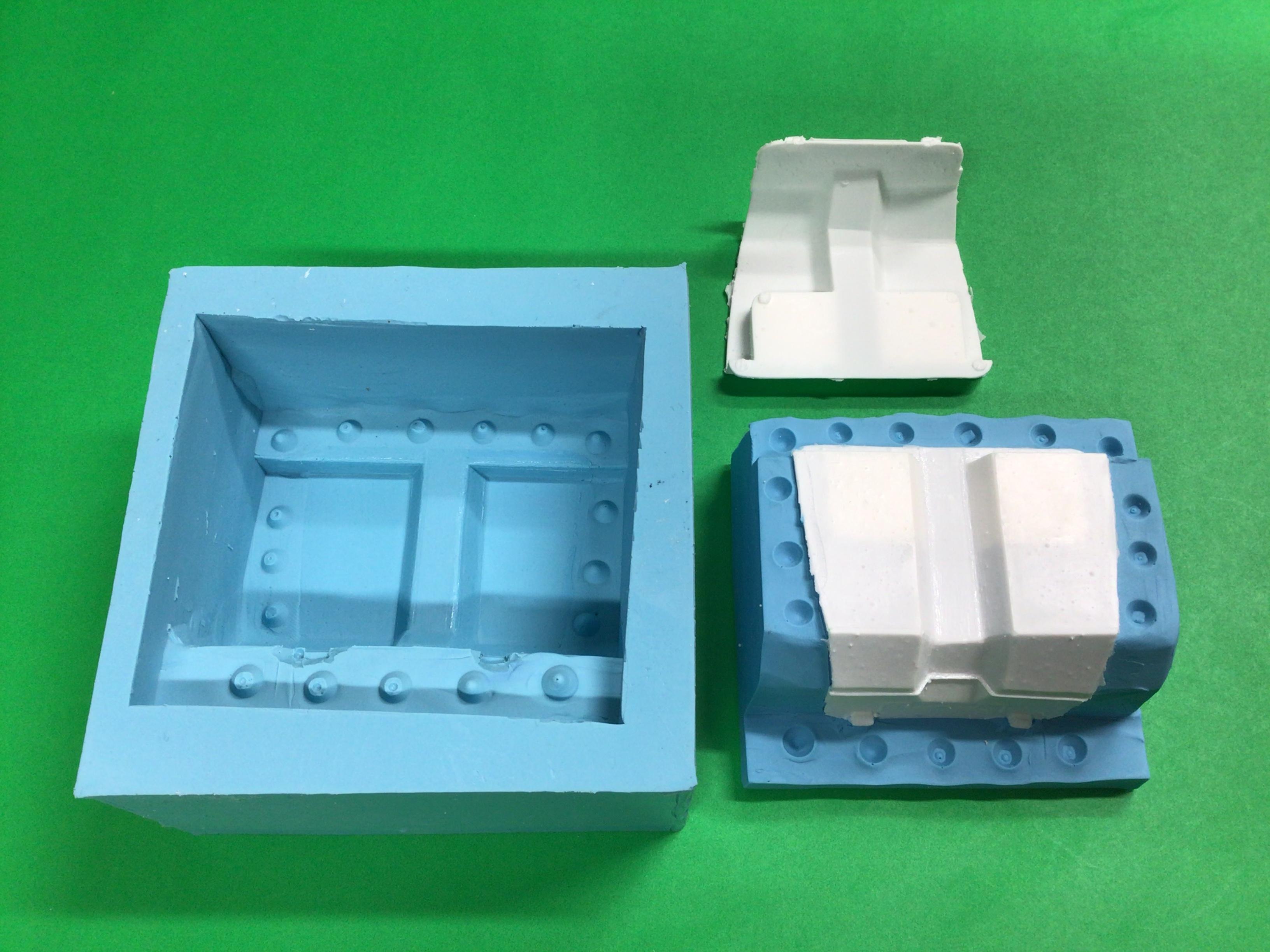

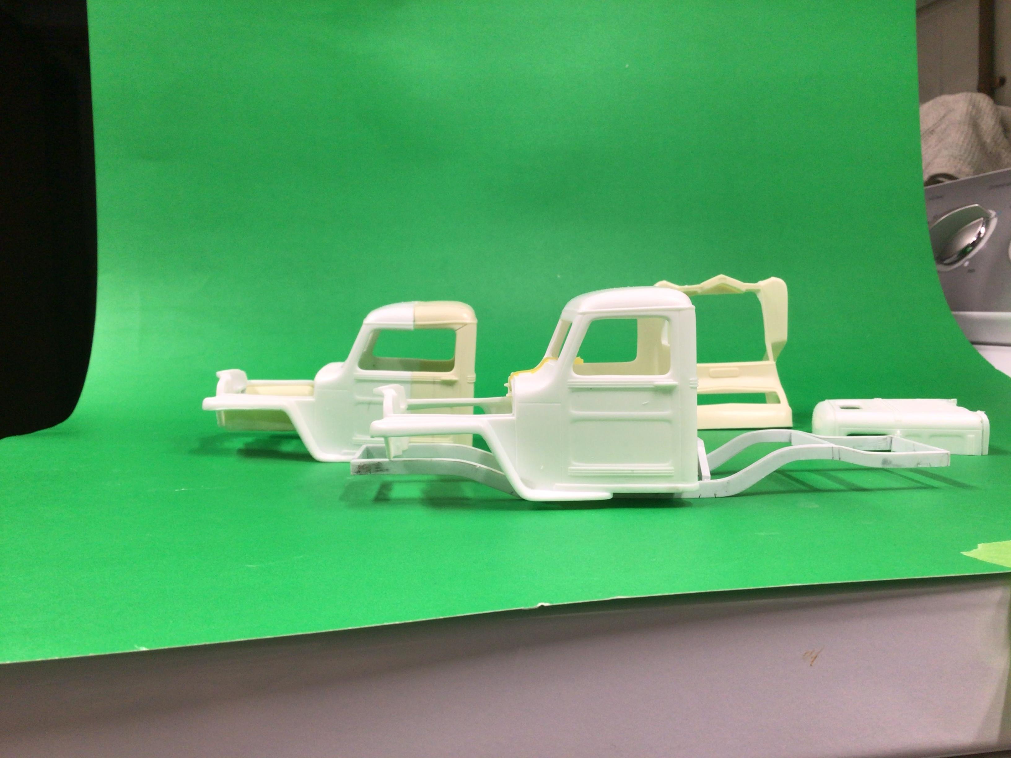

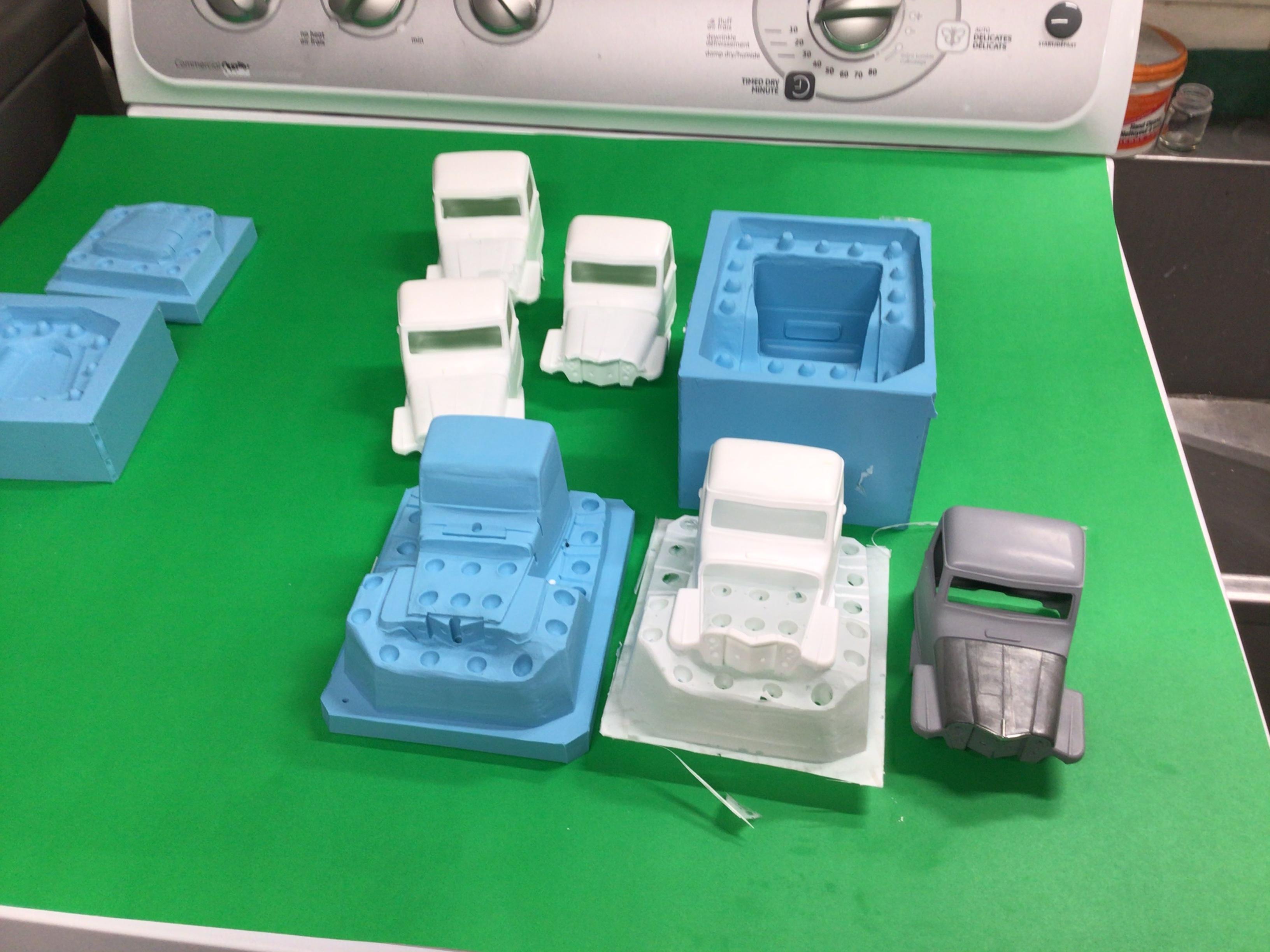

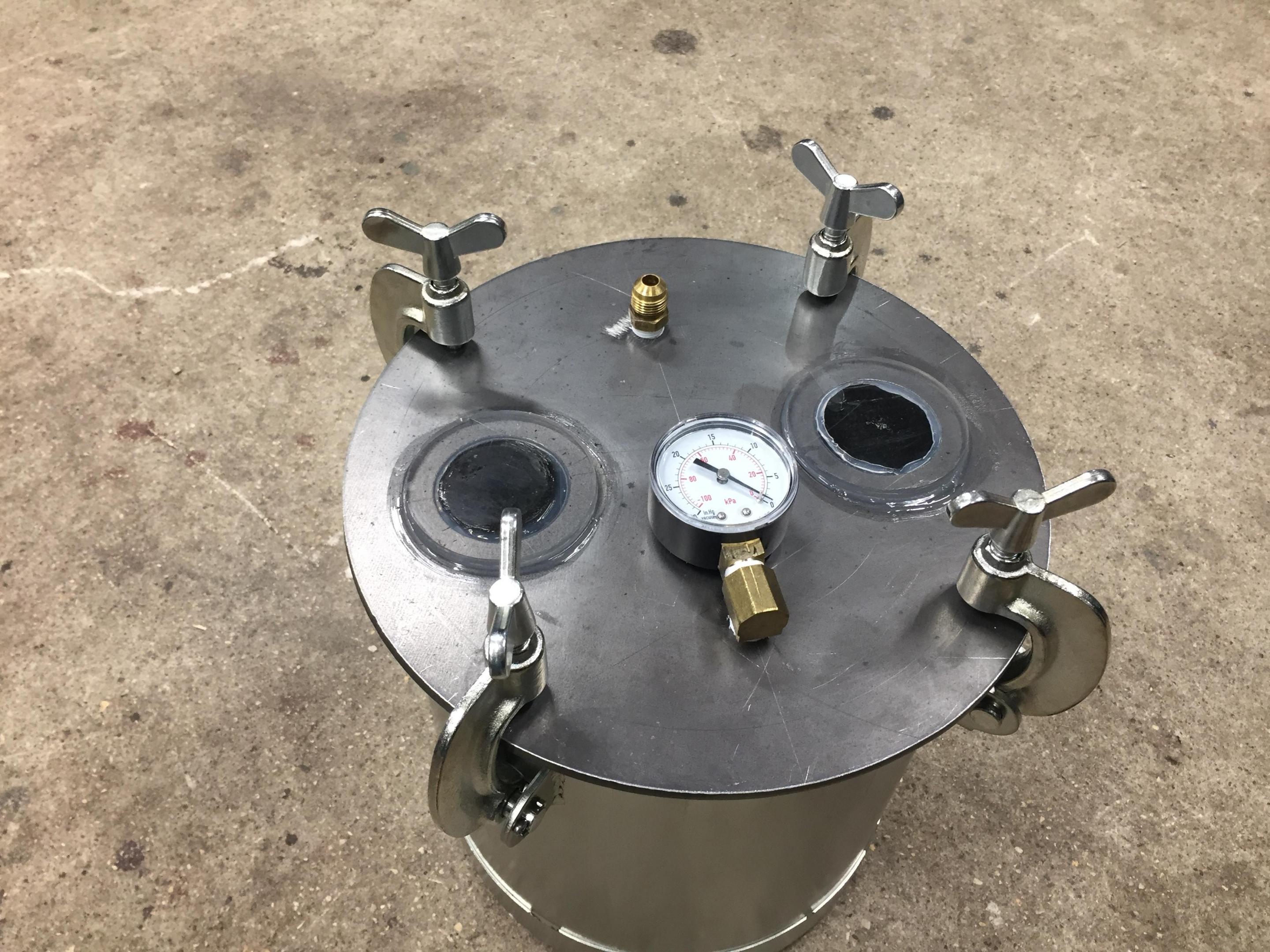

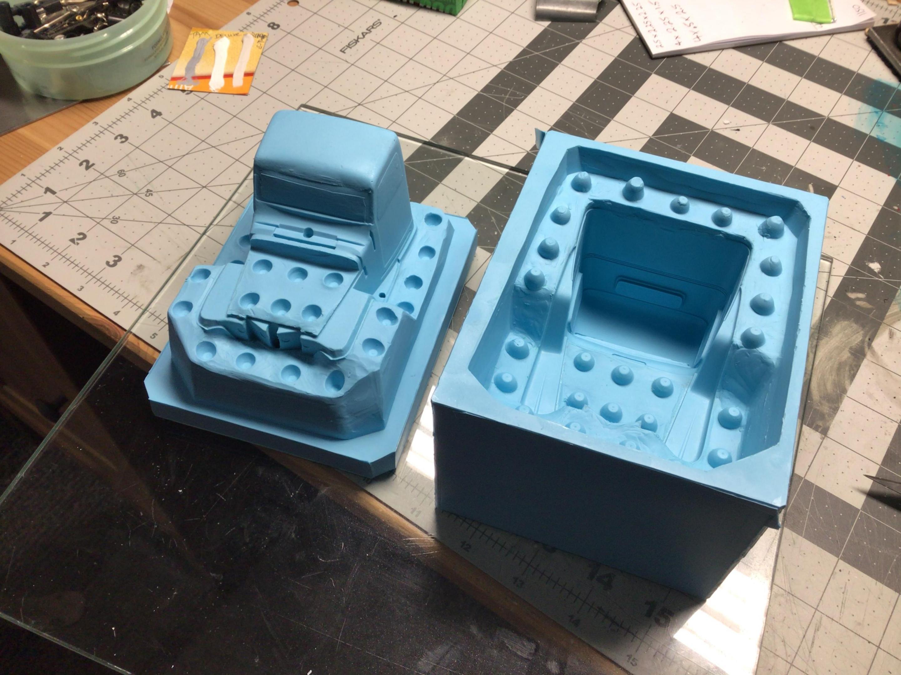

Some more parts. I bought a vacuum pump and converted my pressure tank into a vacuum chamber. What a difference it makes in the quality of the silicone moldings.

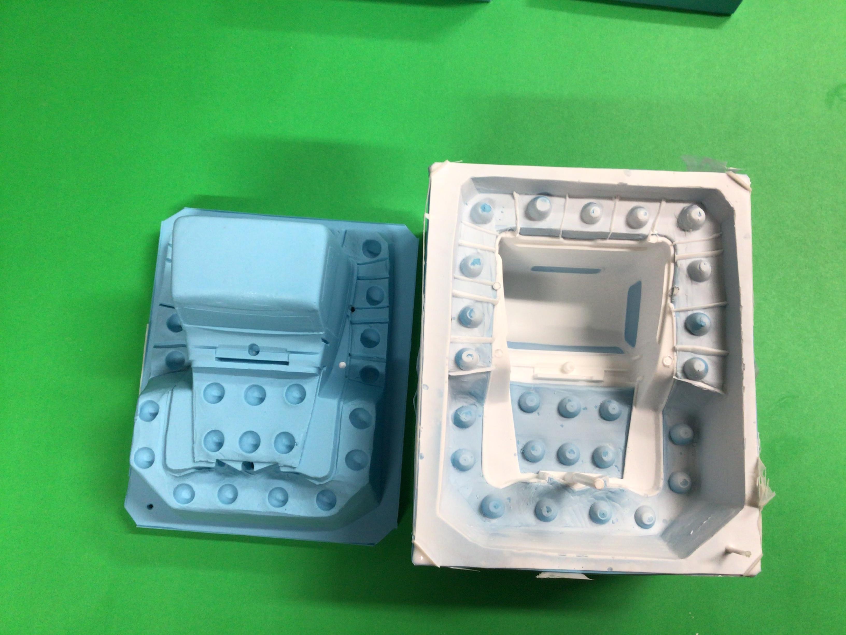

It took me four tries to get a cab that is almost flawless. There’s still a couple tiny air bubbles on the fender edges that can easily be filled. The first three castings have voids in them. There is an inner and outer skin with an airspace between. Two of them are fairly minor so I injected some resin into the void and they may be salvageable. This so far has used up the last of my year-old open bottle of resin...so hopefully fresh stuff will work even better.?

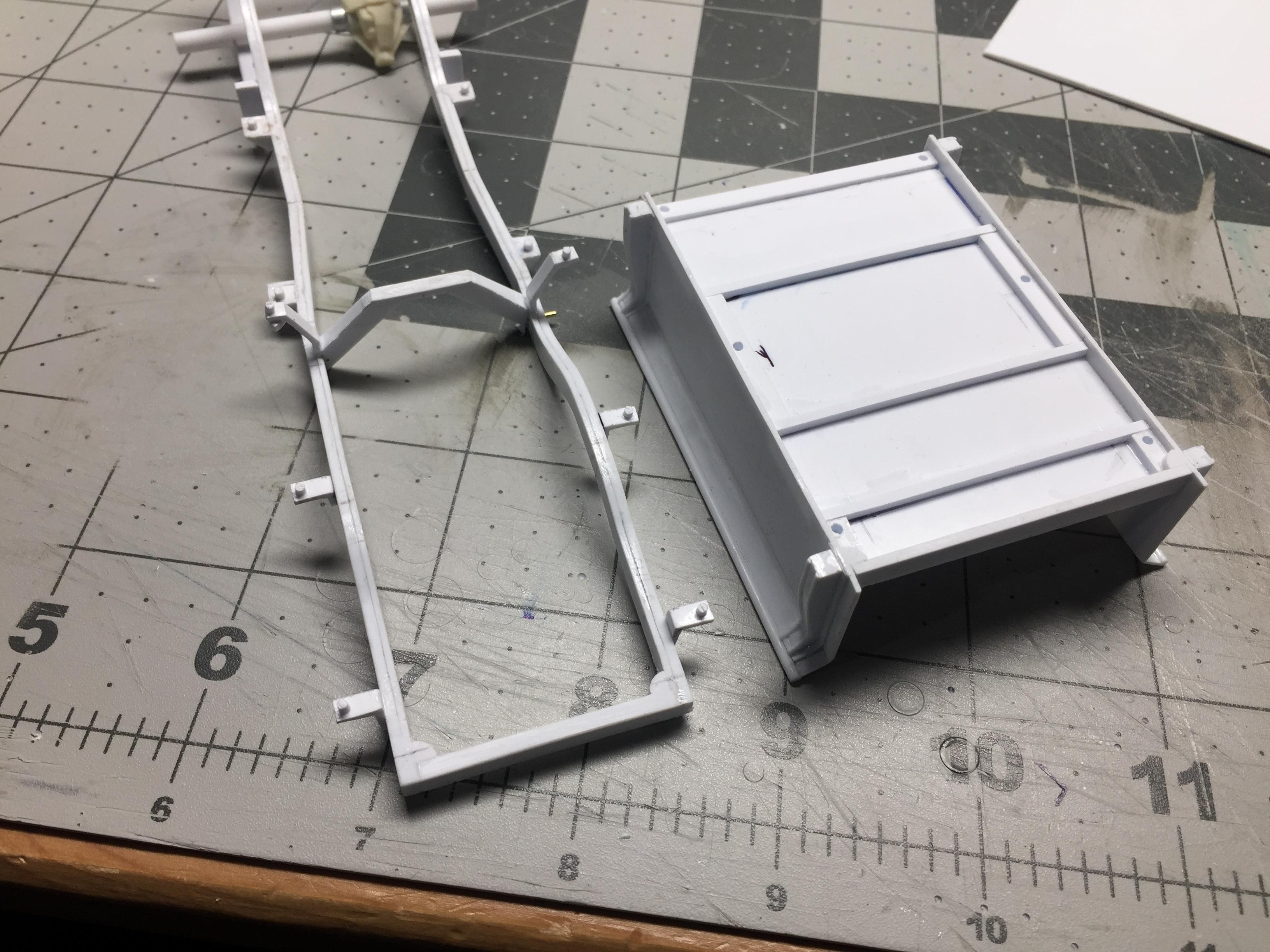

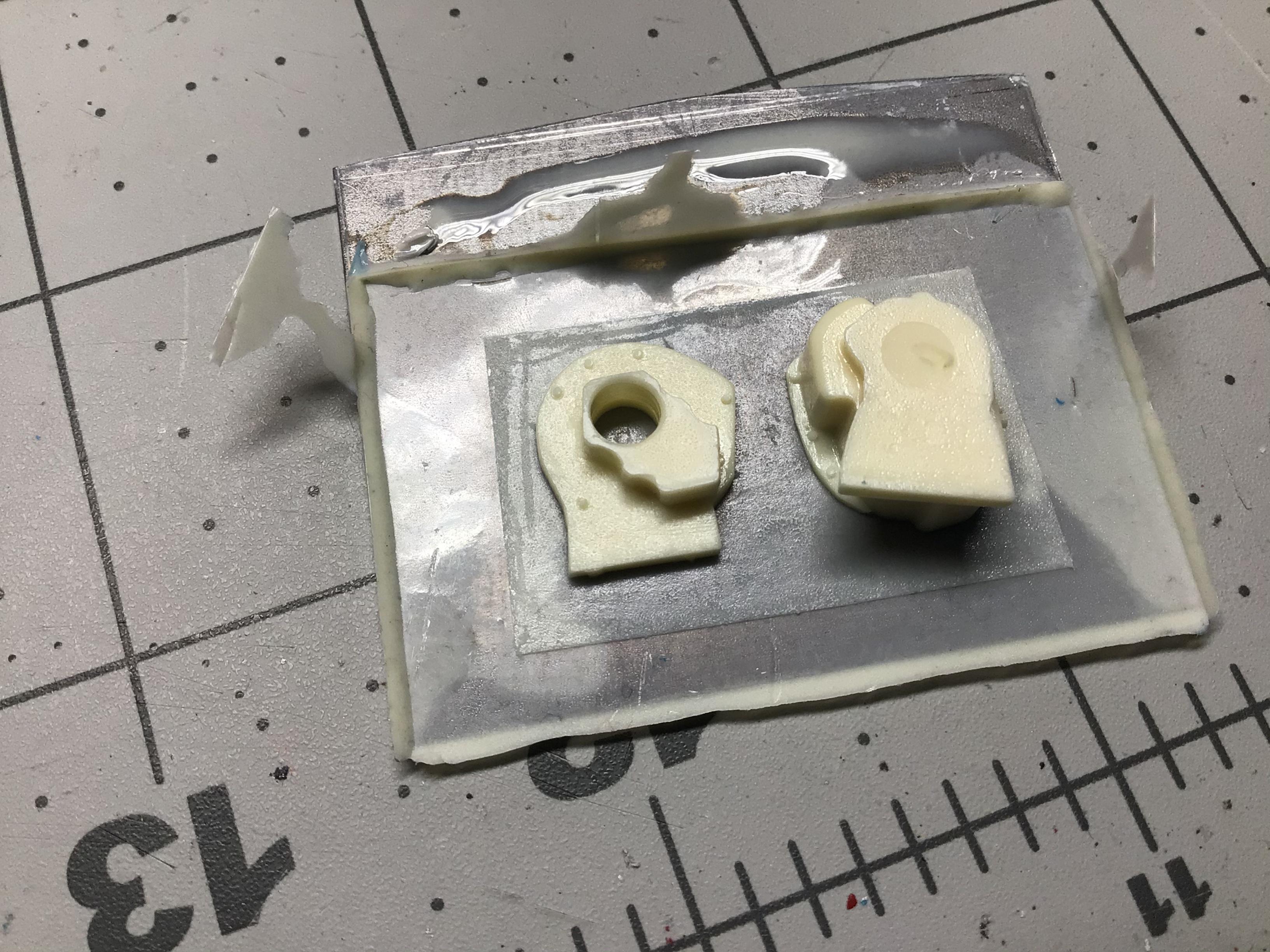

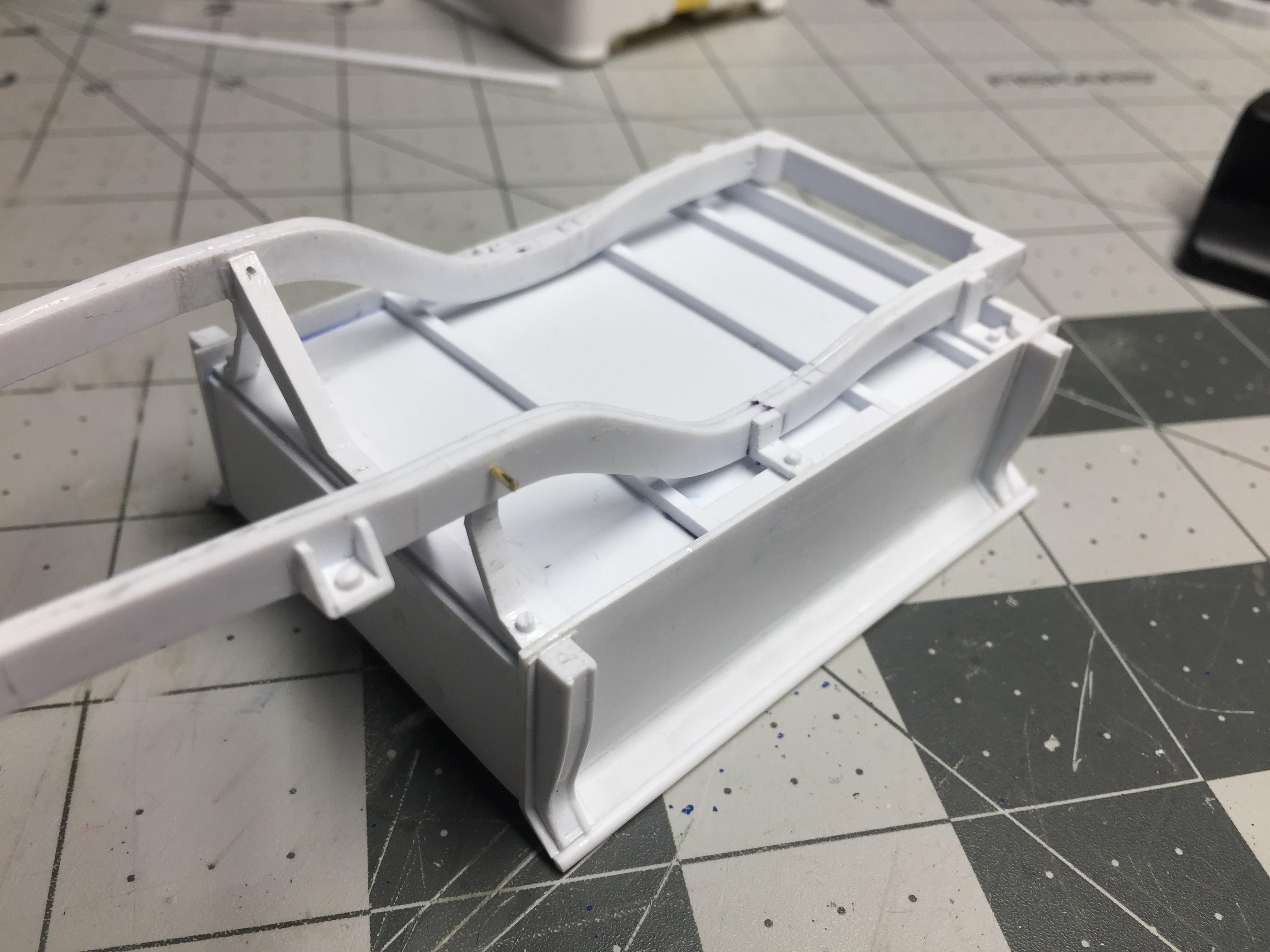

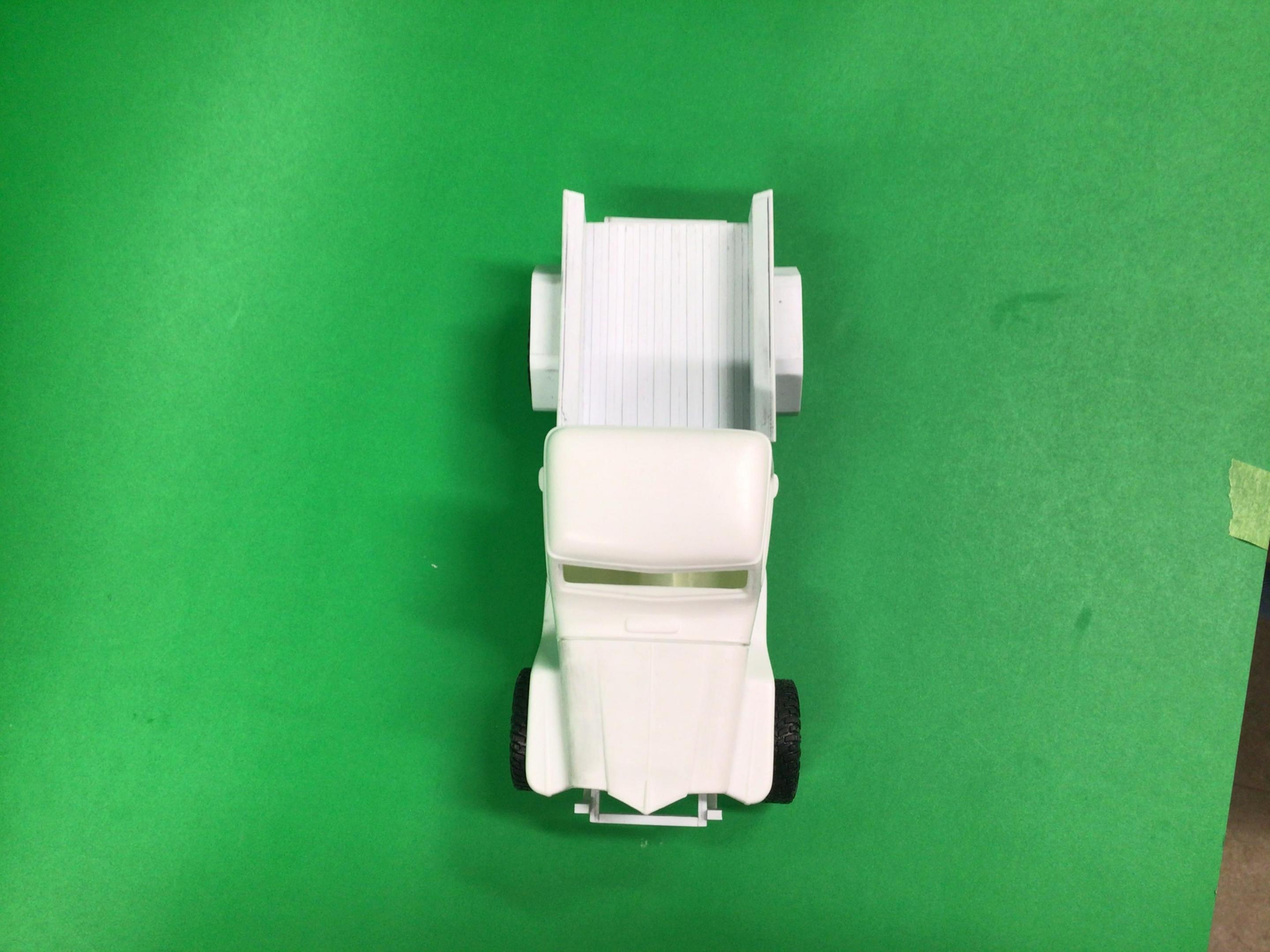

I added some cab mounts to the floor pan and made a new mold for it.FDD17196-9F72-401D-B1E2-29BC5195F083.thumb.jpeg.3058c57b13b55325f98a7ebb31b04dae.jpeg

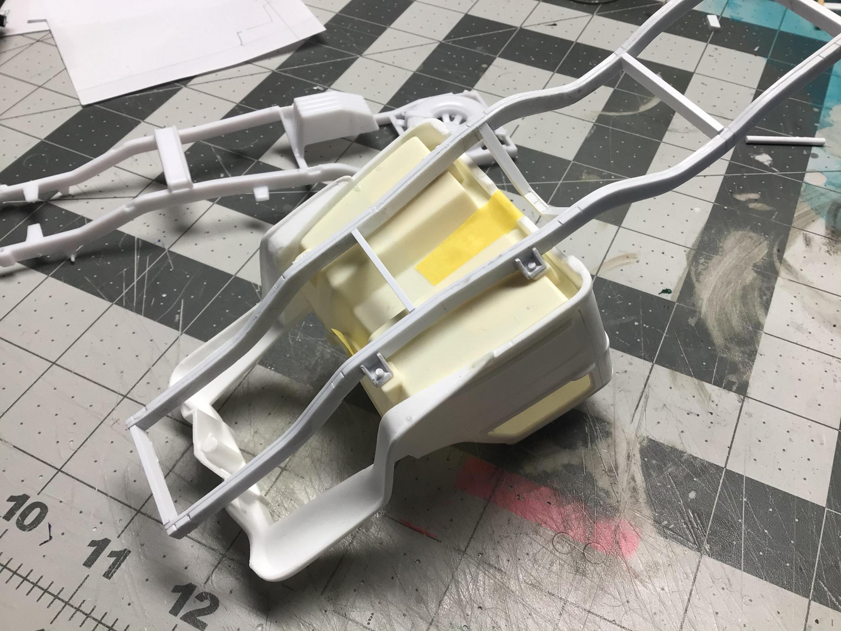

 I’ve decided to use the Revell Jeep Honcho frame instead of the cut down GMC frame...it is already 114” wheelbase and it just seems to fit better.
Jeep Honcho:
GMC:
Since I would have to move all the mounts and get rid of the spare tire and fuel tank, I figured I would make a copy of the frame and still be able to build the Honcho sometime.
Edited by NOBLNG

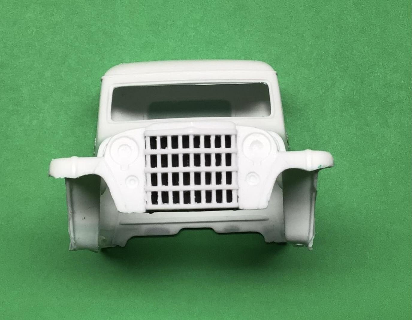

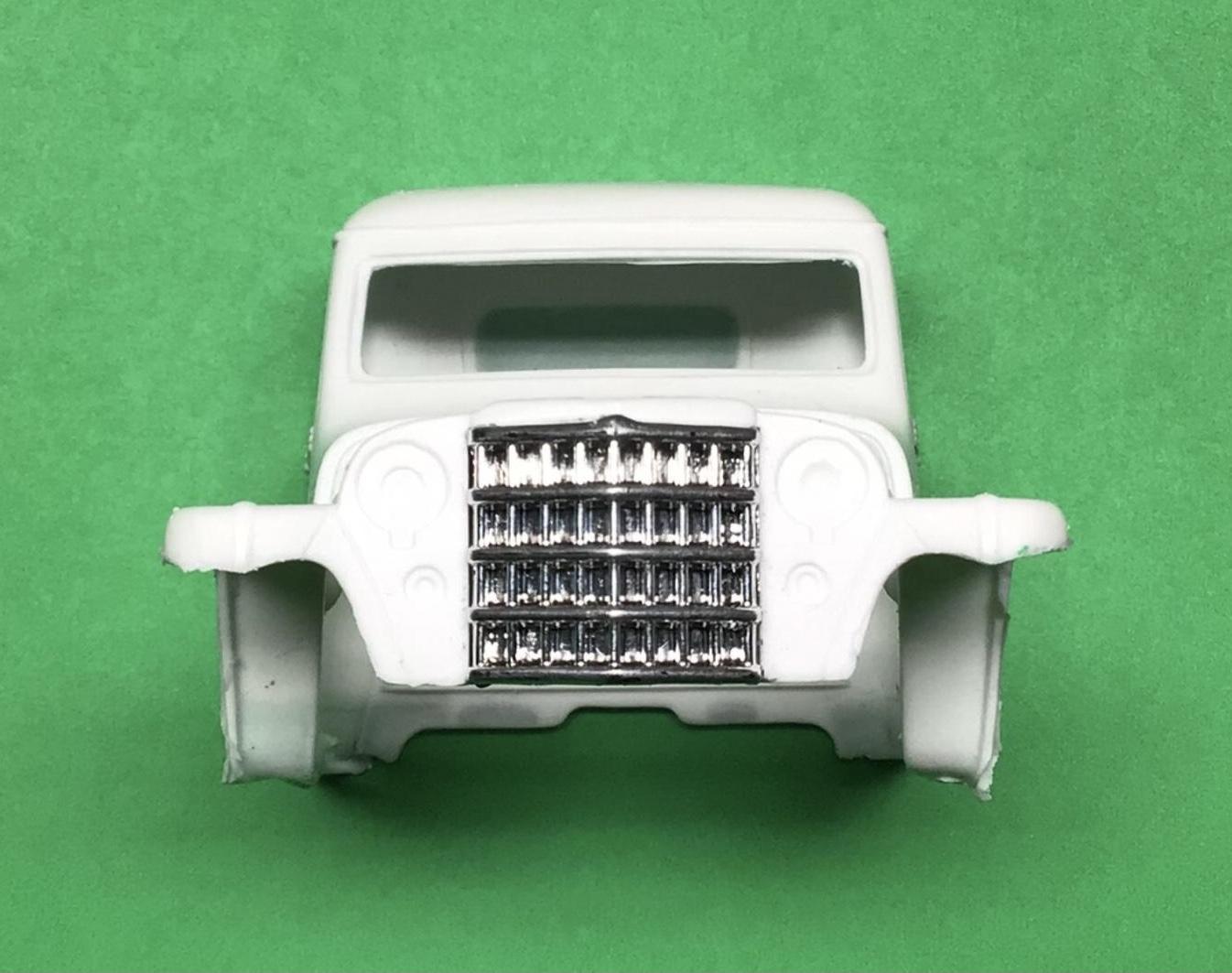

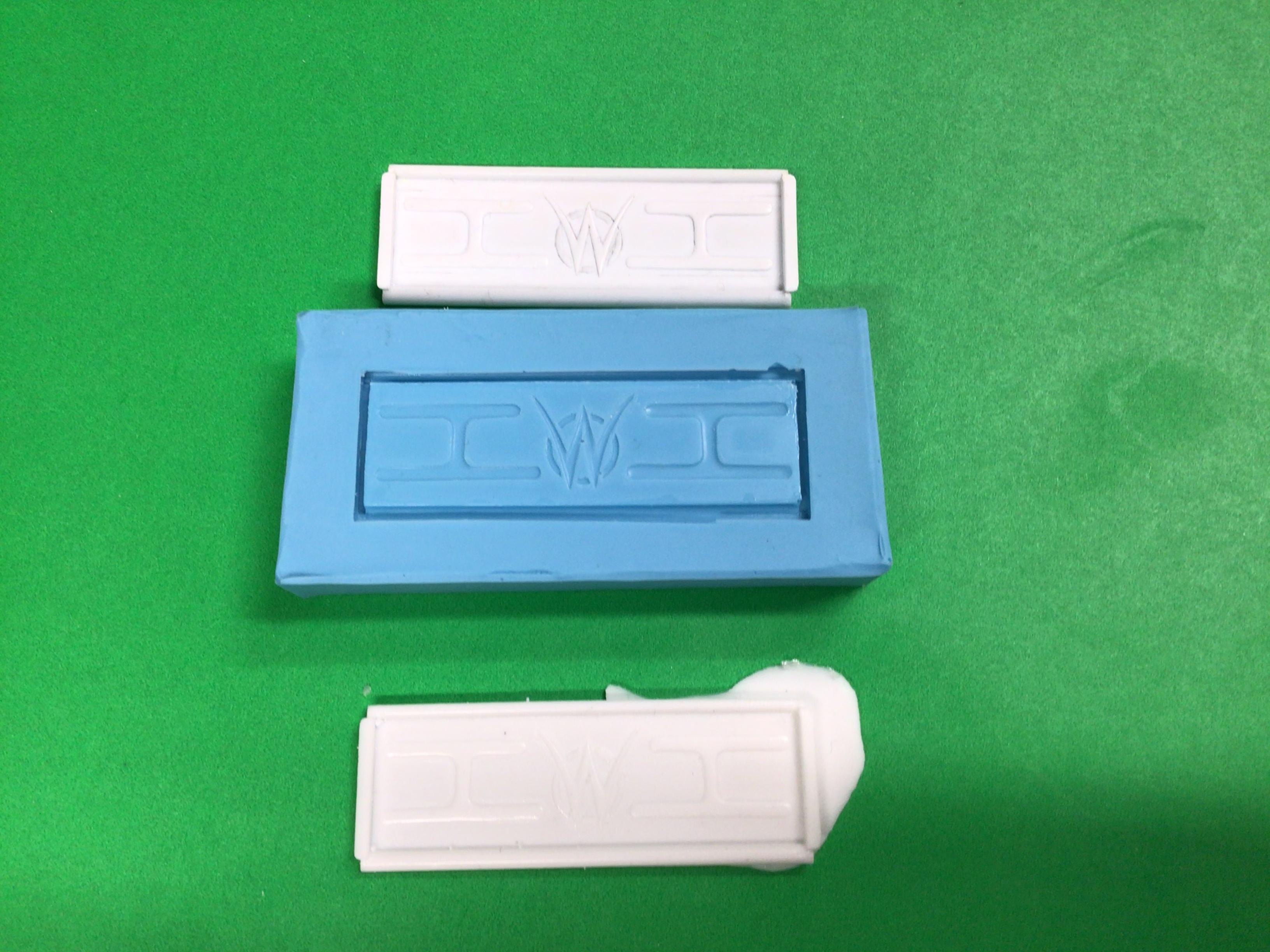

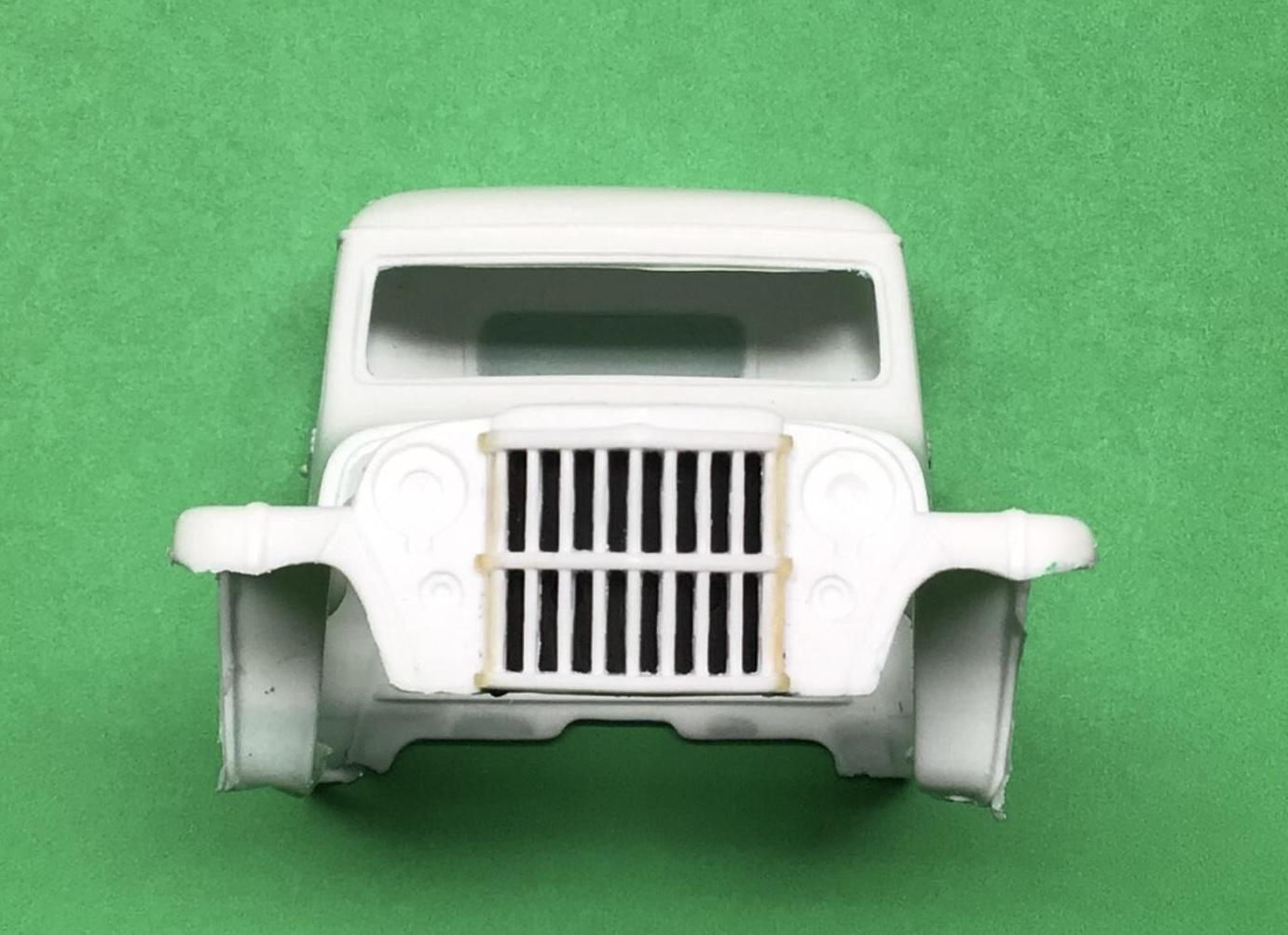

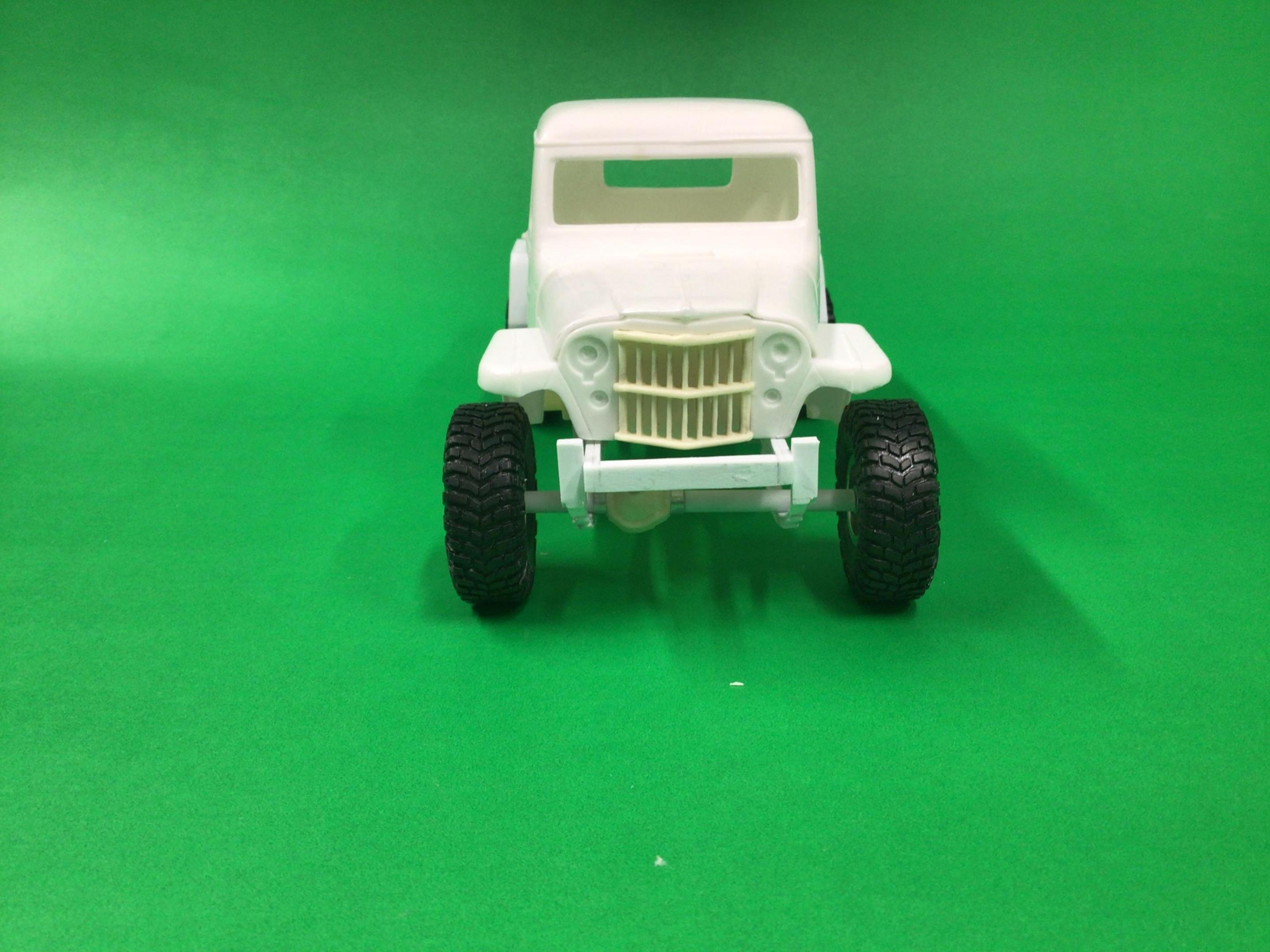

I cast the grill and then opened it up and modified it to the later 3-bar style.
Edited by NOBLNG

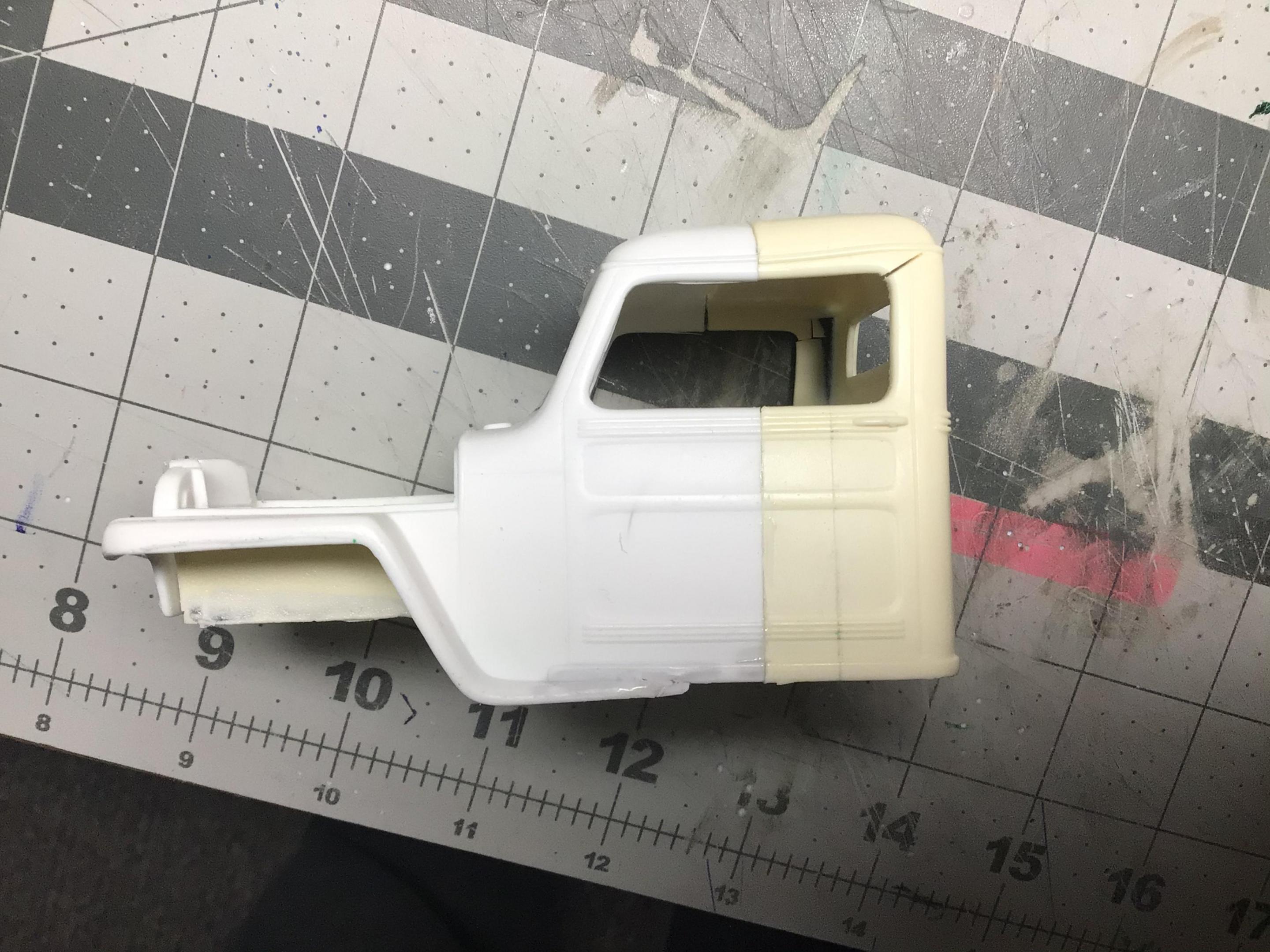

And since I have a couple of cast rejects, I am playing with the Idea of making a stretched cab version.?

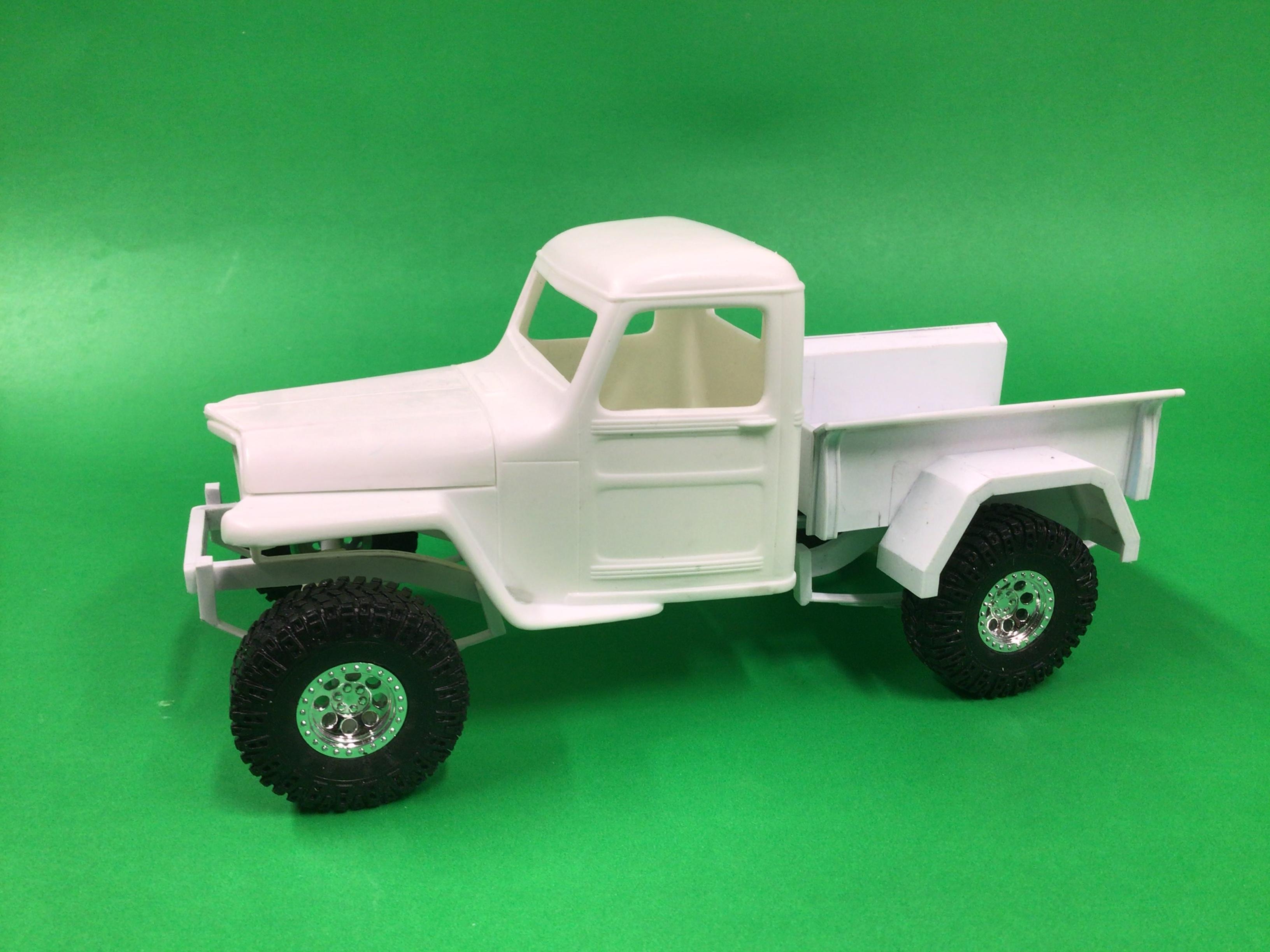

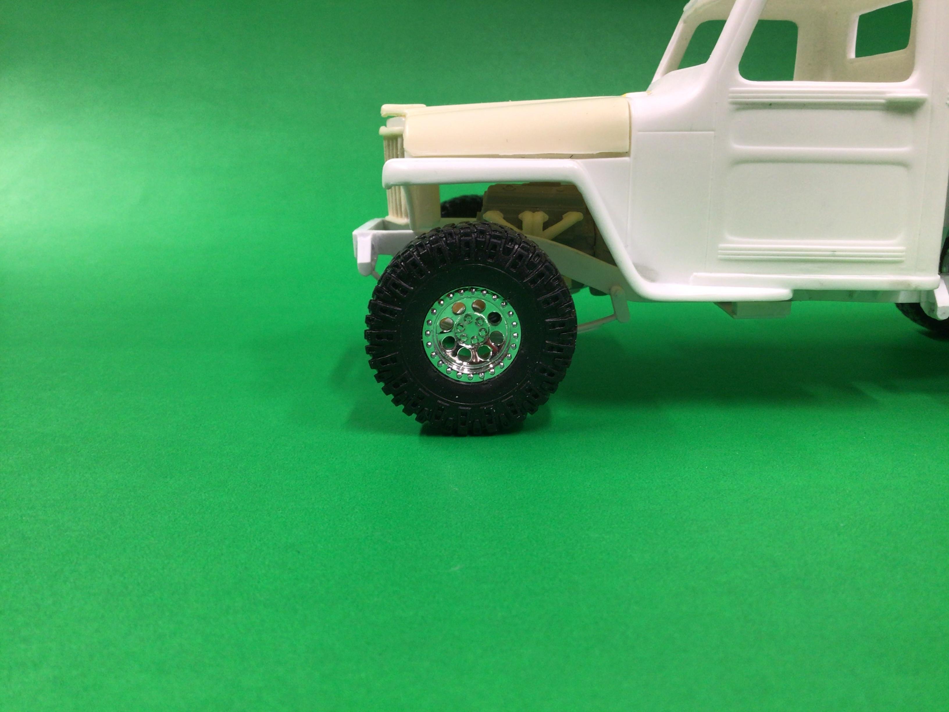

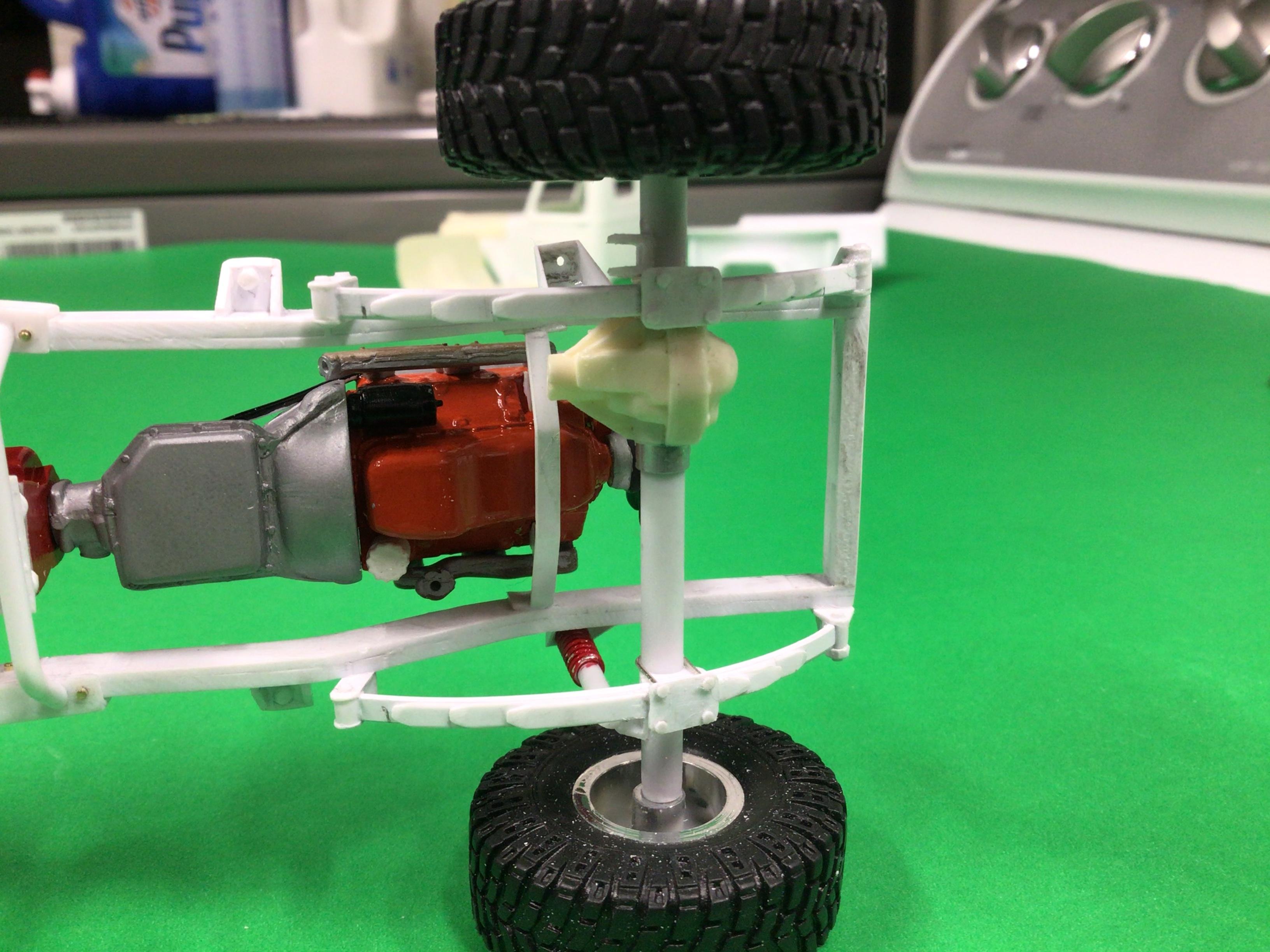

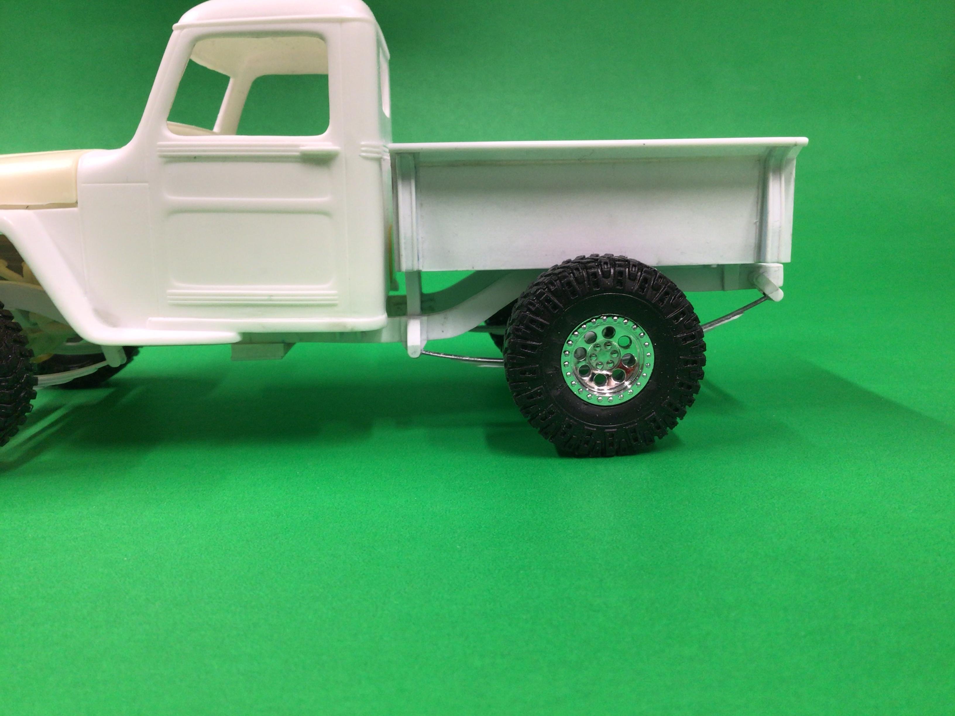

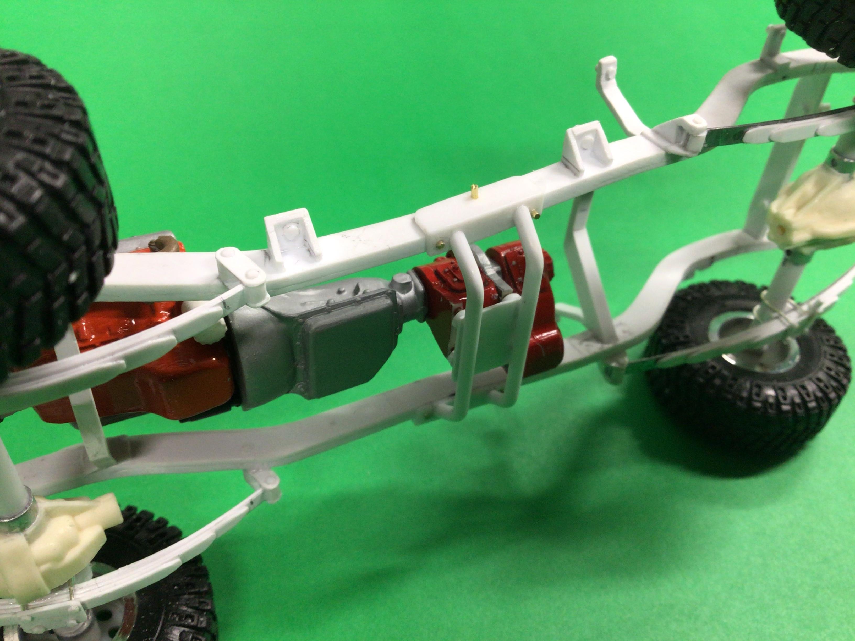

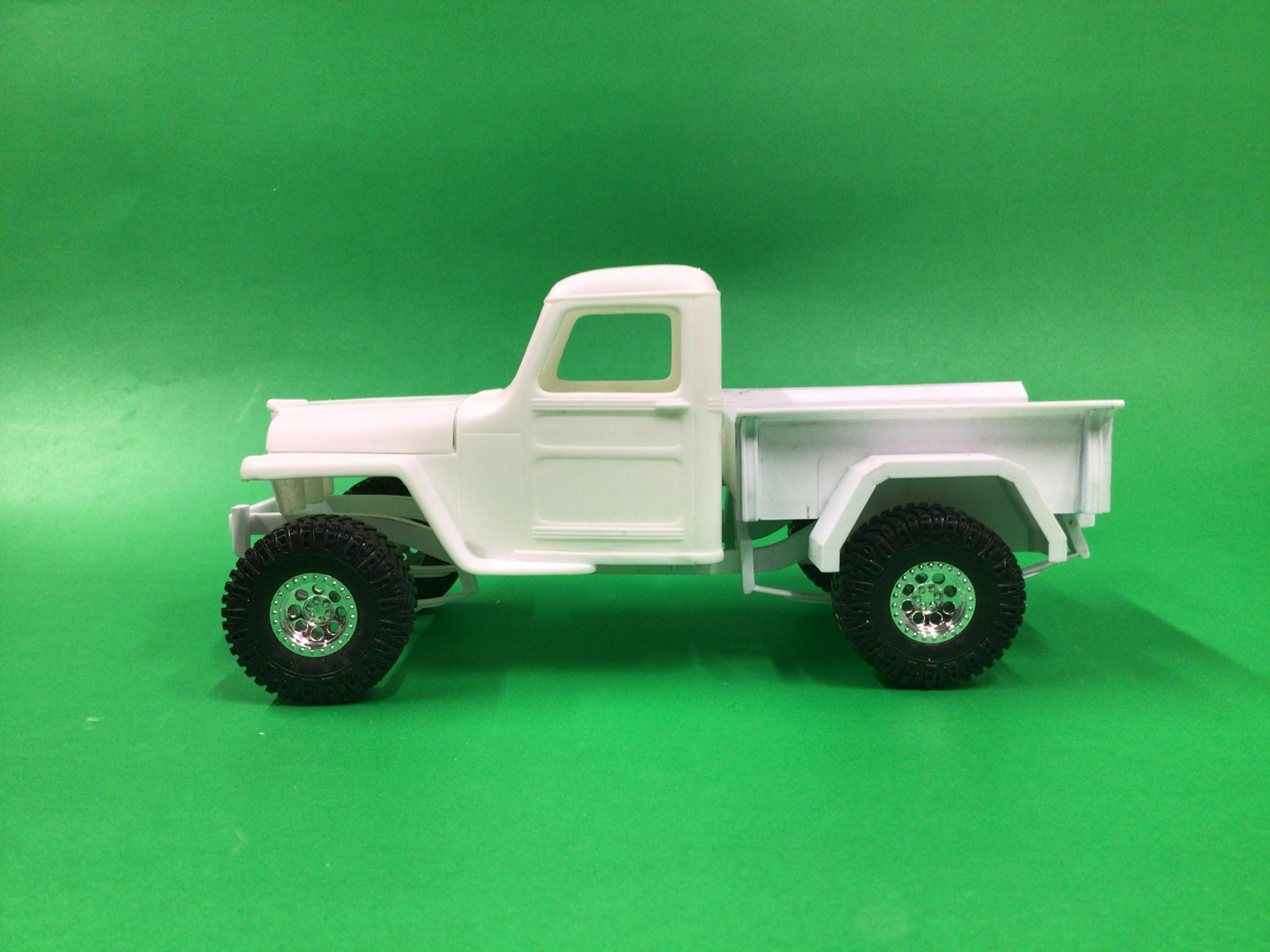

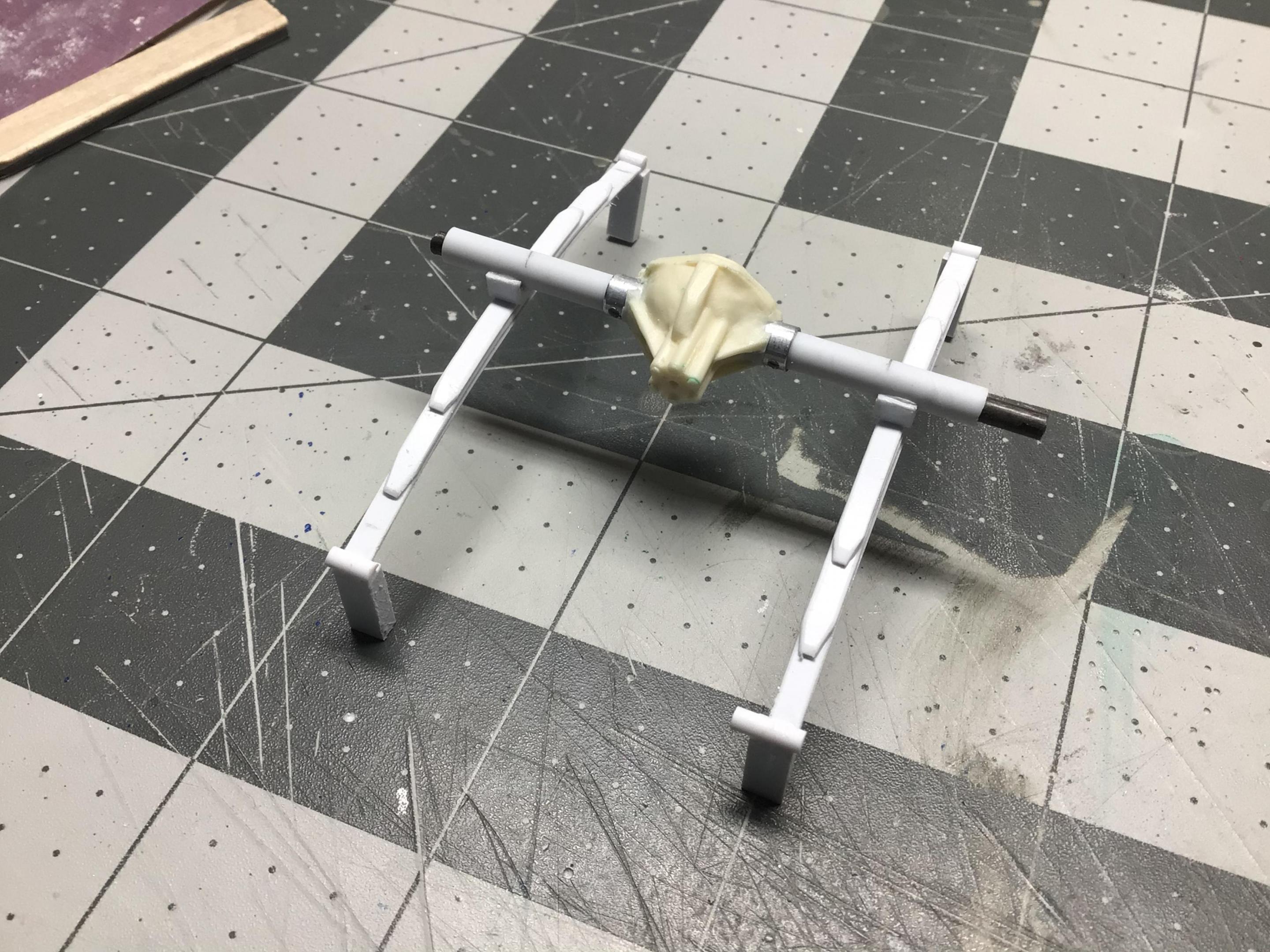

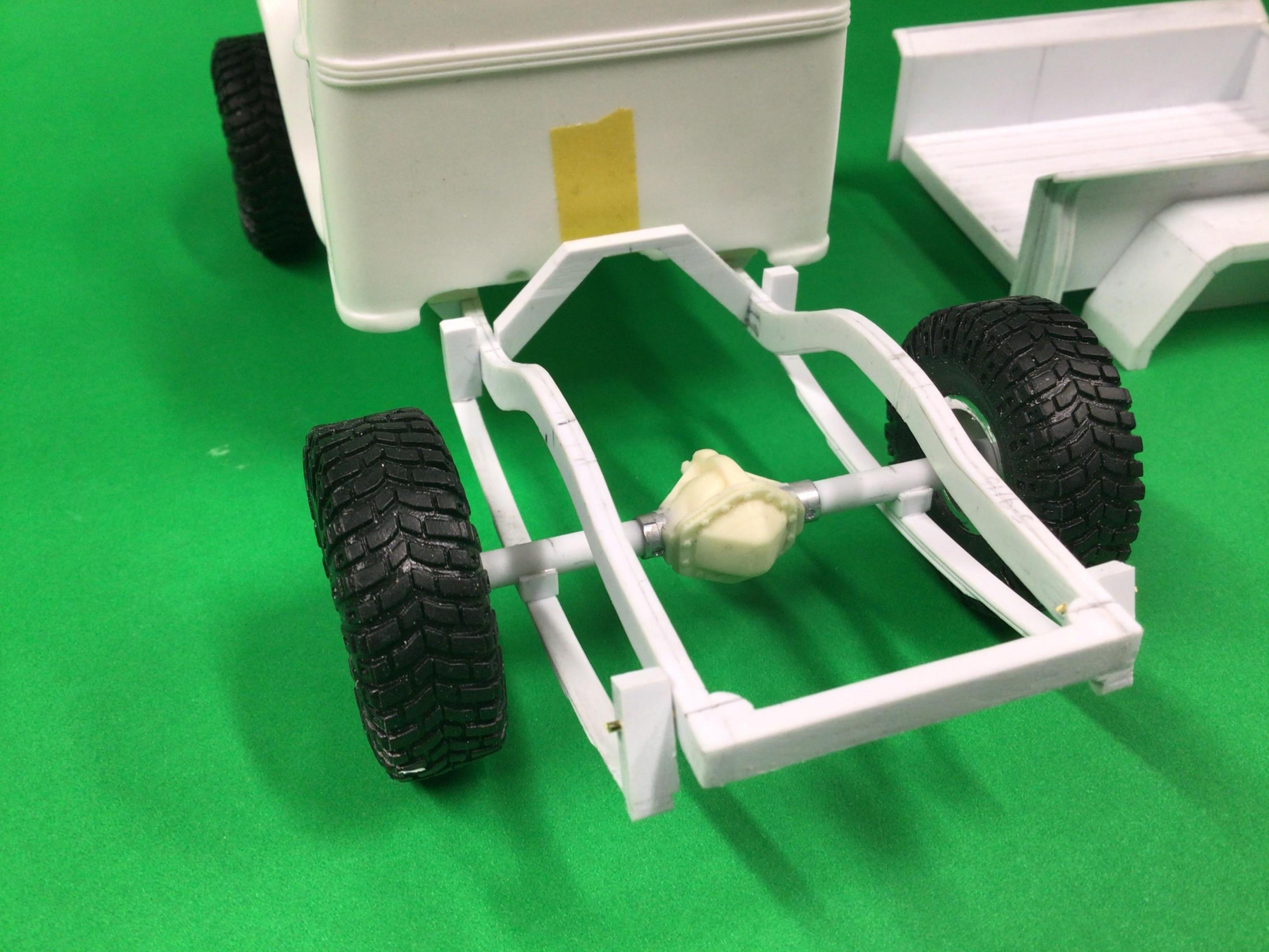

Well I finally got this one up on wheels. I wound up building differentials and springs from scratch. I found a really good tutorial on building leaf springs that Art Anderson put on here years ago.
http://www.modelcarsmag.com/forums/topic/52798-leaf-springs/
Anyway, now that I have a baseline, I can tweak the mounting point locations a bit to level things up. I also need to shape or re-design them to make them more realistic. The differentials are not glued to the axle tubes yet and can be rotated to set the pinion angles once the drivetrain is in place. The front axle will likely  be narrowed a bit yet. The stock trucks had quite a difference between front and rear track width.

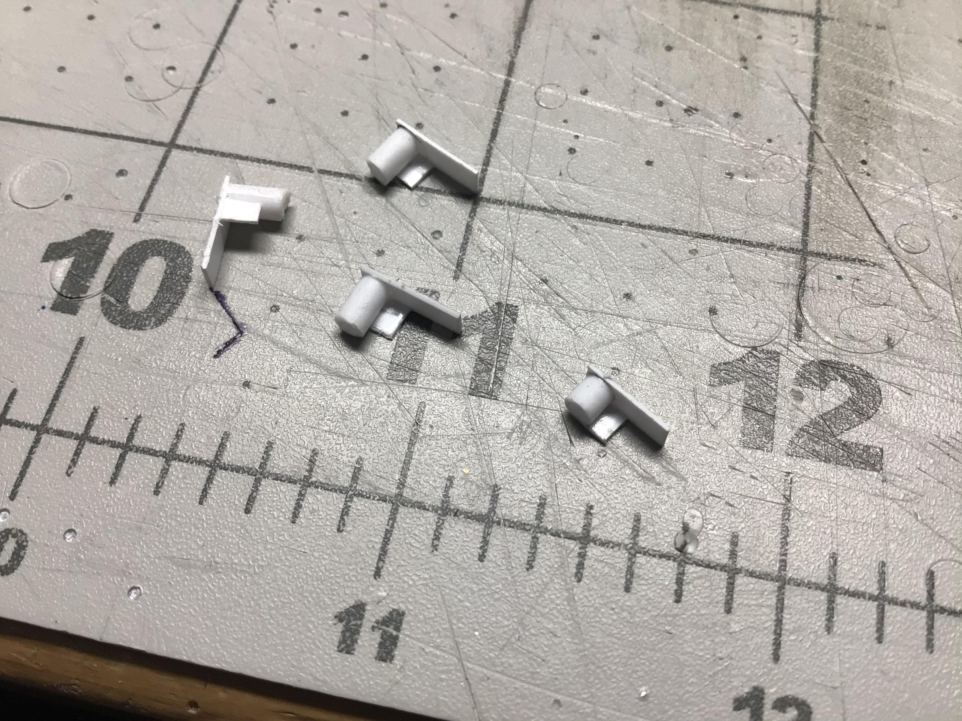

I’ve got the box mounts done using .050” styrene for locating pins. EE55D5D9-62BA-4404-9DB4-2B350E98F092.thumb.jpeg.8dd0f4182acc385b493c4926b8fa3f10.jpeg

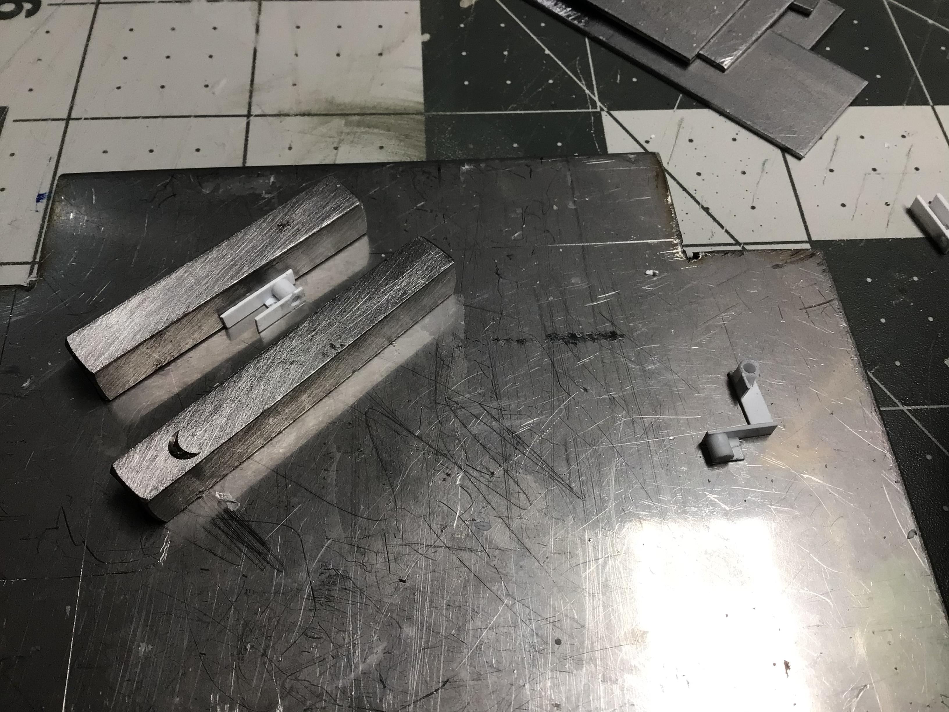

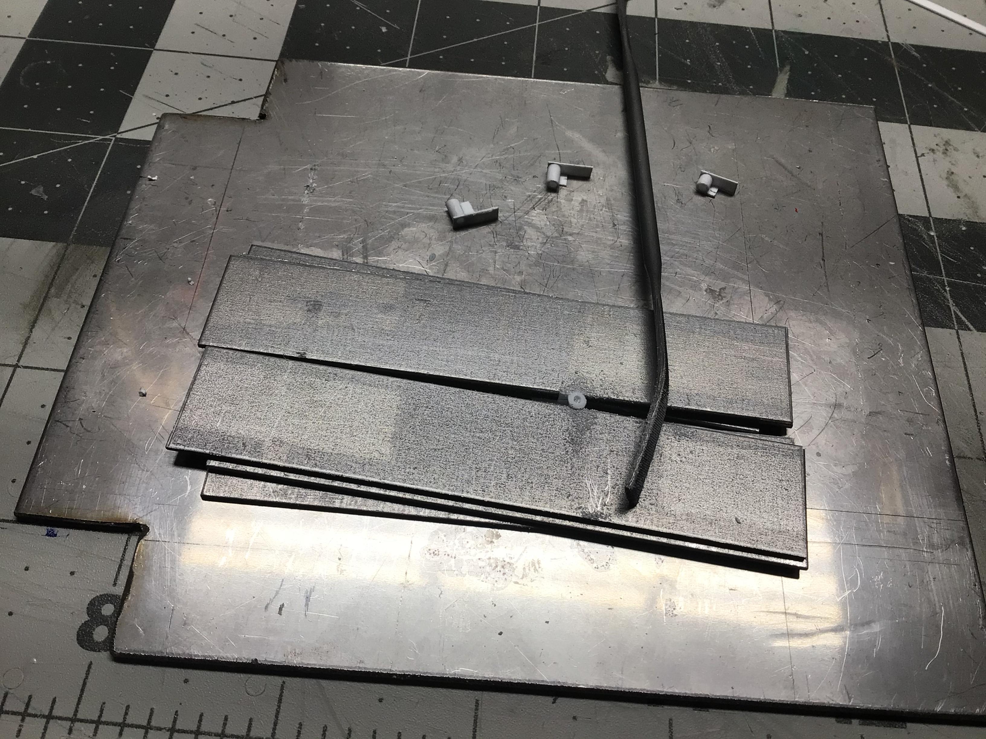

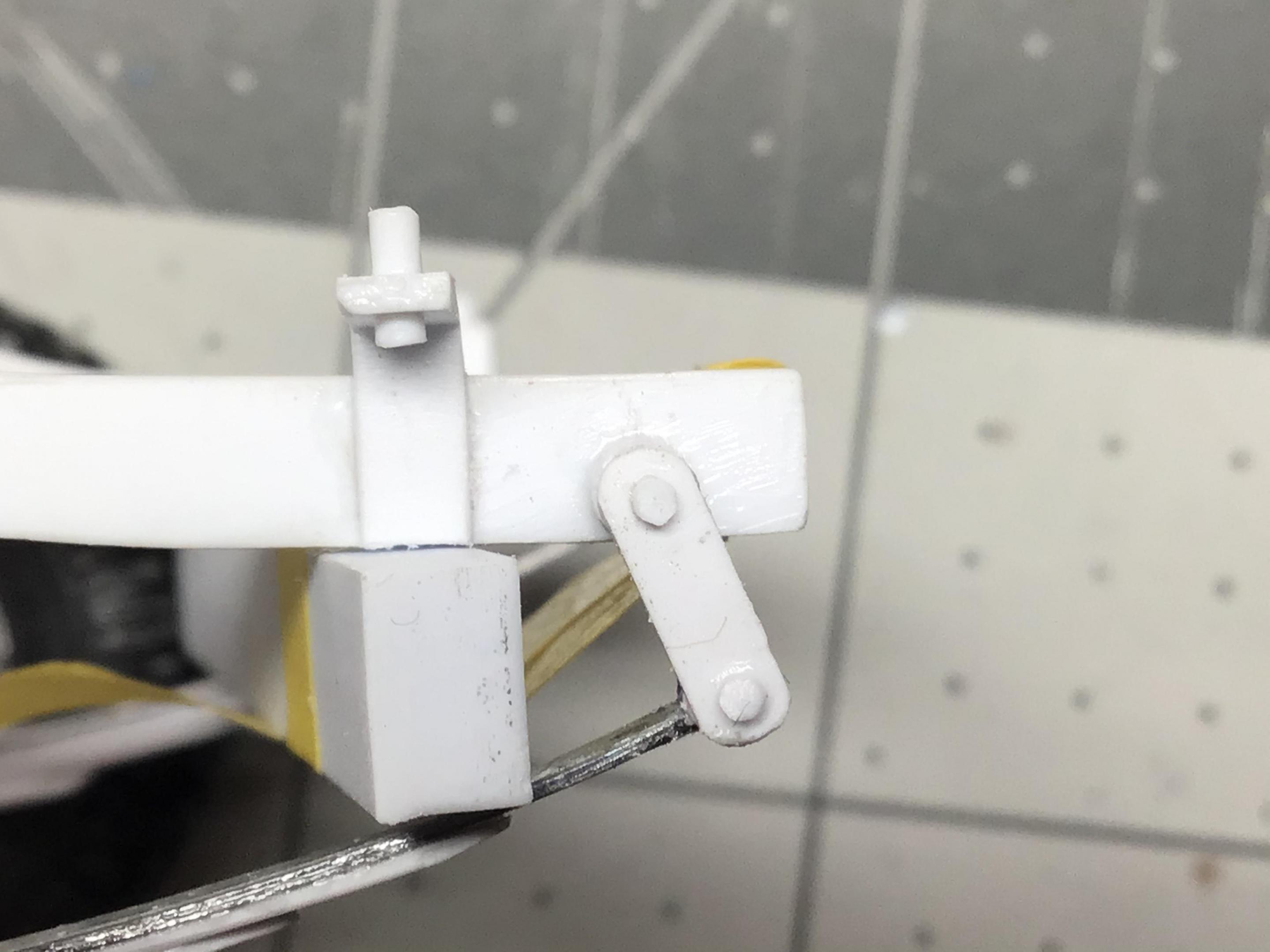

I also got a start on some more realistic shackles. They are .093” evergreen tube and .015” styrene sheet. I have some .038” metal plates (x3=.114”) that I stacked to file the shackles down to width to use with .100” wide springs. Ive used two chunks of 1/4” keystock to press parts together nice and square while the glue sets. Once they are dry they will get filed to shape.680B5E0A-8E0D-4B5C-95D6-188FDBE48F5A.thumb.jpeg.f13ade5532c9b0caa651c1f6c4cb0200.jpeg0E82AB6C-2AC9-4024-9AC8-AE90B3BAA774.thumb.jpeg.db51cb0fb86ab7ff619aae7299e3c945.jpegDE73C247-42C6-4685-B8C1-22575DA74755.thumb.jpeg.d27cfec96ec2aefd0b1f652f9a407d43.jpeg

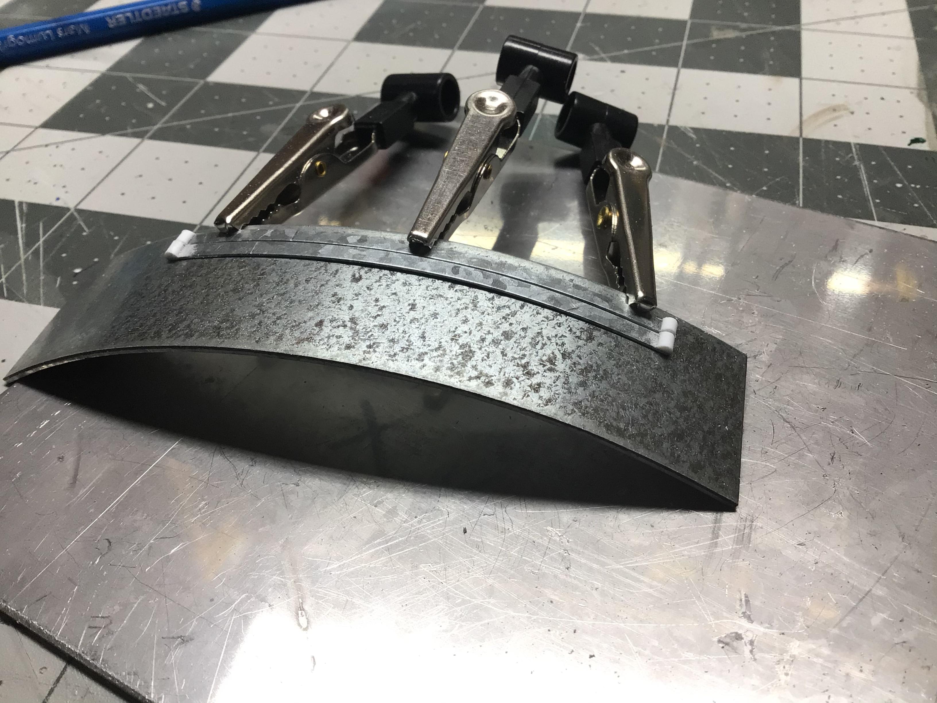

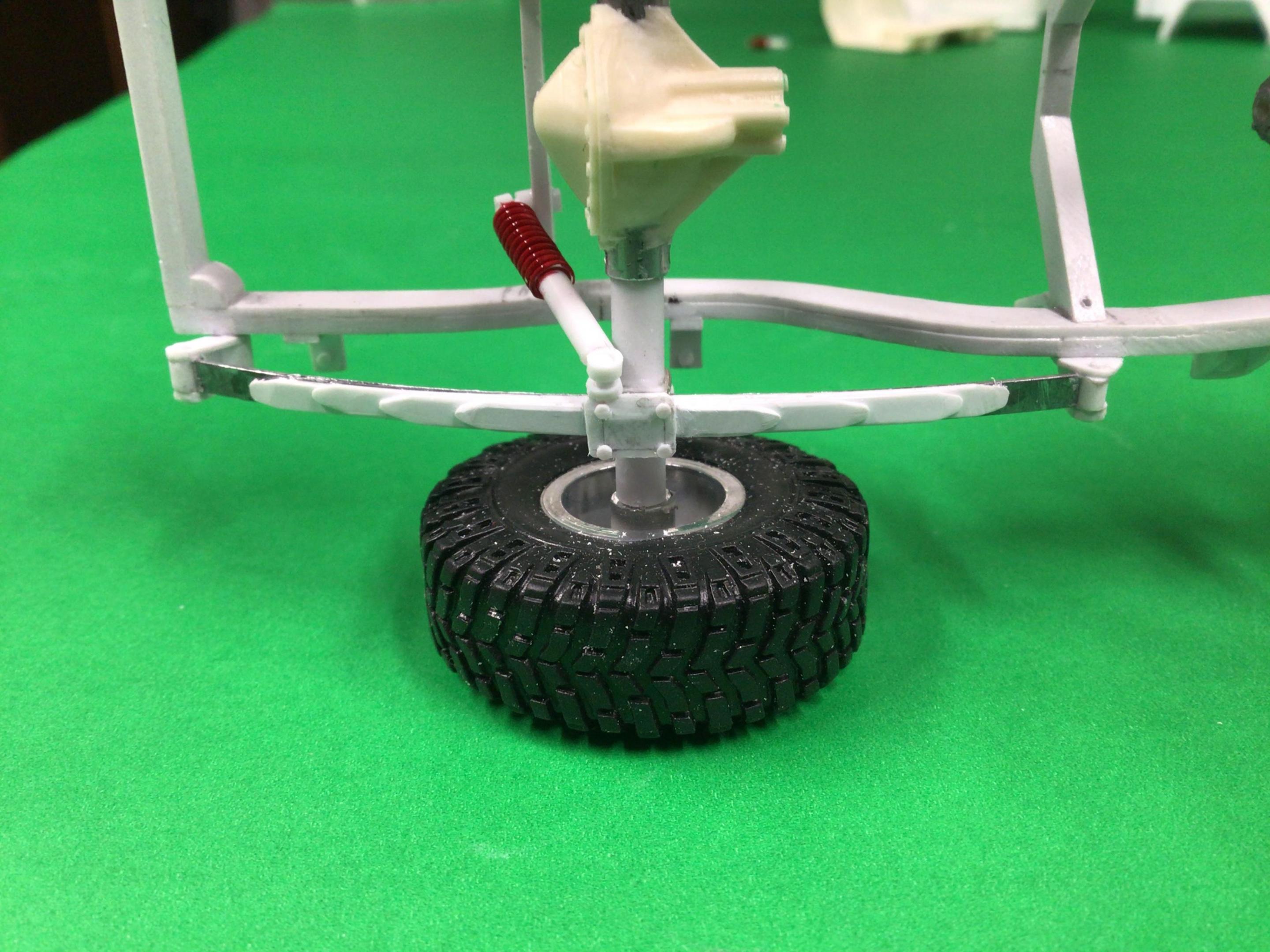

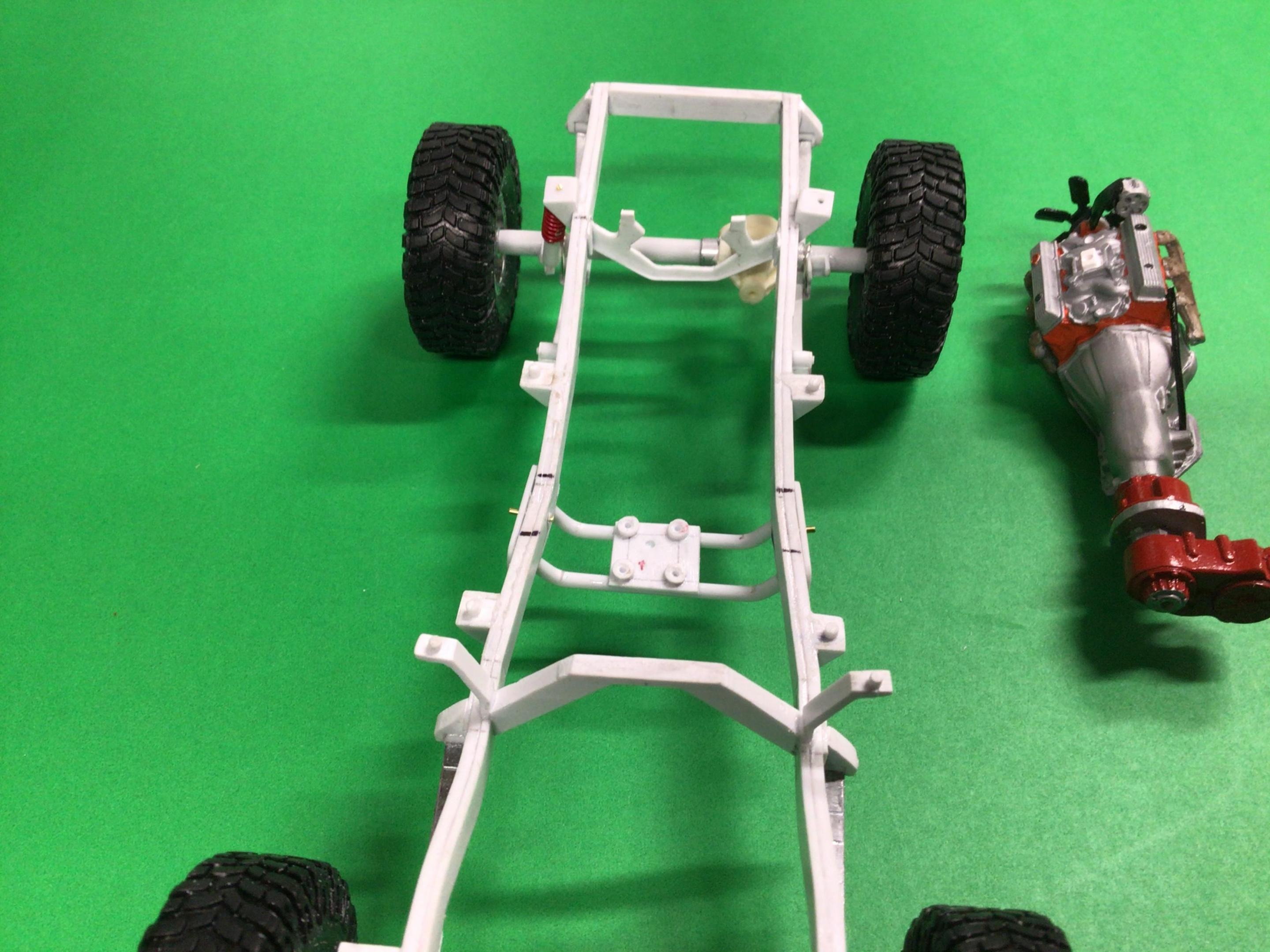

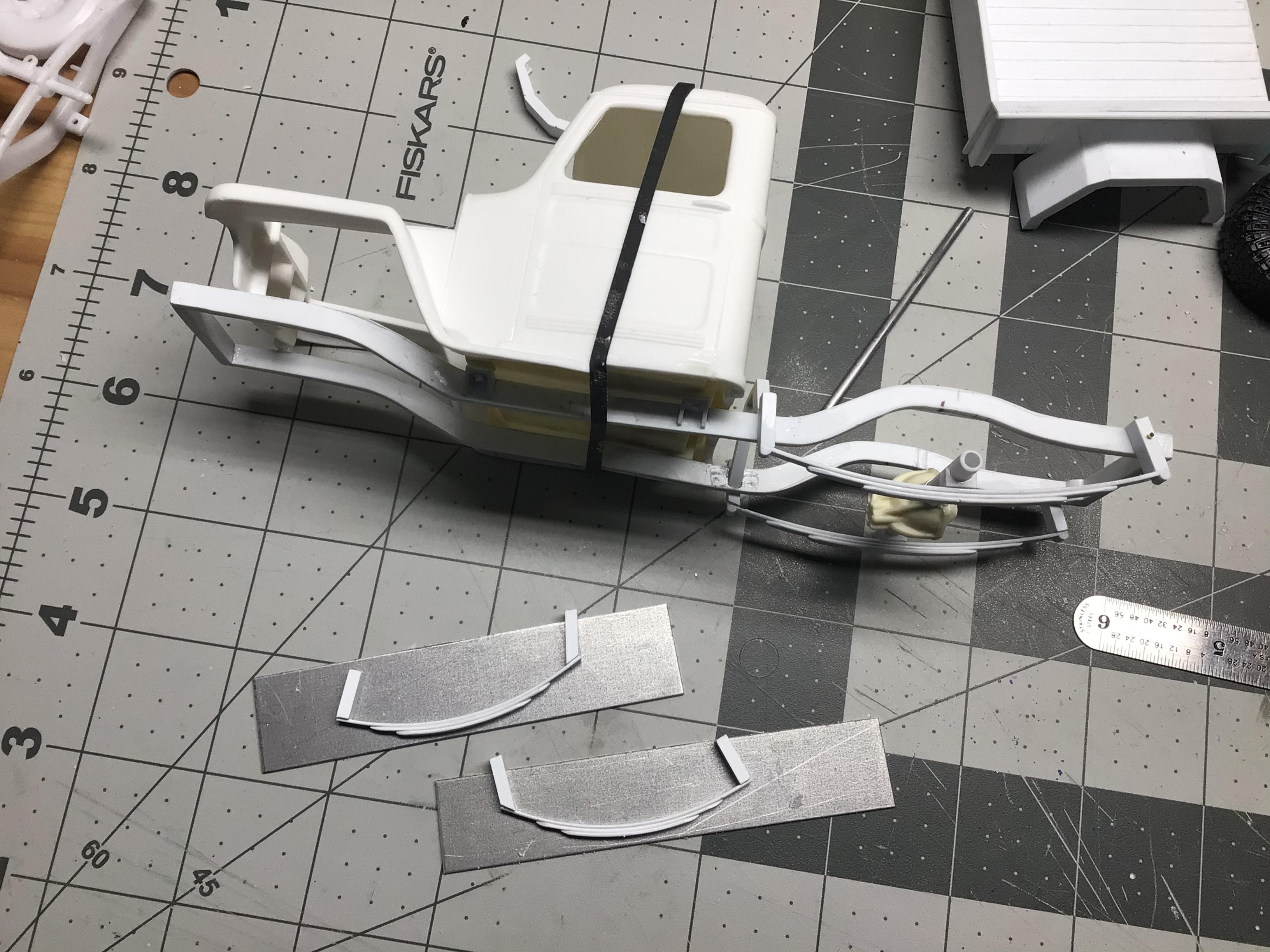

Well the rear springs I made bent while I was fiddling with things, so I re-made them using some 26ga. metal for the main leafs. The fronts are fine as they are shorter and have a lot more arch to them. I got all the spring hangers and shackles made. Also added some u-bolts and plates. I didn’t like the angle of the rear shackles on my first attempt, so I re-did them and made them just a hair longer too. Shocks are styrene tube and .020” aluminum wire.7FF57AFB-16AC-4832-AA79-6A41B37C9E36.thumb.jpeg.5f927530cef7791299cfa1c4902ac903.jpeg7F806BF7-90FC-4664-84E1-AFE3D8B1B23F.thumb.jpeg.9ca54e763a7b8e4a121fc756b7bb241a.jpeg

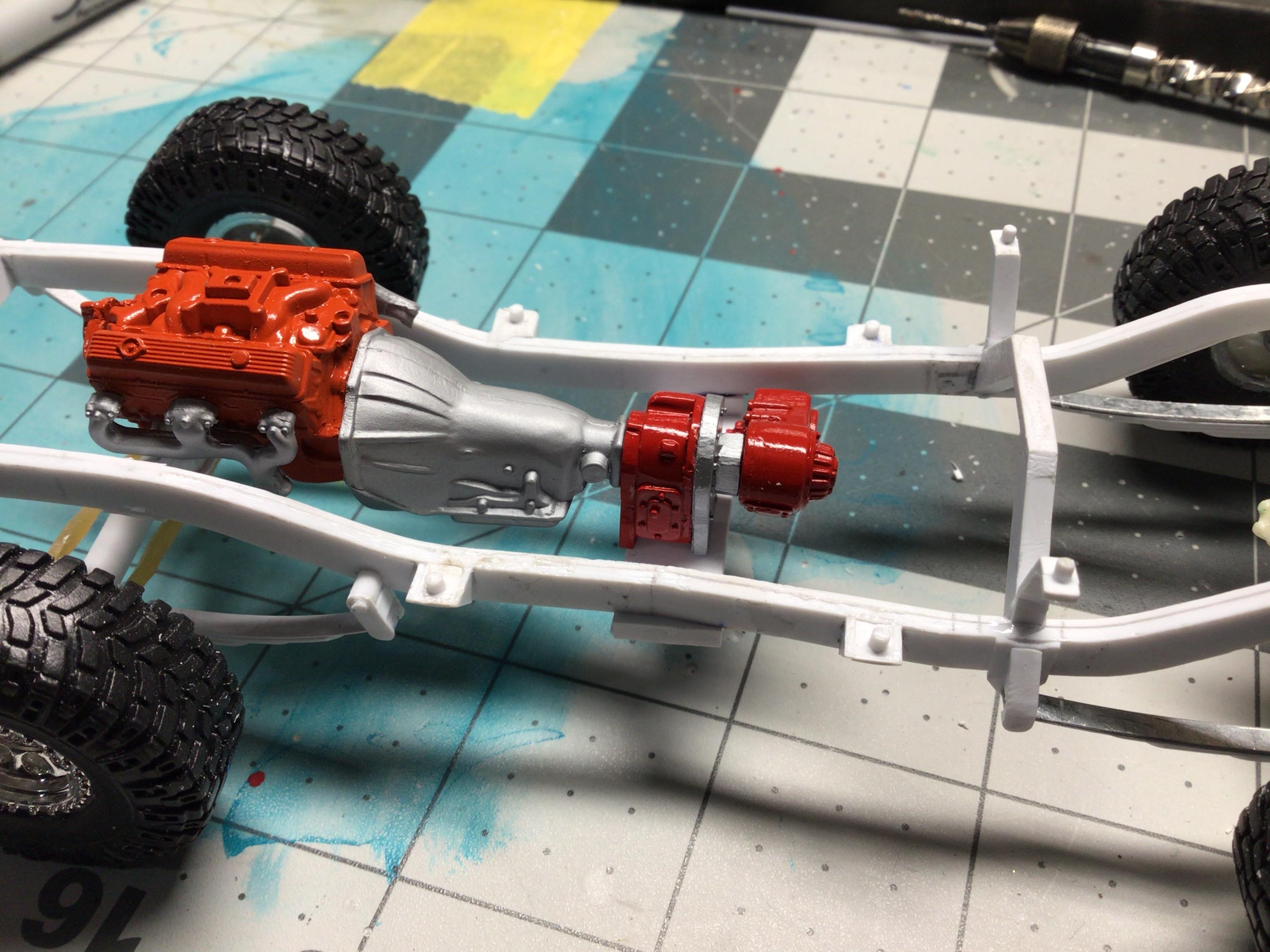

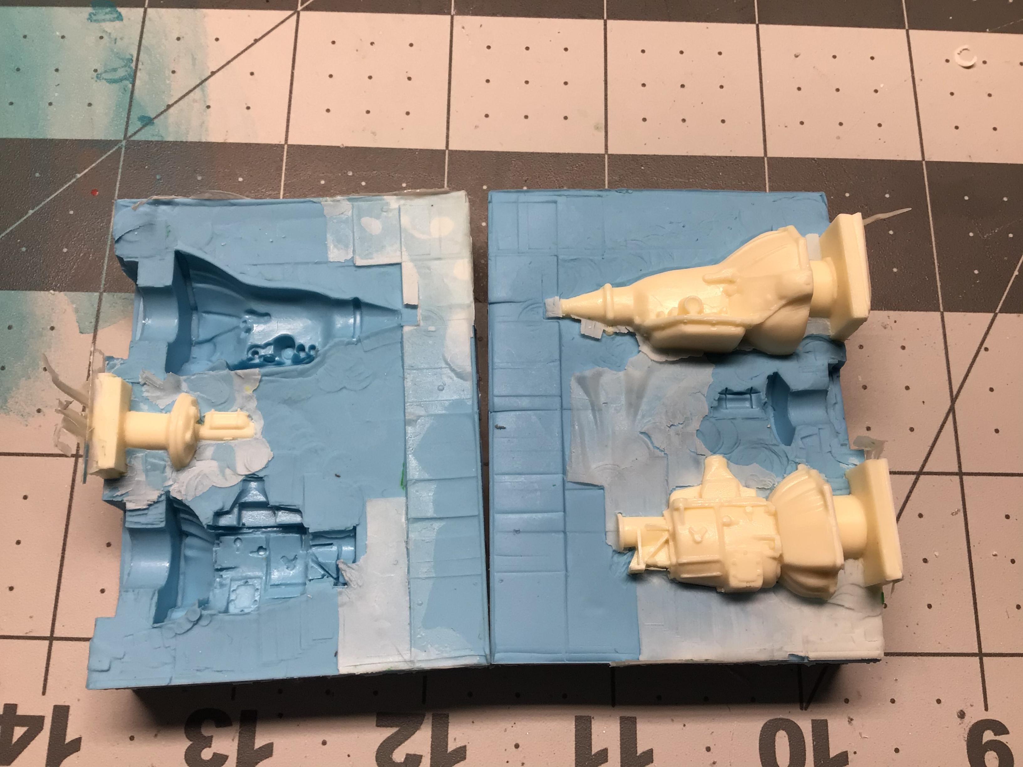

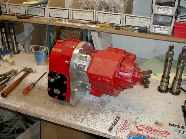

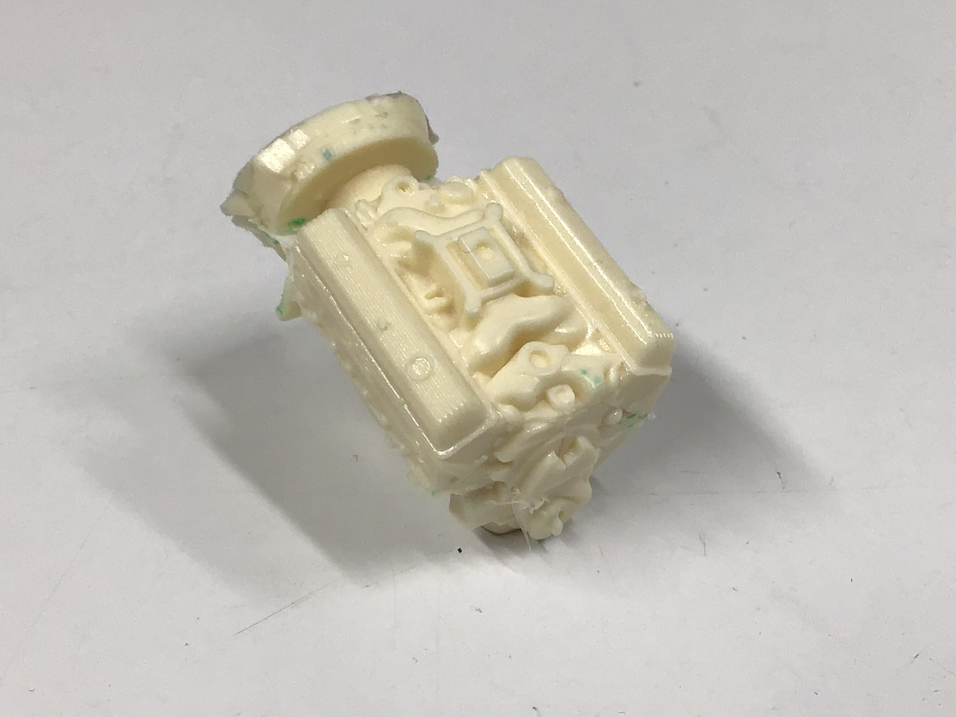

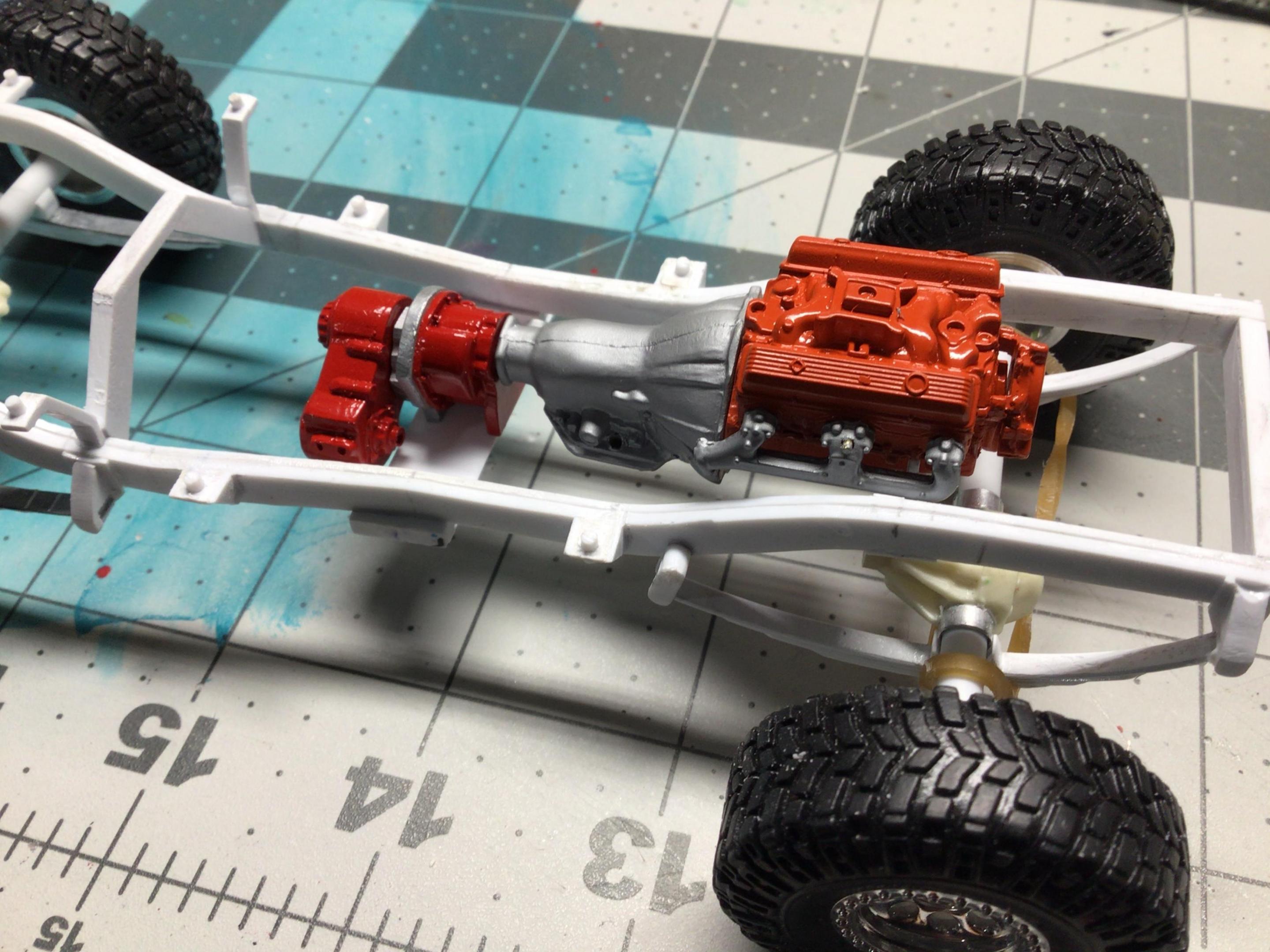

I’ve been busy casting a bunch of miscellaneous parts. My truck has a chevy 350 and turbo 350 trans, so I snagged an MPC El Camino and copied the tranny...engine is copied from the Revell Nova. I also have an Off Road Design doubler kit which pairs the high-low range box from a New Process 203 transfer case with a complete NP 205 transfer case. This gives me two low ranges resulting in a 4:1 ratio for crawling (great for rocks)! I scratch built the 203 range box, the adapter and most of the 205. The last pic is a screenshot of me climbing Jasons Rock at the Dakota Territory Challenge in 2001.
