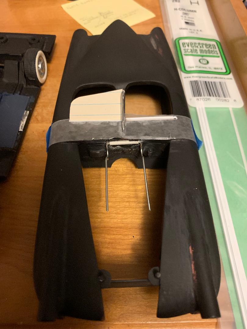

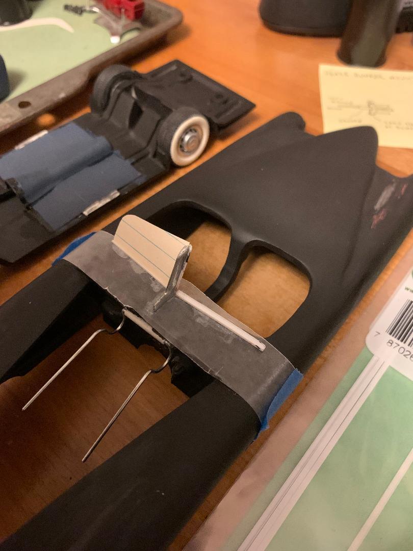

Figured out a possible way to mock up the windshield frame. Cut a strip of waxed paper and taped it over the cowl area. The translucent waxed paper allows you to see what is under it. I then used a bit of white glue to position the central divider, then more glue to hold the two bottom channels in proper relation to the divider and the cowl vee. So far so good. Now the risky part- applying super glue to the joint between the channels and the divider. This is now drying, with a possibility of applying more. In the mean time, I grabbed my trusty card stock to cut a template for the windshield glass. Here is the rest of my cunning plan- once I have removed the waxed paper I hope to soak off the white glue while the superglue joints remain intact, leaving my windshield frame intact. If it hangs together, next will be Molotow. I have a plastic box from which I plan to cut the glass. Installing it should strengthen the frame, allowing it to be installed as a single finished unit.

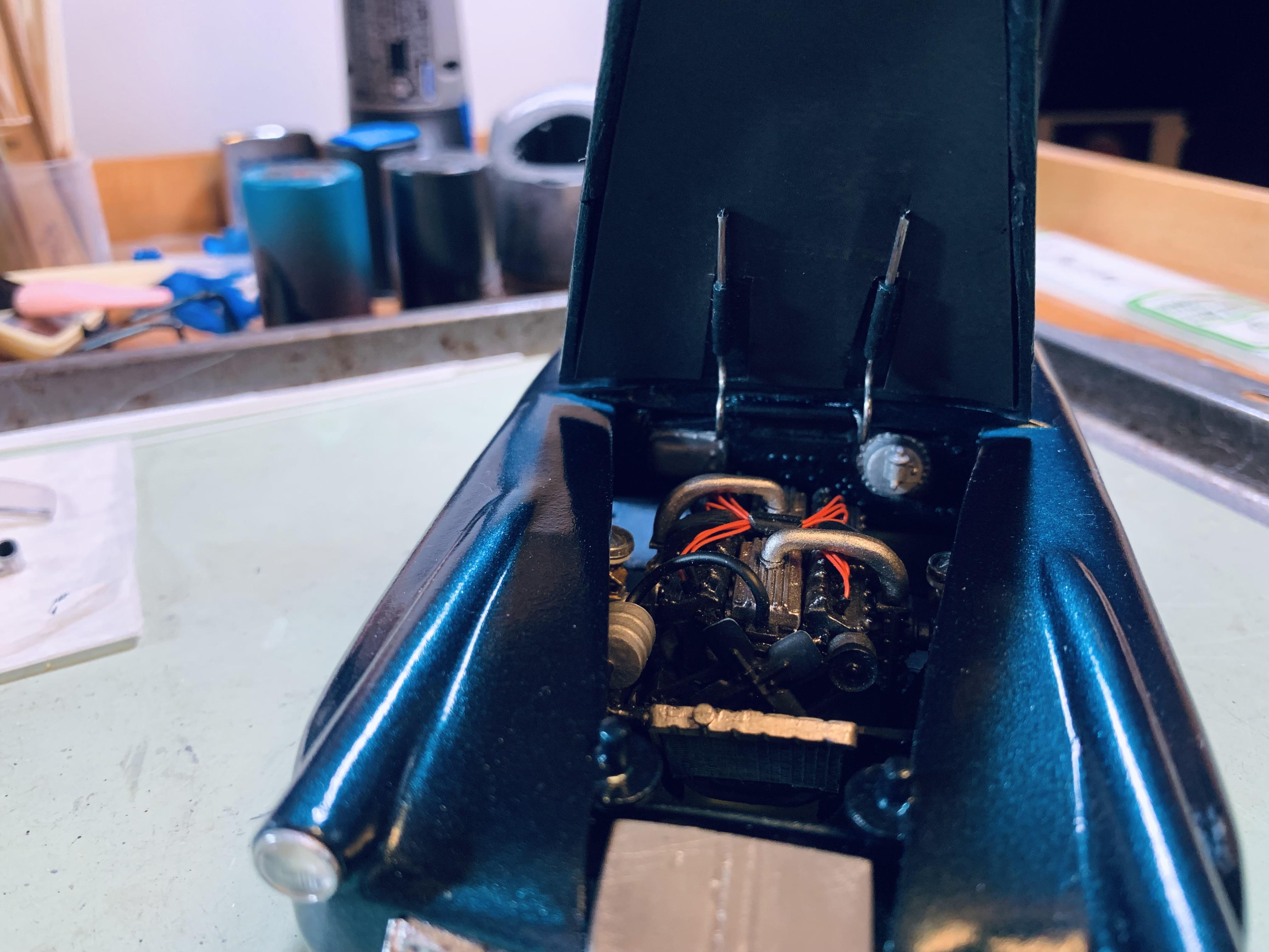

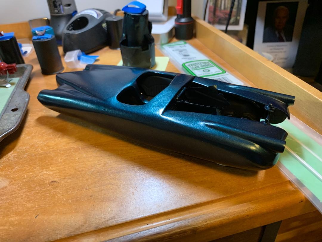

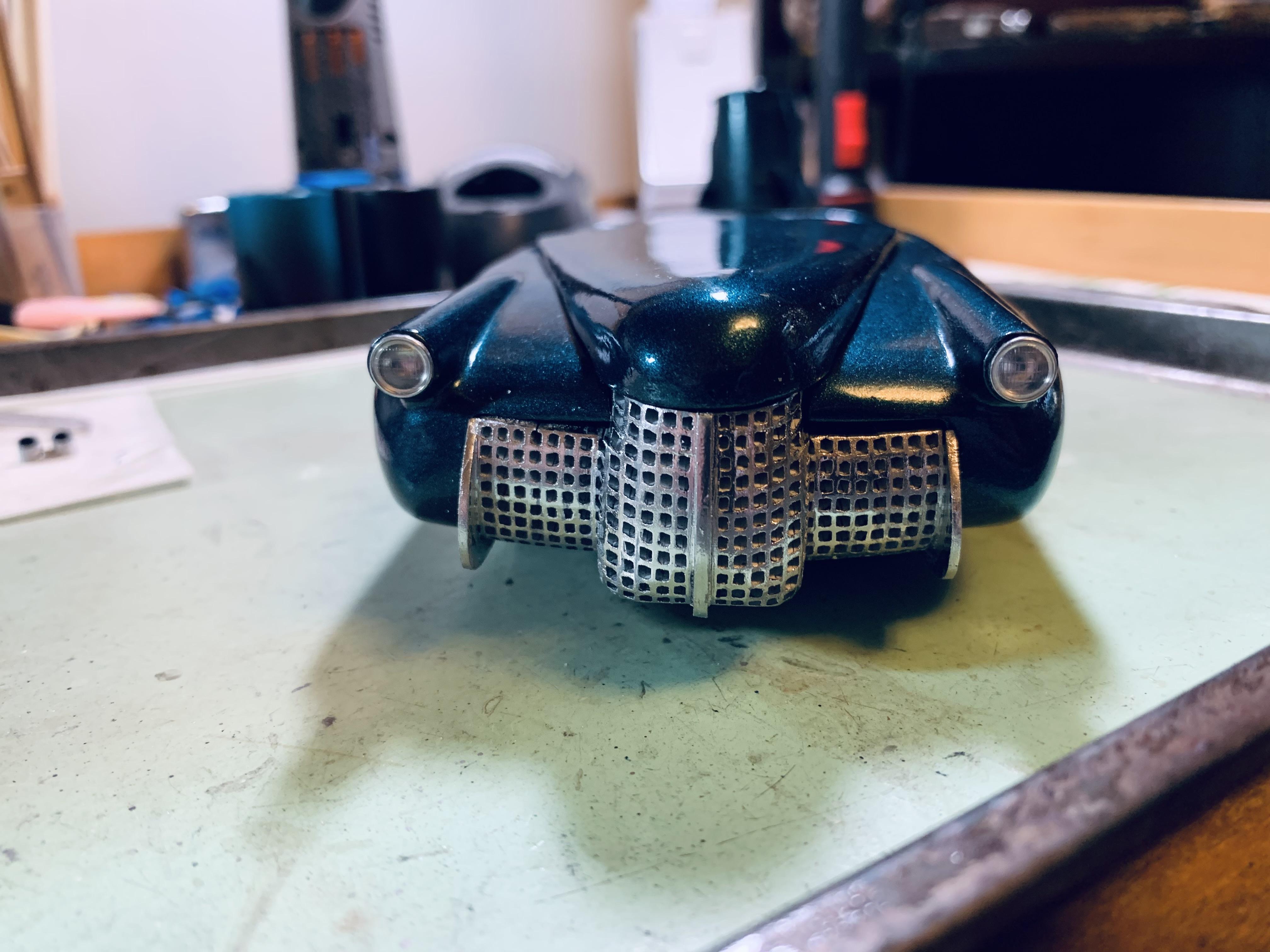

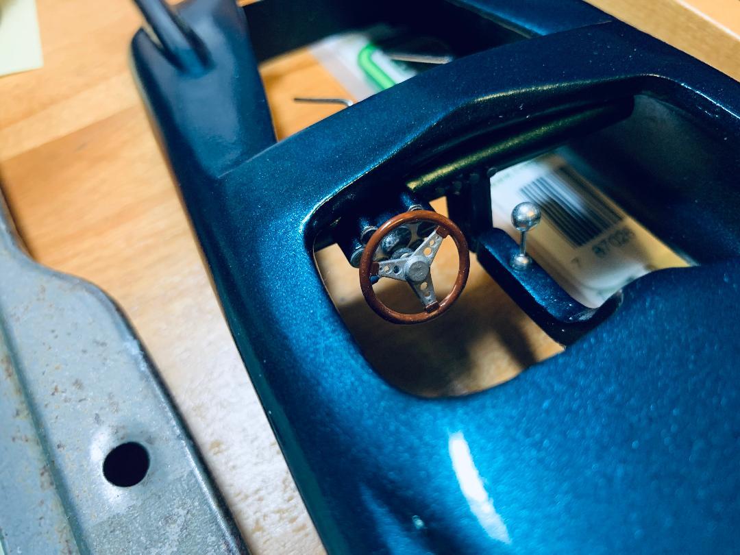

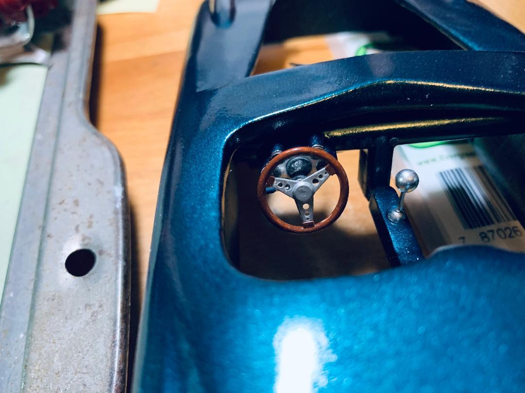

It's been awhile, but I'm still working on it. I finally got a decent coat of paint on the hood, with clear coat. The dashboard and steering wheel have been installed in the body- I test fitted the shifter just for jollies- the console is part of the dashboard and rests on the transmission hump and driveshaft tunnel. I had applied some Molotow to the grille, but a lot of sanding scratches appeared- I sanded everything again and have applied Molotow to one half. When it's dry, I will see if its smooth enough to continue. I filed down the outside of the headlight buckets creating a small lip, then filed a bit on the headlight openings so now I have a nice fit. A little chrome touch up and they will go in. The big project has been the 12 bumper blades- 3 each side, front and rear. I rough shaped 12 pieces, then tried gluing a stack using Elmer's white glue, in order to sand everything to the final contour. Unfortunately, the glue didn't hold, so parts of the stack would come apart. However, I was able to get to the point where I could soak everything apart and do the final shaping using the best piece as a guide. In my stash I located 2 bumper guards of unknown origin. These were white glued together and 3 horizontal notches were filed into them for the bumper blades, then holes were drilled for the brass rod which will be covered with aluminum tube and mounted to the body. I also want to check out finger nail decorating tape, which seems to be available in 0.5mm width, and maybe even narrower. I want to try this for some chrome accent strips as well as door and panel lines.

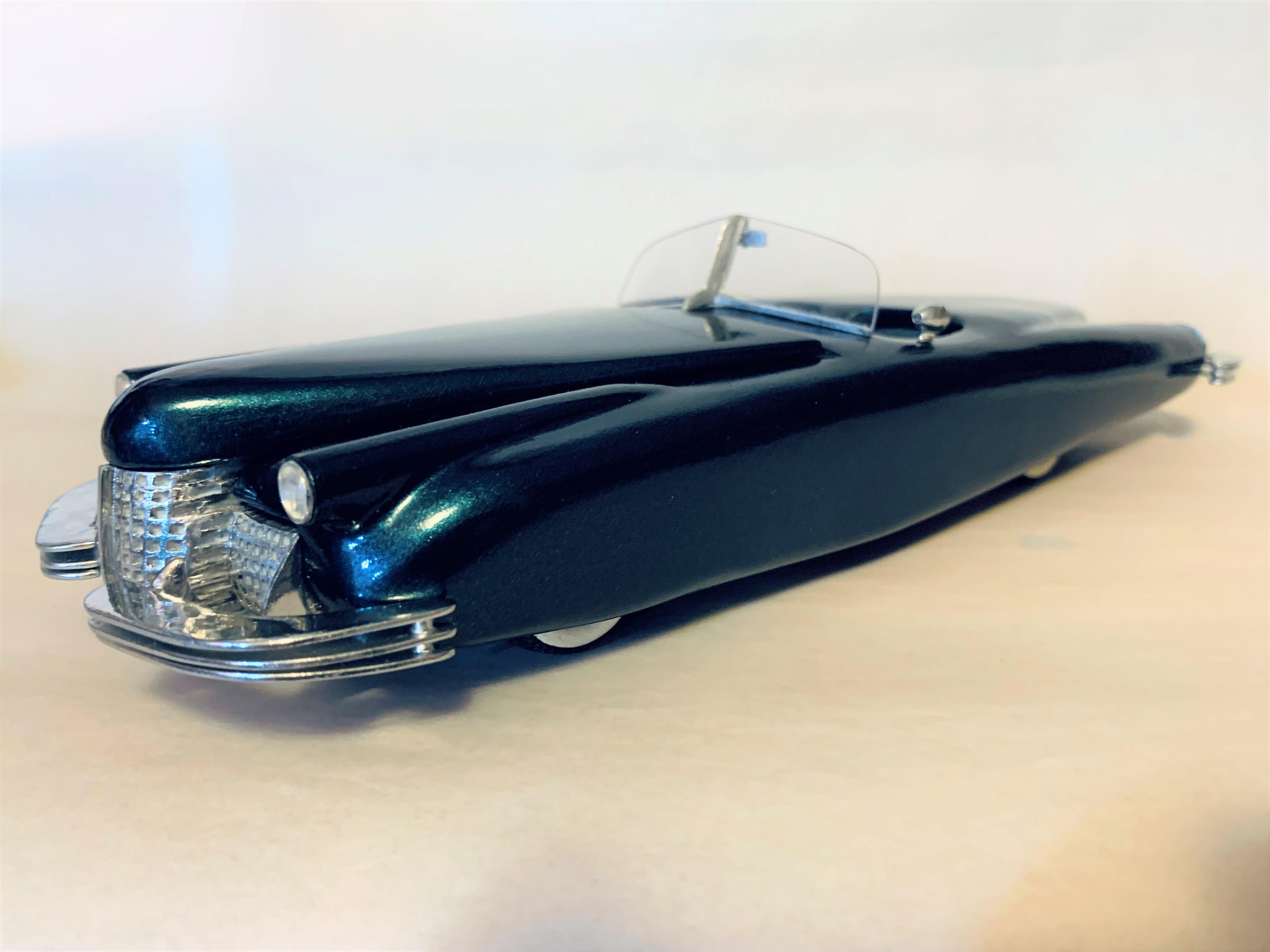

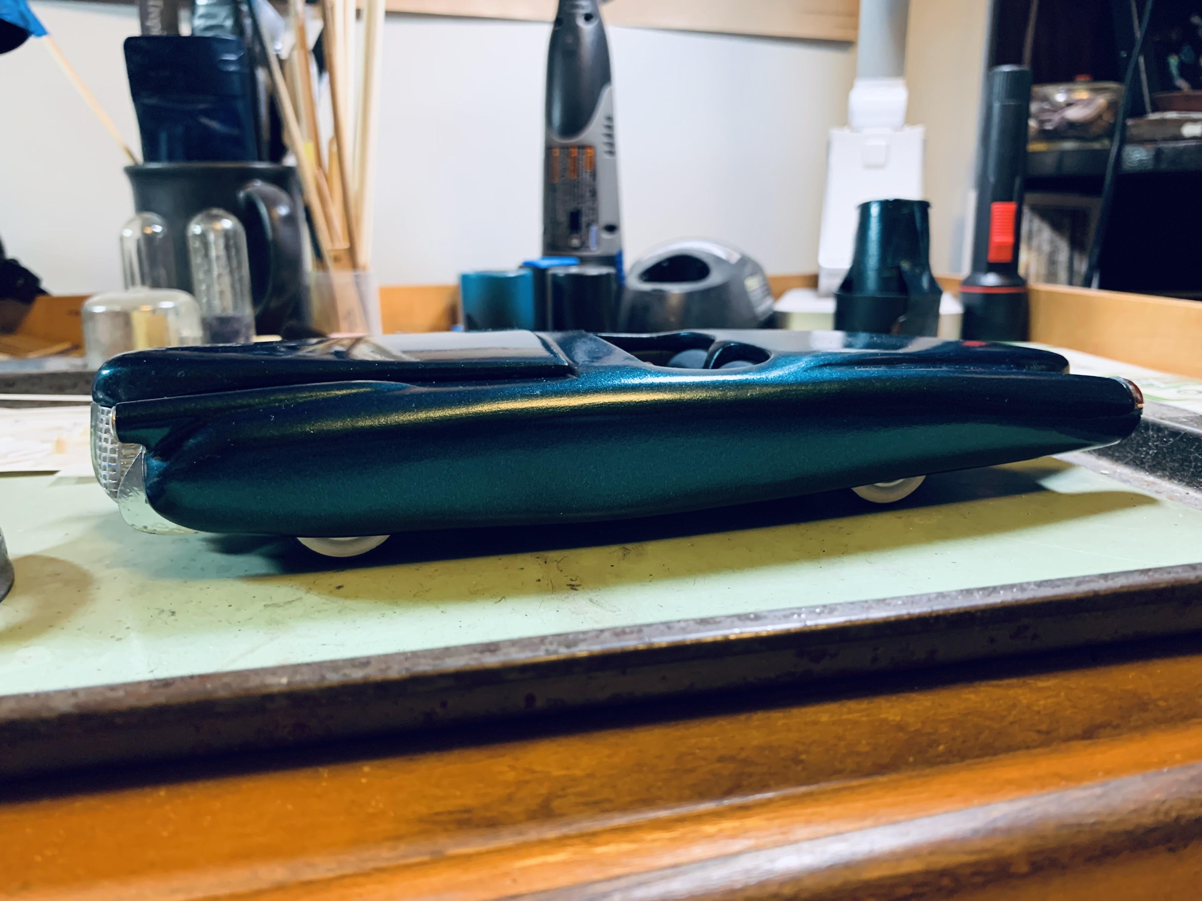

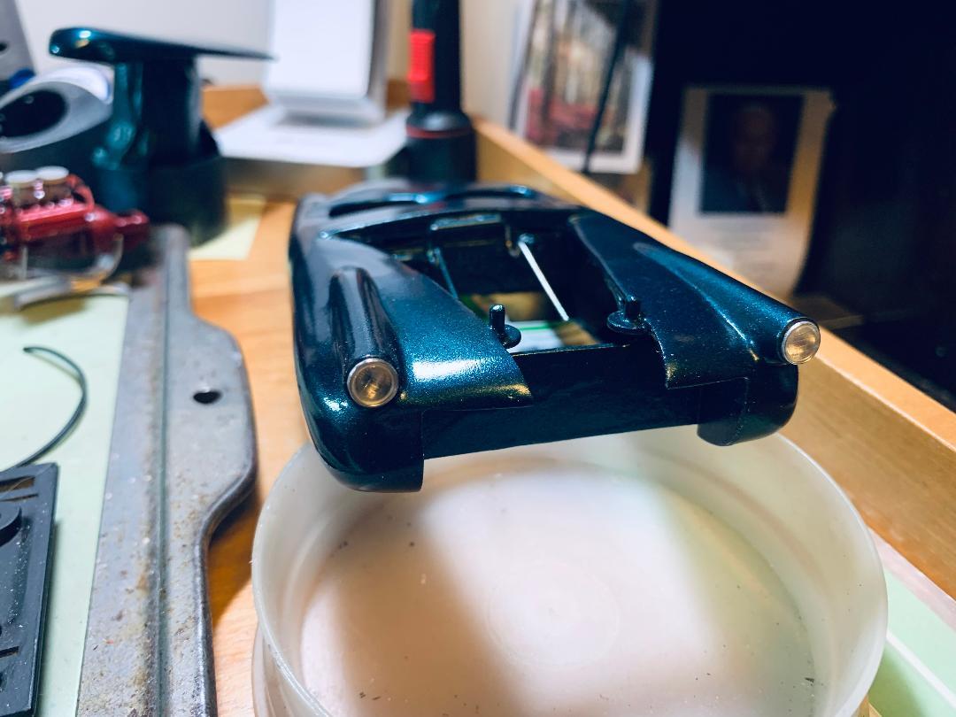

Doing some assembly work and also working on the bumpers. Found some adhesive foil in the odds and ends box, cut it into narrow strips, wrapped the edges of the tail lights, and glued them in with clear gloss. Also installed the grille and hood, and mounted the body to the chassis/interior assembly. Getting to be the home stretch- bumpers, rear view mirror, windshield, and license plate, and the Hurricane Typhoon will be complete!

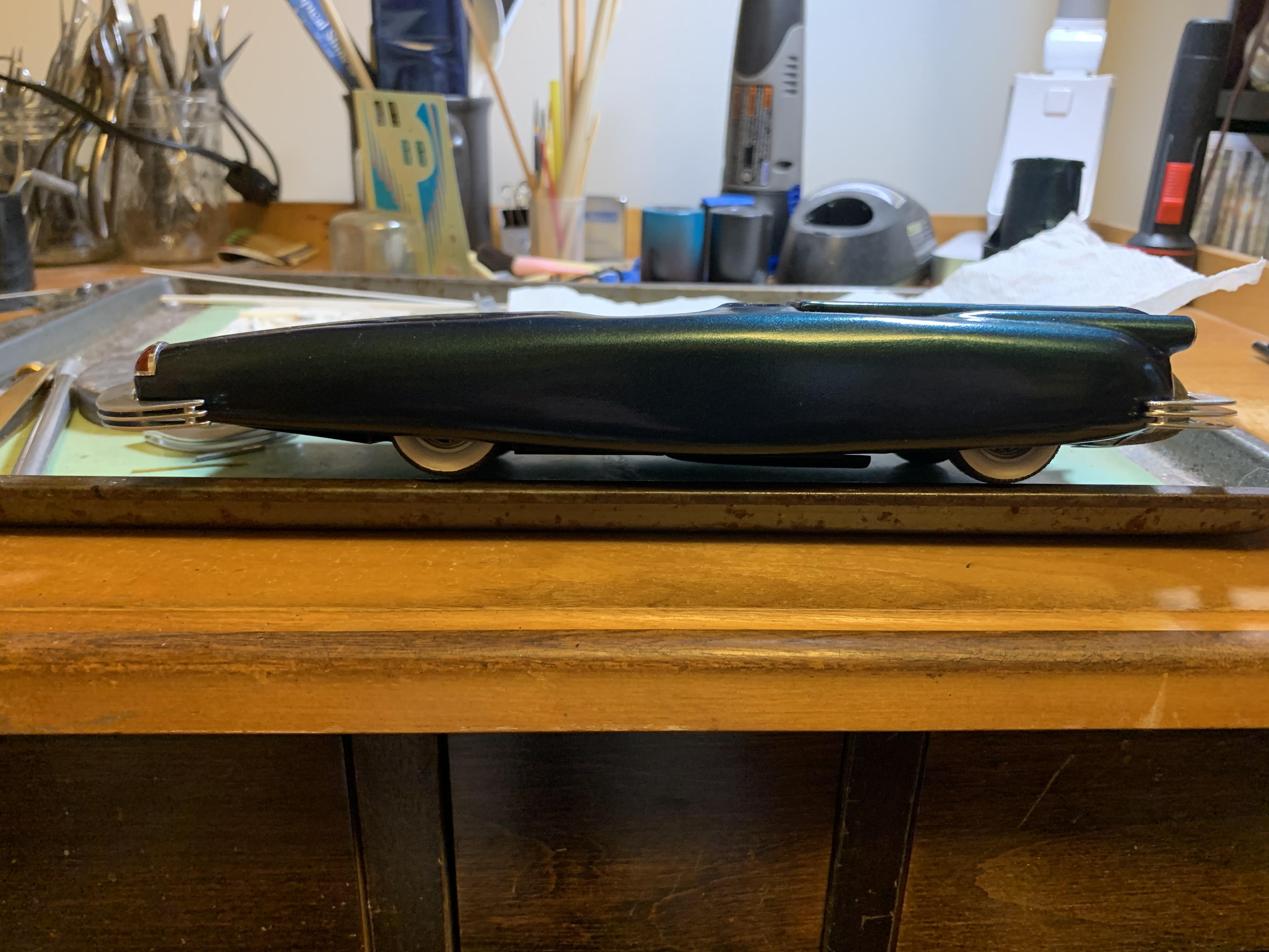

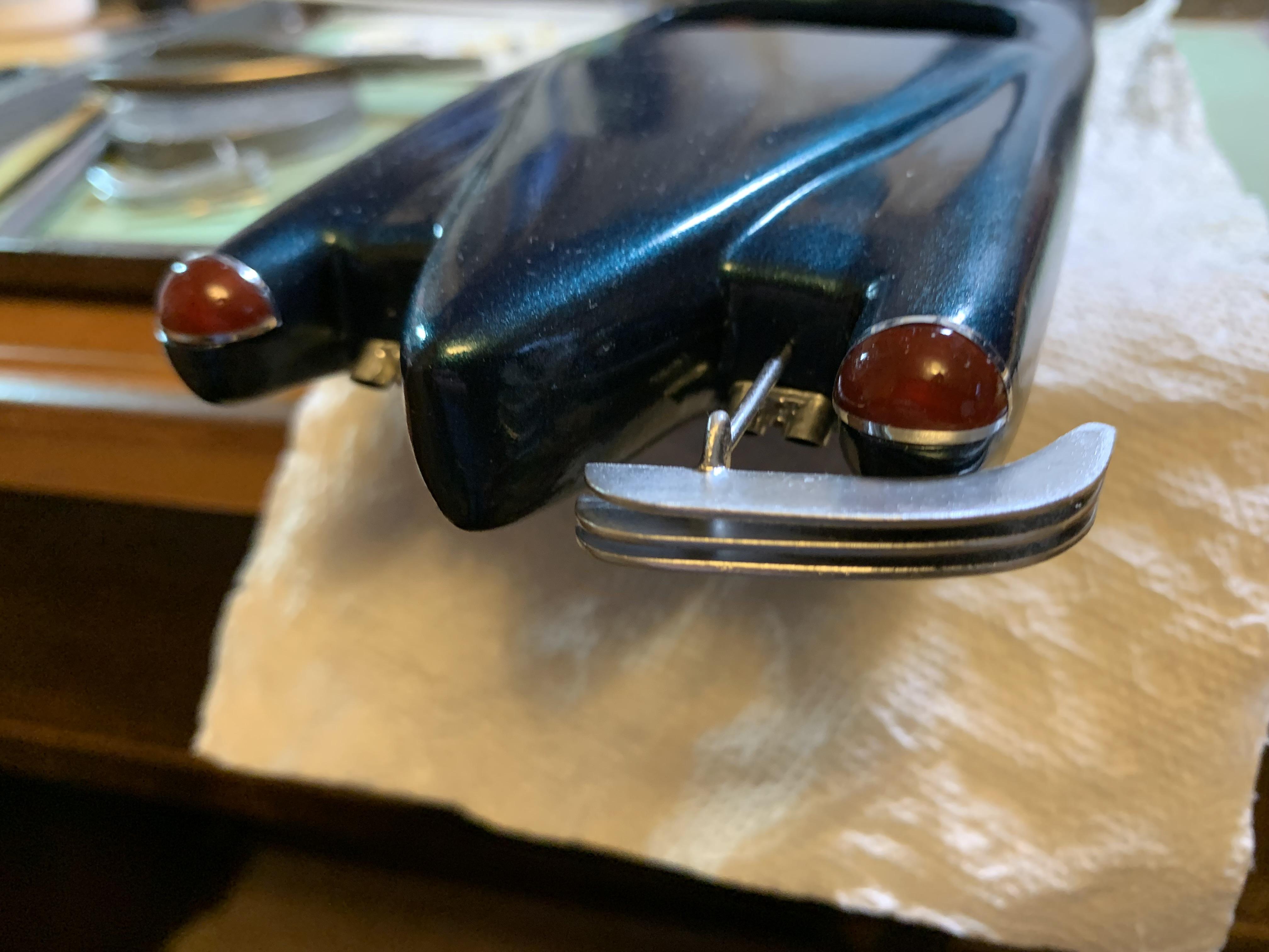

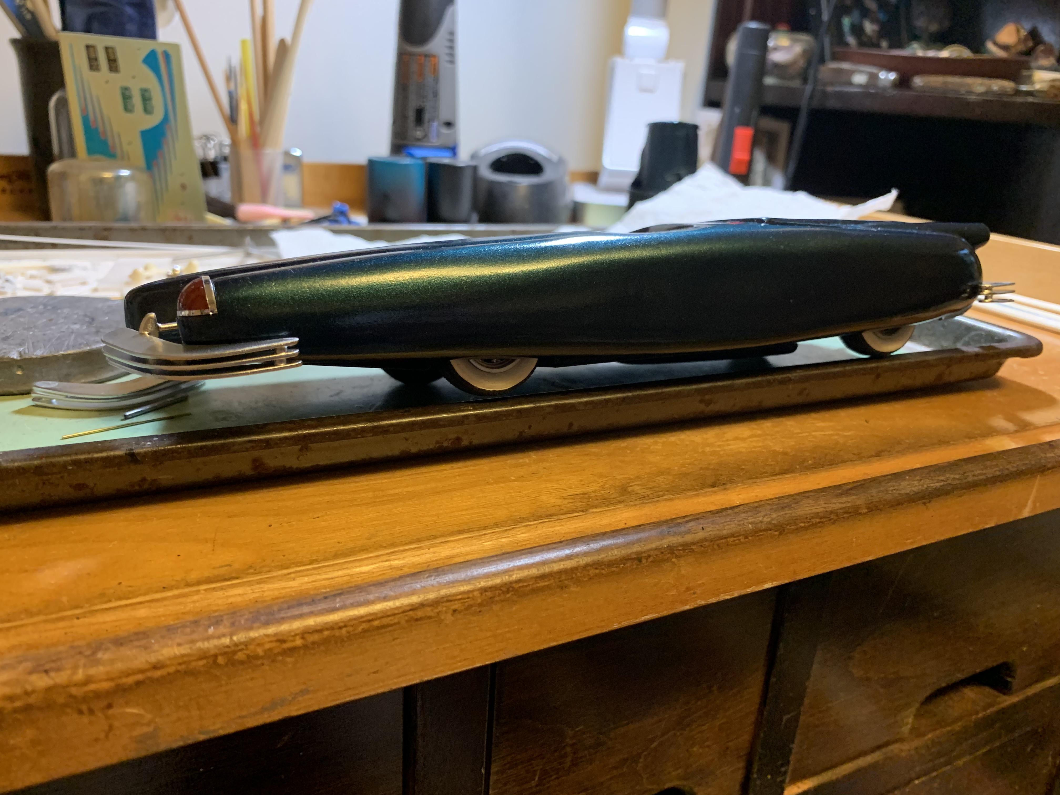

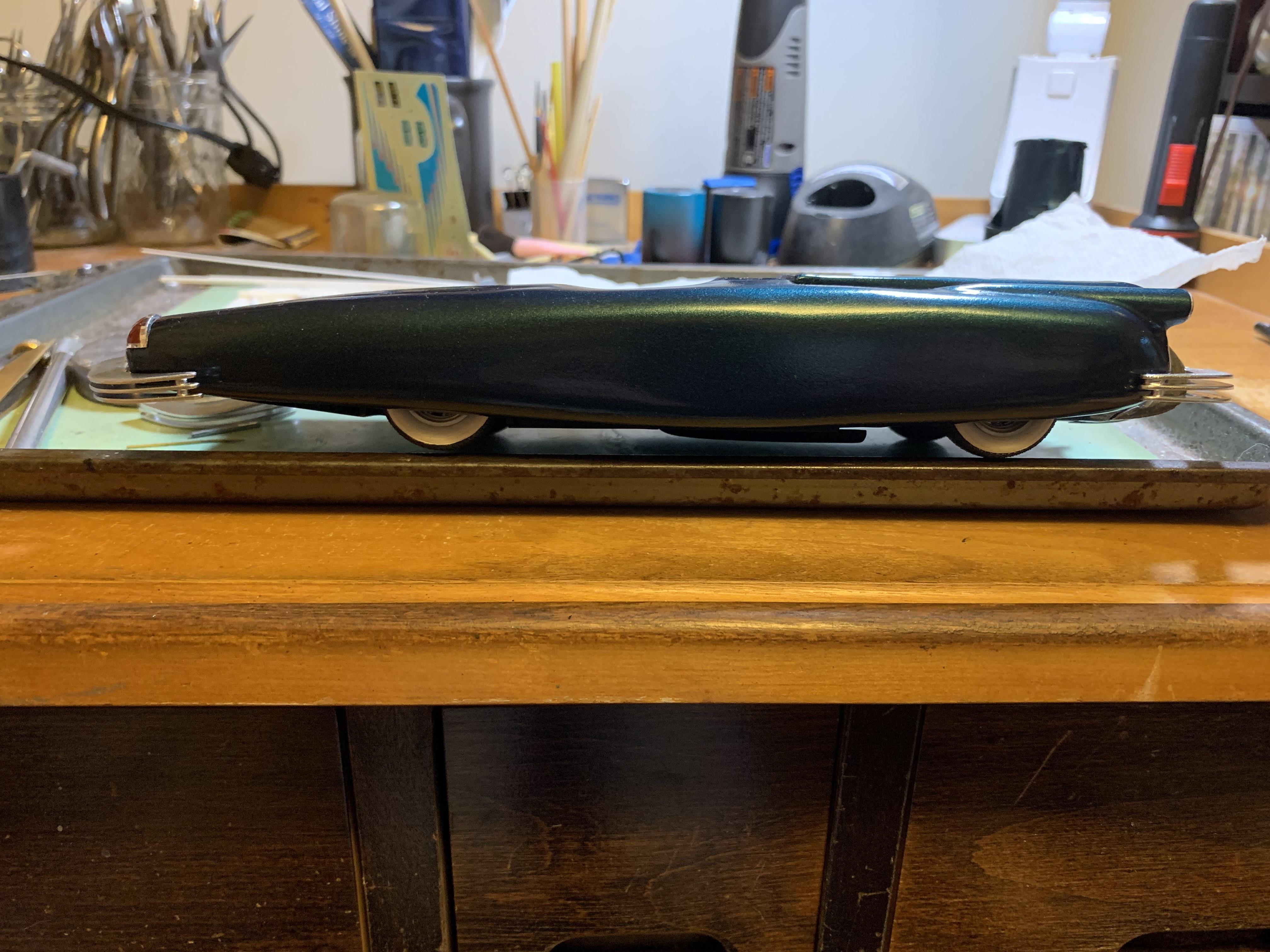

Preliminary bumper mock up- one rear bumper fell apart, tried to get a wet coat of paint on, went on too thick and ran, need to sand and re-paint once the paint is completely dry. Will be adjusting to hopefully snug the rear bumpers closer to the body. Let me know what you think!

I dunno, Paul, this looks like the "future" standing in 1939- maybe the New York World's Fair. Preston Tucker saw this.  He scratched his head and then put his hand to his chin....?
The egg crate grille reminds me of a 46 Lincoln. The bumpers fall squarely in the late Deco Era when it started to move into the early "Jet Age". Certainty no later than 1949
I wonder how that V16 would look in a '29 roadster.....?
