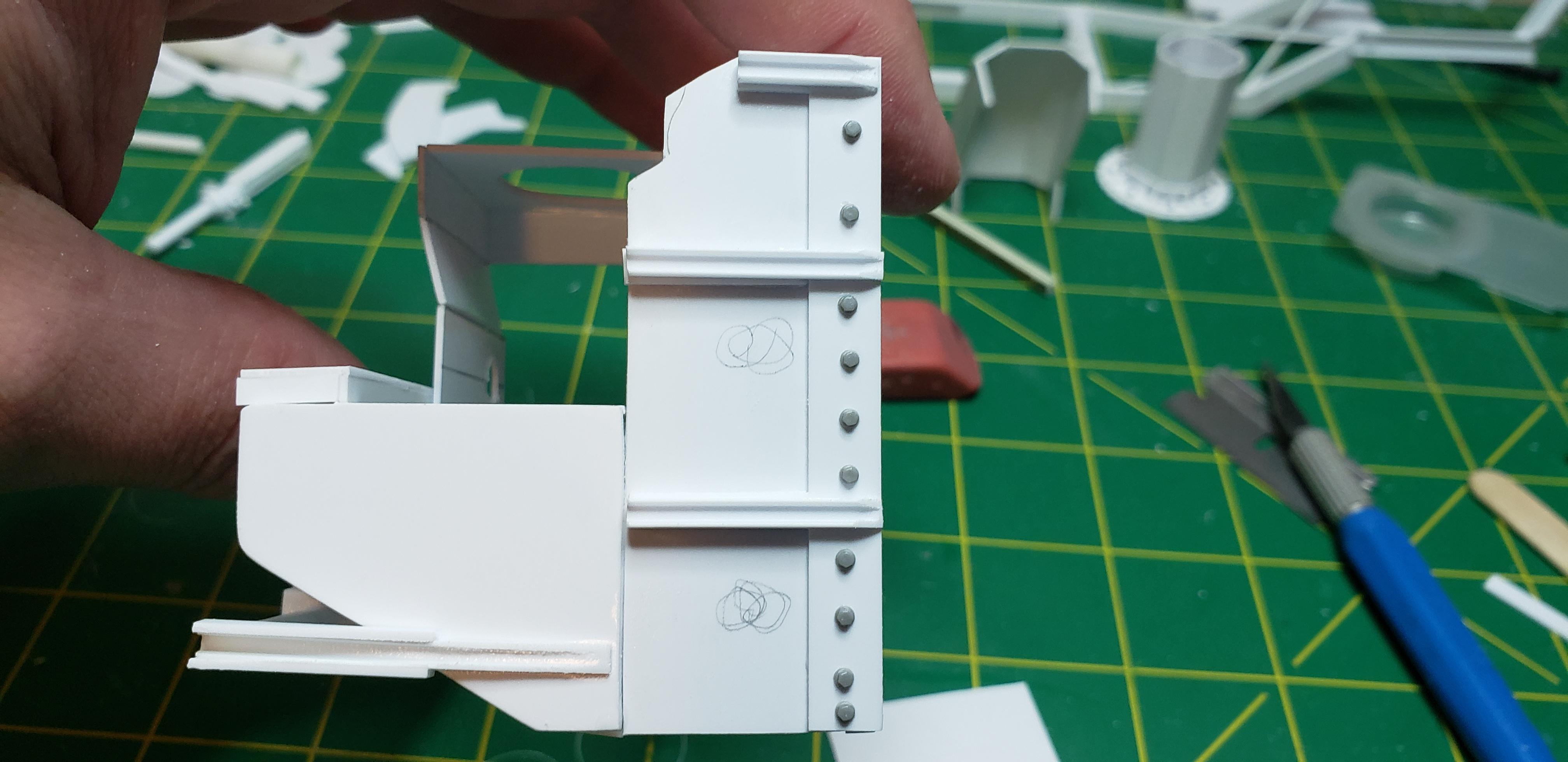

gotnitro? Posted December 8, 2020 Author Posted December 8, 2020 Thanks , the state brought the truck back from summer storage and getting it prepped for duty again . I took a few more detail photos I was lacking for the hitch frame . The shear size of that unit doesn't show in pics, but the top of the auger box is 5 ft !!! Back to work

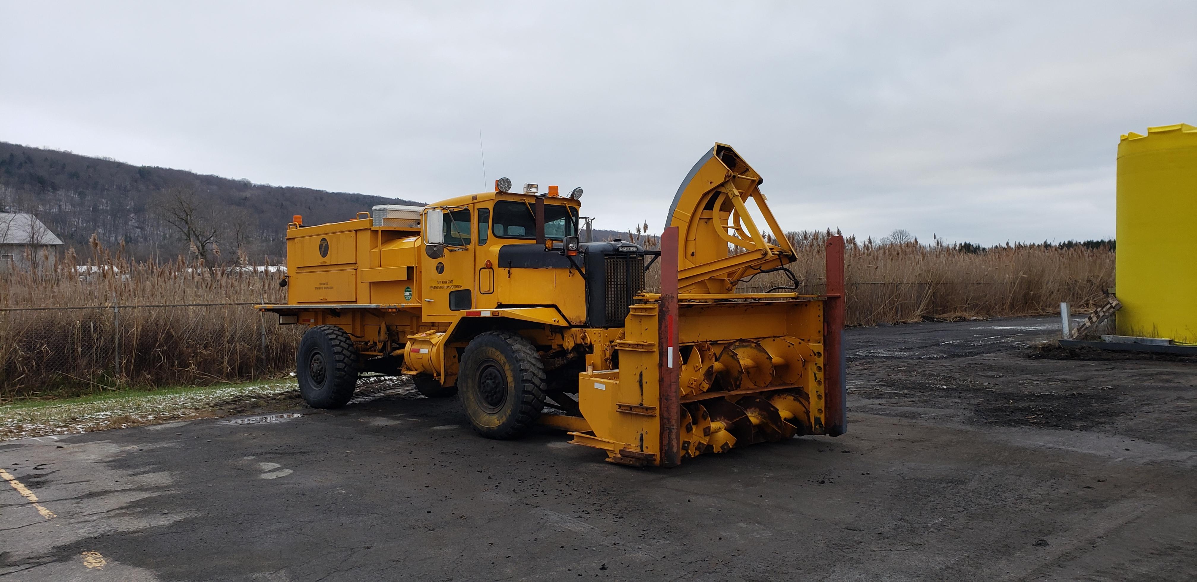

Chariots of Fire Posted December 8, 2020 Posted December 8, 2020 Great Photo! What are those primer colored plates on each side? Reinforcement of some kind?
Warren D Posted December 8, 2020 Posted December 8, 2020 56 minutes ago, Chariots of Fire said: Great Photo! What are those primer colored plates on each side? Reinforcement of some kind? I think they are bank cutters for deep drifts.

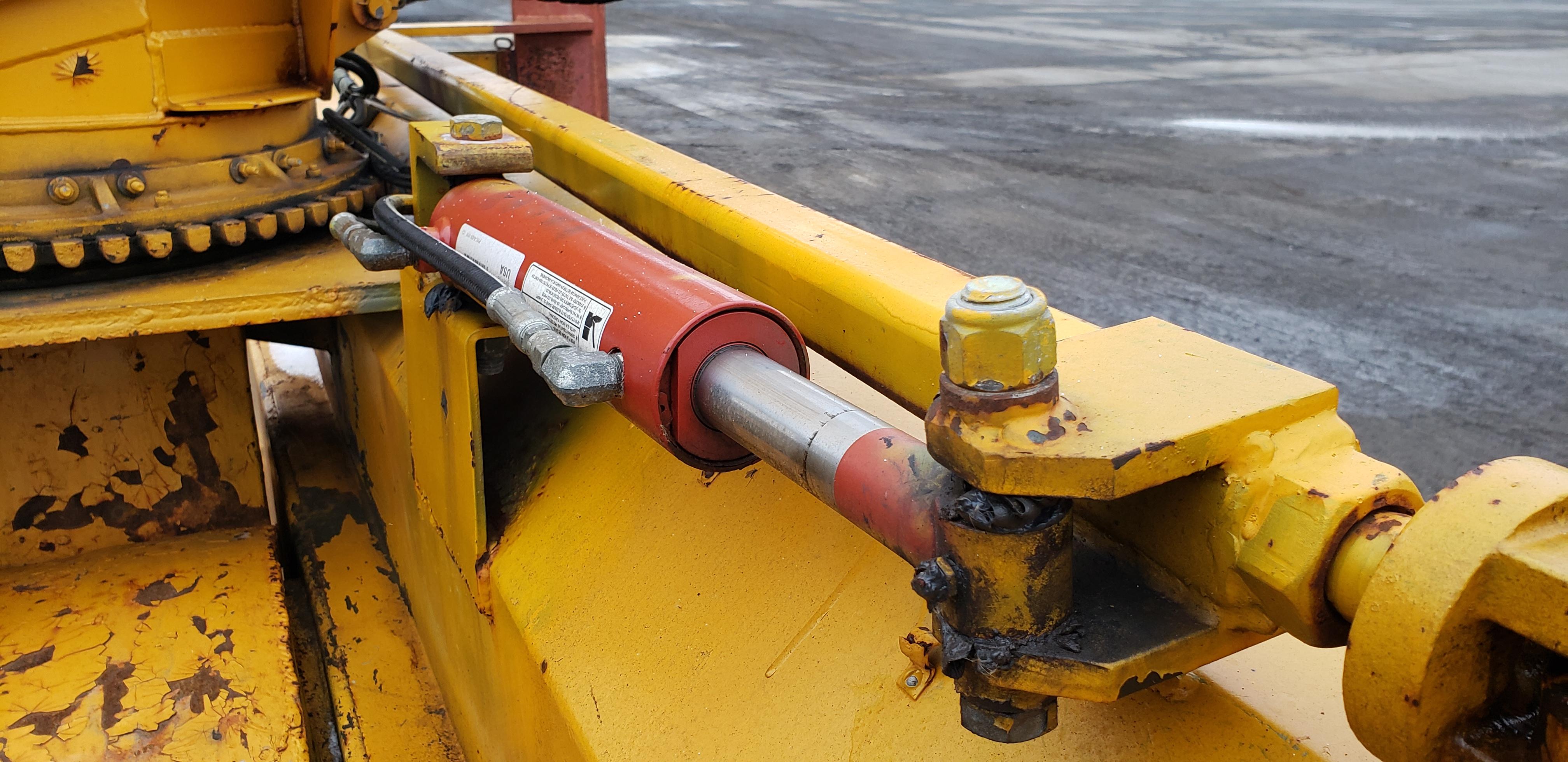

gotnitro? Posted December 9, 2020 Author Posted December 9, 2020 Probably right as to their purpose, there's a hydraulic cylinder on top that moves them to and fro. Being more of a " push pull " arrangement

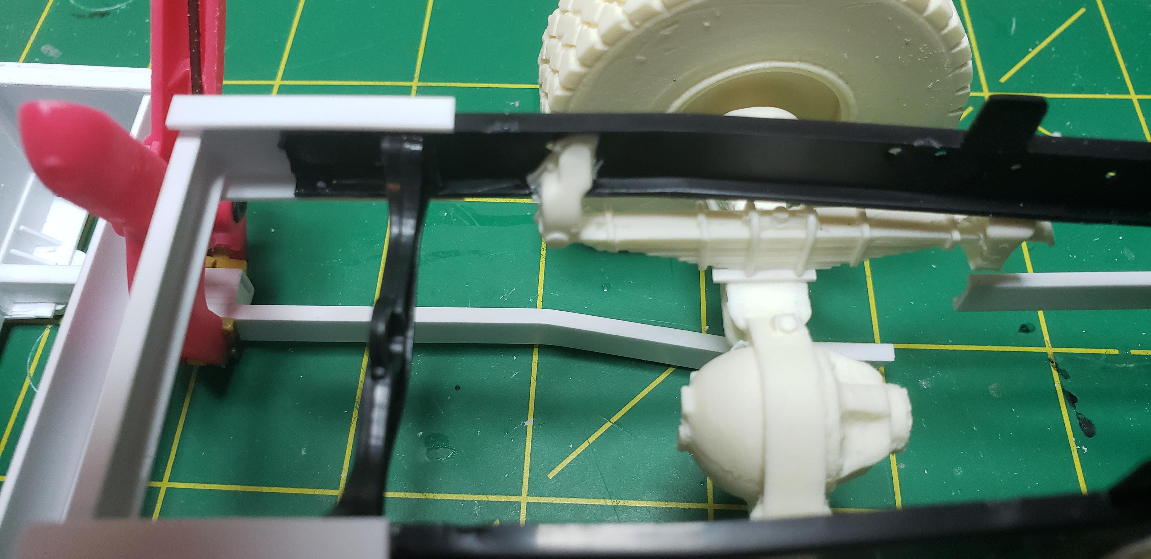

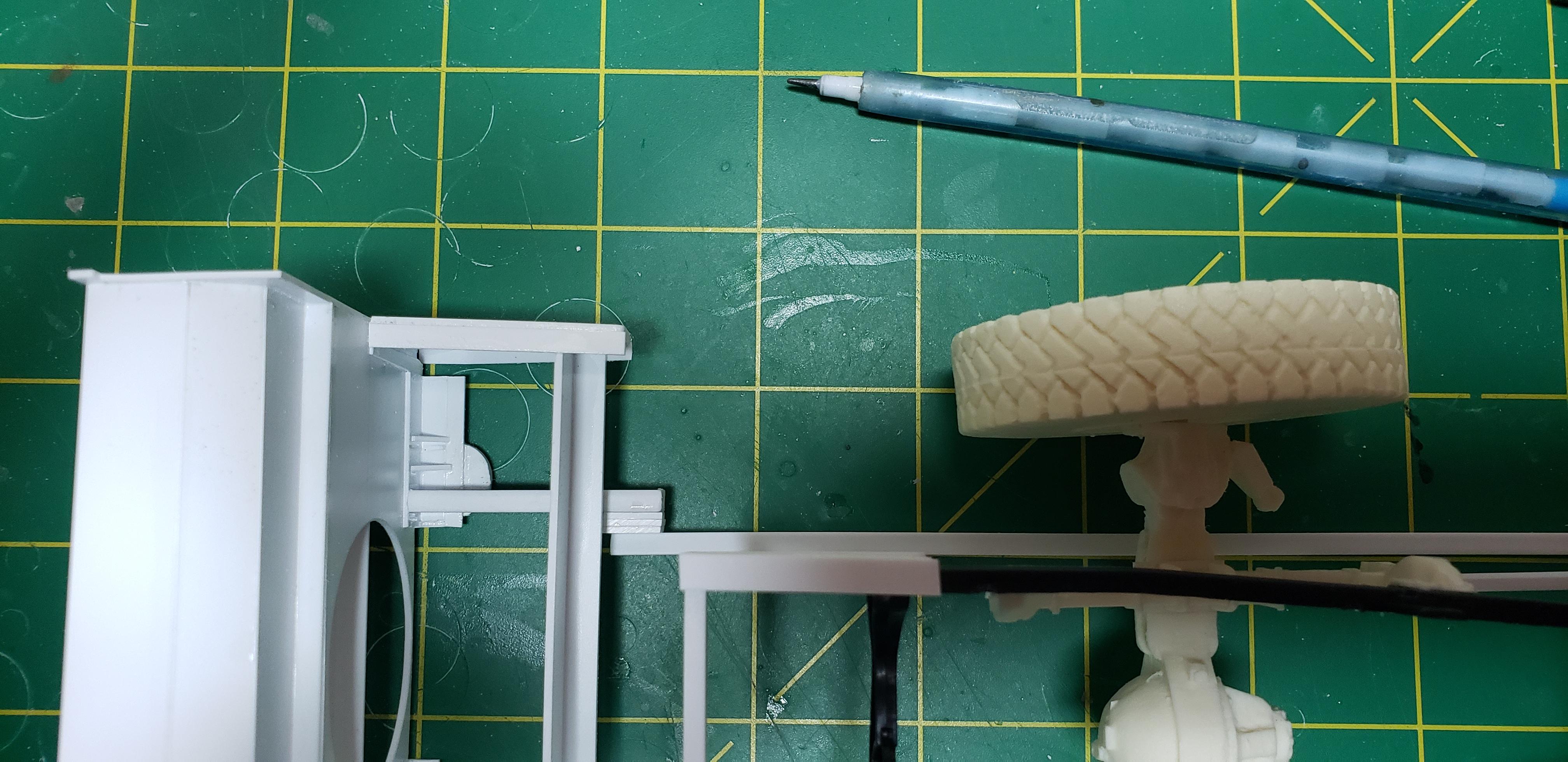

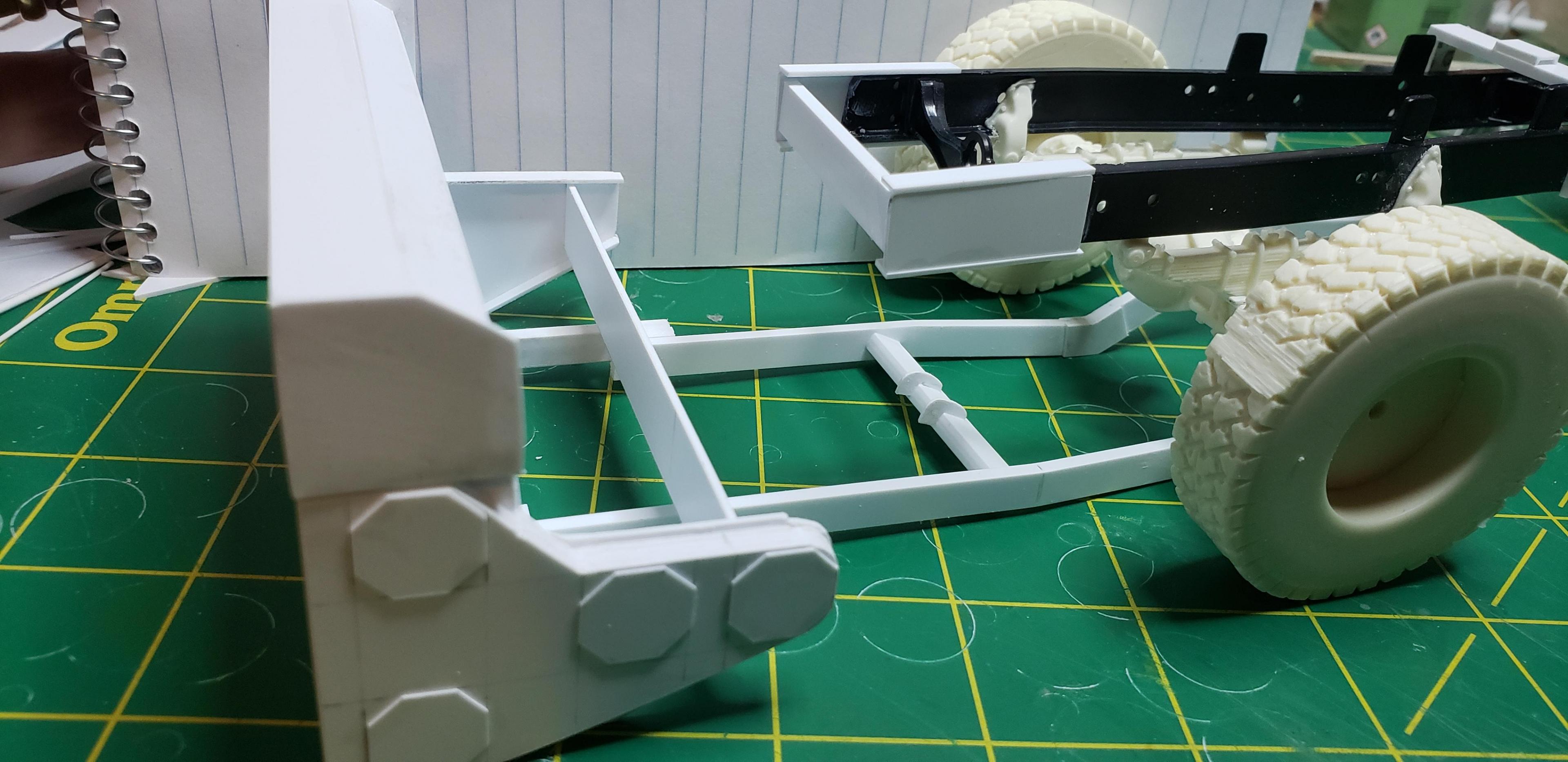

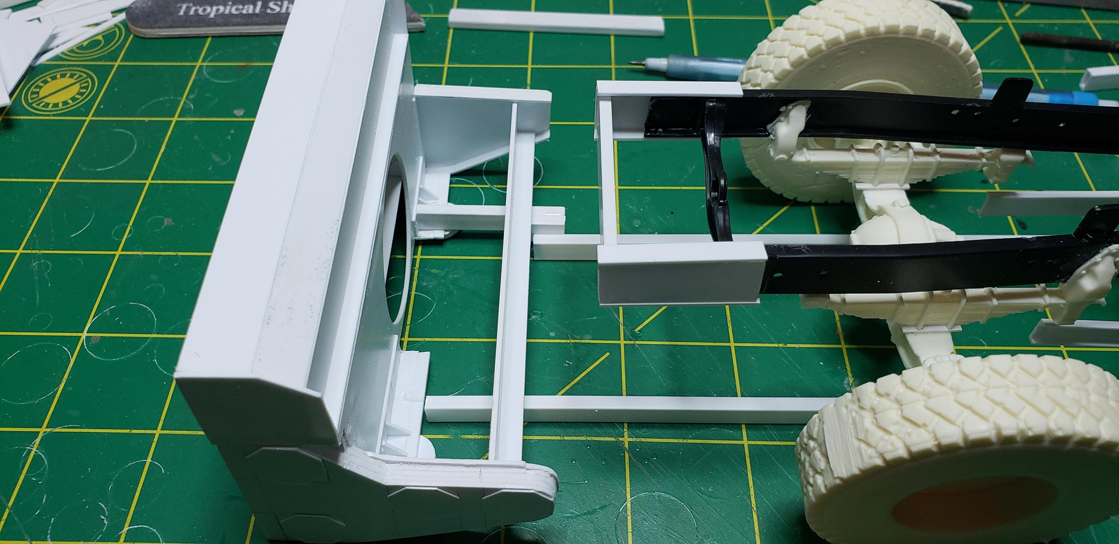

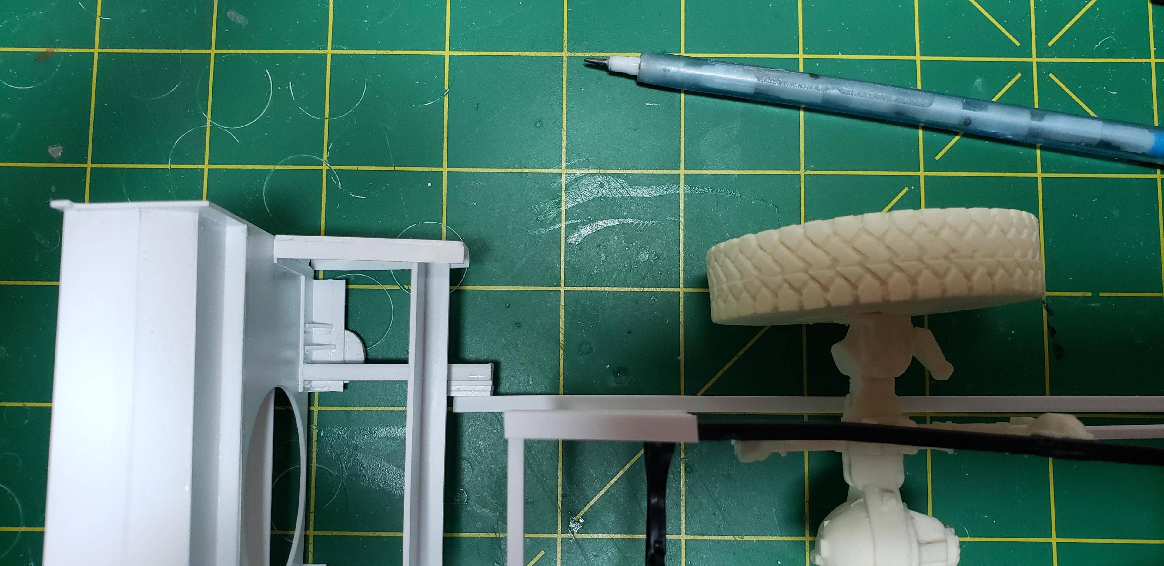

gotnitro? Posted December 11, 2020 Author Posted December 11, 2020 Thanks Gator glad to see ya around hope you've been doing well ! Decided to start laying out the framework that mounts this to the truck chassis. Luck was on my side during last photo op, and showed a large spacer pack shifting frame over around impeller drum . Then it happened...mocking up the tubing that runs under truck showed an issue . The Mack frames bow out in front...where Oshkosh is straight framed . This will cause the frame to be much wider than planned , but only way . I'll shim the belly frame out so everything lines up properly when attached to blower . Theres a vertical strut mounted to bumper welded to hitch frame rail that'll tie it together..

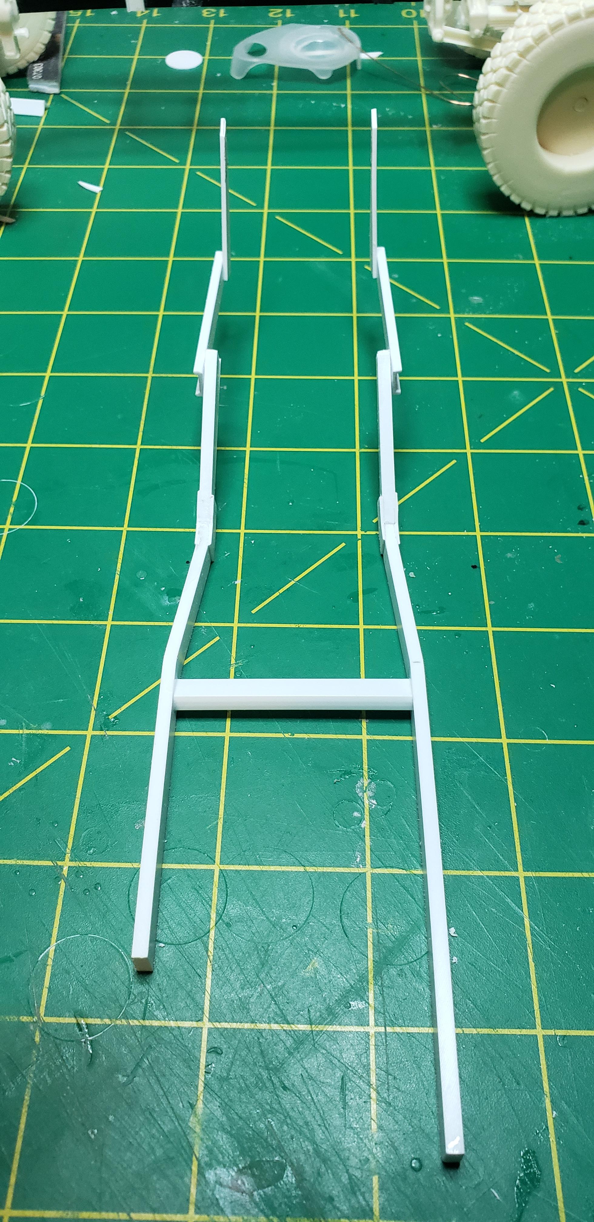

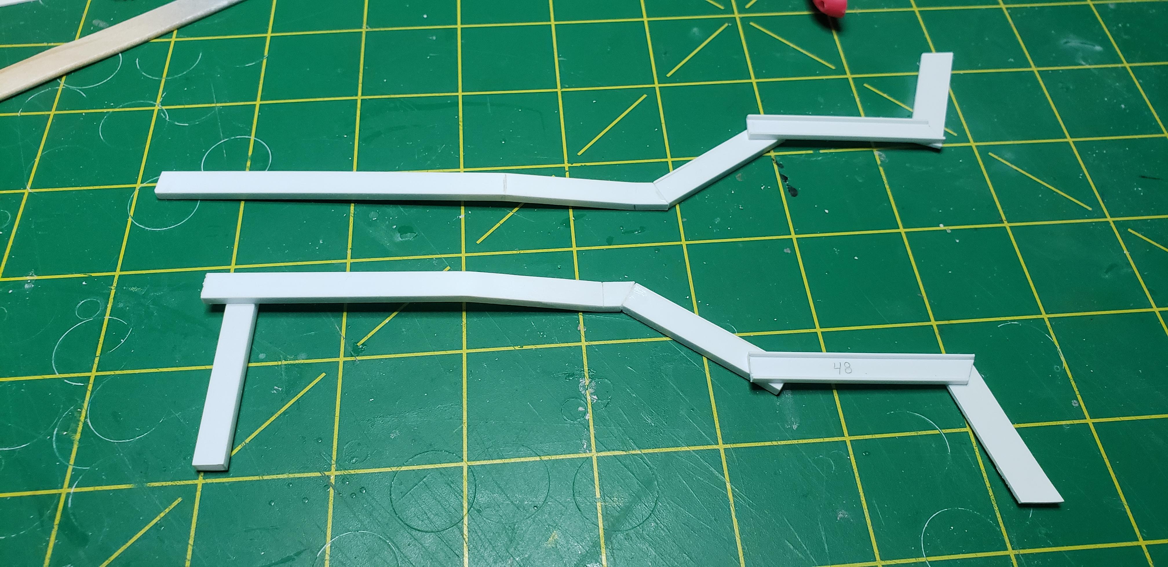

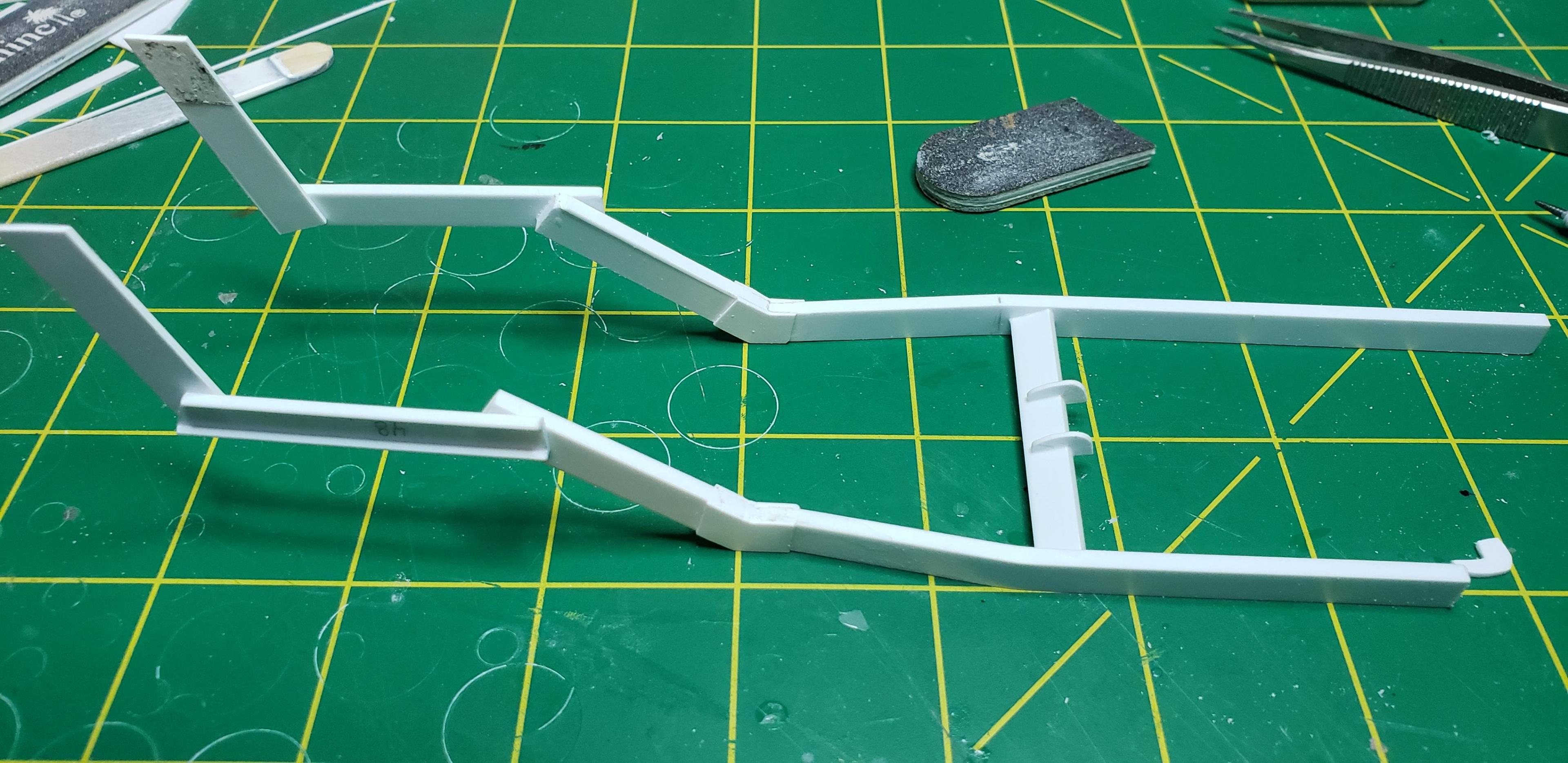

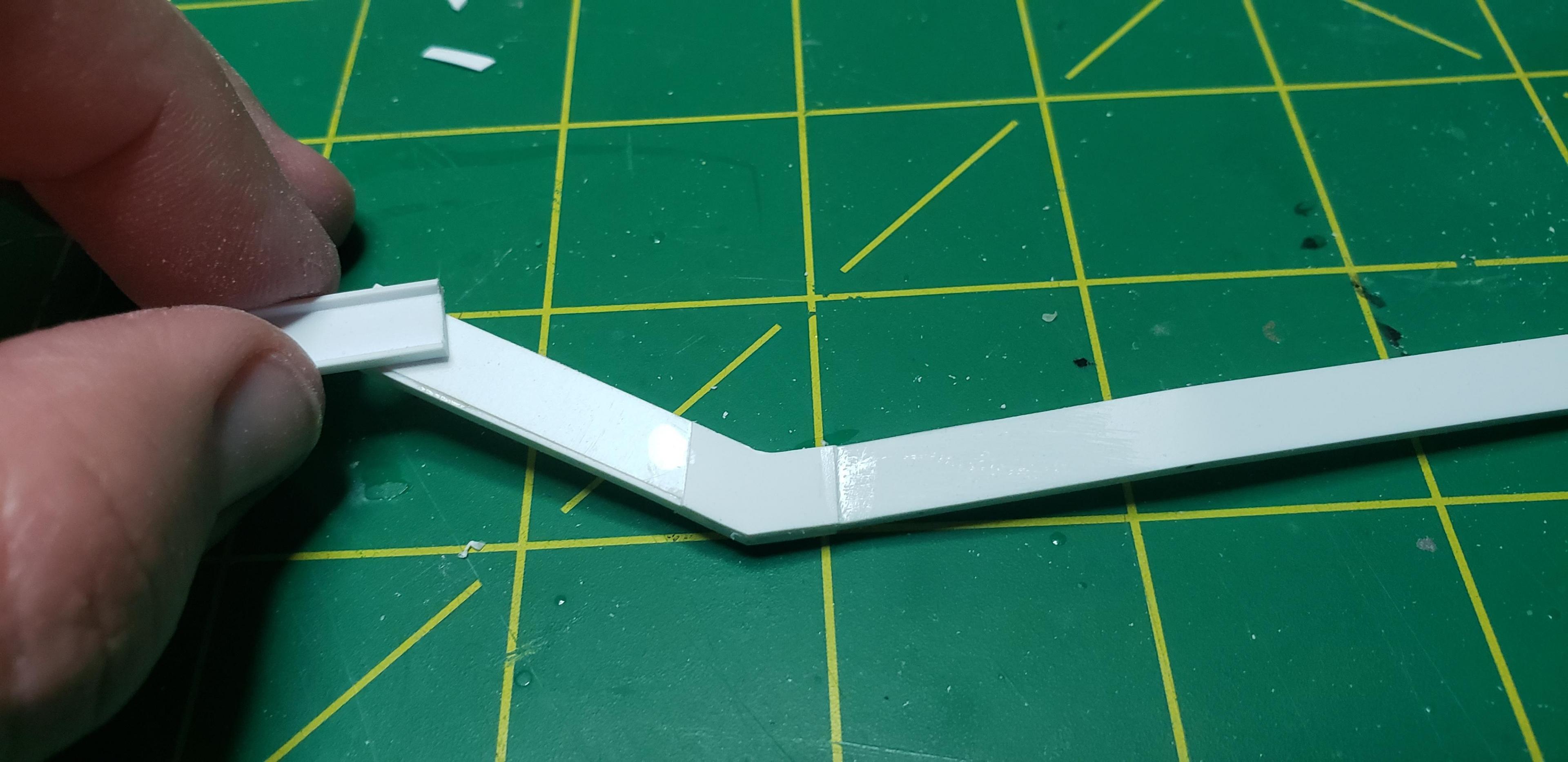

gotnitro? Posted December 13, 2020 Author Posted December 13, 2020 On 12/11/2020 at 10:44 PM, Mopar - D said: Glad you were able to catch the frame difference before you were further along. You’re doing some awesome scratch building here. Thanks ! I've wanted to build this piece of snow removal equipment for a few yrs . Its challenging but also teaching me valuable skills I decided the simplest way to approach the frame was to follow Mack's design and make mine bow also ! They already engineered it , why not borrow the idea. So using solid .100 x .250 rectangular stock, I slowly bent a bow into it approx behind the bumper. Then bend again to line up w mounts, and repeat!! I'm more than pleased w shape. One area concerned me where I attached the vertical mount to the horizontal rail. The glue joint was strong but decided to fishplate the joint . Here's the progress Fishplates The final frame before adding cross braces ..one side is much shorter , they shift the rail over to avoid the impeller drum. now for the bracing and hydr cylinder goodies

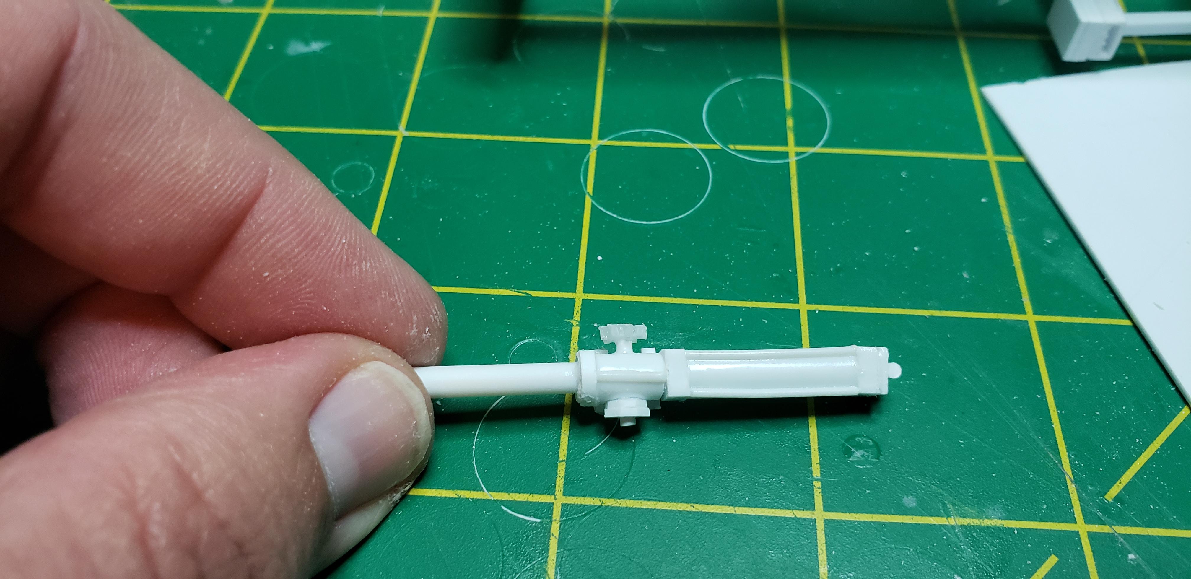

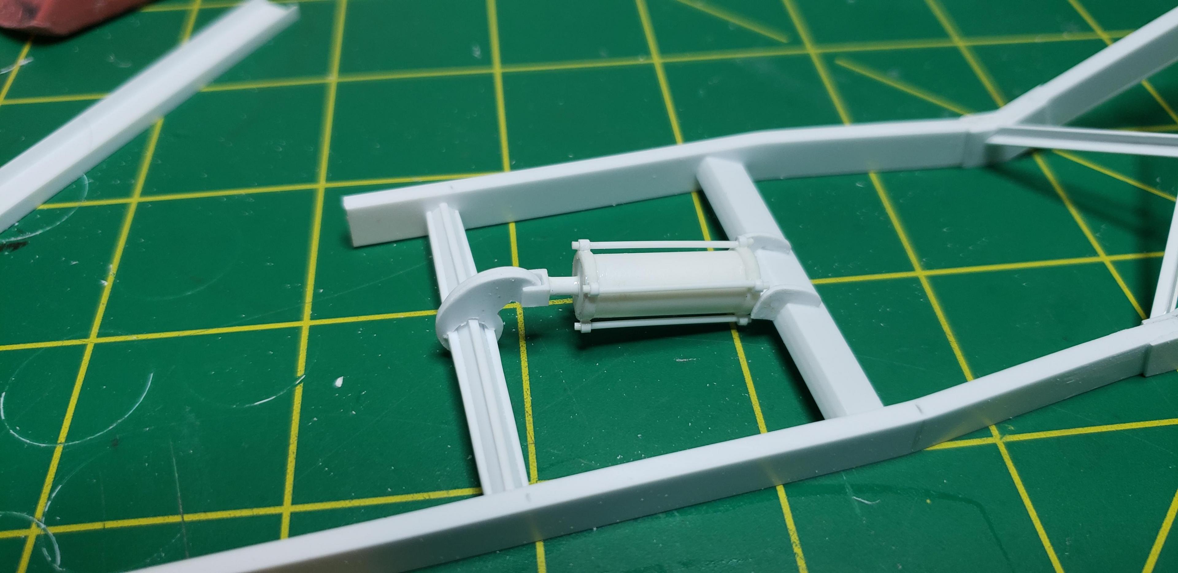

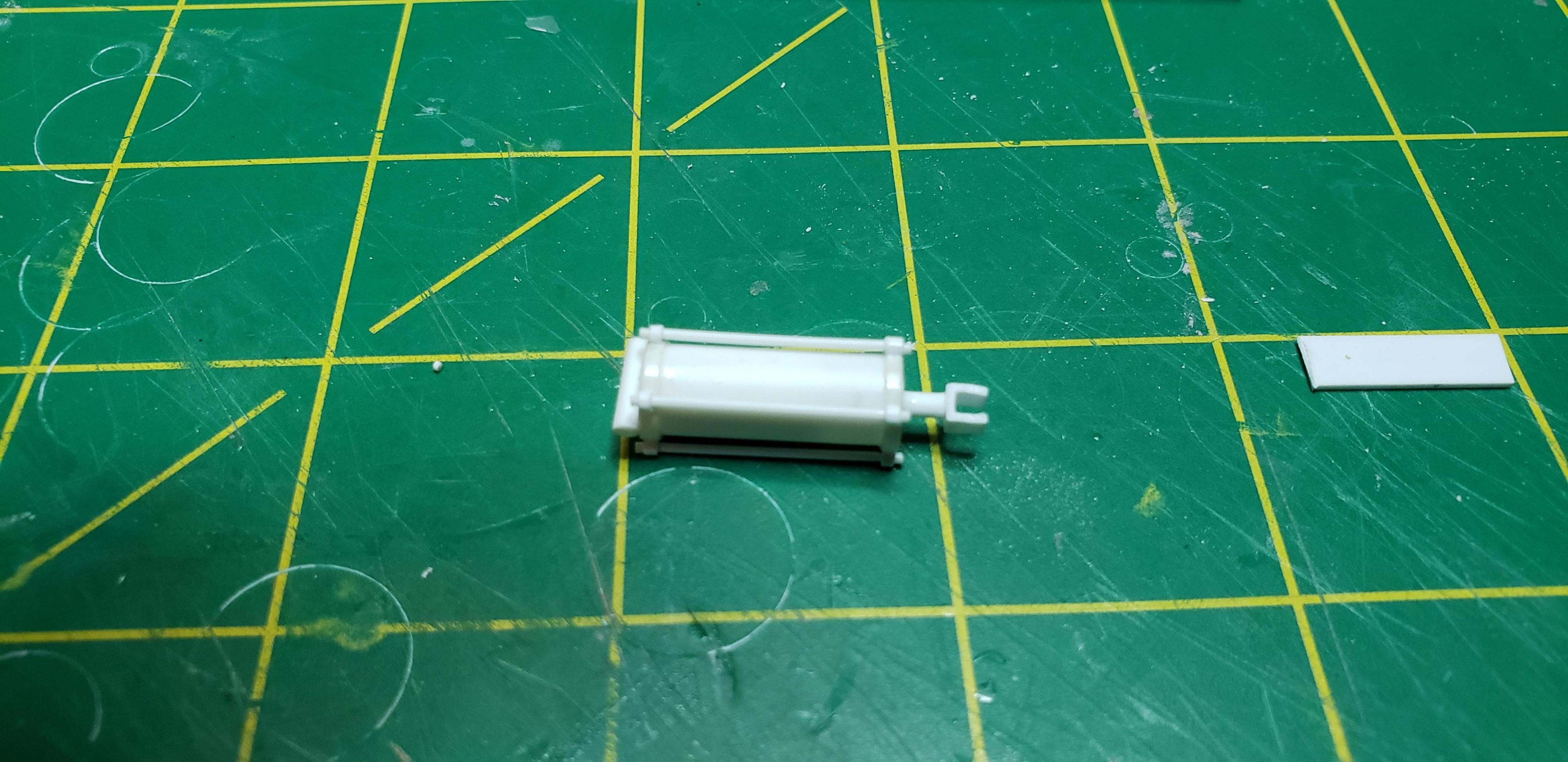

gotnitro? Posted December 14, 2020 Author Posted December 14, 2020 More work was done on the hitch frame , started the mounts for the hydraulic cylinder, built up a cylinder to lift the snowblower, and mocked the hitch frame up before installing cross braces This little cylinder took 2 hrs of work ...can't believe how many parts it took And under the truck Now a spider web of wiz bangs doodle bugs and thing a ma jigs . Ive gotta plan a few steps ahead or get myself painted into corner Thanks for following

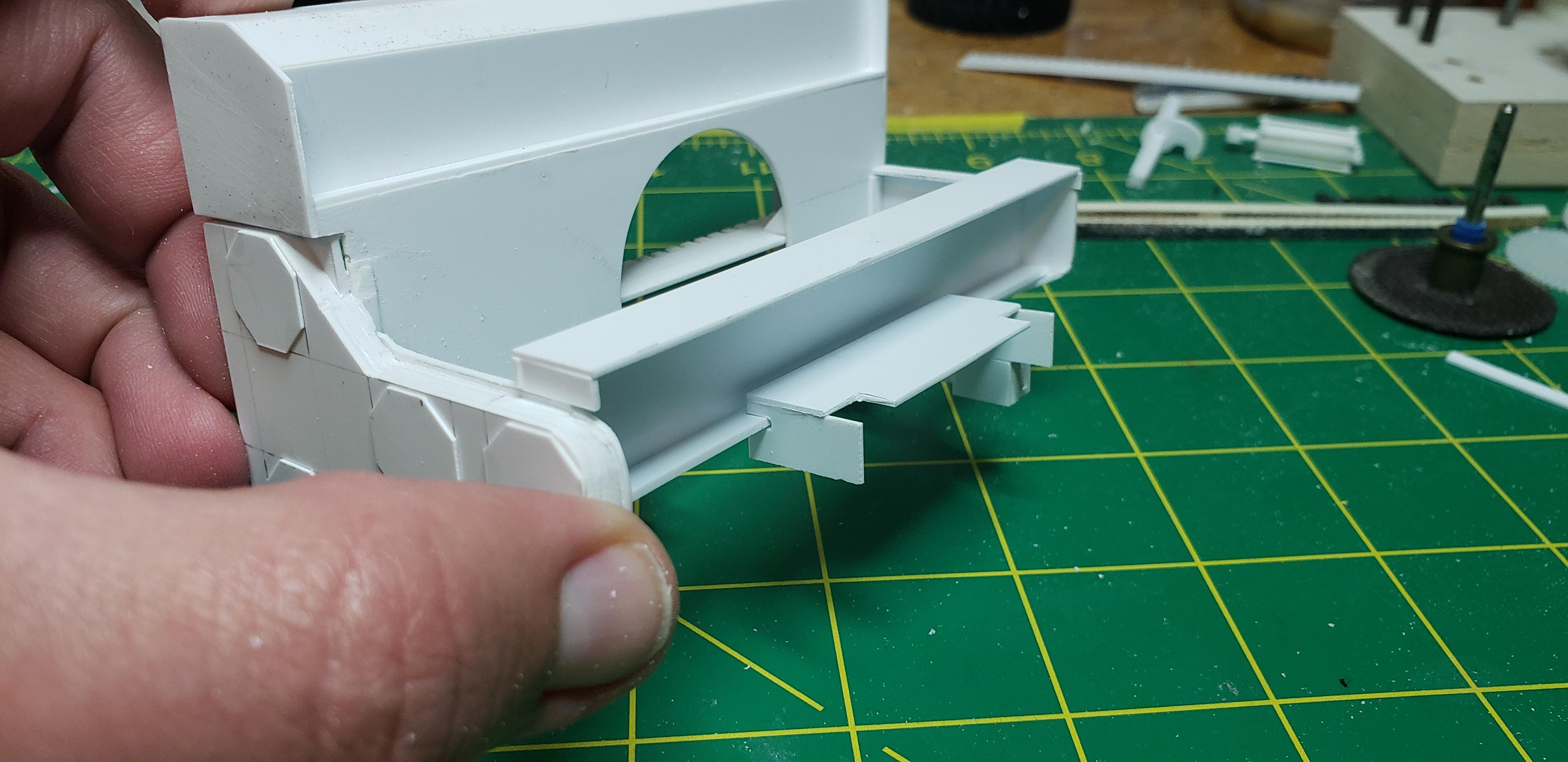

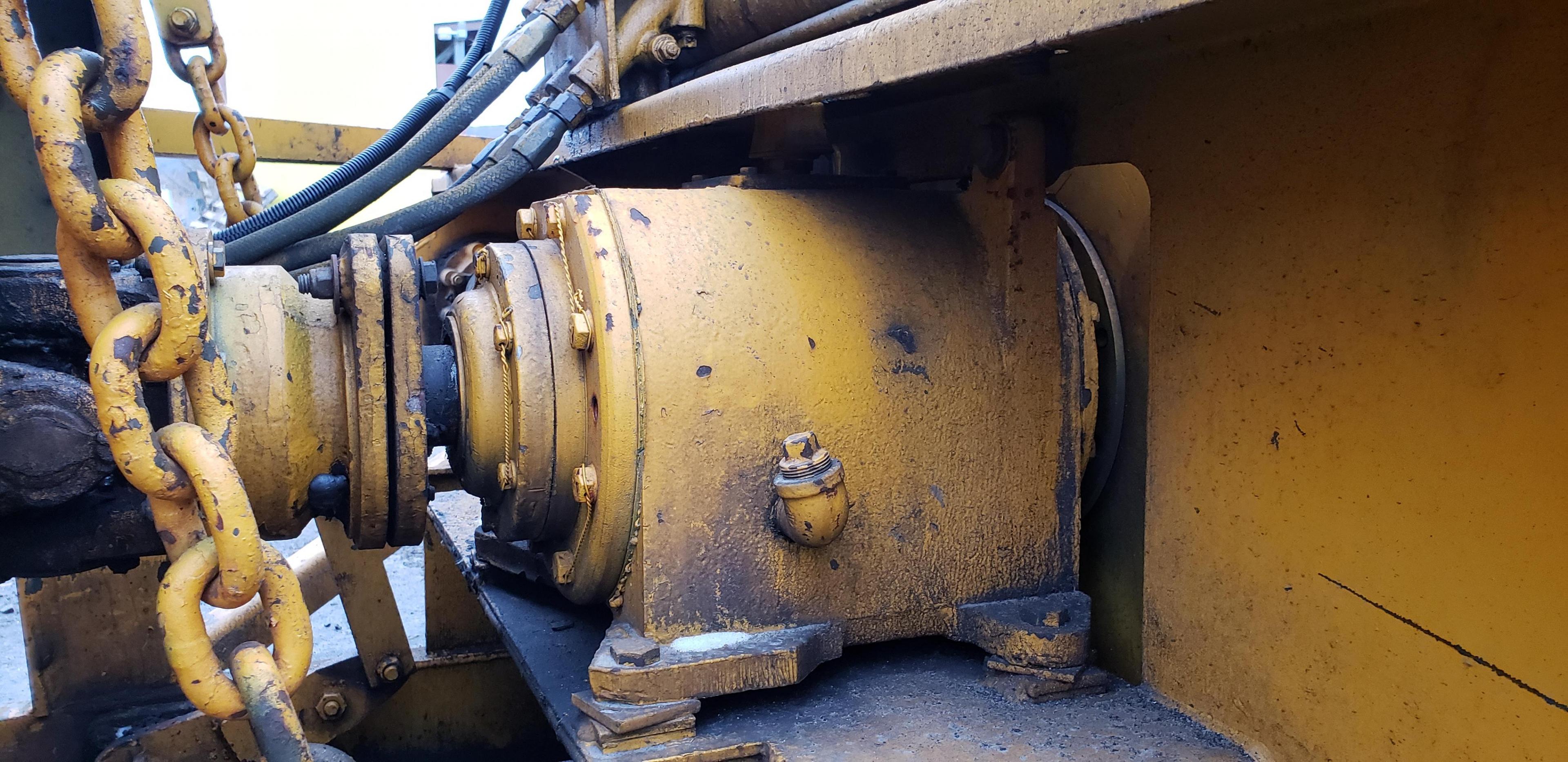

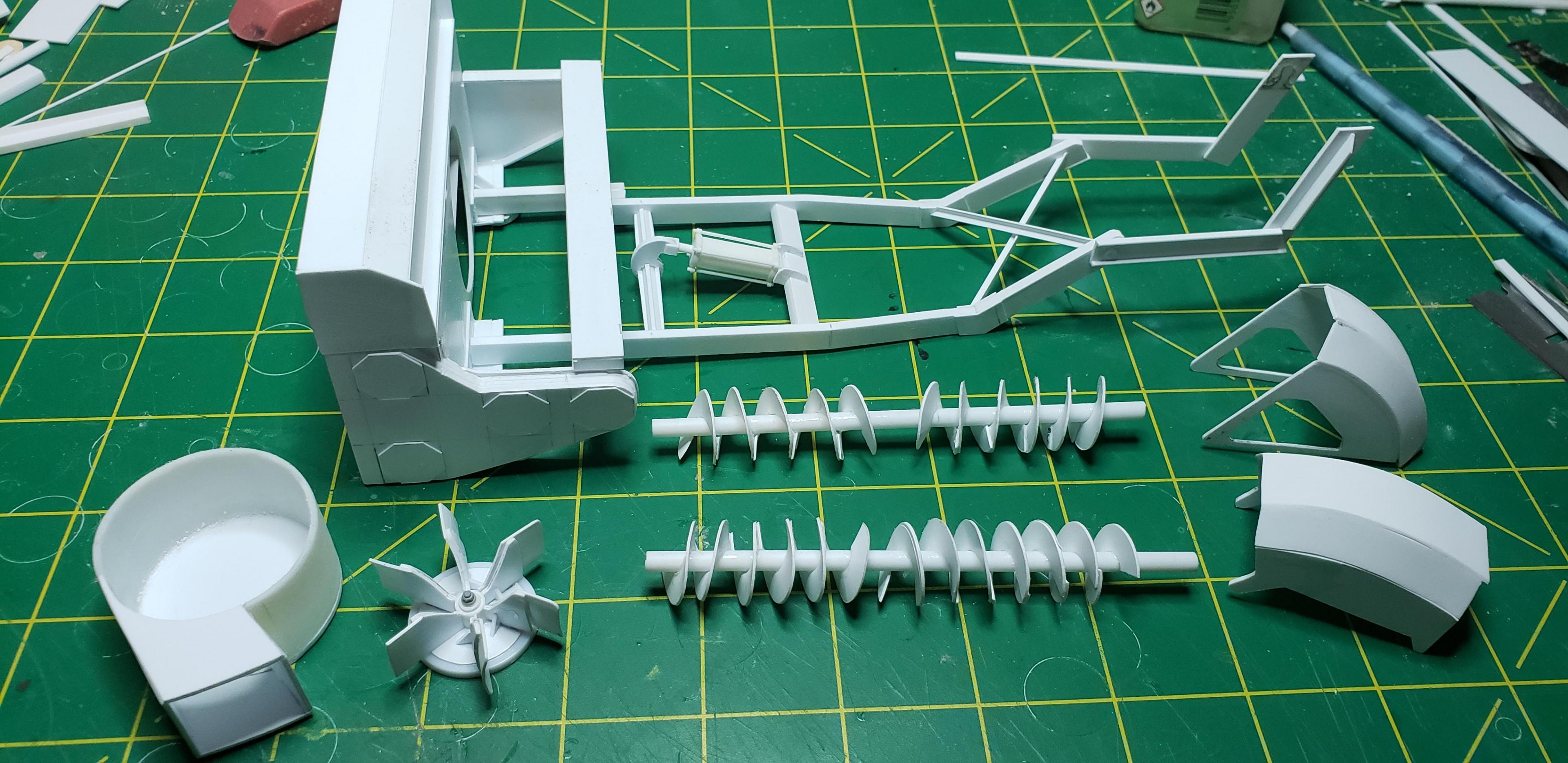

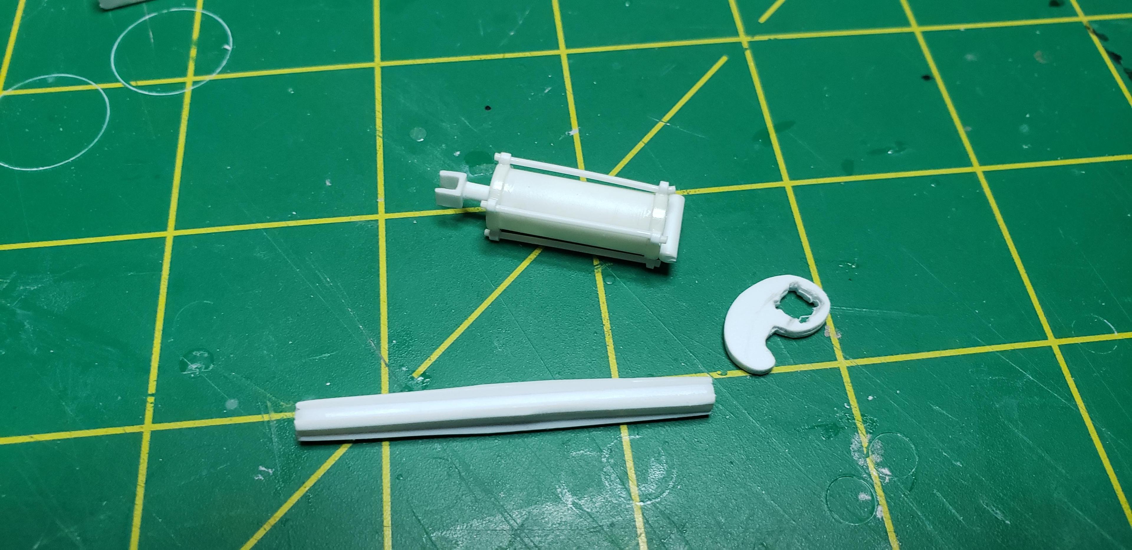

gotnitro? Posted December 17, 2020 Author Posted December 17, 2020 So far the squirrels have assembled quite a few parts ..but still a ways to finish up. Last night I started the impeller drive motor , after mocking up the mounting plate . Here's all the parts the furry buggers stashed around the bench..The discharge chutes still need clean up The blower lift assembly parts made from several different bits then sanded into shape Lastly the motor mounting plate ready to accept the drive motor once its fabricated. Heres the real one for an idea of whats ahead... I asked Santa for some help..even the squirrels laughed ..guess I'm going solo ! Jeff

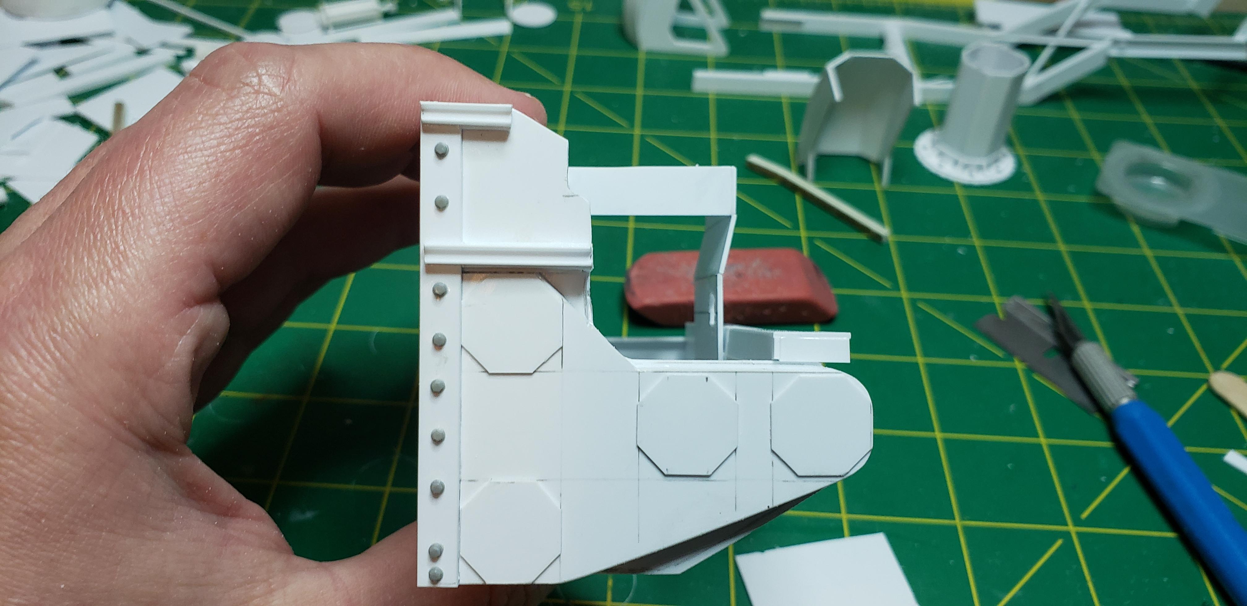

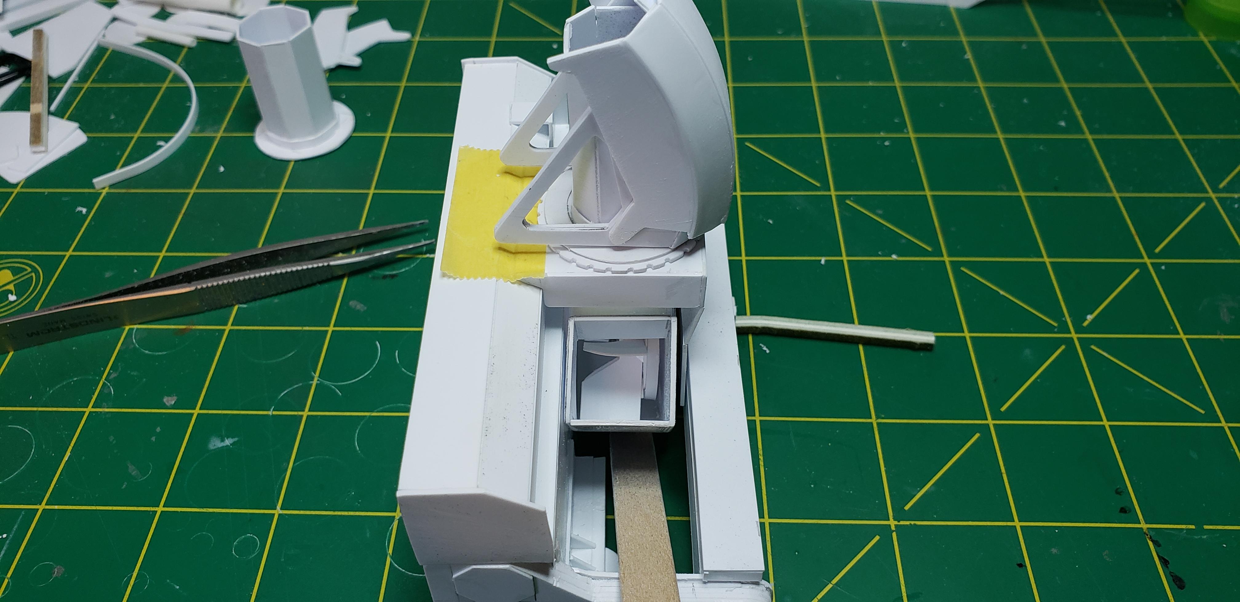

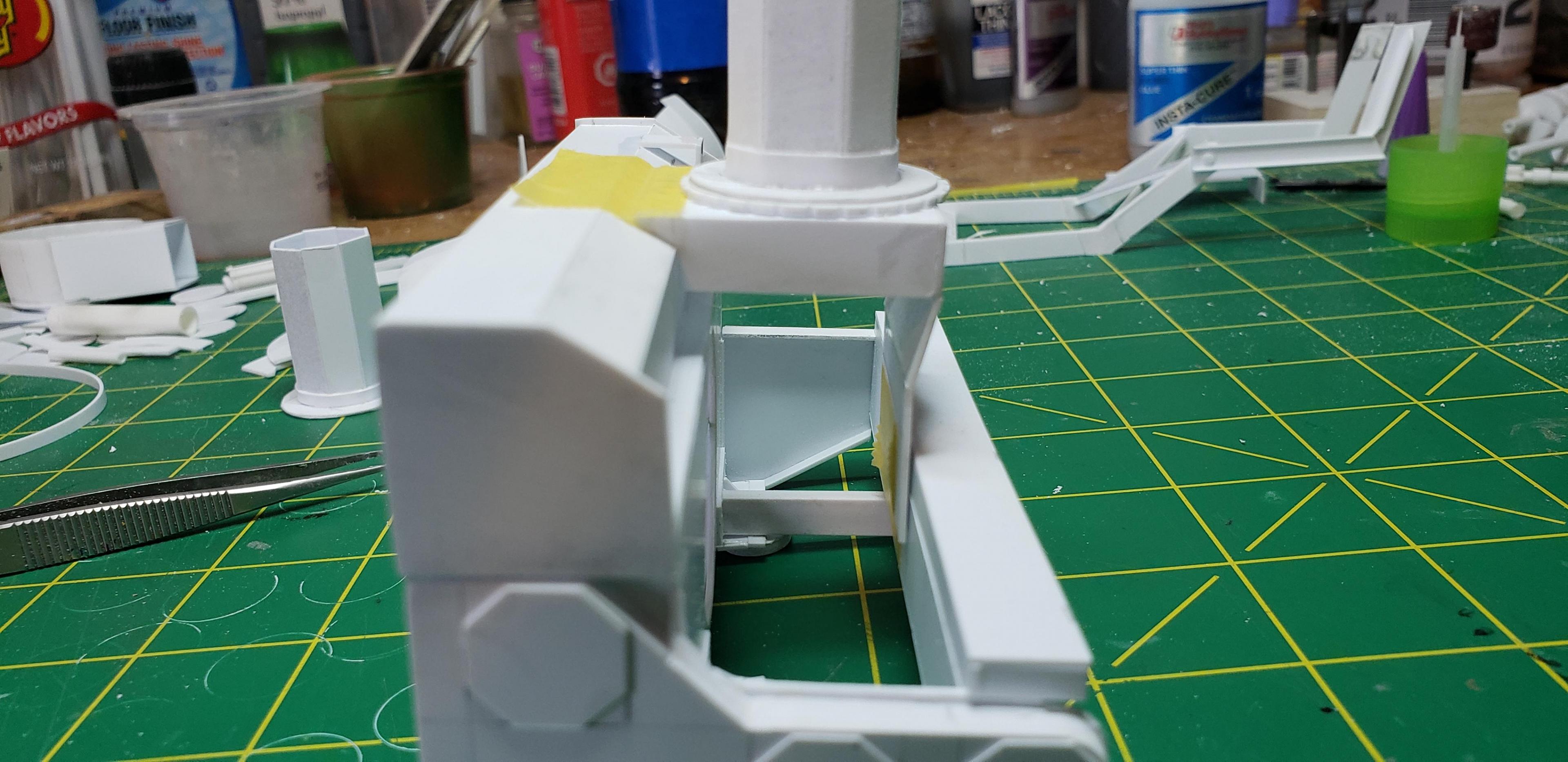

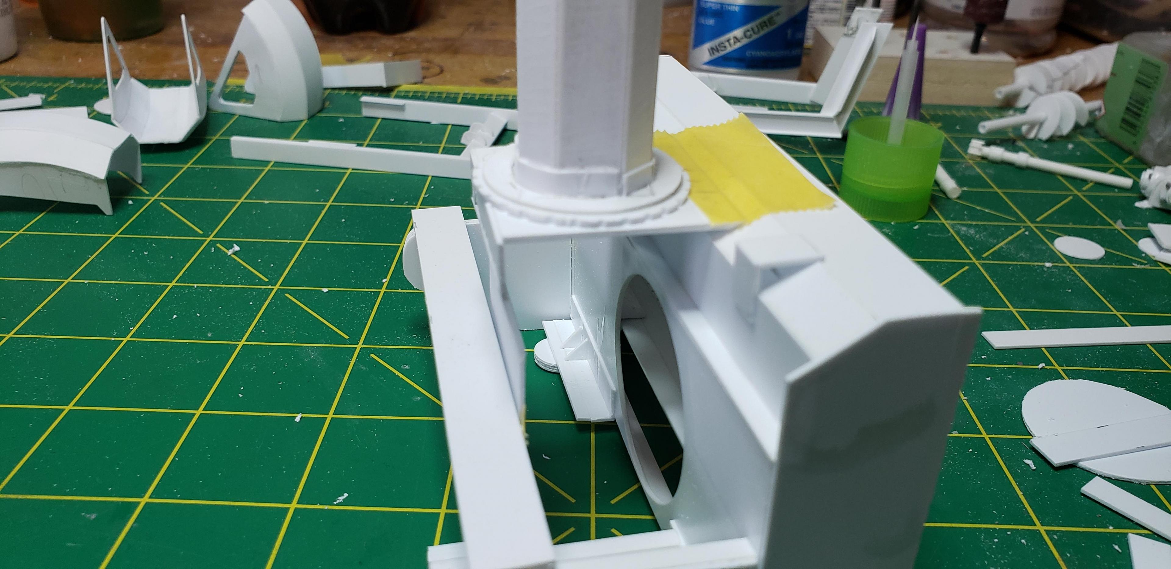

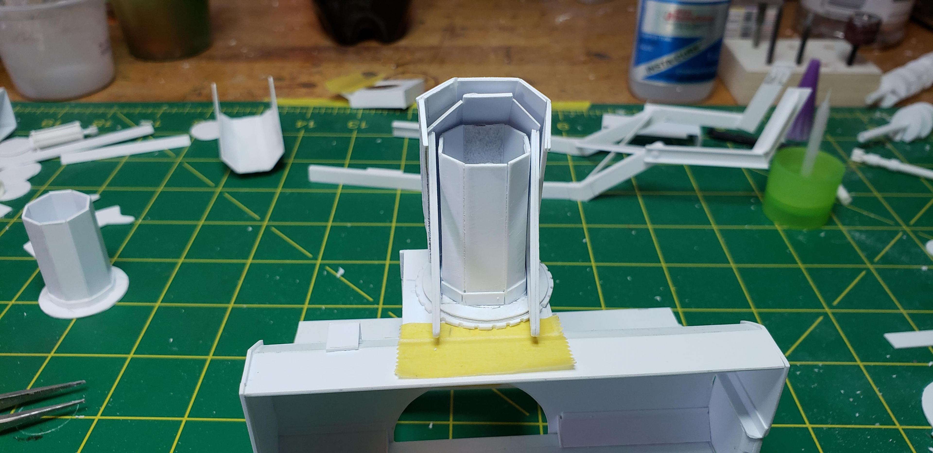

gotnitro? Posted December 27, 2020 Author Posted December 27, 2020 Big mock up day ! Assembled the chute tower mount and had to see how it looked together I almost had a panic attack when it dawned on me the impeller drum wasn't gonna fit..but it dropped right in..whew !!! now for the chute drive motor and bank cutter parts ..the end is closer !!!

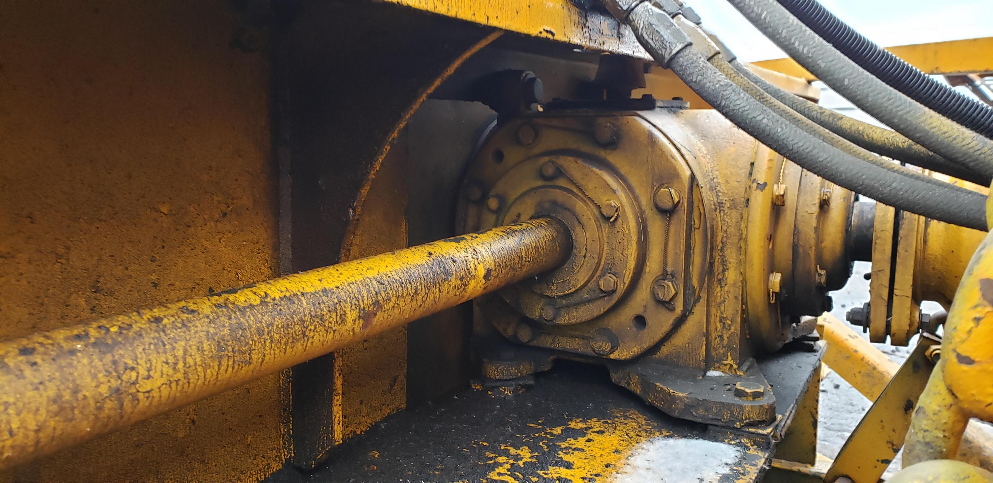

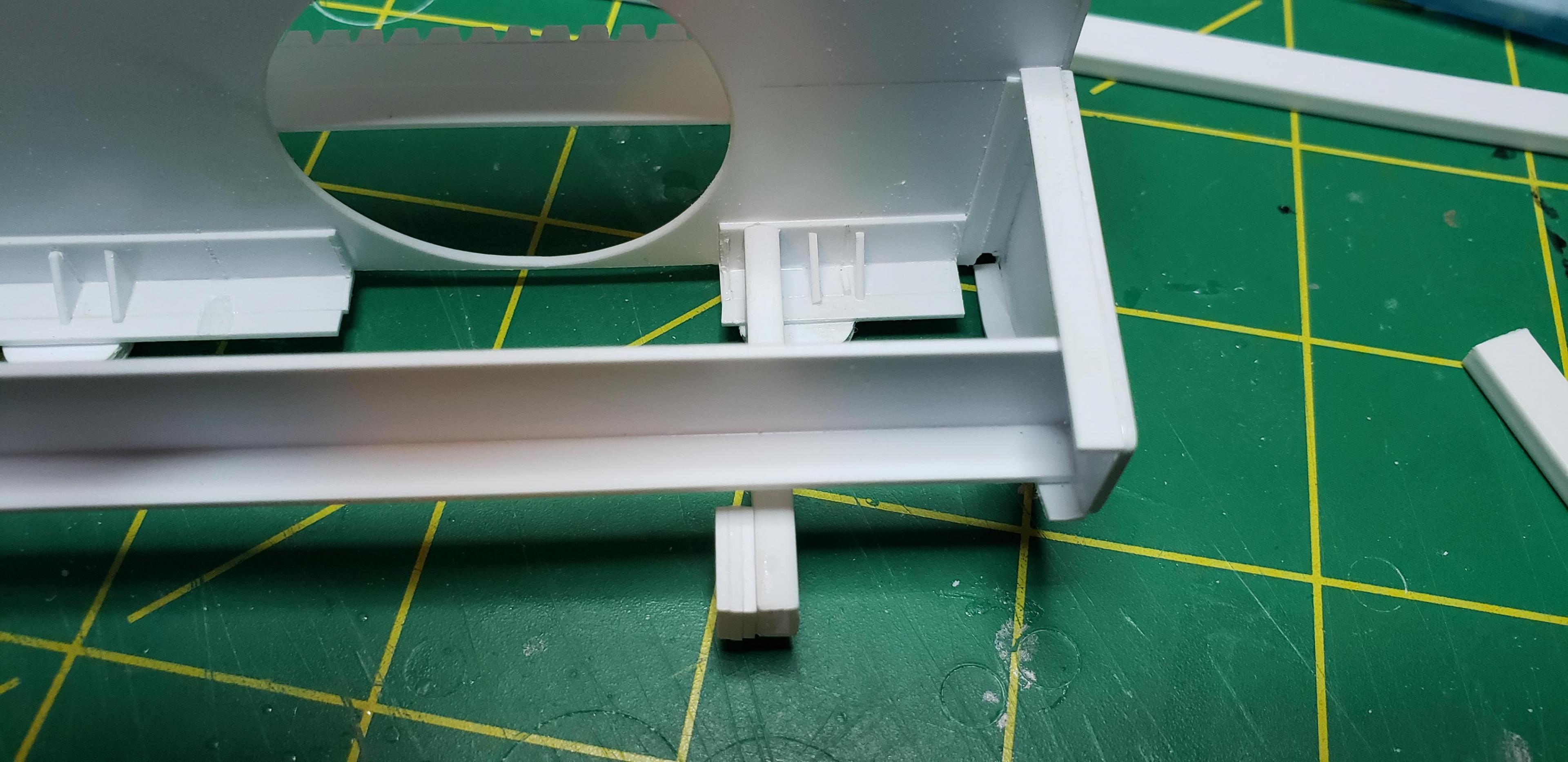

gotnitro? Posted December 27, 2020 Author Posted December 27, 2020 Tossed a few braces and Meng bolts on for detailing. After looking at bare plastic for weeks this felt really good! One major part i wanted to knock out was the drive motor / cylinder that rotates the drum . A few pieces of rod, and square tube made up the assembly. The gear was found lurking in a spares bin Back to work tomo to pay for my snow tires... Thanks for following
