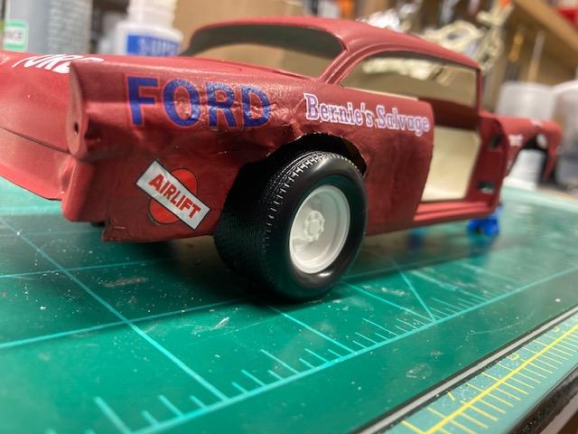

wrenchr Posted November 16, 2020 Posted November 16, 2020 Been working on this the last week. Using PPP tires and wheels. Not patterned after any car just a fun project for a shelf model. Thinned the body from the inside and the used a lighter to bend/dent the panels and then foiled the outside panels. AMT 56 Ford. Quote

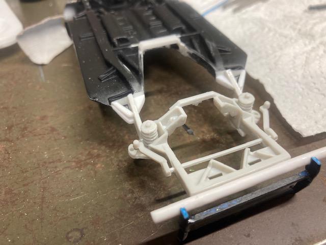

wrenchr Posted November 17, 2020 Author Posted November 17, 2020 The front suspension is fighting me. Ride height. Will get it. Quote
TarheelRick Posted November 18, 2020 Posted November 18, 2020 Excellent body damage. These machines did not stay pristine very long. Looking forward to more updates. Quote

wrenchr Posted January 28, 2021 Author Posted January 28, 2021 Update. Grafted an AMT stock car ford frame clip on it. Will get it repainted this weekend. The exhaust being there bugs me but it is good enough. I will build another but in clean shape using what I learned here. Quote

alan barton Posted February 1, 2021 Posted February 1, 2021 That is looking dead on for an early low bucks race car! A few years ago I built a 57 on a very similar theme but not as beaten up, maybe it was it's first night rather than the end of the season? I would never have thought of doing a black wash over the entire body - I really like that effect and will be trying it on my next dirt car.. Could I suggest a light wipe across your decals in the damaged areas with a piece of 240 wet and dry would add some scuffs to show where it had been hit? I think it would add a lot to the wear and tear you are representing so well here. Can't wait to see it finished. Cheers Alan Quote
TransAmMike Posted February 2, 2021 Posted February 2, 2021 Looks great Jason, very realistic looking? Quote
wrenchr Posted February 2, 2021 Author Posted February 2, 2021 18 hours ago, alan barton said: That is looking dead on for an early low bucks race car! A few years ago I built a 57 on a very similar theme but not as beaten up, maybe it was it's first night rather than the end of the season? I would never have thought of doing a black wash over the entire body - I really like that effect and will be trying it on my next dirt car.. Could I suggest a light wipe across your decals in the damaged areas with a piece of 240 wet and dry would add some scuffs to show where it had been hit? I think it would add a lot to the wear and tear you are representing so well here. Can't wait to see it finished. Cheers Alan Thanks Alan, I will try that with the sandpaper, never thought of it. The wash I have done on other cars and trucks and it really tones down the finish, but in this case gave more depth and grunge to the finish. On the Fairlane I did the same wash and then dullcote. Quote

Sledsel Posted February 11, 2021 Posted February 11, 2021 Looks awesome.. These are always fun builds. The only thing I'd have done differently is sand the trim off the roof and remove the vent windows. Other than that, I'd call it perfect. Quote
horsepower Posted April 11, 2021 Posted April 11, 2021 On 11/17/2020 at 12:10 PM, wrenchr said: The front suspension is fighting me. Ride height. Will get it. I've sawed the original axle from the front spindle and found a piece of sprue runner or rod that fit in the wheel then after cutting it to the right length drilled through it and the spindle that will let you press a straight pin through. I epoxy the pin in place putting it in from the inside of the spindle so the head of the pin goes against the backside of the spindle upright for a little more strength then coat the pin and the mating end of the replacement axle and push it on the pin and against the upright as tight as possible and usually use an alligator clip as a clamp to hold it in place then using a good set of snips or if you have a Dremel use a cut-off wheel to make a smoother cut. By doing some creative sanding to the end of your replacement axle on the surface where it meets the upright it's really easy to put some camber in the front suspension! Also and the pin makes it stronger than the original. For the rear its even easier, just shorten the springs on a NASCAR type suspension, or with leaf springs just move the rear (or both) ends of the springs to a higher on the frame mounting point, and in the rear of the springs just make a little longer shackle (don't forget to reverse the way it mounts) that was the way we did it waaaay back to even lower our street cars. And there's always the old lowering block between the springs and axle housing with springs that mount under the gear housing. You have a good job going on a popular project. Quote
