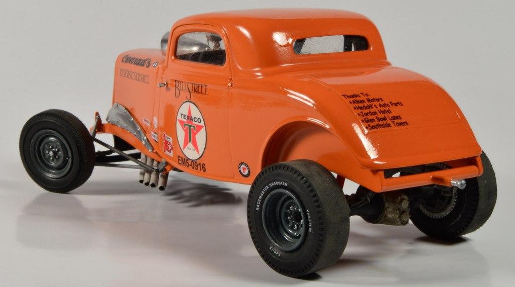

Straightliner59 Posted November 25, 2020 Posted November 25, 2020 I bought some by Blingasm, on Amazon. I've had very good luck, with it. I use both white and transparent. The decals on these cars were all printed on it. On the Chevy II, only the door decals were printed on it. The others were printed on Testors paper.
