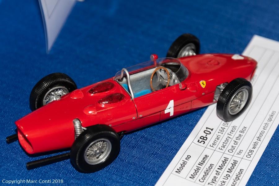

ChrisR Posted December 30, 2020 Posted December 30, 2020 These kits are a lot of work but tuns out nicely. I did built the Ferrari Shark-nose and the ERA although I replaced the cast spoke wheels with photo-etch spokes.
