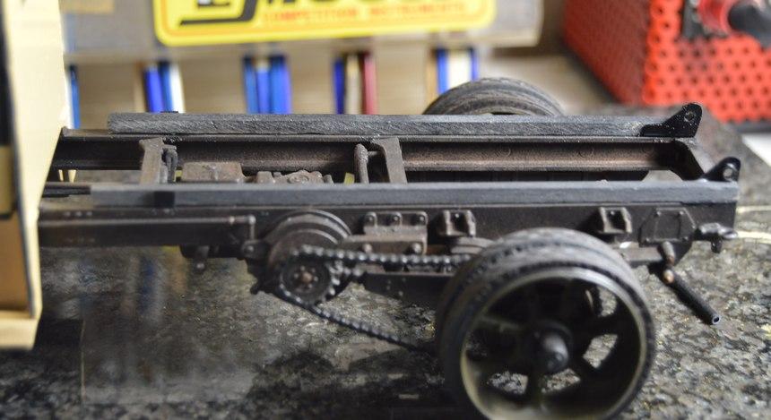

HJK Posted March 2, 2021 Posted March 2, 2021 Hi Daniel, OK, I see. I also have one of the Monogram kits. It's the Texaco Tank Truck. This one doesn't come with these levers. That's the reason I asked the question. Another thing is also puzzling me. On one of the pictures at the beginning of your thread one can see six rivet heads nearly in the middle of the frame rails. There is nothing in between the rails, no cross member or similar parts, so I'm asking myself what are they for? Do you have any idea what they are for? Is there a special reason for them? Are they needed for the Log Hauler Kit and they just use the same frame for all the kits? BTW, I thought about your solution of routing the ignition cables. That's a very clever method, thanks again for sharing your idea. Juergen
Straightliner59 Posted March 3, 2021 Author Posted March 3, 2021 On 3/2/2021 at 2:18 PM, HJK said: Hi Daniel, OK, I see. I also have one of the Monogram kits. It's the Texaco Tank Truck. This one doesn't come with these levers. That's the reason I asked the question. Another thing is also puzzling me. On one of the pictures at the beginning of your thread one can see six rivet heads nearly in the middle of the frame rails. There is nothing in between the rails, no cross member or similar parts, so I'm asking myself what are they for? Do you have any idea what they are for? Is there a special reason for them? Are they needed for the Log Hauler Kit and they just use the same frame for all the kits? BTW, I thought about your solution of routing the ignition cables. That's a very clever method, thanks again for sharing your idea. Juergen Expand Juergen, I will have to look at it, when I get home. The rivets may be for the hydraulic cylinders. I have decided to leave off the box sides and tailgate, and install stake pockets on the sides of the bed. I drove lumber trucks, for many years. I have long wanted to build one. Since they all had dump mechanisms, I am finally going to build one, using this truck. There may not have been many set up this way, in the late '20s-early '30s, but, the technology was there, and trucks have been infinitely customized, so, I am going with it! Thank you again! On 3/3/2021 at 2:43 AM, DRIPTROIT 71 said: Looking good! Expand Thanks, kindly, sir!
Straightliner59 Posted March 3, 2021 Author Posted March 3, 2021 On 3/2/2021 at 2:18 PM, HJK said: On one of the pictures at the beginning of your thread one can see six rivet heads nearly in the middle of the frame rails. There is nothing in between the rails, no cross member or similar parts, so I'm asking myself what are they for? Do you have any idea what they are for? Is there a special reason for them? Expand Juergen, I have to say that I am as clueless as you, regarding what those might be! ☺️ There is absolutely nothing near them. Hmmm... The cab parts have been painted, and are sitting on the fender/chassis assembly while they dry enough so that I can weather them. The lights and the flash are washing out a lot of the weathering--especially in the places I've used an 8B pencil to represent worn through paint, through use. I think it'll look good as a lumber truck.Anyway, here are the latest photos. As always, questions, critiques and comments are always welcome. Thanks for looking!

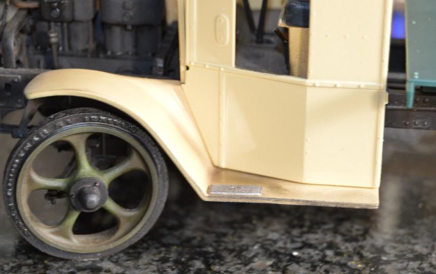

Chariots of Fire Posted March 10, 2021 Posted March 10, 2021 Weather the sides of the cab where they would have been scrubbed by dirty shoes getting in. Also along the beginning of the curved part of the cab where it would get touched by hands. Some of the Tamiya bare metal weathering material put on with their little sponge tip would do the trick. To Robert; I think is is a matter of test fitting these pieces as you go and making sure that all is square. The least bit of raw plastic where the sprues attach can be the cause of a lot of grief if they are not sanding off well. Just a thought. I've done a couple of these and the fit can be tough, especially with the hood so it takes a bit of tweaking.

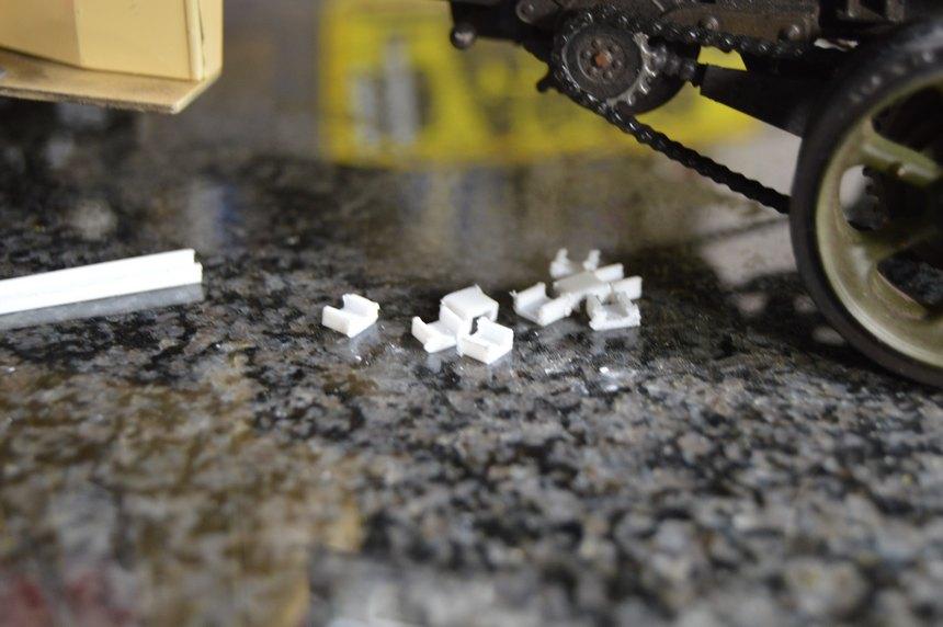

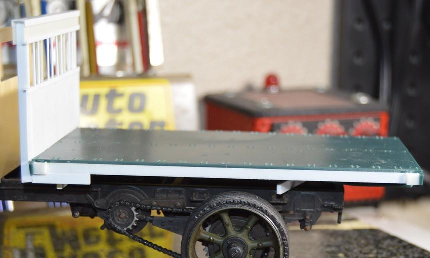

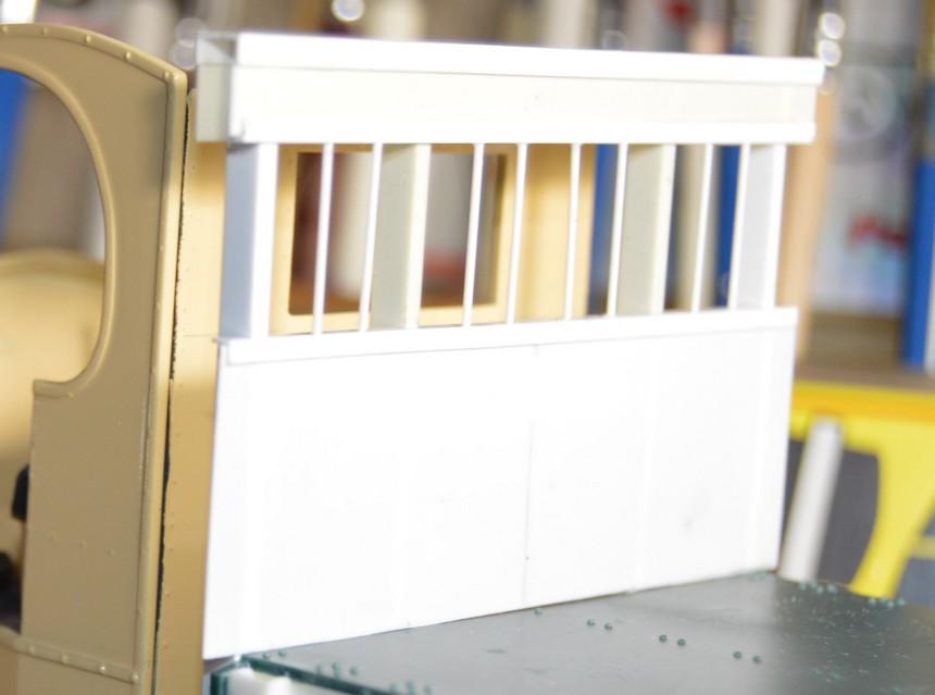

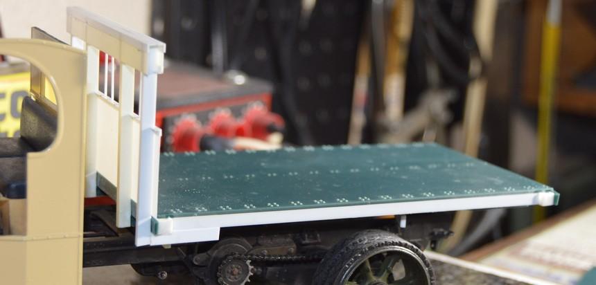

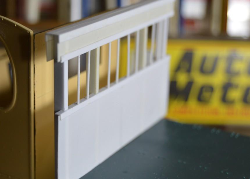

Straightliner59 Posted March 15, 2021 Author Posted March 15, 2021 The wood bed cushions/hinge pieces were warped, from the box, so I replaced them with pieces made from plastic, for the hinges, and wood strips, for the cushions. The hinges aren't prototypical, but, they look better than the kit parts. I also messed around with the fit of the cab pieces, firewall and radiator. They fit together nicely, with some work. It will take a bit more work to get them to fit together snugly, AND on the chassis. I've seen enough work of guys who know how to do this (Charles Rowley, Joe Cavorley, to name just a couple) to know that it can be done, however. Of course, the new pieces in these photos still need weathering. I've had the bed mounted as it will be, permanently, so that's figured. Anyway, here are just a couple of shots of the latest work. Comments, questions and critiques are always welcome. Thanks for looking!

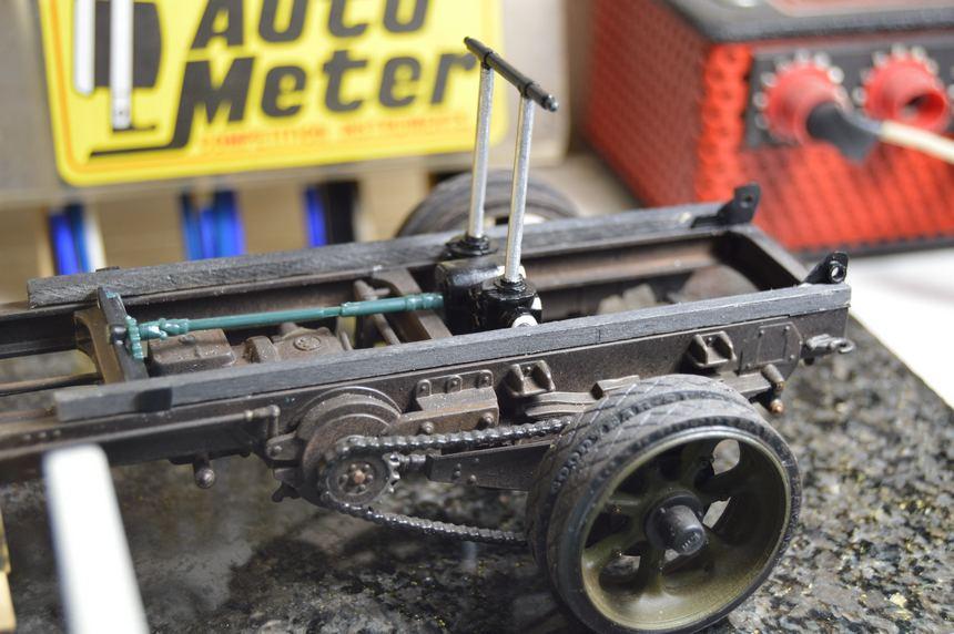

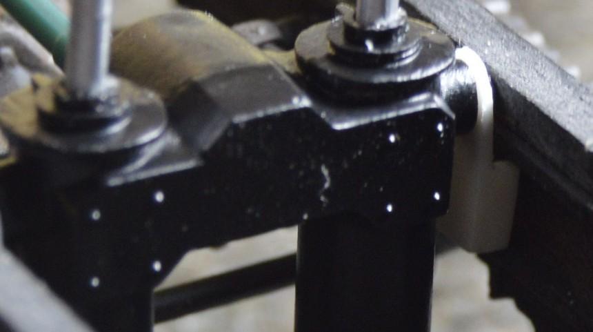

Straightliner59 Posted March 23, 2021 Author Posted March 23, 2021 It took some "figgerin'" to build the bed hoist assembly! The hydraulic cylinders needed to be assembled, so that the seams could be removed, prior to paint. However, the pistons/rods need to be installed prior to cementing the cylinder halves together. I will have to illustrate it, one of these days, since I got caught up in designing and building it, that I neglected to take in-process photos! Sorry! Anyway...here's what I ended up with. The pieces in white are swaged onto the cylinders. They are carriers for the cylinder assembly that allowed me to turn the assembly in to the chassis rails, then slide it into position. Obviously, all of this needs paint, weathering, detail paint, etc. Now, though, I know it will all work, together with the bed. As always, questions, comments and critiques are welcome. Thanks for looking!...Dan
