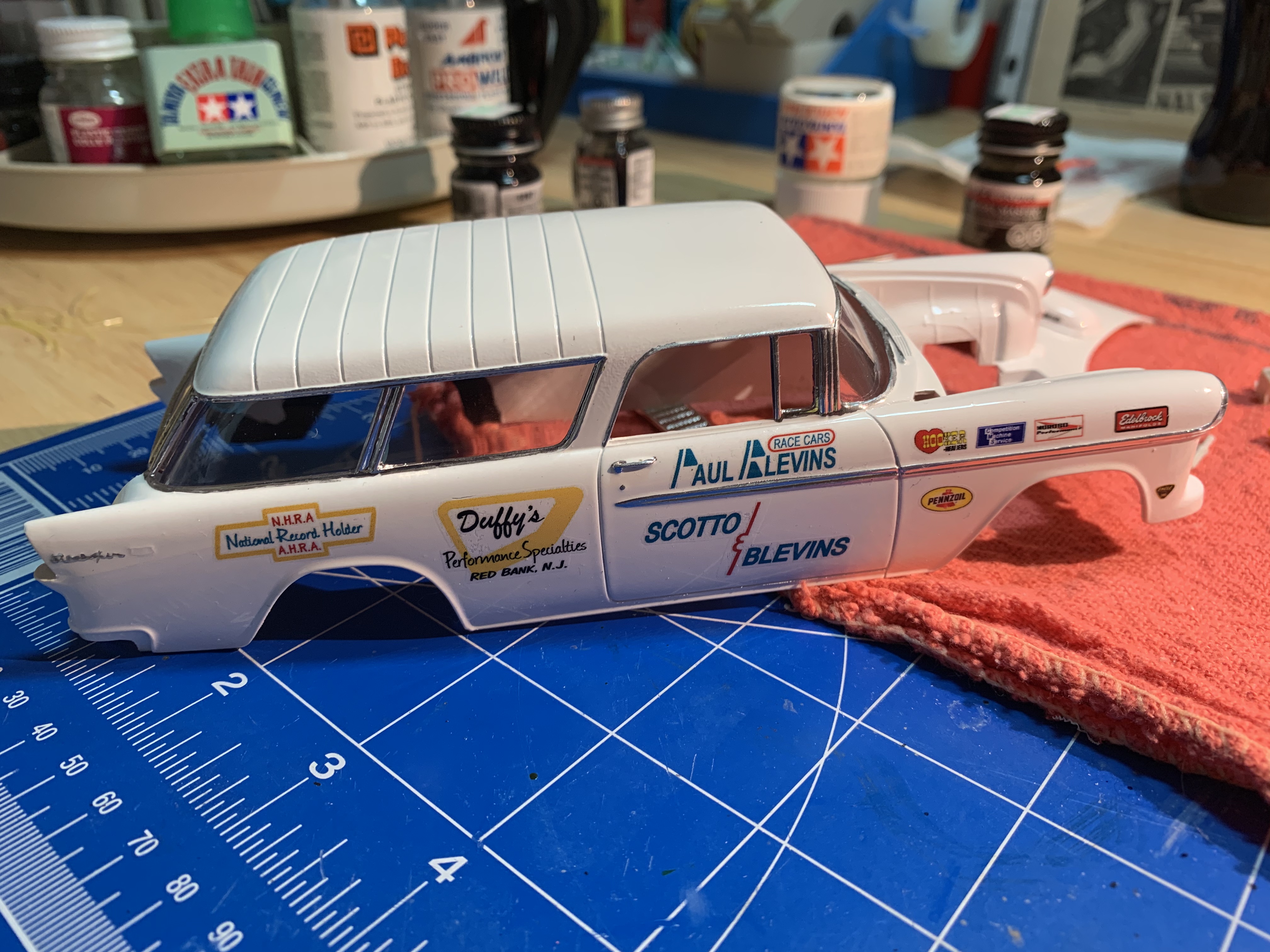

While trying to recover from my bout with Civid-19, with lots of time and limited energy and brain power I decided to do something much simpler than the Shahan’s Hornet. As your becoming aware I like old drag cars, and this one has been on my build list for some time!
Years ago I purchased a set of decals off the internet to do both the 55 Nomad and the Corvette of Scotto & Blevins, so I started going through the AMT kit I realized this would be an easier build than I thought. Almost everything I needed is in the box. I robbed the AMT 65 El Camino kit for the Cragar wheels, and the AMT parts pack for slicks.

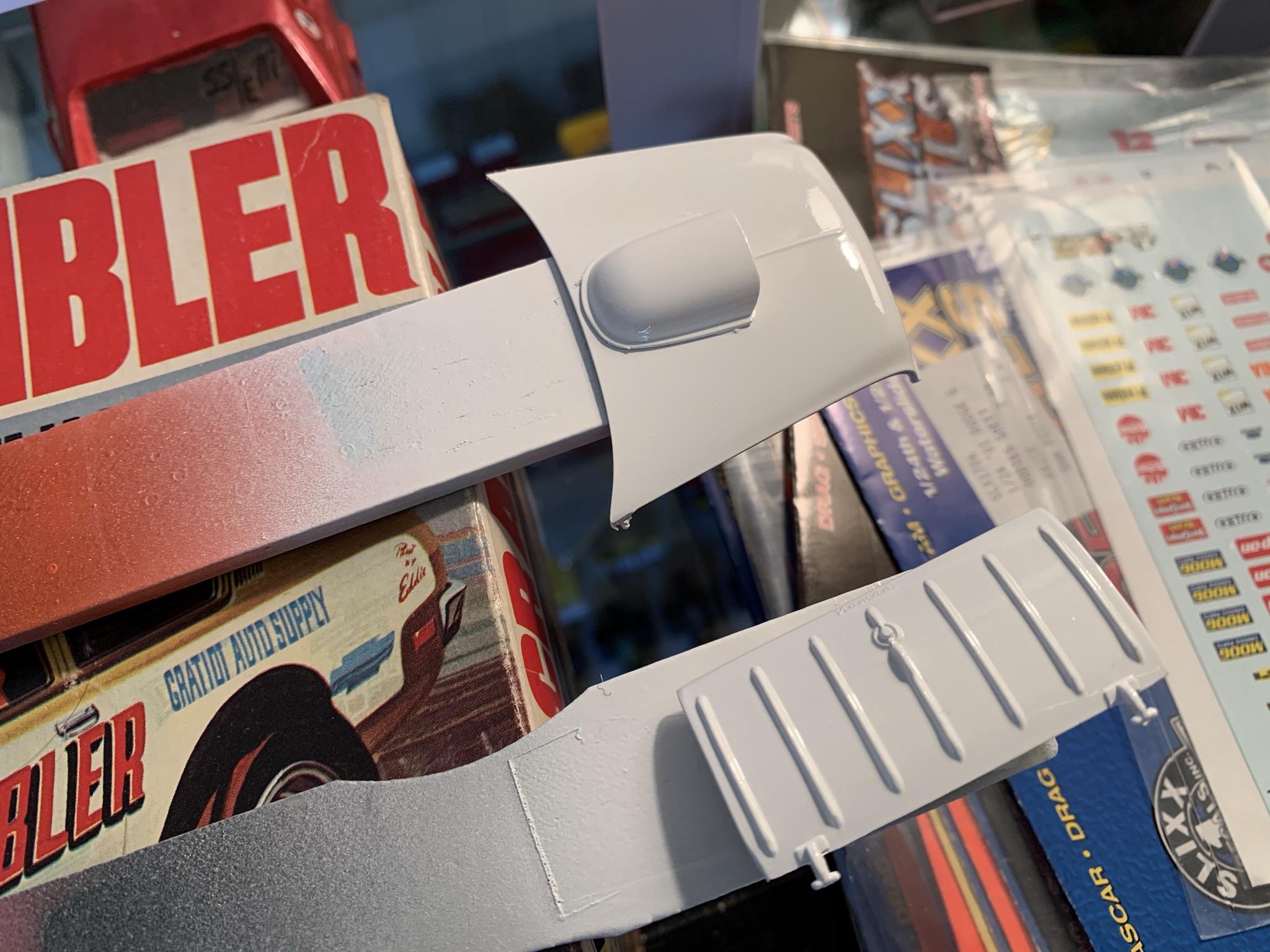

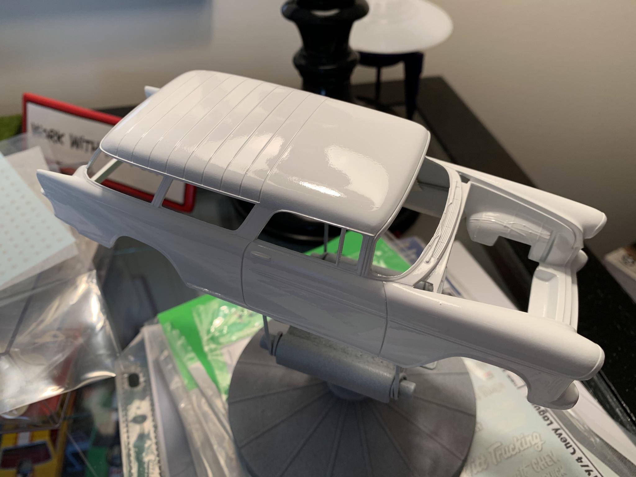

I started doing research on the car and found some great reference photos on the internet. During that internet search I came across another set of decals for this car from SMP Products. They had the 55s decals as well as a set for the Corvette. I ordered a set of each. I was very pleased with the quick service and the quality of the decals. The color and size are so much better than the first set I purchased. Here’s where I am today.I removed the muffler and tailpipe, I deepened the oil pan, and painted the body Testors Classic White Enamel.

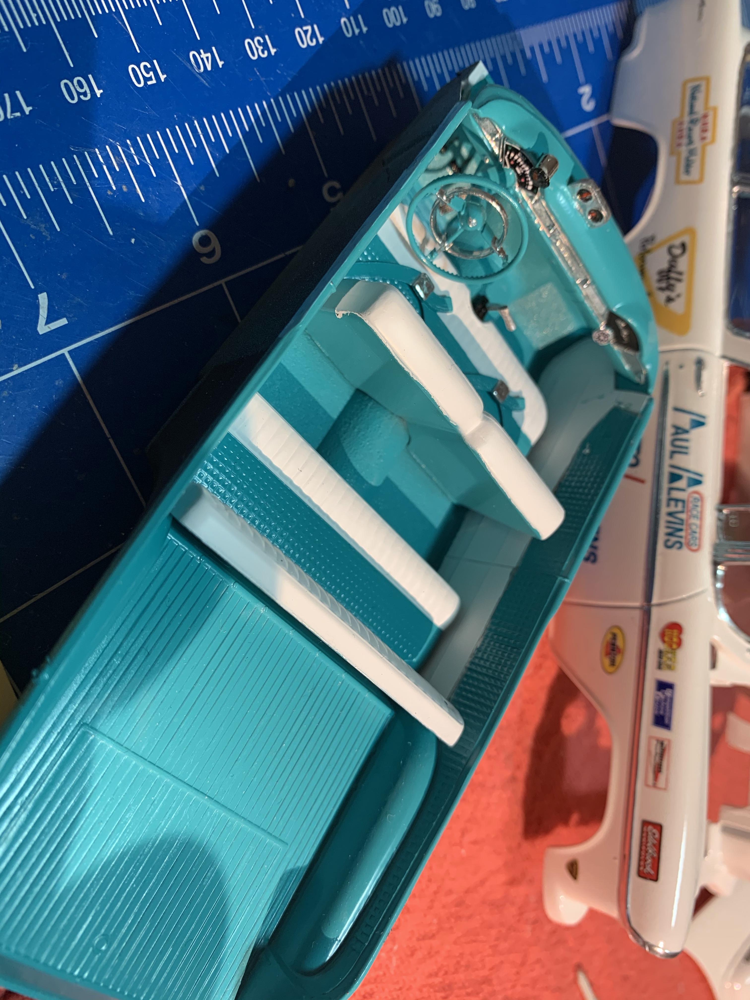

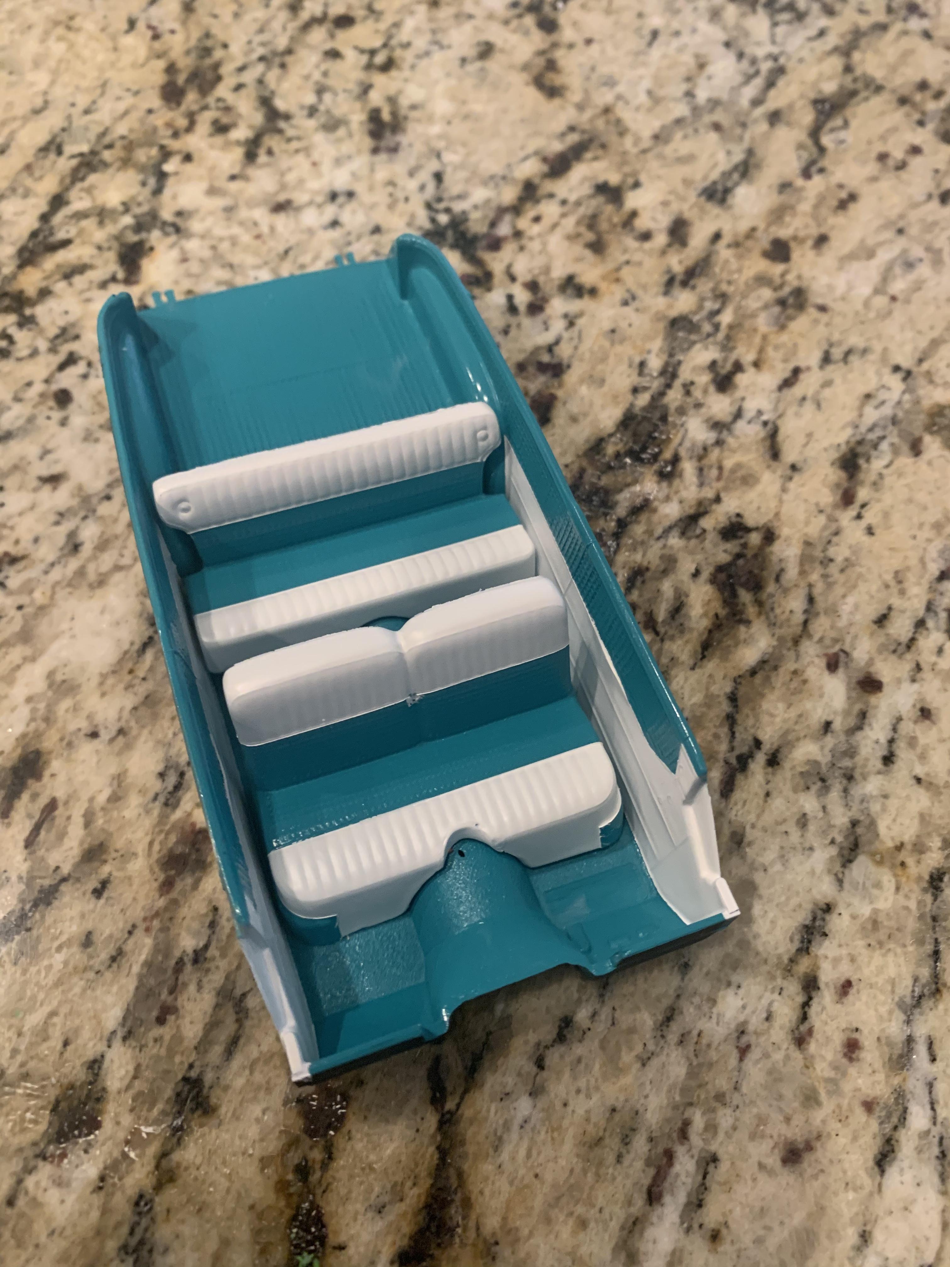

My research showed the interior to be pretty stock, the front bench seat notched to clear the Hurst shifter, a turquoise and white Upholstry the tach mounted on the dash above the speedometer.

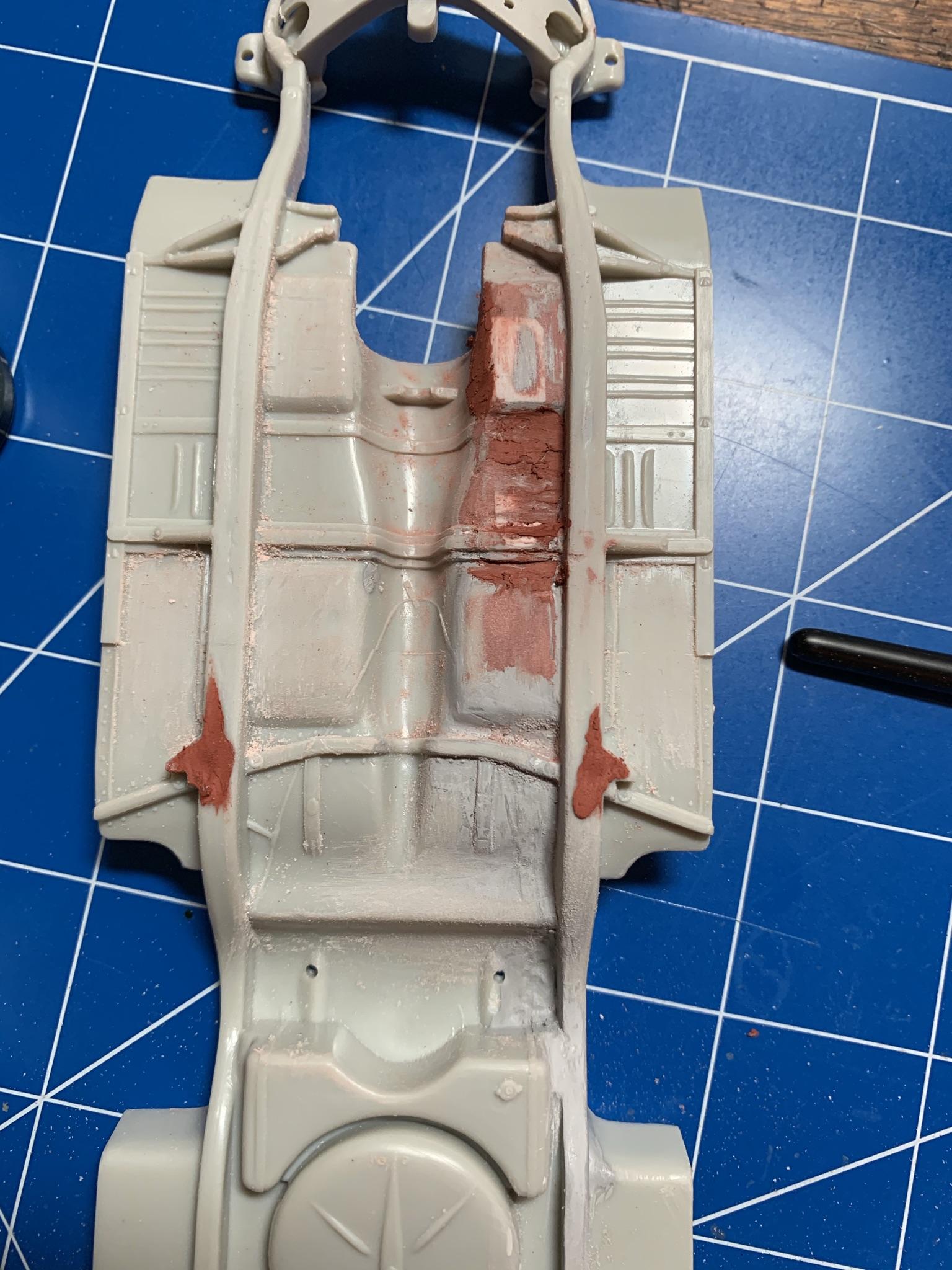

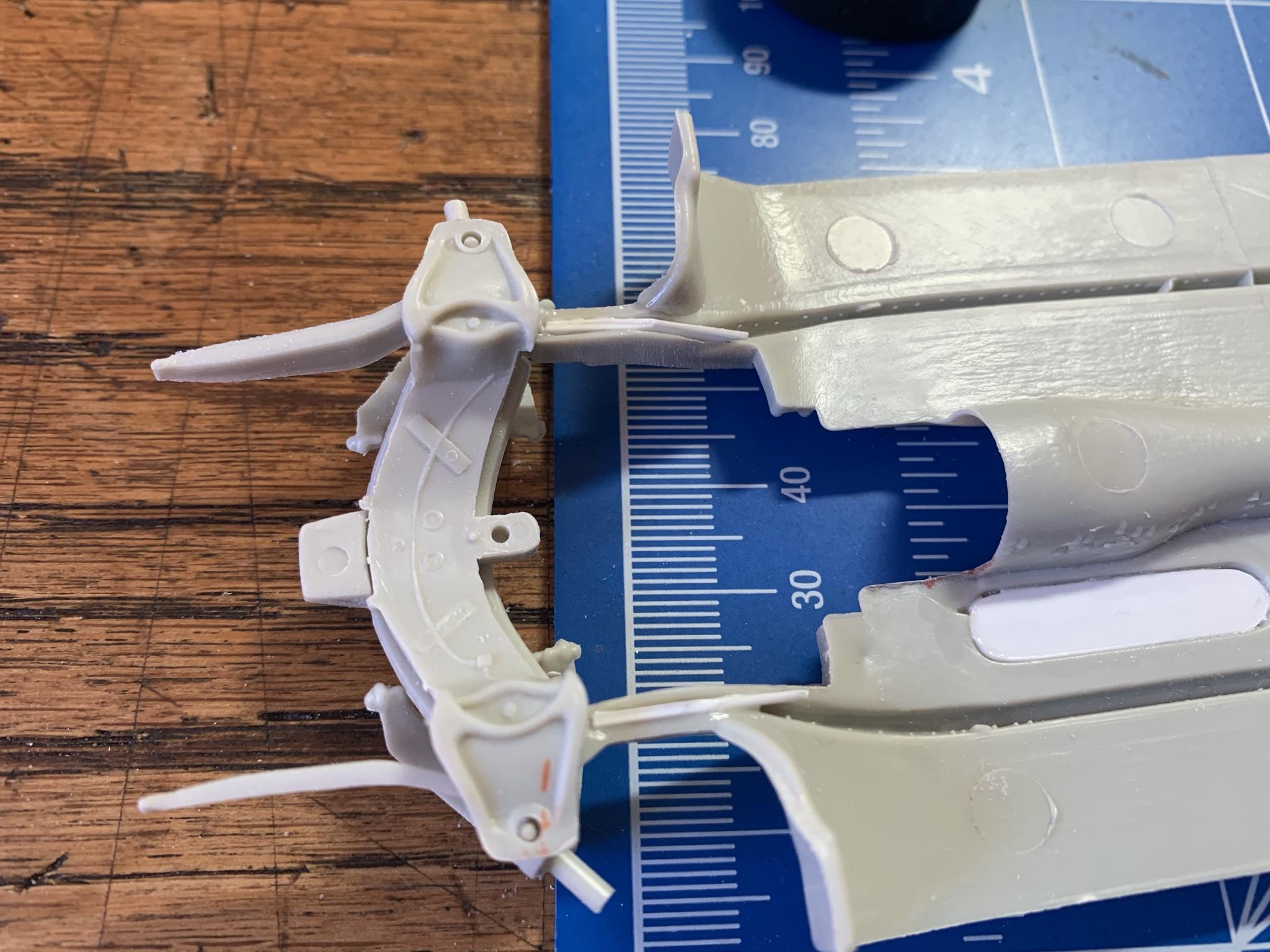

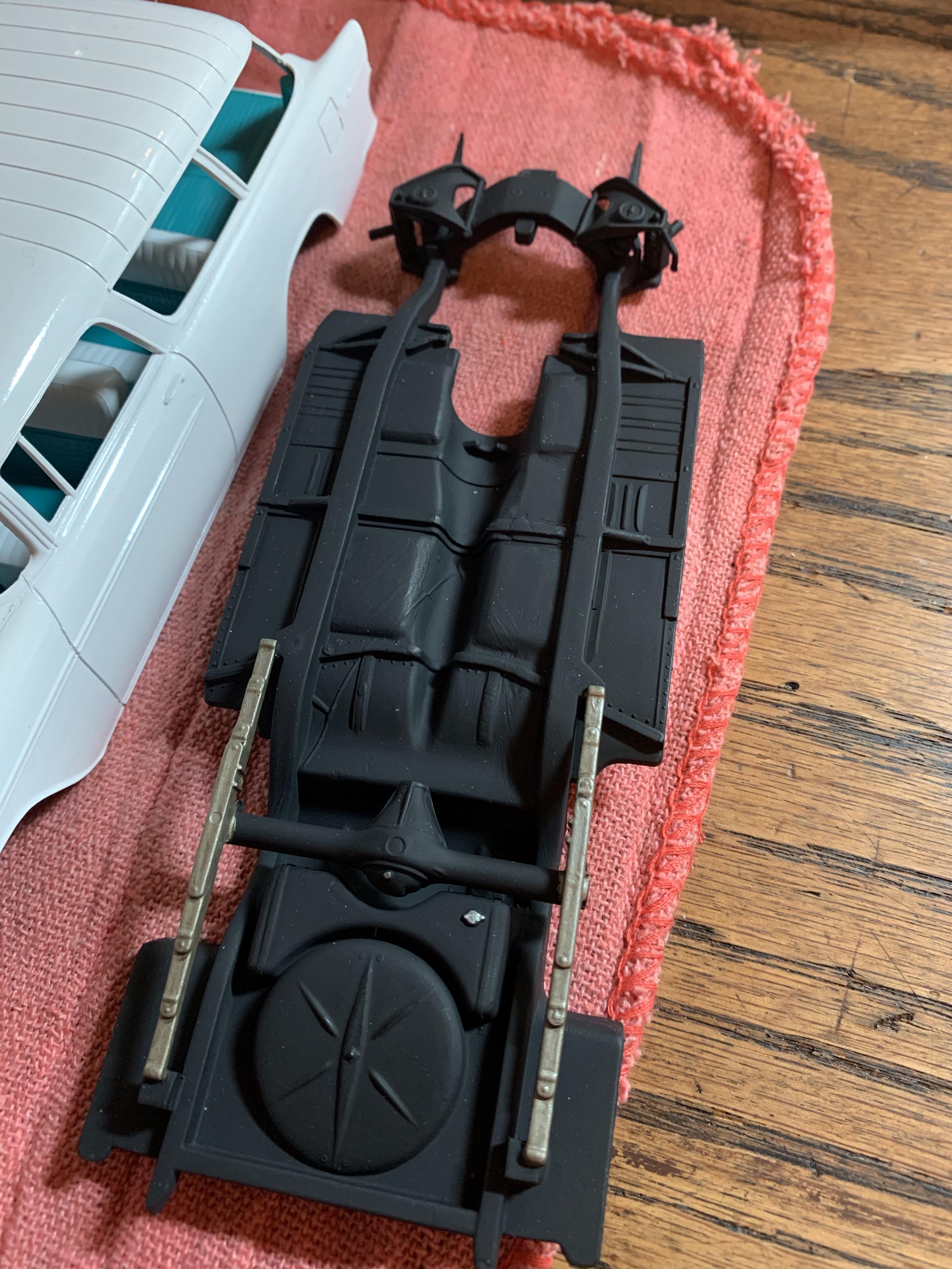

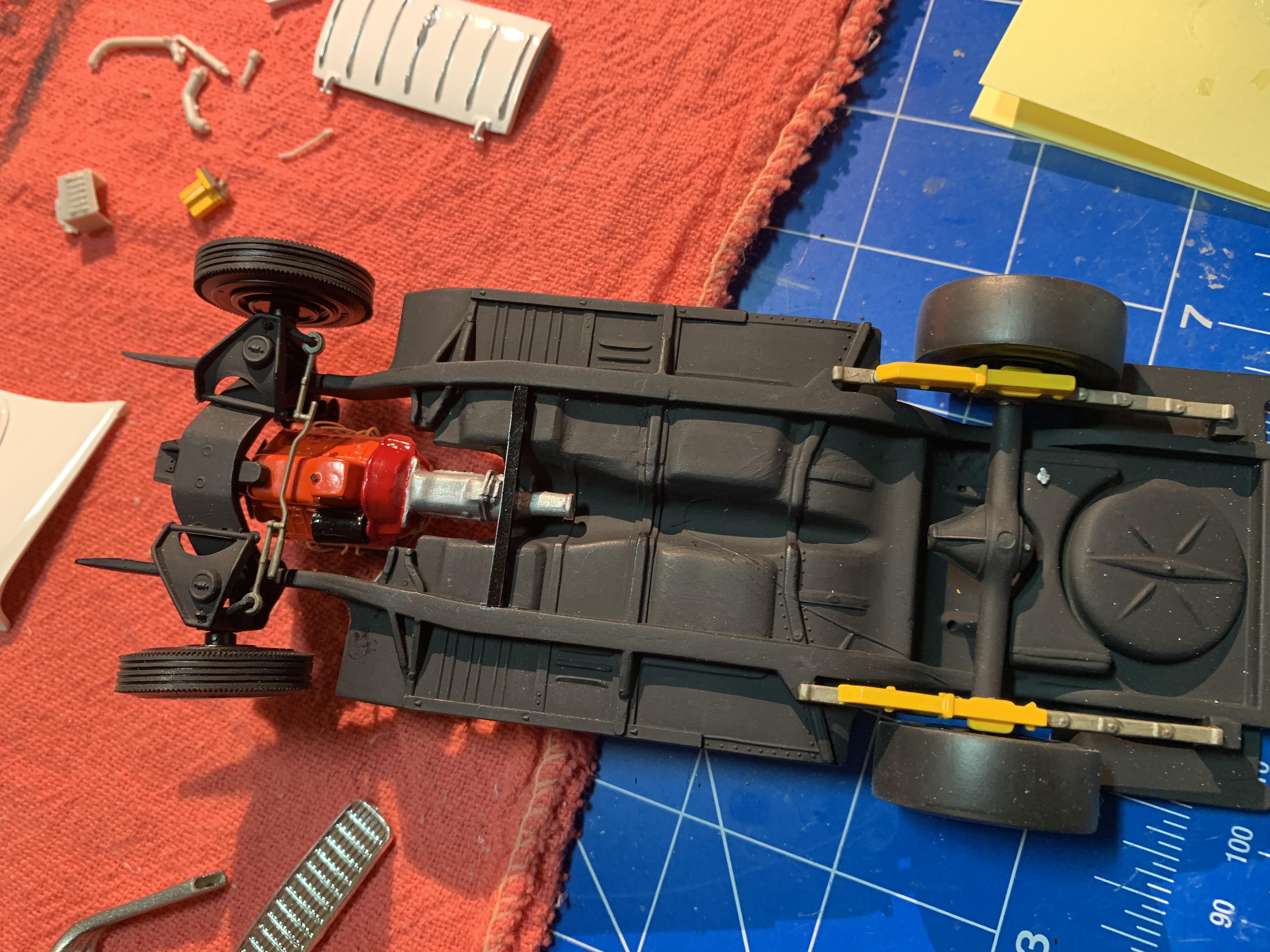

Final detail to the interior, I still need to add the two gages above the radio. I filled the gaps in the front frame rails, and painted the chassis flat black as the original car was.

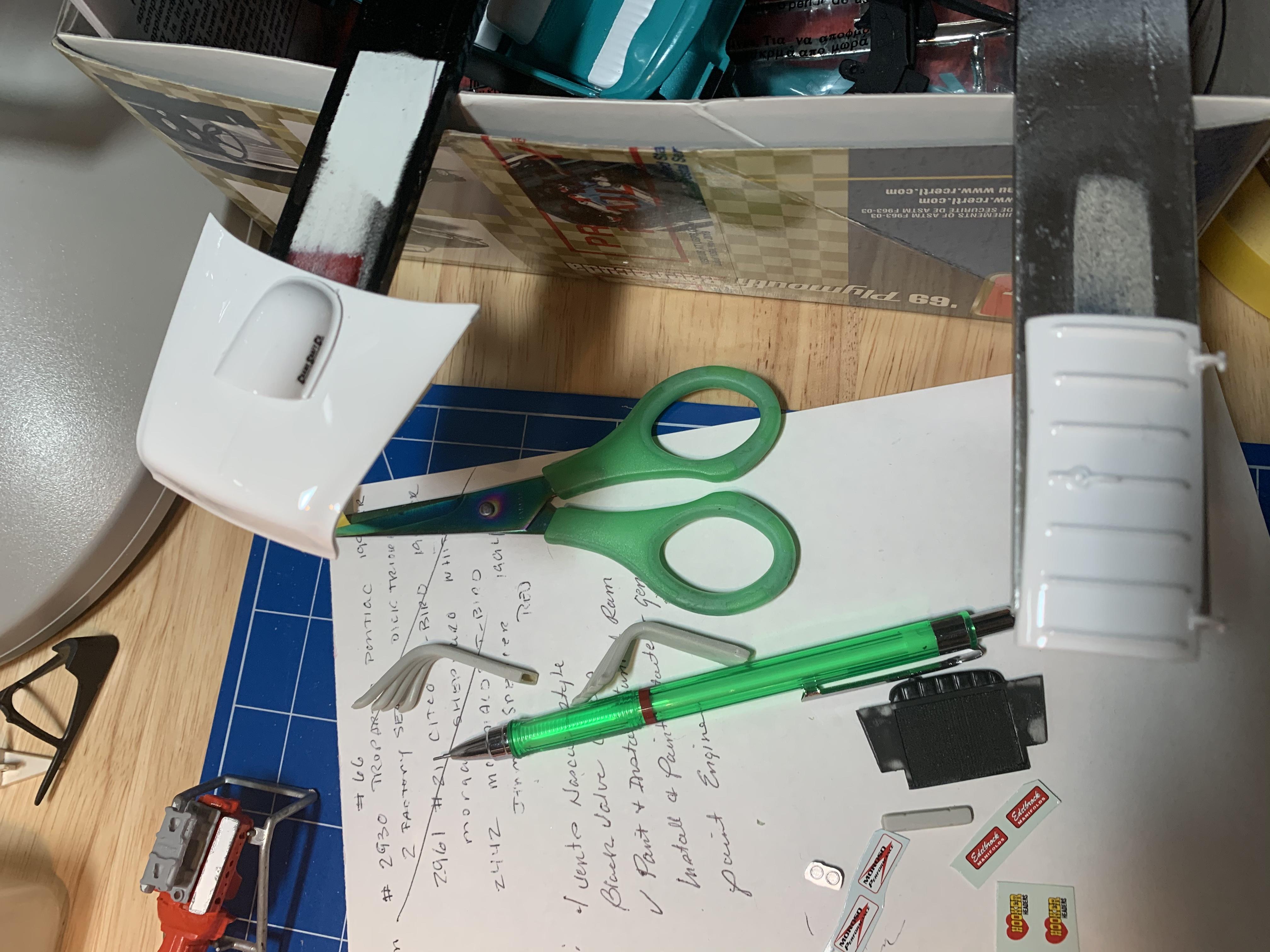

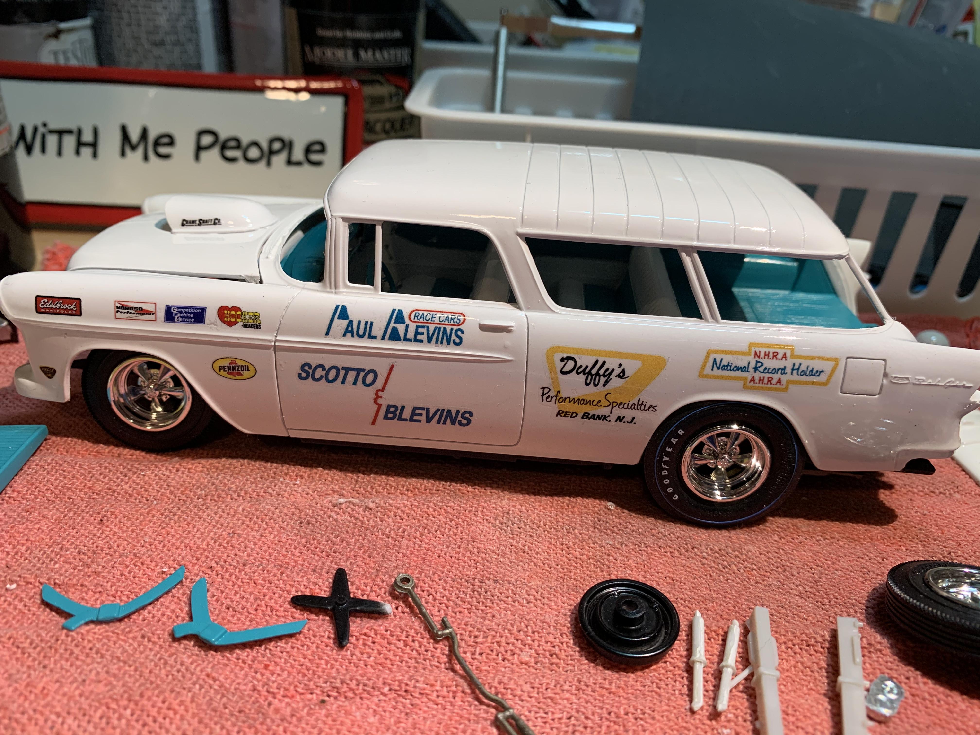

Here’s the decal I used, and here’s the pic with some of them installed. I need some warm weather for the clear coat to be  added. Also added a photo of the actual car.

45 minutes ago, doggie427 said:
Beautiful Roger ! This was probably my favourite of their killer cars. Where did you source the hood scoop?
I found it in my parts stash, it was longer and clear, it’s a little bigger  than the one on the 1-1 car, but it works.

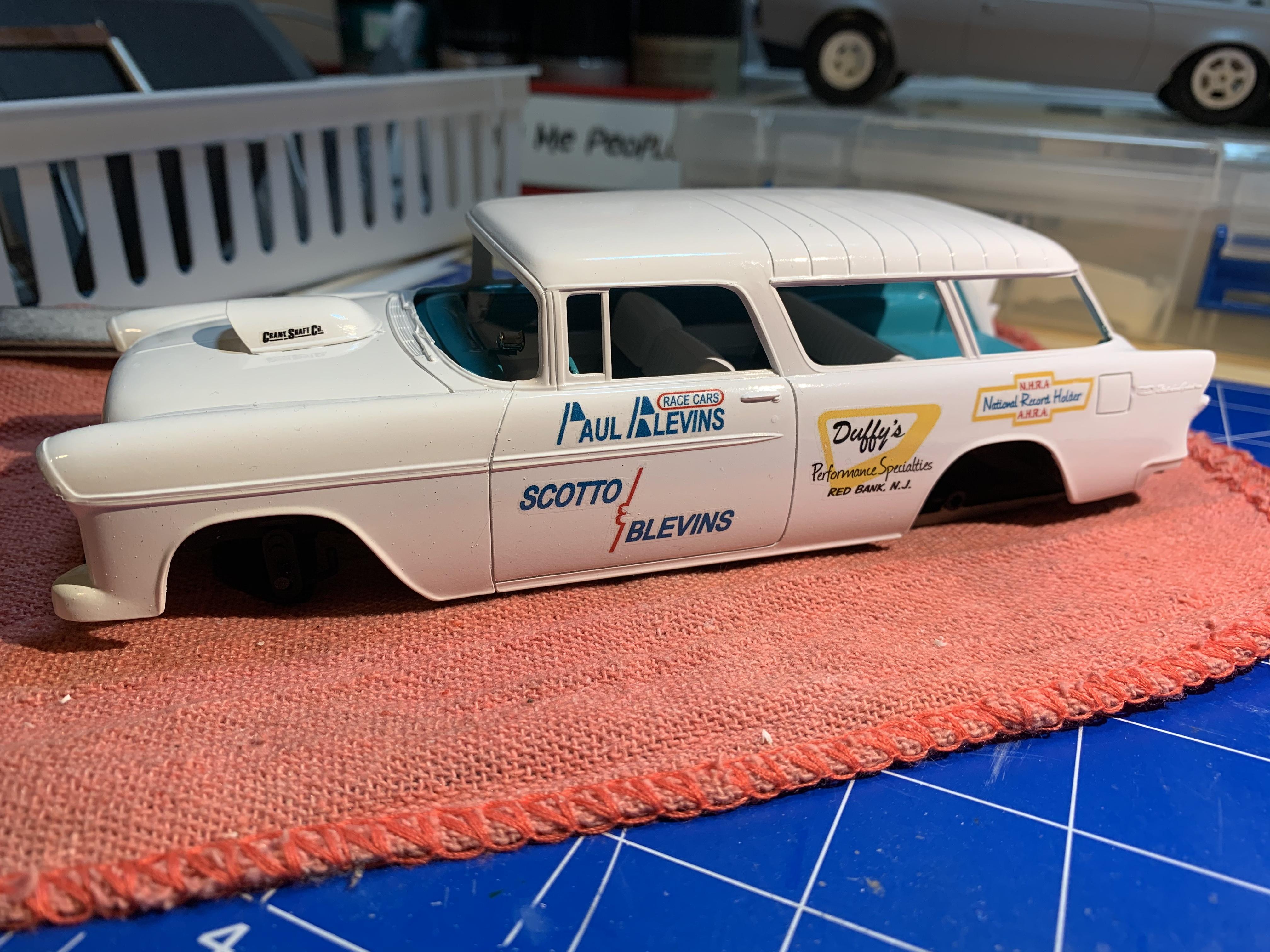

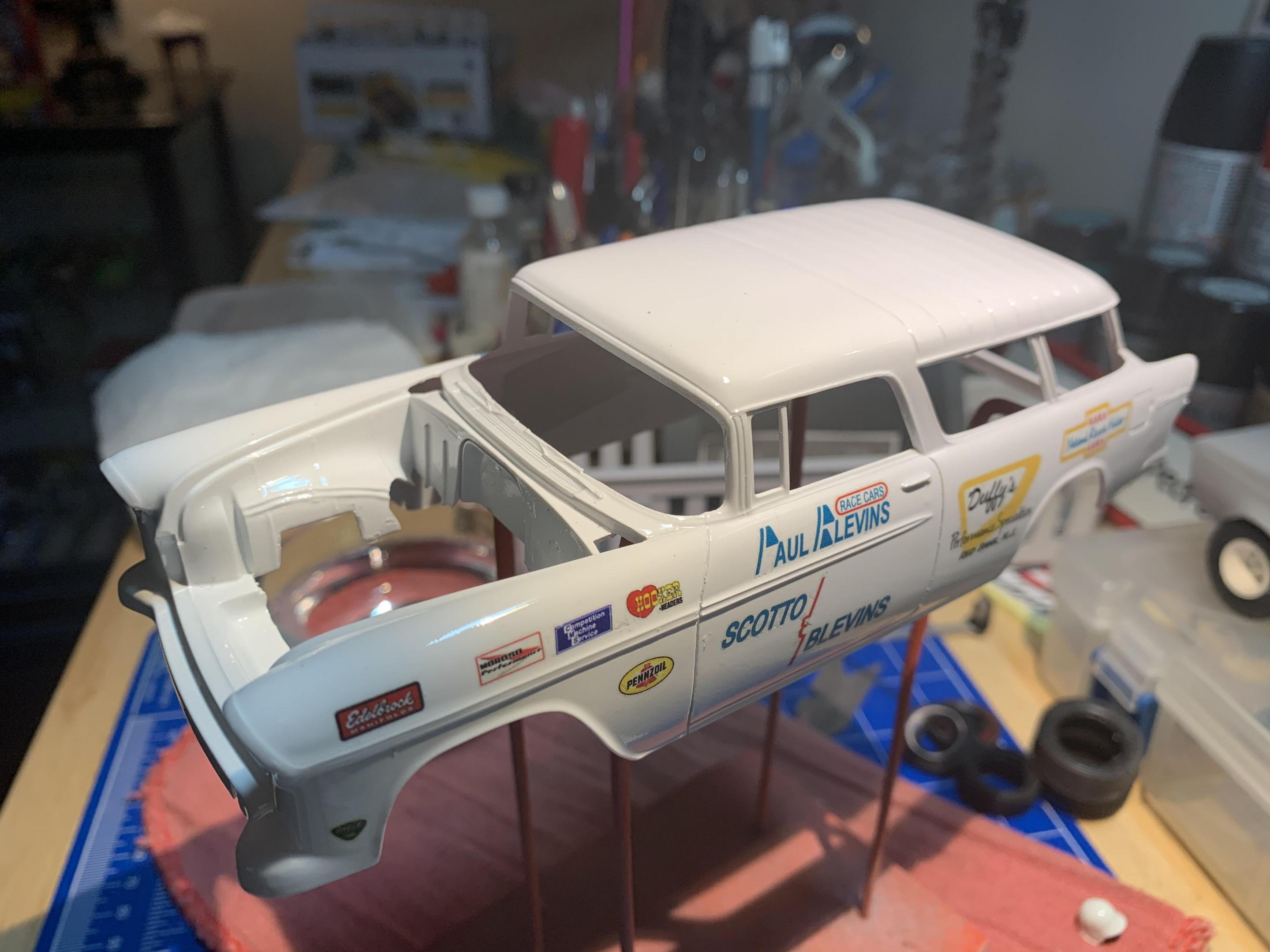

Quick update shot clear coat in 55 degree weather, added decals to fenders. I got tired of waiting for warm weather. It worked. I tried my hand at making fender well headers from solder. It’s not pretty, apparently not in my skill set, no I’m not posting a pic of the failure.

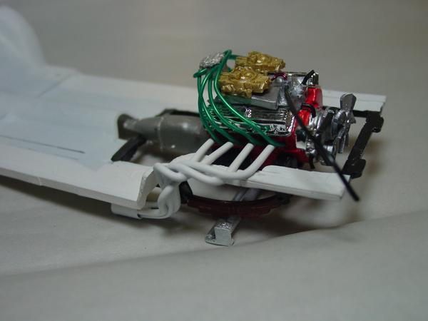

I also love these older drag cars.  You are doing an outstanding job on this one.  If you are not satisfied with your fenderwell headers, simply roll out the pieces of solder between two boards to get them straight and try again.  With a bit of trial and error they really look sweet. This was a set I built for a SCRambler gasser. I started with four pieces of solder glued into holes in the block, the engine is tack glued to the chassis.  I then bent each one to fit the fenderwell area, allowing for tire clearance.
Yeah I did most of what you recommended, mine don’t look anything  like yours, yours are very well done!

Wow I can’t believe the last time I posted was in February, since then I’ve moved my daughter back from Indiana and had little to no bench time. I really hate to loose the momentum I had building last year, so I’m trying to push a little more.

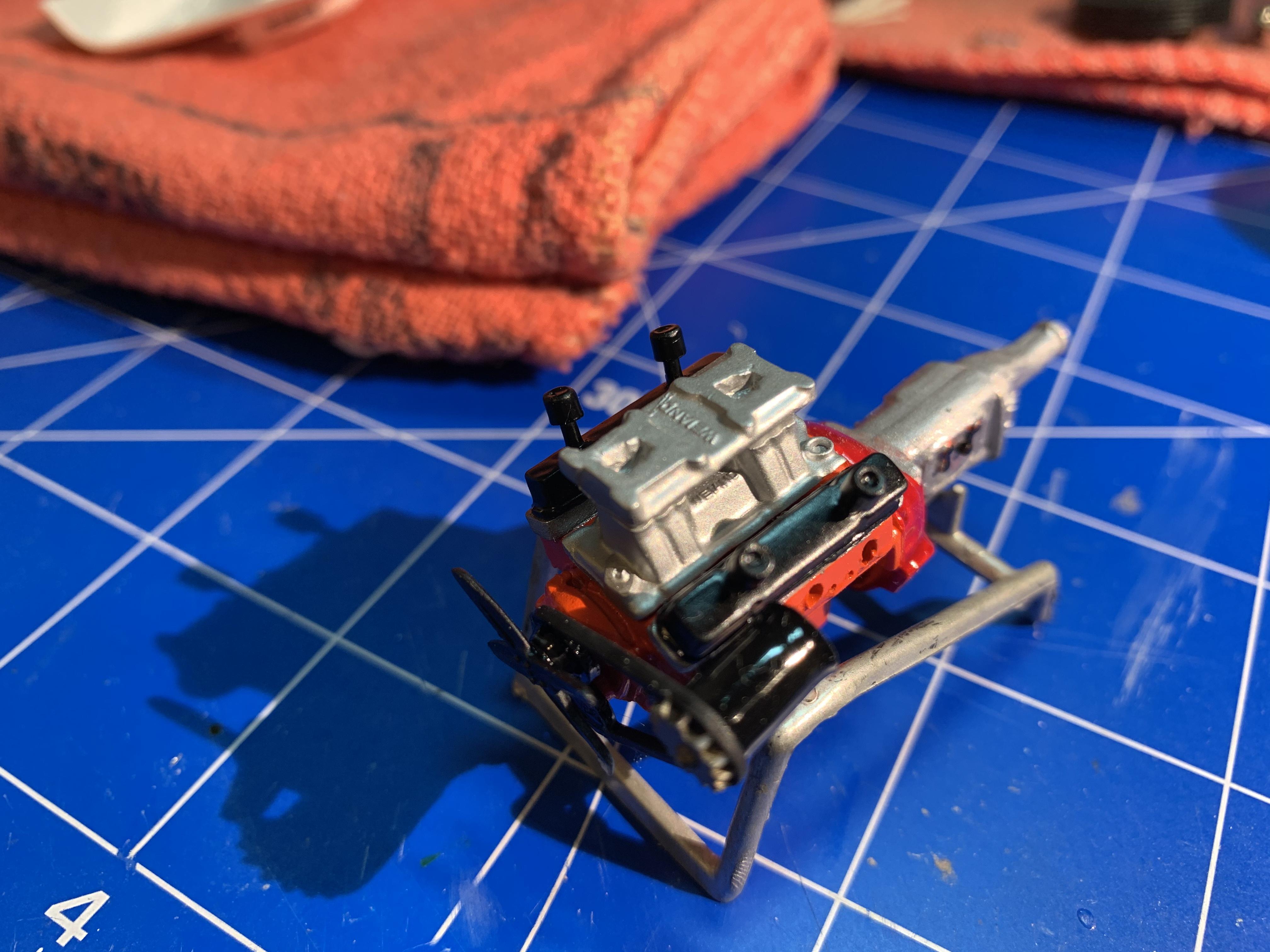

Small update, I got the gages added to the interior, the chassis is done except for the drive shaft safety loop. The chrome trim is done and the glass installed. I’ve added spark plug wires to the engine. I’m getting close
