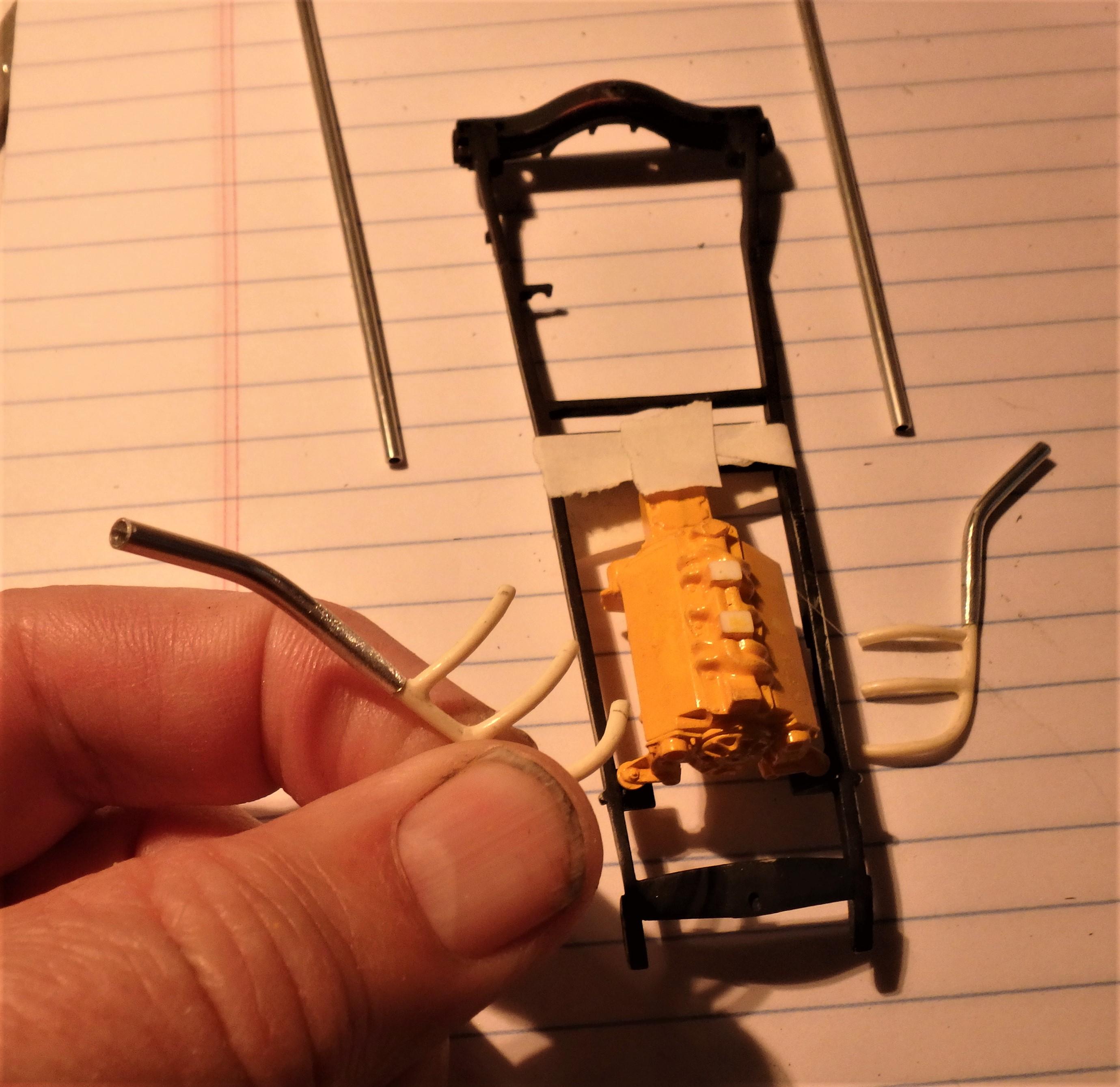

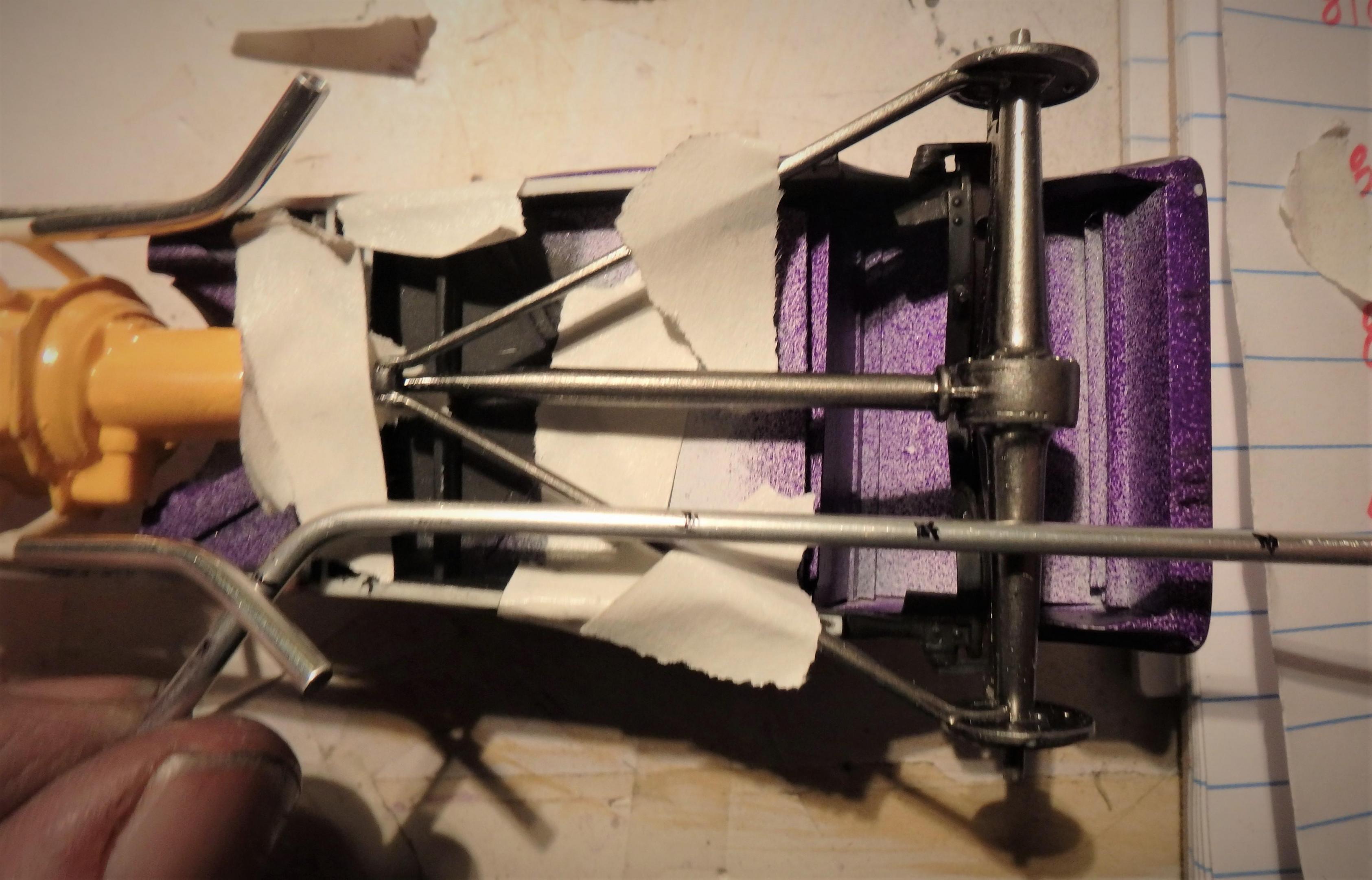

Working on the flathead exhaust headers....this is a R&M part...will need to break out some K&S aluminum tubing or brass rod...for the extensions and under frame mufflers.
  • Like 1

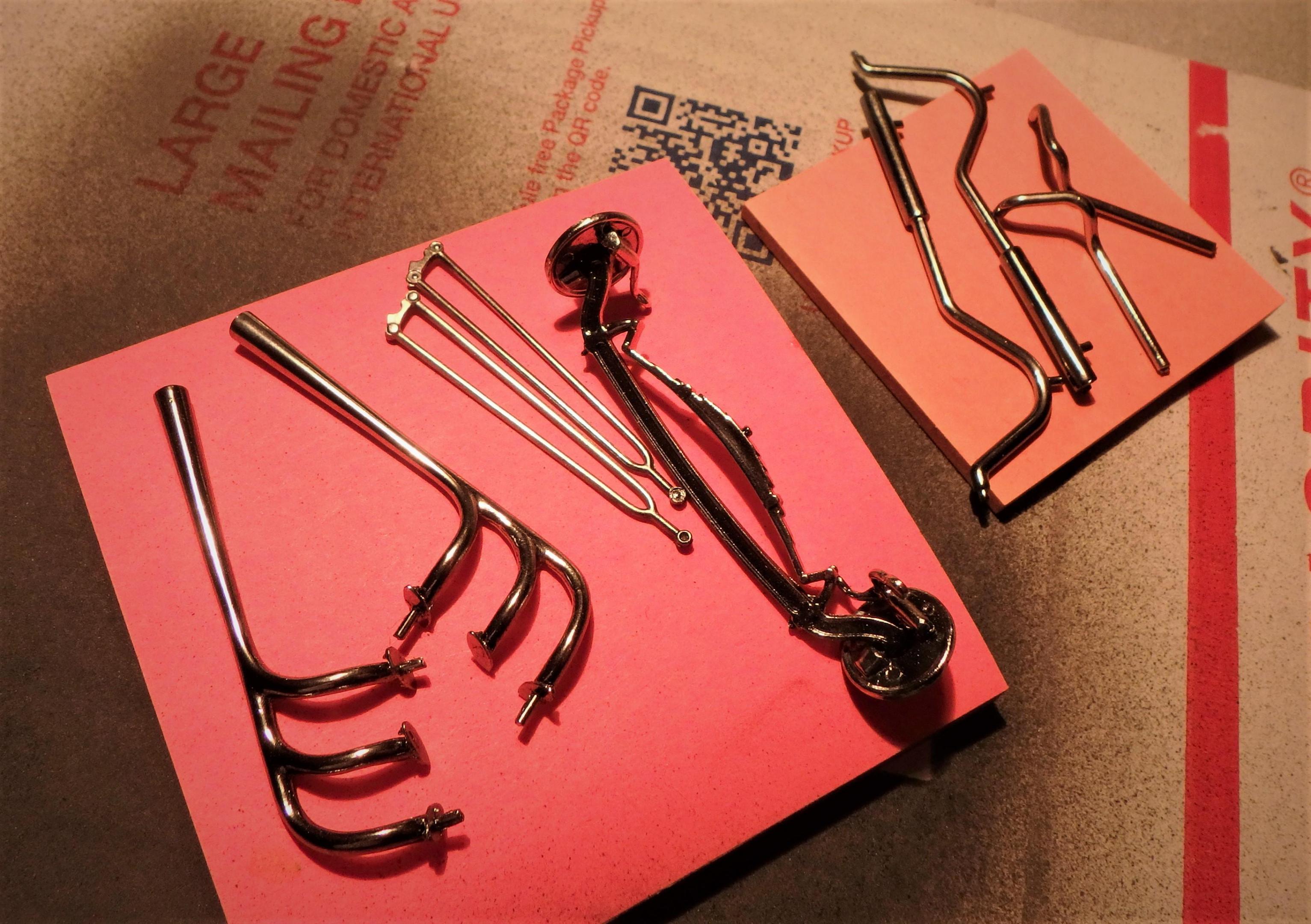

Worked on the exhaust headers....R&M #DD-10 - Cut off the collector on the end of each resin piece, bent a piece of 3/32 inch aluminum tube (using a styrene rod insert to prevent kinking) to fit over the 1/16 inch of each header.
Filed the tubing sides to taper the joint to match resin header OD. Headers will be plugged type for street.
Measuring exhaust extension to connect to the plugged headers and fit under frame with dual exhaust mufflers.
  • Like 1

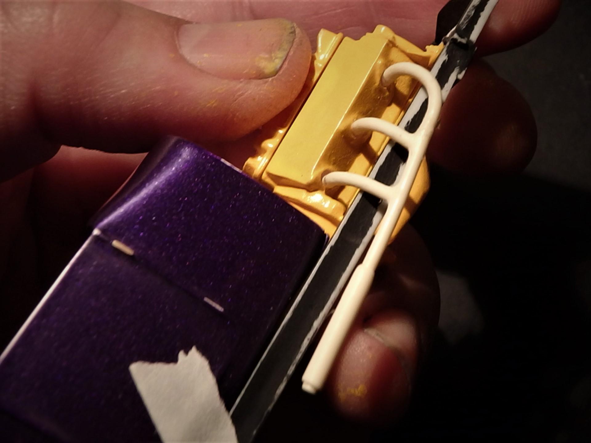

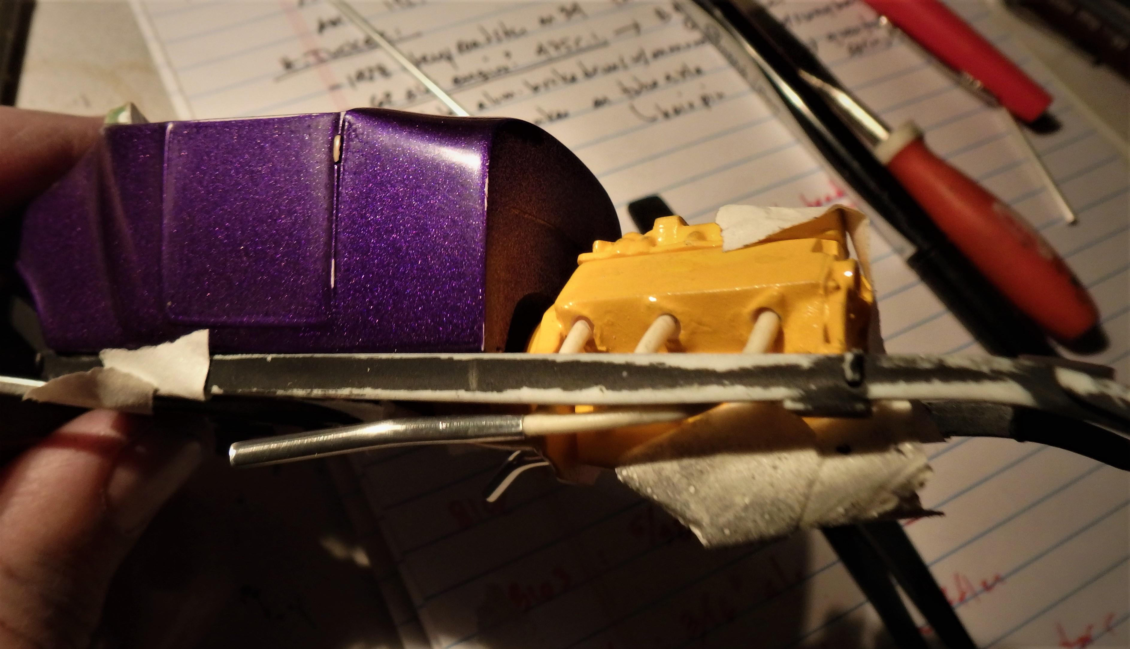

Having some issues routing the dual exhausts from the plugged headers.
I can only bend aluminum tube so much w/o kinking or breaking.
I got thee minor bends using finger pressure with a styrene rod inserted in each to prevent kinking.
  • Like 1

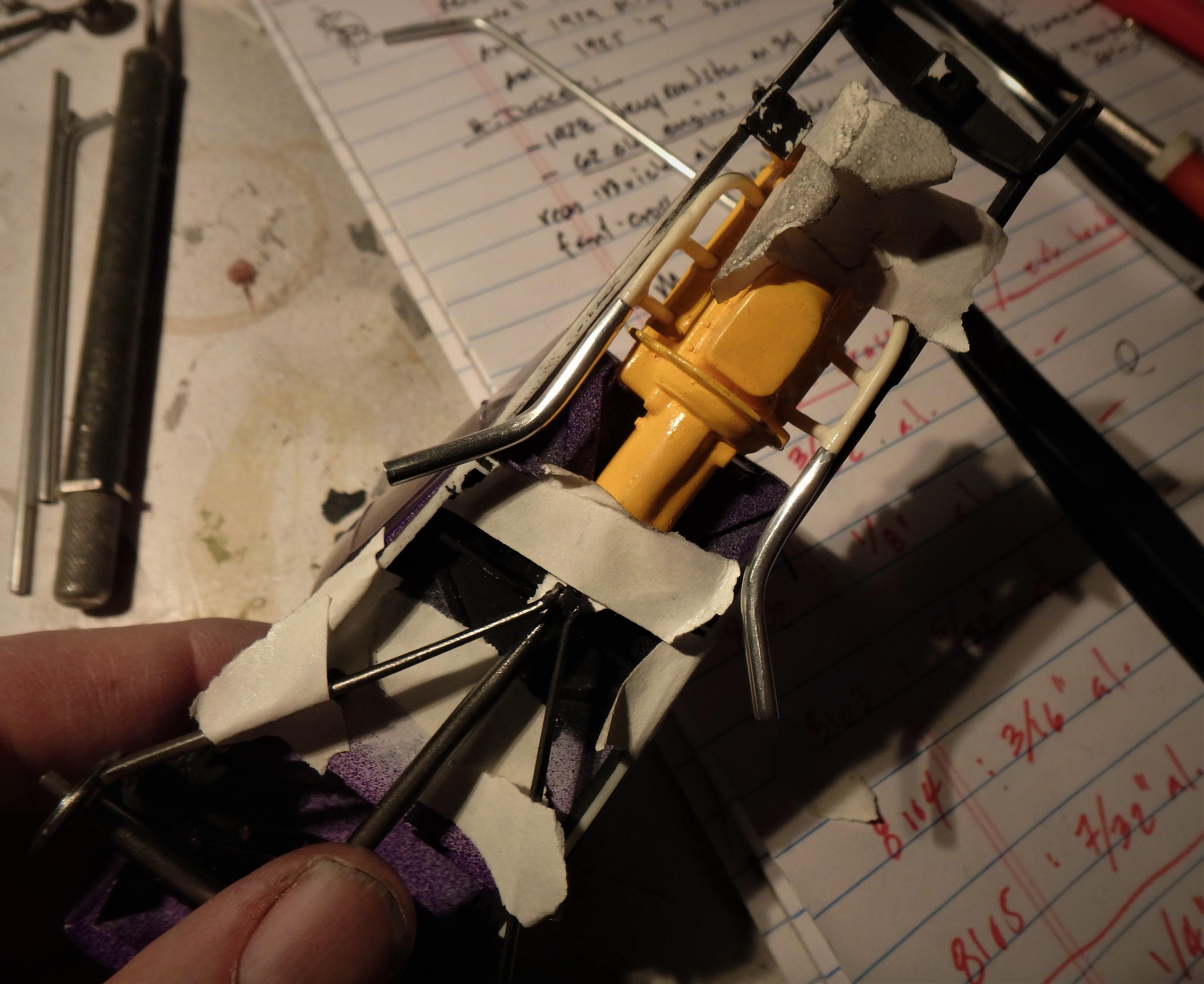

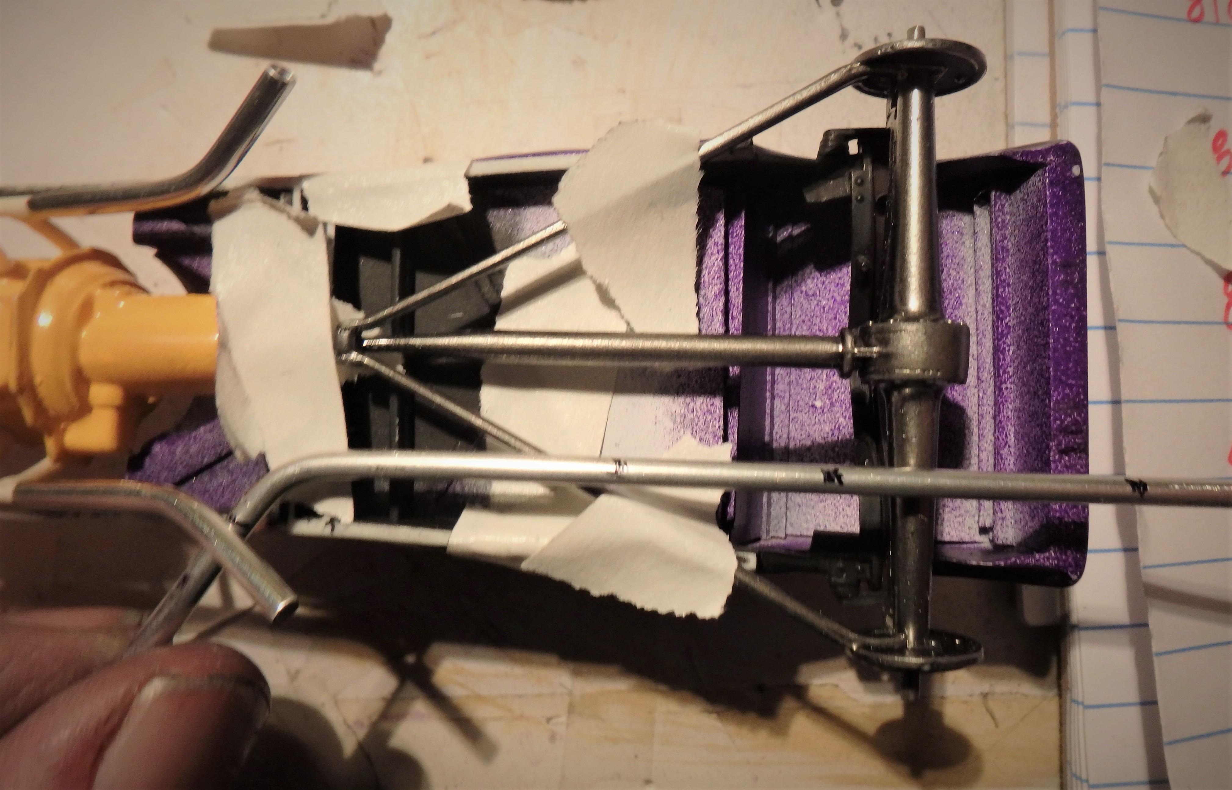

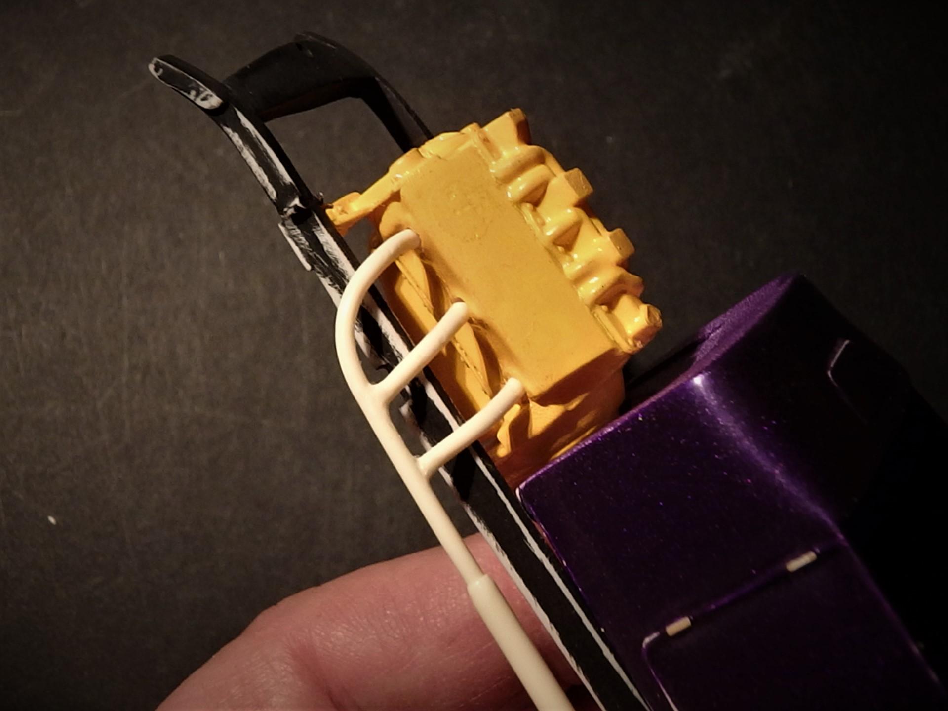

Decided to look at an alternative to hanging the exhaust pipes and mufflers under the axle.
Did not want to figure out how to put the necessary sharp bends in aluminum tubing to route it thru the leaf spring and rear axle.....the exhaust train from the Revell Model A roadster looks like it will fit.
I got a set of headers from Replicas and Miniatures , applied Alclad to these.
  • Like 1

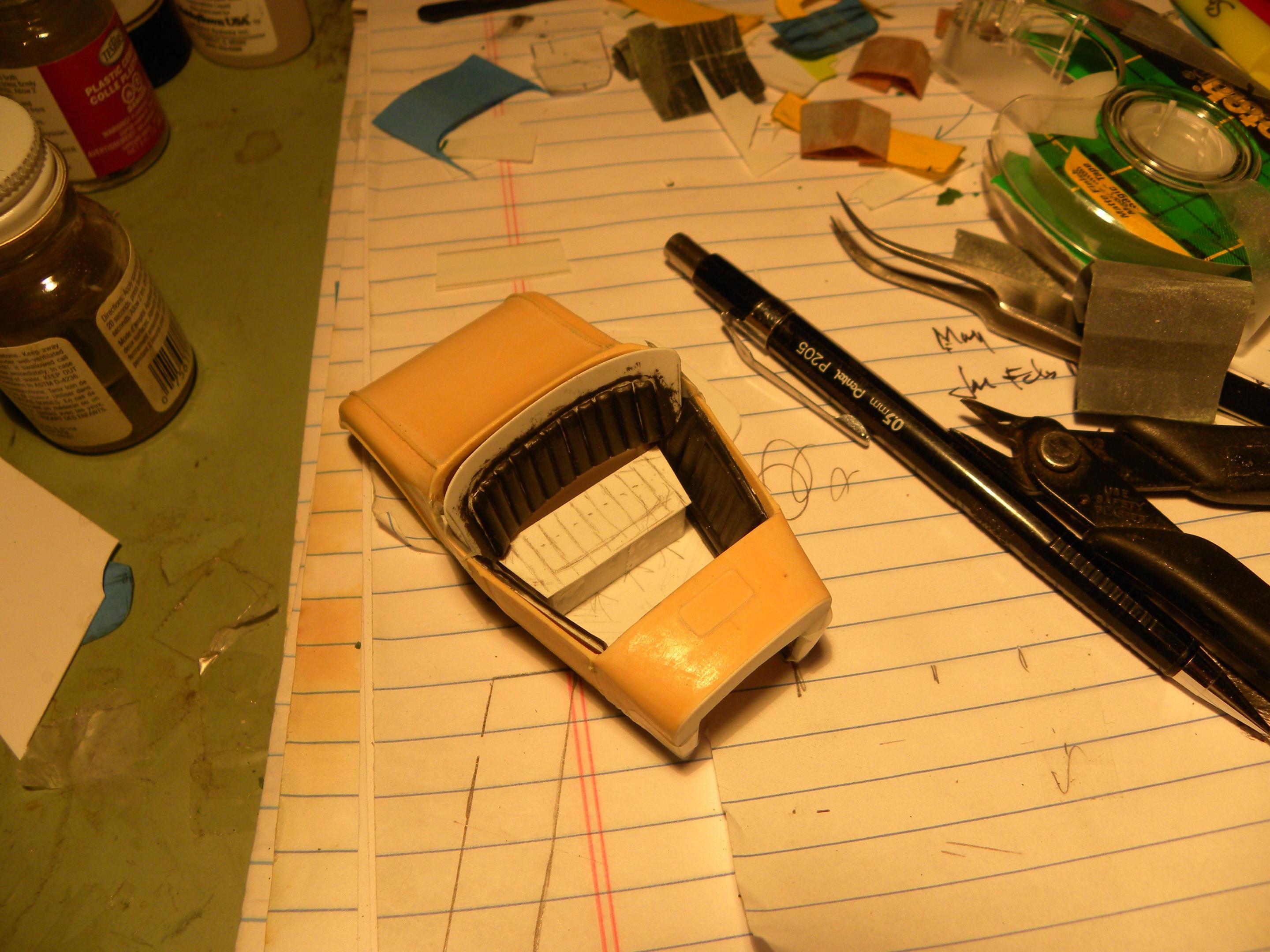

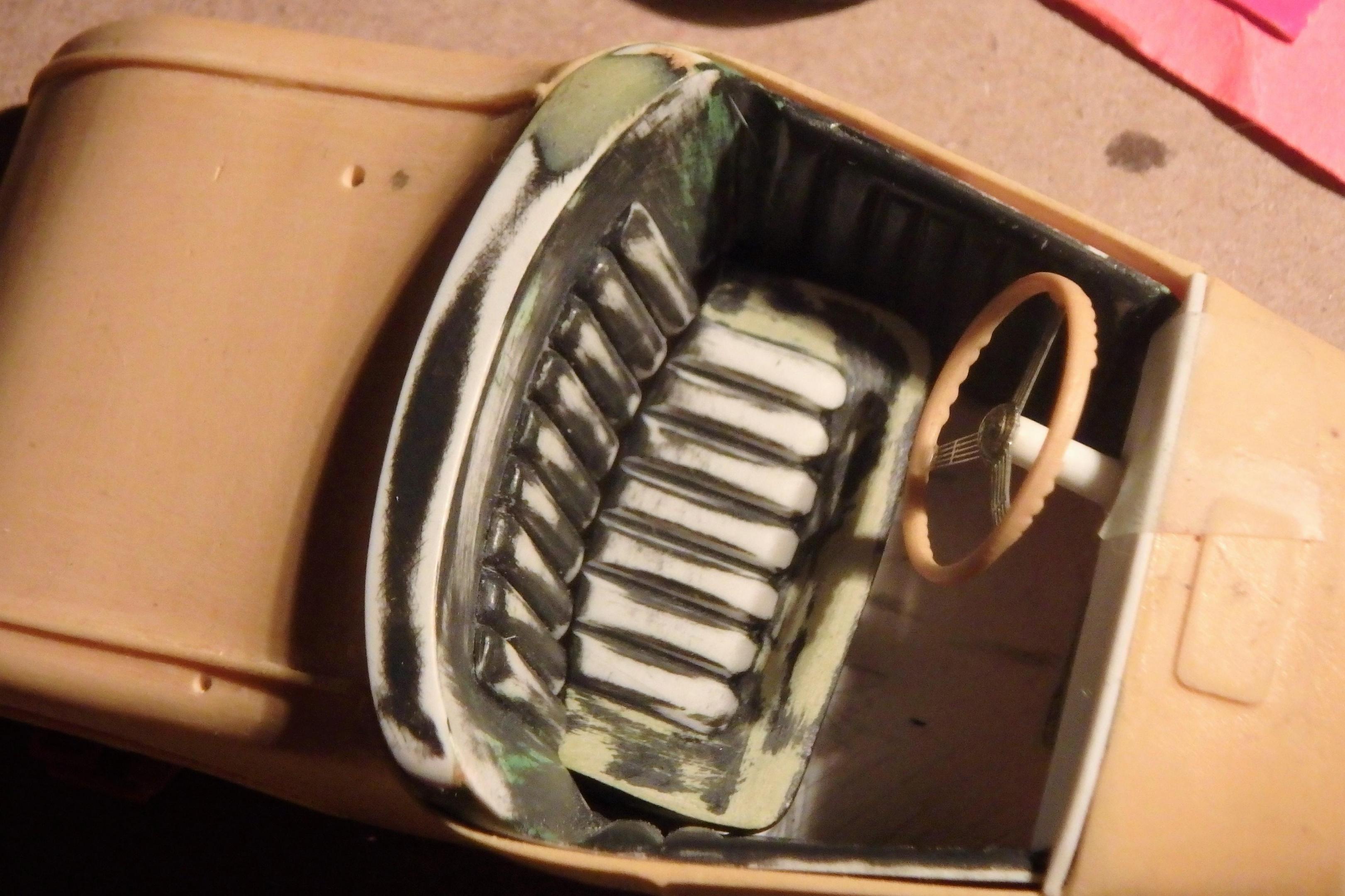

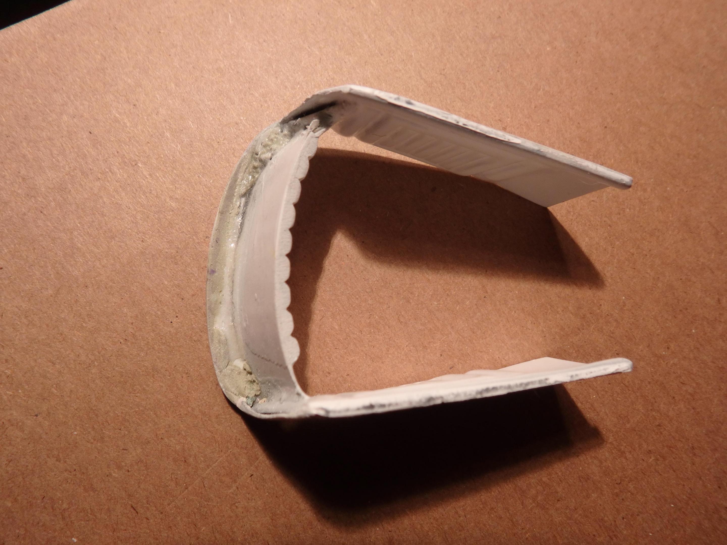

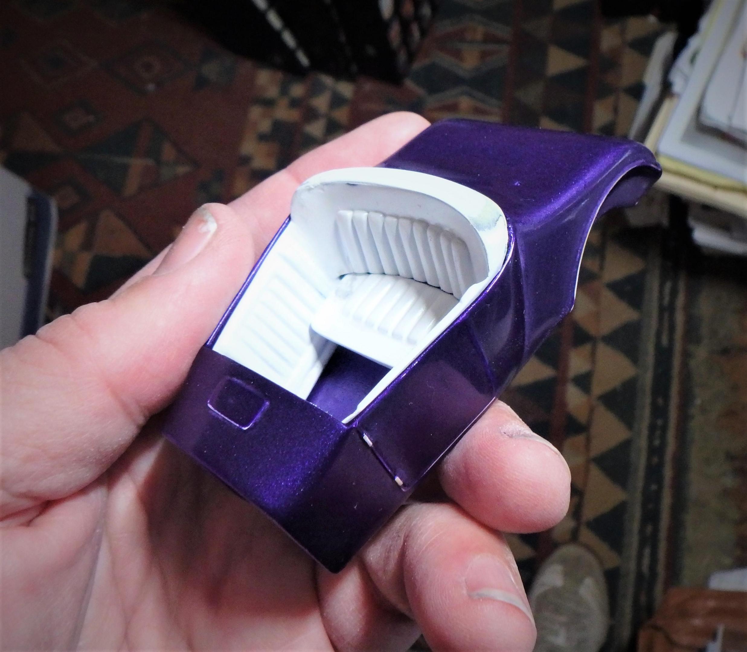

Beautiful work you're doing here. I did a 27T hiboy several years ago and I can report that this was among the most challenging projects I gad attempted up to that point. In particular is the fact that there are virtually zero parts that are a straight fit for the body shell, not chassis, nt interior bits, nor windshield. That model has I built has suffered over the years and needs either a re-do or perhaps an entire second version. I've already noted the gorgeous interior you've crafted and I'm looking forward to you tackling the windshield. How did you maintain the curvature of the seat back during fabrication?
On 1/22/2021 at 3:54 PM, SpeedShift said:
Had to scratch build an interior for the body shell. Plastic sheet and evergreen strip provides the tuck and roll.
On 1/22/2021 at 3:56 PM, SpeedShift said:
Here's a composite pic of my first attempt, which was on Revell '32 Ford rails.
  • Like 2
That's a really good looking 27 T you built there. I see you placed it on a 32 frame and it sits well.
I debated using a '32 frame but wanted to try a Z'd model A frame and was following some tips I had read in Plastic Fanatic at the time (Dan Harrison's excellent five part series "A Tale of Two Roadsters - a great read).
On the curved interior...I should have taken more pictures back when I started.
The curved seat back is held temporarily in place when inserted into the cockpit, and I think I glued the edges of that to each R & L door side panels .
What I would call the coaming (for lack of a better term) that runs along the top/rear is also curved and the helps hold the curved seat back.
I put dabs of Milliput epoxy putty on each corner underneath (see picture) and after it set up,  it held the shape pretty good permanently for future trial fitting, sanding etc..

Finally got enough white base coat on the seats to apply a final pearl finish - and then masked off the seats to paint pleated inserts black.
  • Like 1

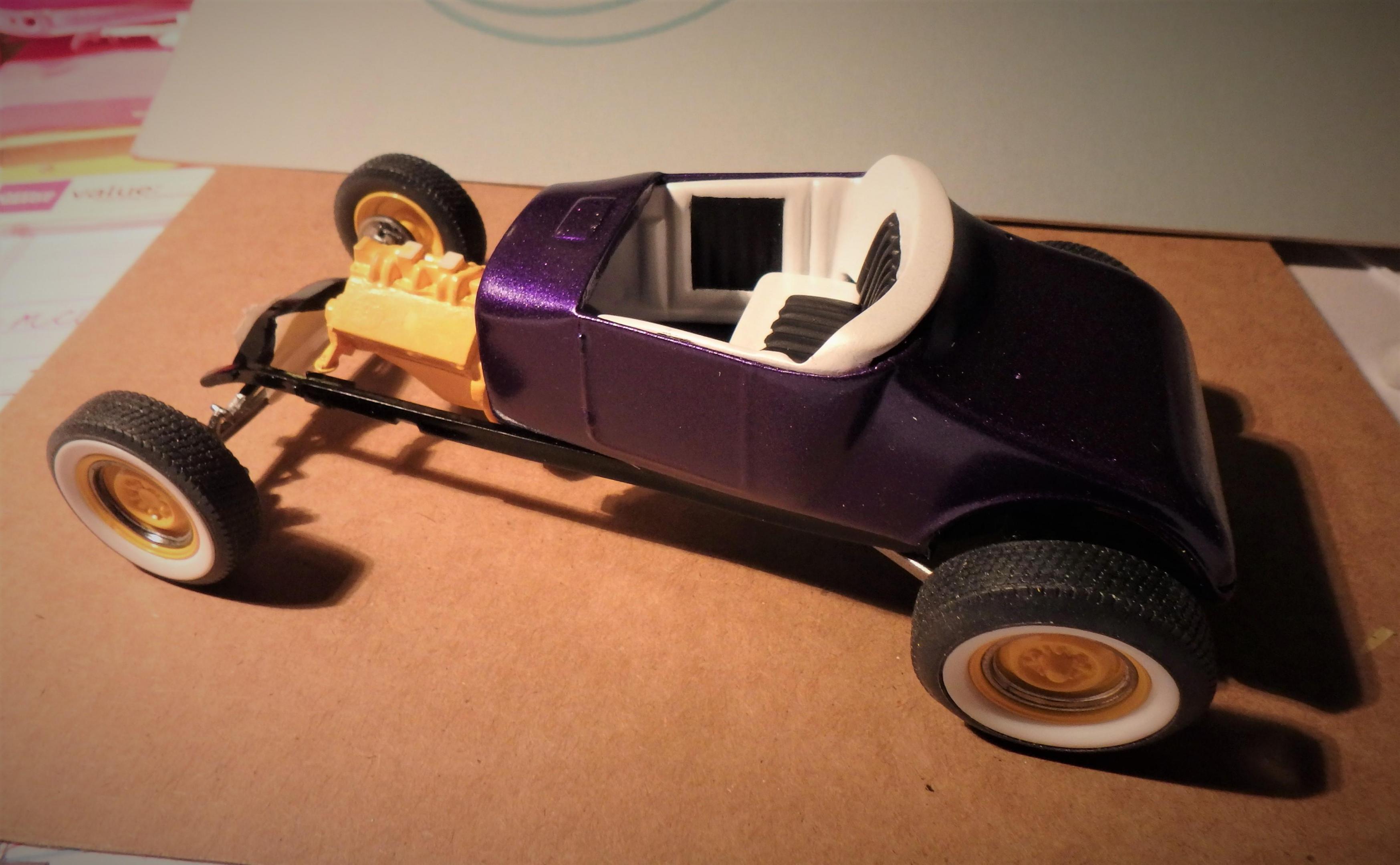

Thanks.

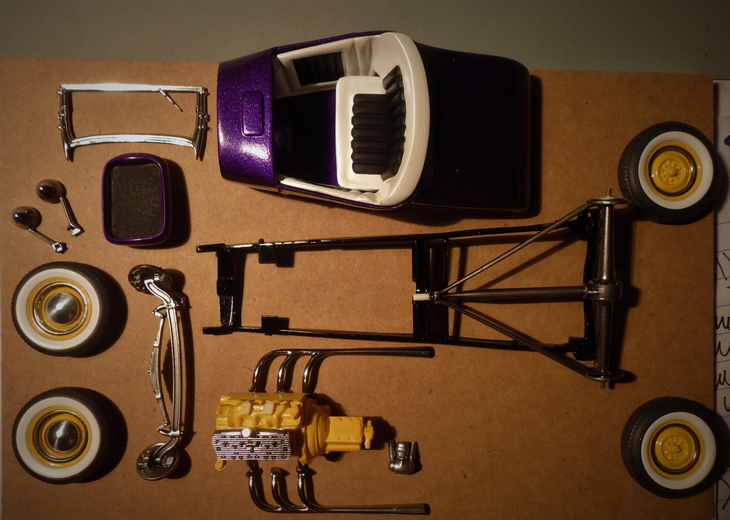

I did a tape together mock up to check things over.
The steelie wheels have trim rings installed, will get chrome baby moons.
Engine has exhaust system in ALCLAD, but needs all the hop up parts.
Chassis needs some detailing, tie rods and drag link.
The interior needs dash board, gauges and steering column.
Windshield frame is chromed, as are headlight brackets. Think I've sourced some vintage tear drop tail lights.
Think I see light at the end of the tunnel, might get this one done.
  • Like 2
