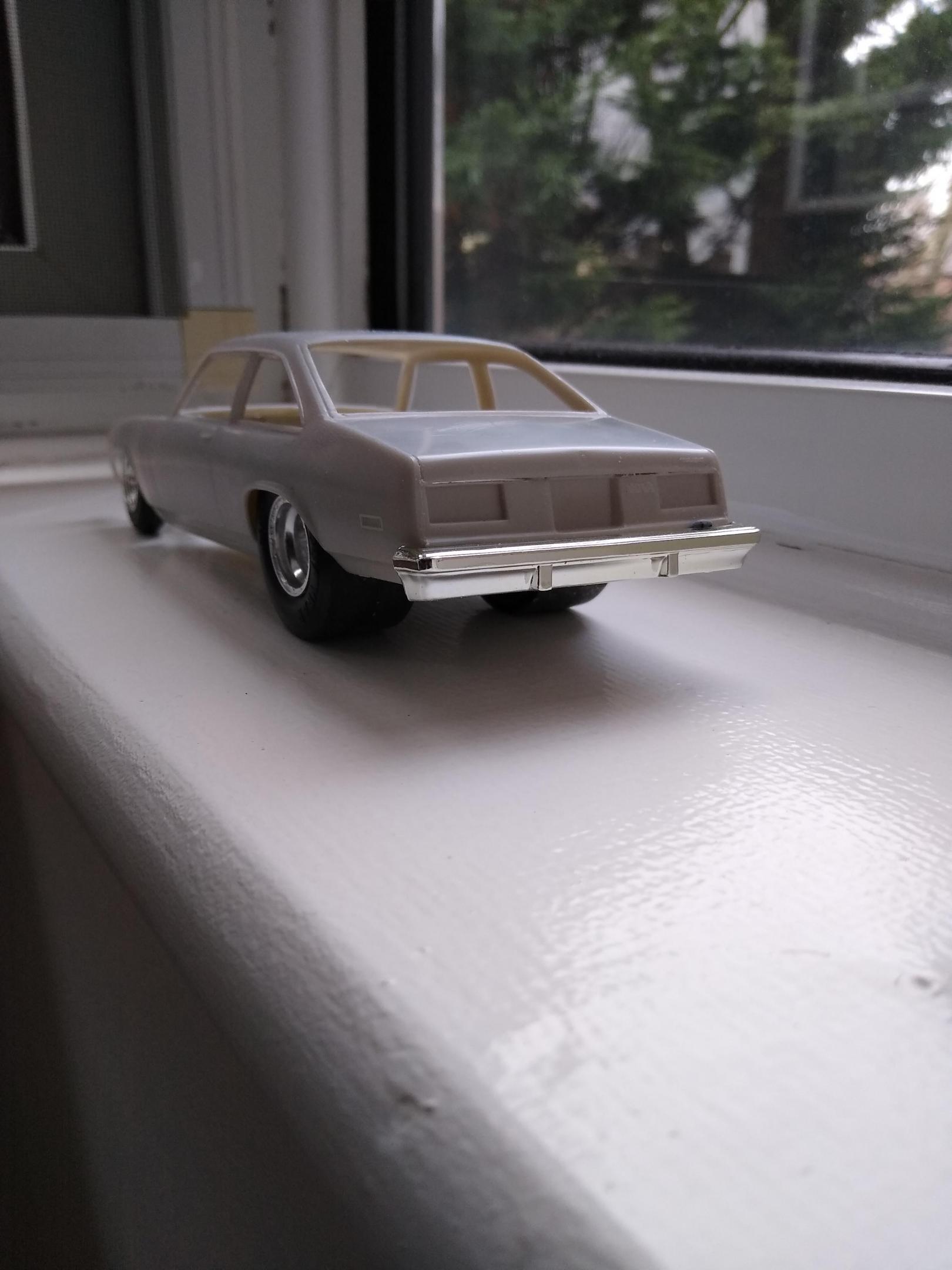

It appears to be a clean looking body with well defined panel lines around the doors. Didn't realize there wasn't a back seat on this one.
And yeah, I've joined the club having just received the MPC '79 Nova a couple of days ago and looking forward to building mine.

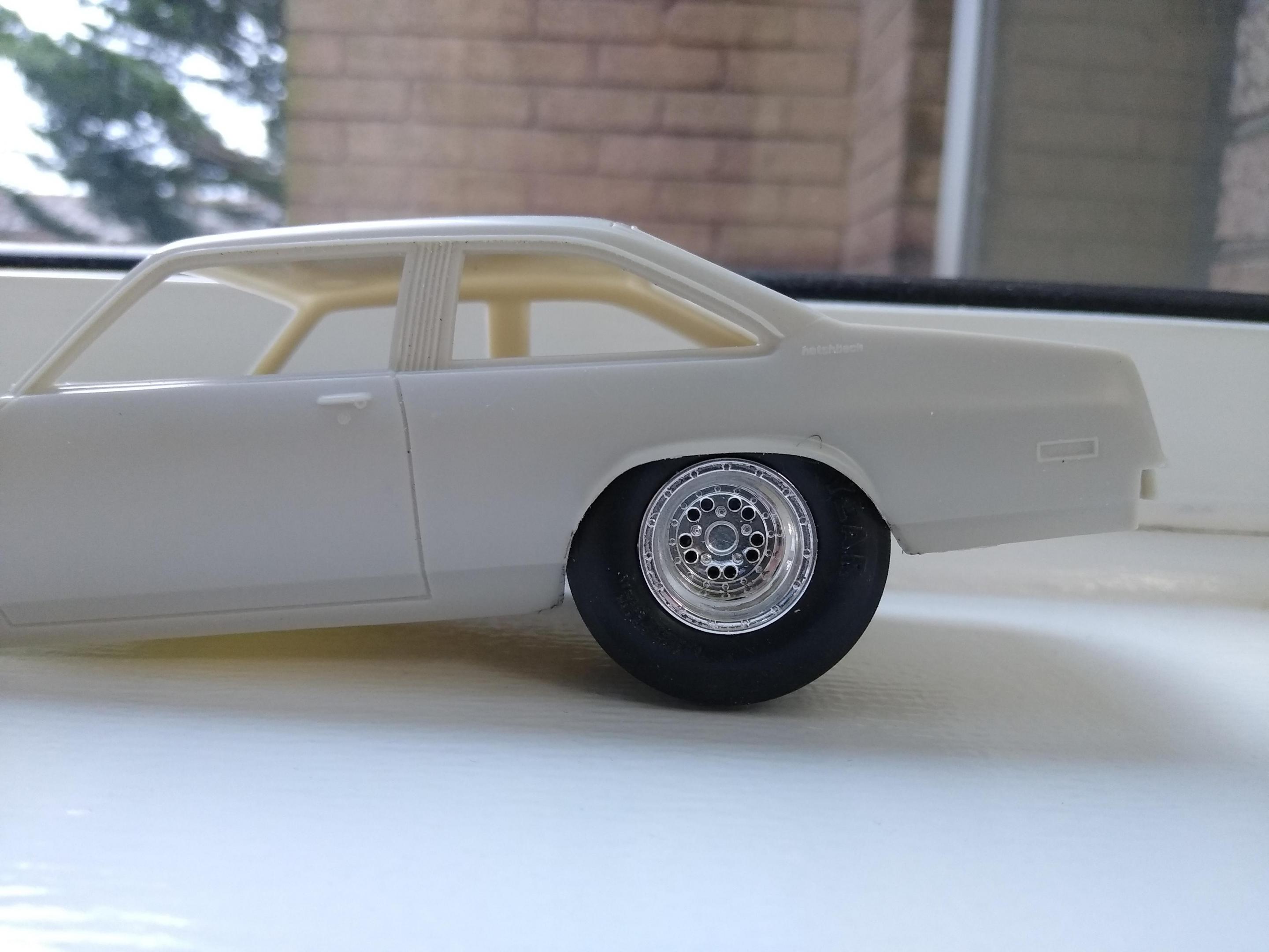

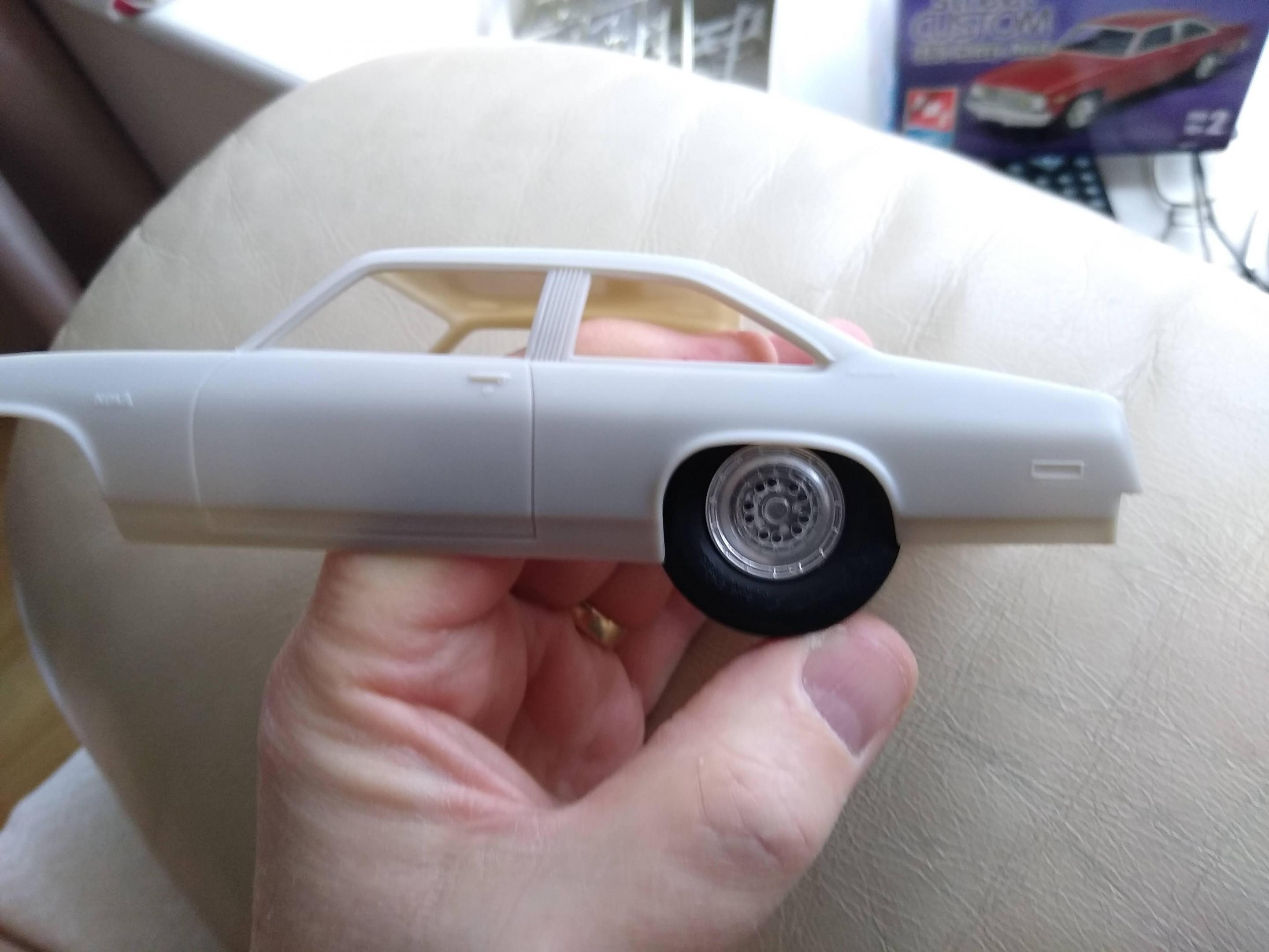

Thanks, I can't wait to mock the rear wheels up but it can't get them past the sill at the moment, some reprofiling of the arch required I think. If I narrow the axle anymore it'll just be a diff with two tyres. What have I done to  myself!?

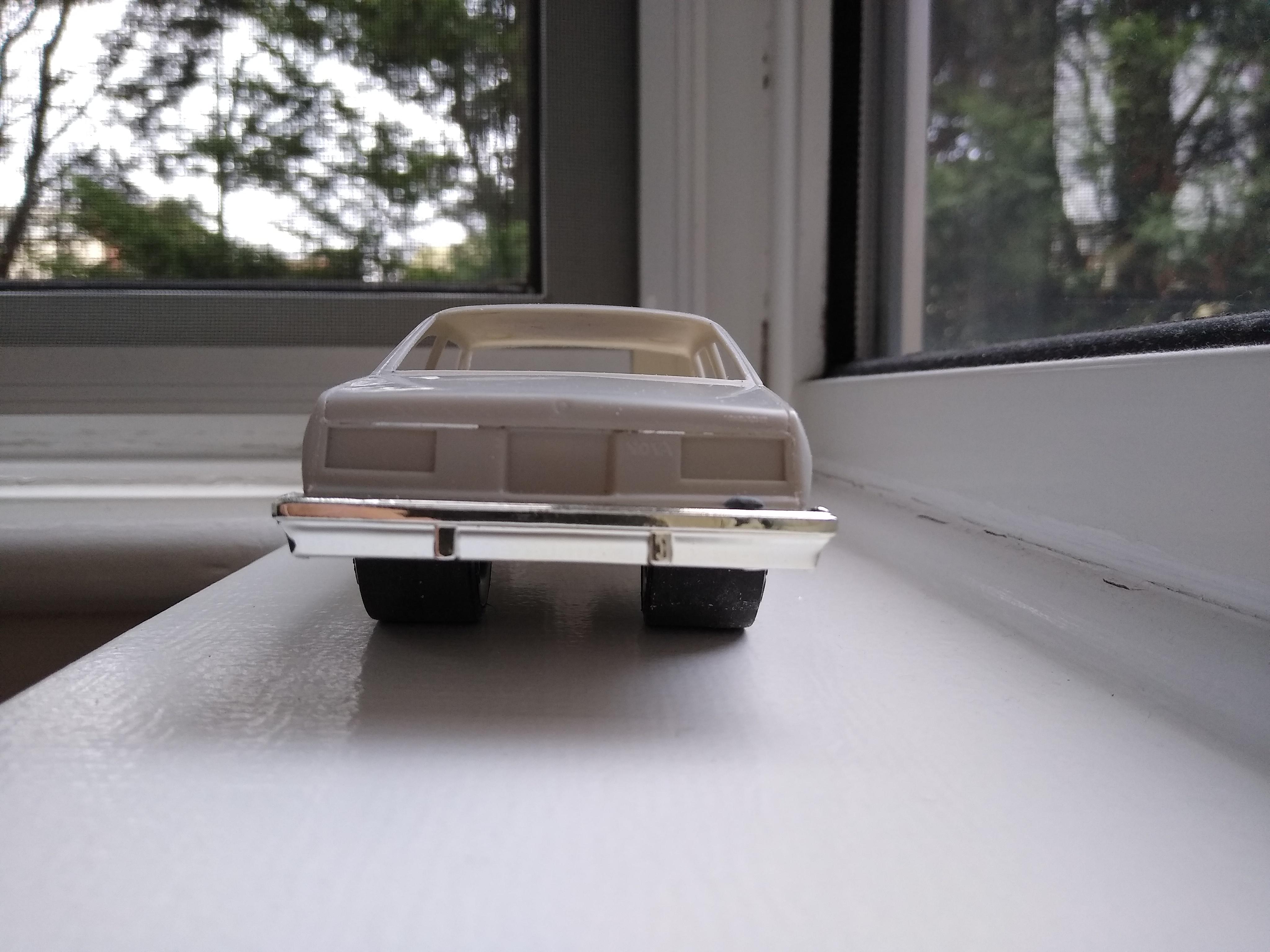

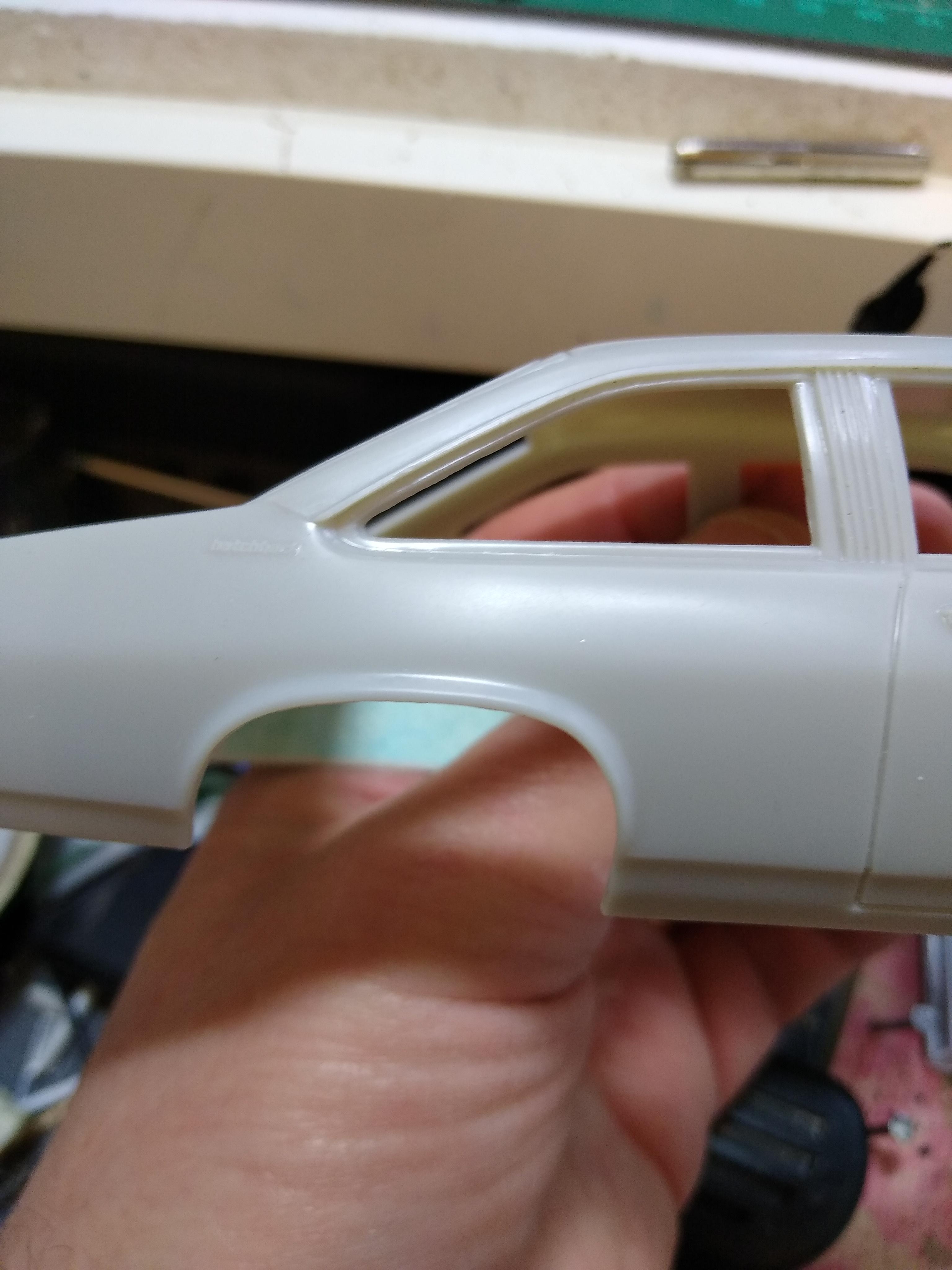

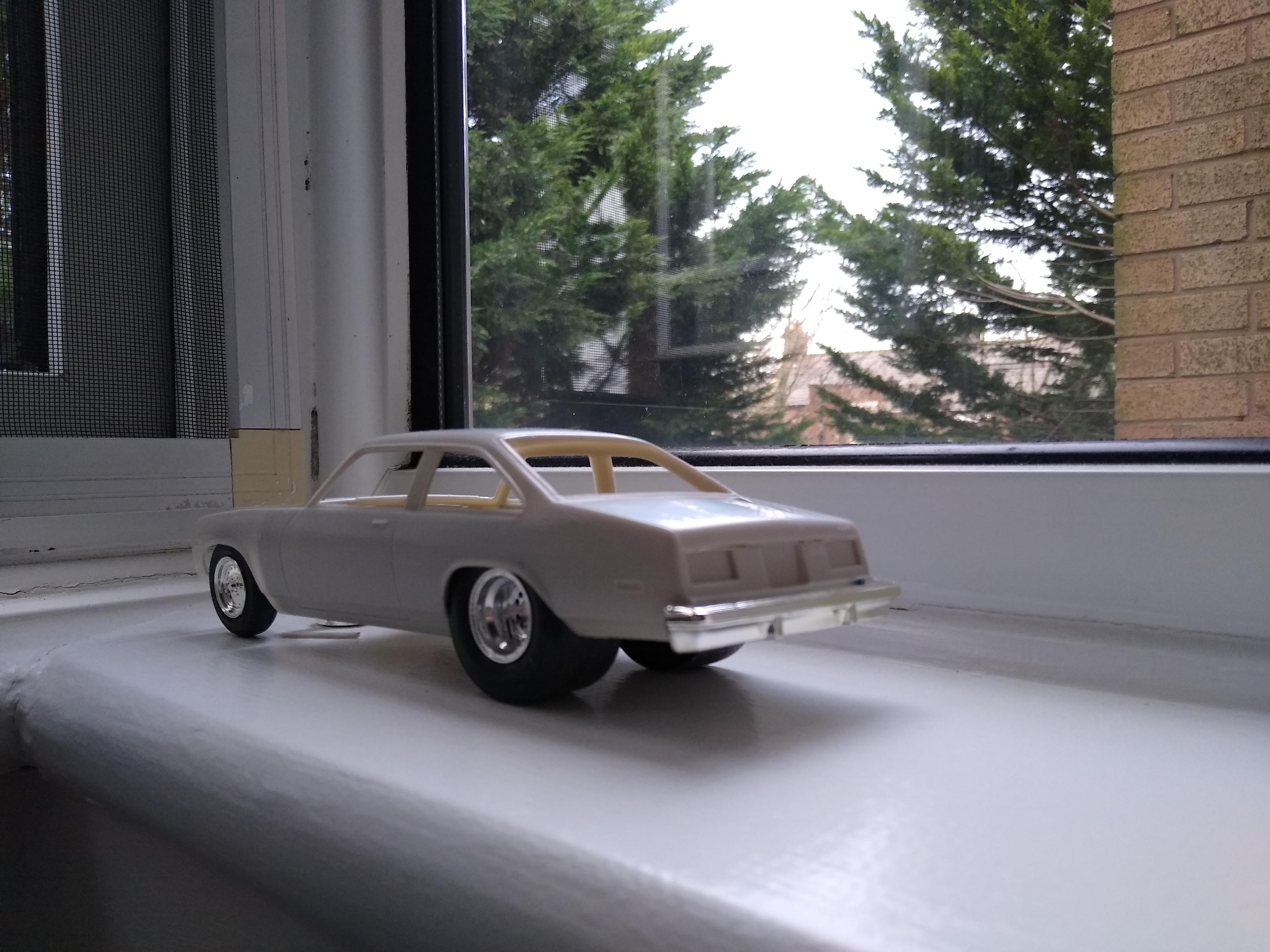

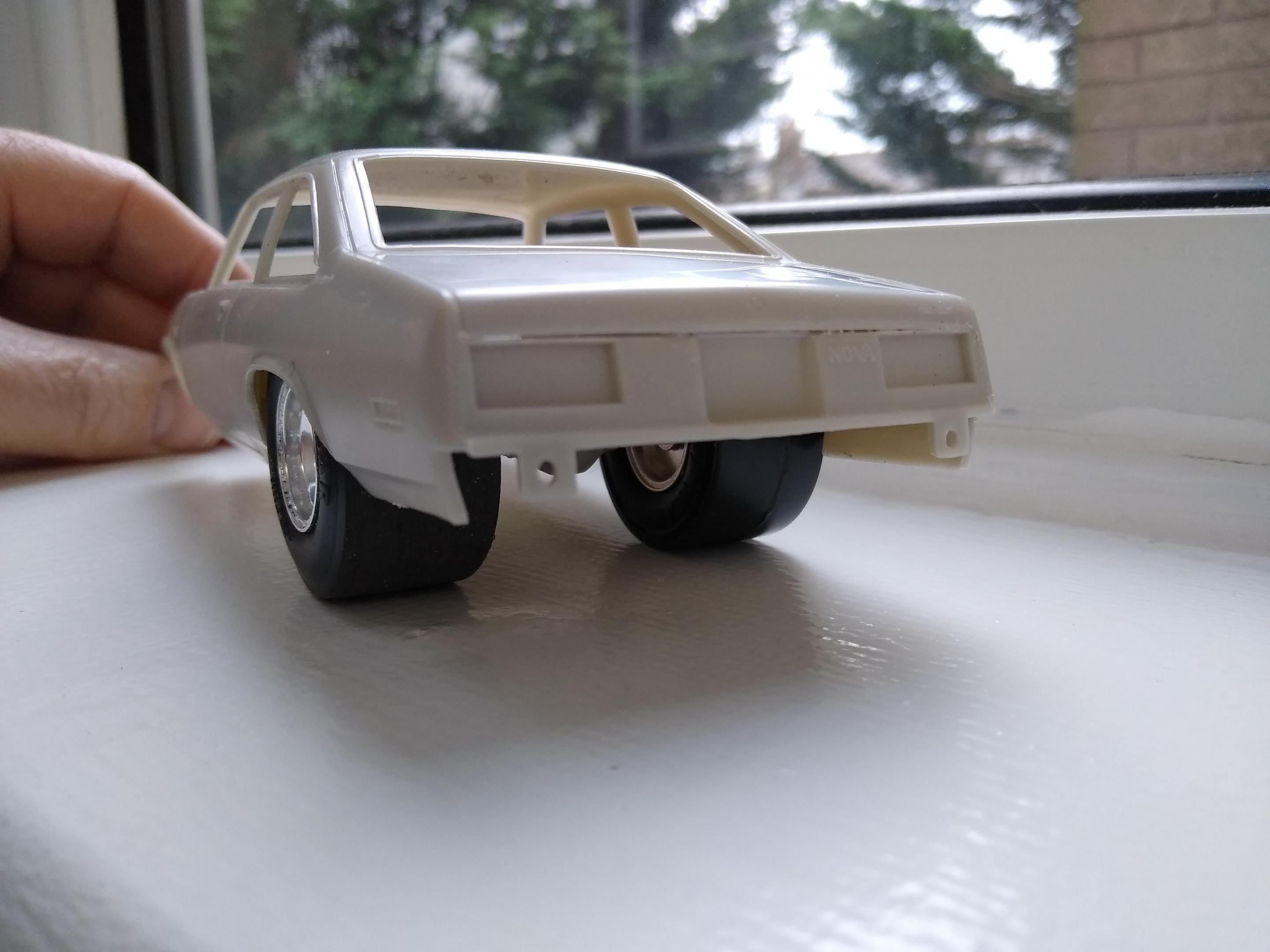

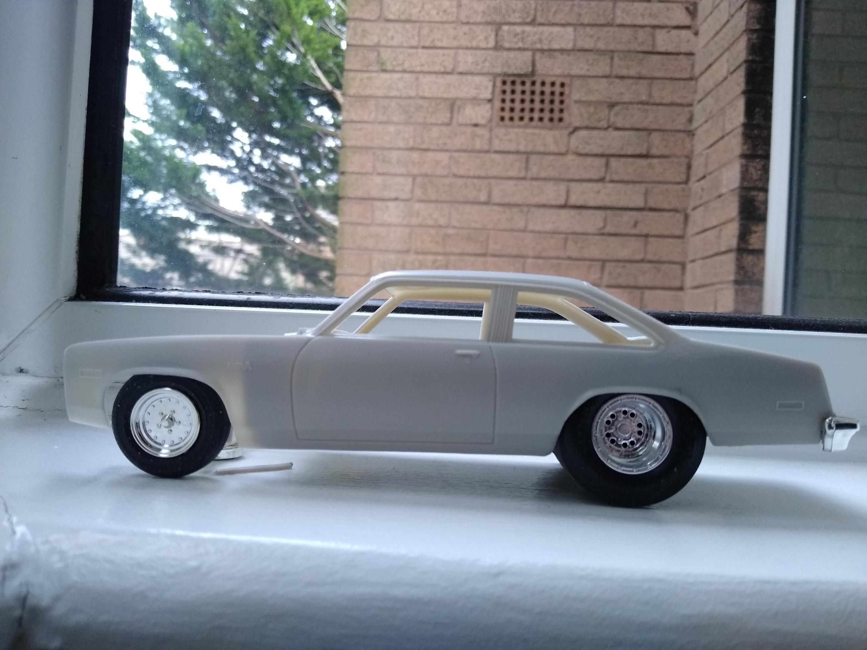

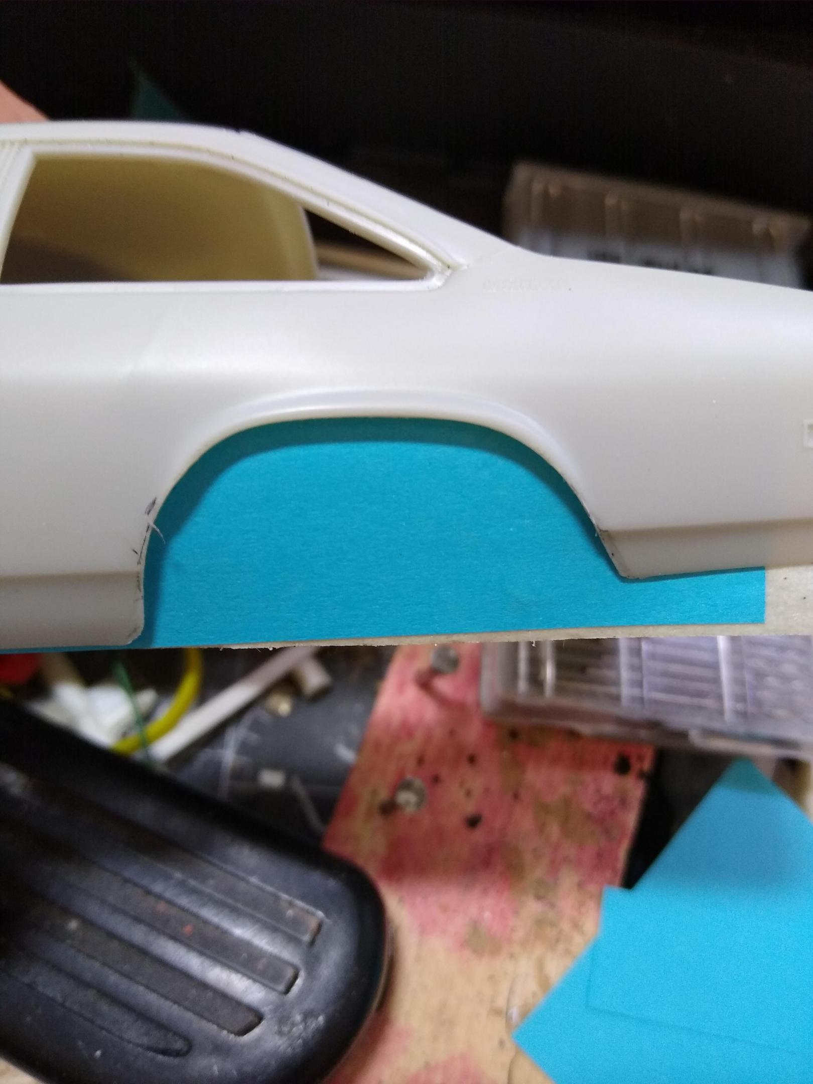

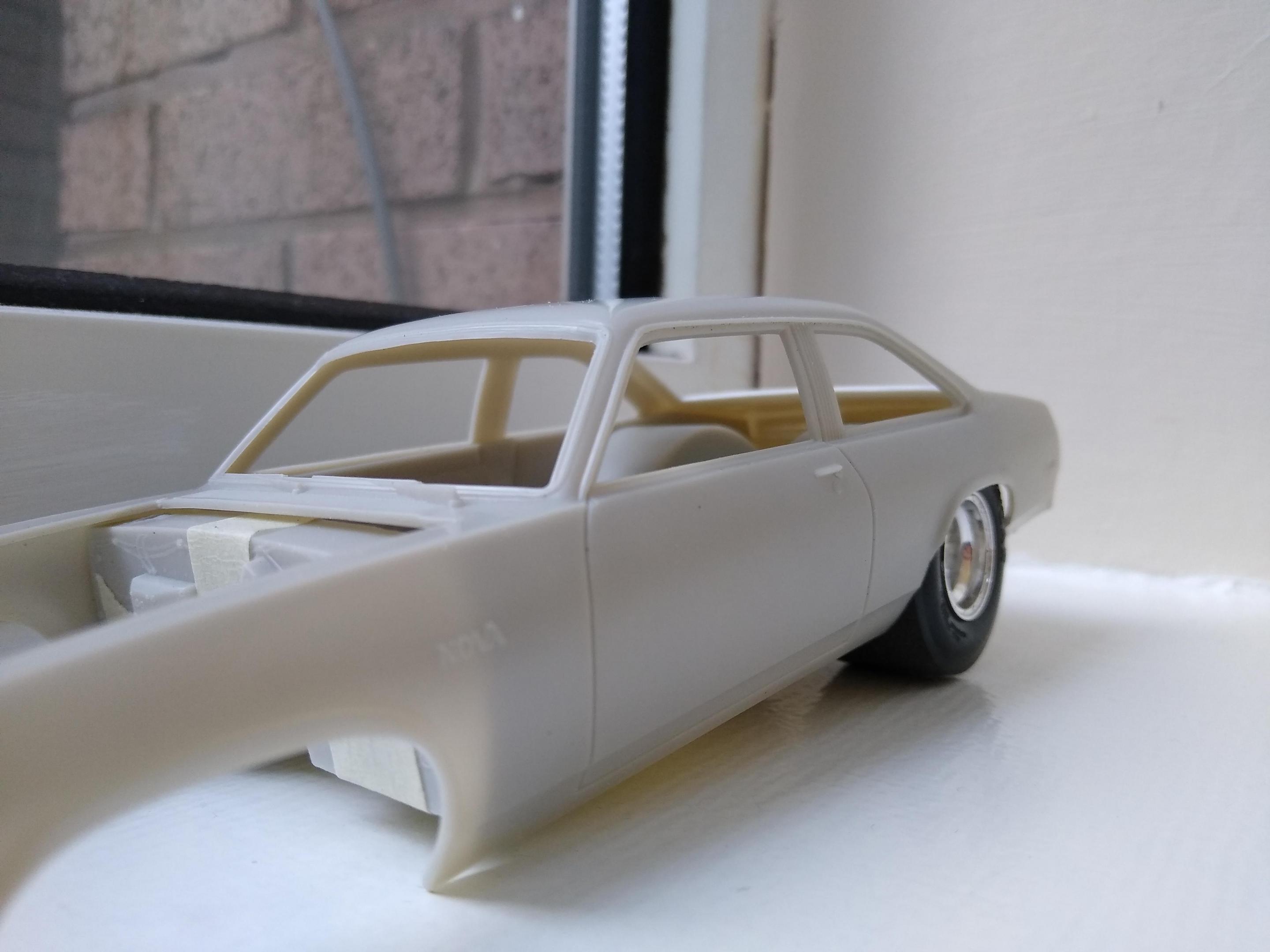

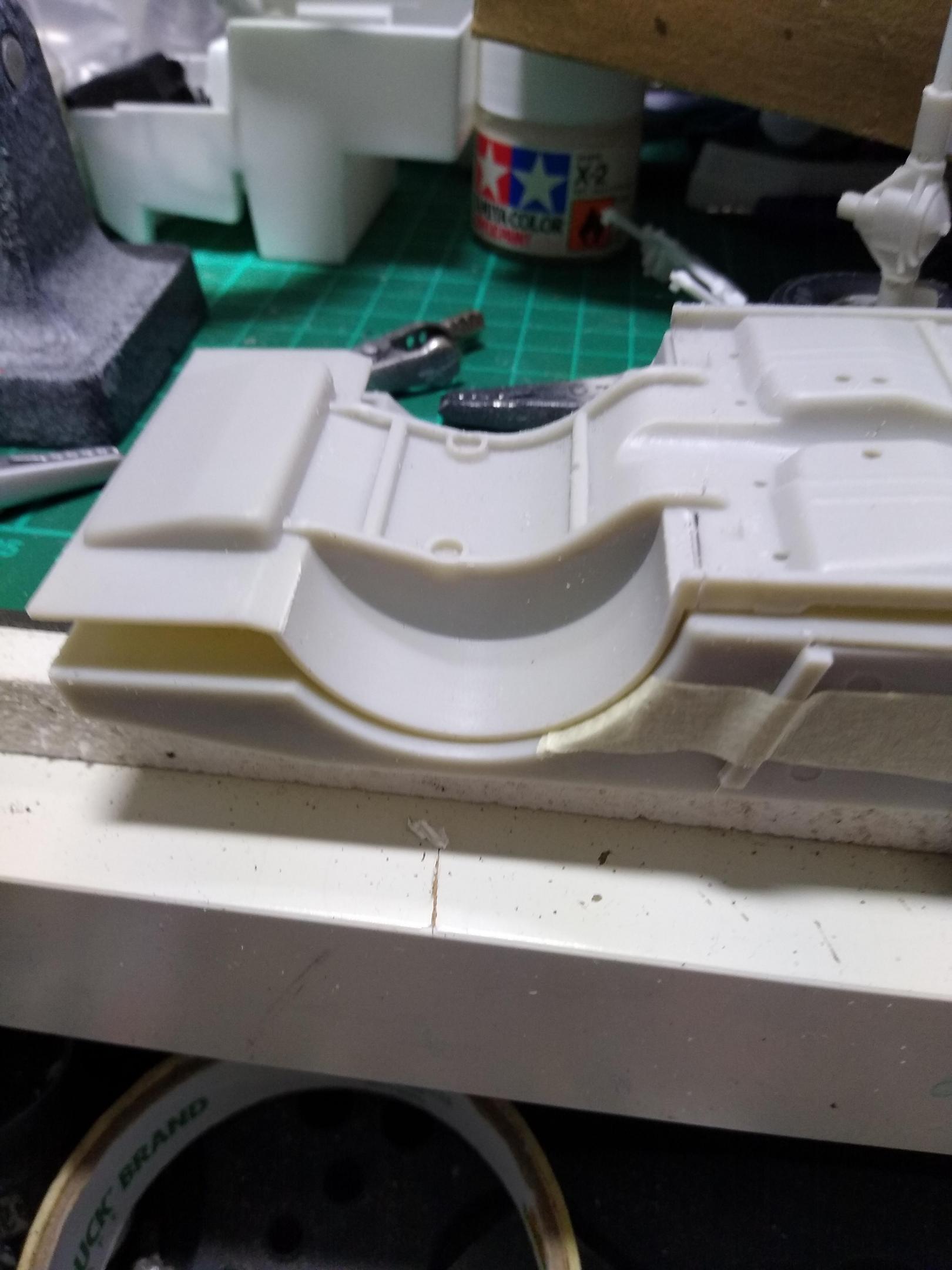

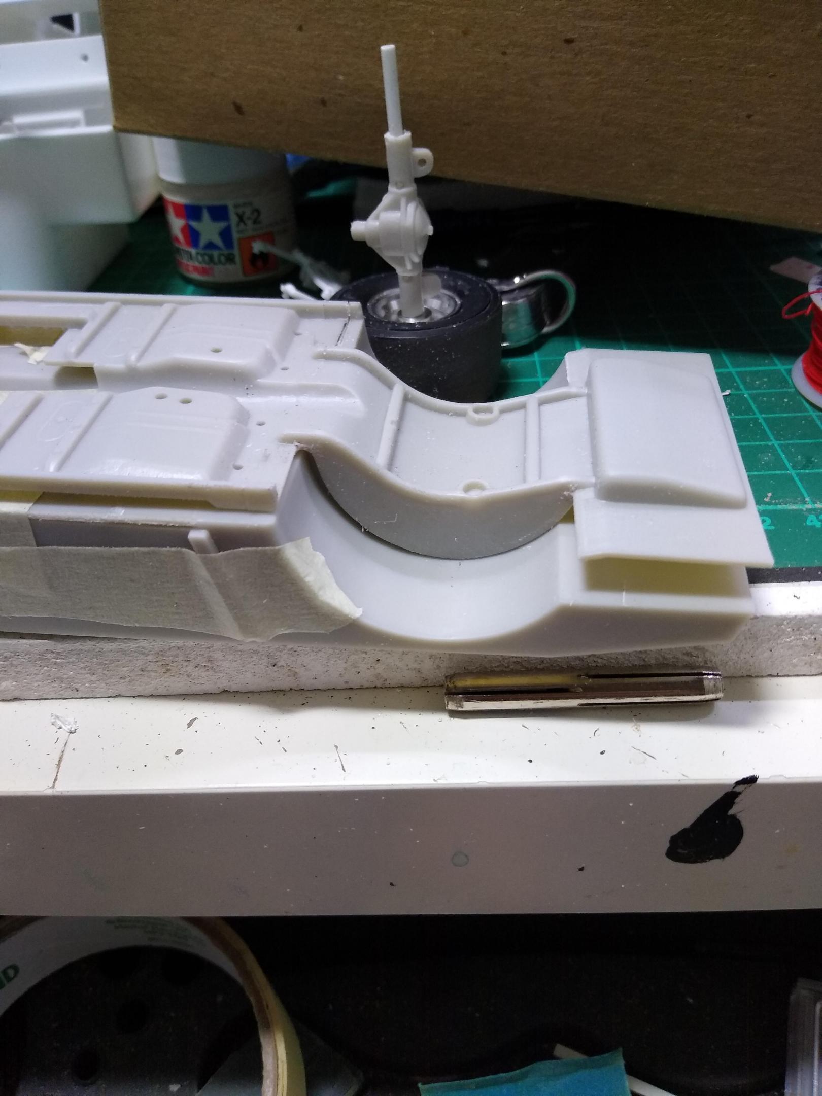

To get the tyres under the body I had to widen the wheel arches at the bottom. I want to keep the outer profile as stock as possible. I worked on one arch until a tyre would nestle up to the skin of the fender. Once I was happy I taped some paper behind the arch and traced the outline. I can then copy the profile on the other side of the car. I thinned the plastic around the arch too, it's quite thick (like myself) and squeezes the tyres as they go up into the body.
I still had to shorten the axle but not by much. A quick mock-up and it looks meaty meaty meaty! All still roughly done at the moment but looks promising.

Very interesting project Stephen!   I've seen a lot of this Nova body style on drag racing tracks and they look great.  I love big-tire cars and your project fits perfectly into this category!   A big block engine would be a must for this car by the way but I think that's what was already included in the kit anyway!   👍

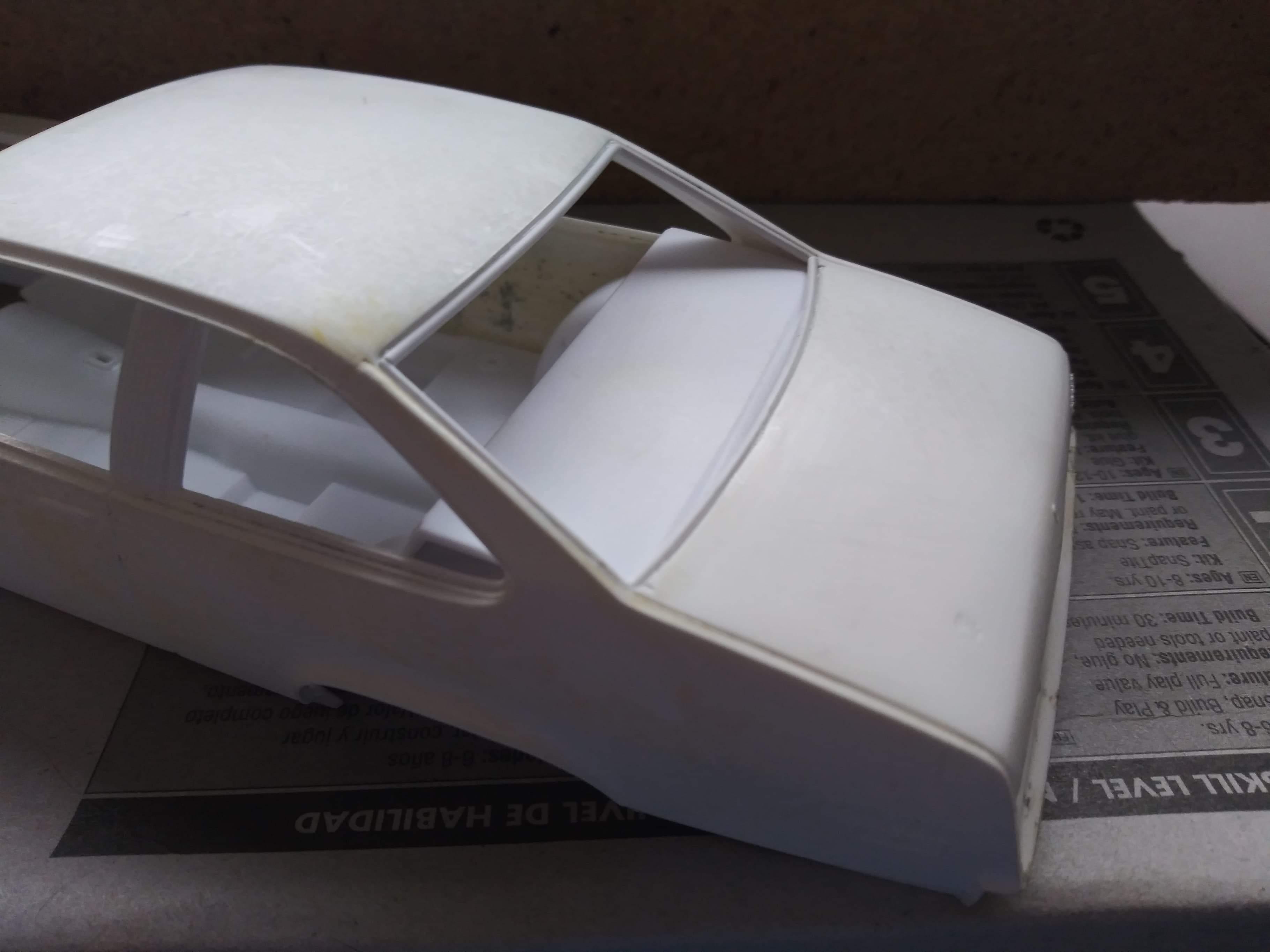

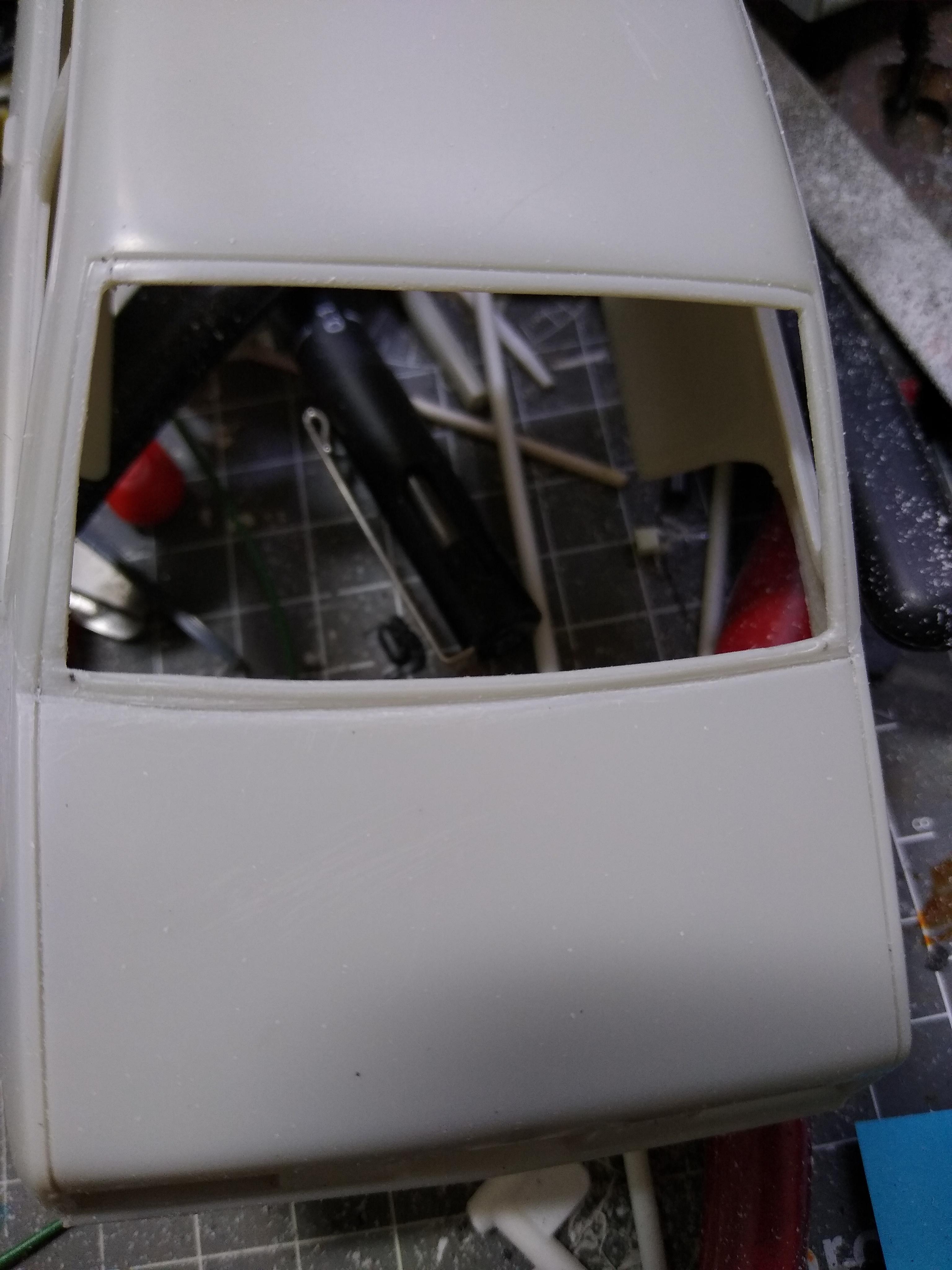

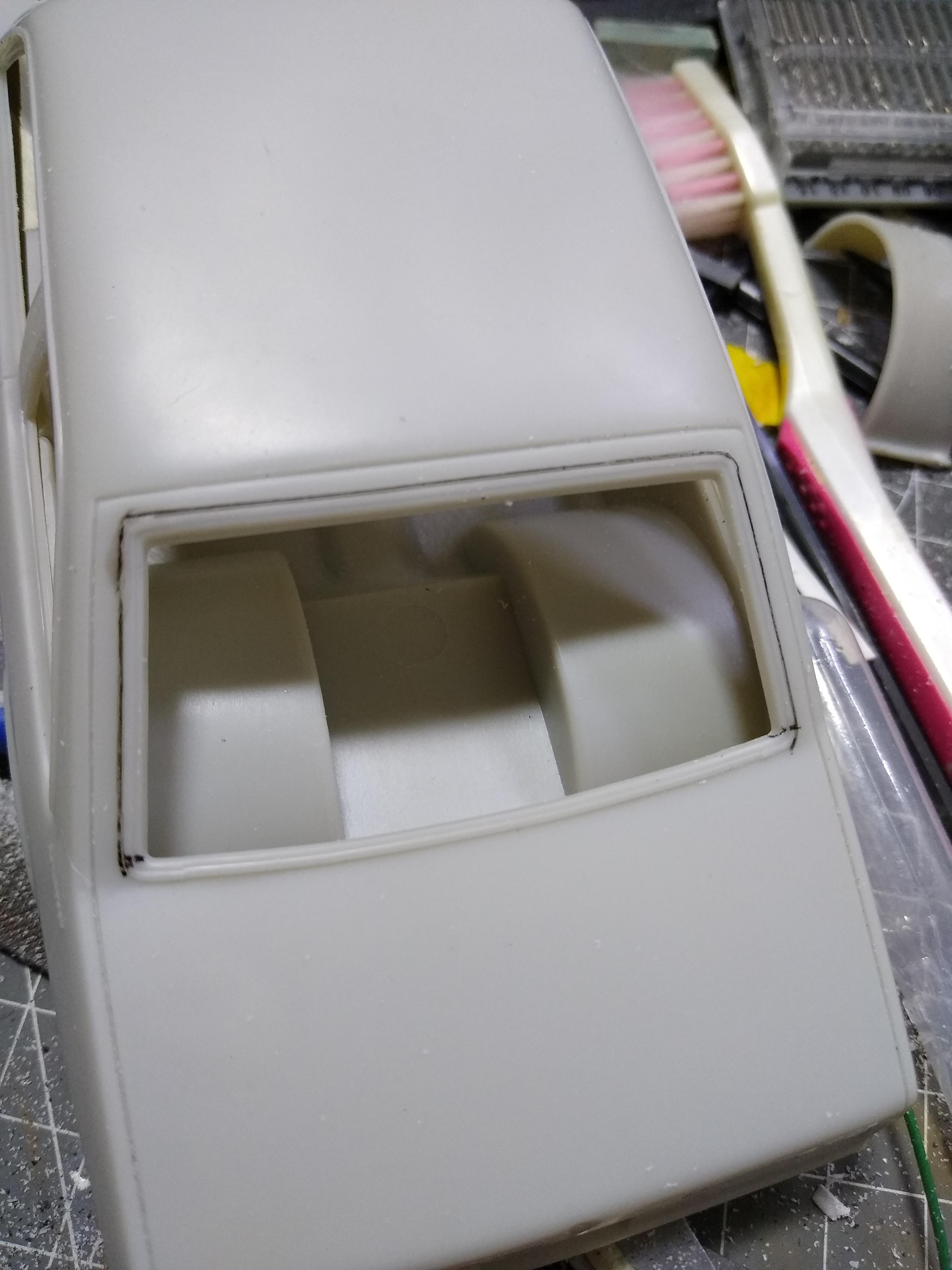

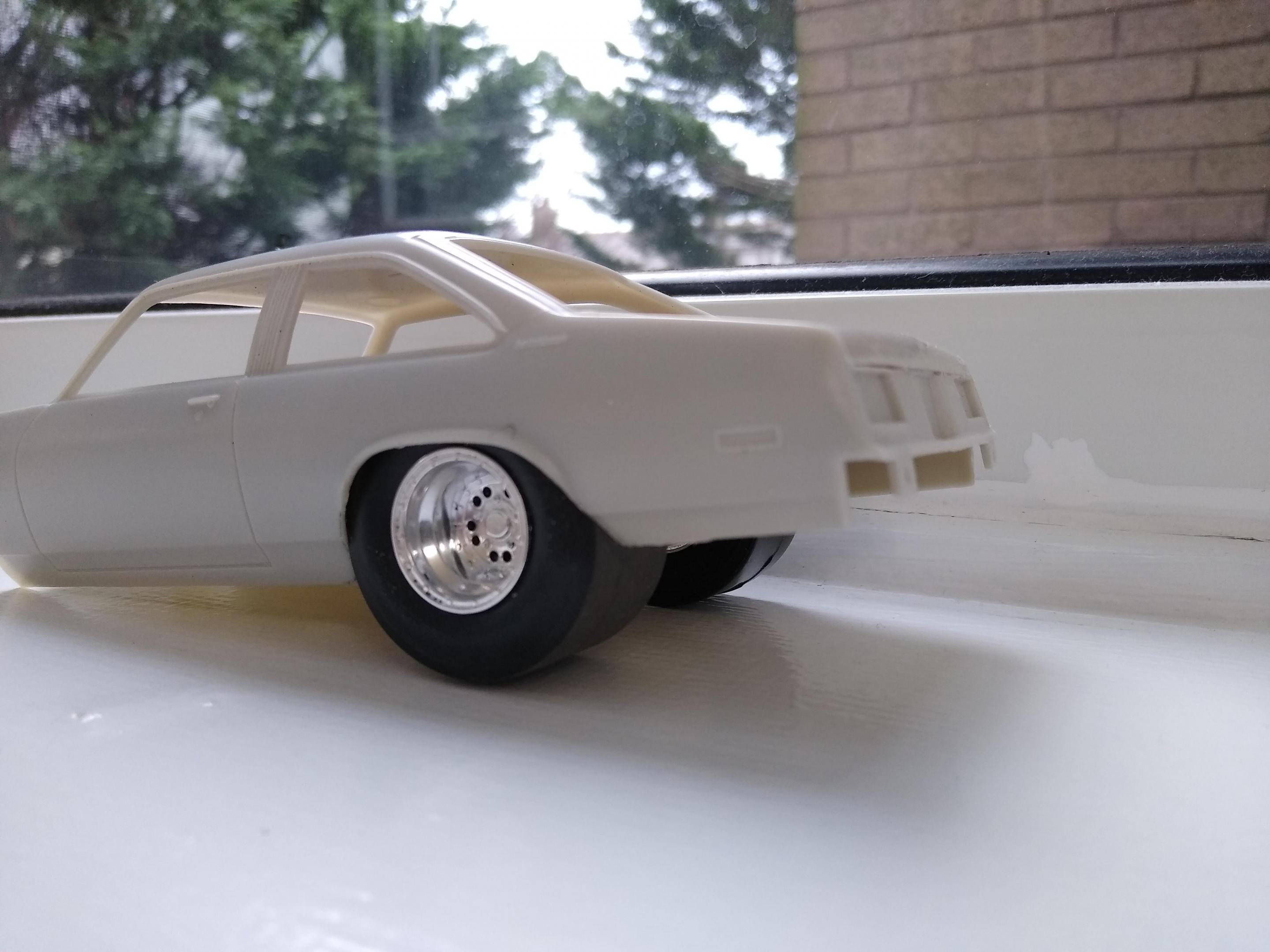

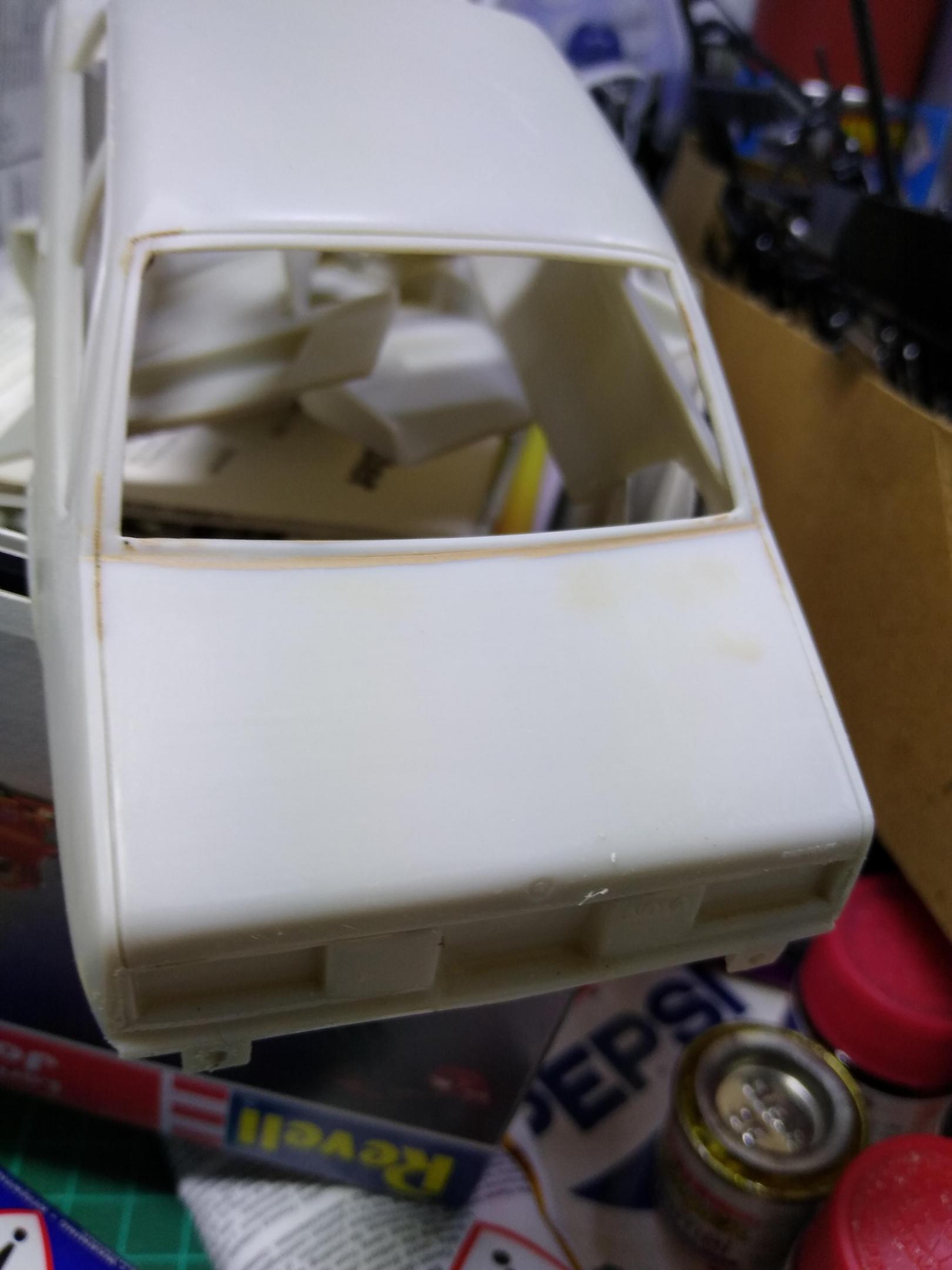

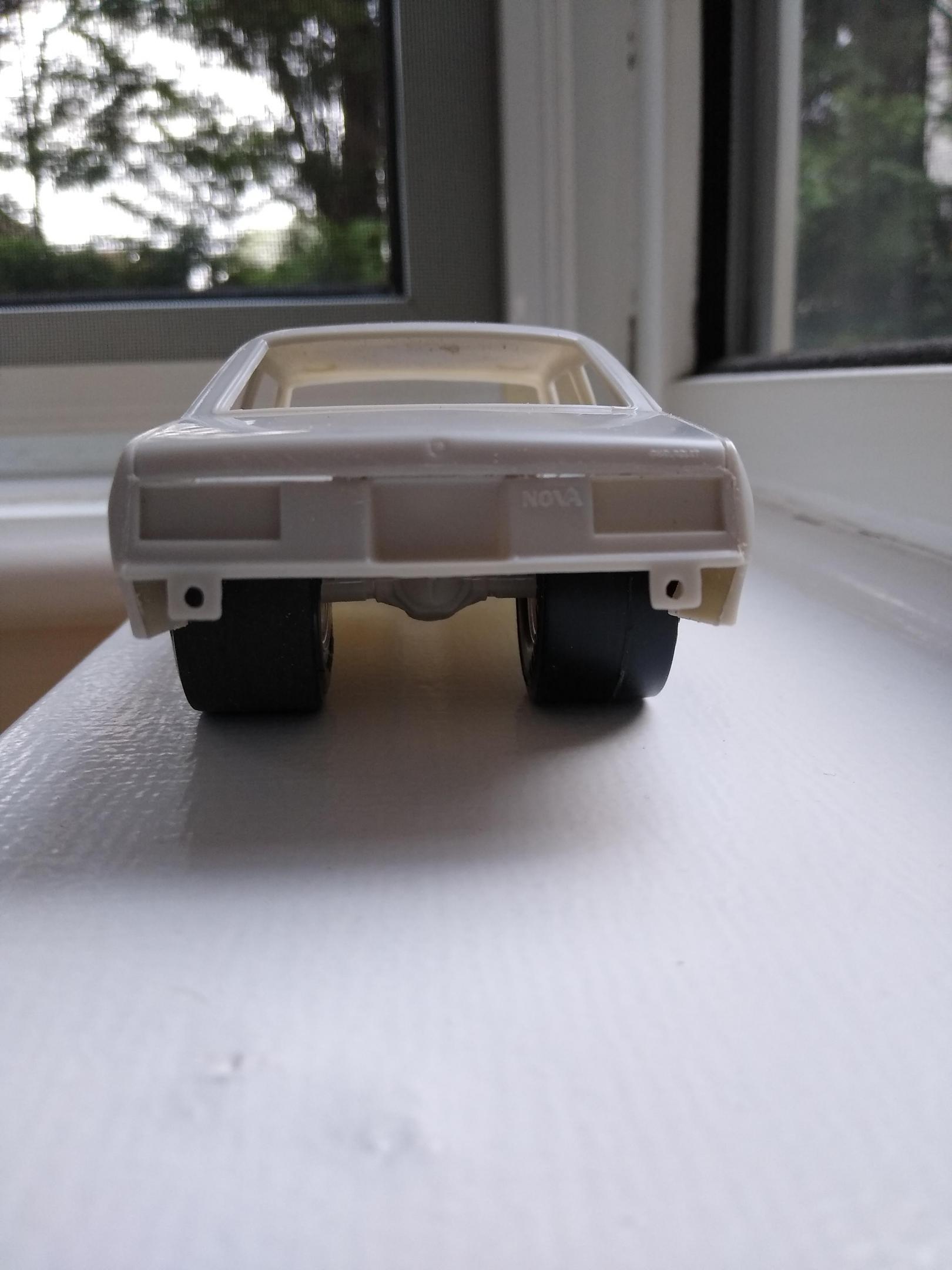

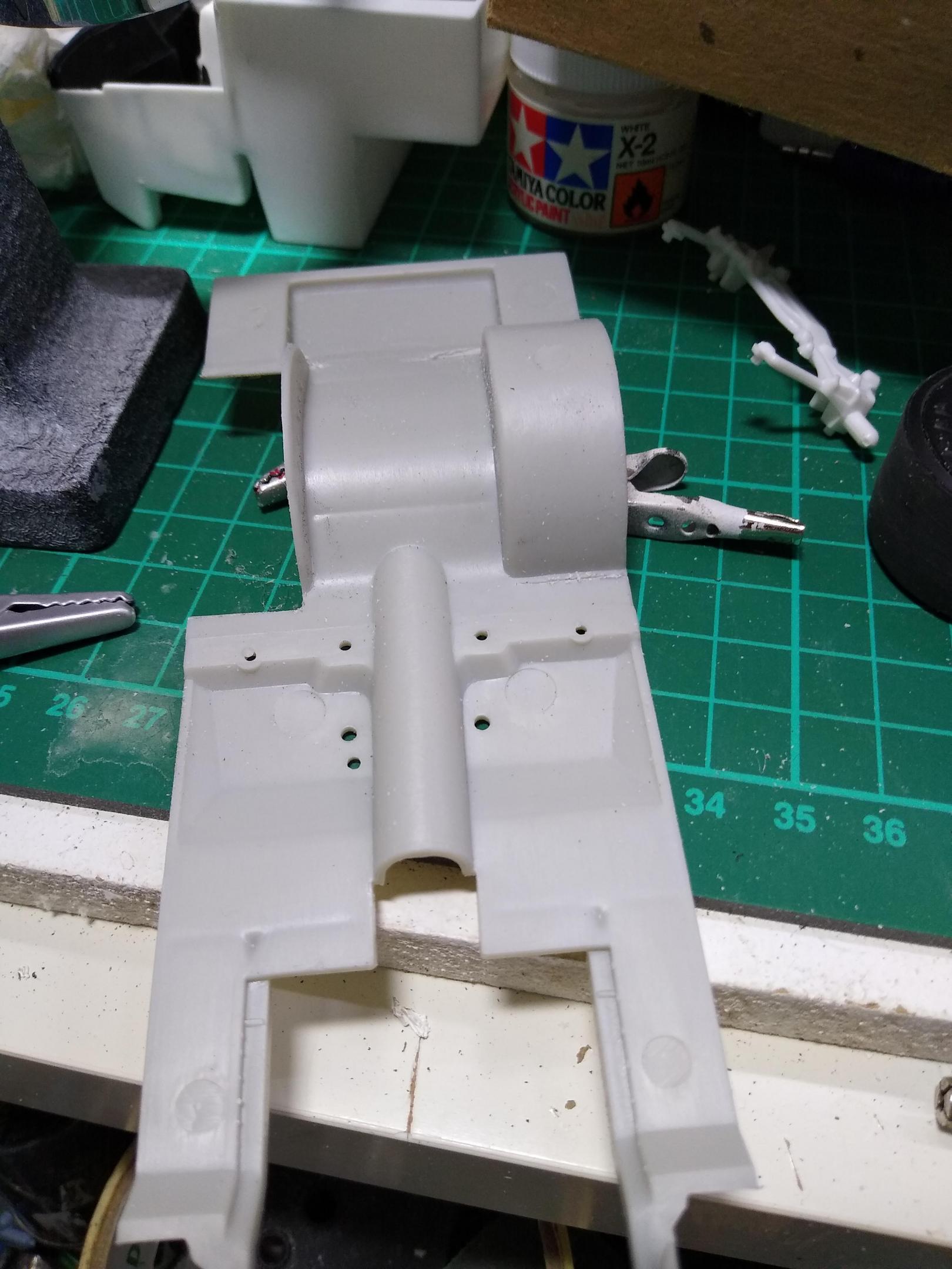

Not much to report today, cut the rear tubs out of the floorpan to give the slicks more room. Worked on shortening and strengthening the rear axle, cleaning up the tyres and roughing the rolling surface up. They had a terrible seam in them and took some filing but looked ok in the end. I'd love to have the tread of a set of Mickey Thompsons but beggars can't be choosers!
Also opened the rear window up to the fixed coupe version size. I just scribed a line around the outside of the existing window trim and then cut it out, but it still needed filing down a little. The hatchback shut line is now the outside edge of the window trim. I needed to scribe a shut line for the front edge of the trunk lid immediately under the lower trim.  When I was scribing it I slipped and made a pig's ear of it. I'll have to fill it and start again but you get the idea and it does look a lot better.

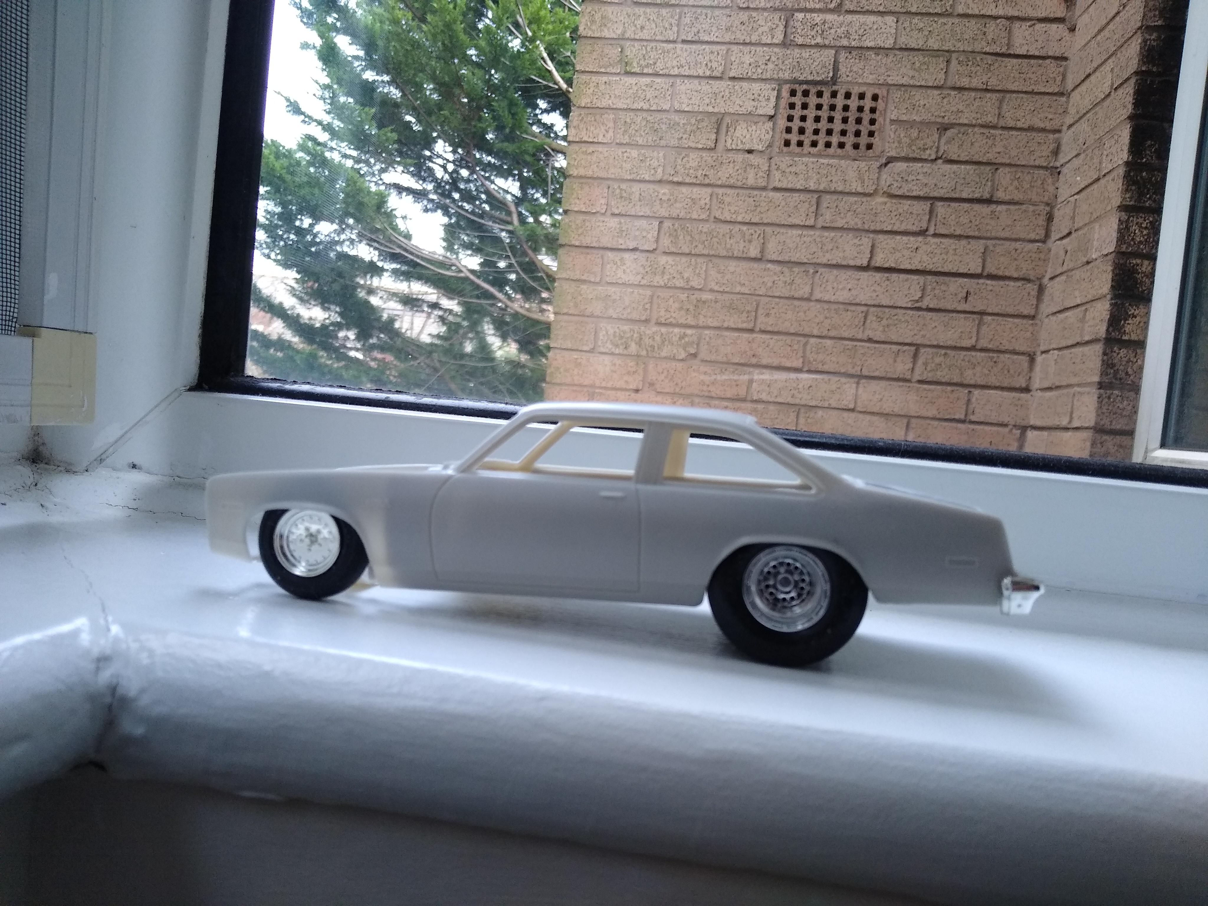

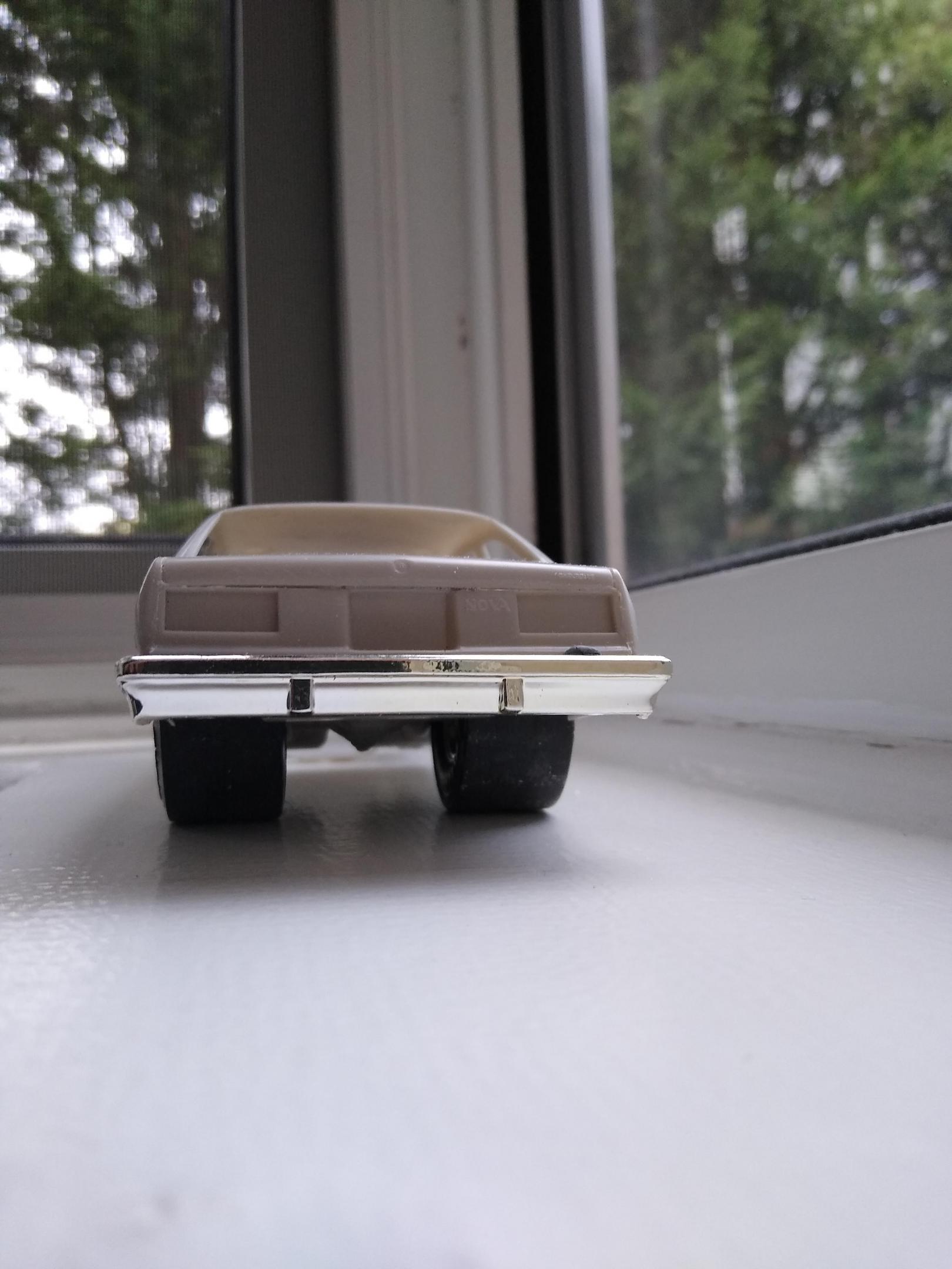

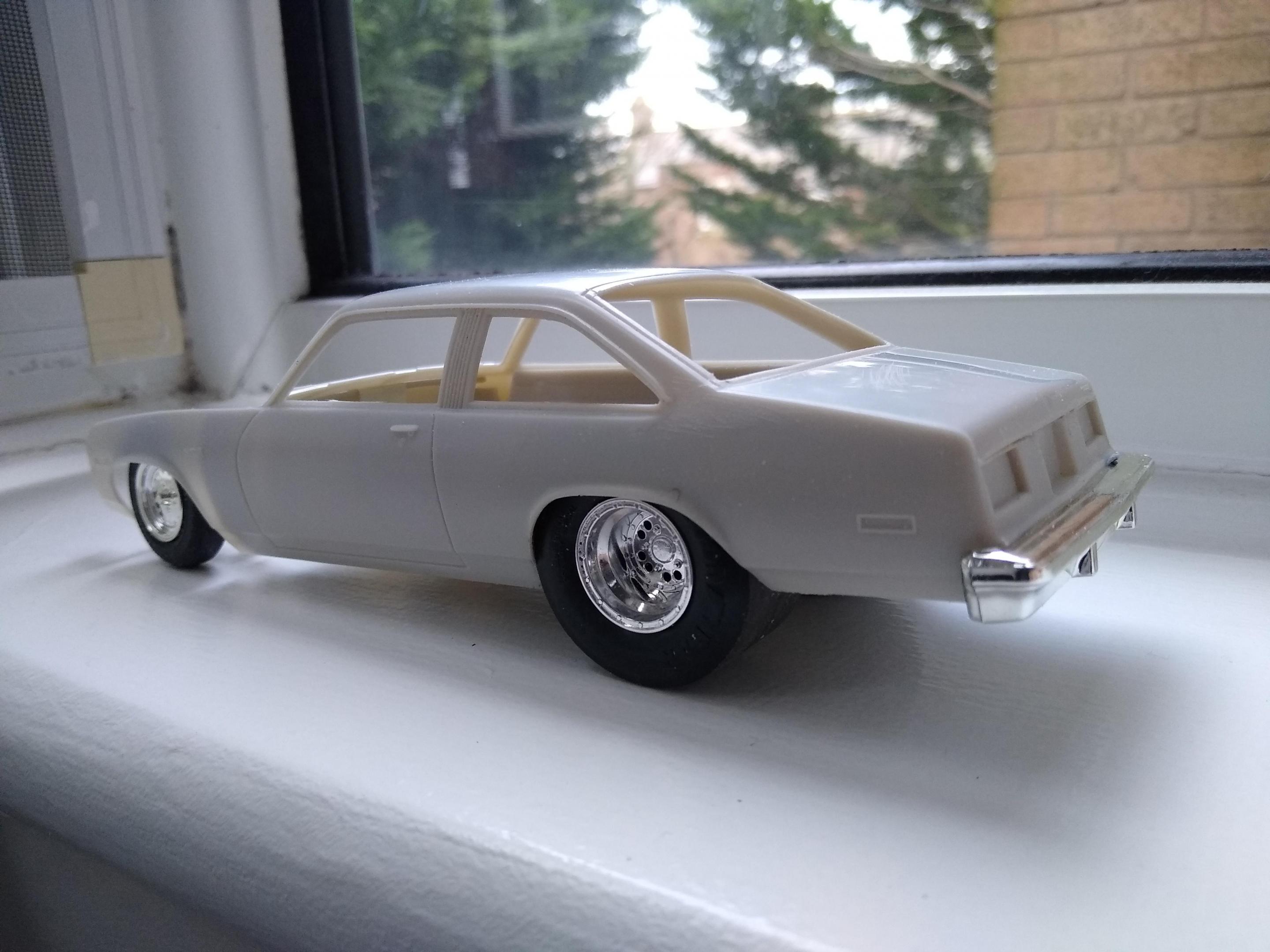

I mocked it up again with the rear bumper and a front wheel I found in my parts box. Not sure if I want stinkbug or near normal stance and let the rear slicks and the blower do the talking. I was thinking of painting it the same colours as my car, even keeping the vinyl roof and adding the side trim on the waistline.

57 minutes ago, Spottedlaurel said:
Looks mean!
Good work on the rear window.
29 minutes ago, AMT68 said:
Agreed the work removing the hatchback lines looks excellent.
Thanks gents, it's a bit tatty at present but I'll be doing a lot more finessing before I get to the paint stage. The bigger window really does  improve the look in my eyes. I wondered about  getting the slicks further up into the body but the tubs are already at the lower edge of the side windows, so that's the ride height by the looks of it.

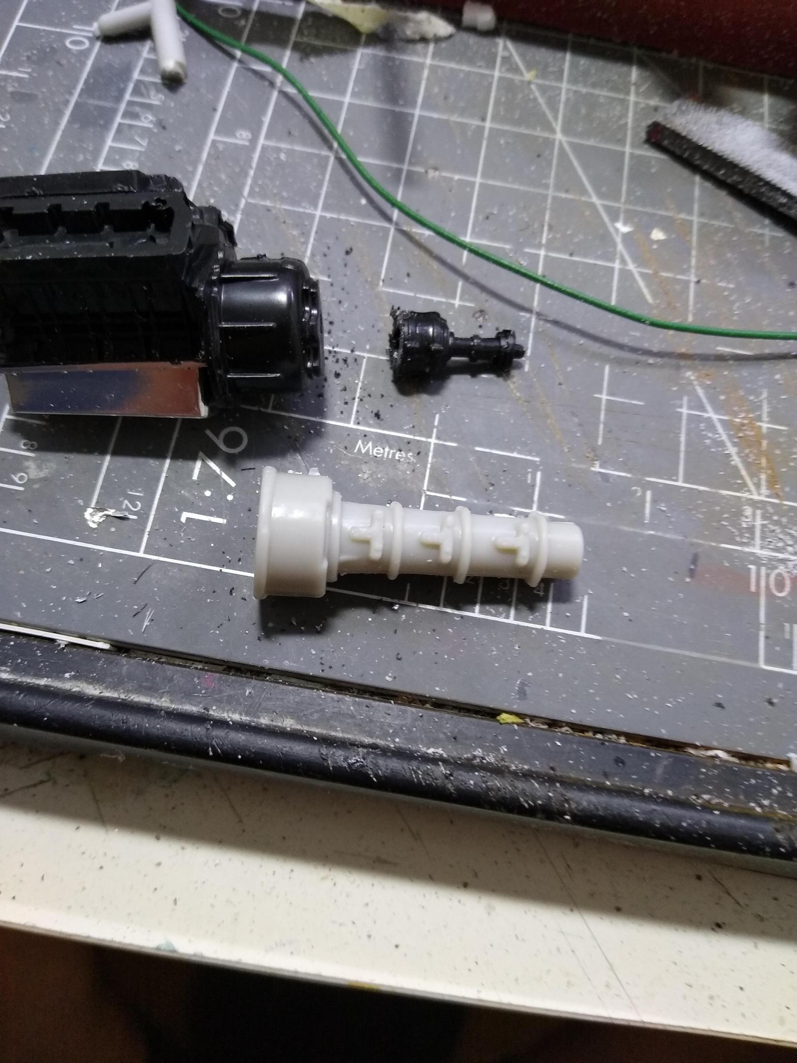

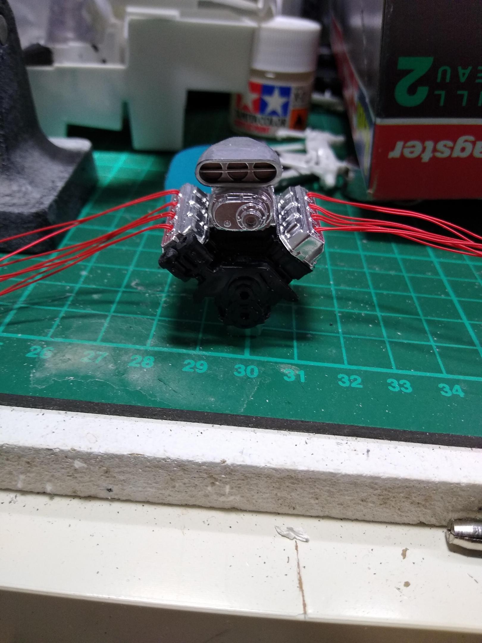

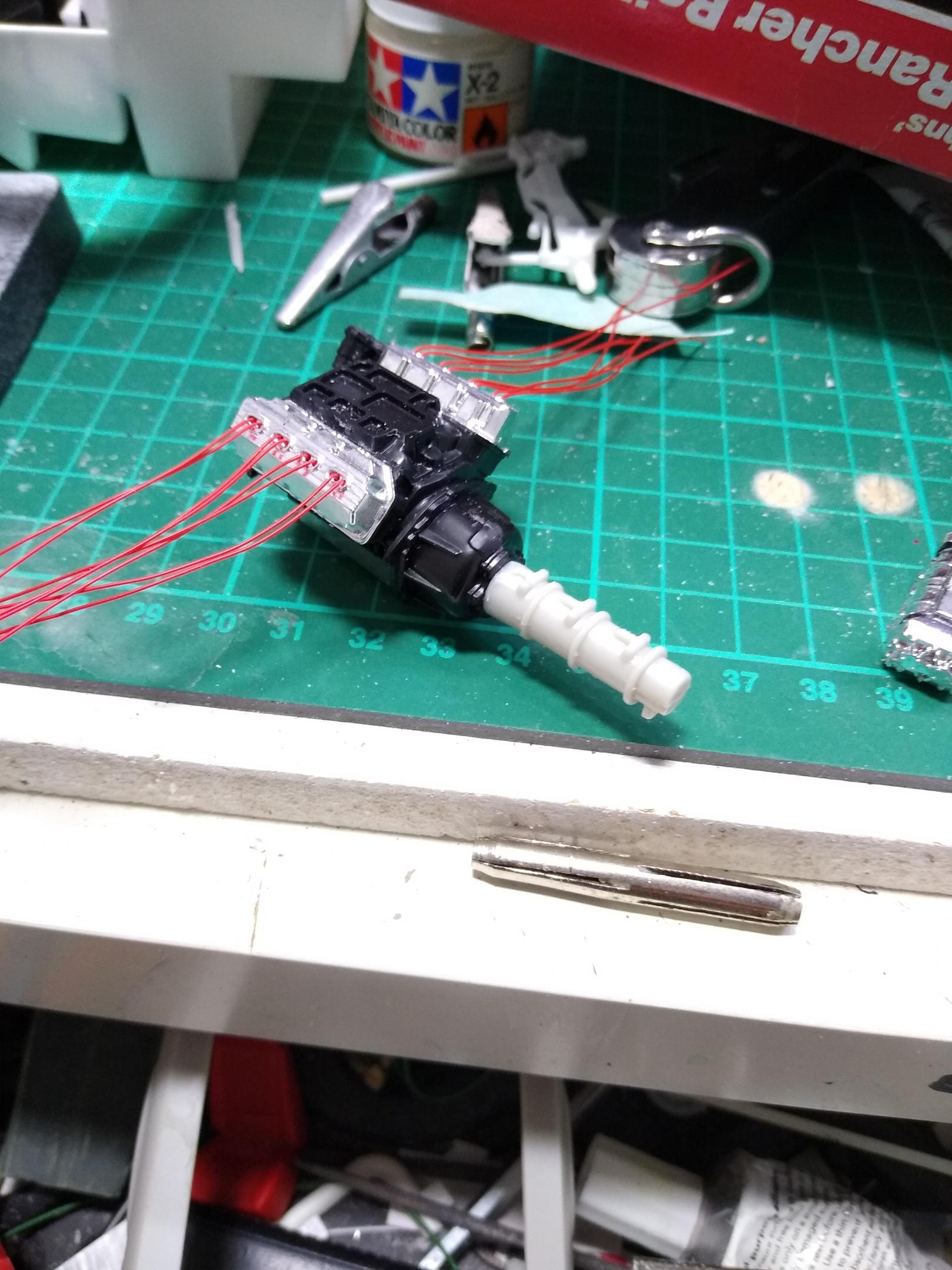

Not great progress but something. Built the short motor, drilled and wired the rocker covers. Cut the two speed off the scattershield and attached the Lenco transmission (less its scattershield). Mocked the engine up. I'm thinking of using a motor plate to mount it in the chassis.
Repaired the mess I made of the trunk panel line. Removed the "Hatchback" script from the C-pillars.

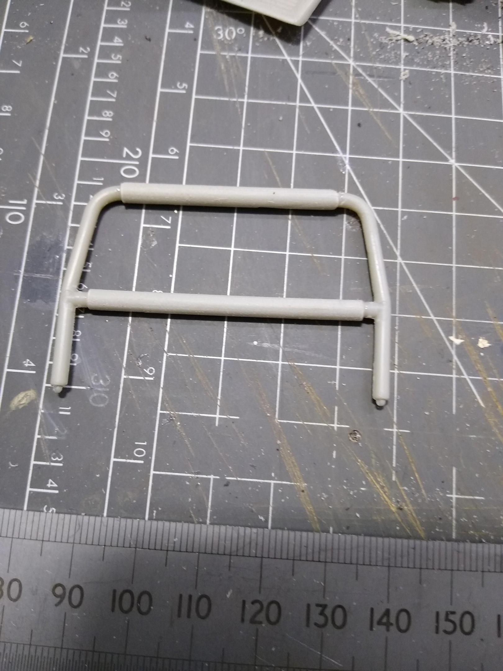

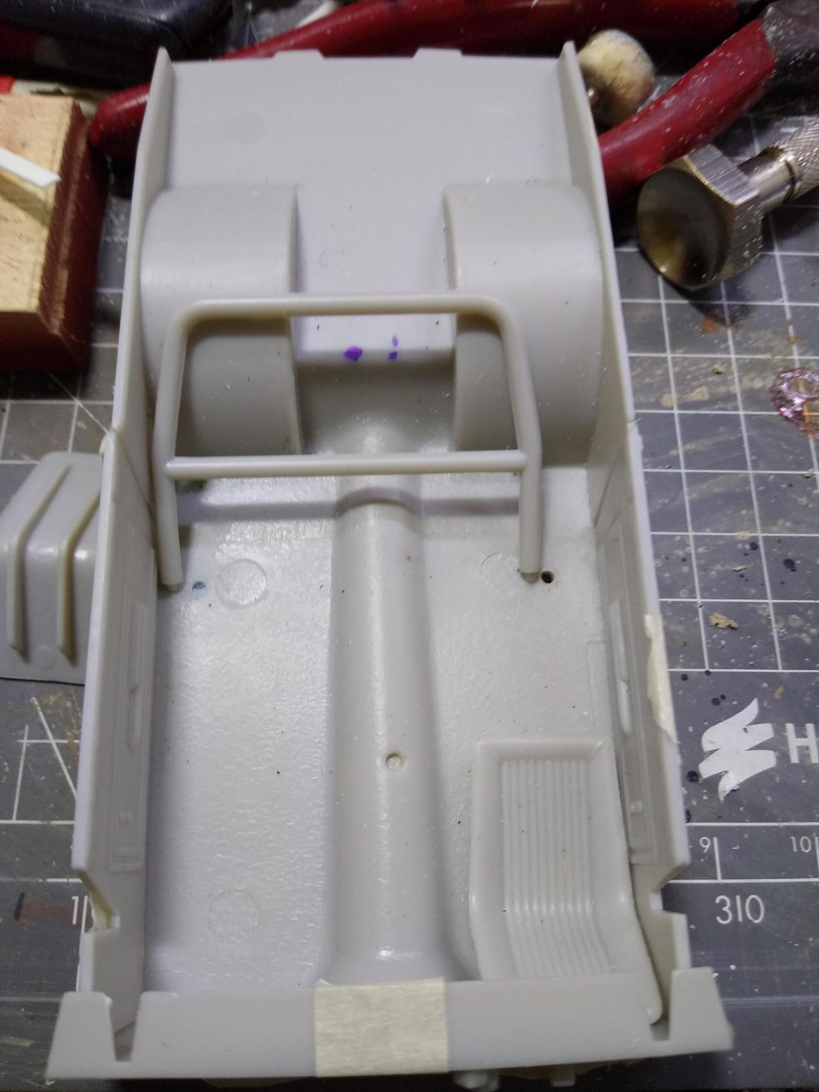

Started thinking about the interior. I'd love to fit a front bench seat but I'm not sure it will fit with a full cage. There's a simple roll bar that comes with the kit but it's too narrow. It's a start though, so I widened it using sprue. As it was thicker than the rollbar I made the cuts as close to the end as possible so that it looks like padding on the bars. I'll have to make door bars, a cross brace and connectors to the rear end.
