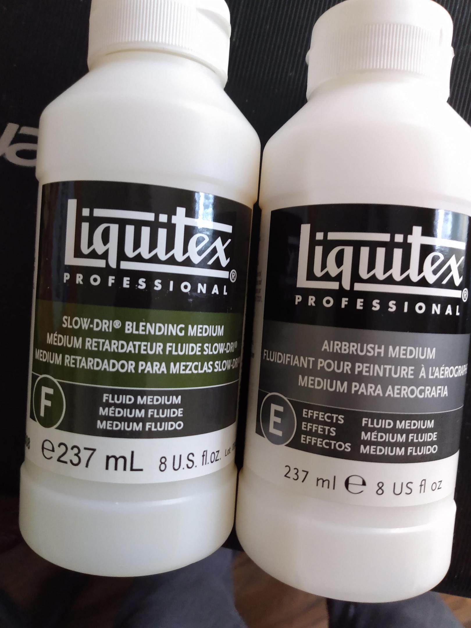

Washer fluid is about 40% methyl alcohol ( or methanol ), water and a touch of detergent. Some craft acrylics like that alcohol, others ipa, others no alcohol. What washer fluid doesn't have is retarder in it and that greatly aids in fighting tip dry. Just sayin
