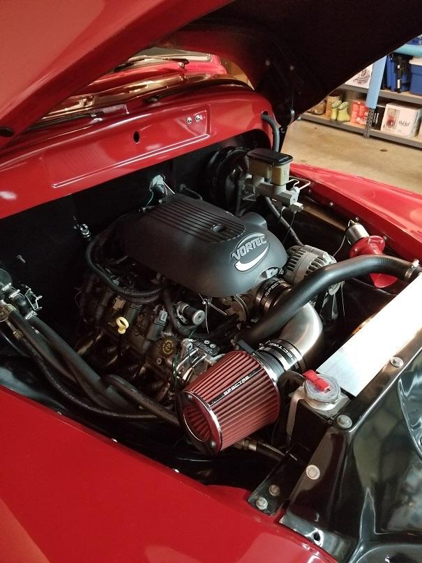

Zippi Posted April 19, 2021 Author Posted April 19, 2021 26 minutes ago, Dave G. said: Just suggesting if you want to wax then do it later, not a day after you painted. But you certainly are free to do as you wish. That said, I doubt you painted your 49 this morning and moved on to waxing it this afternoon...... You do keep it immaculate. We have one in town here too. I assume it's a small block but is green ( actually more mid to dark teal). We have a Ford around too but that may be original flathead in that, it's just a nicely done restoration for a business . Thanks dude. Yeah I would'nt have painted my 49 that quick. I have an 5.3 LS in my 49.

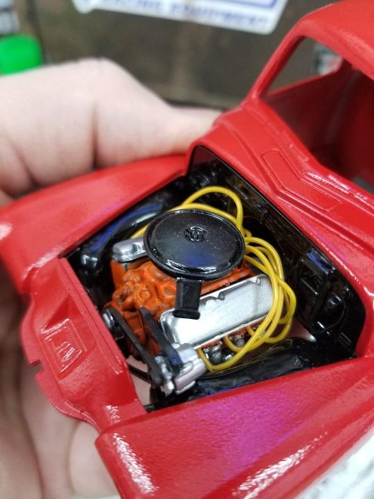

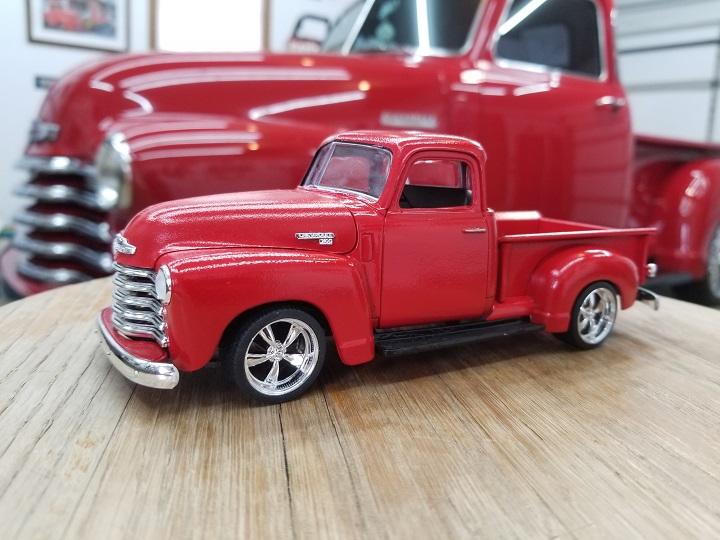

Zippi Posted April 20, 2021 Author Posted April 20, 2021 (edited) I built the amt 1950 Chevy pickup to look like my 49. I bought aftermarket Torque Thrust wheels to match mine and put a BB 396 in to replace the inline 6. This was my first build and it didn't come out a good as I would have liked. I plan on building another down the road to redeam myself. Edited April 20, 2021 by Zippi

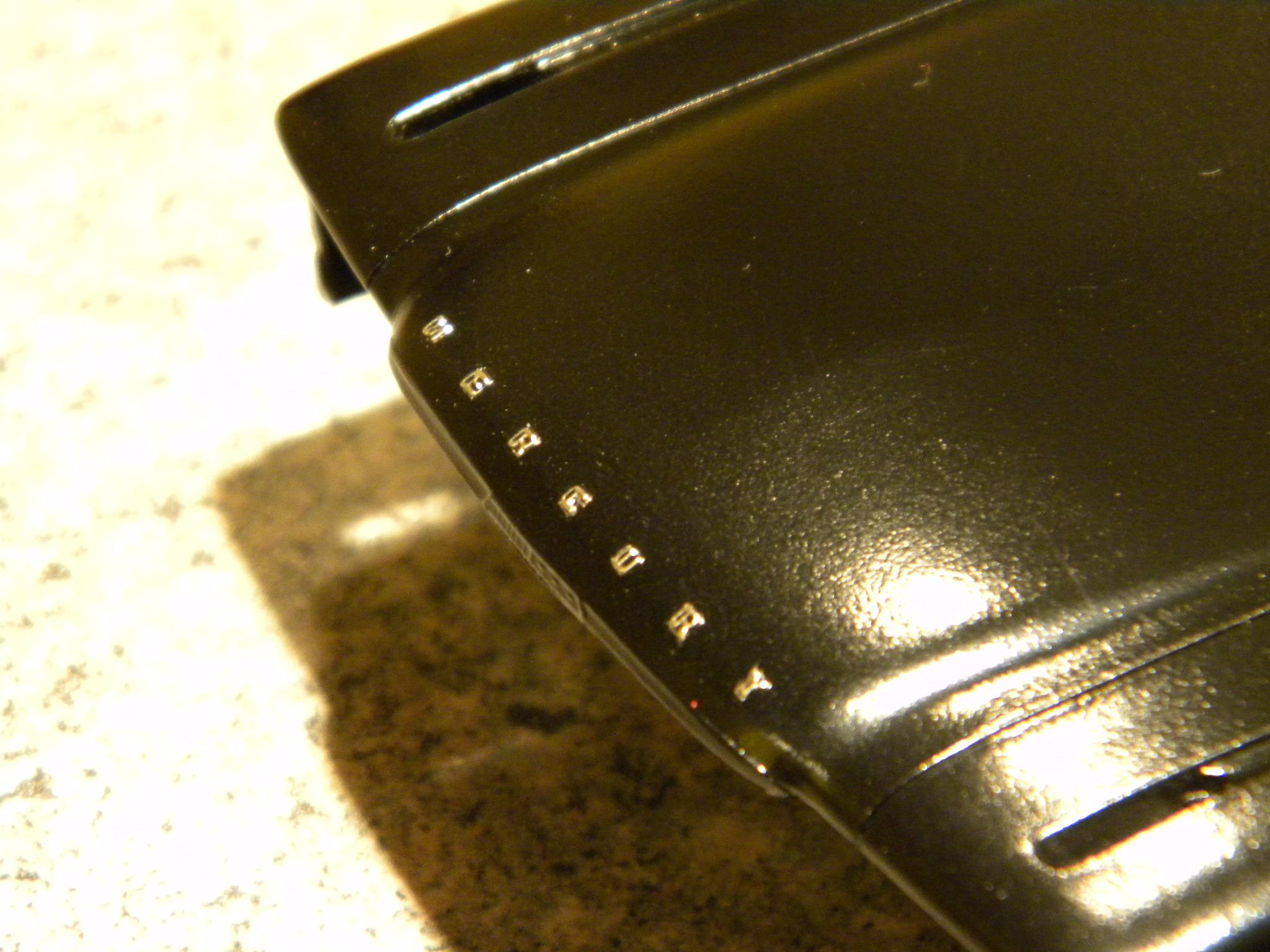

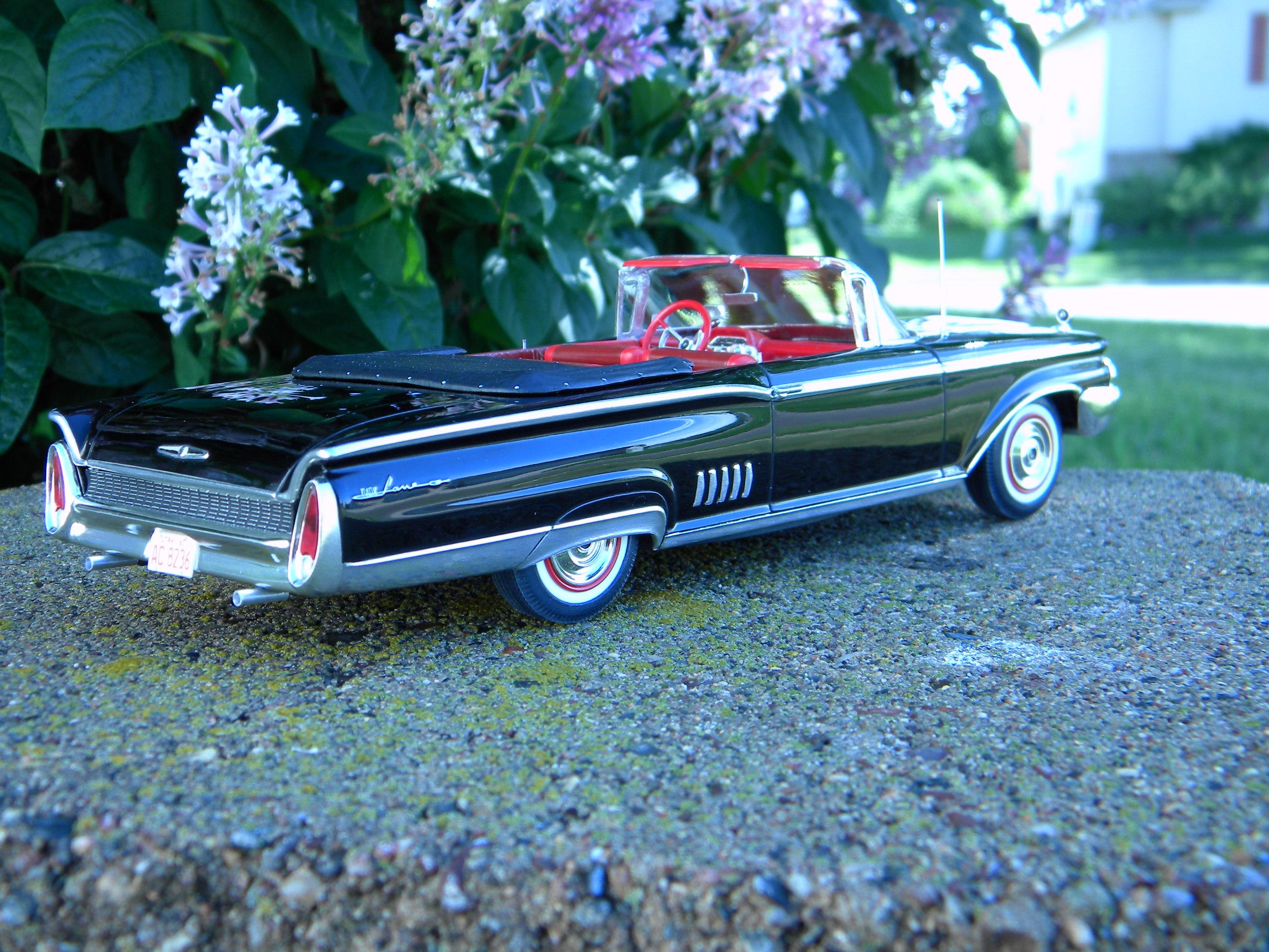

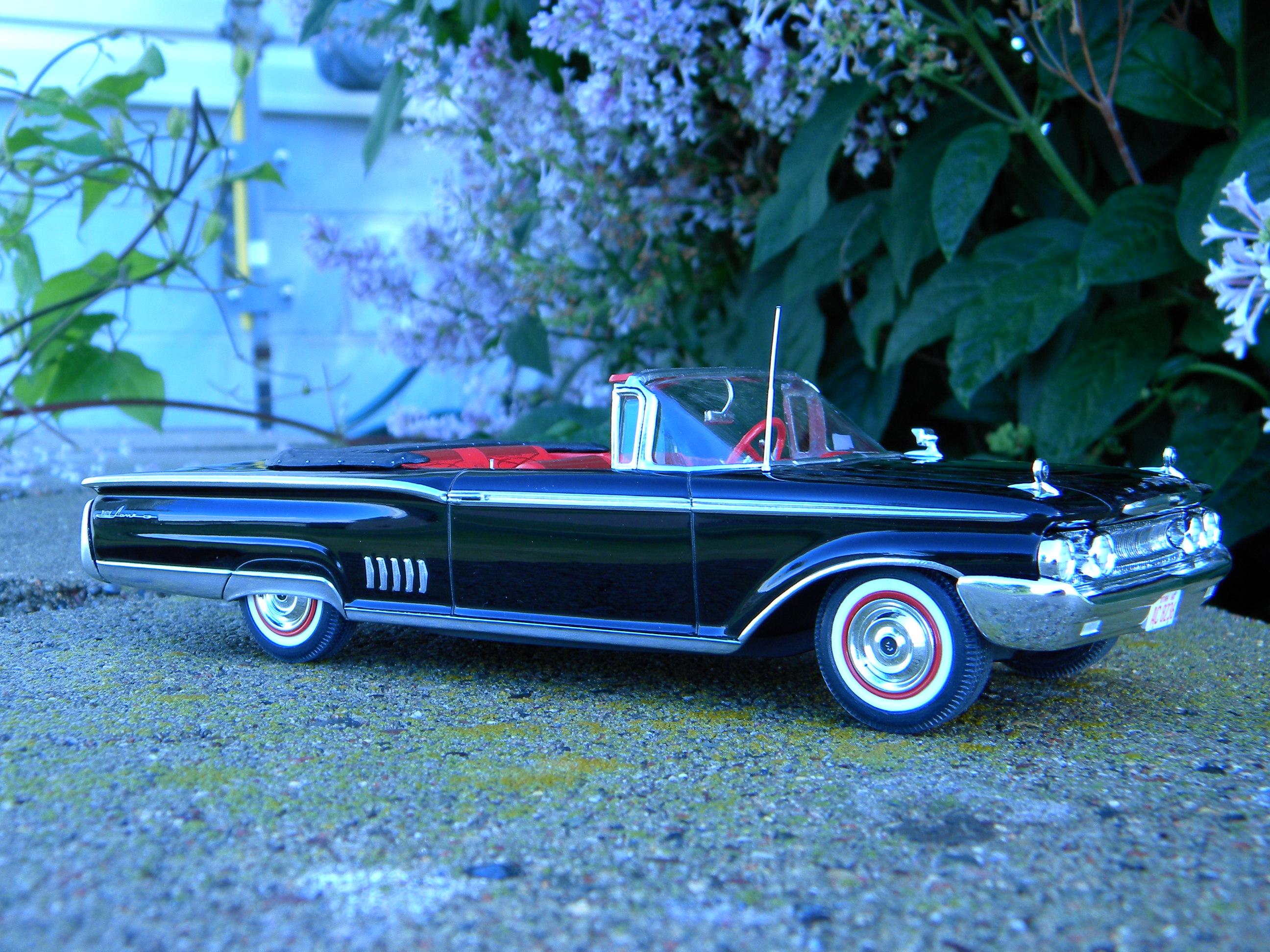

StevenGuthmiller Posted April 20, 2021 Posted April 20, 2021 My 2 cents, you need to be very careful about sanding color coats if using a metallic paint. Sanding can "smear" around the metallic particles and leave striations that are only amplified under clear. I will also add that while it's best to get your color coats as smooth and perfect as you can, it's not always going to happen that way, and yes, you can get a great finish over some orange peel with ample clear coats and careful polishing. I don't even worry anymore about getting perfect primer and color coats. A lot of evils can be corrected with clear and polishing. This was a very freeing revelation to me during the course of my modeling career. It's great to be an expert painter and get perfectly smooth substrates on every project, but it's not always in the cards for some of us. Some of us might struggle with that task for most, or all of our modeling careers, to the point that some give up. But it doesn't need to be that way. With some mediocre painting skills, good materials and some elbow grease, anyone can turn what might be viewed as a subpar paint job into a true gem. Personally, I think that unpolished paint can look too shiny anyway, akin to a piece of hard candy. Polishing can add that little extra boost of realism. Anyway, I'll just add this example. This 1960 Merc was painted the same way that I do them all. No sanding between primer coats, (unless there's a little junk to remove) no sanding between color or clear coats, (again, unless there are imperfections) and then just a good polishing job at the end. I look at it from this perspective. Either you can spend your time sanding between every coat of paint, or you can spend that time polishing once at the end. It's really a wash. After final color coats, complete with orange peel. After clear and polishing. Steve

Zippi Posted April 20, 2021 Author Posted April 20, 2021 Thanks for the info guys and good explanation Steven. Your 60 Merc looks pretty good. How did you go about polishing your Merc and what polish did you use?

StevenGuthmiller Posted April 20, 2021 Posted April 20, 2021 2 hours ago, Zippi said: Thanks for the info guys and good explanation Steven. Your 60 Merc looks pretty good. How did you go about polishing your Merc and what polish did you use? I use a "Micro-Mesh" polishing pad set, and liquid polishes. I generally try to start no courser than the 3200 grit, (3600 if possible) and work my way down to the finest 12000. After getting it as smooth as possible, and trying to stay away from edges as much as possible, I'll give it a light polish with Novus #3 "Heavy Scratch Remover" to remove any heavier scratches left by the pads. Then a couple of passes with Novus #2 "Light Scratch Remover". Finally, I'll give it a good buffing with some Turtle Wax "Scratch and Swirl Remover". This really seems to help to bring out the ultimate luster. After the model has been nearly finished, except for the addition of small external details such as mirrors and antennas, I'll give it a polish with Novus #1 "Clean and Shine". Steve
