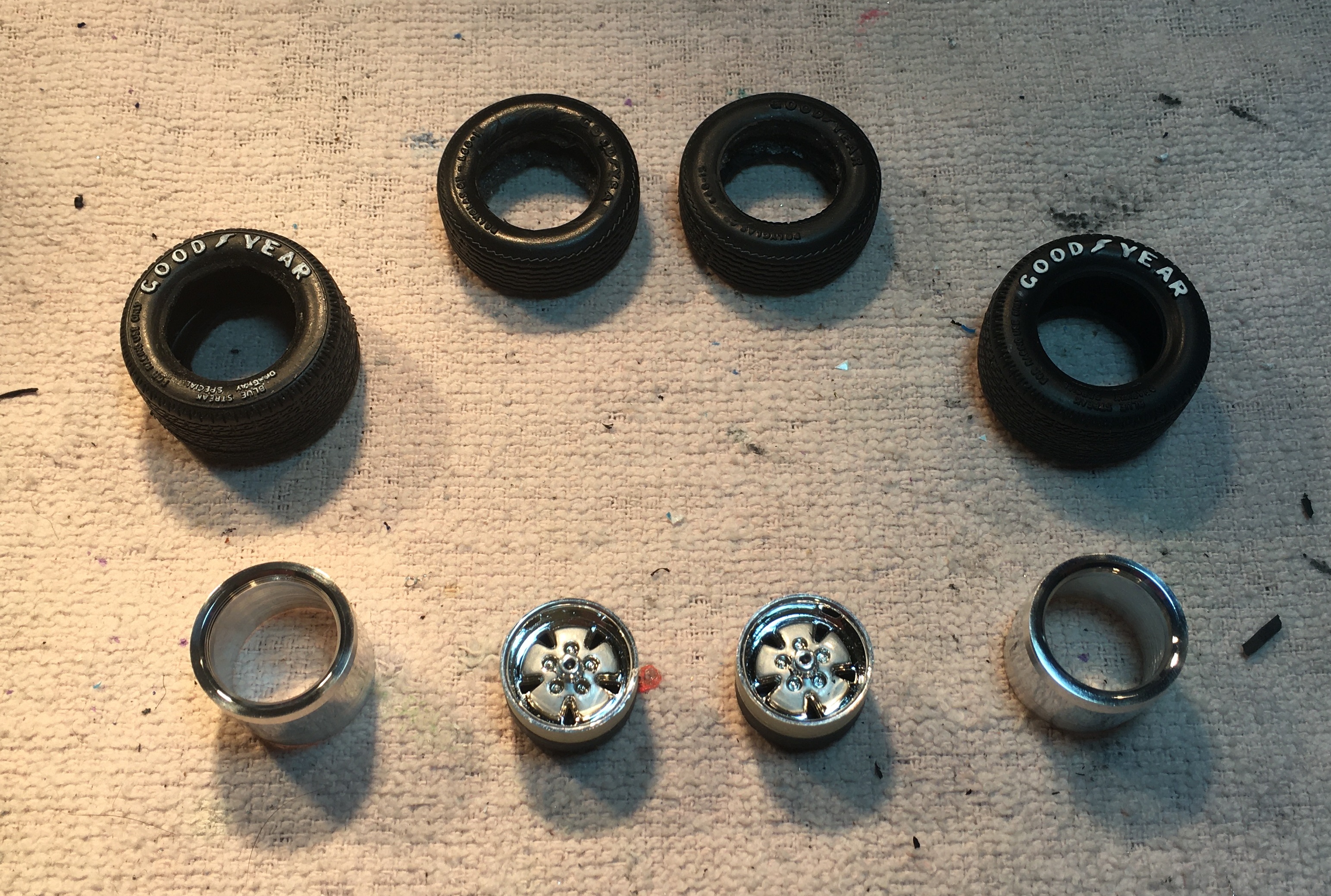

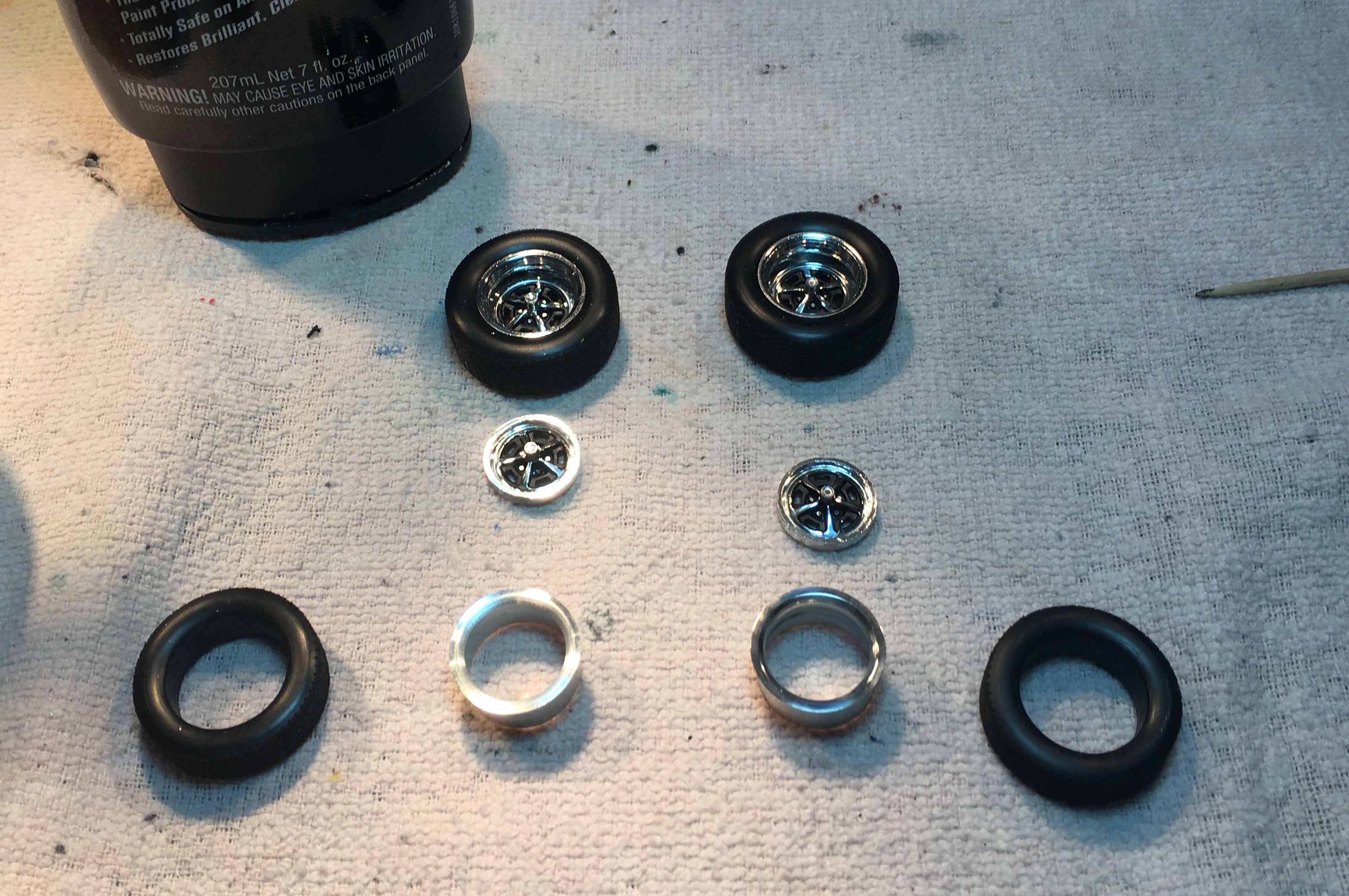

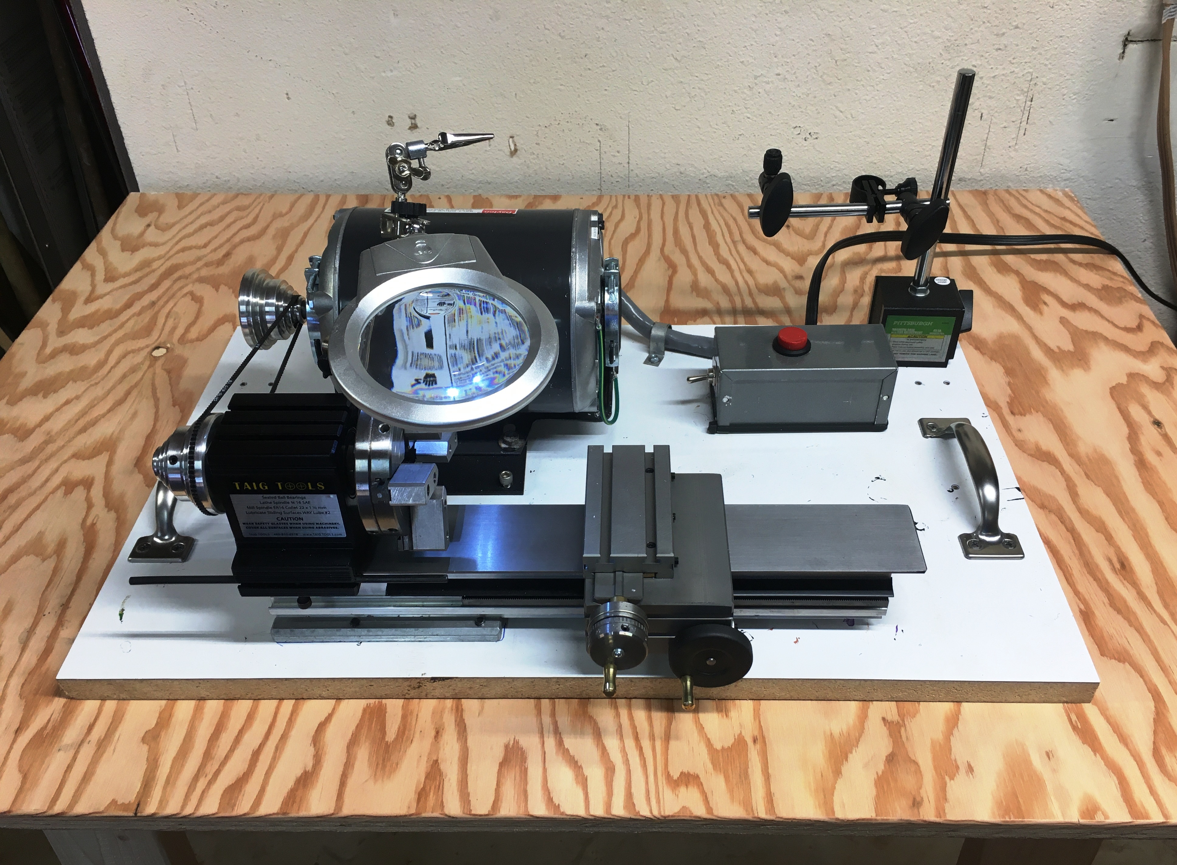

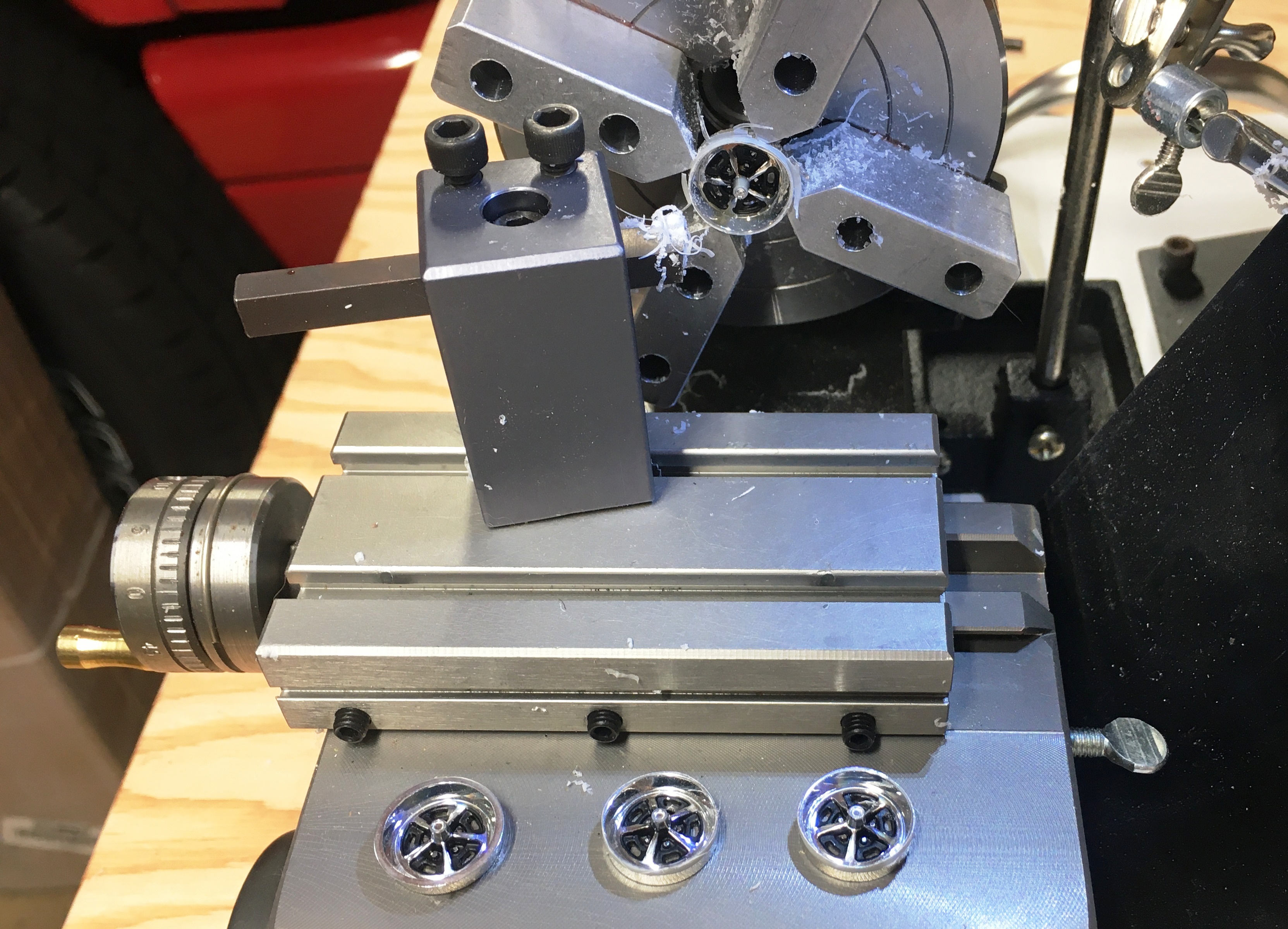

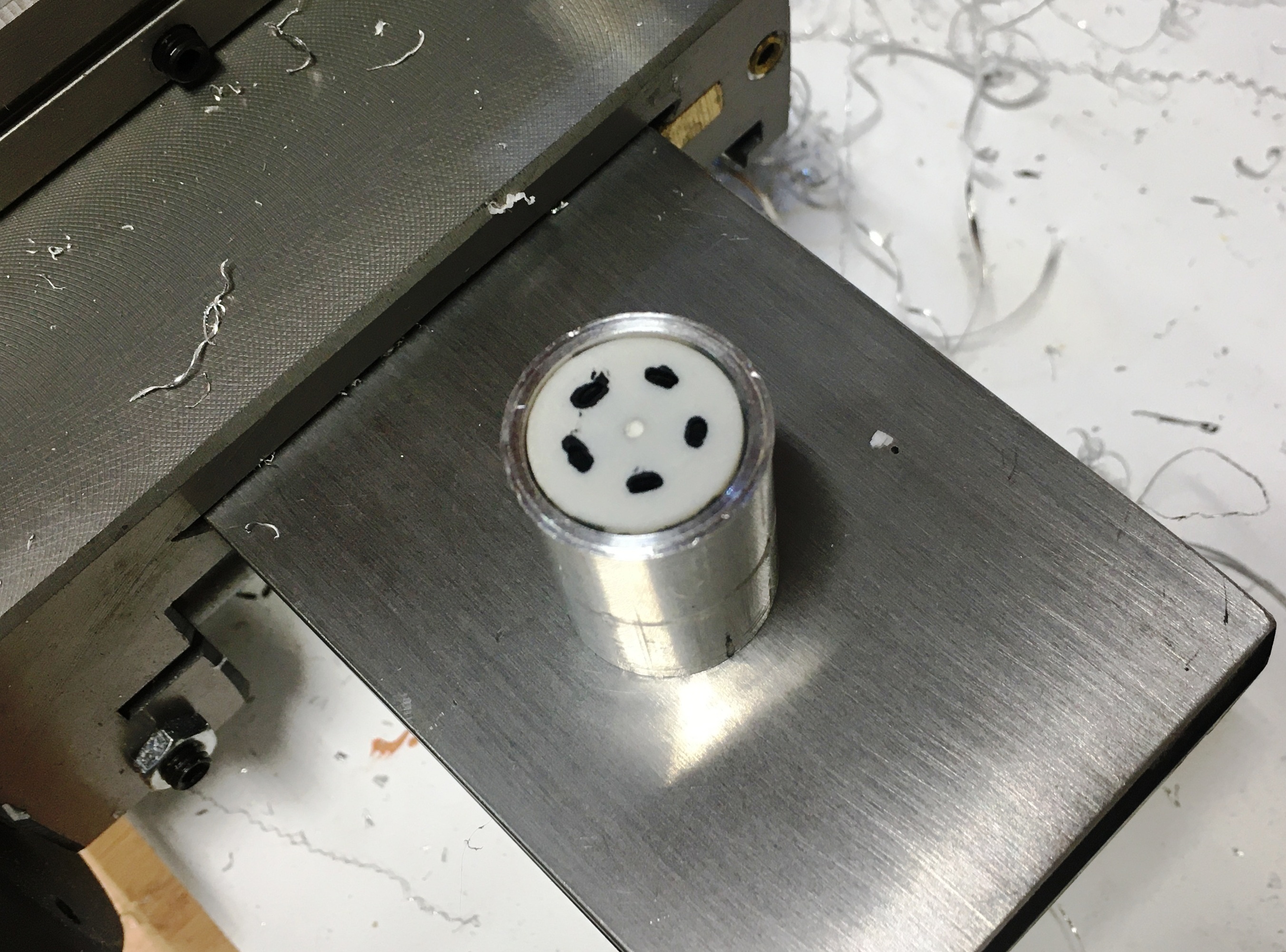

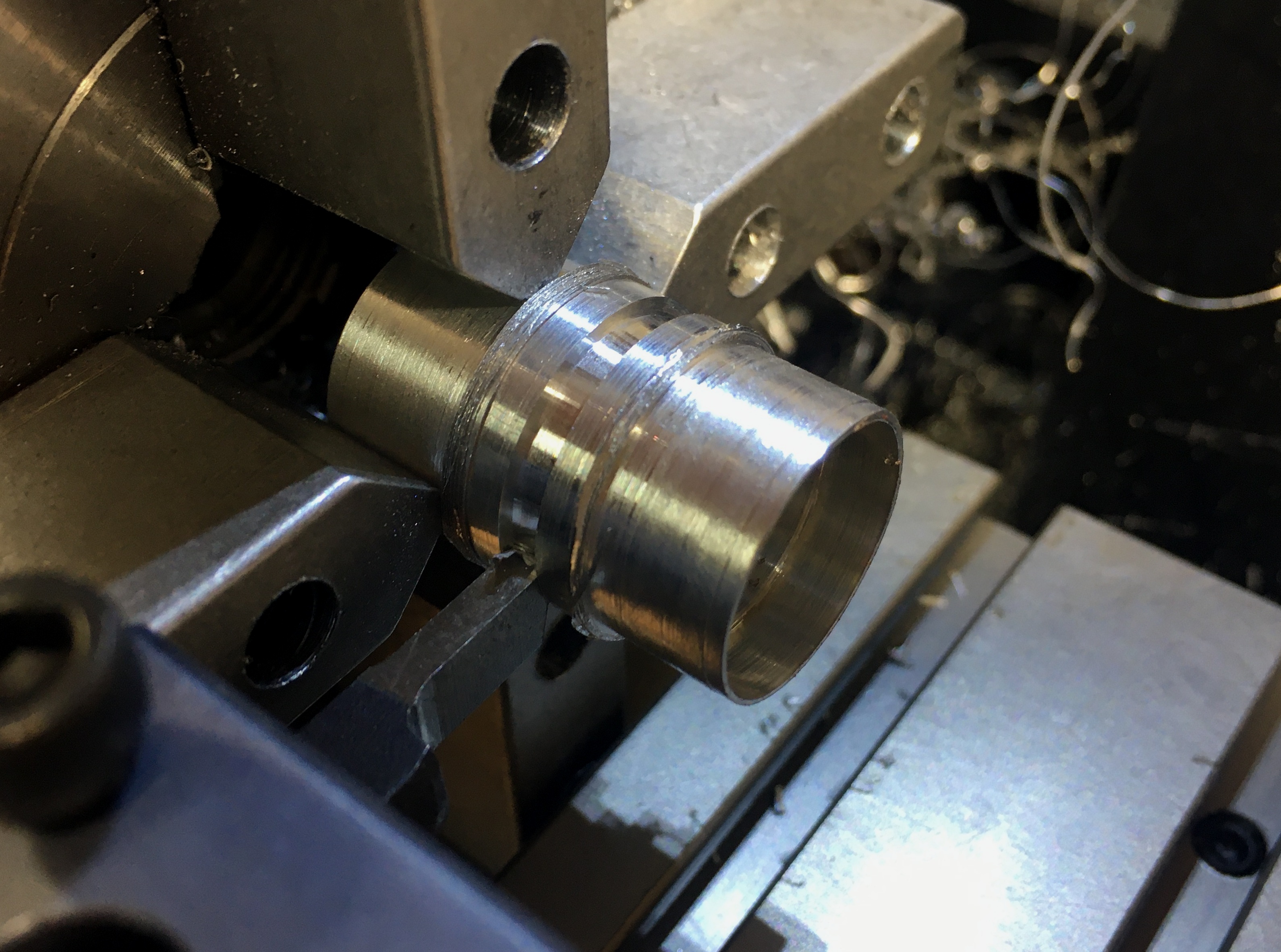

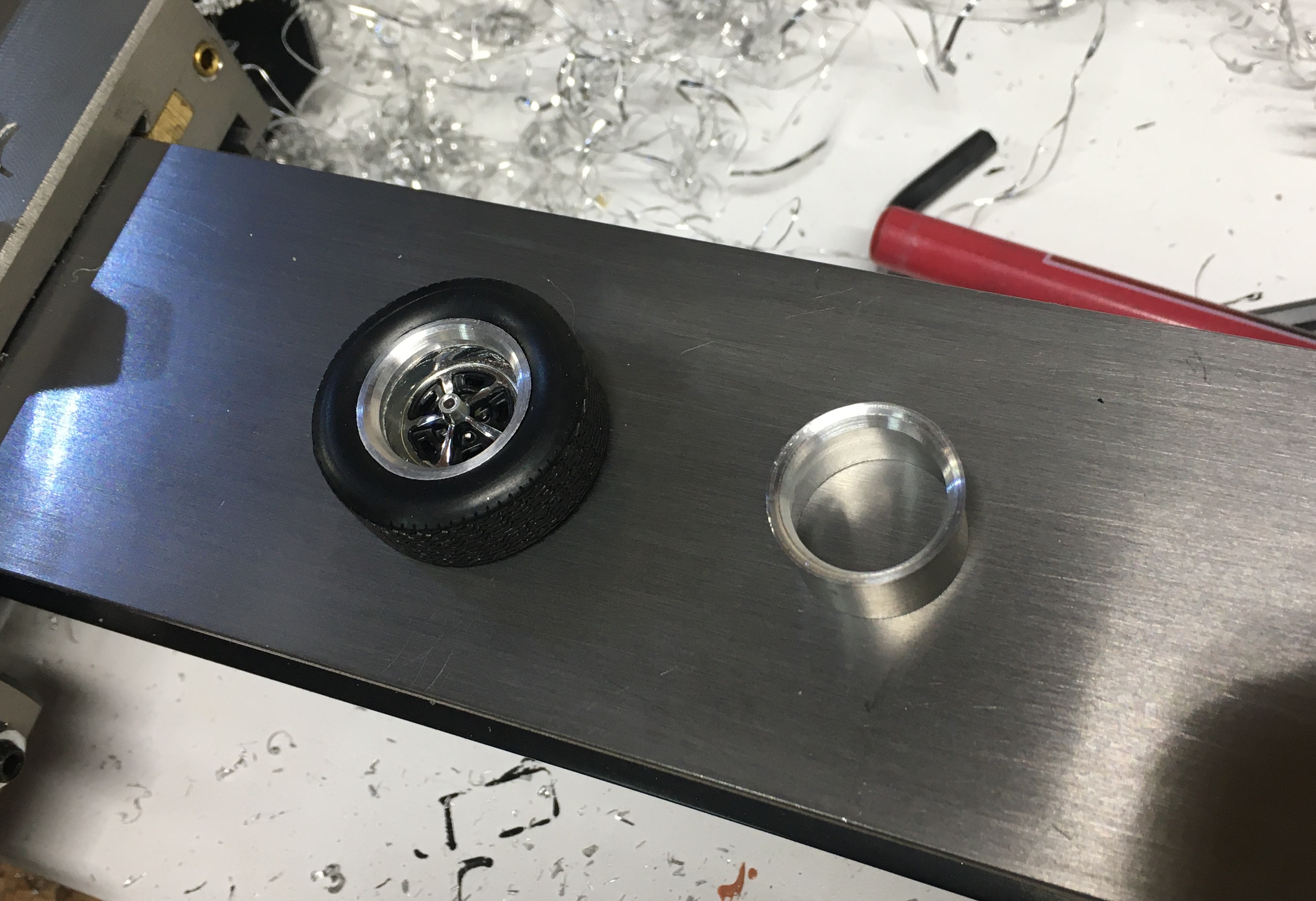

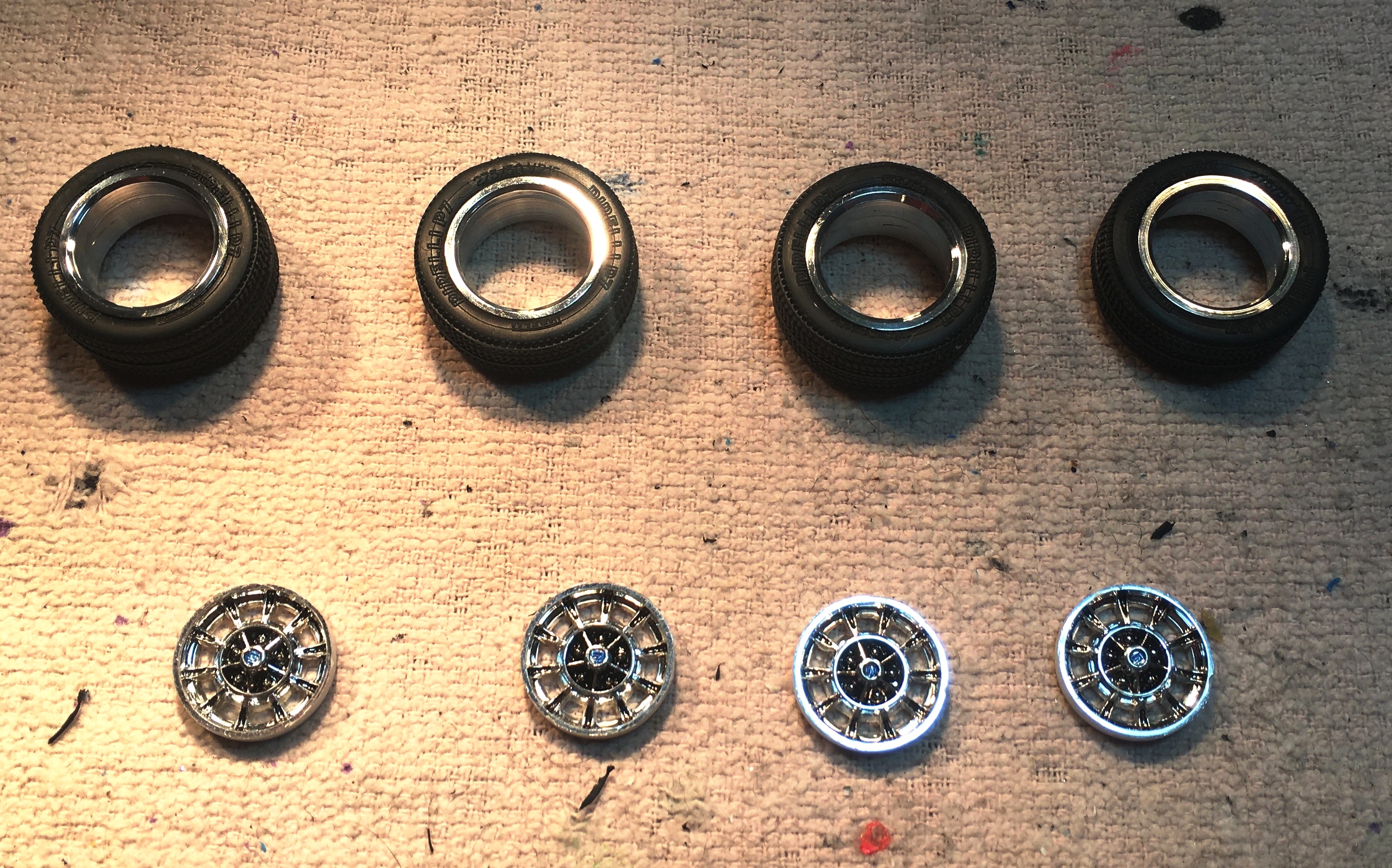

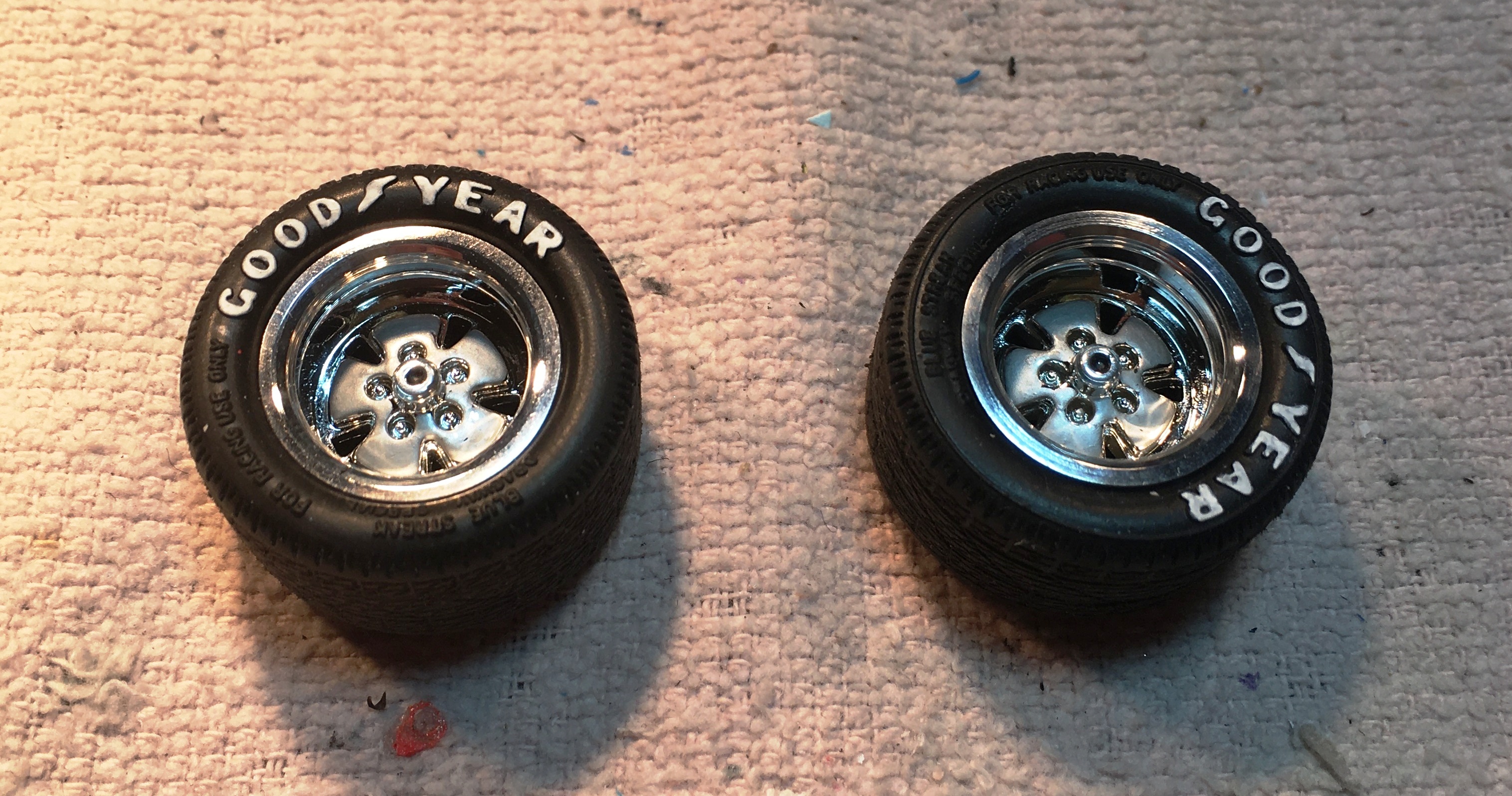

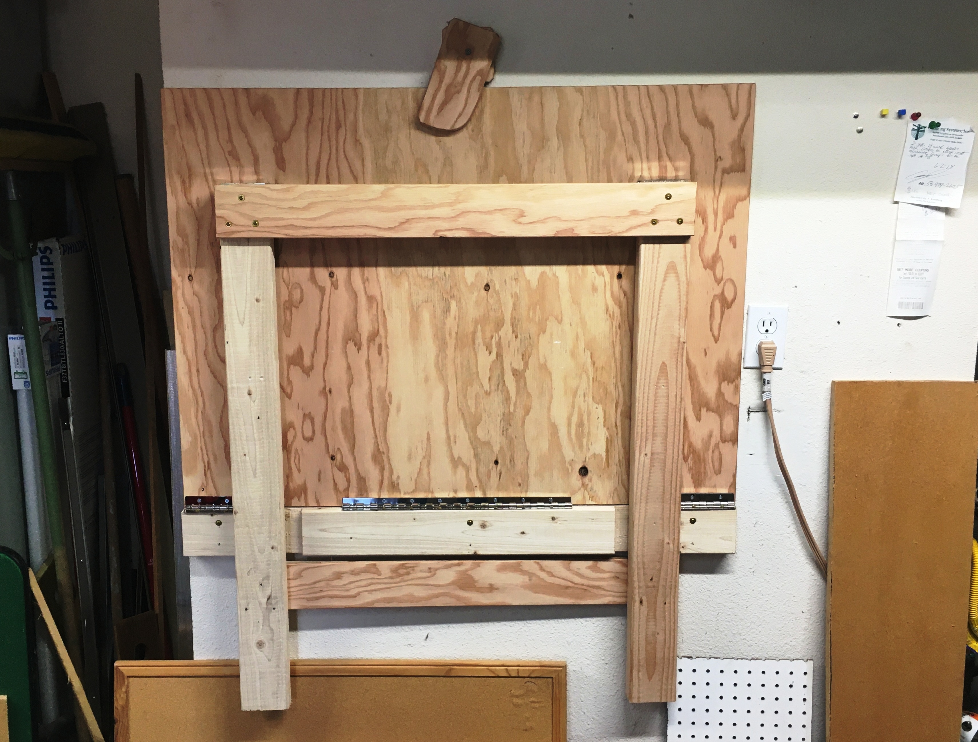

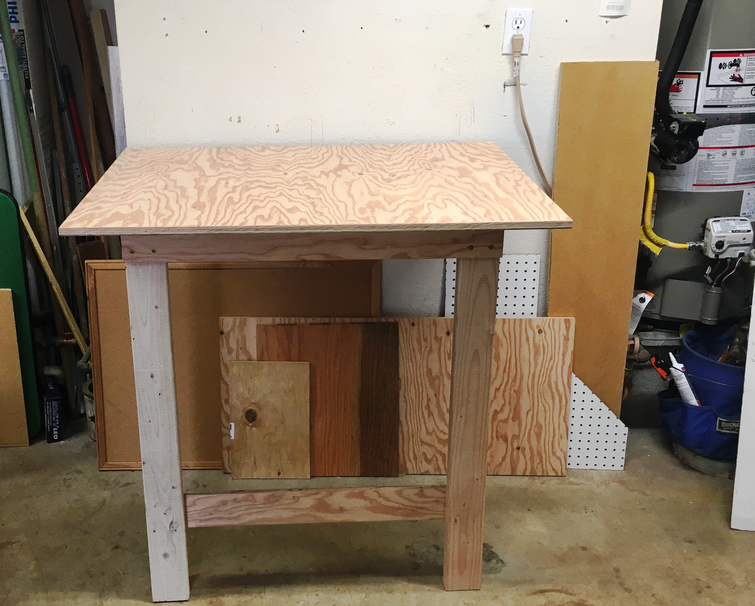

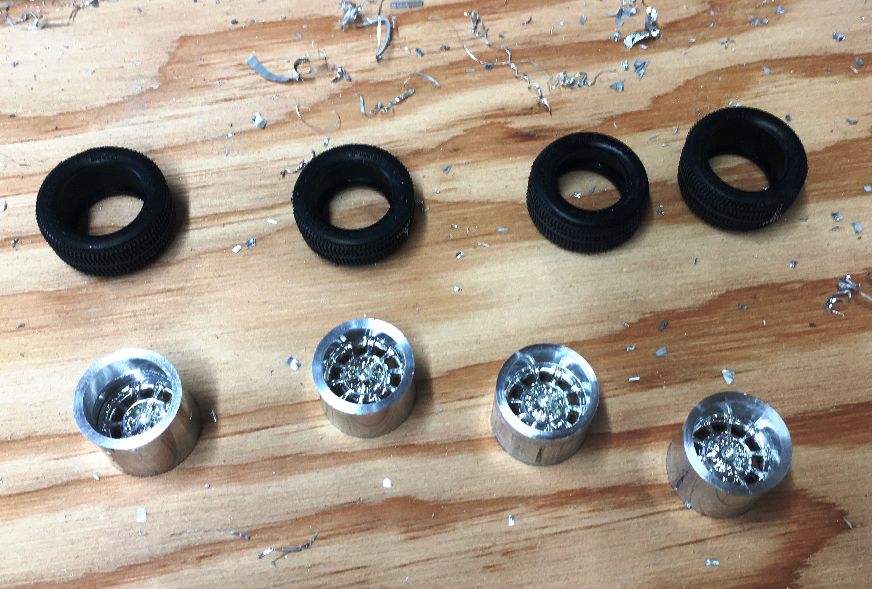

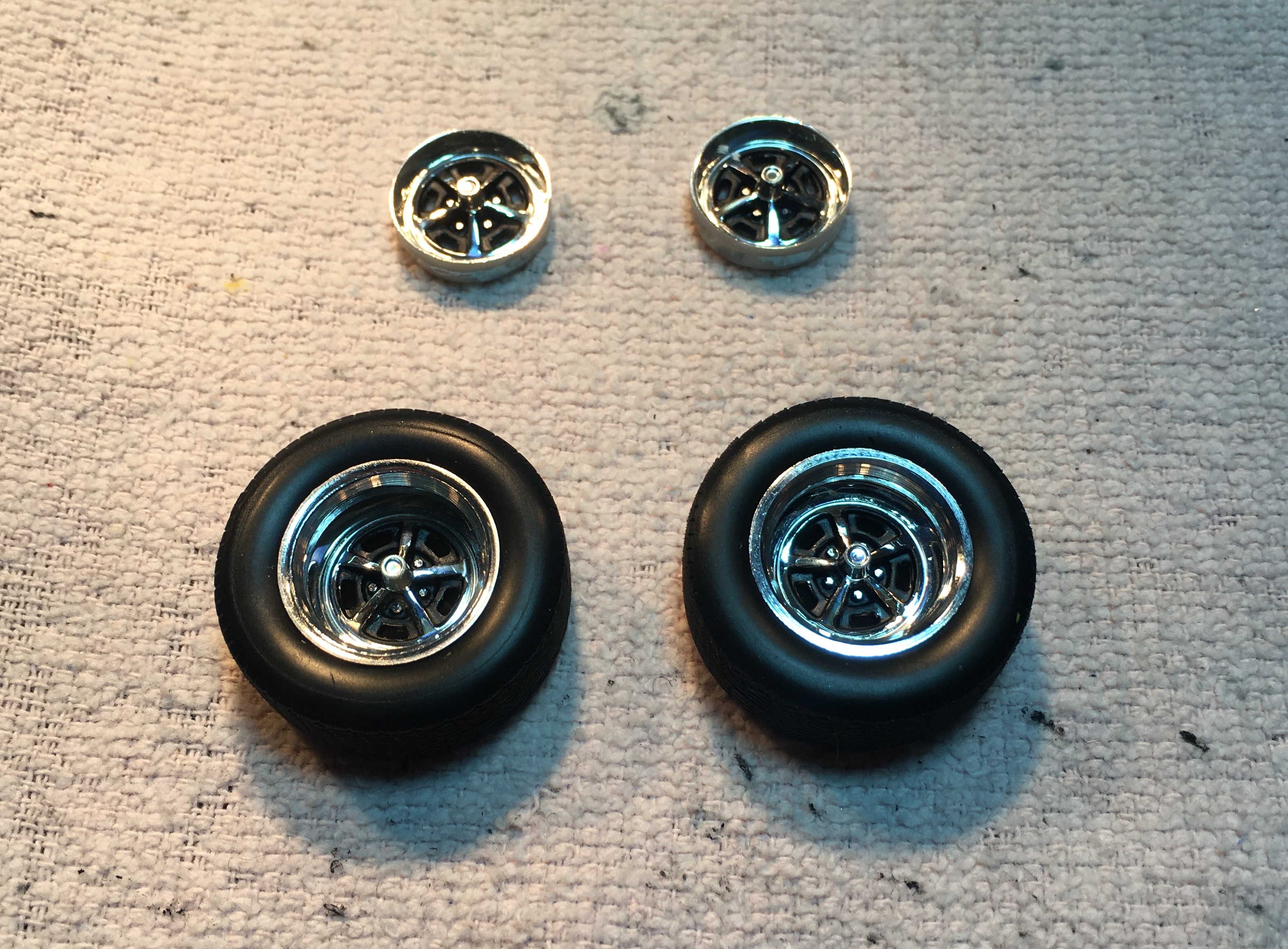

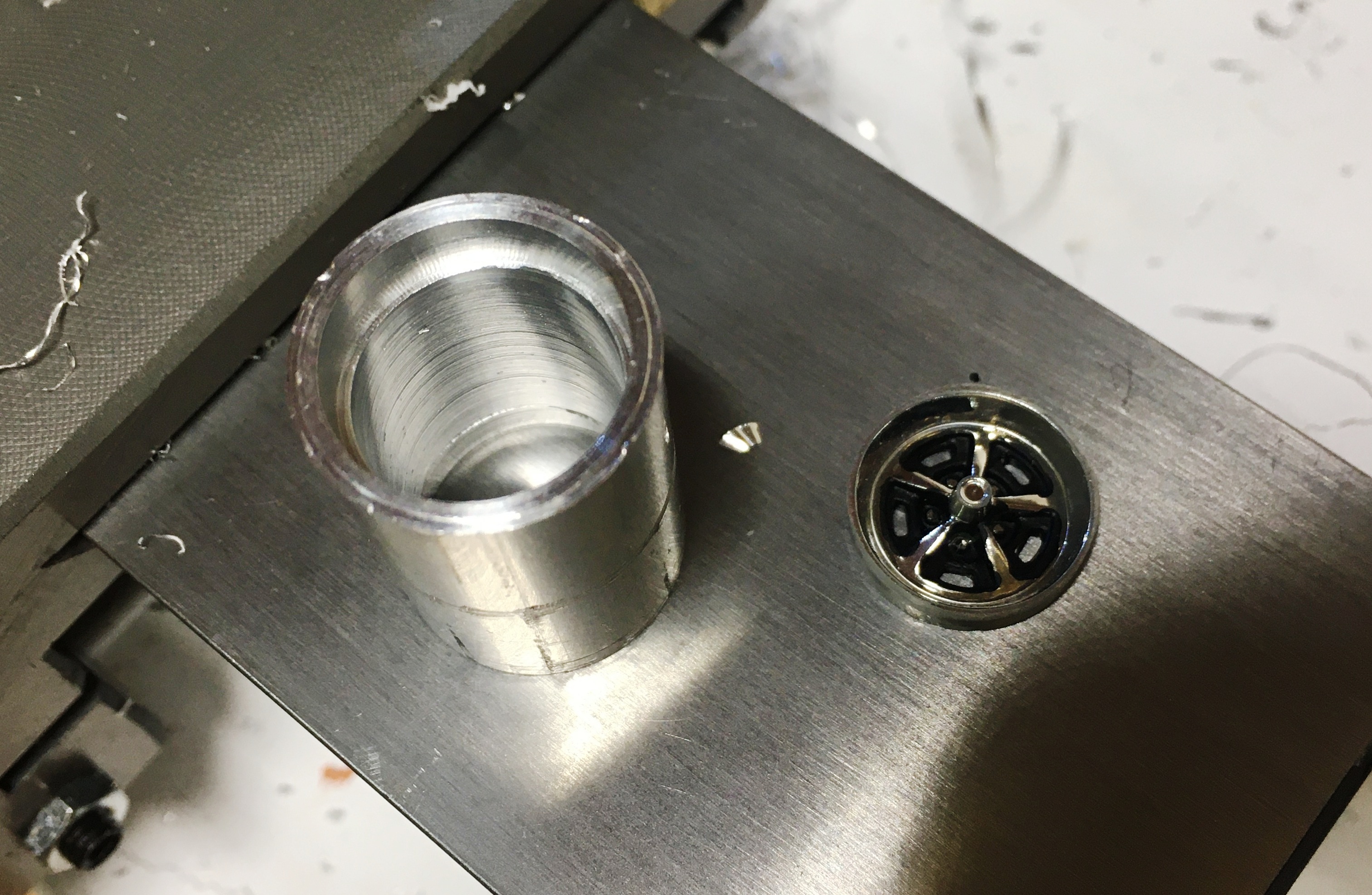

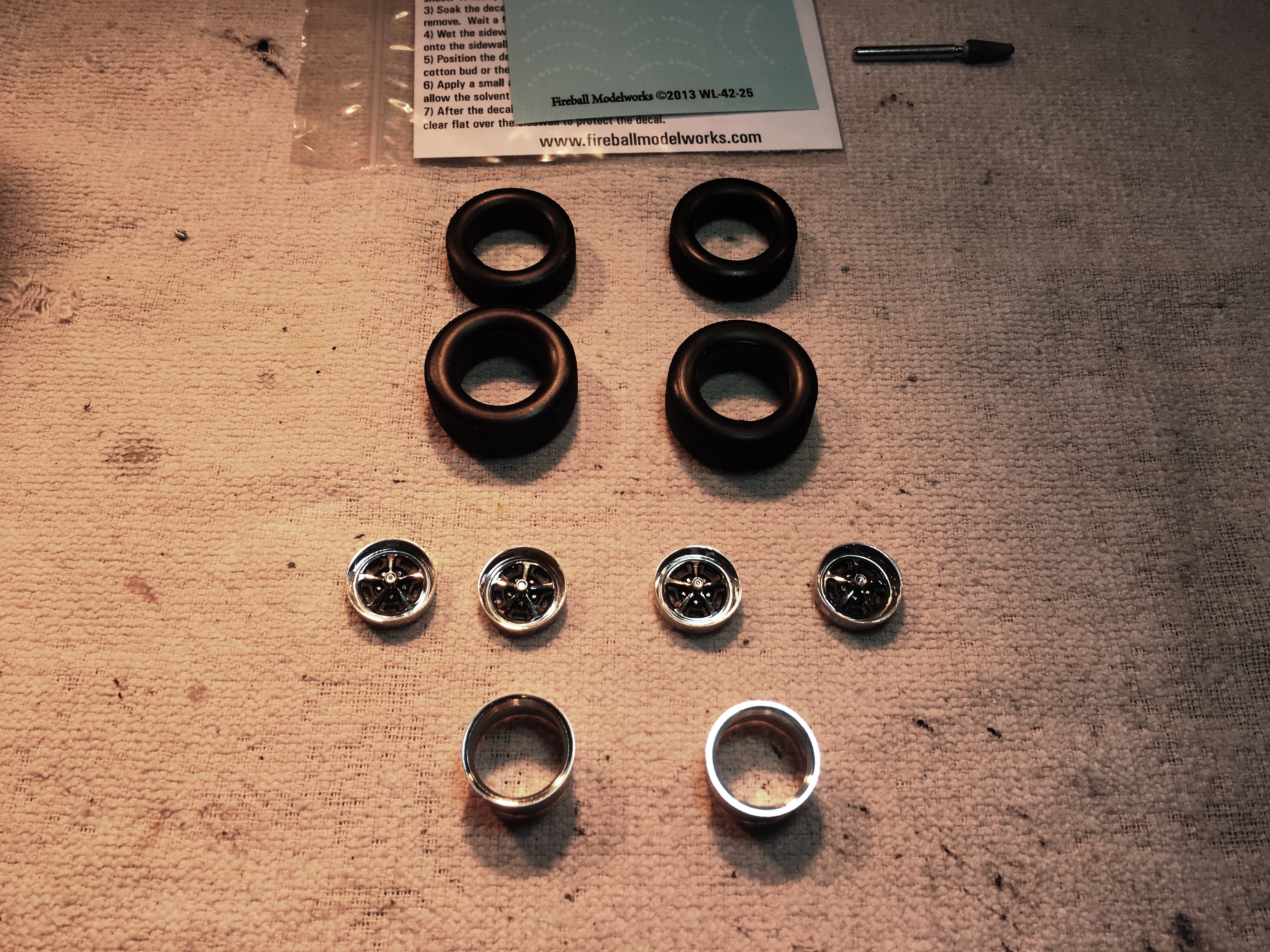

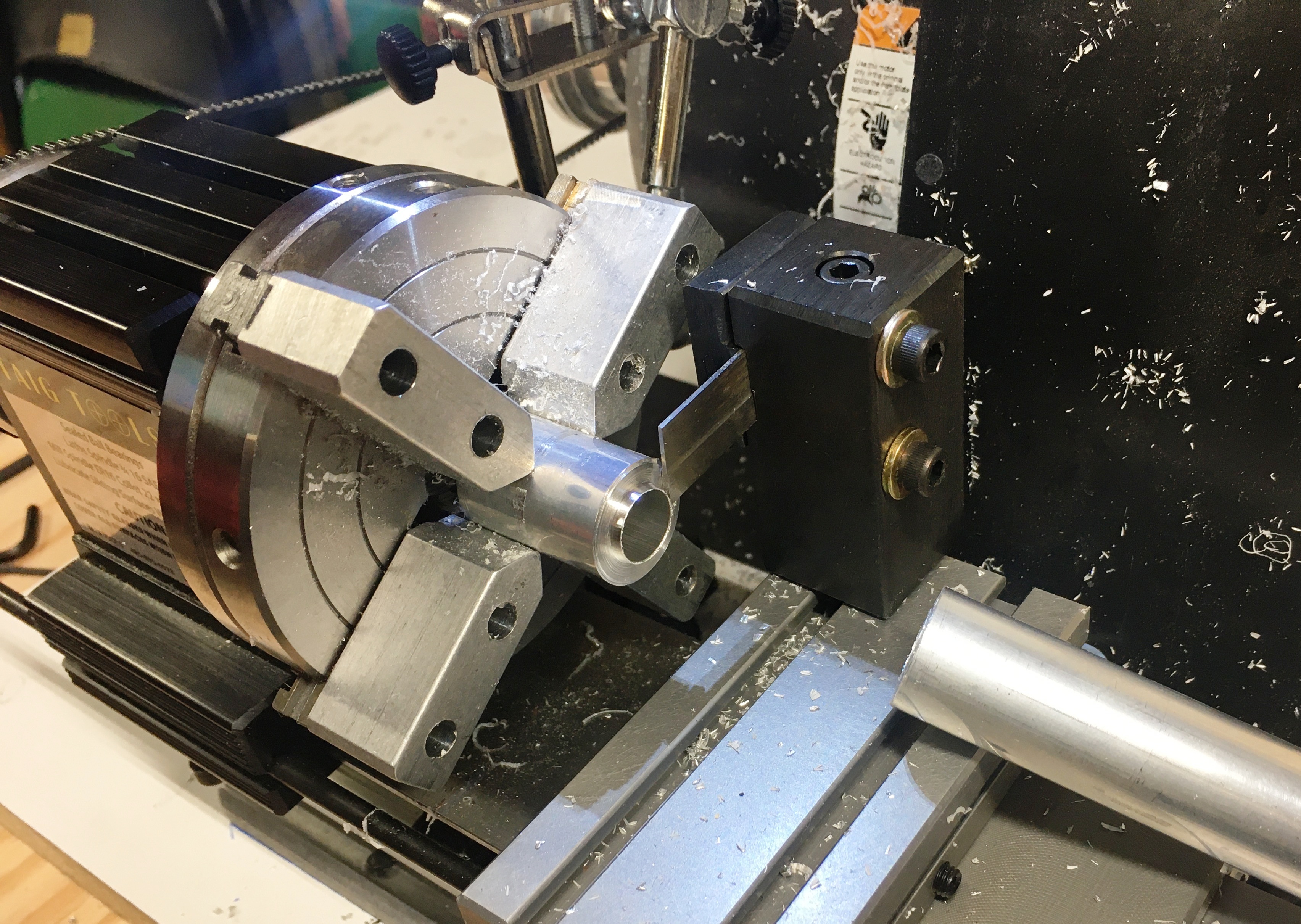

I build day-two "Streetmachine" versions of Muscle Cars. These typically have wider rear tires and mags all around. Up until this point, I always had to sacrifice some other kit's rims to get deep dish rings to get the look I have been going for. Once upon a time, I ordered some aftermarket rims from Hobby Design for a (yet unfinished) project. They came with aluminum hoops and styrene (or resin) centers. I like the concept a lot. Ever since, I always wanted to make my own aluminum hoops. Especially since I have a boatload of nice rims that do not necessarily fit properly in the full model boxes of tires I have. I came into some extra cash around last Christmas, so I purchased a Taig mini lathe. Lathes are very messy and generally take up permanent bench space. My tight 2 car garage always must have two cars in it and I do not have a shop or basement. I made a fold down work bench and mounted the lathe on a base that can be stored on a shelf. This week I finally got to actually use it. I successfully made two pair of custom hoops for the Magnum 500 wheels for my 1969 BOSS 429 Mustang. I look forward to making more for future builds.

It may not be able to do everything a bigger lathe can do, but I needed portability as I do not have the room to keep it permanently set up.
It definitely does what I wanted to do very well. It also has 6 speeds that you can change in about 5 seconds due to the belt drive design.
I even made mine reversible.
