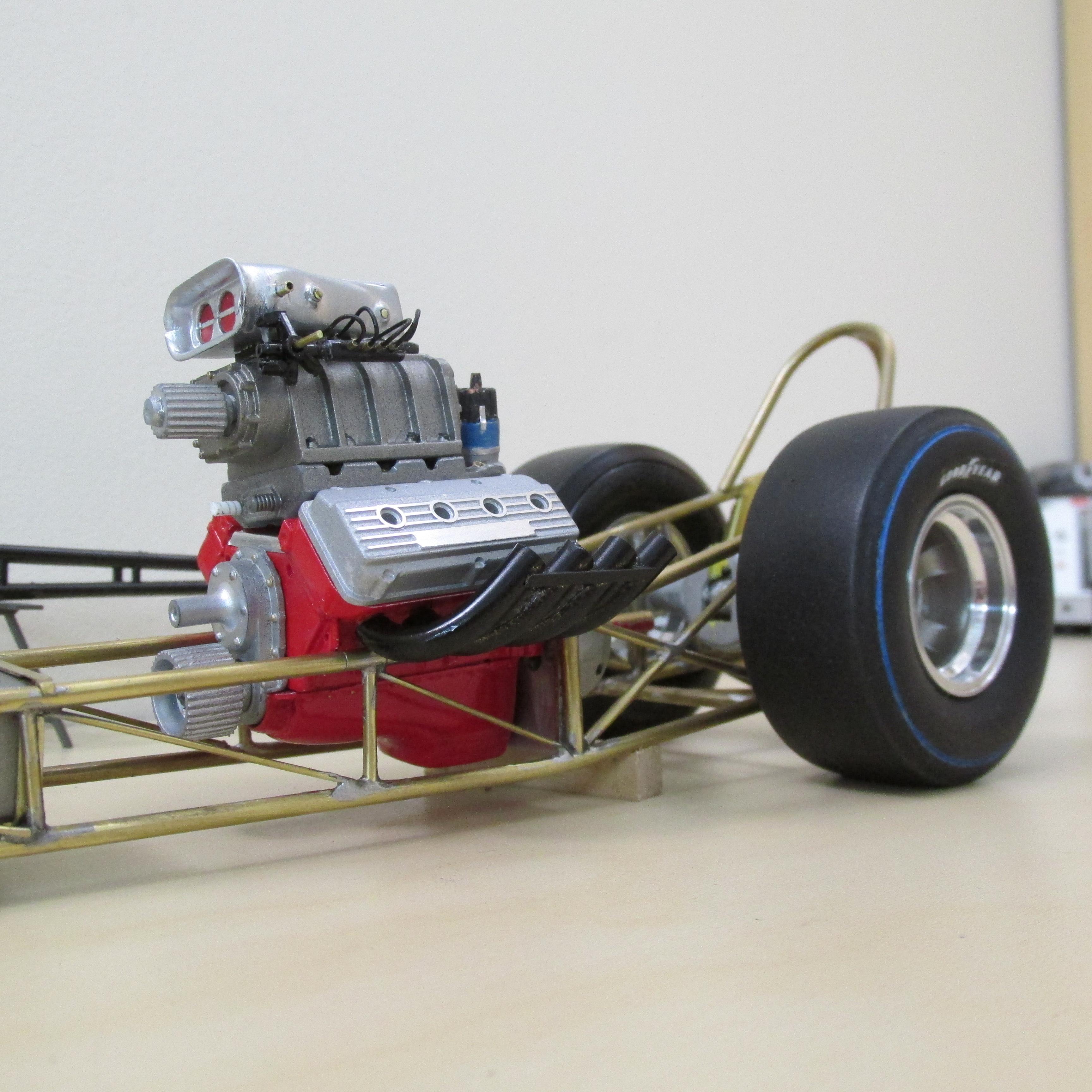

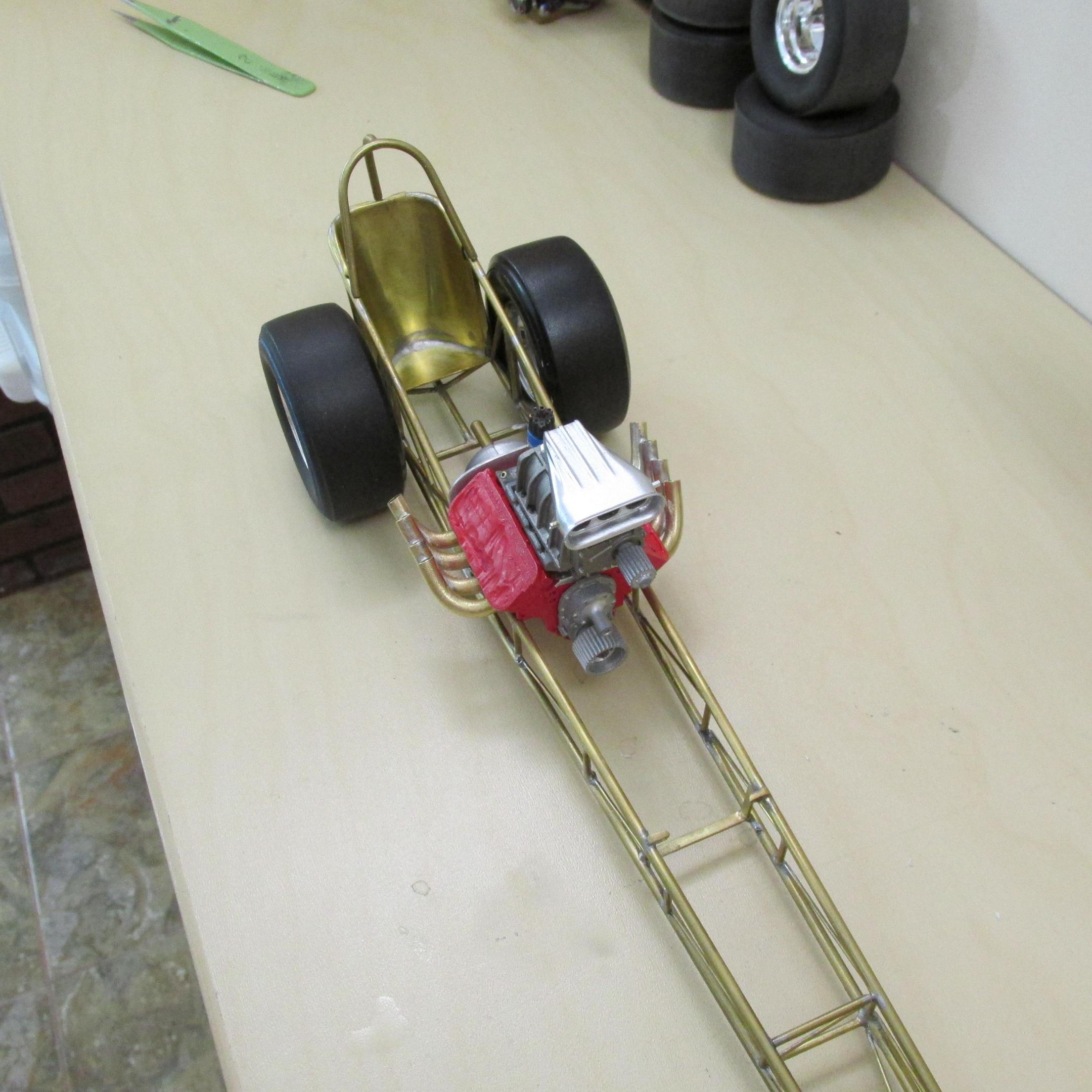

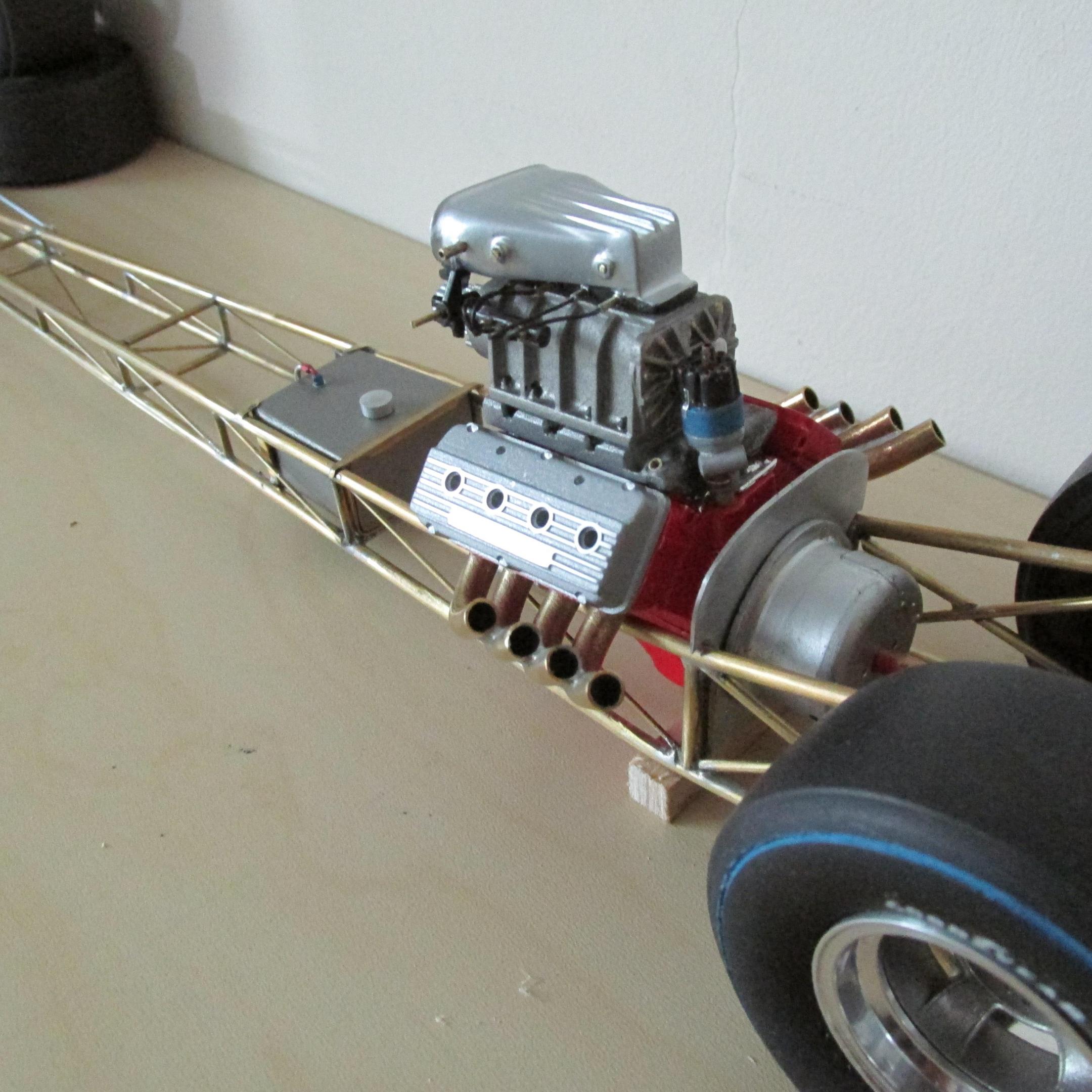

Ian McLaren Posted September 13, 2021 Author Posted September 13, 2021 Headers just hung on the studs. Once tightened the exits will be pretty much vertical.
Codi Posted September 15, 2021 Posted September 15, 2021 Headers look fantastic Ian. Are you going to add the cross brace to them? The angle and up sweep look spot on! cheers, tim

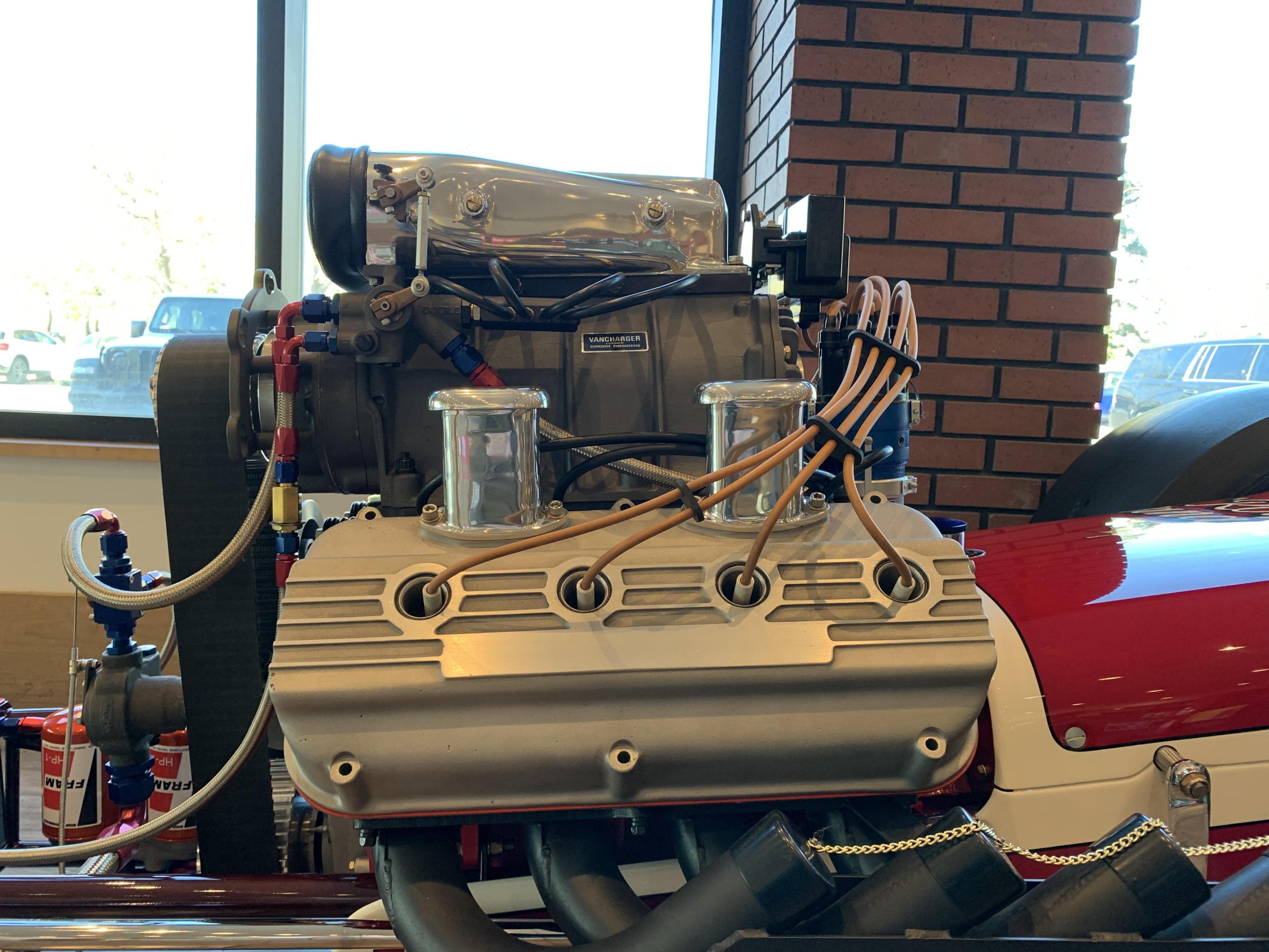

Ian McLaren Posted September 16, 2021 Author Posted September 16, 2021 Barrel valve, and upper injectors with lines installed, fully polished machined aluminum valve cover recoated in natural aluminum and nameplate and fins re polished

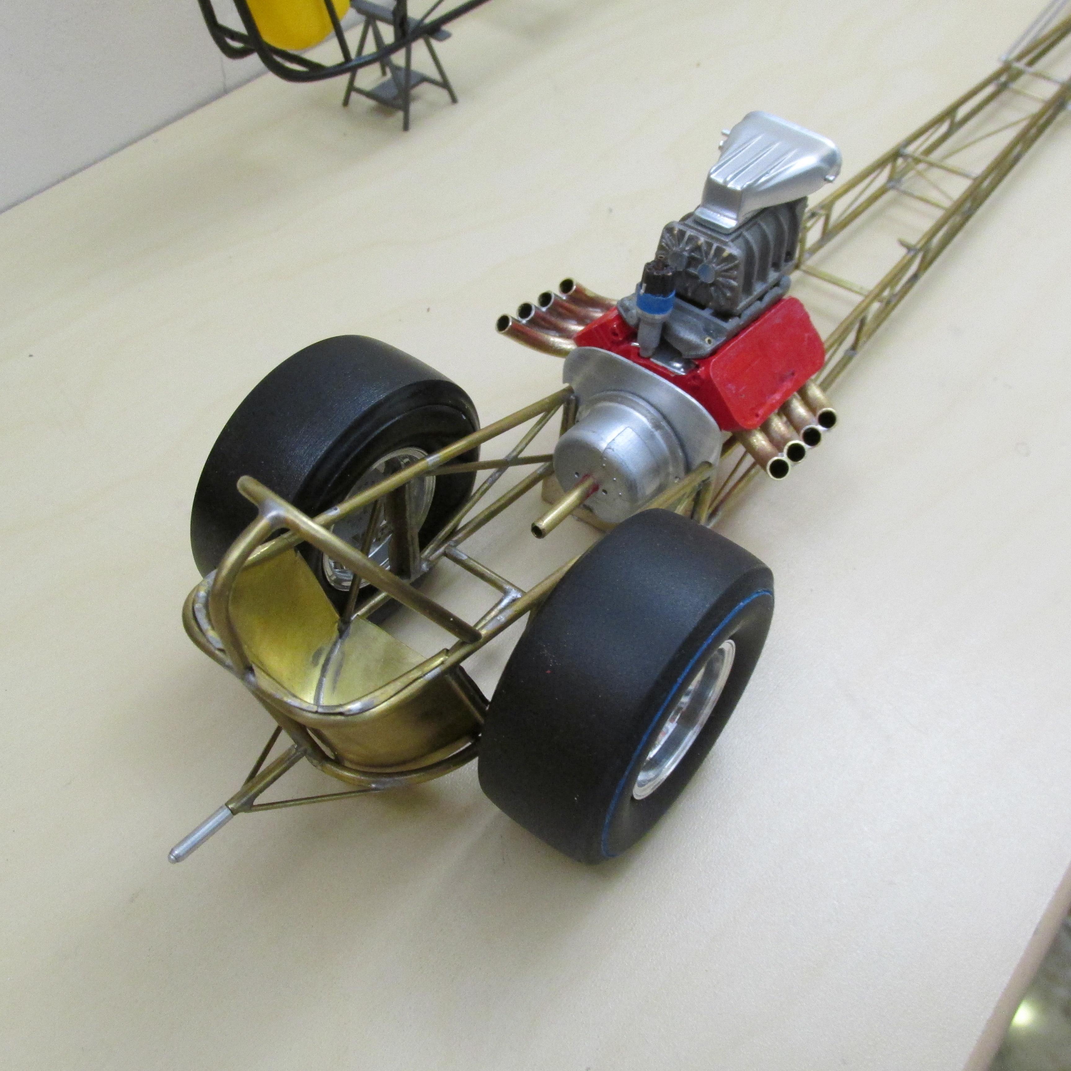

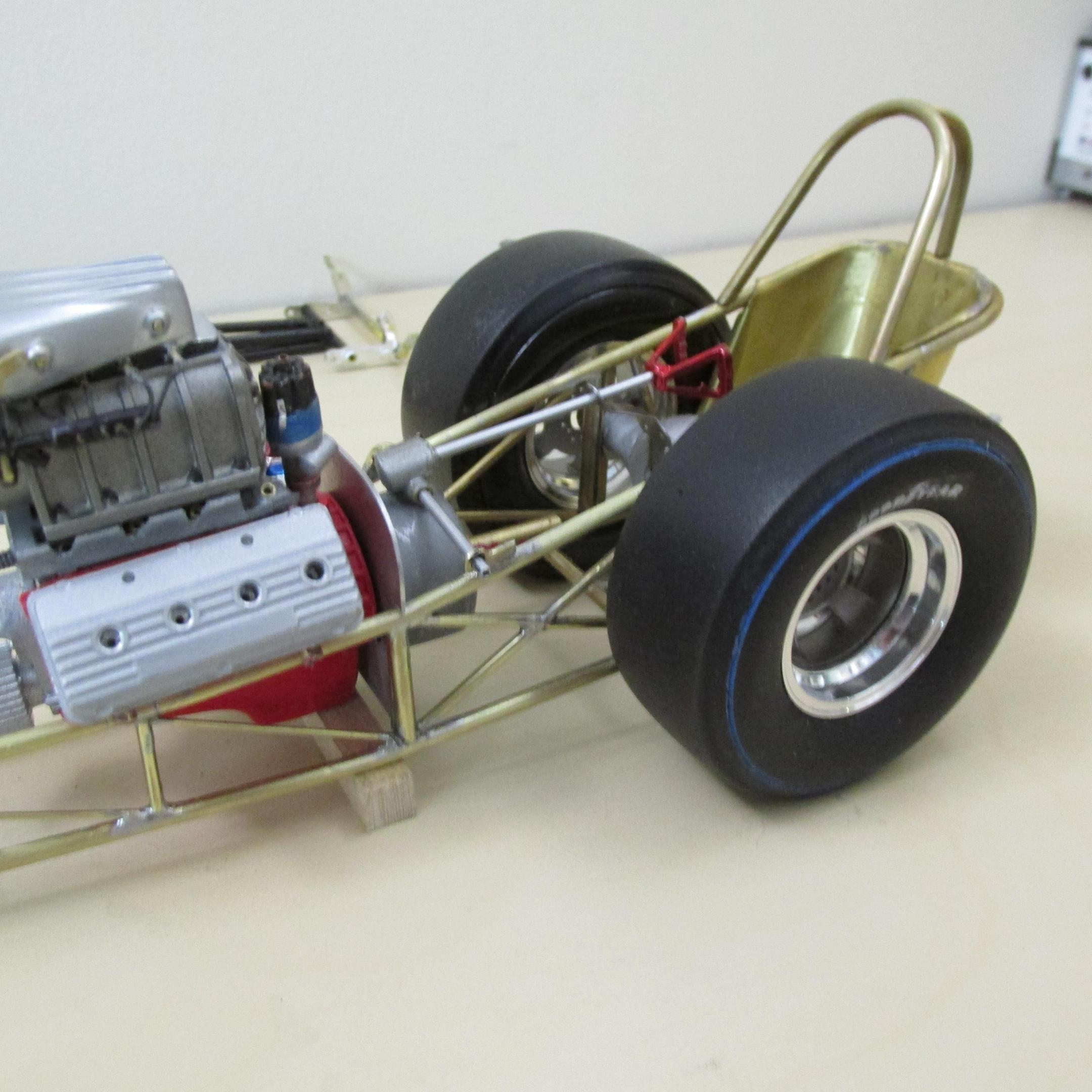

Ian McLaren Posted September 17, 2021 Author Posted September 17, 2021 (edited) 33 minutes ago, Nitrobarry said: Keep goin Ian, I`m sure Don K will be quite pleased when this is finished! Well done! Hi Barry I'm not sure Don even knows about the project, I've been building it fir Bryan Hodges, the current owner. Here's where I'm at today Dropped the intake this morning , these 3D printed parts are like handling glass, I was going to change both sides with HO gauge railroad coupler springs and RB Motion bolt pins and washers anyway. As well as cleaning up the remaining solder joints Edited September 17, 2021 by Ian McLaren

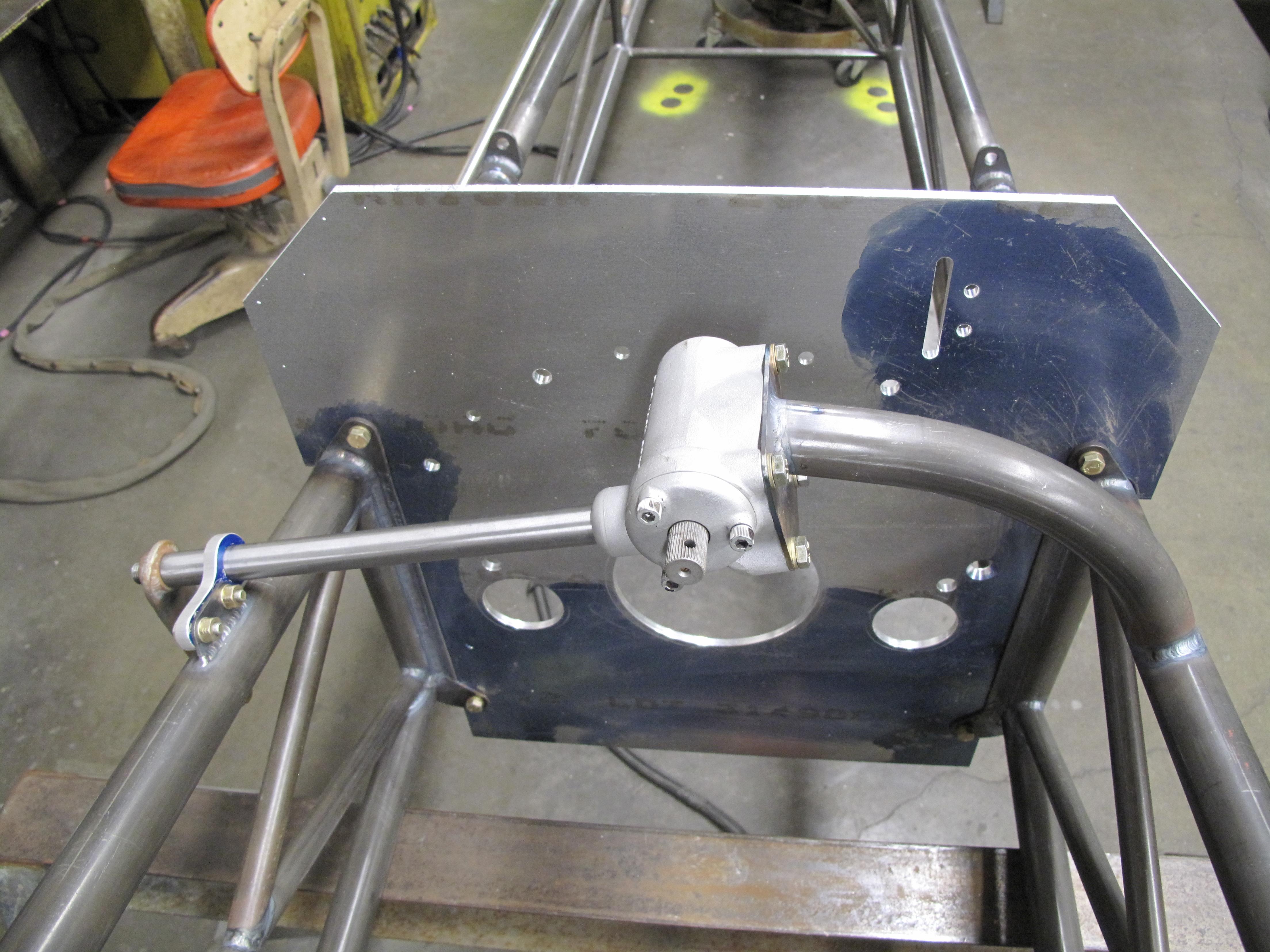

Ian McLaren Posted September 26, 2021 Author Posted September 26, 2021 Steering box mount fabricated and installed. Now I have the same problem with installing the bellhousing from the top as the real car. Also fabricated the rear steering shaft mount. Steering wheel is a kit piece that will be replaced by a Future Attractions photo etch piece.

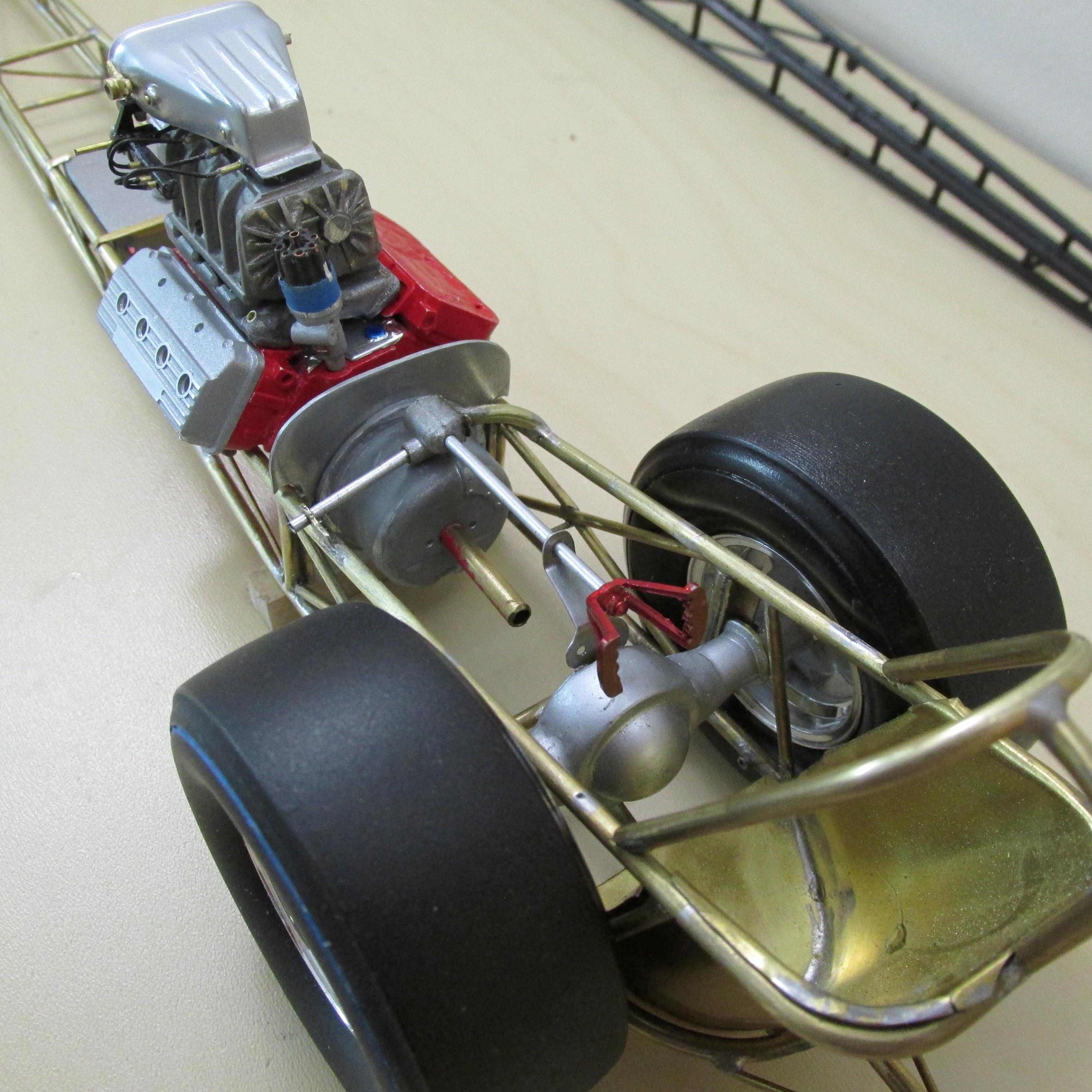

Ian McLaren Posted October 10, 2021 Author Posted October 10, 2021 The engine is progressing, swapped out the Donovan based blower manifold for a lower profile CRAGAR manifold to match the one that is run on the car. Lowering the blower a significant amount really enhanced the look of the engine. Scratch built Hilborn PG-175 fuel pump as per the original and 3 way fuel shutoff valve combined with RB Motion anodized fitting to the main fuel just waiting for addition fuel lines and control cables. Working on control cables, arms and linkages next

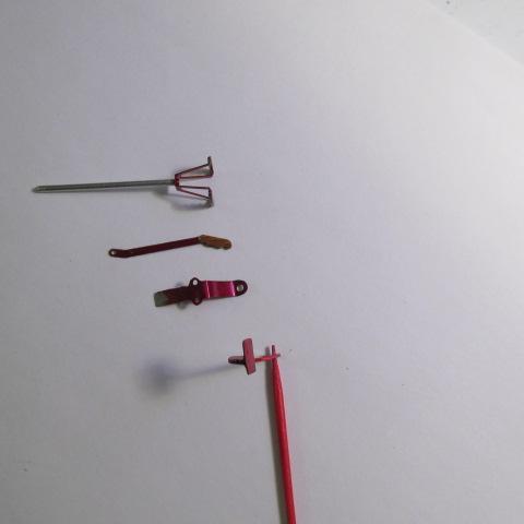

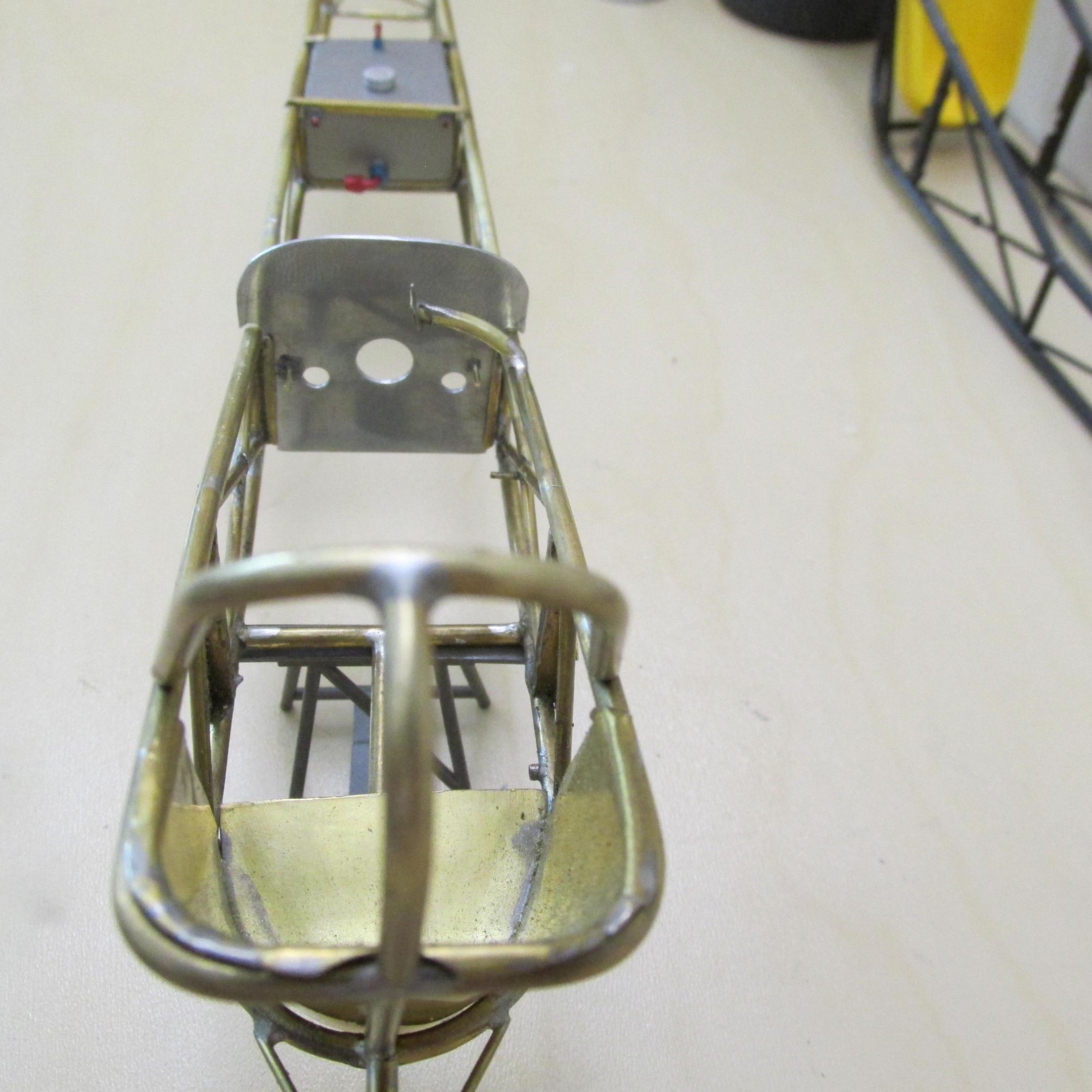

Ian McLaren Posted October 29, 2021 Author Posted October 29, 2021 Just working on pieces right now, clutch pedal and clutch arm just have to build the rod, note the scratch built master cylinder in the back ground, bellhousing with dust tube hole, dust tube will be added once the floor pan hole location is set. Valve covers natural cast aluminum with polished ribs and name plate area just waiting for plug boots, fasteners and breathers, dual parachute mounting plate and helmet bar with embossed padding also showing First color as a test and the painted helmet bar.

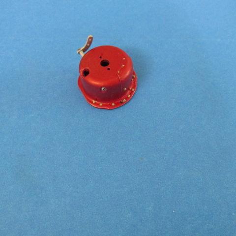

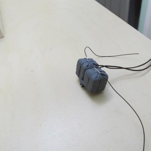

Ian McLaren Posted November 11, 2021 Author Posted November 11, 2021 (edited) On 11/7/2021 at 3:06 AM, Lee Yoder said: Any more progress with this Ian? Later, Lee Just a bunch of bits and pieces not really the stuff of updates, but here are a couple. Chute pack hand carved and a mold made, this is the first casting out of the mold also my first attempt at this procedure. Aluminum rear face on the seat added. Happy with the wood on the steering wheel Edited November 11, 2021 by Ian McLaren
