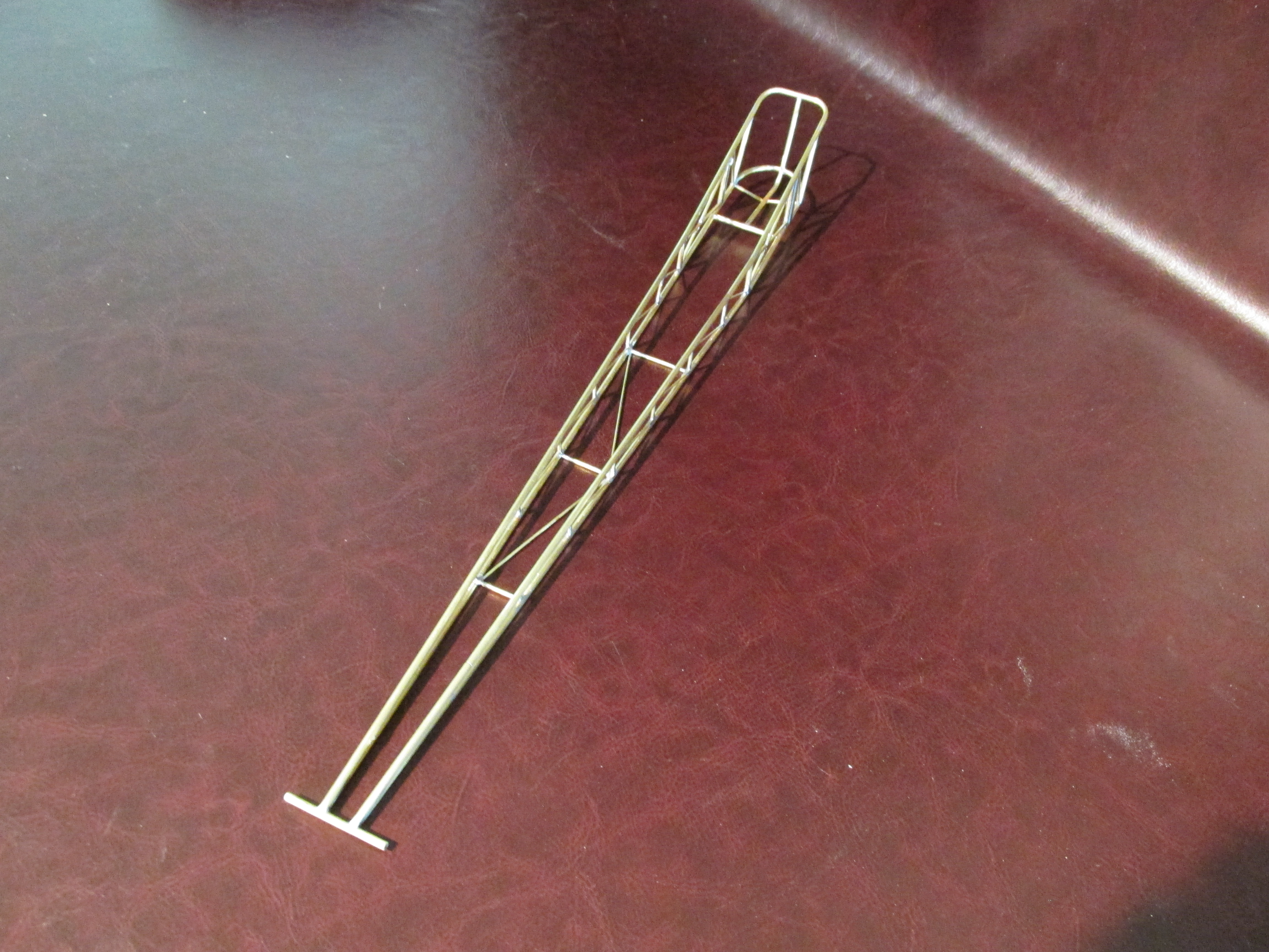

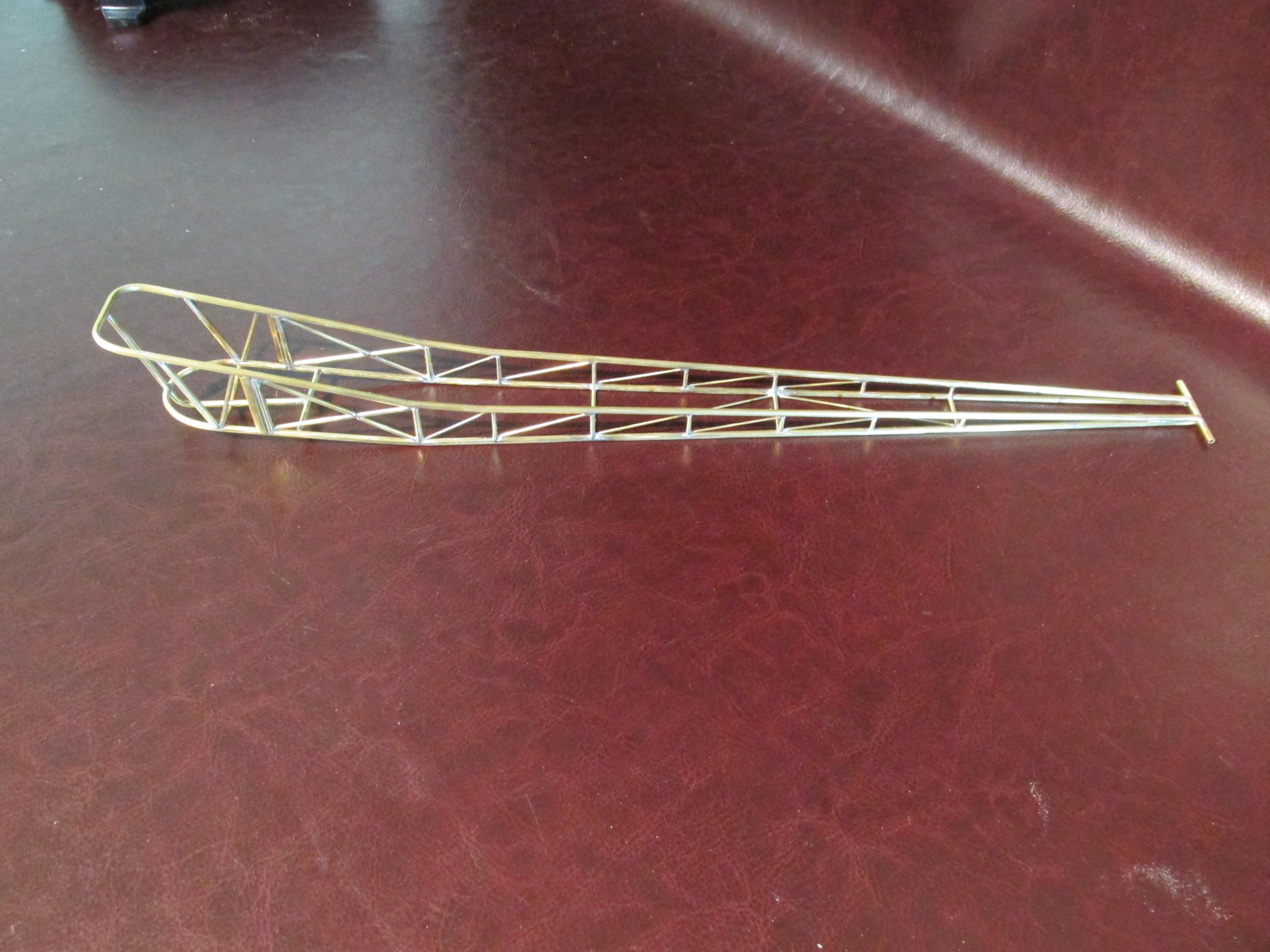

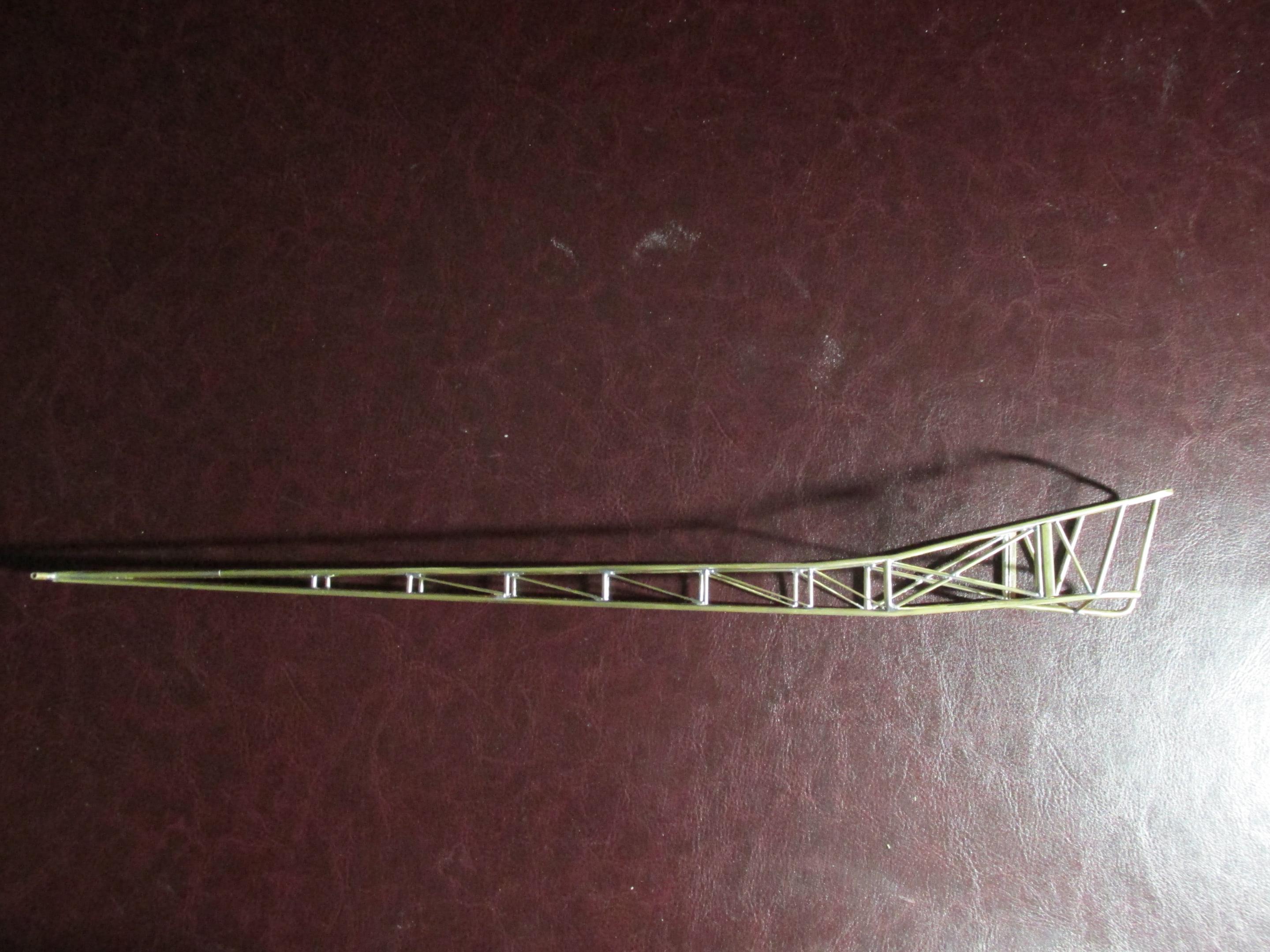

Ian McLaren Posted May 24, 2021 Author Share Posted May 24, 2021 Sides have the main tubes and cross braces installed Quote Link to comment Share on other sites More sharing options...

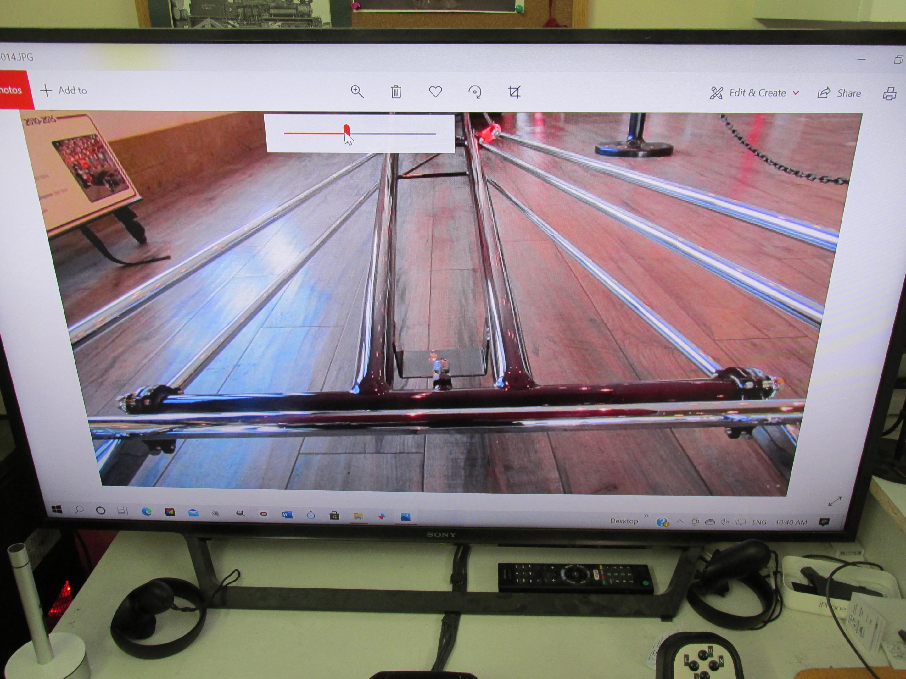

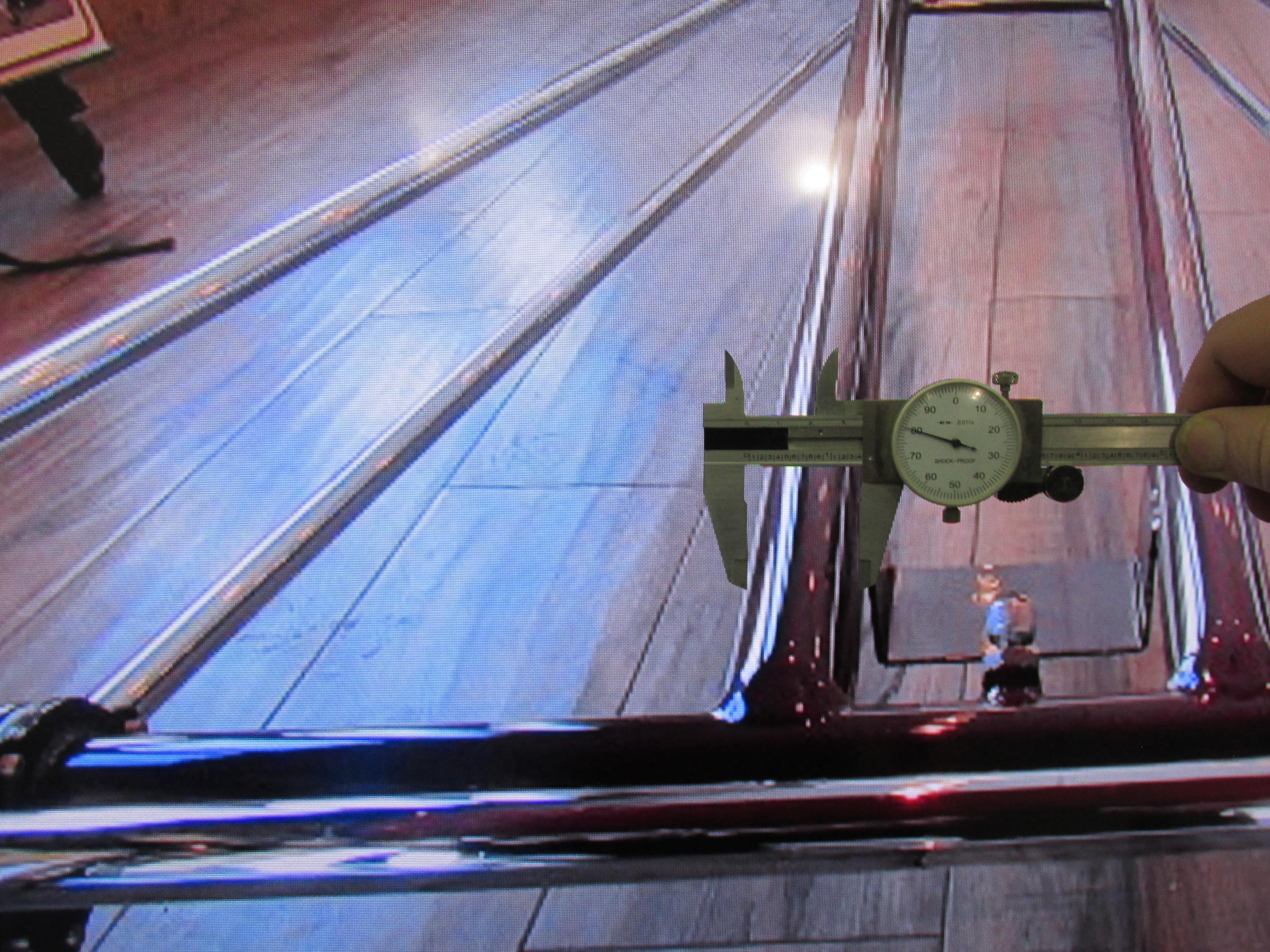

Ian McLaren Posted May 30, 2021 Author Share Posted May 30, 2021 (edited) Torsion bar tube and rear upper and lower hoops in, chassis is square and straight thanks to the jig I built this morning. All measurements checked from measurement taken from the real car, conversations with the owner , and close to 500 pictures from in period, current restored condition and during the restoration at Don Longs shop and others. The plan in the background I received from Roger Lee of a Woody RCE chassis from around the same time. I'm using it as a reference only confirm I'm on the right track. And the advantages of a large (30 INCH) monitor, I can take a photo and if I know the actual size of any one item IE upper frame rail, I can enlarge the image until that item is full size.. I can then measure most things that are in the picture as though the car was in my workroom to a reasonable amount of accuracy. Edited May 30, 2021 by Ian McLaren Quote Link to comment Share on other sites More sharing options...

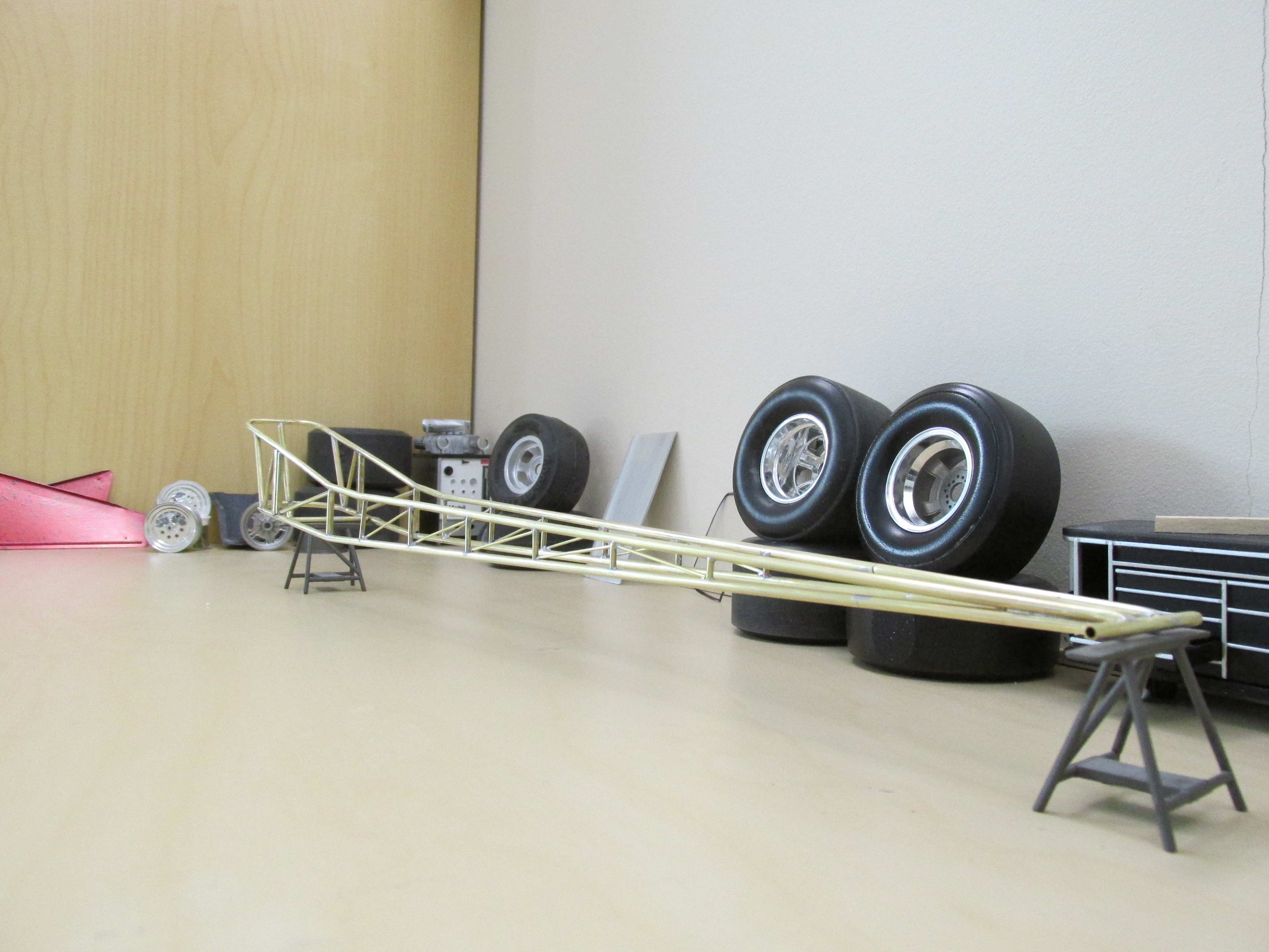

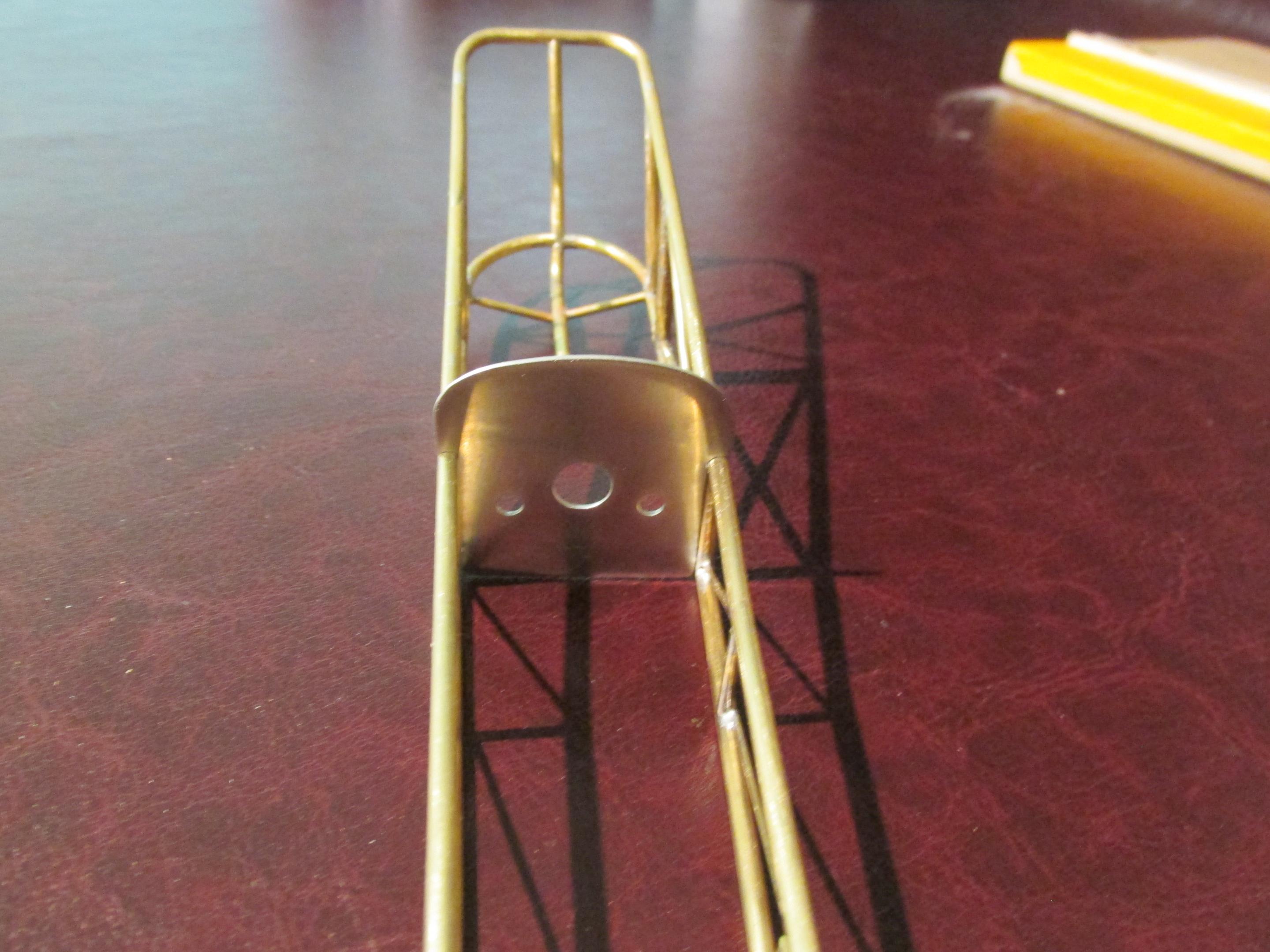

Ian McLaren Posted June 1, 2021 Author Share Posted June 1, 2021 This is the chassis basically set out, only missing a couple of top cross braces but I need to start planning where the brackets and parts are going to go and when additional details have to be mounted 1 Quote Link to comment Share on other sites More sharing options...

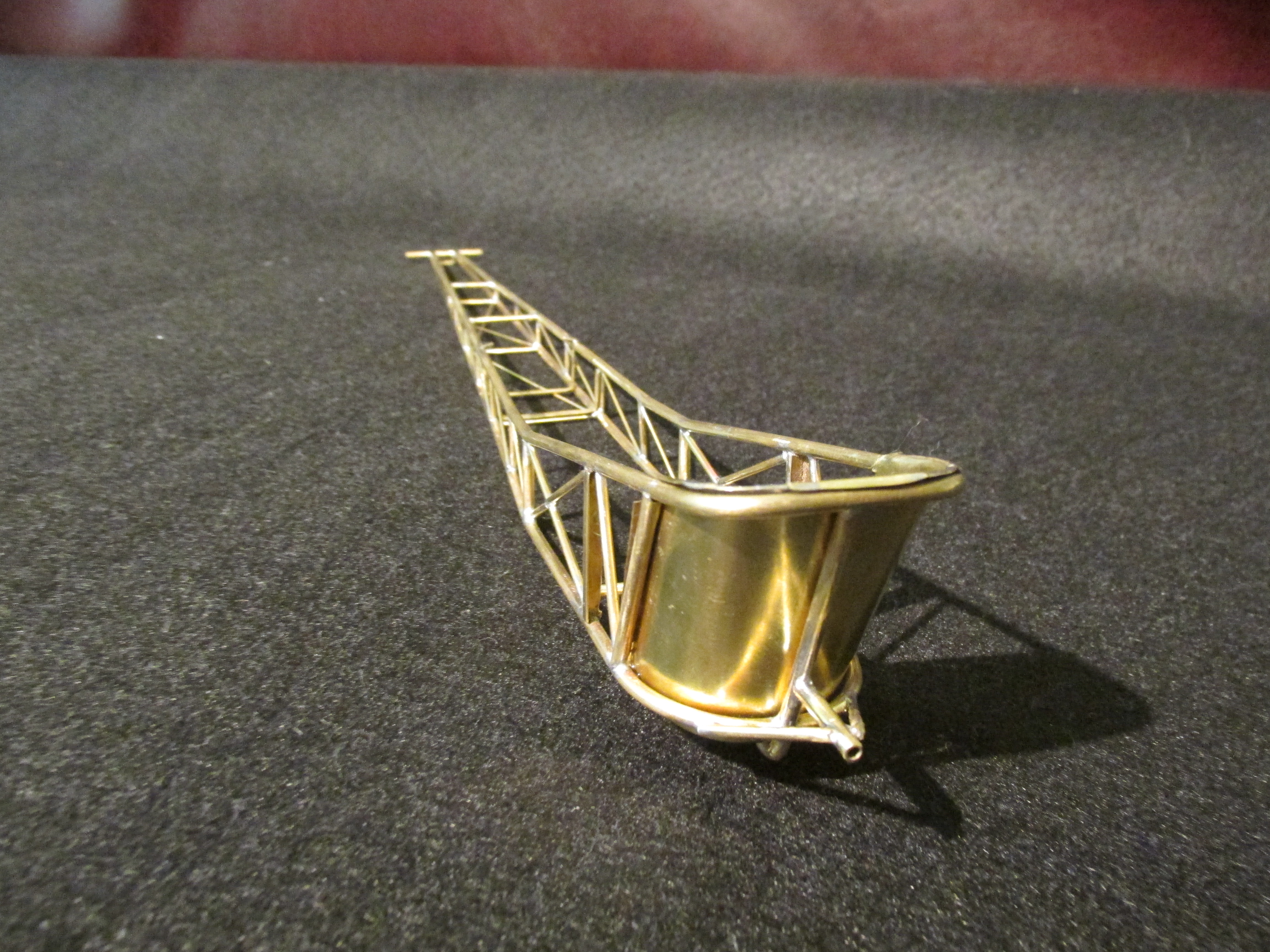

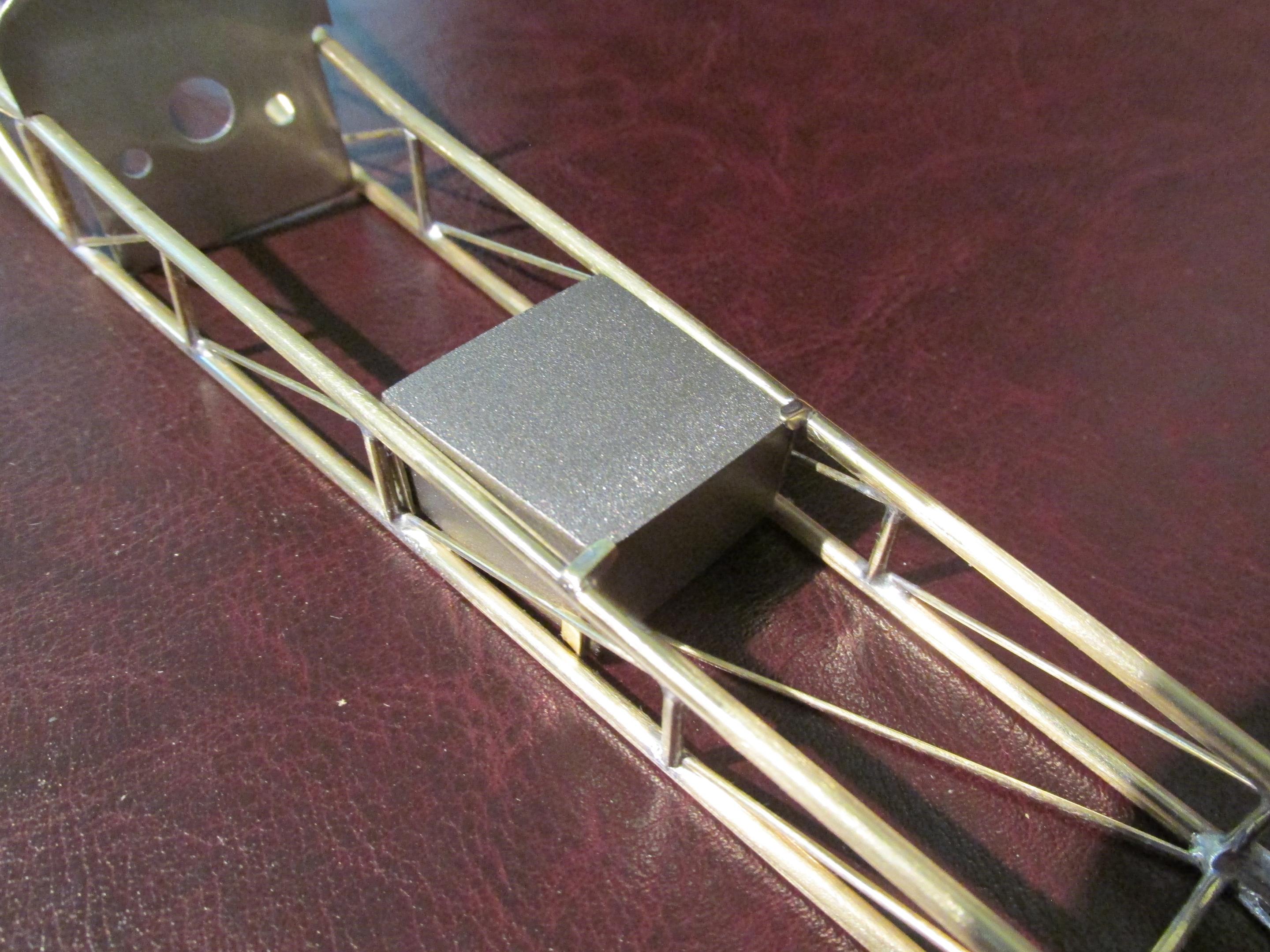

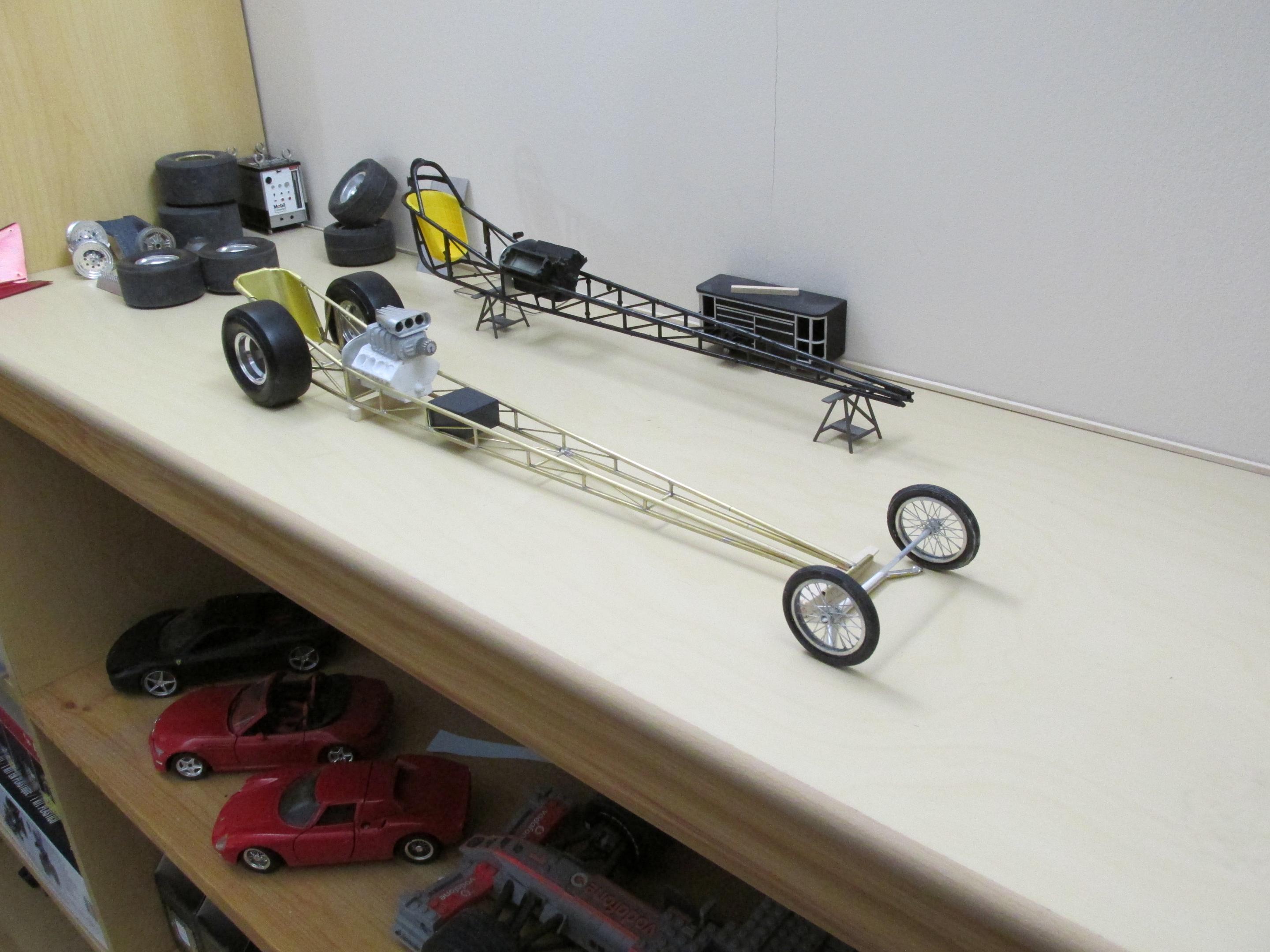

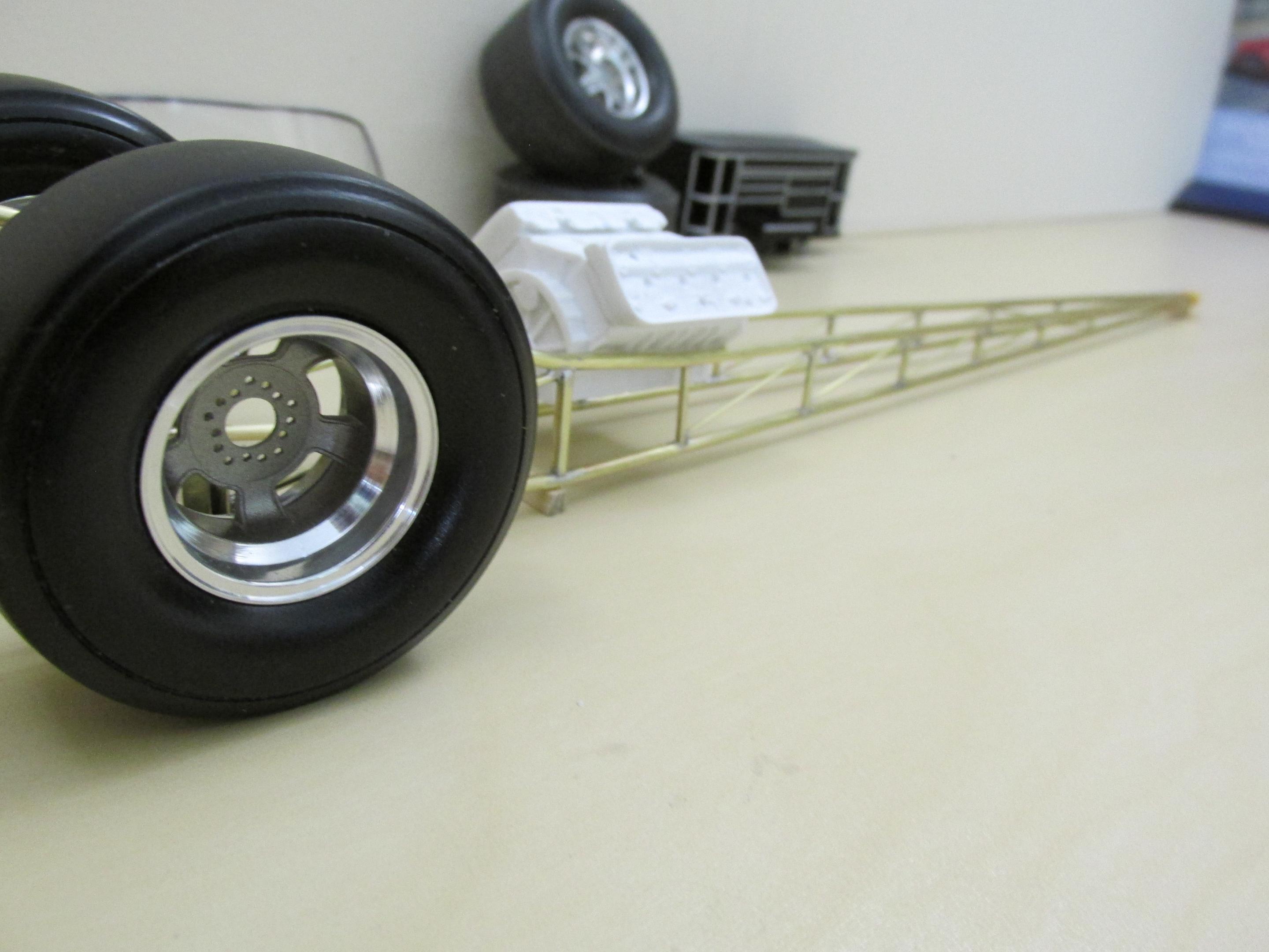

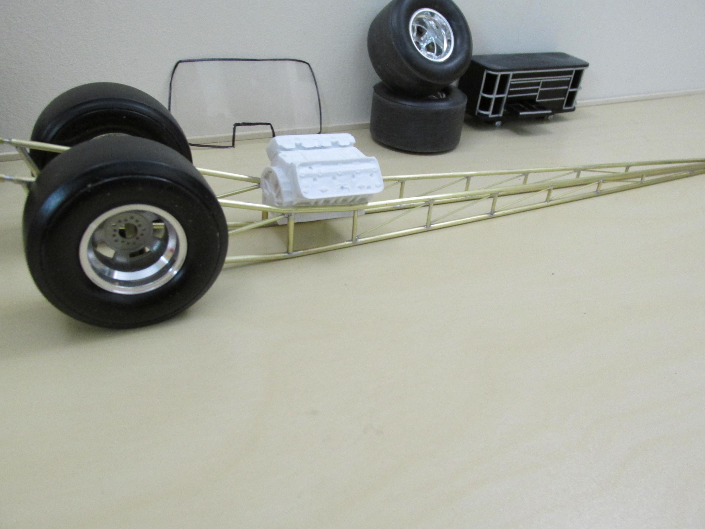

Ian McLaren Posted June 5, 2021 Author Share Posted June 5, 2021 Rough mockup at 4 inch ride height to establish rear axle vertical positioning on uprights, motor plate fitted with the major details in place, fuel tank rough blank sitting on installed lower tank straps and secured with front corner hold down tabs Quote Link to comment Share on other sites More sharing options...

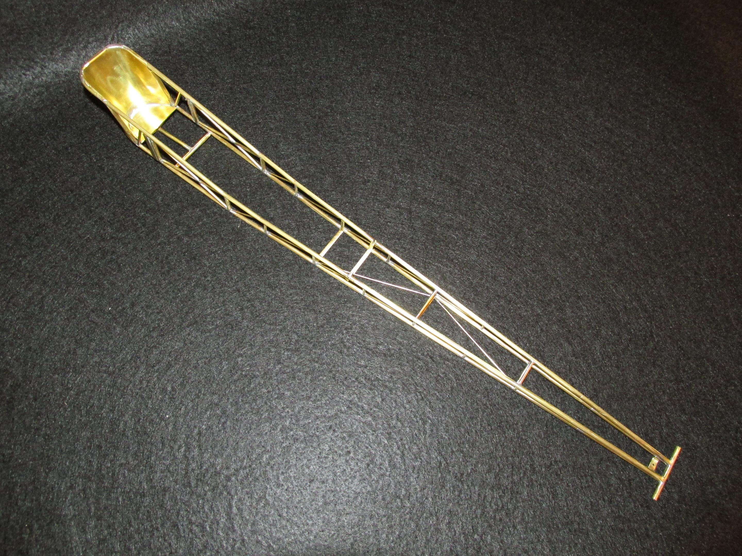

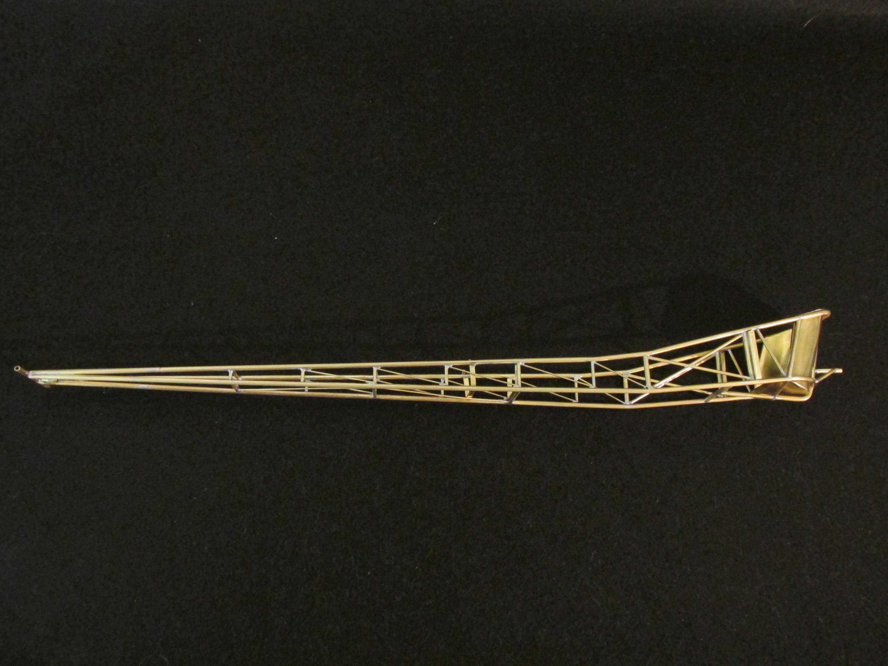

Ian McLaren Posted June 12, 2021 Author Share Posted June 12, 2021 Structurally the chassis is complete, less the roll bar which has to go on last brackets and mounting points have to be added, but other than that virtually every thing bolts on. 1 Quote Link to comment Share on other sites More sharing options...
