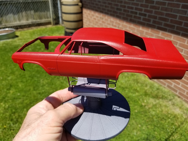

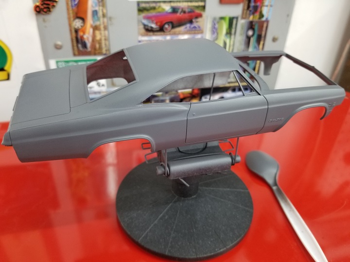

Zippi Posted May 25, 2021 Posted May 25, 2021 (edited) Yup. Rust-Oleum 2X Flat Gray primer is what I always use. I airbrush craft acrylic paints and Tamiya acrylic paints. Here is a 65 Impala body I primed in Rust-Oleum Flat Gray that I shot Tamiya X-7 red acrylic paint over. Edited May 25, 2021 by Zippi
