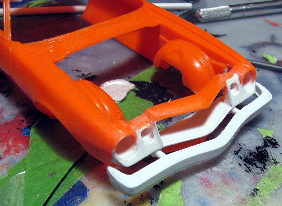

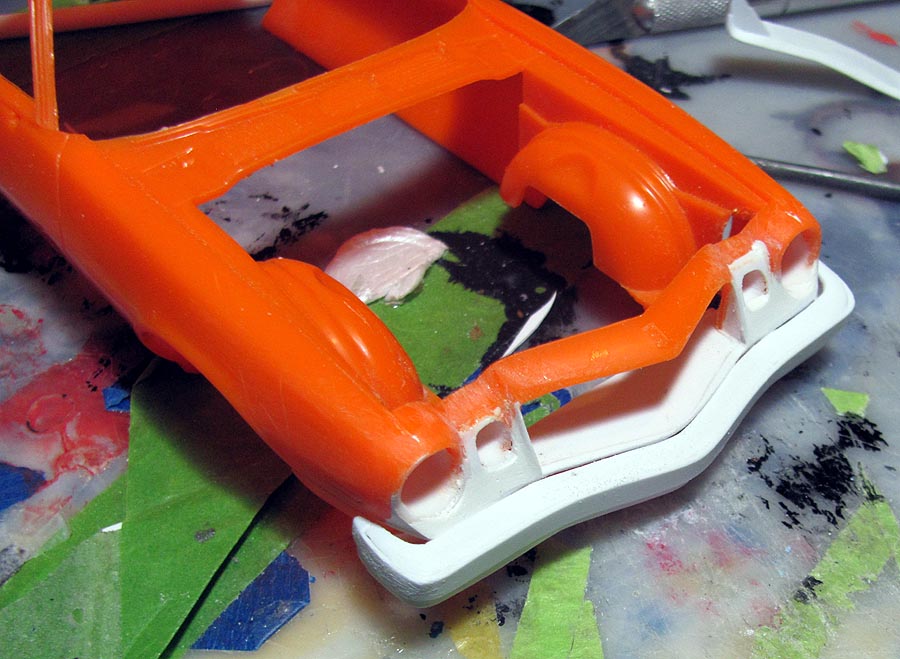

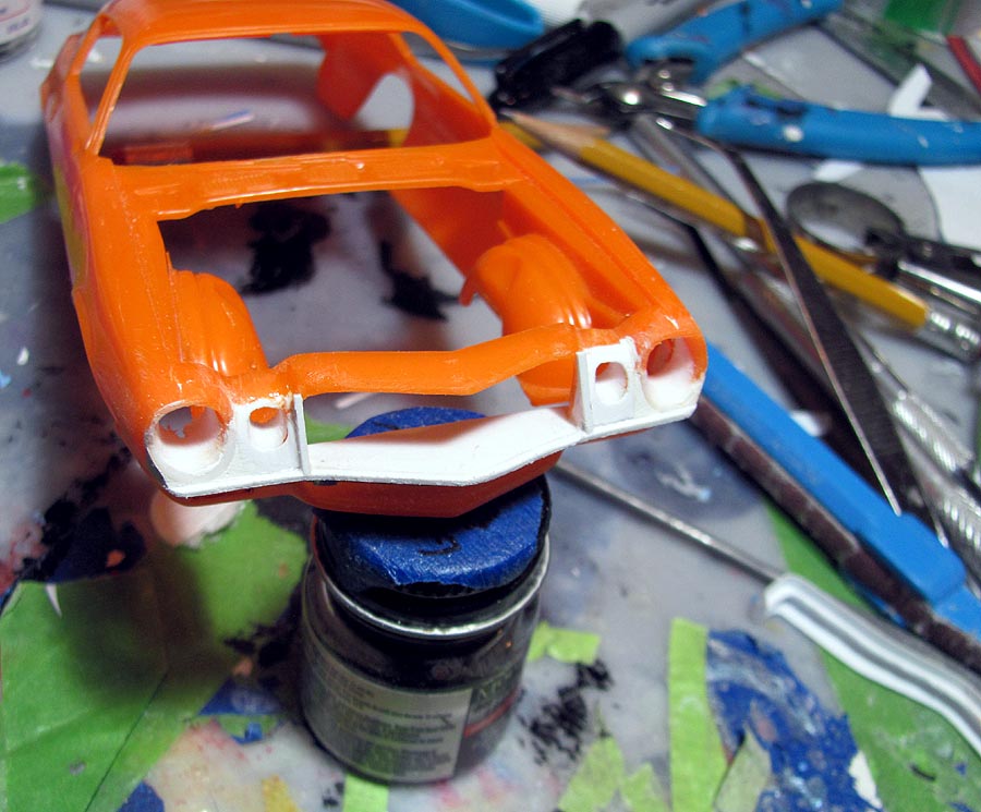

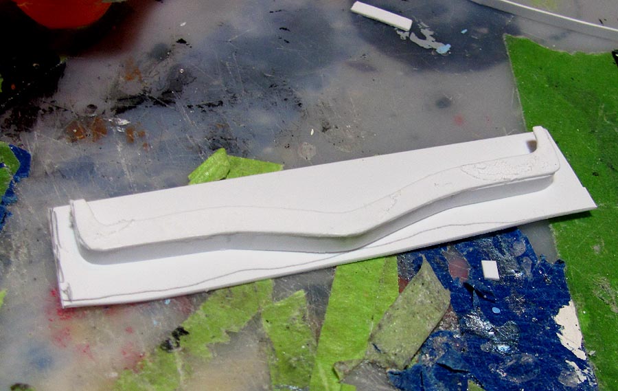

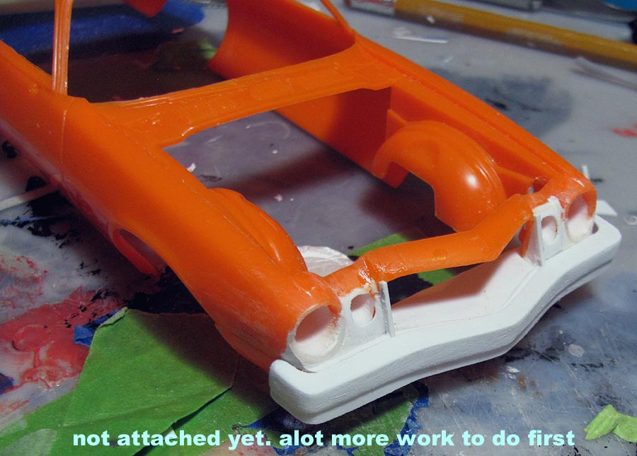

MarkJ Posted June 14, 2021 Author Posted June 14, 2021 Got some more work done on the front. Will need to add more putty and shape those side grille opening uprights. The bumper will need a rubber strip added to the top (but it will be plastic of course). I will also need to scratch a front cattle guard spoiler that attaches right below the top half of the bumper. It really dominates the front of the car.
TransAmMike Posted June 15, 2021 Posted June 15, 2021 2 hours ago, MarkJ said: Started on the front spoiler. Wow Mark, your nailing it my friend!!!

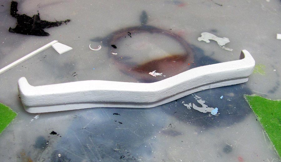

MarkJ Posted June 15, 2021 Author Posted June 15, 2021 16 hours ago, TransAmMike said: Wow Mark, your nailing it my friend!!! Thanks, Mike. The spoiler was tough because you really need 3 hands. you hold 2 pieces and an extra hand to hit it with the glue. I'll show some pics of it later today.
MarkJ Posted June 15, 2021 Author Posted June 15, 2021 What I mean't above is that the glue dries so fast that you don't have time to put glue on one surface and then bring the other surface together . you need to hold bothe pieces together and hit it with the glue brush and holdf for 20 seconds till it sets. Anyhoo, below is some more fine tuning on the front and the spoiler before adding some putty to it . 1

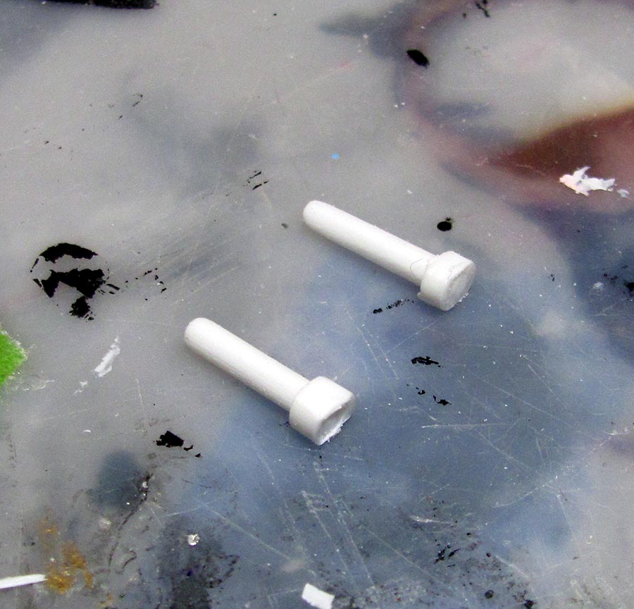

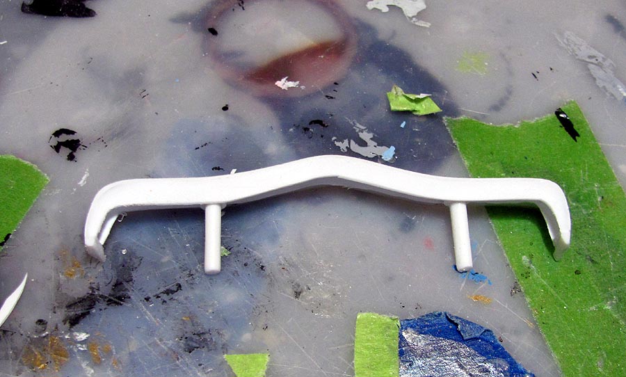

MarkJ Posted June 18, 2021 Author Posted June 18, 2021 I used rods and tubes to attach the front bumper to the body. I don't have to attach it till all the painting is done. And I dont really need to glue it, but I probably will.
1972coronet Posted June 18, 2021 Posted June 18, 2021 Man , that is some great work ! Those bumper mounts resemble the actual bumper "rams" of the 5-MPH Bumpers of 1974 & later !

MarkJ Posted June 19, 2021 Author Posted June 19, 2021 17 hours ago, 1972coronet said: Man , that is some great work ! Those bumper mounts resemble the actual bumper "rams" of the 5-MPH Bumpers of 1974 & later ! Thanks, John. the 74 Camaro did not use what you are referring to. They were spring steel brackets that could bend and rebound. they did have a rod and tube deal that kept the bumper in place from side to side. If you google the front bumper schematics you will see what I'm talking about. 1
