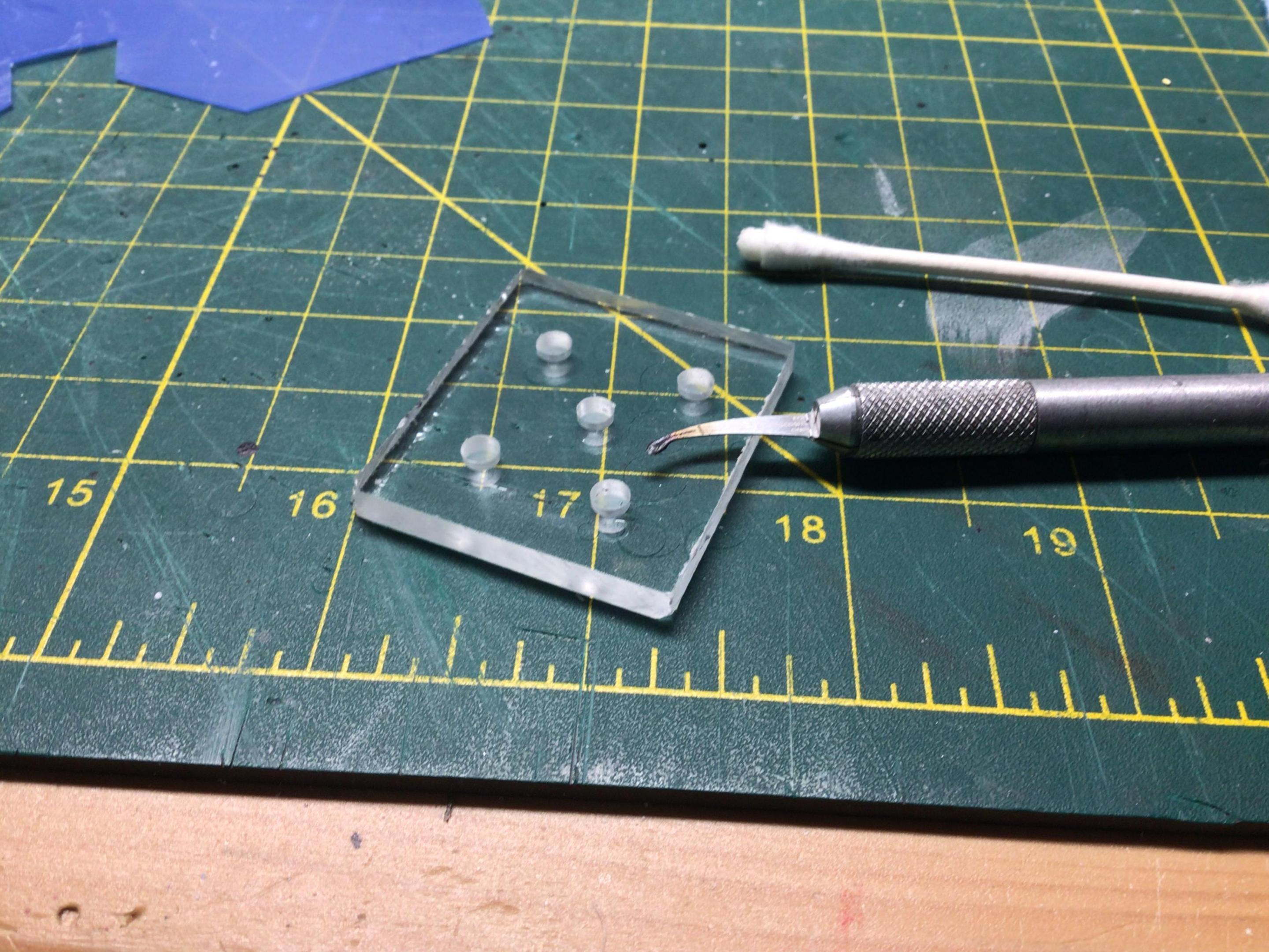

NOBLNG Posted October 8, 2021 Posted October 8, 2021 (edited) I recently bought the glue loopers for super thin CA. They work great, but you have to put a drop or two of CA in something to dip the looper in. I am running out of bottlecaps.? It wants to wick around the cap and doesn’t really want to form a deep enough puddle to dip into. So I have some 3/16” thick plexiglass that I drilled some 5/32” holes about halfway through on my drill press. Each hole holds a drop of glue and maintains a nice deep puddle for dipping. I should be able to put close to 150 glue wells in this 1-1/2”x6” piece. Edited October 8, 2021 by NOBLNG 6
Chariots of Fire Posted October 8, 2021 Posted October 8, 2021 How often do you have to clean up the looper? I use an old disecting needle much the same way you use the looper but I have to scrape off the excess CA every so often or it tends to build up.
NOBLNG Posted October 8, 2021 Author Posted October 8, 2021 (edited) 36 minutes ago, Chariots of Fire said: How often do you have to clean up the looper? I use an old disecting needle much the same way you use the looper but I have to scrape off the excess CA every so often or it tends to build up. Quite often, but I use a butane lighter and the dried CA burns off in two seconds. I did previously make a couple from needles and they did work, but not as good as these. And those I had to dip into the bottle of CA….a disaster waiting to happen I thought!? Edit: I likely don’t need 150 holes. I can probably soak up the un-used CA with a Q-tip and clean up the well with the drill bit. It’s been close to an hour since my original post and the CA is still liquid and useable….unlike the bottlecaps. Edited October 8, 2021 by NOBLNG 1

NOBLNG Posted June 1 Author Posted June 1 (edited) Well all my glue loopers have finally broken. I made one from brass that lasted for a little while but it was hard to clean. This one works fantastic! Much like a sewing needle, but the one leg being able to flex makes the thin CA wick away much better I think. I bent a piece of 0.015” piano wire in a U shape and filed the ends square on a diamond stone. Then added a tiny piece of brass tube to one leg for a spacer and crimped it in place. The brass leg is held in a hobby knife handle and the other leg floats in the slot. About a 1/32” gap works great for thin CA. You might not even need the brass tube?🤔 Edited June 1 by NOBLNG 2

peteski Posted June 3 Posted June 3 On 6/2/2025 at 11:55 AM, NOBLNG said: Thank you Peter. if you scroll up you will see you already posted this same response. I tried the needles and wasn’t impressed. My latest version is something new that I find works very well. You can pick up however much CA you want with it. Just another option for anyone who wants to give it a try. Edit: I think I will drill two holes in a large piece of sprue or Evergreen and mount two separate wires. That’ll free up the hobby knife handle for other uses. Sure, we all find or of fabricate tools which give us best results. As I also mentioned, the needle ones work really well for me. I have multiple size needles for when I need different amounts of CA dispensed. I agree that mounting your applicator in a permanent handle does seem like an excellent idea.
