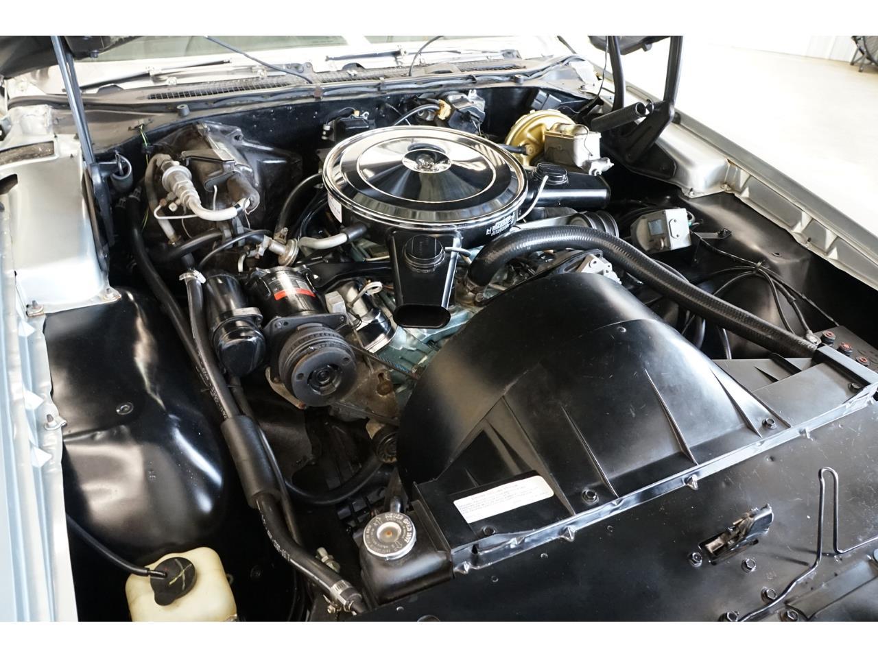

Bills72sj Posted November 5, 2021 Posted November 5, 2021 On 11/3/2021 at 12:49 PM, Oldcarfan27 said: Steve, I think you just need to stretch the frame in front of the transmission mount and move the motor mounts back to match. The engine setback on the GP is significant, look at the underhood especially the fan shroud. Quite a bit away from the radiator. You are correct on the appearance of the engine setback. On my 1:1 I have actually changed camshafts without even having to unbolt the A/C condenser from the radiator support. There is so much room with the fan, shroud and radiator out, you can climb in and sit on the sway bar to change the timing chain.
Bills72sj Posted November 5, 2021 Posted November 5, 2021 Steve, To add some input on the engine bay I looked through some of my builds in regards to the firewall and cowl. The Monte firewall with the A/C evaporator box is pretty close. The top of the cowl has the 3 vents in approximately the correct size and shape but lack detail as far as the eggcrate vent pattern over the openings. With your skillset I am sure you could overcome that obstacle with some screen material. All my Chevelles of that vintage have the same lame, detail-less cowls. The 69 Olds 442 cowl has some grille detail in the openings molded in, but it is too fine and the openings are a bit too narrow. On a separate subject, the A/C compressor from the Monte appears correct but mounts to the wrong side of the engine. This will make all the kit's hoses all wrong. But since they are just hoses, I am sure coming up with flexible substitutes will be no issue for you. The large fan shroud will likely have to be made from scratch. The Monte shroud has too much ribbed, support detail and also appears to be too small in diameter. The fan shroud is a serious fail in all the MPC Grand Prix kits of that vintage. The pics are from a gluebomb restoration of a 70 I did years ago.

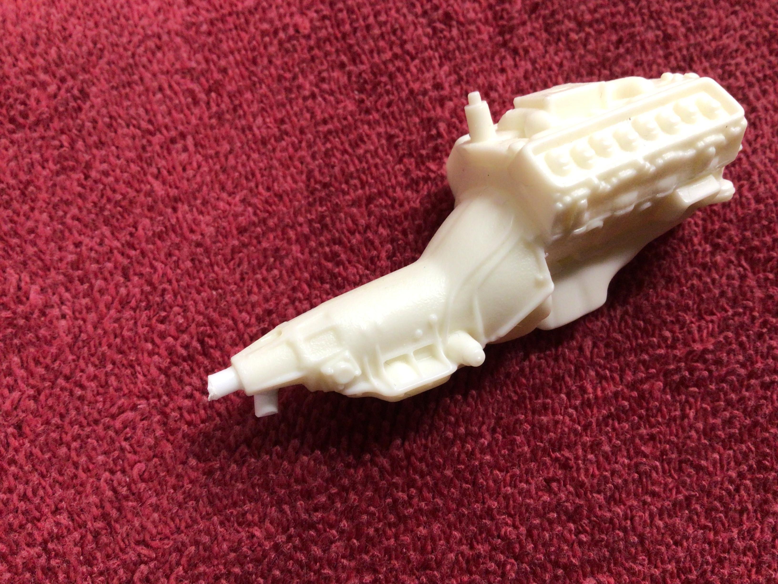

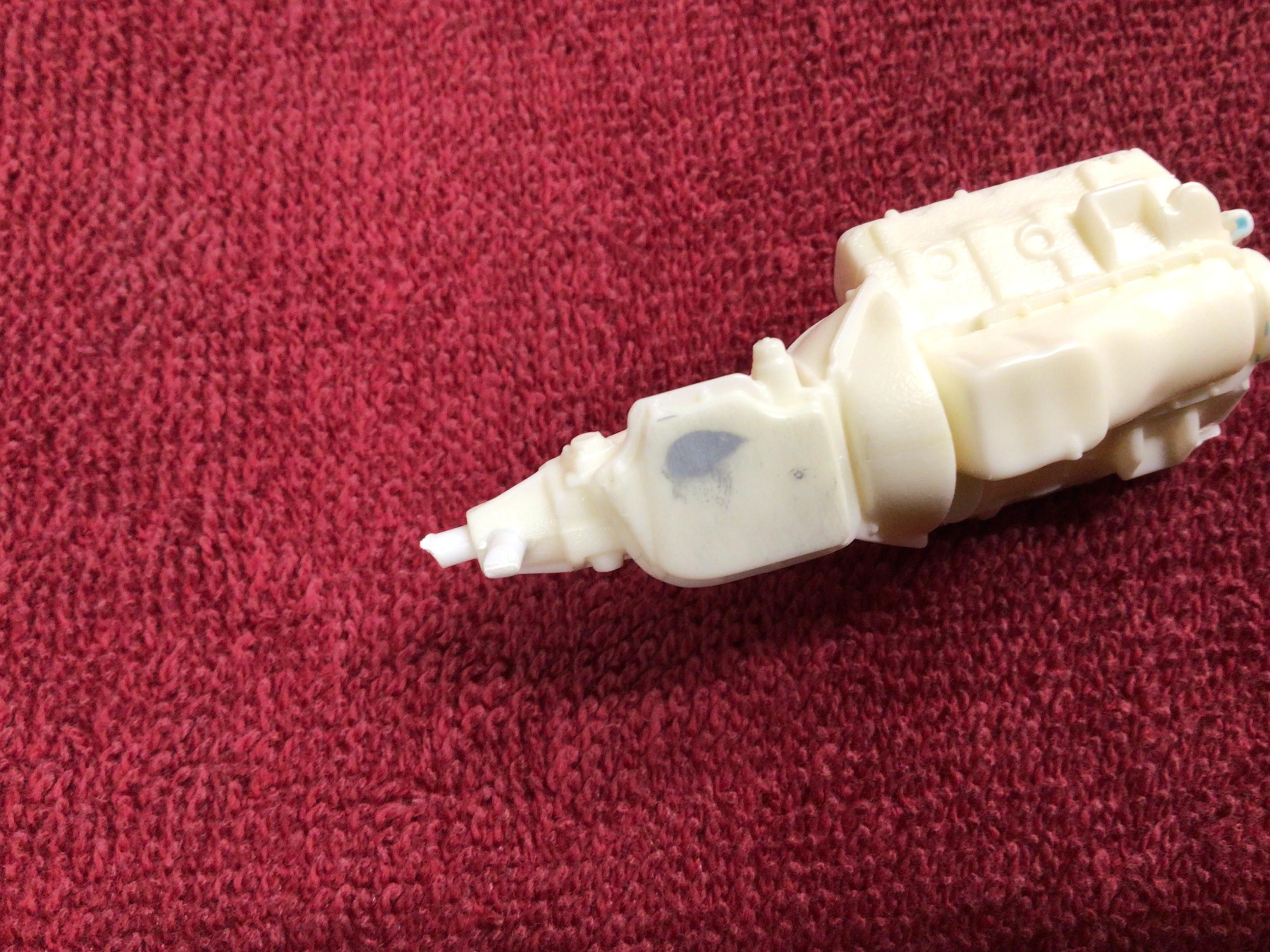

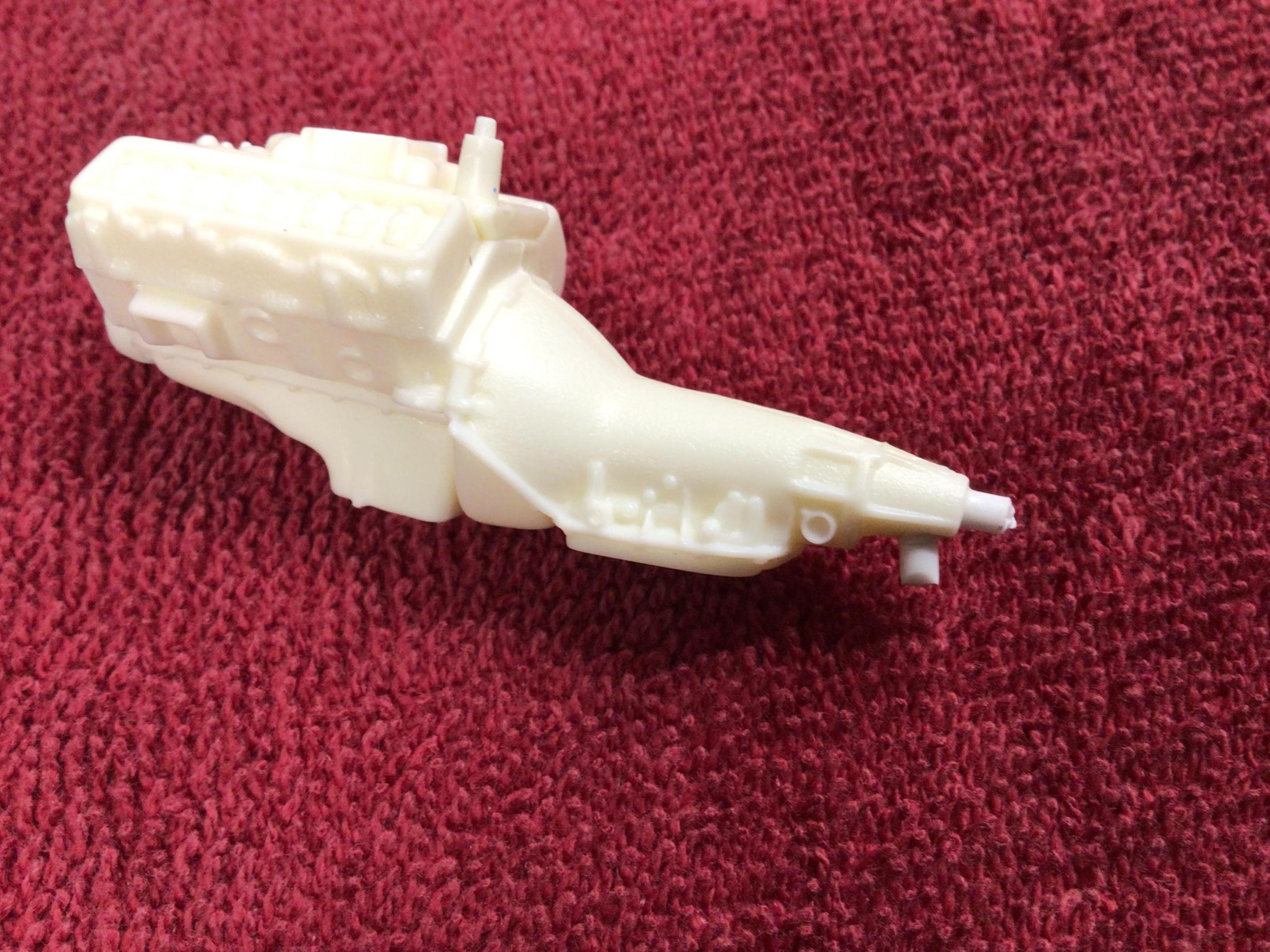

Rodent Posted November 6, 2021 Posted November 6, 2021 (edited) Kris Morgan makes a nice one as well, with a separate pan. It might be worth the few dollars to preserve the Monte's engine as trading fodder. B.O.P. bellhousing bolt patterns are different from Chevrolet. I am not sure if you are that much of a rivet counter or not. This is obviously a manual bellhousing, but you can see that there is a huge difference in the shape vs. the Chevy. I don't have the Firebird, but maybe you could use part of its bellhousing with a M.A.D. TH400? If it's that important to you. Edit: Also, Pontiacs have the starter on the driver's side, Chevys are on the passenger side. That affects the shape of the bellhousing area as well. Edited November 6, 2021 by Rodent
1972coronet Posted November 6, 2021 Posted November 6, 2021 The AMT TH-400 is a nice replica . My only complaint about it is that the oil pan is moulded-in , and is split with the trans' case . I'm sure that you could modify the poop out of it if need be , Steve . I second the M.A.D. TH-400 . I have a few in my stash for conversions of a few of the Revell 396-427-454 engines .
