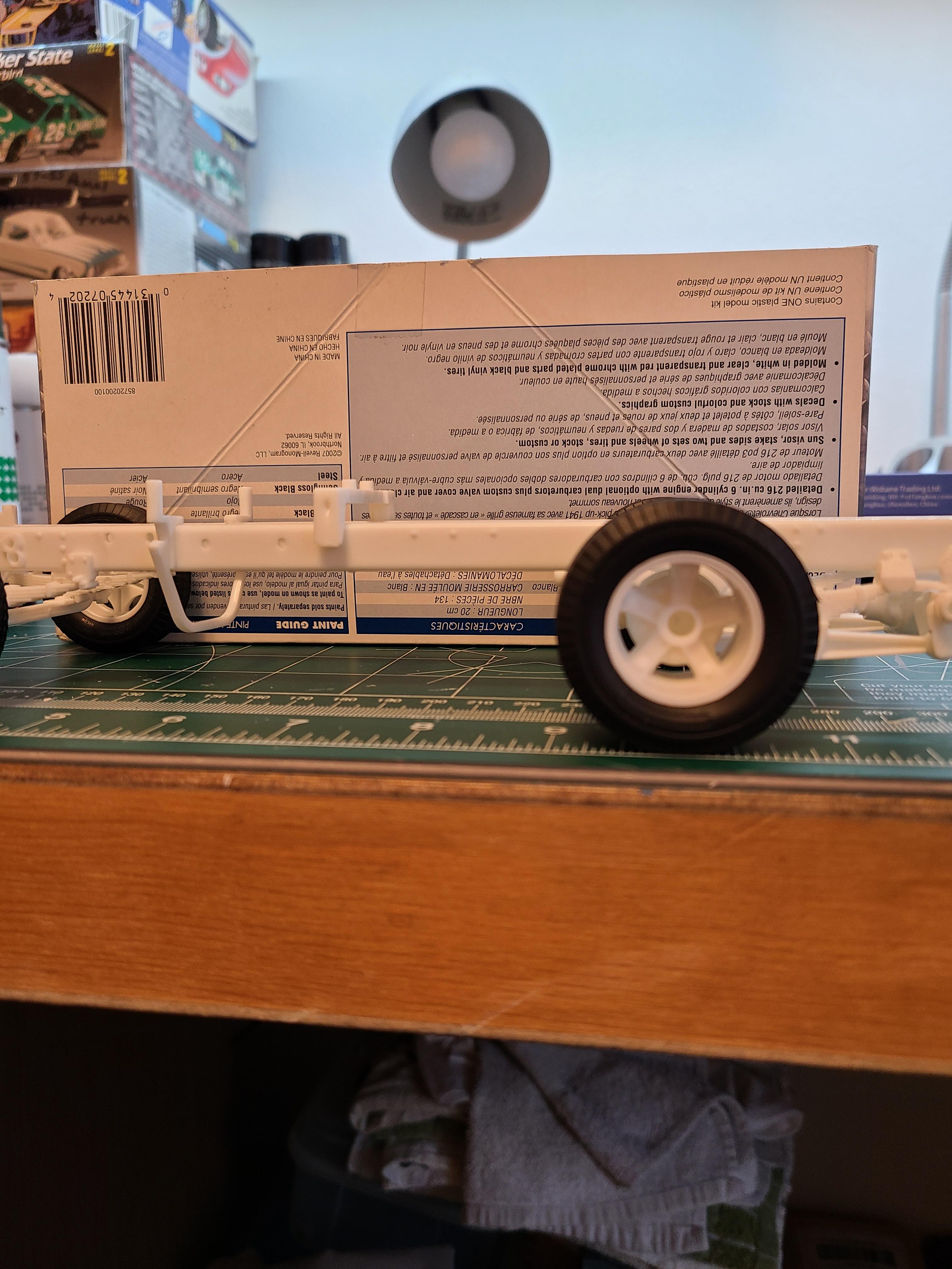

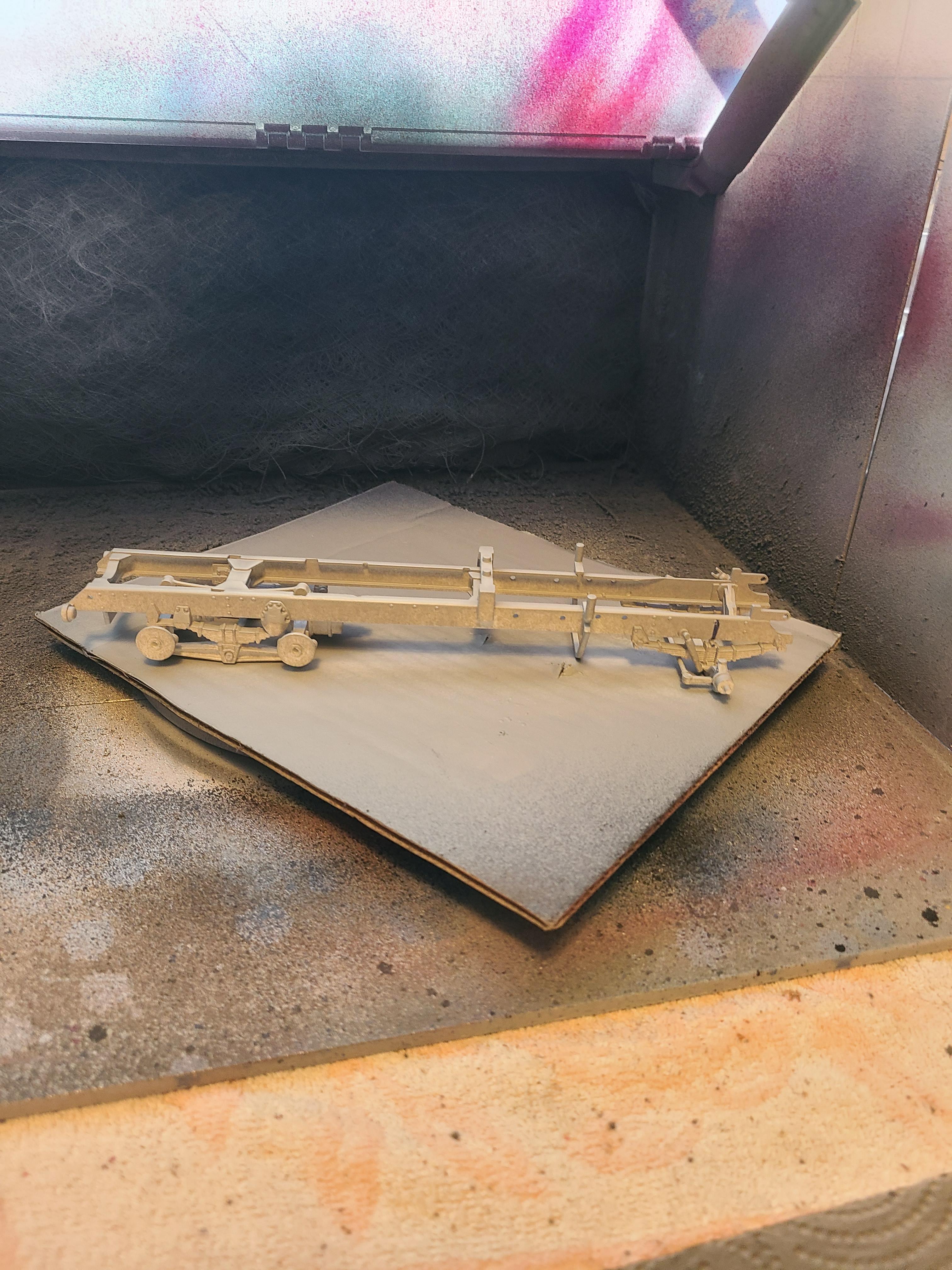

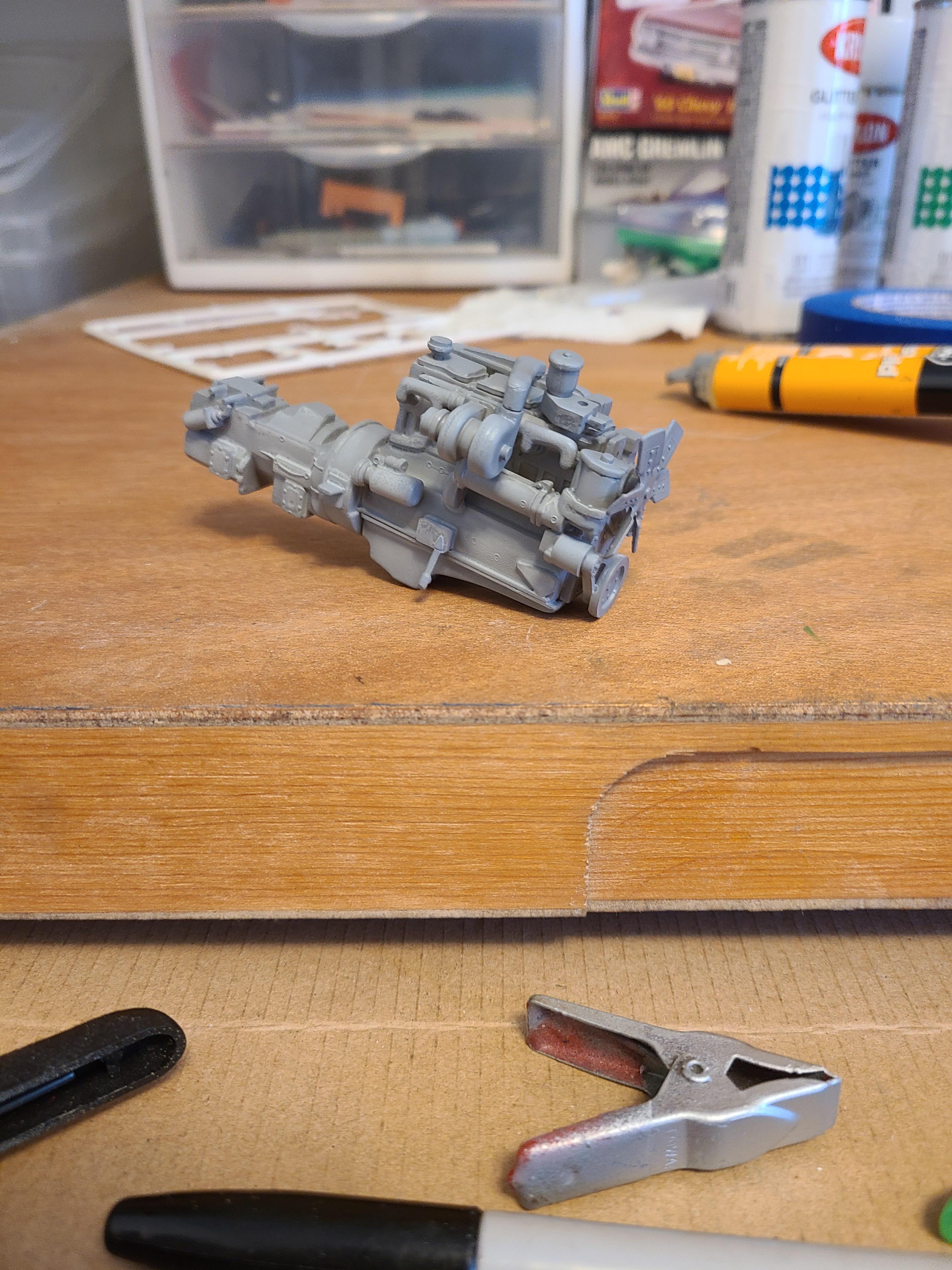

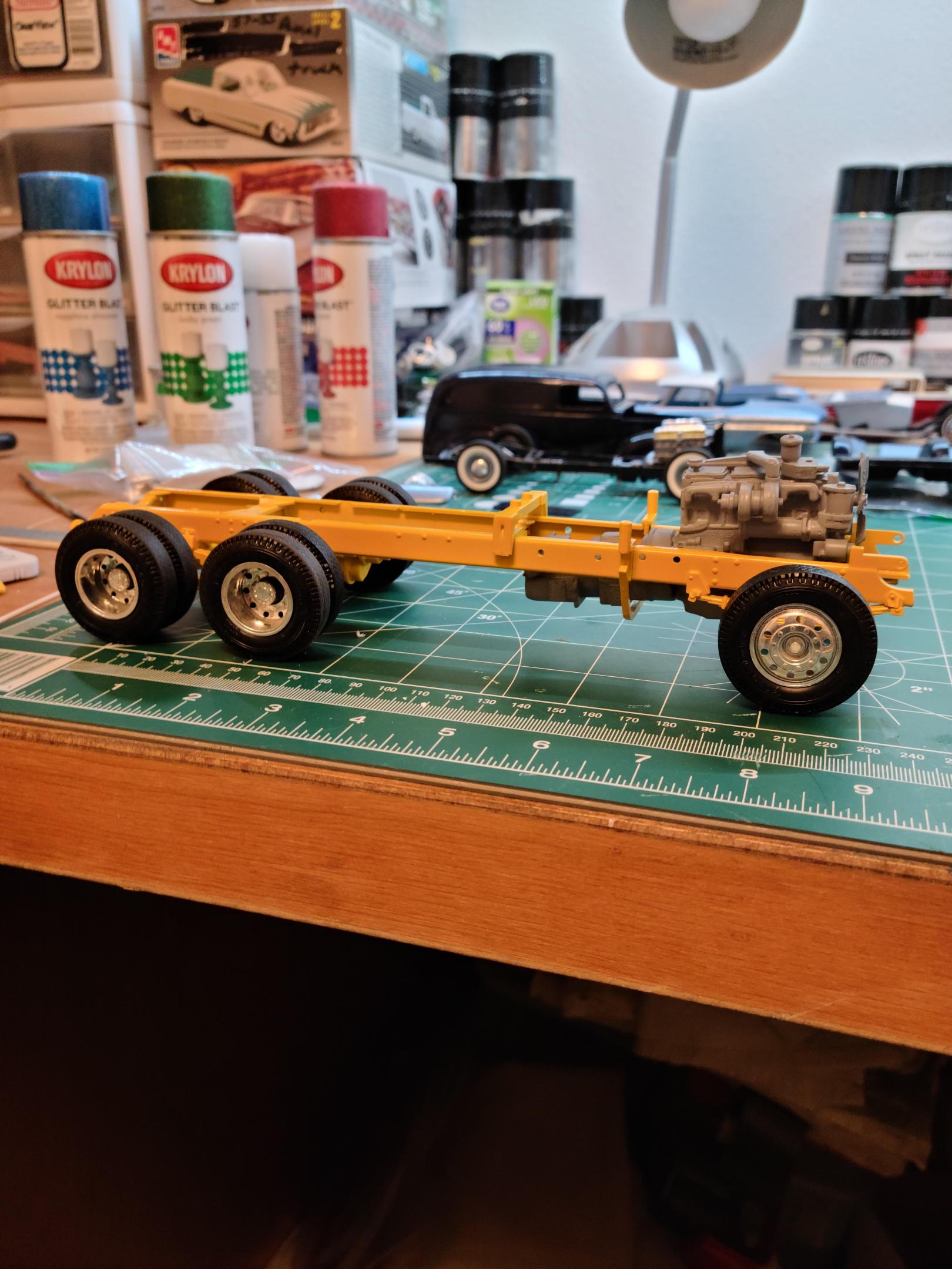

Sam I Am Posted November 7, 2021 Posted November 7, 2021 After having a great transaction with a fellow member, this huge squirrel slapped me up side the head and made me look. The results are this start. Chassis and engine are assembled and in the process of being primed. I actually (with the help of same member) lowered the chassis. We will see how that turns out. Looking at a green and yellow for color combo. Other mods will be revealed as I figure them out. ? 2

leafsprings Posted November 7, 2021 Posted November 7, 2021 WOW, that's a big transmission for the D. R.

Madd Trucker Posted November 9, 2021 Posted November 9, 2021 you may want to remove the dipstick and flip it over it is up side down but every thing so far looks good
Sam I Am Posted November 9, 2021 Author Posted November 9, 2021 4 hours ago, Madd Trucker said: you may want to remove the dipstick and flip it over it is up side down but every thing so far looks good Thanks for catching that. Funny how you can miss something like that when it's very late and all you want to do is get it assembled and go to bed. ?

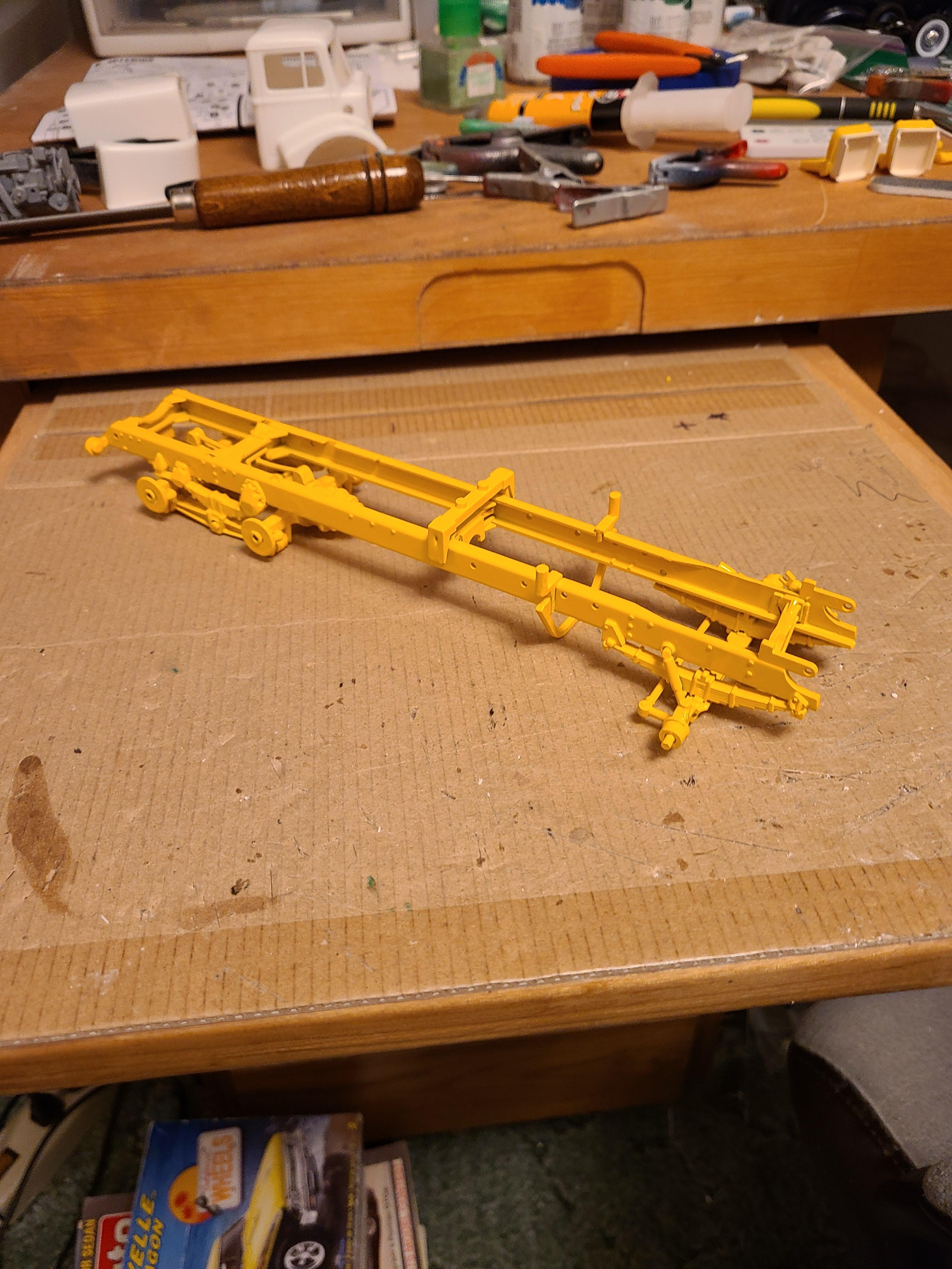

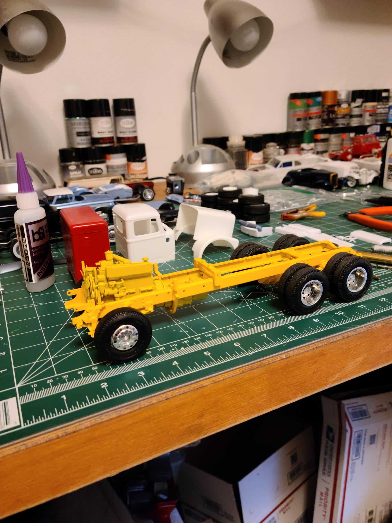

Sam I Am Posted November 13, 2021 Author Posted November 13, 2021 13 hours ago, '70 Grande said: Looking good thus far. Just curious; what's the reason/motive for lowering the chassis, (overall look of the finished build)? Just an overall look. Hoping to get a more custom truck when finished. Thanks everyone for the positive comments. It really helps to stay motivated. I thought I had a partial can and full can of the yellow, it turned out to be two partial cans....soooooooo I need to order a couple more cans. That is what happens when I think. Here is the chassis in its coat of yellow. This will be the last update for a few days. Anniversary is this weekend, so as they say, see you on the flip side. 3

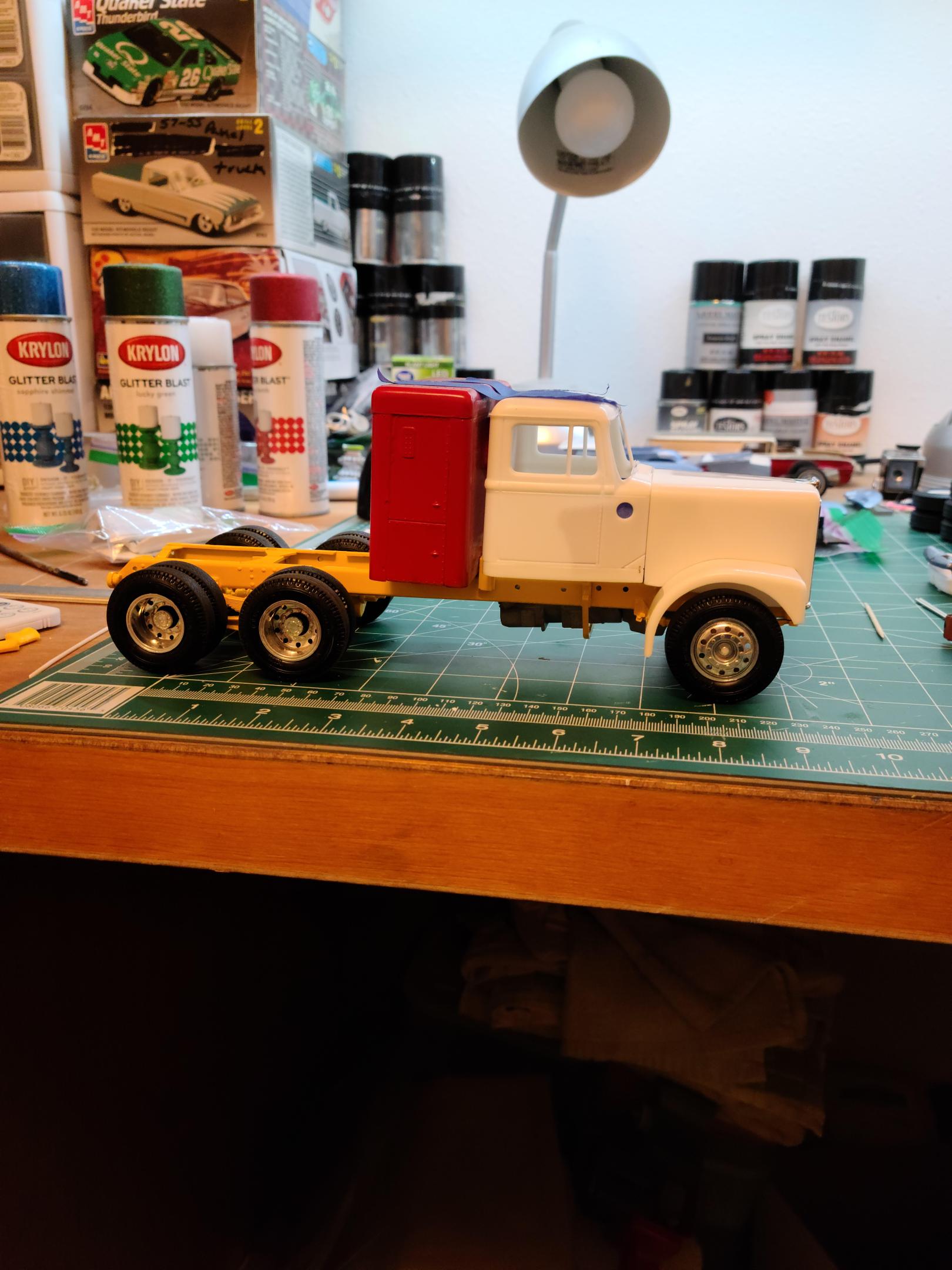

Sam I Am Posted November 26, 2021 Author Posted November 26, 2021 Thanks guys ! I had some downtime today and spent it at the bench. I have switched out the kit wheels for these, so it is up on all ten now. The engine is just mocked up. I also did a mockup using the Peterbilt sleeper...and no sleeper. 2
Bills72sj Posted November 26, 2021 Posted November 26, 2021 The mock up with the sleeper gives the illusion the frame needs to be longer.
wayne00 Posted November 26, 2021 Posted November 26, 2021 I like to look with the sleeper but it does make it look a little stubby. On 11/7/2021 at 2:57 PM, Sam I Am said: I actually (with the help of same member) lowered the chassis. On 11/7/2021 at 11:18 PM, TruckerAL said: glad I was able to help you, and continue to help you! Care to share, that would be some useful info!! Following along. Rog?

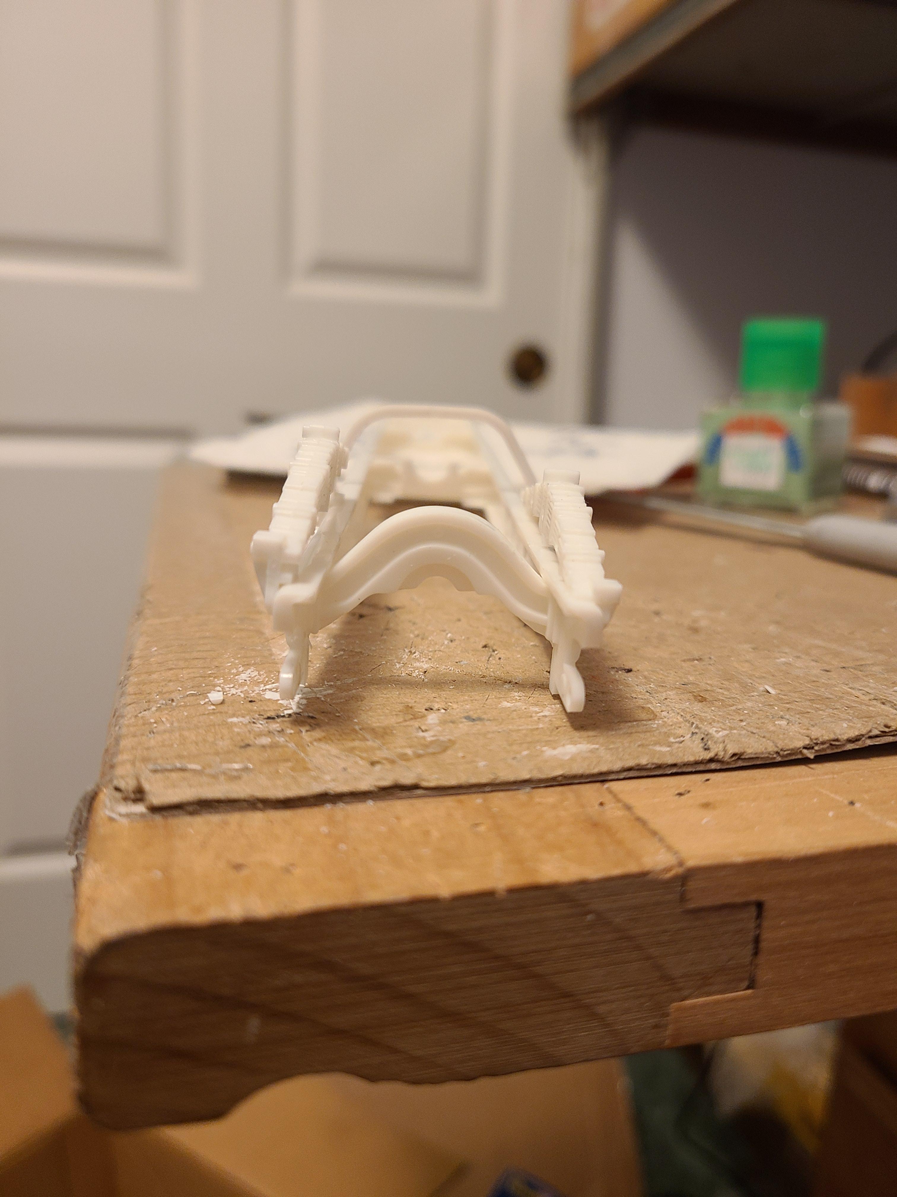

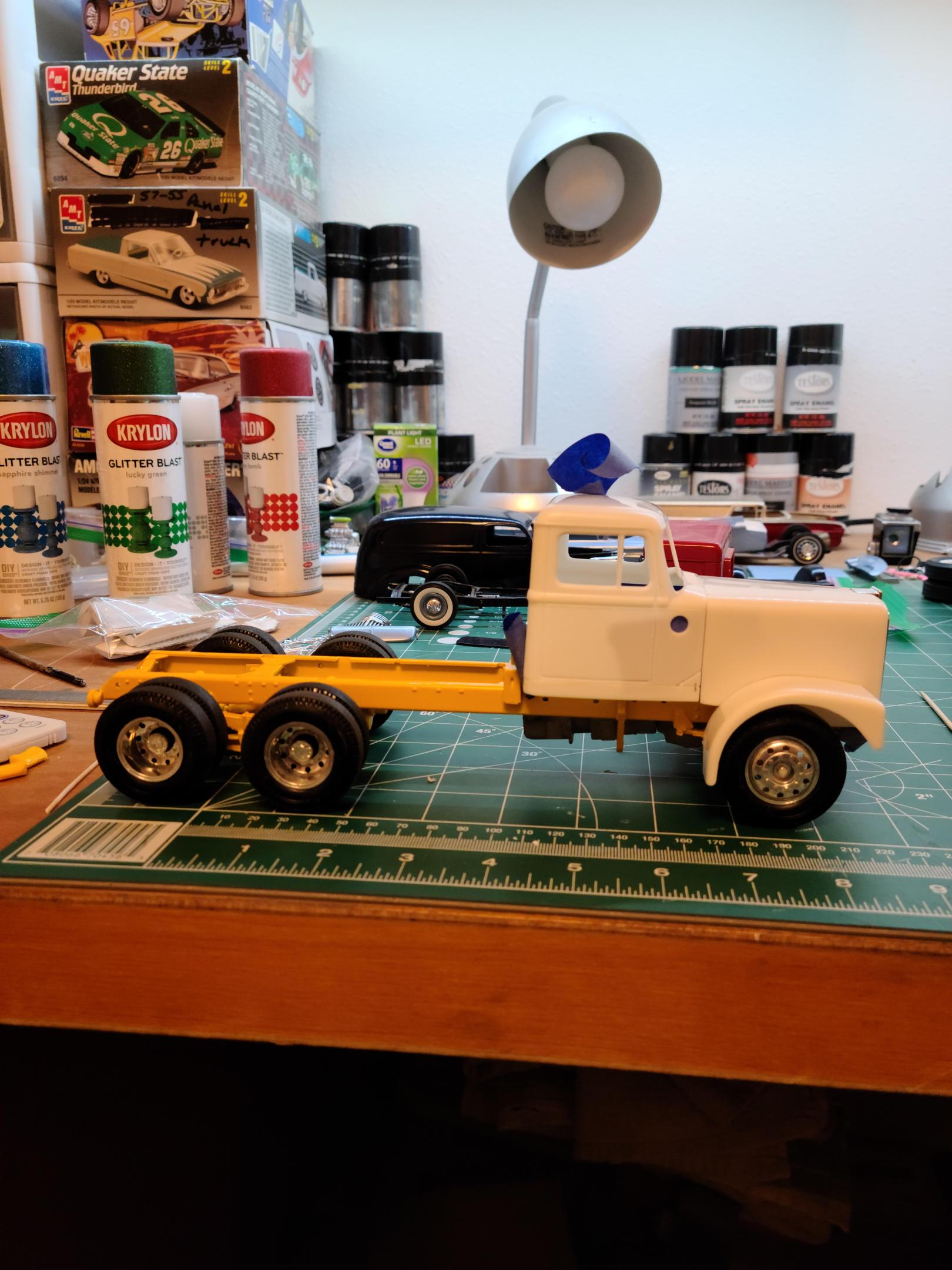

Sam I Am Posted November 29, 2021 Author Posted November 29, 2021 On 11/25/2021 at 10:36 PM, wayne00 said: Care to share, that would be some useful info!! Following along. Rog? Rog, I glued one front spring assembly in place, then drew a center line on the frame down through the center of the axle mount. I then cut the spring loose from the shackles, cut about an 1/8 of an inch out of the shackles and glued the spring assembly back onto the shackles. Rinse and repeat for the other side. Did a similar process on the rear. Not as low as I would like, and not an accurate representation of actually lowering a truck. Just a simple way of achieving the look, and as they say, "baby steps". The engine is now installed. For some reason the camera is not catching the difference in color from the frame, but it is. So no sleeper. I do want it to appear lowered, and that will help. 2

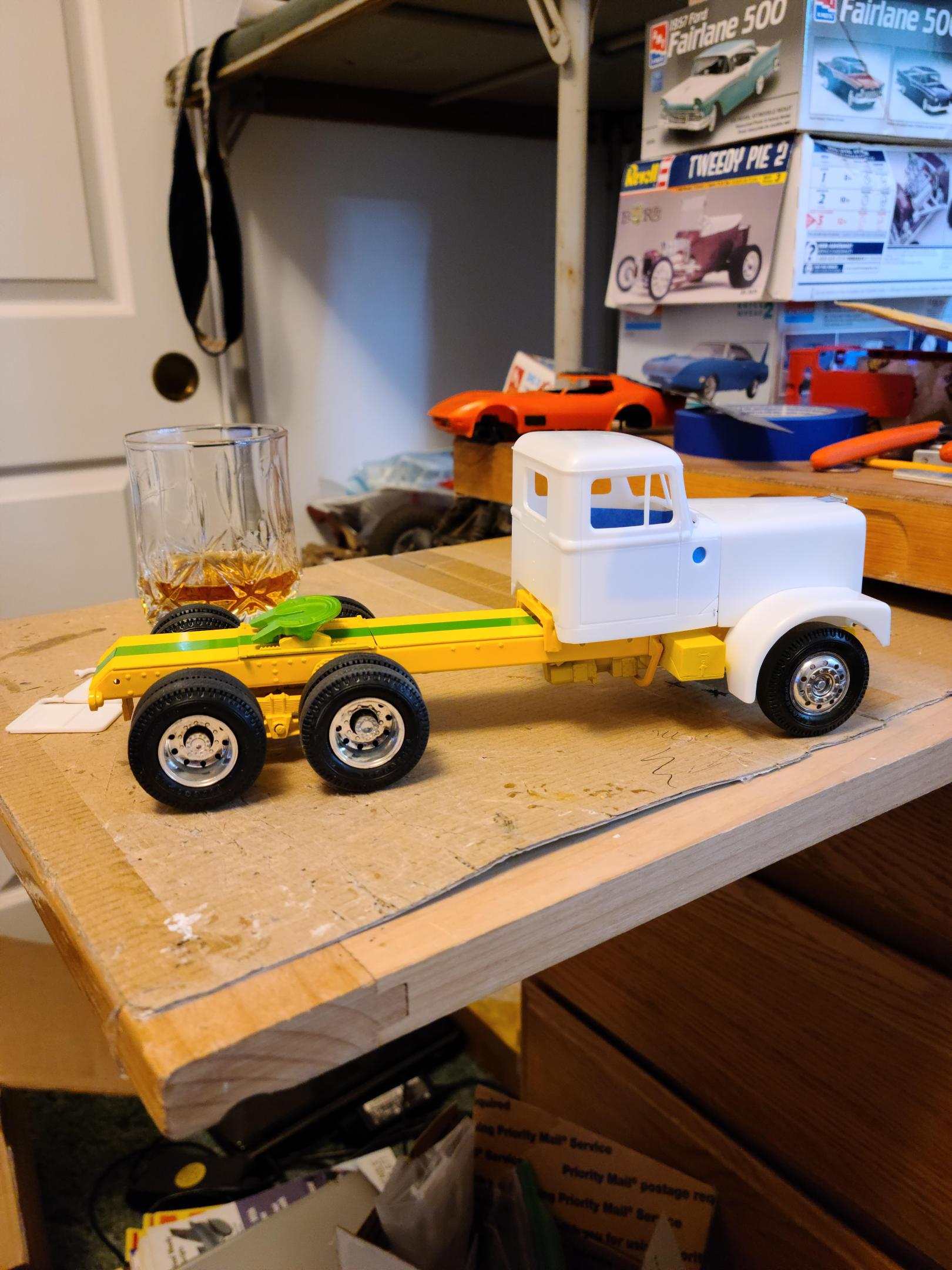

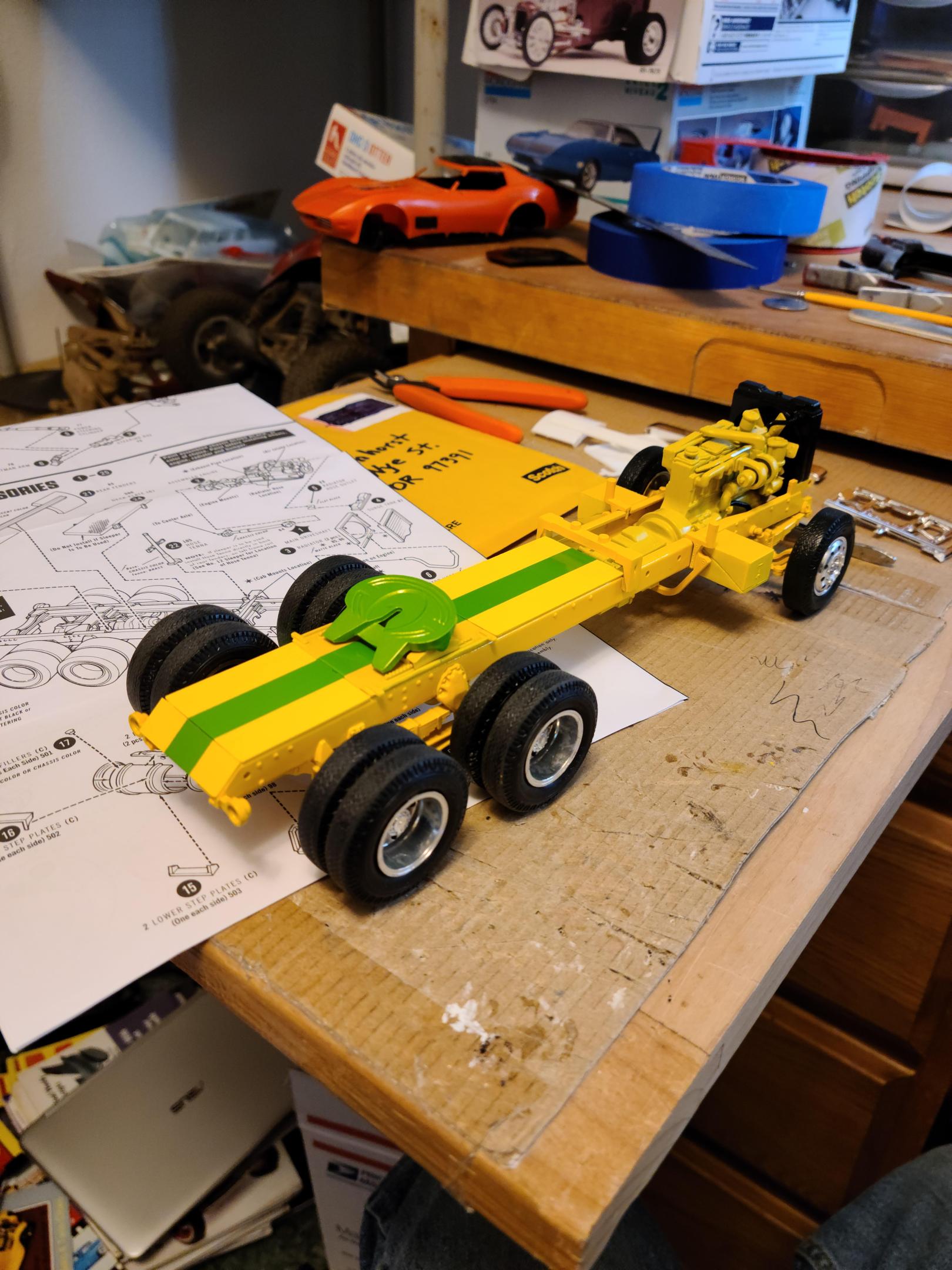

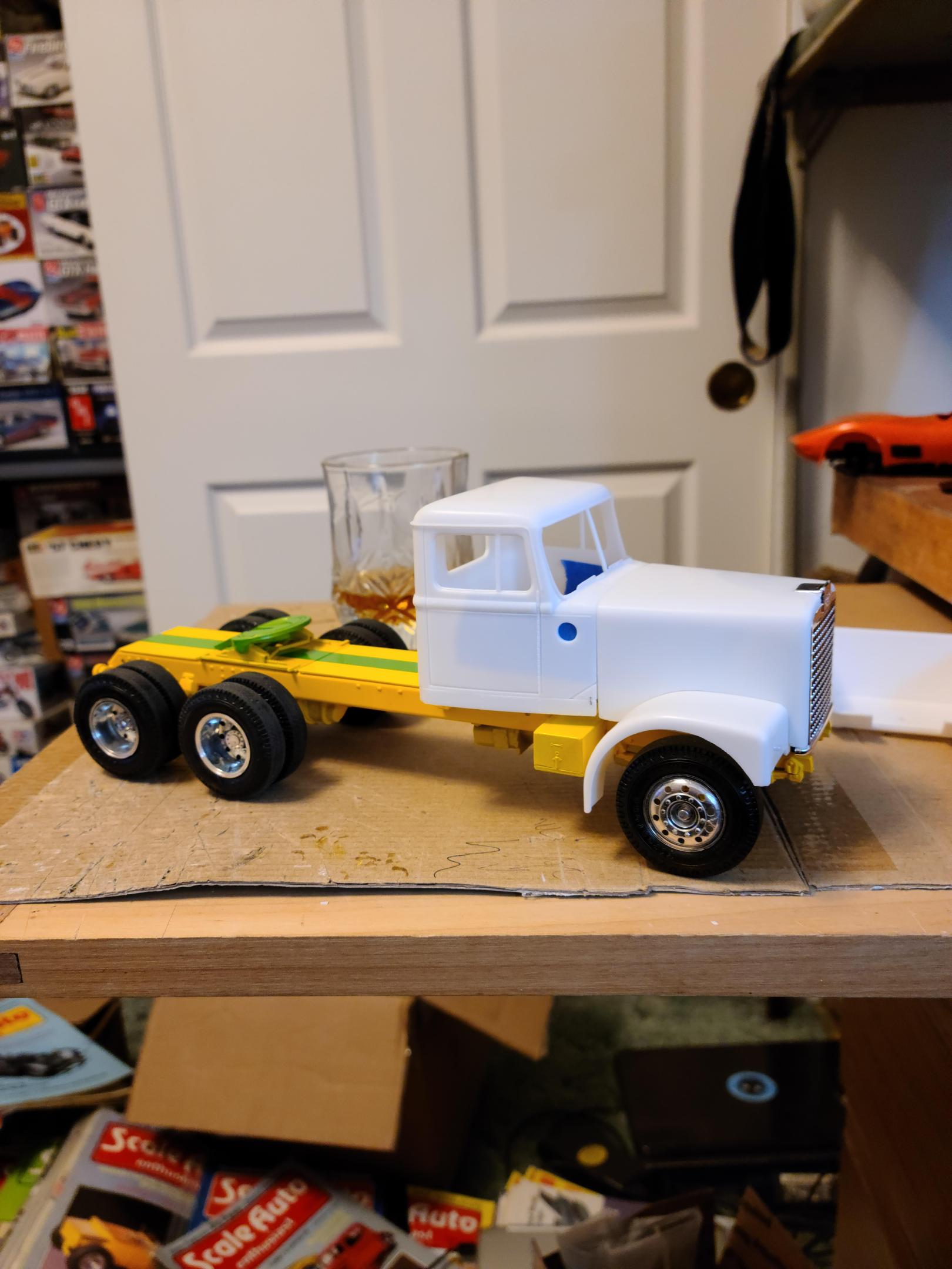

Sam I Am Posted January 18, 2022 Author Posted January 18, 2022 Well, I am not happy with how things are turning out, but will finish it nonetheless. I couldn't figure out why my yellow chassis parts looked like I used three different color primers under them when I know I didn't. Turns out that the third partial can of Tamiya yellow was slightly different. So I ended up with the original yellow on some, blended yellows on some, and different yellow on others. Fortunately, the cab, nose, and deck plates will be out of the same can. The green will be tied into the stripes on the cab. I think I am done with yellow for a while... 2
Sam I Am Posted January 18, 2022 Author Posted January 18, 2022 I feel a bit better now that I have the cab and nose mocked up (probably just the bourbon talking"). If anyone is good with making decals, let me know. After I get the green on the cab, I will need a bright yellow O and the words "QUACK ATTACK" ? 3
Bills72sj Posted January 18, 2022 Posted January 18, 2022 16 hours ago, Sam I Am said: I feel a bit better now that I have the cab and nose mocked up (probably just the bourbon talking"). If anyone is good with making decals, let me know. After I get the green on the cab, I will need a bright yellow O and the words "QUACK ATTACK" ? Sam, After your generousity, I would be happy to make decals for you! PM me

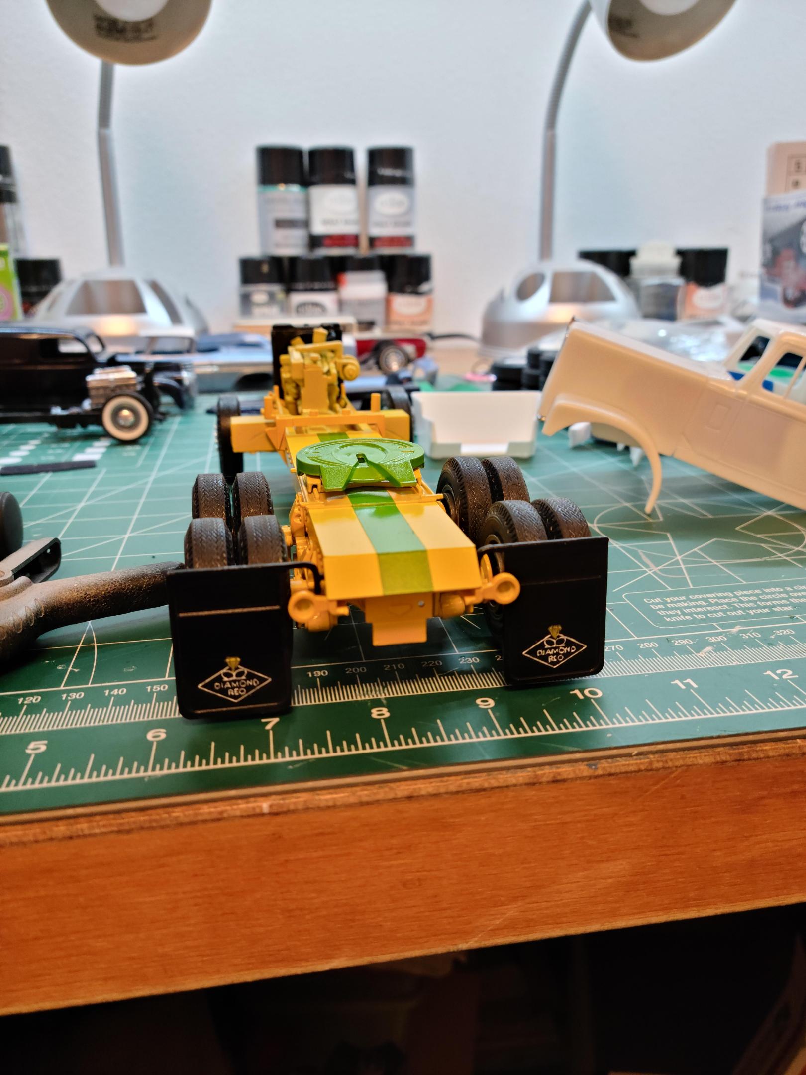

Sam I Am Posted January 29, 2022 Author Posted January 29, 2022 I will take you up on that Bill, and thanks much. Just a minor update. Mudflaps! I really do like gel pens. 1
