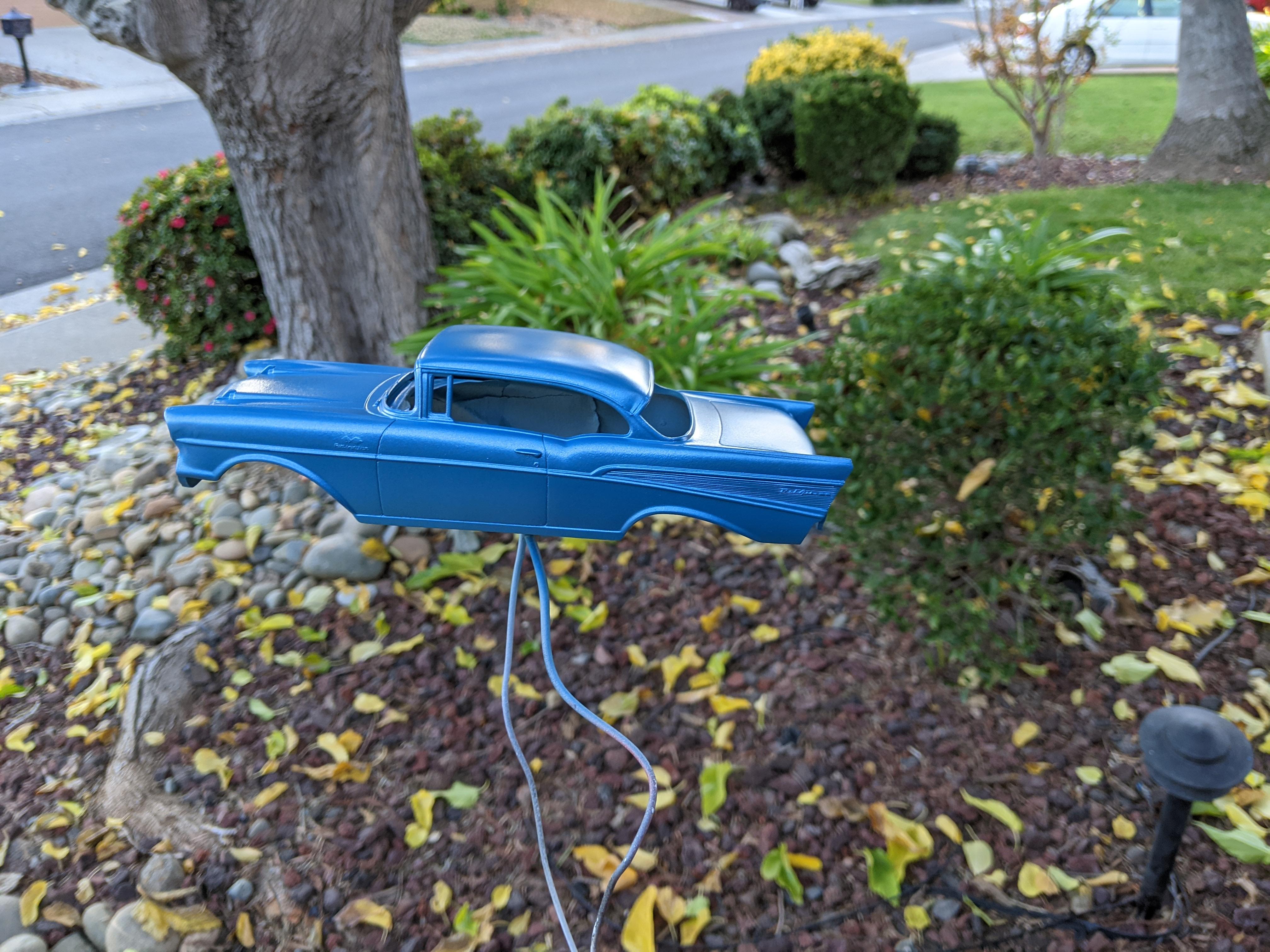

Rodent Posted November 11, 2021 Posted November 11, 2021 I found the idea of using paint, thinner, and clear gloss to help keep the paint from separating an interesting one. I have never heard of that. I wonder if it works? That said, I am just getting back into airbrushing after a hiatus. I got my feet wet with Scale Finishes Harbor Blue (pre-thinned) on this Revell 57 Chevy snapper. Since one of the interior choices was matching blue with black, I shot the interior pieces first to get a feel for the paint. I have a Paasche H, with a 5 needle. I started at 25 PSI on a 60-ish degree overcast day in the garage and rain was just beginning to fall (bad). The interior came out pretty well, and my left hand was quite blue (stupid paint cup). On a better day, I shot the body at 30 PSI with the needle closed down a bit from how I did the interior. Paint went down nicely. Now I just need to clear it. Hopefully I won't mess it up. I guess that is practice?
