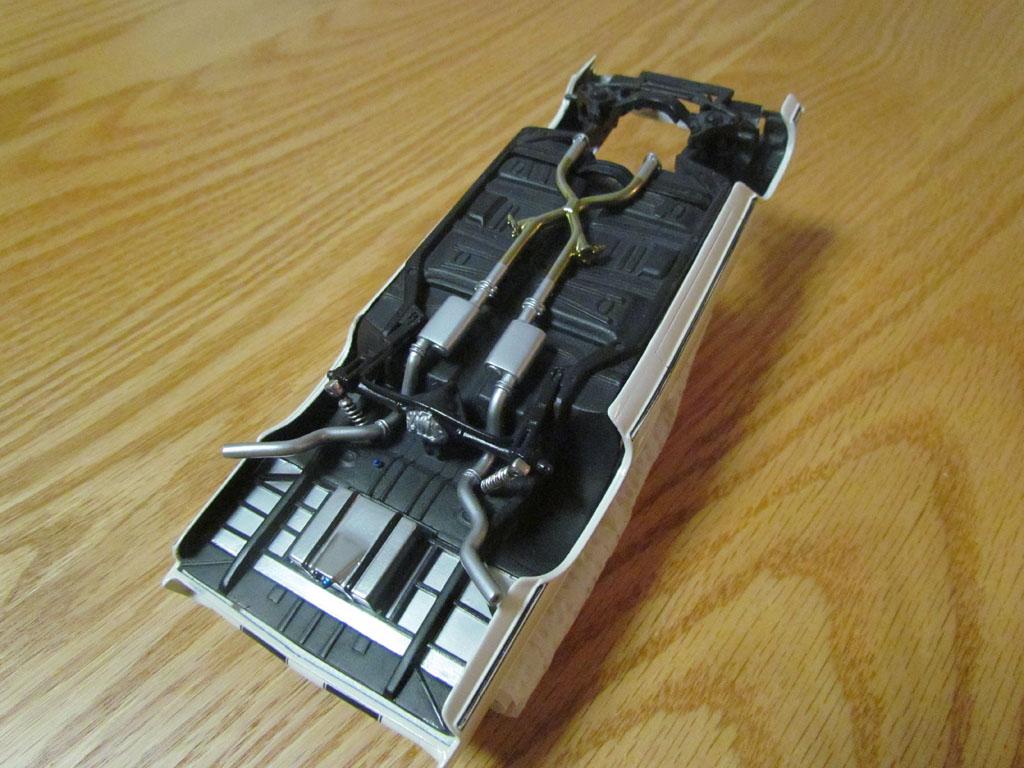

It's been a few weeks since my last update.  I got some more work done.  I painted the exhaust system.  I first painted it with Alsa Easy Chrome.  I then sprayed Alclad Aqua Gloss over the Easy Chrome and sprayed Tamiya Acrylic Clear Yellow over it to give it the color of straw.  The main part of the exhaust in the car is stainless and it turned the color of straw.  I then polished the Tamiya Clear Yellow a bit with Meguiars Scratch-X to blend it in so it doesn't look like candy paint.  The silver parts of the exhaust and the mufflers are painted Alclad Aluminum.  I placed the fuel cell and rear framing on for the pictures.  It all has to be glued in place.
I painted the engine, bell housing and transmission.  The engine is Tamiya Acrylic Gold Leaf with some XF-64 Red Brown added to darken it a bit.  The bell housing is Tamiya Acrylic Flat Red and the Transmission and heads are Alclad White Aluminum with a dark wash over it.

I painted the front inner fender wells black and also painted the grill black.  I painted some Tamiya Clear orange on the front turn signal lenses in the front bumper.  I have a Photo Etch piece with OLDSMOBILE lettering that'll be glued in between the headlights as well as a Photo Etch 442 emblem for the grill.  The front grill/bumper is a resin part from Model Car World.  I sent it to Little Motor Kar Company for the chrome plating.  Dale did a great job chroming the resin.

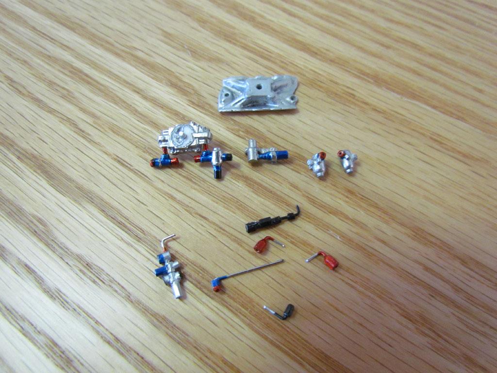

I sprayed Tamiya Gold Leaf on the oil pan and proportioning valve.  Then I followed with a 50/50 mix of Tamiya Clear Yellow and Clear orange sprayed over it for a gold anodized look.  In person they look a bit deeper and a touch more orange than the picture is showing.
The headers are painted with Alsa Easy Chrome over Alclad Aqua Gloss Clear.  The base color is gray primer.  The wheels are painted Alclad Polished Aluminum over Alclad Gloss Black Base.
The anodized fittings and fuel pump were done with Tamiya Clear Red and Clear Blue.  I used Alclad White Aluminum on the intake manifold.

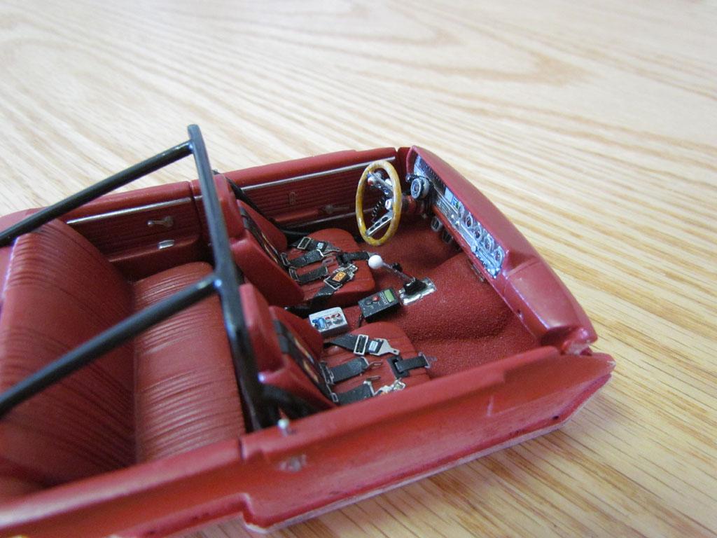

Since my last post I got some work done and unfortunately had to strip and re-paint the body.  I had problems polishing the clear.

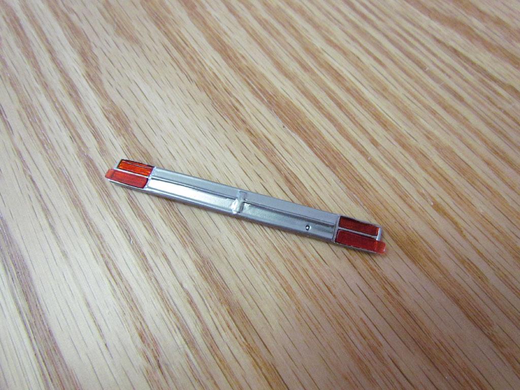

The tail light panel is painted with Alsa Easy Chrome.  I sprayed it heavier to look like aluminum.  I painted Tamiya X-27 acrylic clear red in the tail lights and will use the optional custom clear red tail light lenses that came in the '64 442 kit.

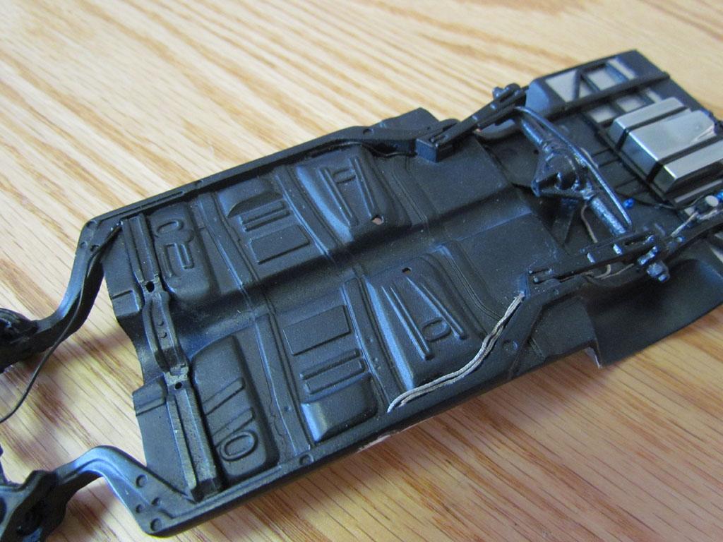

The fuel lines are connected to the fuel cell and the battery cables are done.  The battery in my friend's 442 is in the trunk.  The black wire is for the battery.

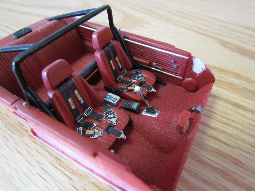

I made the coiled wire for the micro switch on the steering wheel and added the line lock switch to the shifter.

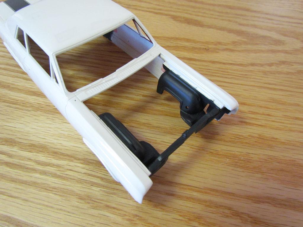

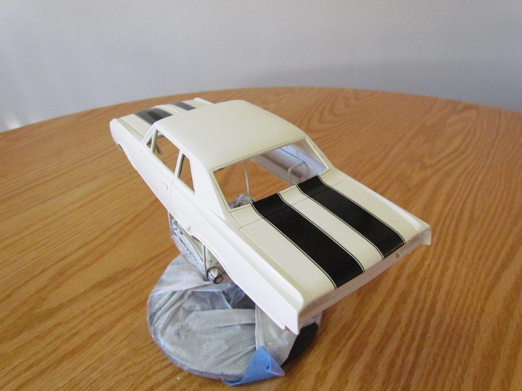

As I stripped the body I noticed it had started to crack along the driver's side rocker panel.  I added some styrene strips on the back sides to strengthen them.
The body and stripes are painted.  I used MicroScale 1/64" black pinstripe decals along side the wide painted stripes.
I'll be using Duplicolor Perfect Match Protective Clear Coat Finish on this.  I already sprayed some over the stripes to apply the pinstripe decals.

The resin tail light panel I got from MCW didn't have sharp details and the tail lights weren't wide enough so I decided to scratch build a new one.  In the picture with both tail light panels painted the new one I scratch built is on the bottom with the wider tail lights.

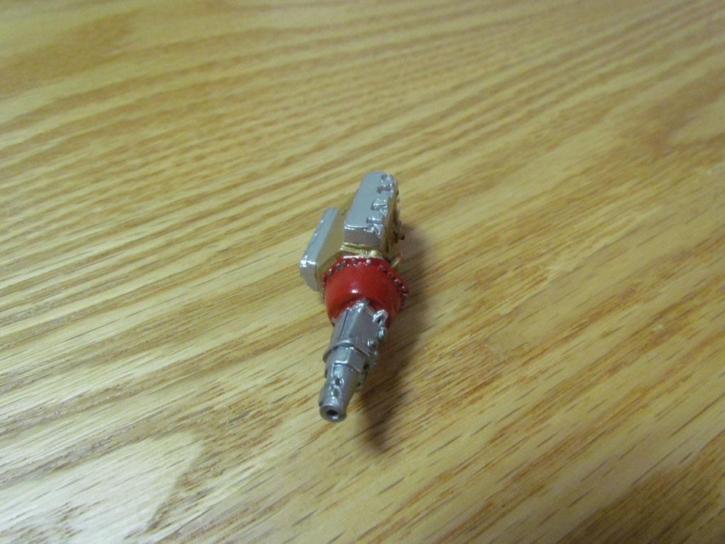

The last change I made was the carb.  The resin carb I had was too large and made the air cleaner sit too high.  I got a resin carb from Fireball Modelworks and added the plumbing as I had on the first one.  The new one is the unpainted one in the picture.
