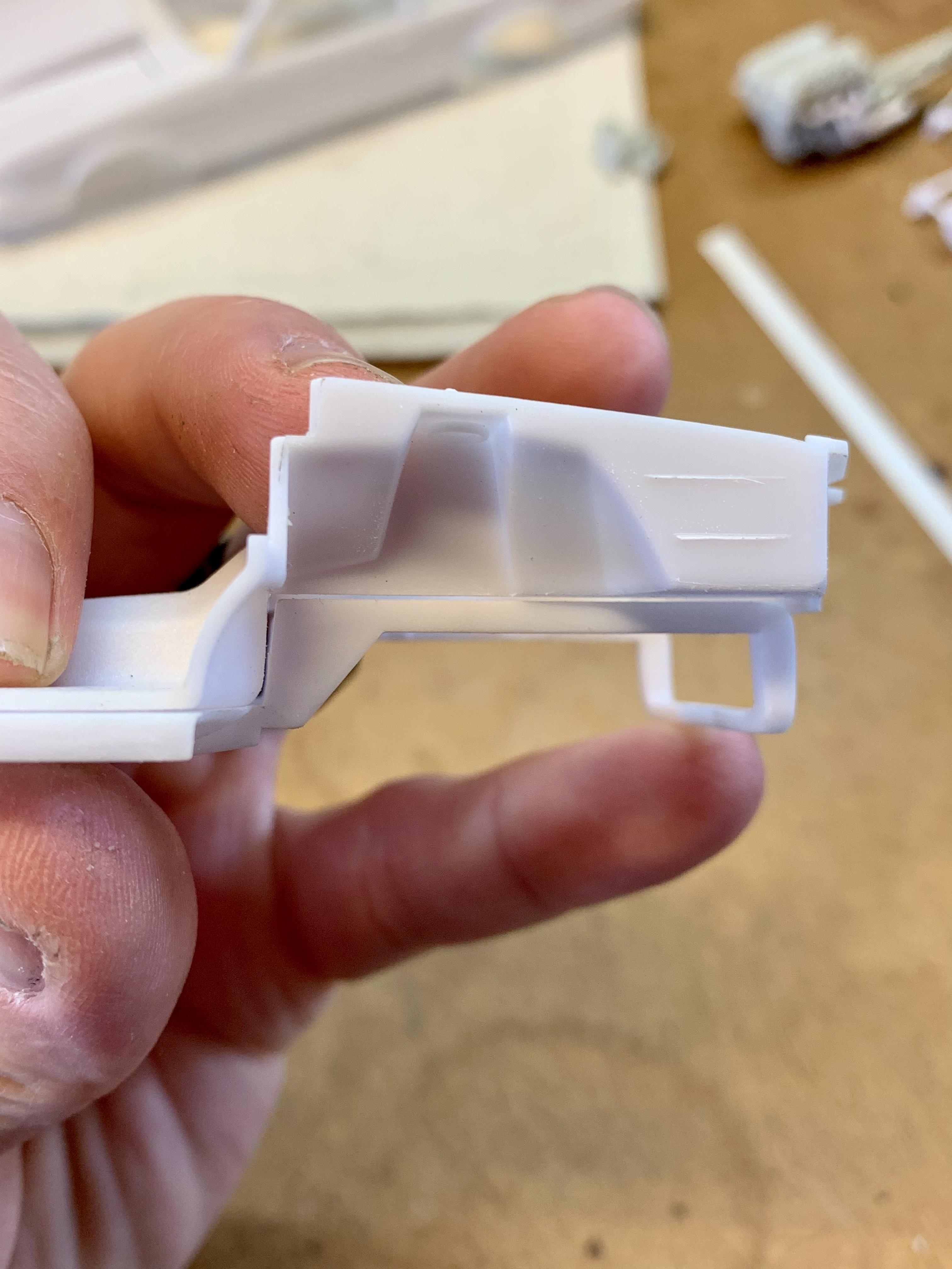

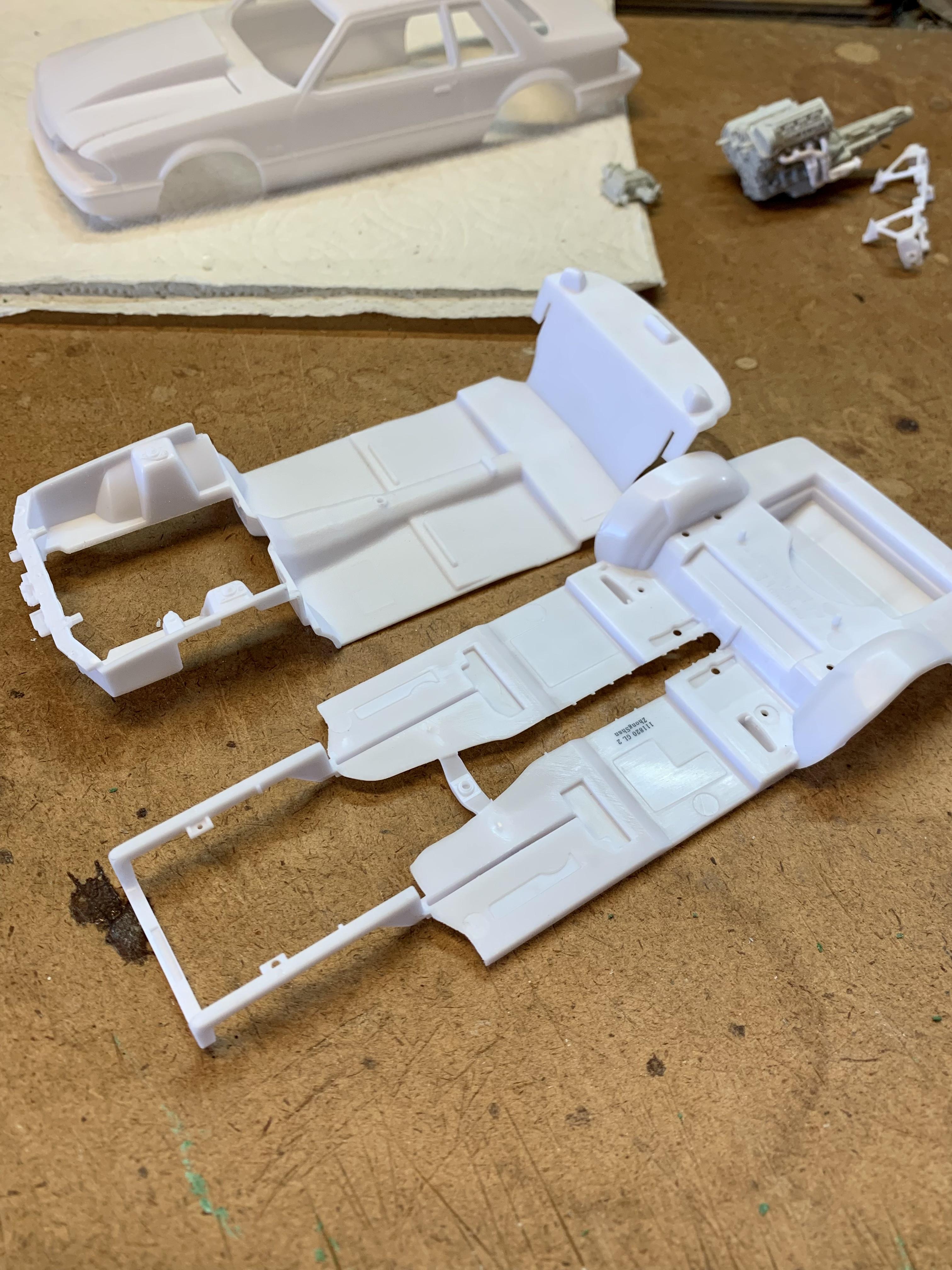

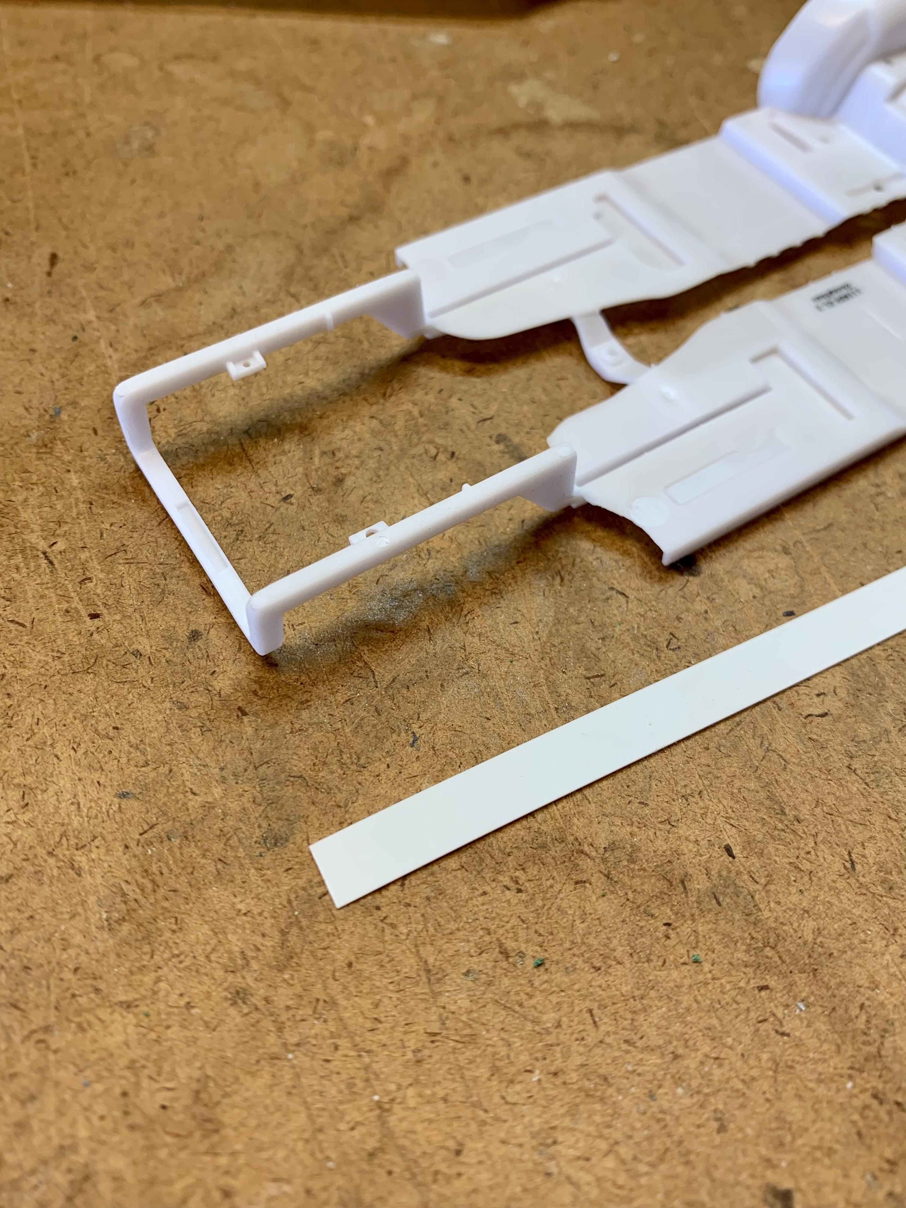

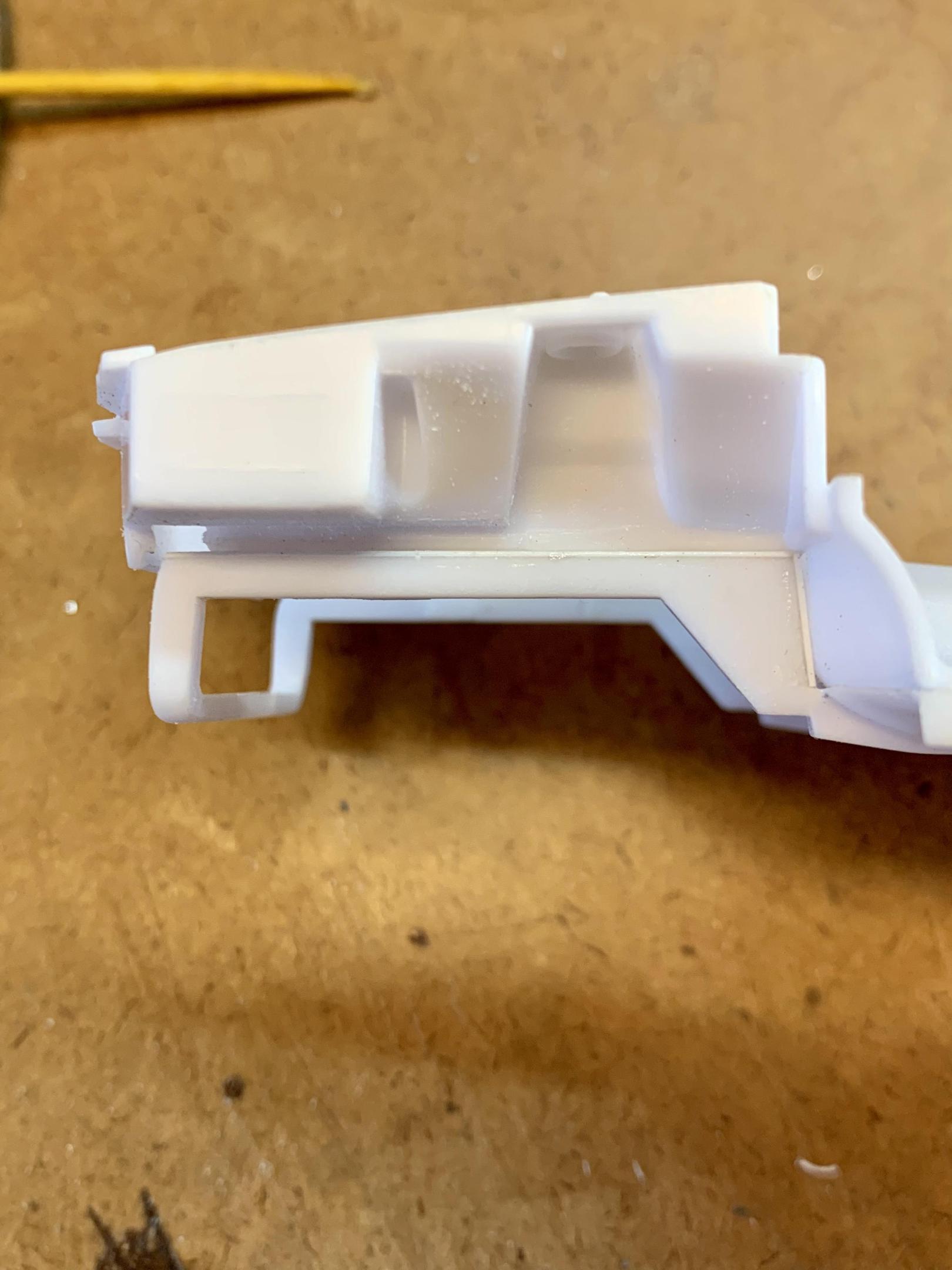

Yesterday I spent some quality time at the bench.  The way this kit is made has the floor pan, front frame rails and lower core support as one piece and then the engine bay side panels, upper core support and interior floor as another. Now the full size car is a unibody so the frame rails and engine bay are not separate, they are a constructed unit. The thing I don’t like about the way the kit has them separate is it leaves the frame rails flimsy and also without any positive locating tabs at the front it makes keeping the rails and bay together and aligned a pain.

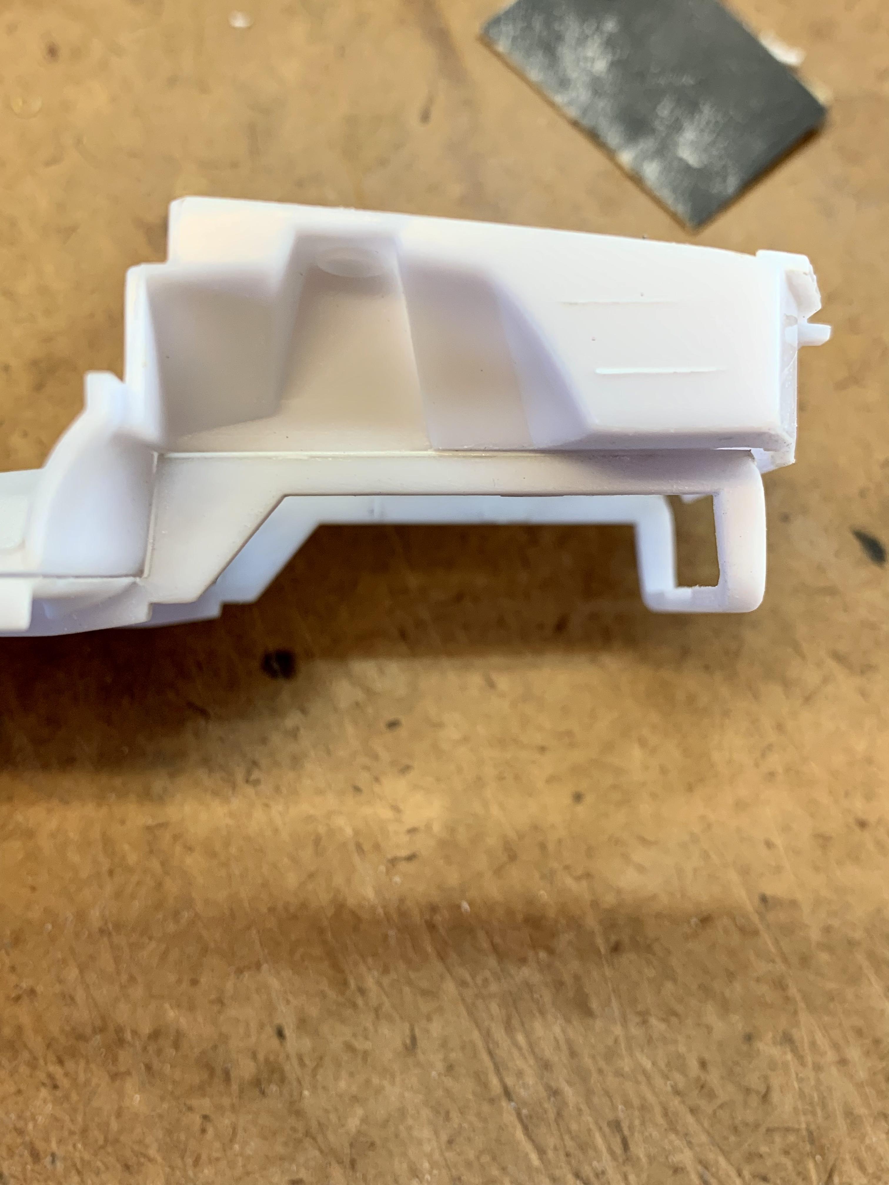

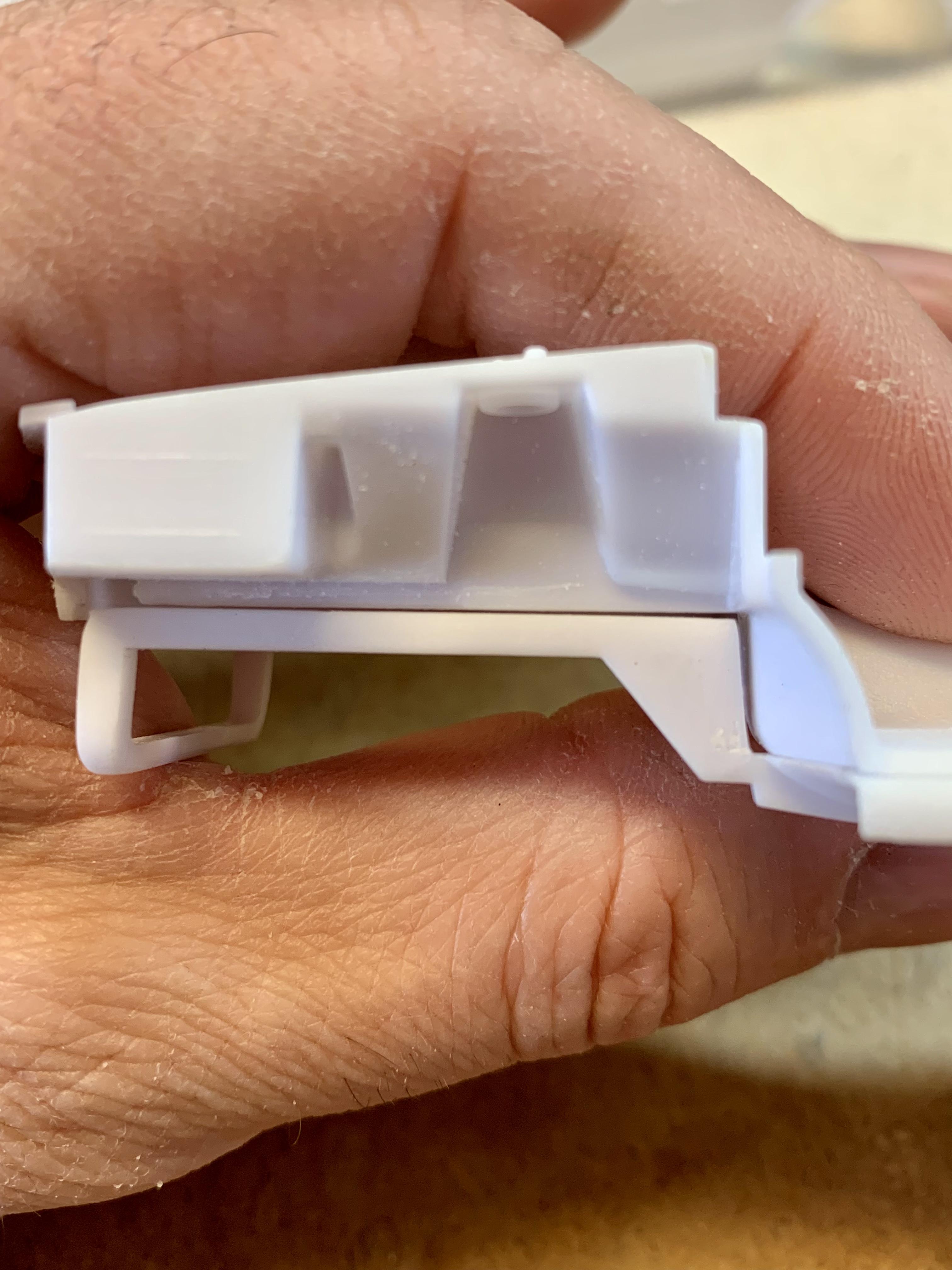

After studying the situation for a bit I found no reason why these two big pieces can’t be permanently joined now to make life easier during construction. It just means a bit of masking when I eventually get to painting. I’d rather deal with masking later than clumsy separate pieces now. The only thing is that when you place the two parts together there is a gap between the frame rails and bottom of the engine bay walls. If you push them together they will touch at the front but still leave a wedge shaped gap. There’s also a gap at the back edge where the frame rails should butt against the lower part of the firewall.

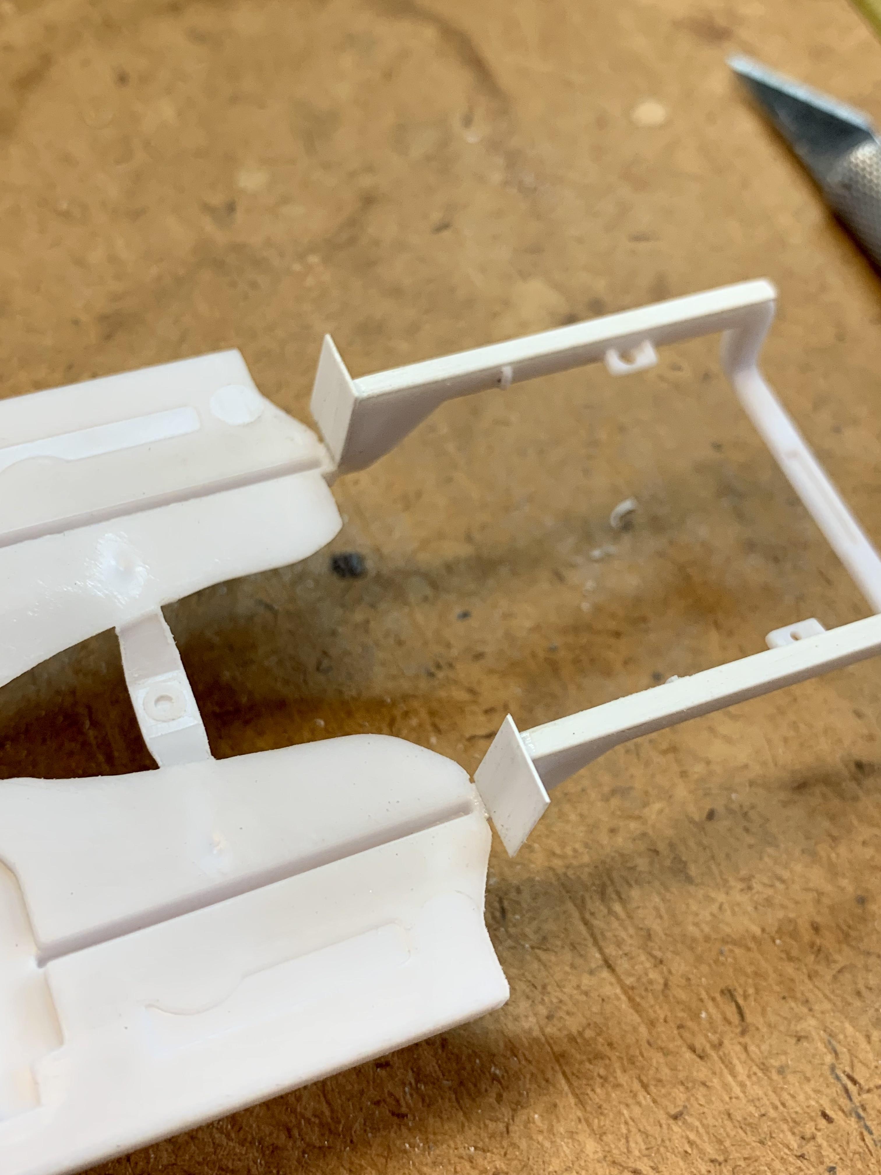

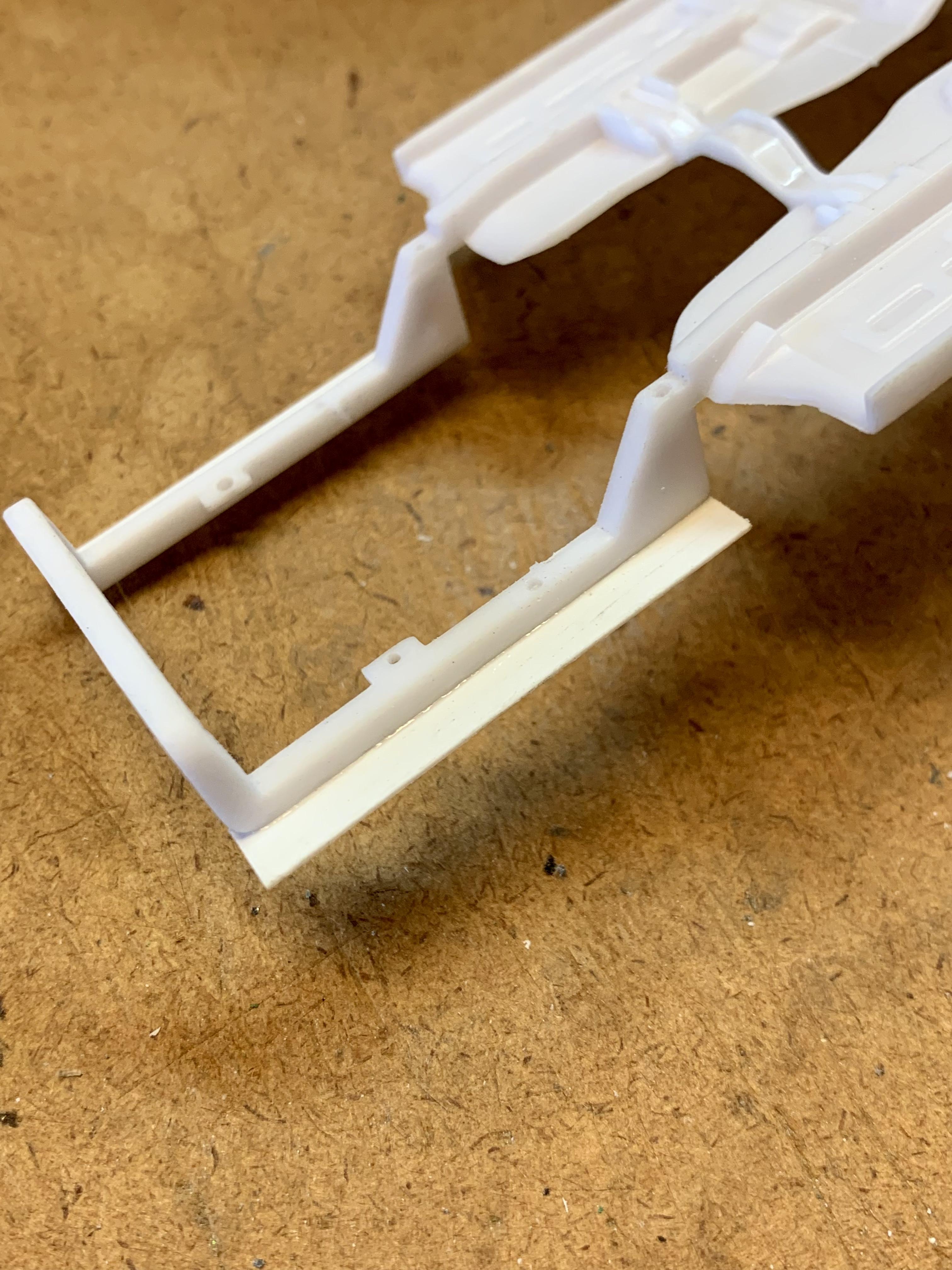

To remedy this I added strips of .010” Evergreen to the tops and back sides of the frame rails. The excess was trimmed and sanded flush and then the floor/frame rails piece was permanently joined to the engine bay walls/interior floor piece. Now the chassis has some sturdy structure to work with.

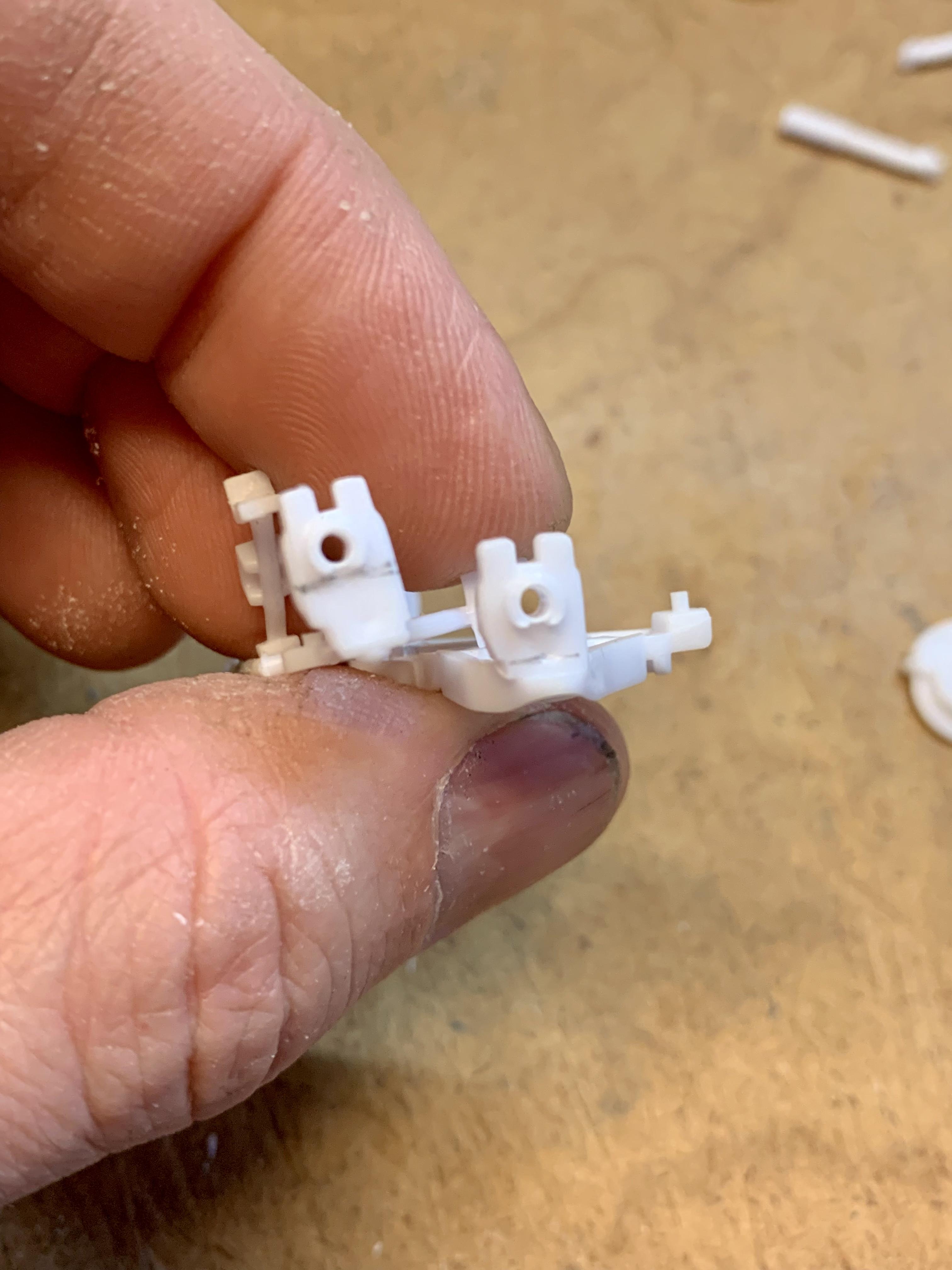

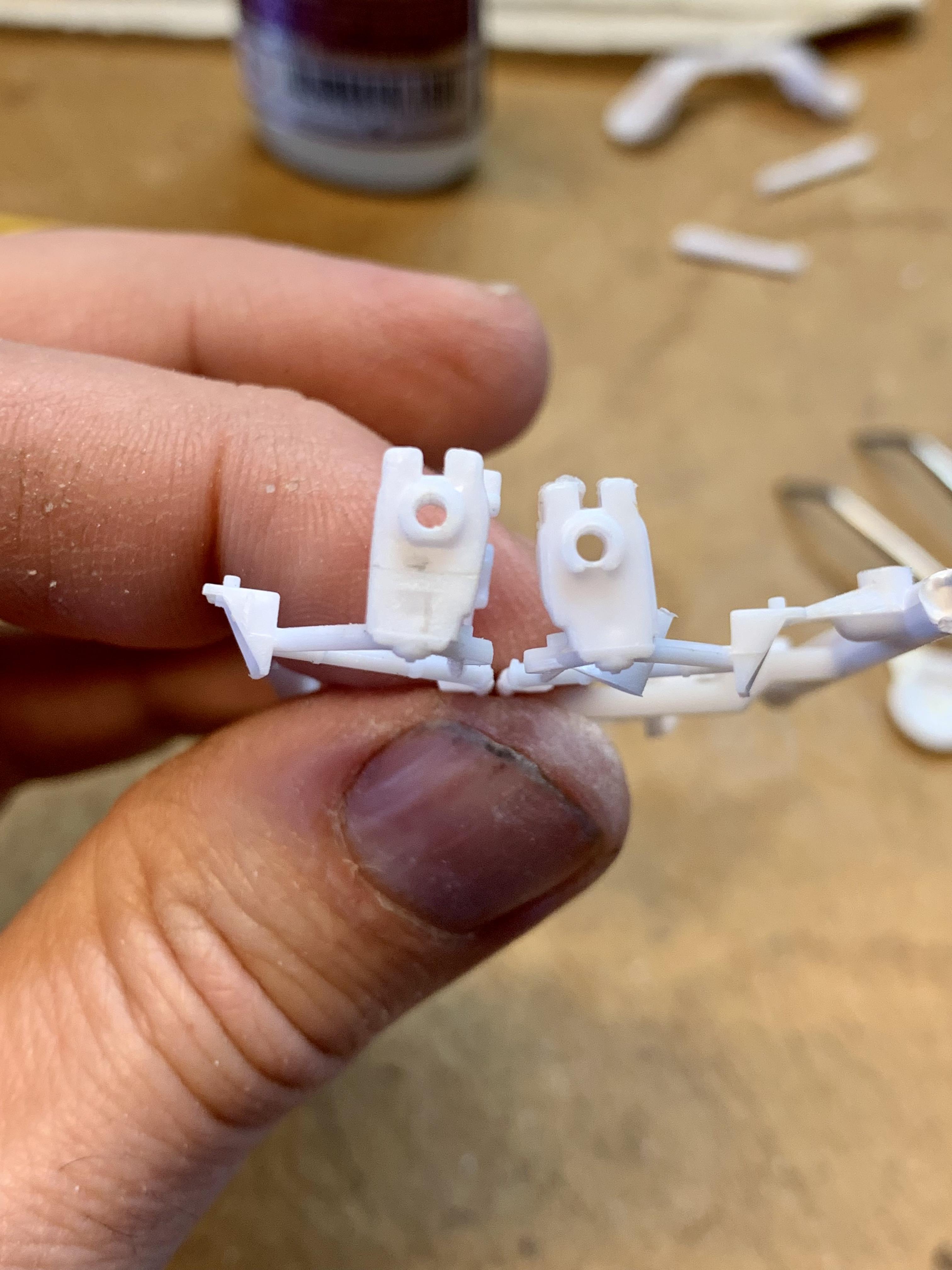

Moving on, the next thing was to figure out how to lower the front of the car. After mocking up the tubular k-member and struts I realized I only needed to get a 1/16” drop to have the little bit of tire tuck I want. After some staring and thinking I realized I could cut the “spindle” area off just below the raised D-shaped registers for the brakes then cut the “spindles” off at their base from the unused stock k-member piece, graft those pieces onto the tube k-member and create a set of “dropped spindles” which actually do exist in the aftermarket for these cars.  I added some support strips to the backside to strengthen the graft. I’ll clean those areas up some more later.

Support strips on back side of modified “dropped spindles”:

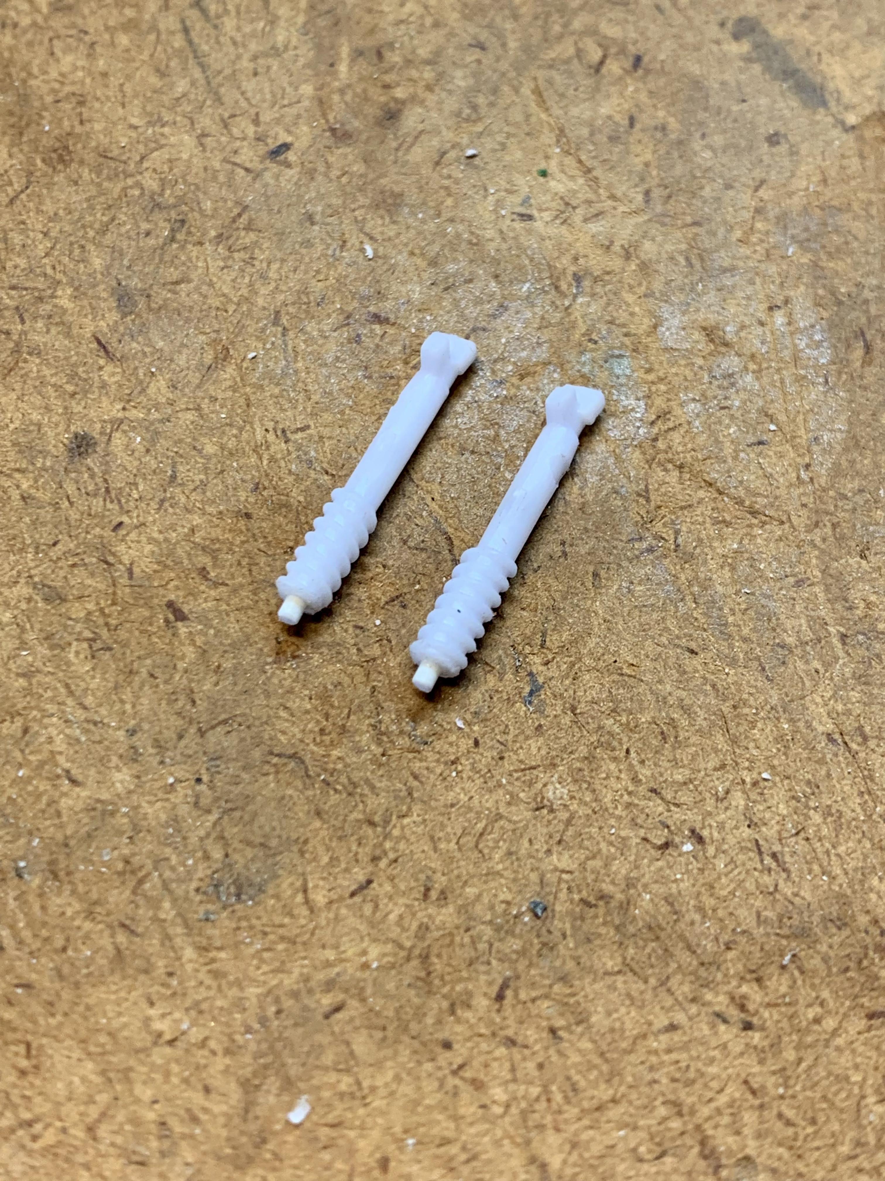

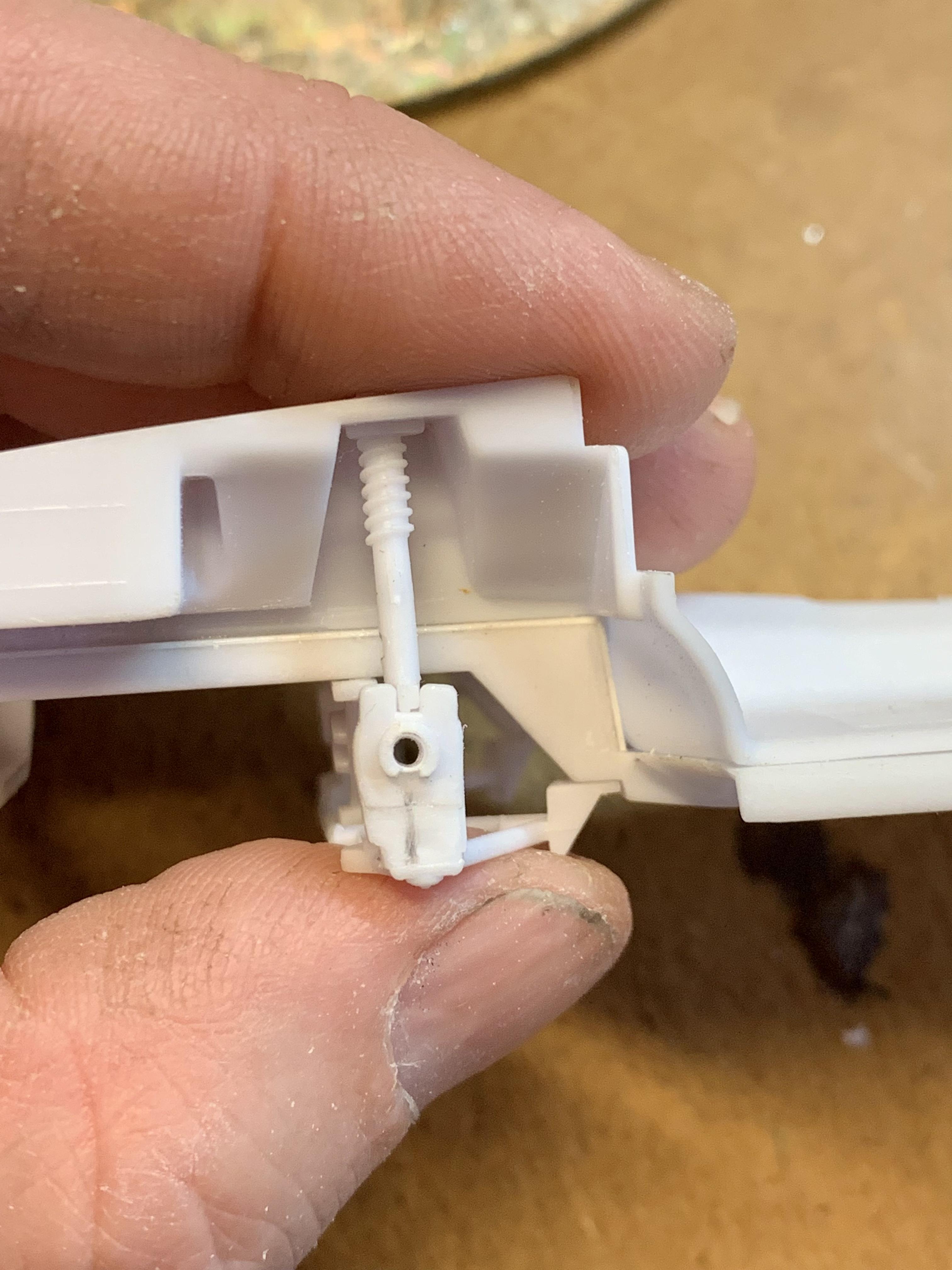

For use with the tube k-member the kit gives a set of front struts rendered with coil over springs. With the “spindles” made taller it means that the struts are too long. I shortened them the necessary amount and inserted .040” rod into the tops. The kit has these locate inside 2 shallow circles up in the bottom of the strut towers but it’s not a positive locating fit so I drilled shallow holes for the pins that I added to the struts to register in (circled in red.)
Here is the left front held together. With the struts pinned this is now a sturdy assembly.

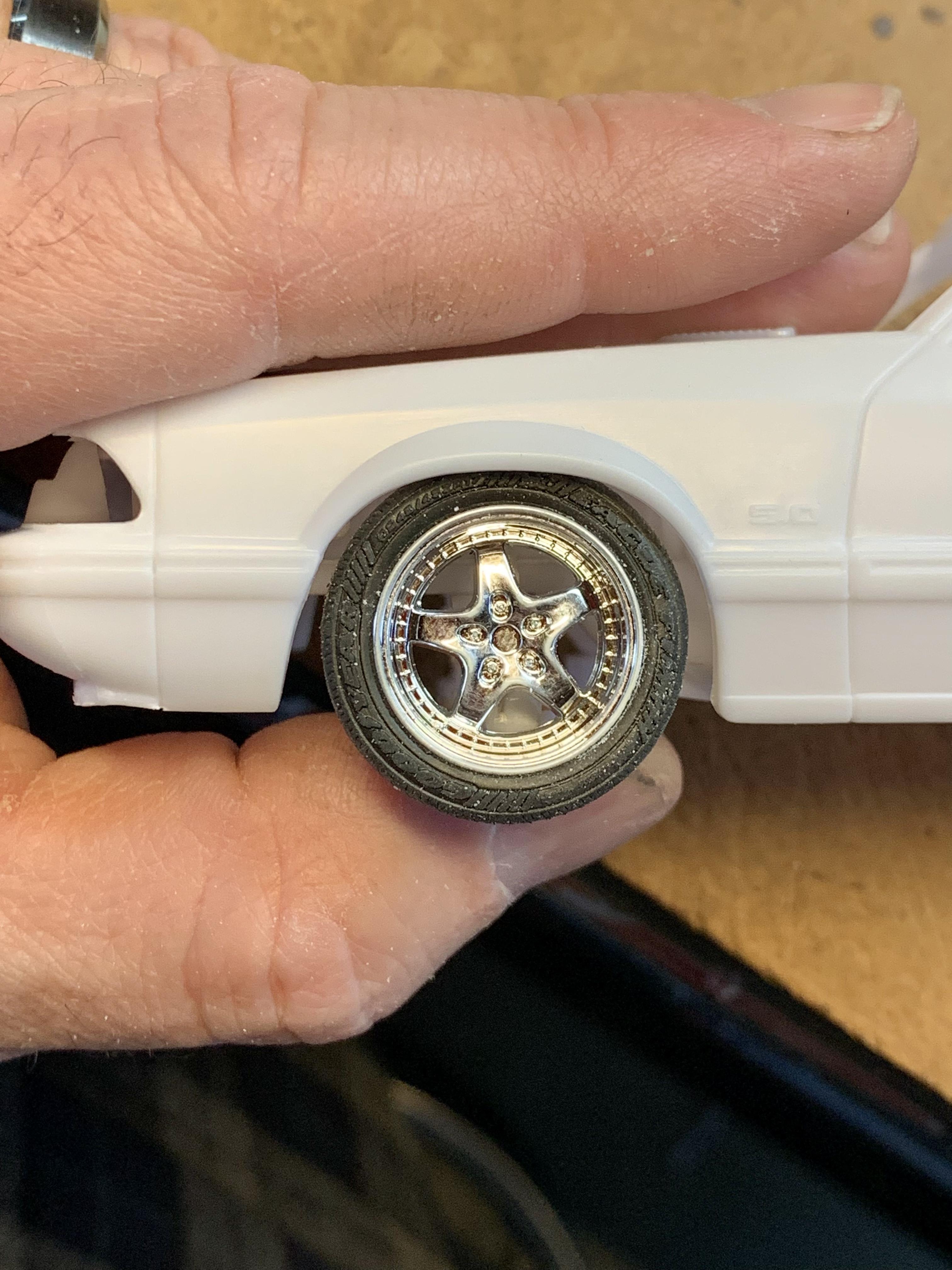

And here is the resultant tire tuck with the wheel lined up on center. Just right!

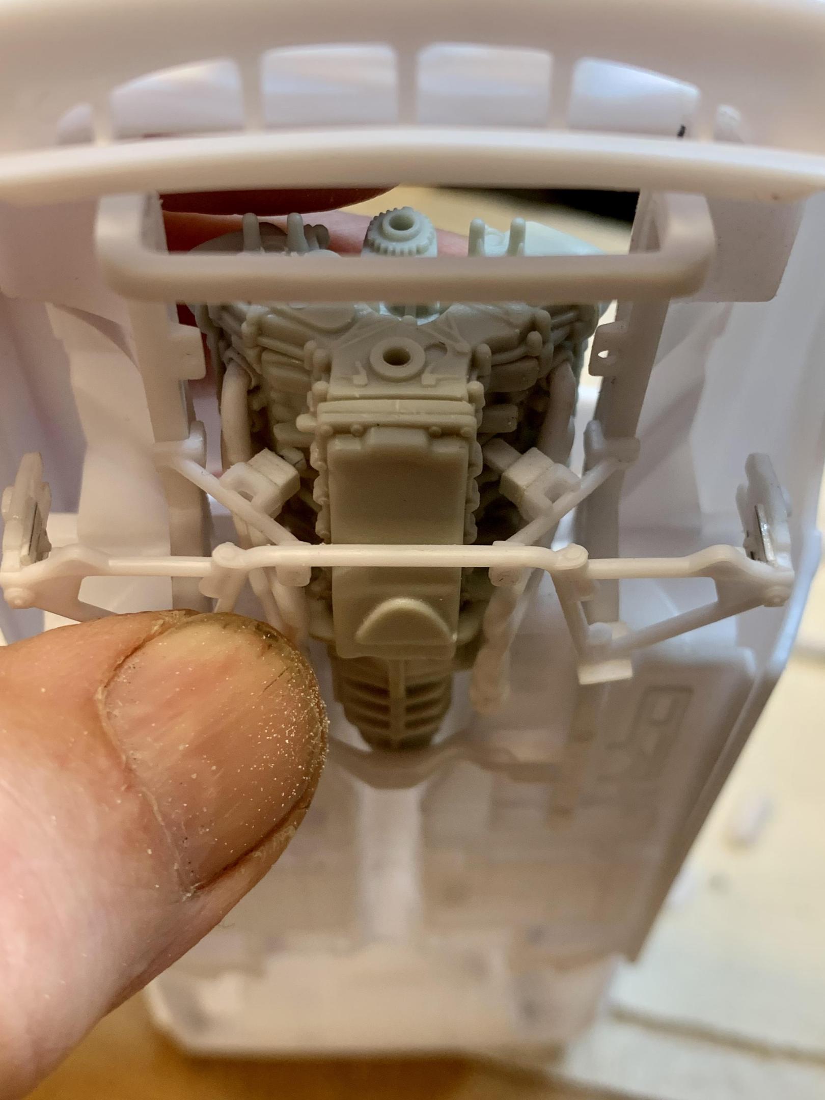

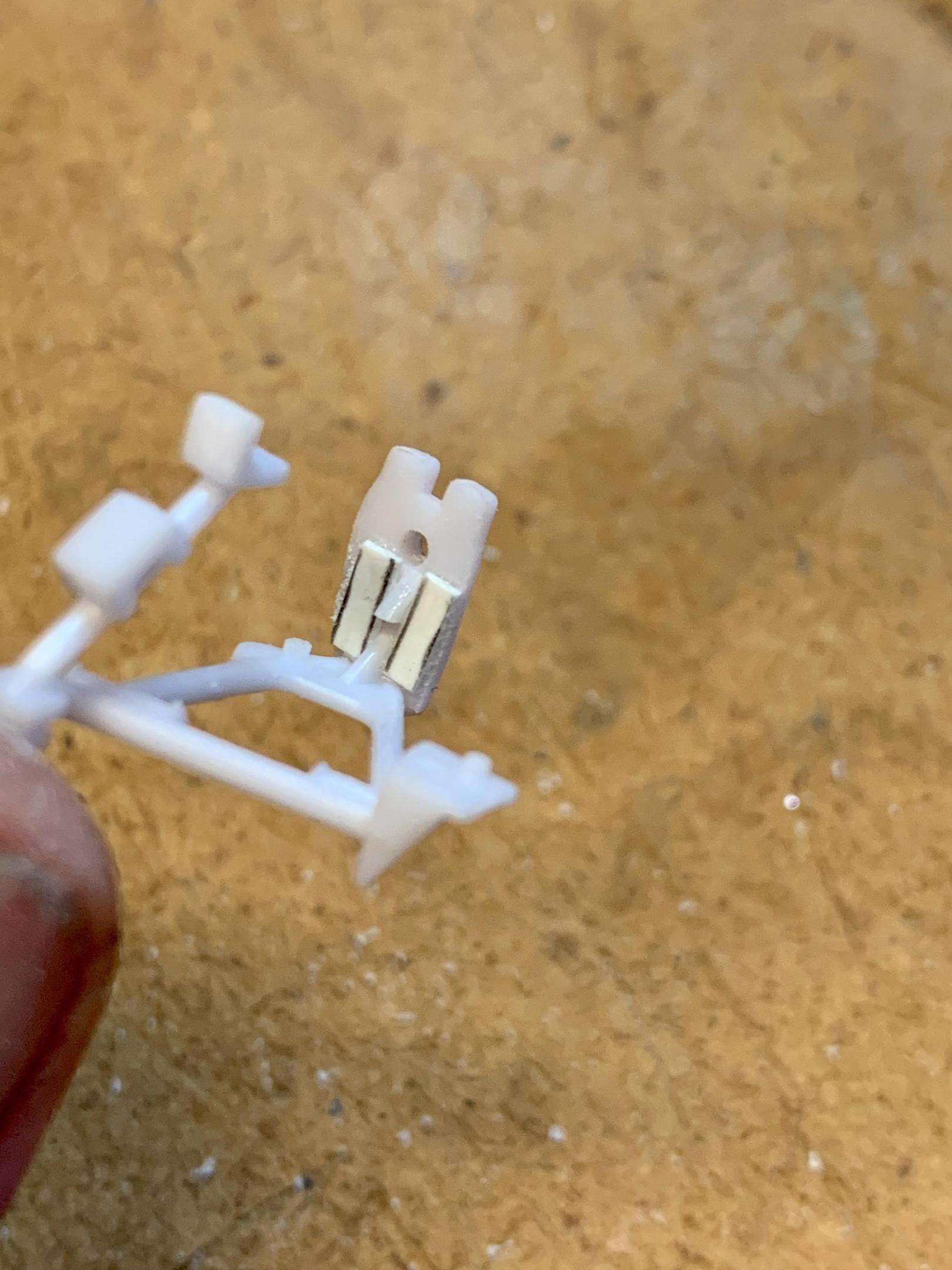

The last thing I accomplished yesterday was building some front motor mounts to hold the engine in proper location. These are not prototypical (that would be a big undertaking) but they get the job done and sit on the mount pads of the tube k-member. In the end I will paint these so that they look like something.
