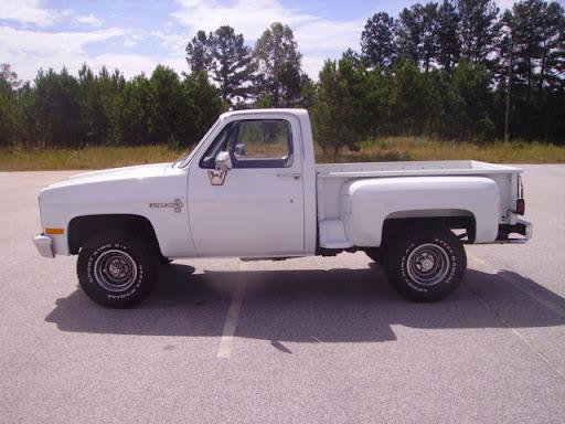

One question. Were this generation 4X4's named C/20s? That's what it has on the fender badge. I was thinking half ton 4X4's were K/10s and the three quarter tons were C or K 20s.
4wd’s were k/10, k/20, or k/30 for 1/2, 3/4, or 1 ton ratings. C designated 2wd. It does look better now, but the box is still tilted back a bit and not parallel with the body line on the side of the cab.?
Edited by NOBLNG
That body is sitting a lot better now. The mock-up is reminding me of the Chevy from Red Dawn. 7B10DCF6-C71D-4C37-B125-476DAF189ABB.jpeg.256d40518f8833cbf50259911392ea76.jpeg
The MPC kit depicts a K10 (4 wheel drive half ton) stepside in Custom Deluxe trim.
That's confusing. That truck has the gas door on the passenger side.
Thanx for the info Greg! I thought that's how it was with the Chevies. You're right about the bed. It does need to be raised a bit more.
Dual saddle tanks were likely an option.
Edited by NOBLNG
Standard they came with one tank on the driver side. Dual saddle tanks were a popular option. What confuses me is that MPC tooled the chassis with just one tank and on the passenger side.
