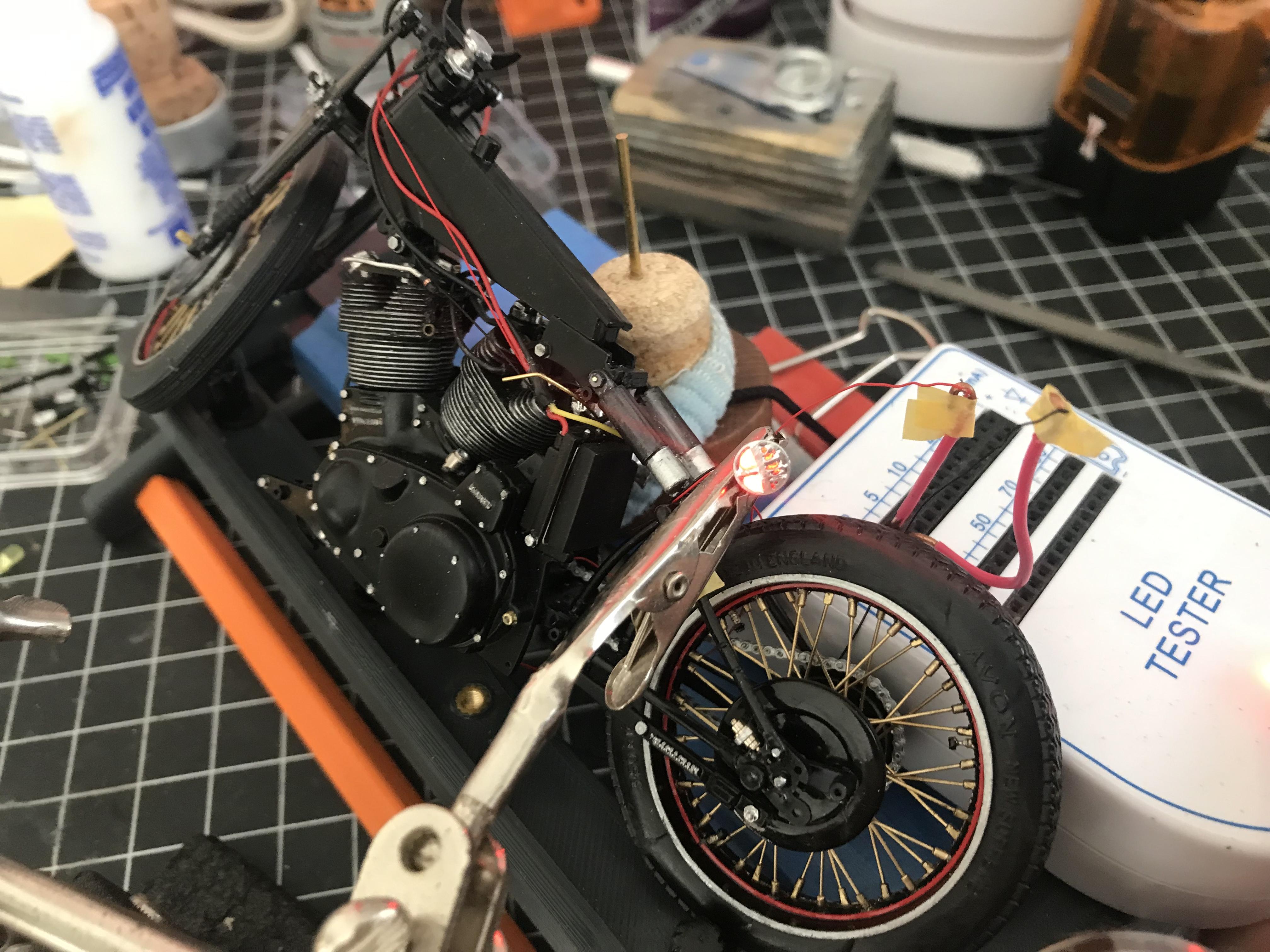

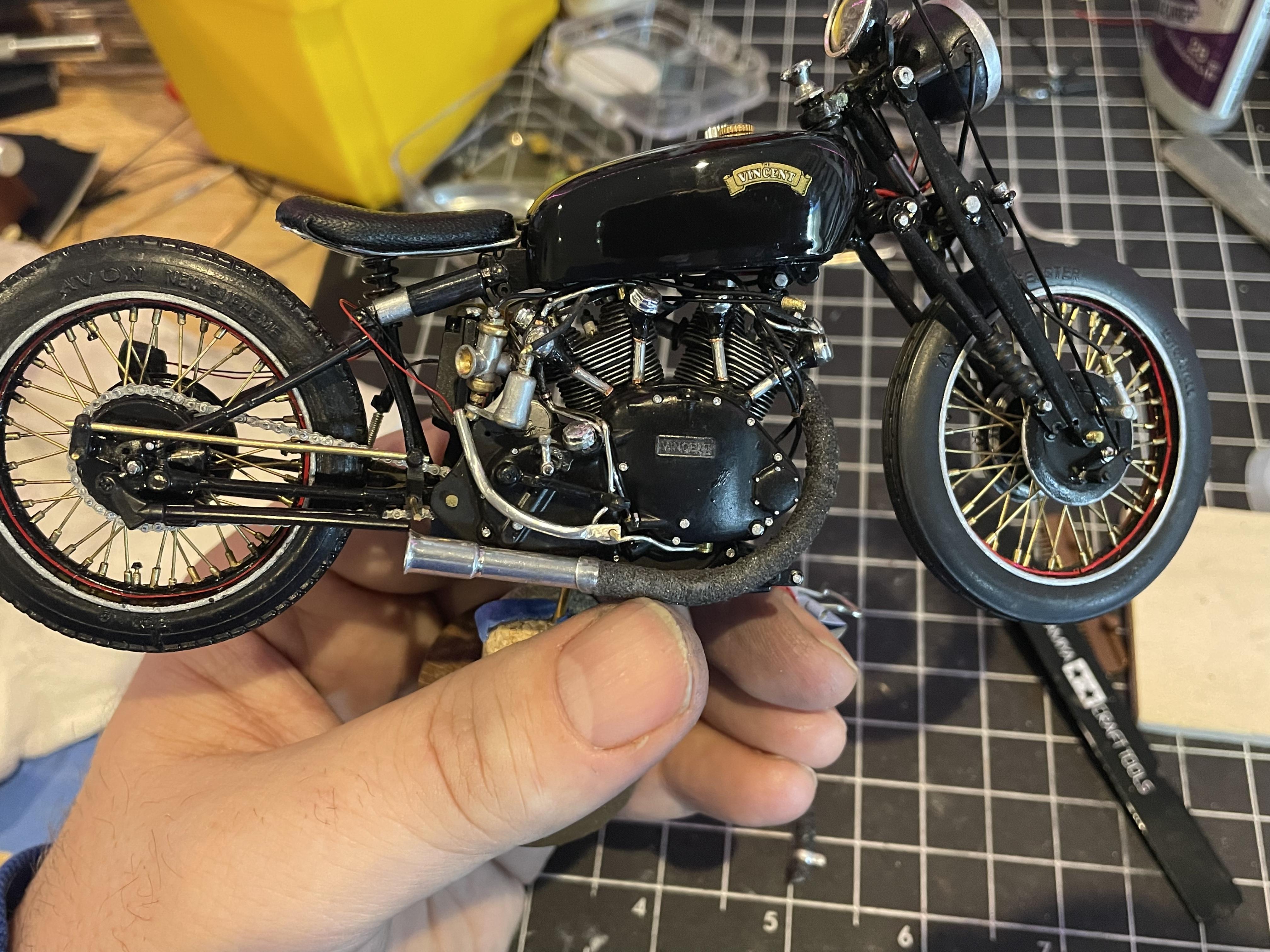

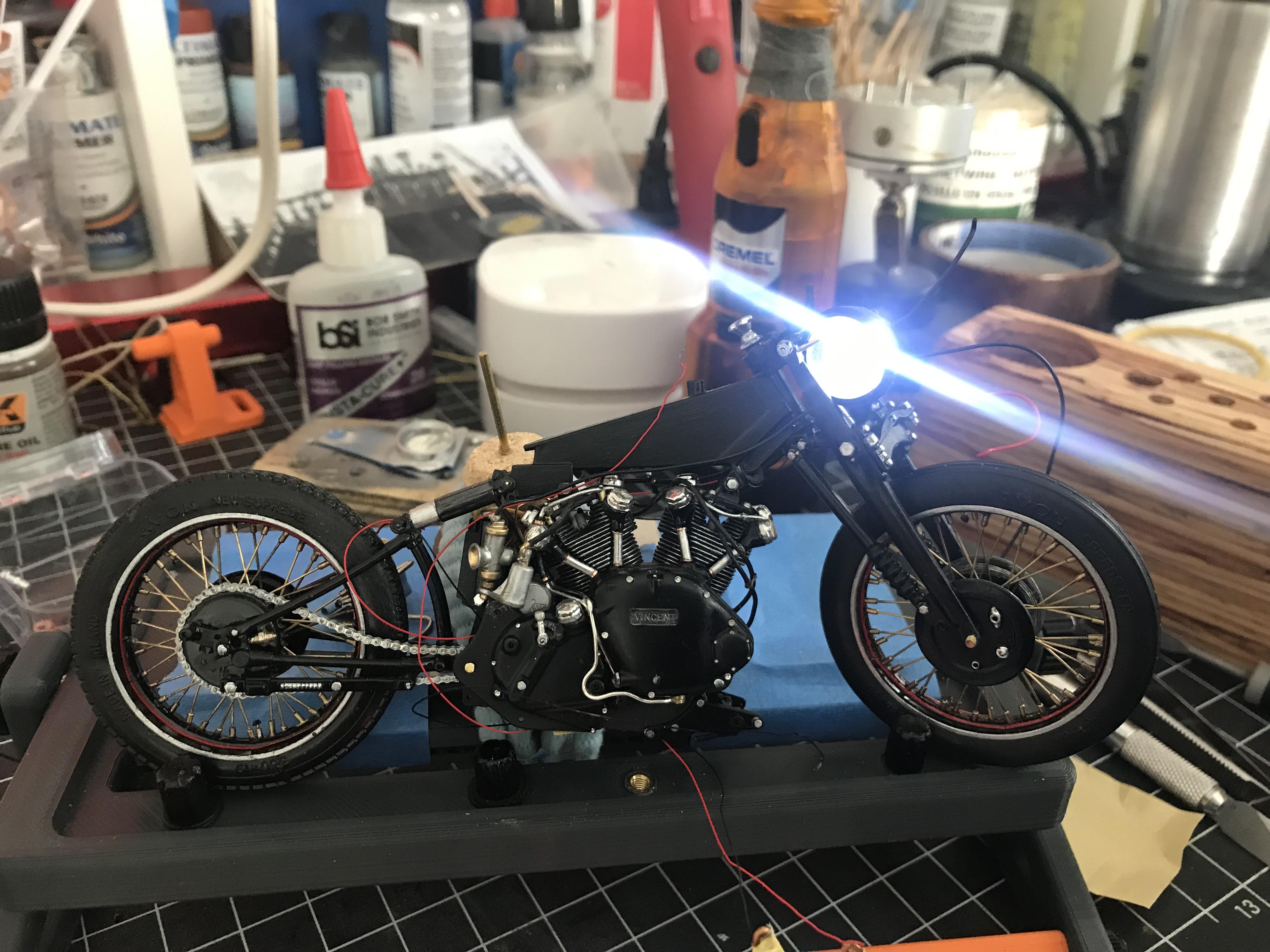

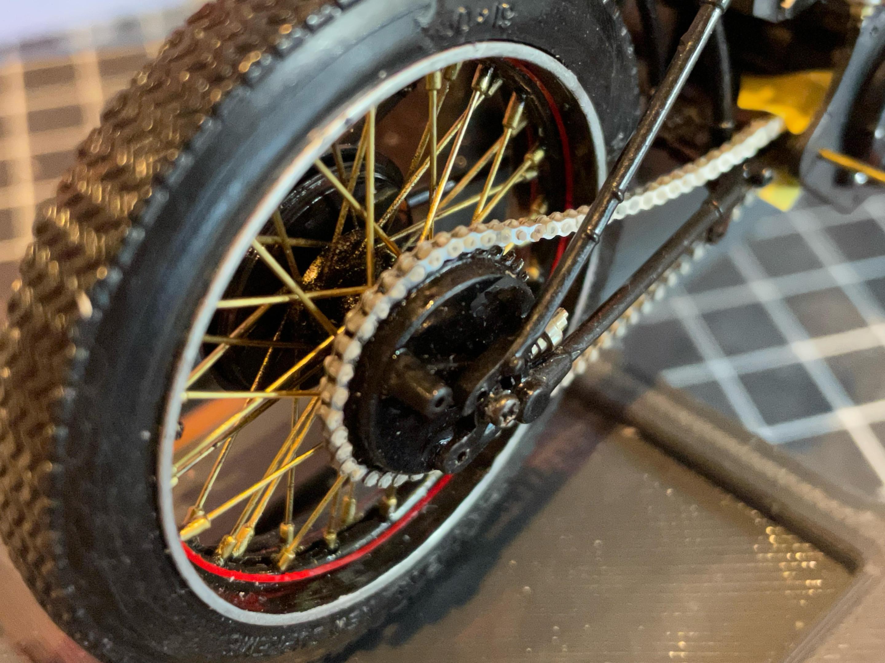

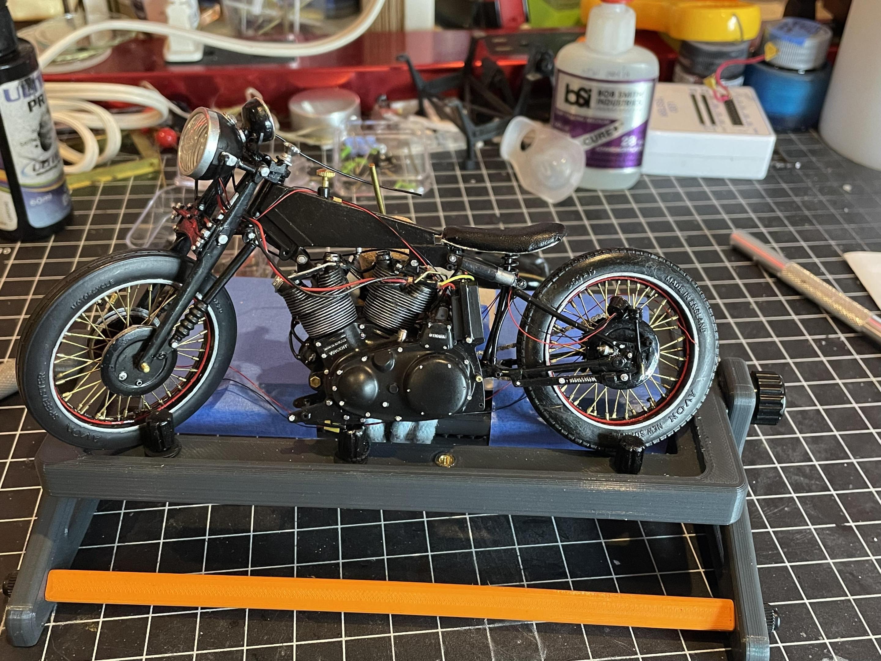

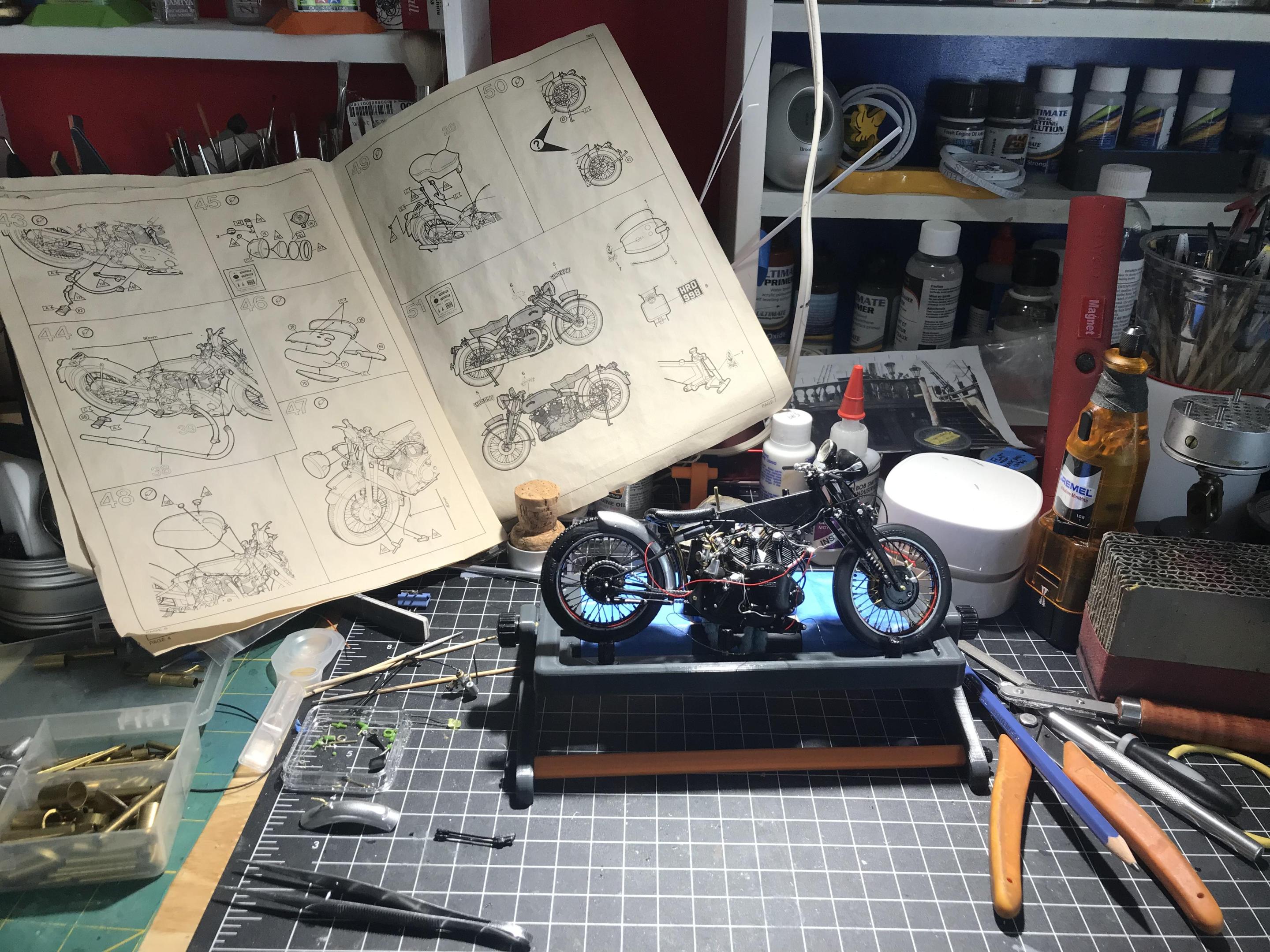

Been working on a project for over a year. This old kit has had a few manufacturers take the moulds. This one is Revell

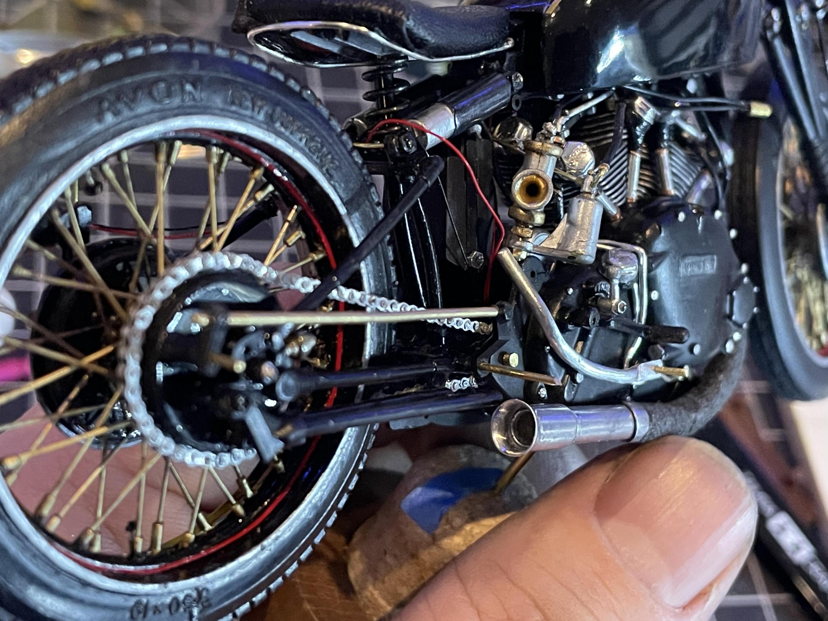

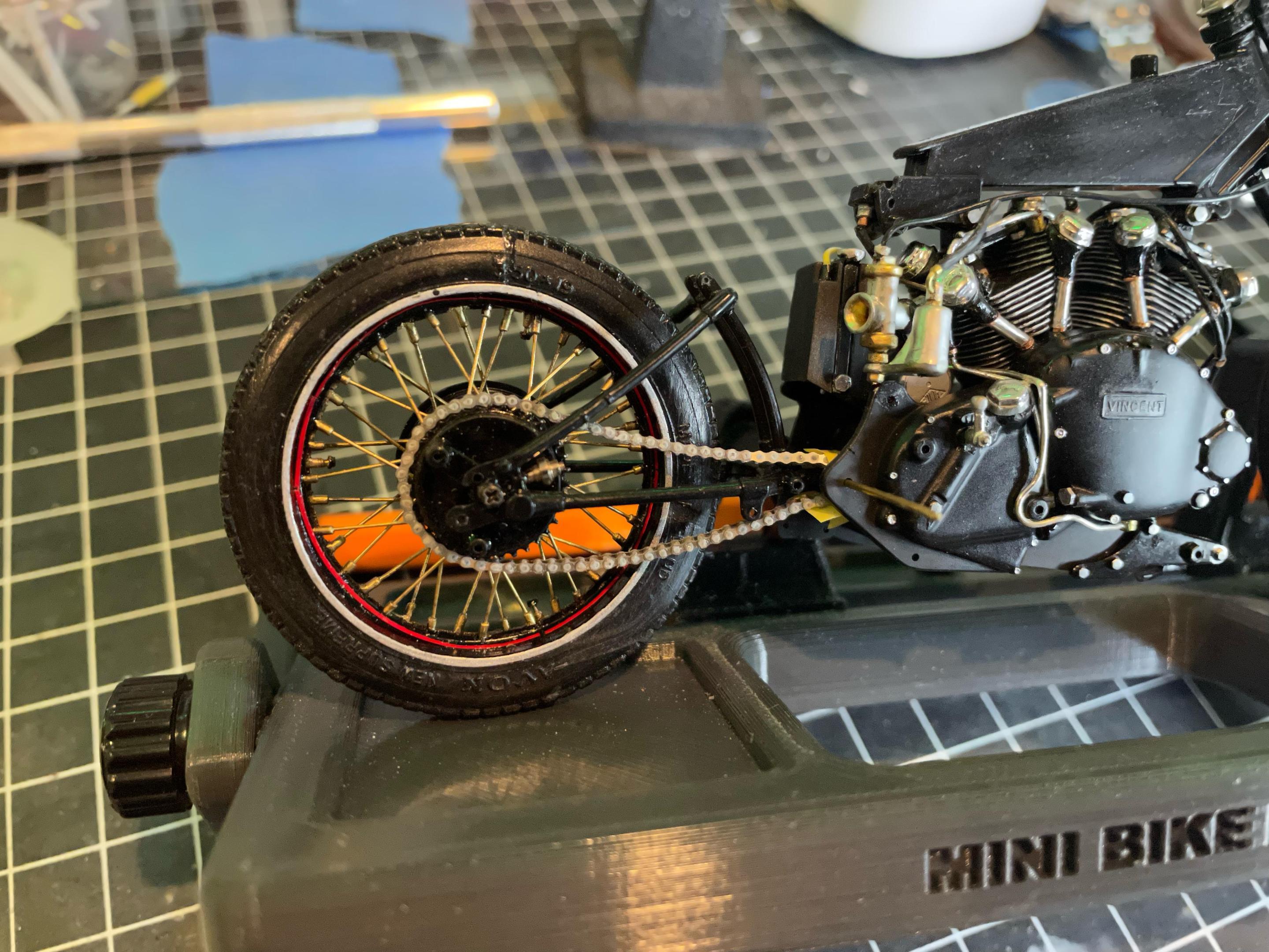

I have re-done the wheels in brass spokes, detailed the engine up a bit, made a MFH metal chain and am in the process of making a couple new seats and a custom exhaust before she gets finished over this Christmas break
All attachment points have either threaded brass rods or brass pins for more strength and hold. I had to pin and cement the hard rear tire as it split.

Delightful work transforming that old Vincent motor cycle kit. I think it was from Matchbox originally.
The old Airfix BMW R69 kit could.make a nice compliment to this one. Not sure if it is to the same scale of not. Have not seen one for a number of years.
  • Like 1

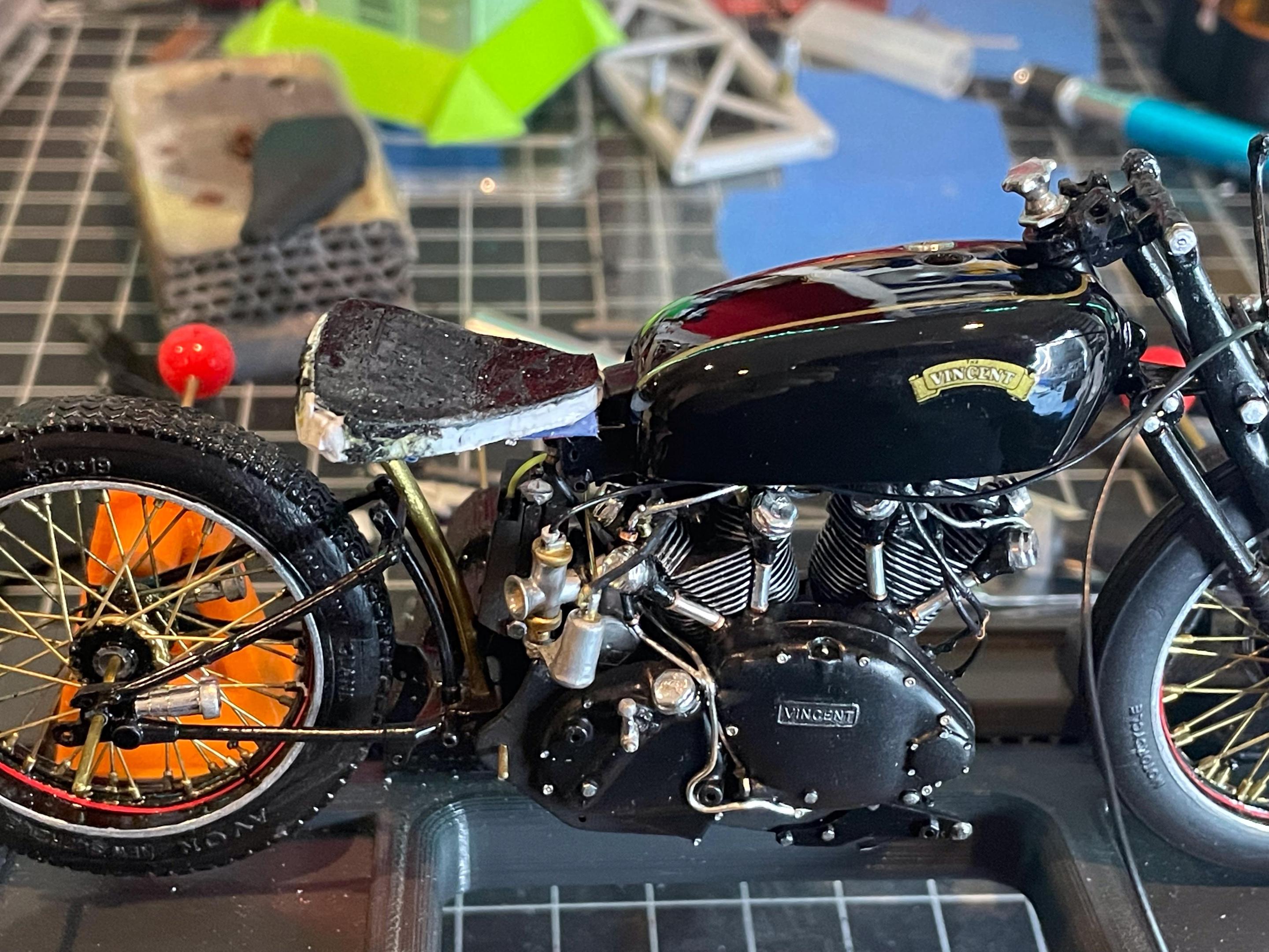

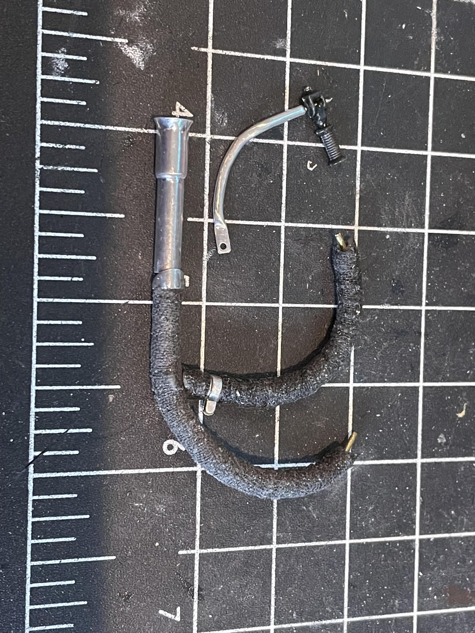

Got over two big hurdles that were slowing this build down

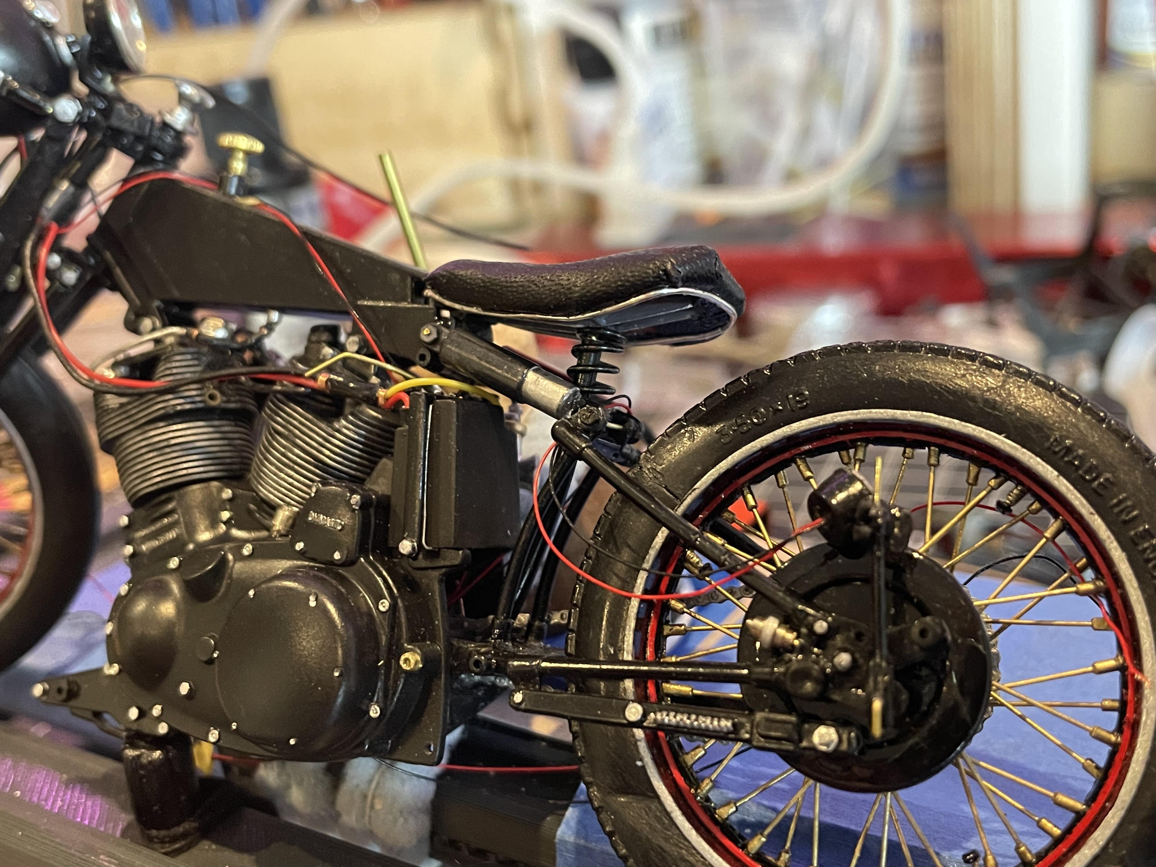

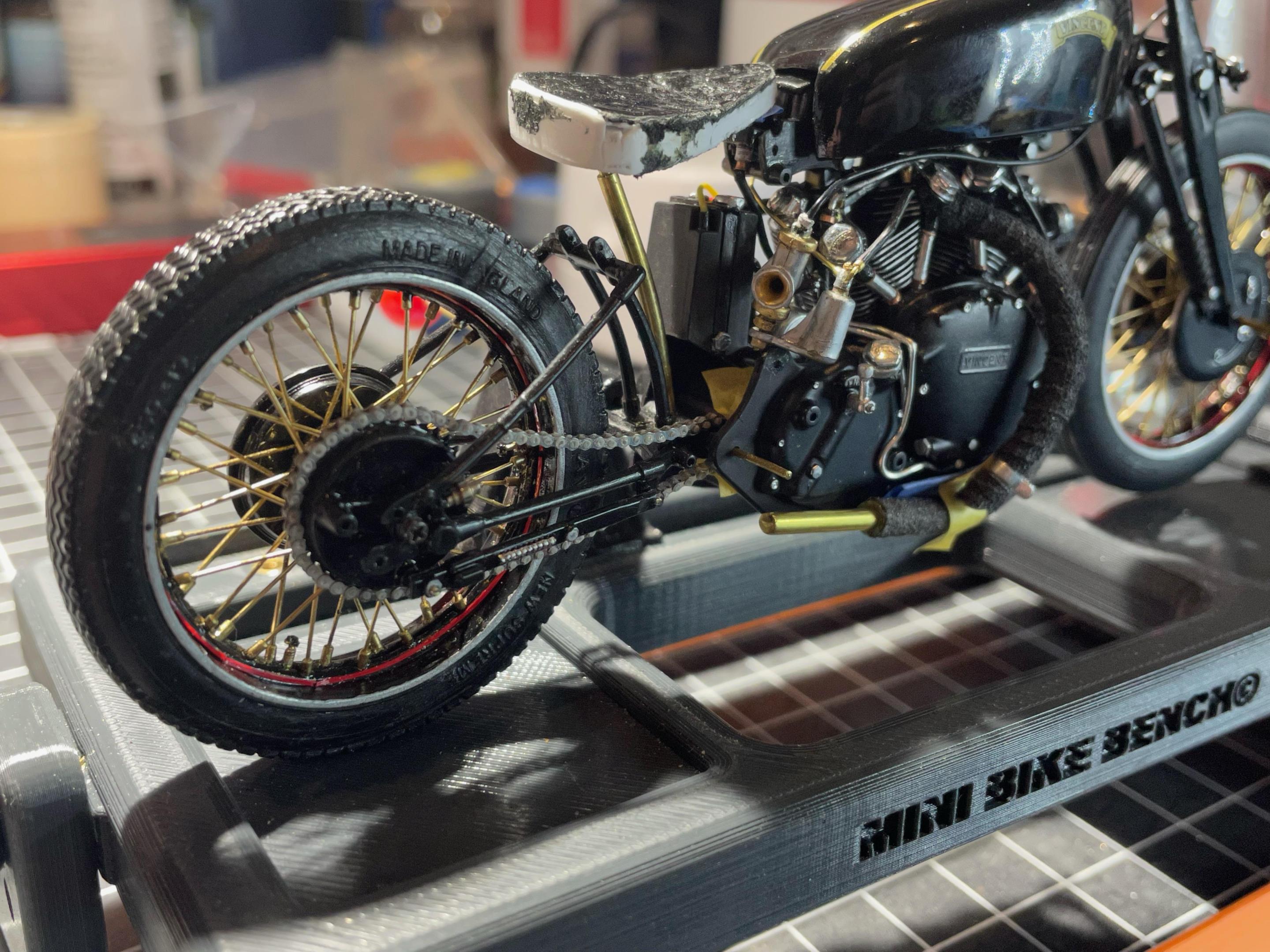

First the seat and the seat post: I made a smaller/sleeker leather seat and a spring for the support bar.

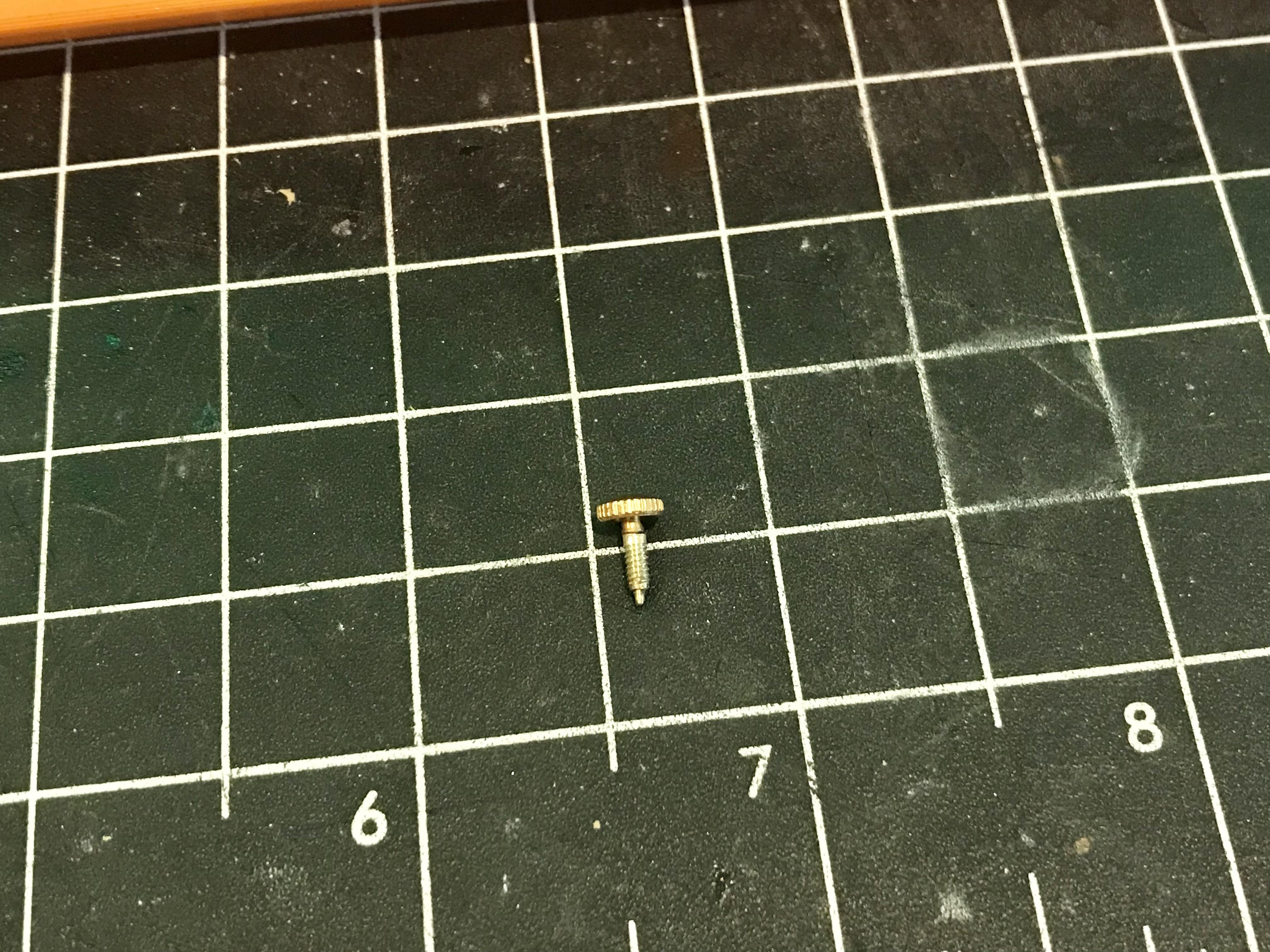

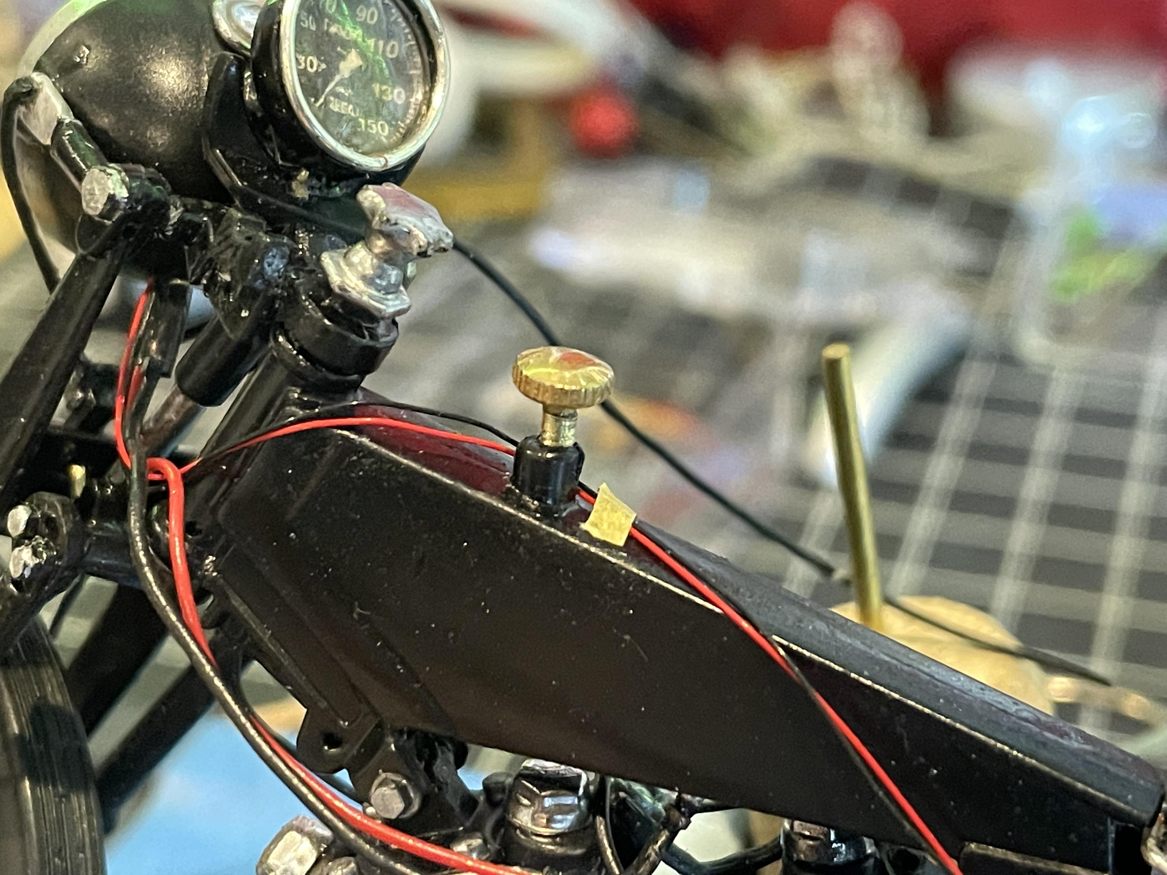

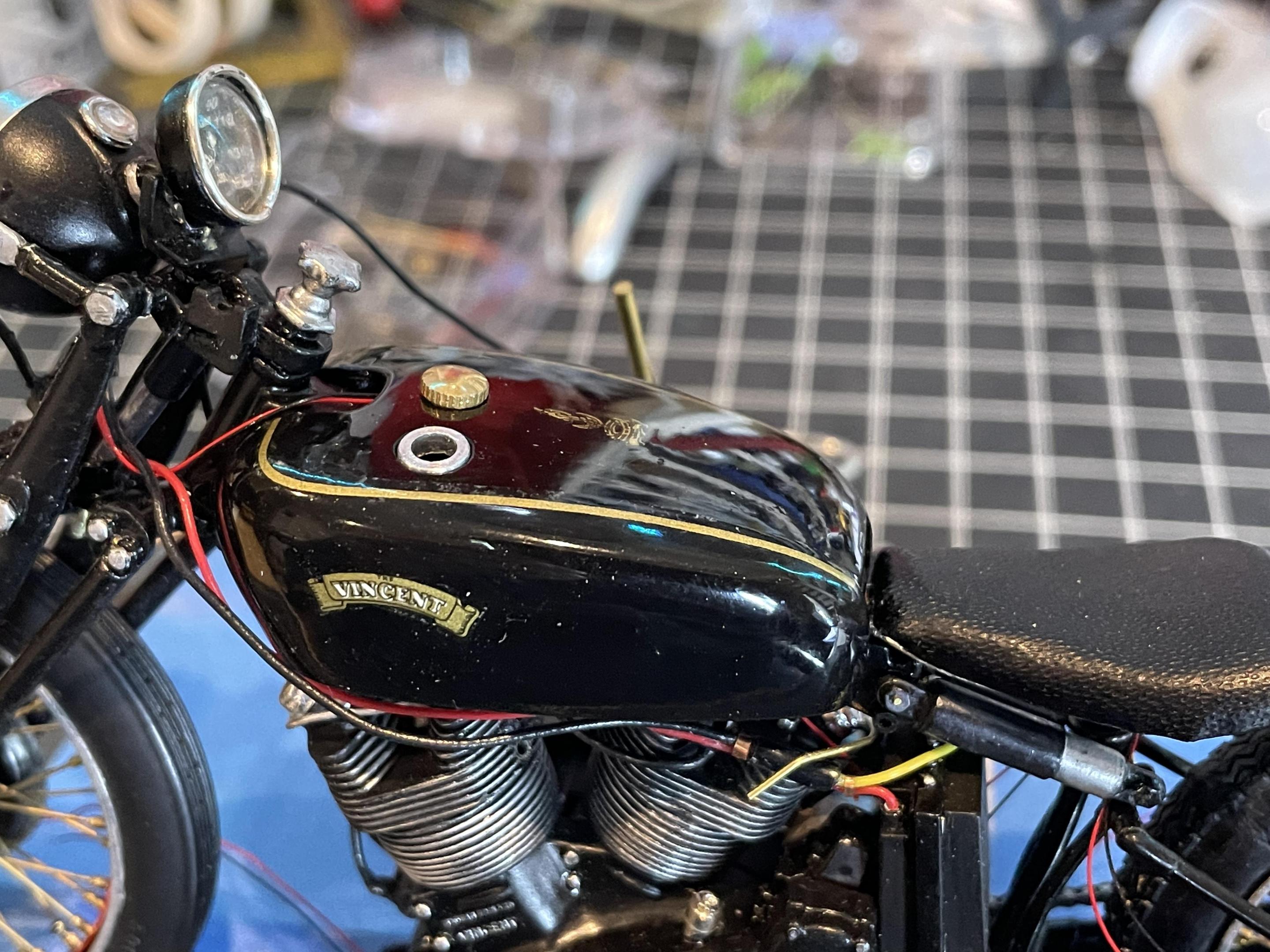

Second: I needed the fuel tank to be stable so I can do the carbs and the fuel lines. A wobbly tank means loose floppy lines. So I tapped a brass tube and got it into a brass watch crown that is the oil tank cap
Then I tapped the plastic part of the oil tank to allow me to actually screw on the tank.
This will be huge in stabilizing things so I can connect the dots with the necessary fuel lines while still getting the tank off so I can polish it for final assembly

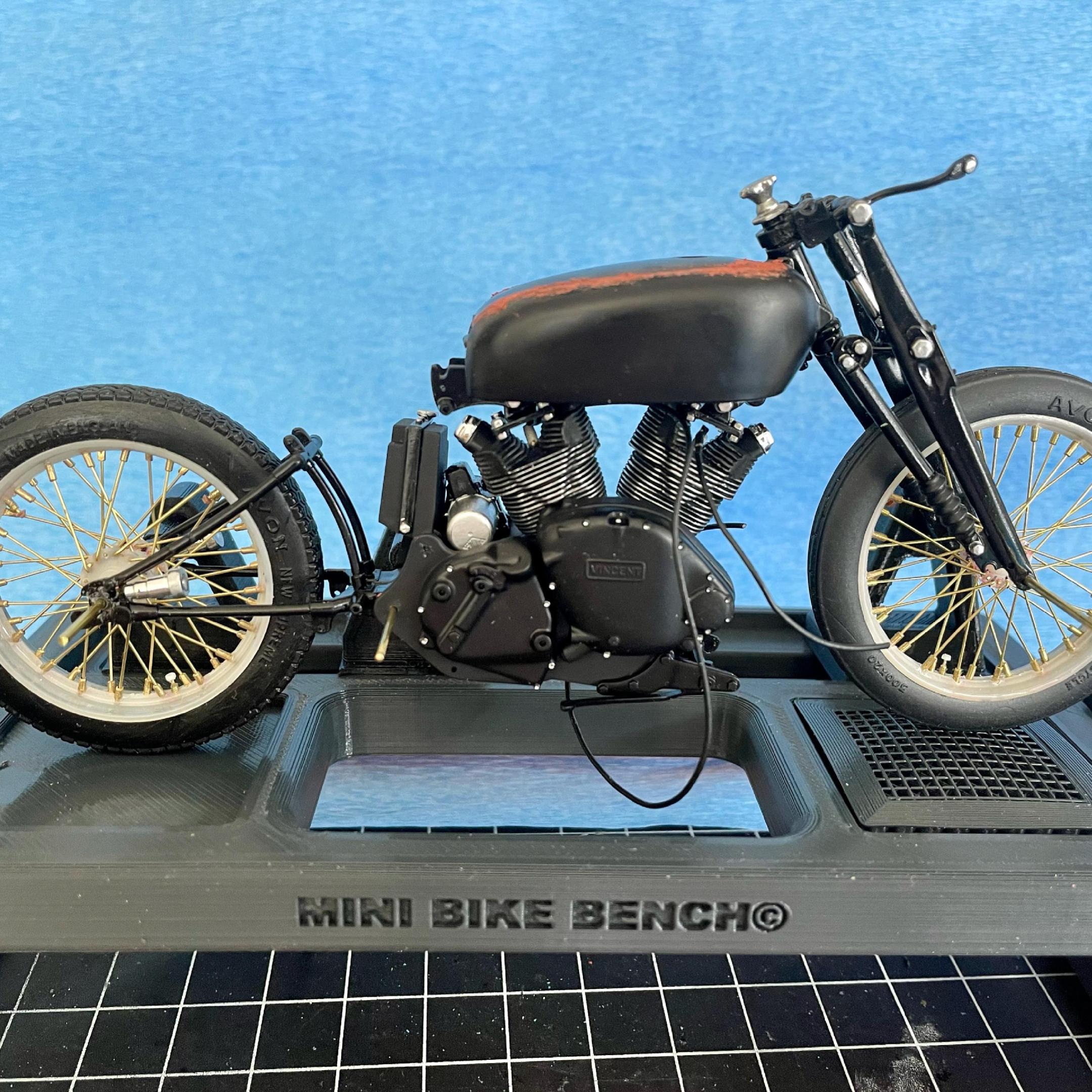

The stand is a prototype from a friend In England. He was designing it and asked help with working out some bugs.
This mini bike bench allows you to tilt the build while still secure in the table. Very helpful.
Not sure if it is in production for sales, he has been swamped with his work lately minibikebench on Facebook or Instagram
I have the other aluminum rail stand style stand too, both are nice for securing a motorcycle down
