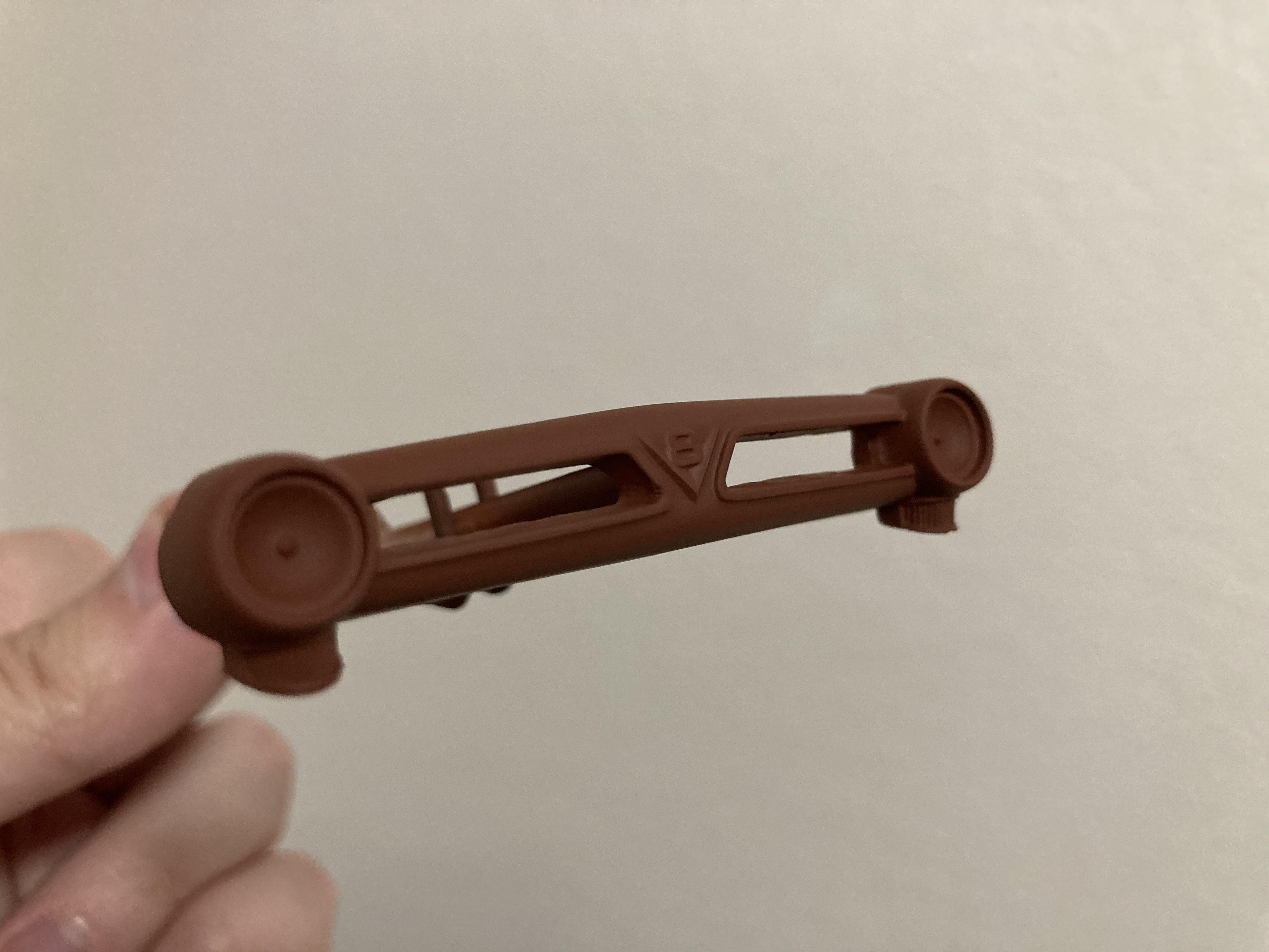

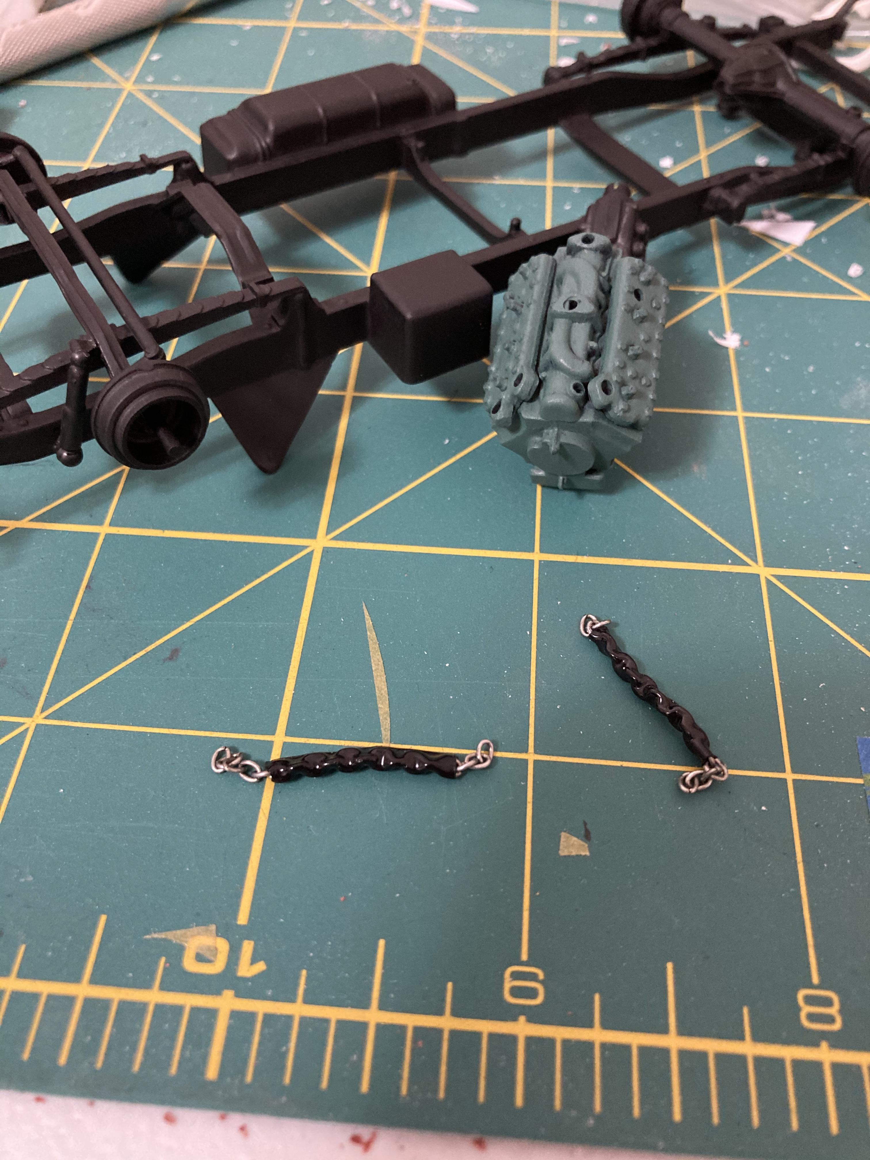

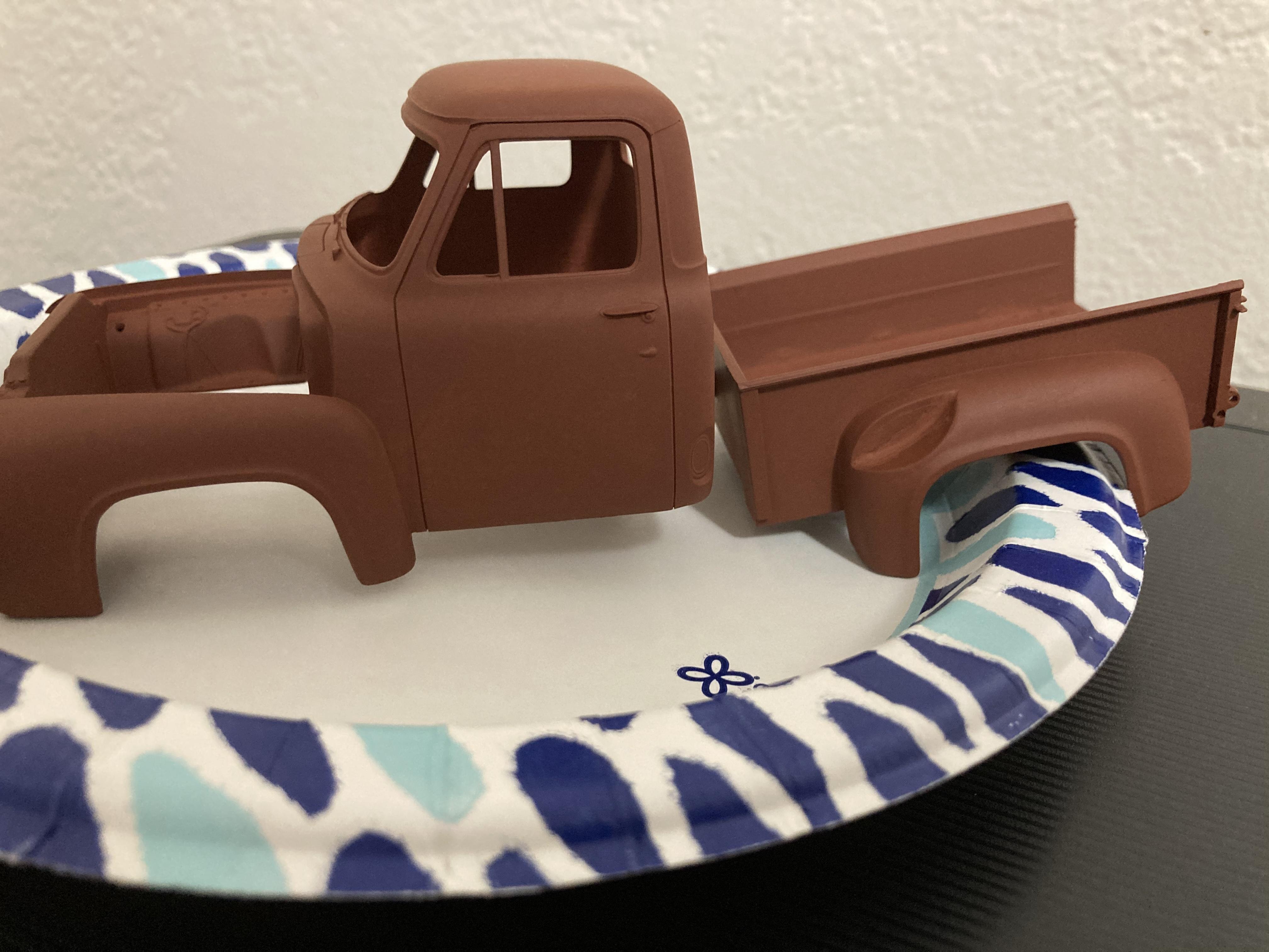

Smoke Wagon Posted January 1, 2022 Posted January 1, 2022 With the BRAT finished up and done, there was about a square inch of bare space on my work bench, so I figured I’d remedy that and start another project while working on the other ones. Jokes aside, my intention with multiple projects is to not get burned out focusing on just one. This kit was the Trophy Series reissue that came with the Wildkat decals and mini box. This is a great kit despite its age, the only gripe I have is with the interior, but the frame, engine(s), and detailing under the bed floor more than make up for it. I chose to make it stock, but not a Deluxe, so I hallowed out the grille and took out the Deluxe grille teeth. The grille will be painted a warm white, and I’ll be using Goof-Off to get rid of the white wall pad printing on all of the tires. I modified the driver side rear fender to accept a side-mounted spare after I saw how good an image of it online looked. I also made some tailgate chains out of jewelry chain and electrical tape, we’ll see if those work out or not. 1

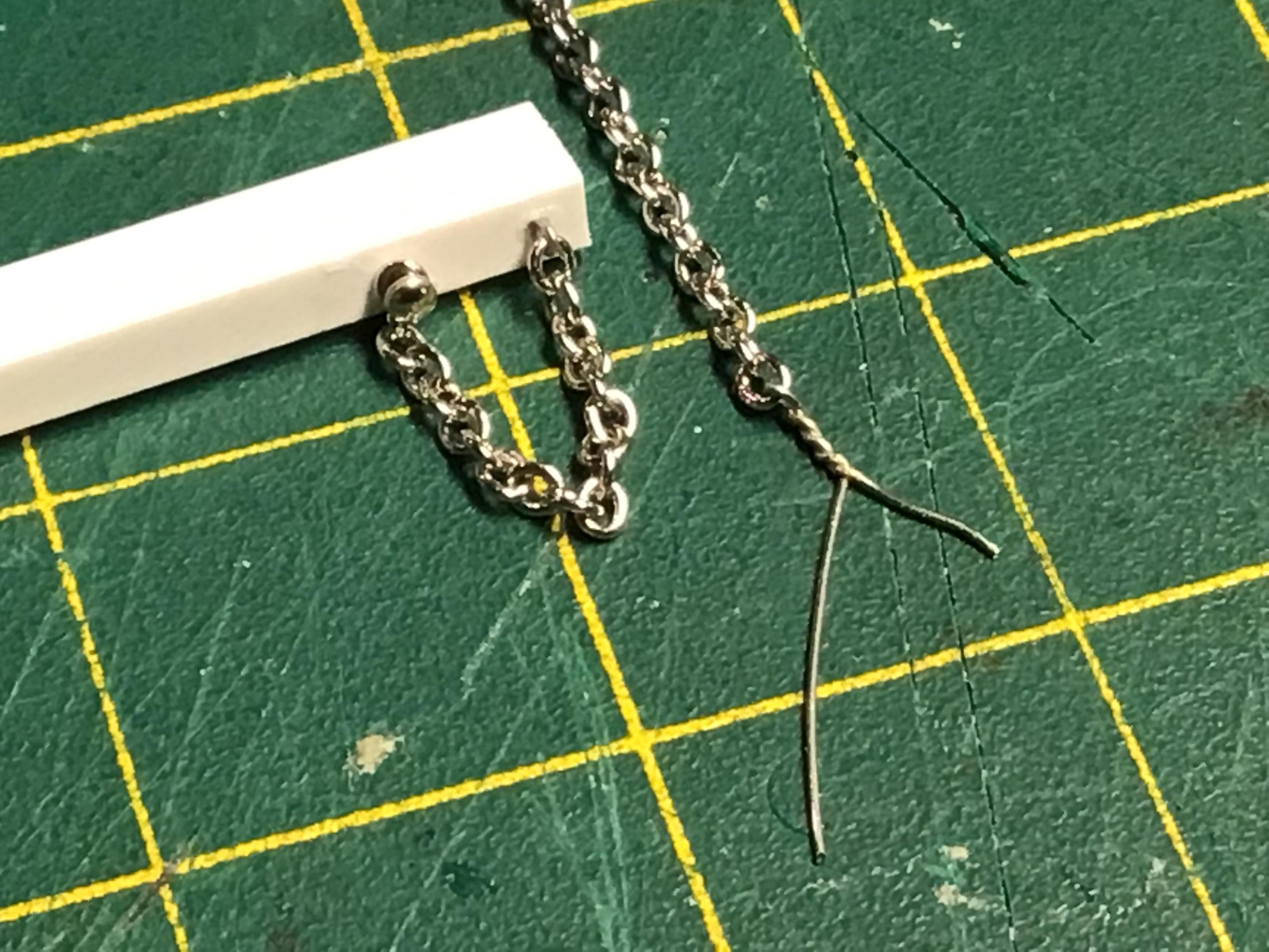

NOBLNG Posted January 1, 2022 Posted January 1, 2022 Nice job on that fender mod. For mounting the chains, I’ve used pins and made U bolts from wire, but the best so far is to make “eye” bolts by twisting .011” beading wire. 1 1
espo Posted January 1, 2022 Posted January 1, 2022 I like how you're doing the side mount spare. I had a 1:1 '56 with this option many years ago. At the time it was not considered to be a desirable option. The attachment to the bed was done with round stock between the side of the bed and a flat plate to which the tire was mounted using three lug nuts. Being a standard model, it may not of even had a hub cap or any other type of dress up.

Smoke Wagon Posted January 1, 2022 Author Posted January 1, 2022 Thanks for the tip Greg. Beautiful clean work there. I’ll have to do that from now on, what I did on this one was glue styrene pegs to the bed and tailgate for the chains to mount onto.
Smoke Wagon Posted January 1, 2022 Author Posted January 1, 2022 6 hours ago, espo said: At the time it was not considered to be a desirable option. The attachment to the bed was done with round stock between the side of the bed and a flat plate to which the tire was mounted using three lug nuts My guess is that a side mounted spare doesn’t lend itself gracefully to custom culture and from a practical standpoint blocks a lot of access to the bed from the side step in front of the driver side rear fender. It does look good on a stock pickup though, and one advantage is that you don’t have to crawl under the truck to retrieve it. As for mounting, was the round stock welded directly to the bedside?

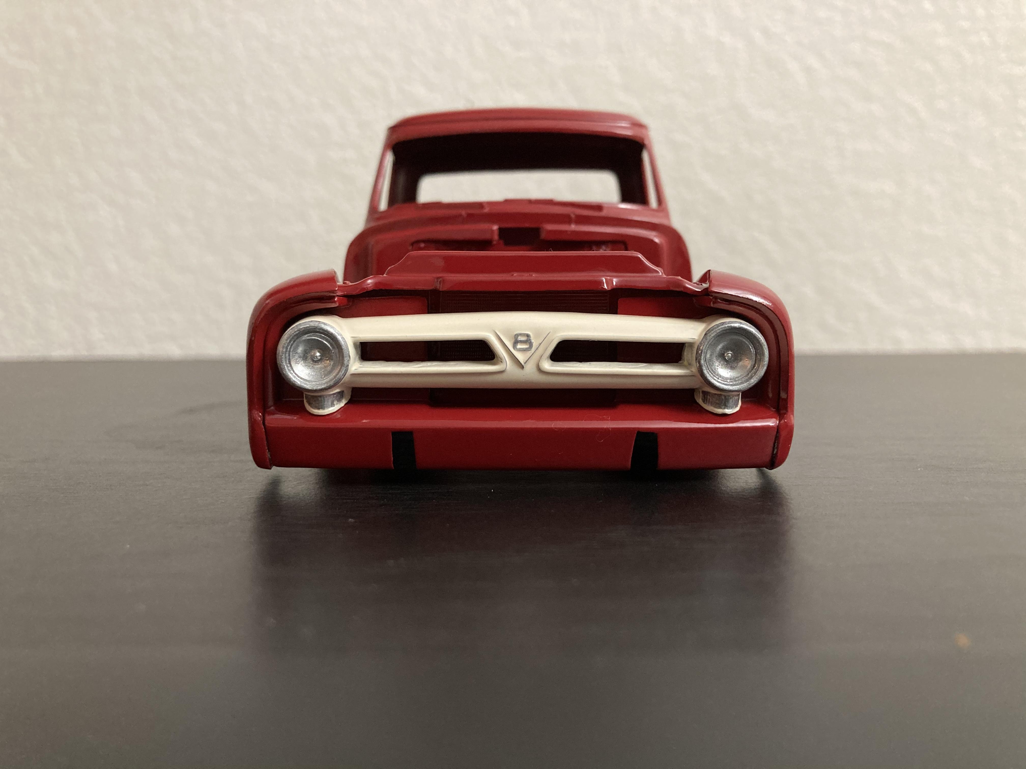

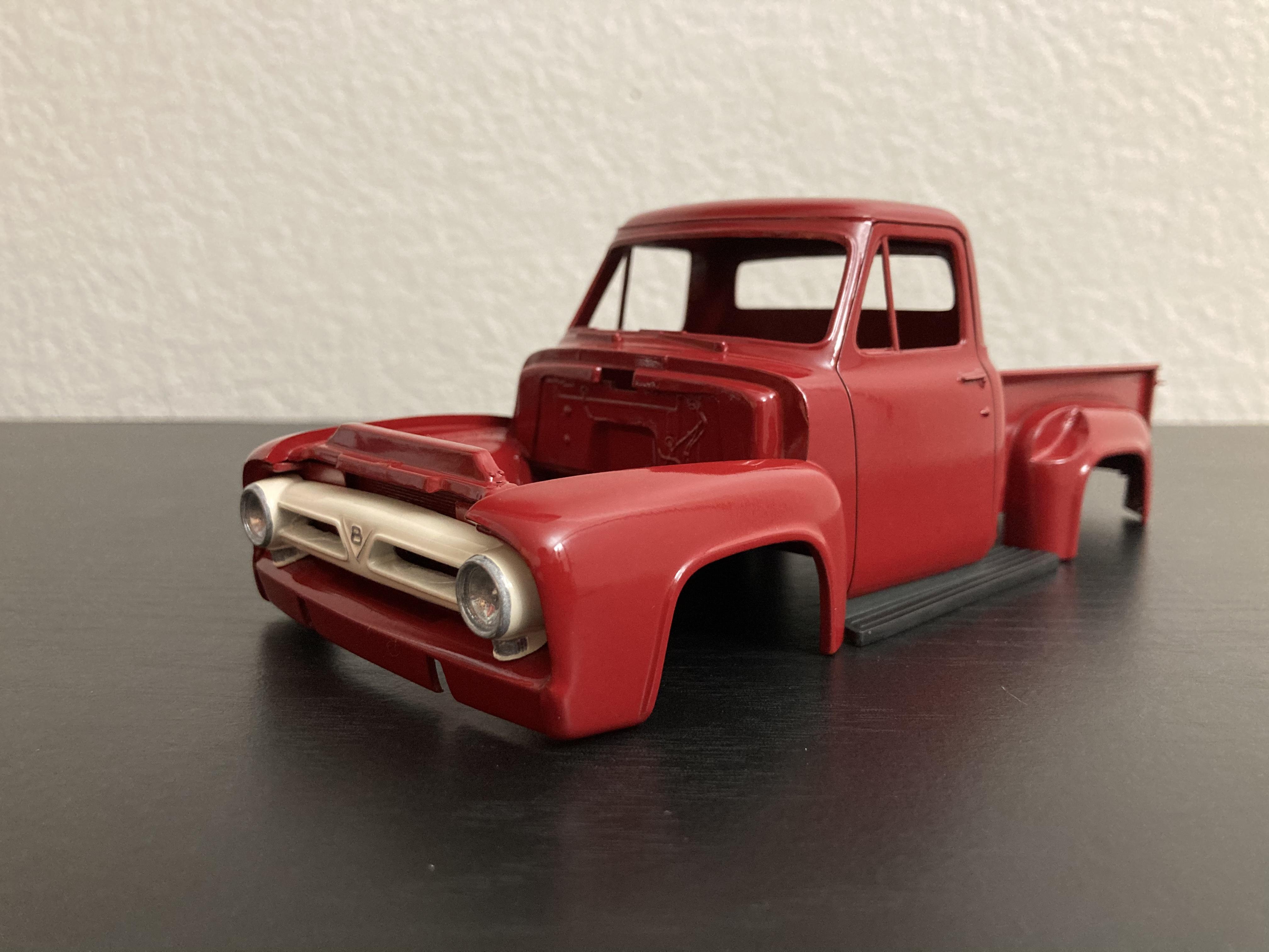

Smoke Wagon Posted January 2, 2022 Author Posted January 2, 2022 Starting to look the part now that we’ve got some paint laid down. 2
Zippi Posted January 2, 2022 Posted January 2, 2022 Riley that paint with the white Grille just looks really sharp. Looks just like the color on a 1:1.
Smoke Wagon Posted January 2, 2022 Author Posted January 2, 2022 Thanks Bob! For the grille I used Tamiya TS-7 racing white over red rustoleum primer, it gives it that warm shade of white that the 1:1s have. 1
