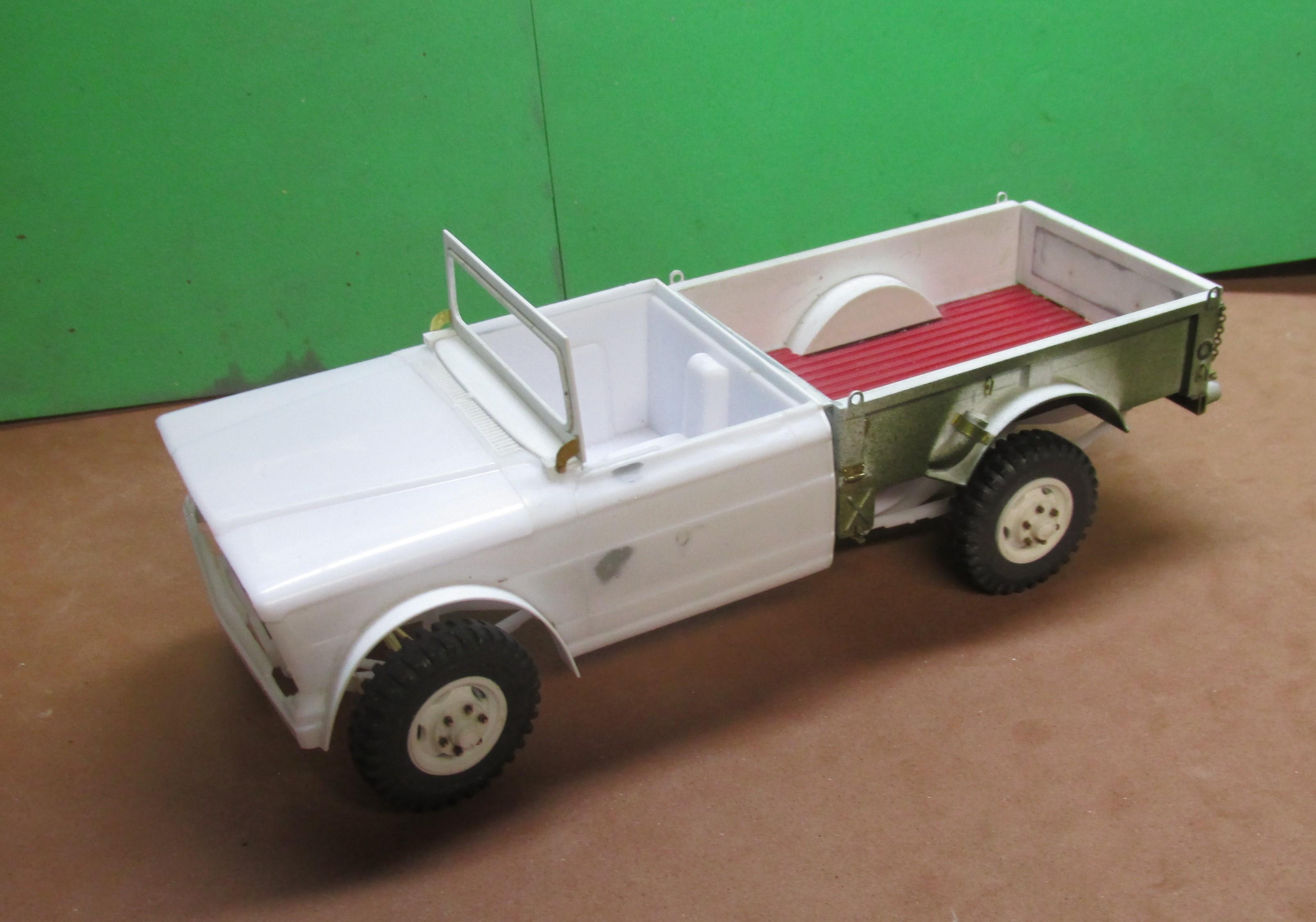

Chariots of Fire Posted January 19, 2022 Author Posted January 19, 2022 Adjustments have been made in the wheels. I used some Tamiya "German gray" for the tire color. Tires are not jet black, especially the sidewalls. The part that is in contact with the pavement is darker because it is constantly being worn away just a little but not the sidewalls. The wheels were modified to a 6 lug design rather than the original 5 lugs that were on the Power Wagon that I originally took the wheels from. The 5 lugs were cut off and the surface sanded smooth. Then I traced around a hexagon pattern that is on a circle template. A hole was drilled at each angle point and a piece of brass wire was glued in. Then #15 fusion beads were dropped over the wire and superglued. Then the wire was cut close to resemble the studs. The front wheels are done. The back ones needed to be done at the time of the photo.
hct728(Bob) Posted January 19, 2022 Posted January 19, 2022 Very nice detailing on the wheels and tires! Thanks for the How-To, looks easy once you see how

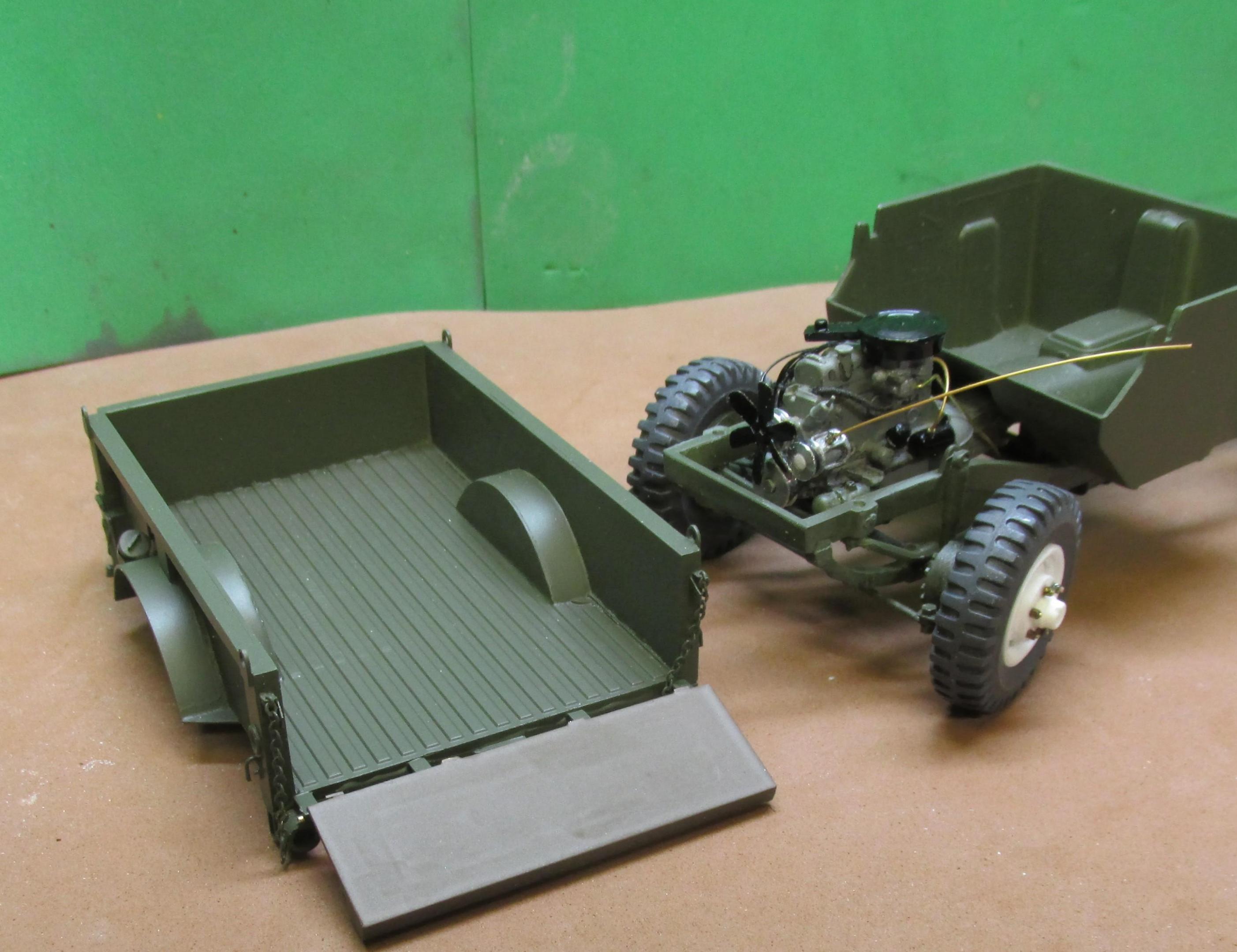

Chariots of Fire Posted January 23, 2022 Author Posted January 23, 2022 Getting ready to make up the top. The framework is done except for some cleanup of the joints. The engine is also done. Things are coming right along now. The gnomes have been busy but will take a well-deserved day off for now! That first photo is lousy, I know! Have to brush up on holding the camera steady!

hct728(Bob) Posted January 23, 2022 Posted January 23, 2022 That engine looks great in place, neat workmanship everywhere else too, very impressive!
