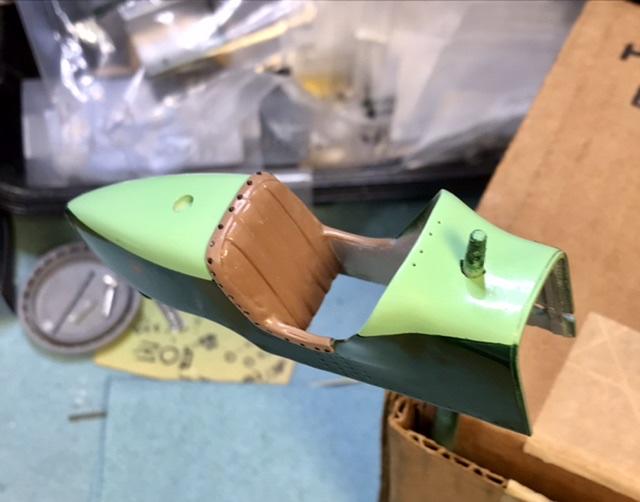

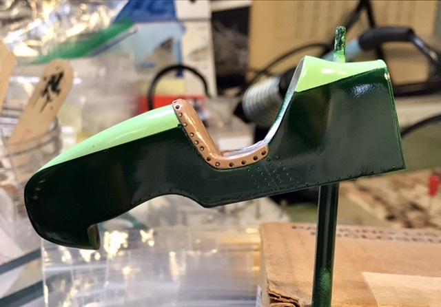

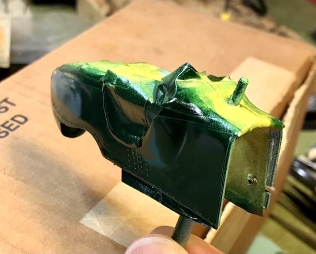

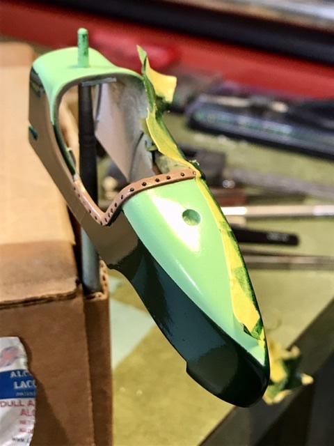

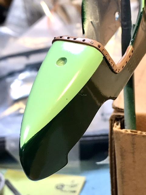

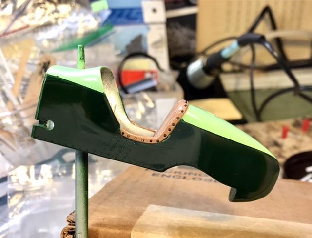

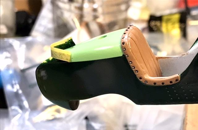

so i finally got some dark green onto the body - its the Model Master Japanese Navy Green fr some old stock - a lucky find …

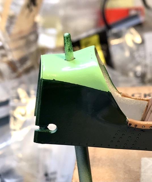

The reviews are mostly good ….  Lines reasonably sharp - some bleed over - will let everything dry Ten days and ponder some corrections - touch ups will be tricky because the light green won’t cover the dark - we’ll see …
Its not always appreciated how great the finishes and paint schemes of old Indy cars because we didnt have color film til a few years before i was born…
Nice to see color on the little Miller. Suggestion about touch ups. Fine tip brush to touch up over dark green bleed through with a bit of acrylic silver, then cover with your light green.

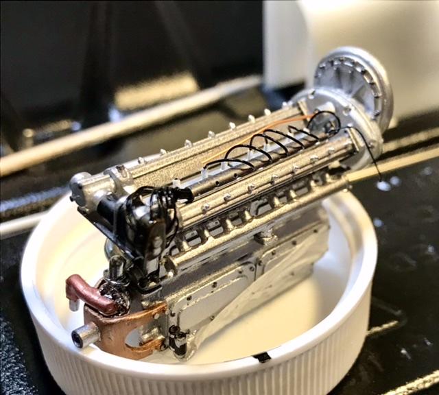

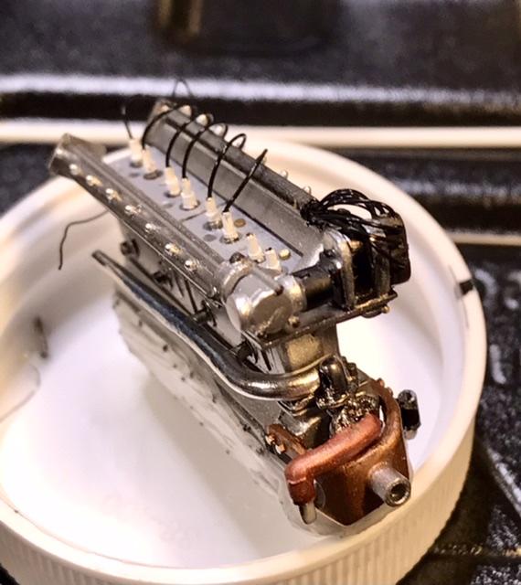

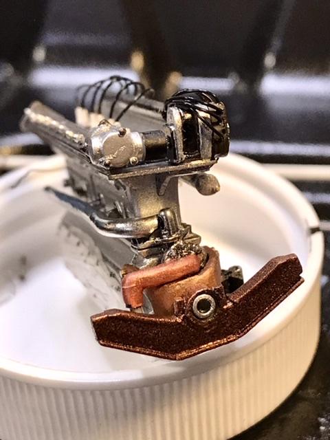

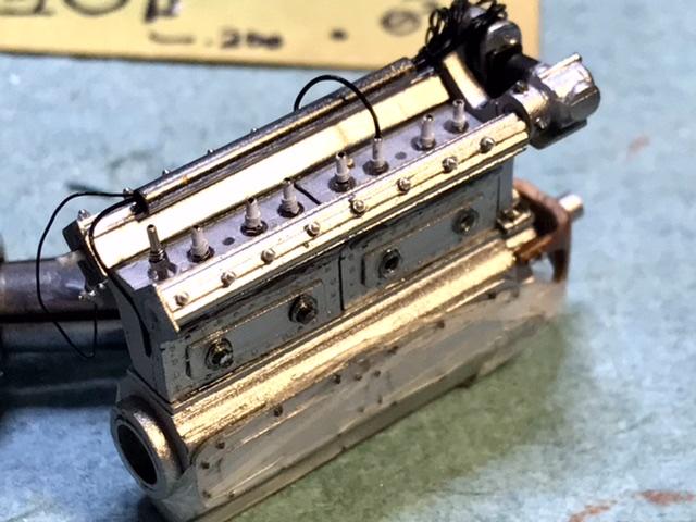

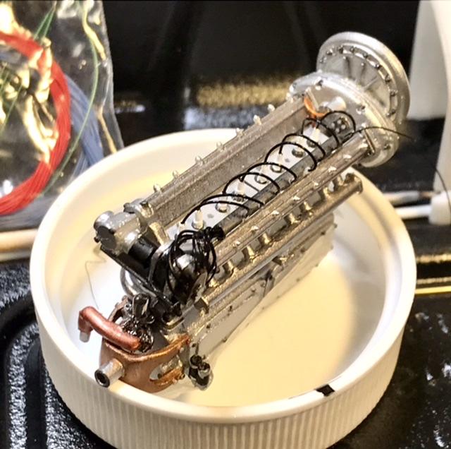

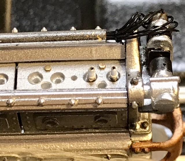

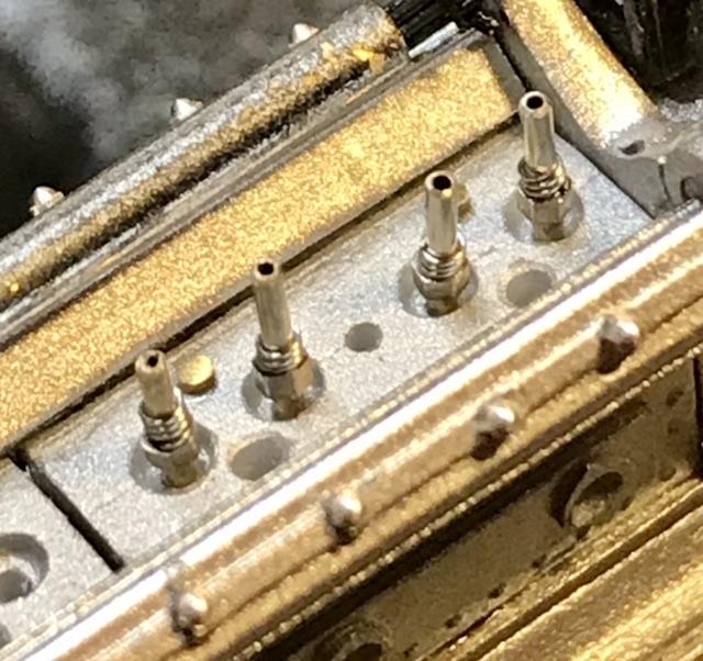

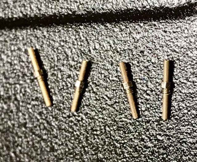

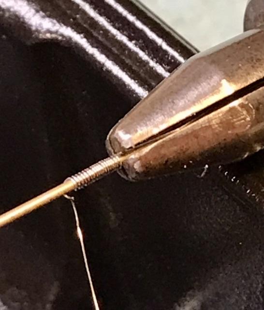

Gracias one and all -back to the engine whilst the enamel dries …. Gotta make 8 spark plugs - .06 tube + .08 nuts + a short section of steel wire wound into something that looks like insulation for the plug … optivisor all the way ….
  • Like 1
Once  the plugs are in - the plug wires are next - the size is .011 - bout 5/16 in 1 to 1 - thats about right- although they look  undersized - thats the scale playing tricks on us …

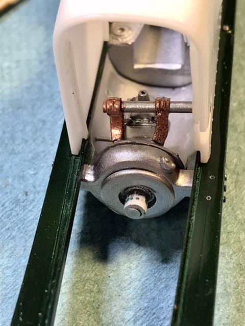

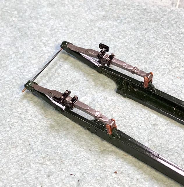

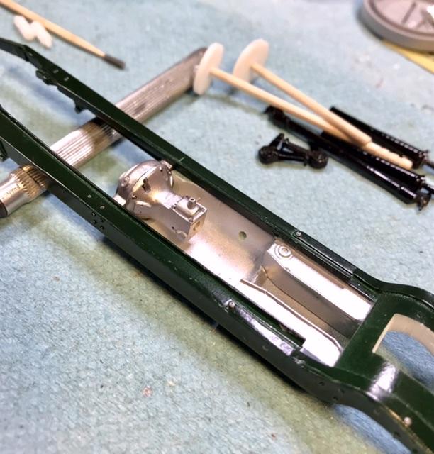

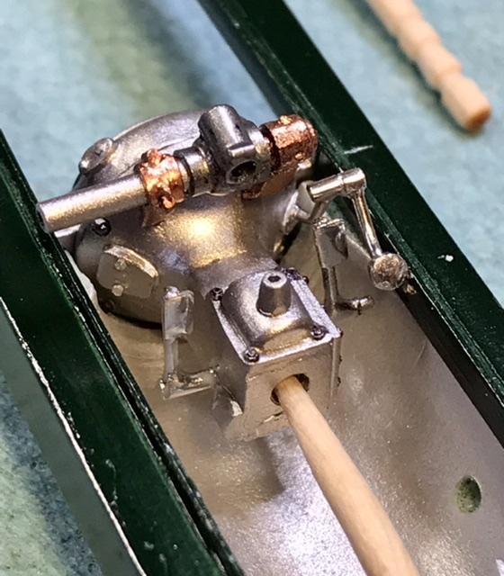

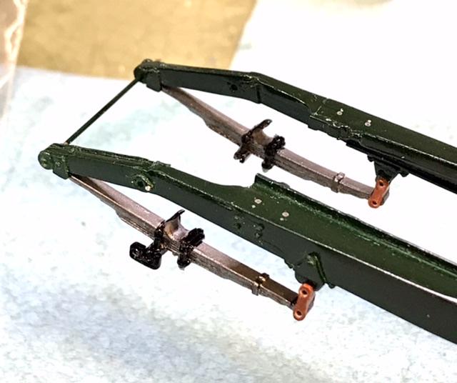

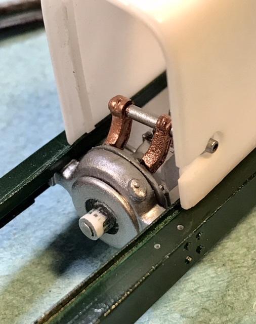

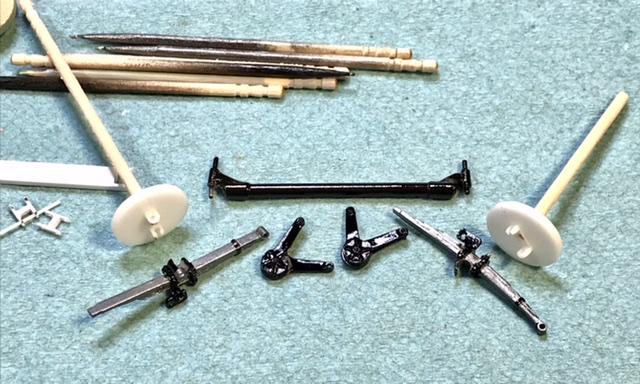

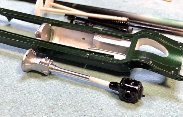

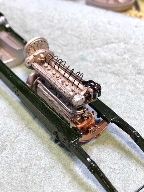

Here’s a mockup of the trans case in the frame - Miller was an early adopter of designing parts to do multiple tasks - so the casing serves as the base for the steering links and posts ….  The pedals were brushed with Molotow - might dull The finish down - the pedals on the Jr Special appear to be steel but not really polished ..
