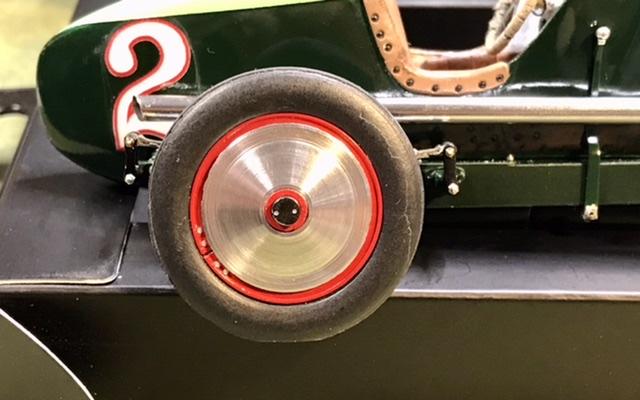

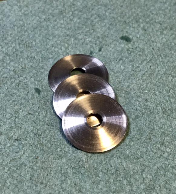

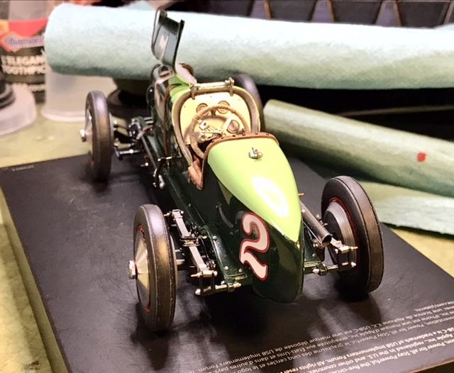

absmiami Posted April 28, 2023 Author Share Posted April 28, 2023 Gracias the third spat is finished … Quote Link to comment Share on other sites More sharing options...

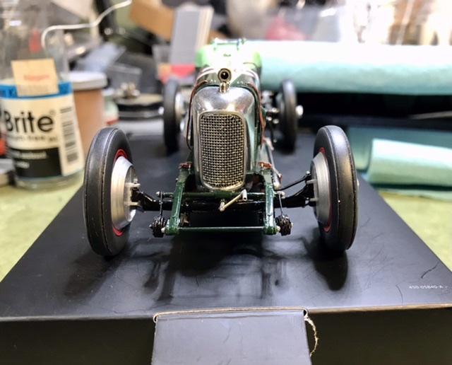

absmiami Posted April 28, 2023 Author Share Posted April 28, 2023 And reinforcements have arrived … Quote Link to comment Share on other sites More sharing options...

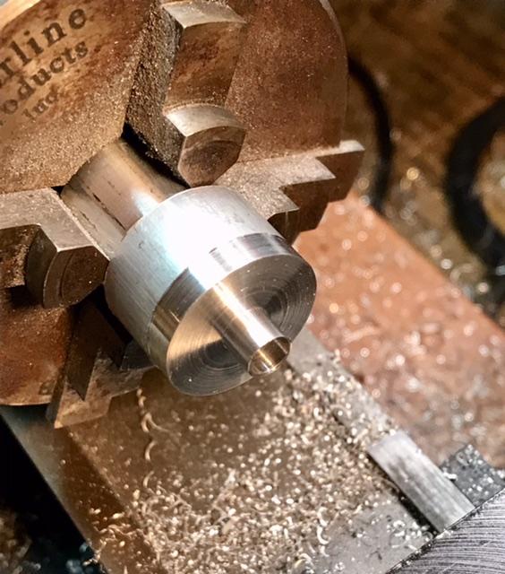

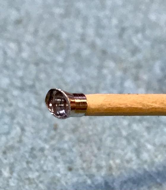

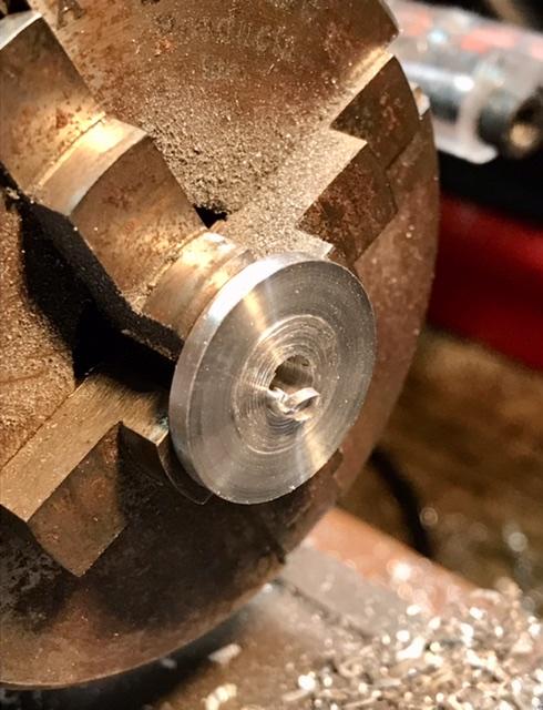

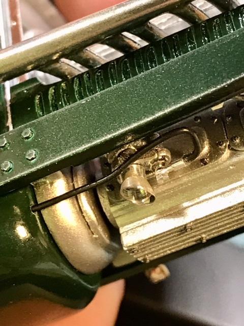

absmiami Posted April 28, 2023 Author Share Posted April 28, 2023 And another last minute detail - ive machined the intake horn for the carb - from aluminum … glued to the bottom of the carbureter - its just visible under the frame … Quote Link to comment Share on other sites More sharing options...

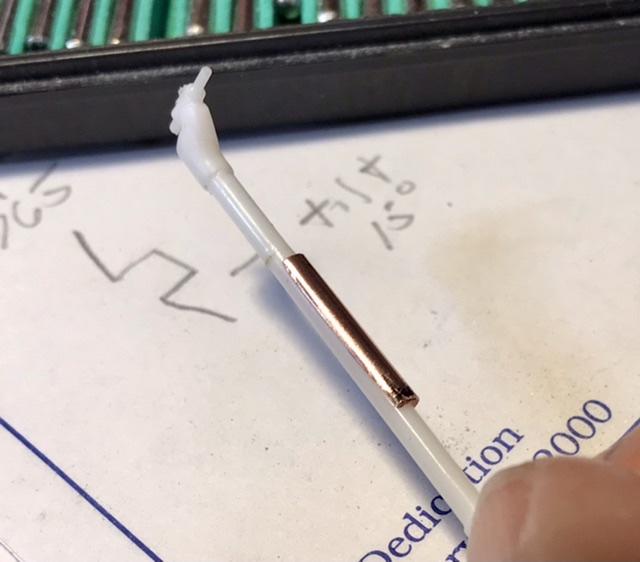

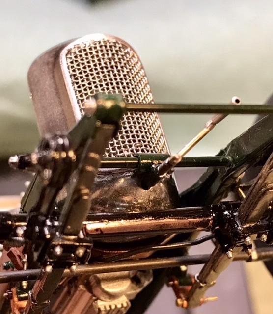

absmiami Posted April 30, 2023 Author Share Posted April 30, 2023 The resin front axle tends to bend / sag with the wheels on - see if i can correct this with a copper sleeve glued to the axle in between the springs - if Harold can do a kit - the axle will have to use an alu, or copper tube in place of the resin … Quote Link to comment Share on other sites More sharing options...

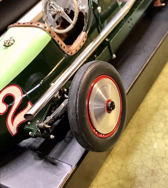

absmiami Posted April 30, 2023 Author Share Posted April 30, 2023 Spats are glued over the wheel spokes before gluing the wheel nuts … 3 Quote Link to comment Share on other sites More sharing options...

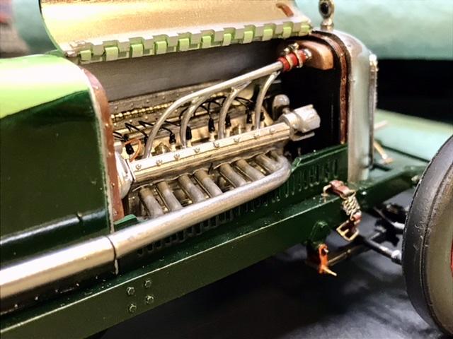

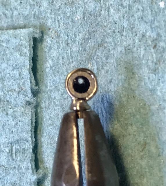

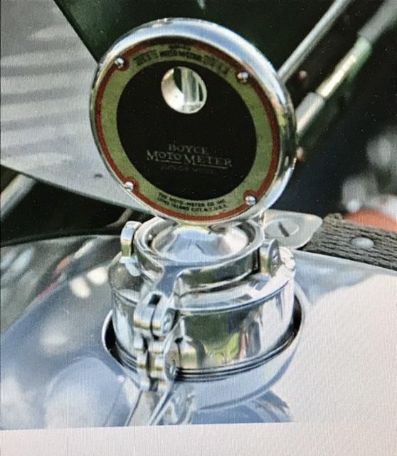

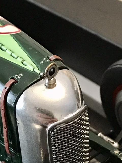

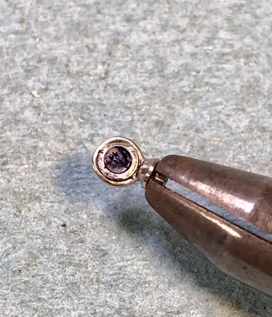

absmiami Posted May 1, 2023 Author Share Posted May 1, 2023 Wait wait wait not done until the radiator gets its filler cap …. Before gauges were reliable - most Millers were raced with meters perched on the caps to warn the drivers of impending engine over-heating - Millers used gauges made by Boyce … Quote Link to comment Share on other sites More sharing options...
