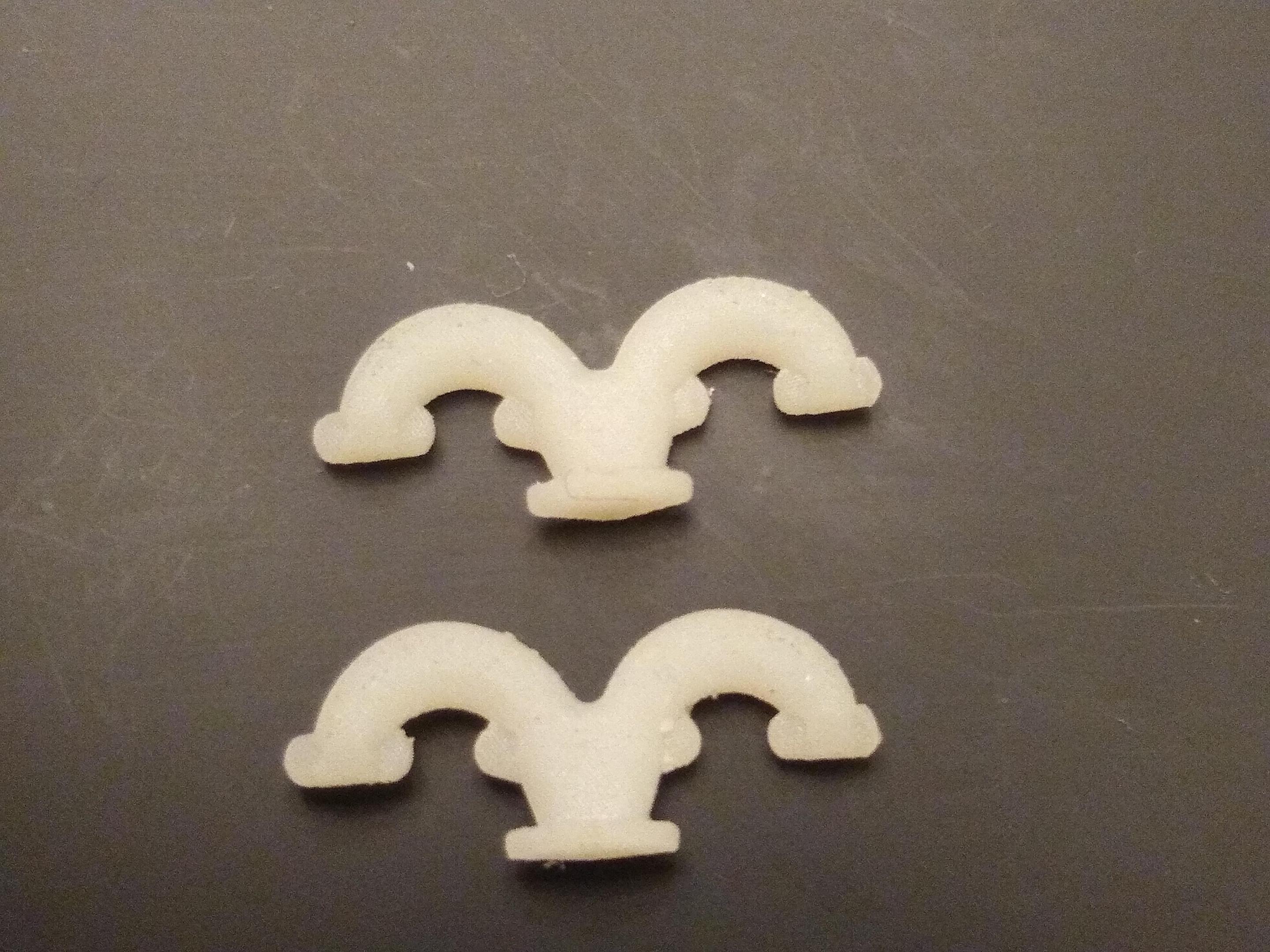

MeatMan Posted January 25, 2022 Posted January 25, 2022 (edited) I got a little work done on them last night and this morning. The result is decent but I think the variations are acceptable when printed to scale. I'm printing some parts for my Club DeMer today so I'll throw these on to see how close they are to fitting the 57 Ford engine. Comments welcome from anyone who sees something that could be done better. As I said, I'm a relative newb. Edited January 25, 2022 by MeatMan
Sledsel Posted January 25, 2022 Author Posted January 25, 2022 25 minutes ago, MeatMan said: I got a little work done on them last night and this morning. The result is decent but I think the variations are acceptable when printed to scale. I'm printing some parts for my Club DeMer today so I'll throw these on to see how close they are to fitting the 57 Ford engine. Comments welcome from anyone who sees something that could be done better. As I said, I'm a relative newb. Looks great!!!! If these are successful, I'd like to purchase some. I have a stalled kit awaiting these. I was gonna look for some SBC manifolds to modify but I am going to hang tight
Mark Posted January 25, 2022 Posted January 25, 2022 Only things I can think of are... -the small bumps on the end cylinders, also the casting marks at the top of each horn. May as well get those if possible, it seems most of the guys who run these manifolds don't smooth them off. -check the angle on the outlet...do these dump straight down, or do they tuck in towards the engine block, like block hugger headers?

Sledsel Posted January 25, 2022 Author Posted January 25, 2022 (edited) On 1/25/2022 at 11:32 AM, Mark said: Only things I can think of are... -the small bumps on the end cylinders, also the casting marks at the top of each horn. May as well get those if possible, it seems most of the guys who run these manifolds don't smooth them off. -check the angle on the outlet...do these dump straight down, or do they tuck in towards the engine block, like block hugger headers? They do dump slightly towards the block. As for the casting bumps No biggie if they are not there..... to me at least Edited January 26, 2022 by Sledsel
MeatMan Posted January 25, 2022 Posted January 25, 2022 Okay, did the first print and they came out good print-wise but I made the mistake of using the kit manifolds for size and didn't account for the bolt holes, which aren't on the kit parts, aaargh?. Its pretty much a do-over at this point because I'll have to resize it in the drawing because I believe resizing the finished file will reduce the print in unintended ways. And yes Andy, they do appear to be curved inward on both pics but I couldn't make that out on the head-on pic. That calls for a different approach than what I used, its called a "sweep" and I used it once before to make a drop axle. I'll give it a go here since I have to start over anyway. As for the casting marks, its no big to add them but they probably won't print well on my low end machine. Thanks for the input.
Sledsel Posted January 25, 2022 Author Posted January 25, 2022 32 minutes ago, MeatMan said: Okay, did the first print and they came out good print-wise but I made the mistake of using the kit manifolds for size and didn't account for the bolt holes, which aren't on the kit parts, aaargh?. Its pretty much a do-over at this point because I'll have to resize it in the drawing because I believe resizing the finished file will reduce the print in unintended ways. And yes Andy, they do appear to be curved inward on both pics but I couldn't make that out on the head-on pic. That calls for a different approach than what I used, its called a "sweep" and I used it once before to make a drop axle. I'll give it a go here since I have to start over anyway. As for the casting marks, its no big to add them but they probably won't print well on my low end machine. Thanks for the input. They look pretty good in my opinion. Maybe shrink the flange size a bit and try to leave the port spacing pretty close to what you have. That set may work on the 56 Thunderbird from Monogram because it is 1/24. I will dig up my 1/24 engine and measure the head length. Nice job for sure.
MeatMan Posted January 26, 2022 Posted January 26, 2022 18 hours ago, Sledsel said: They look pretty good in my opinion. Maybe shrink the flange size a bit and try to leave the port spacing pretty close to what you have. That set may work on the 56 Thunderbird from Monogram because it is 1/24. I will dig up my 1/24 engine and measure the head length. Nice job for sure. Yes, I'd like to have that measurement before I do anything further.
Sledsel Posted January 26, 2022 Author Posted January 26, 2022 16 minutes ago, MeatMan said: Yes, I'd like to have that measurement before I do anything further. The cylinder head length on the 1/24 Thunderbird engine is 13/16" Center to center on the outer exhaust ports is 11/16"

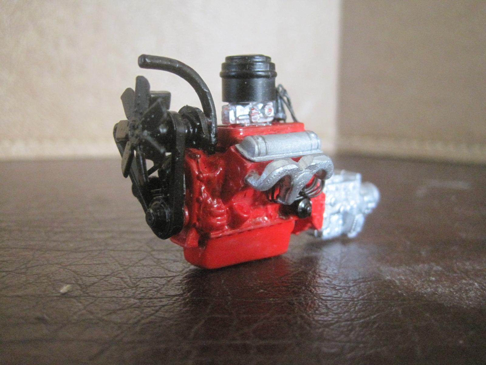

leafsprings Posted January 26, 2022 Posted January 26, 2022 Manifolds look great! Sure wish I had a set when doing the 332 HD for a " 56 T 800 build. I modified some Dodge manifolds. The 302 and 332 truck engines (shown )were introduced in '56 and used up to '63. These engines had gear drive cam and crank, features never used in Lincoln car engines.
Sledsel Posted January 26, 2022 Author Posted January 26, 2022 24 minutes ago, leafsprings said: Manifolds look great! Sure wish I had a set when doing the 332 HD for a " 56 T 800 build. I modified some Dodge manifolds. The 302 and 332 truck engines (shown )were introduced in '56 and used up to '63. These engines had gear drive cam and crank, features never used in Lincoln car engines. Great job on those!!! 1

MeatMan Posted January 27, 2022 Posted January 27, 2022 7 hours ago, Sledsel said: The cylinder head length on the 1/24 Thunderbird engine is 13/16" Center to center on the outer exhaust ports is 11/16" In that case the ones I printed should fit! I'm attaching a better pic and if you are good with how they look, PM me your address and I'll send them out.
Sledsel Posted January 27, 2022 Author Posted January 27, 2022 12 hours ago, MeatMan said: In that case the ones I printed should fit! I'm attaching a better pic and if you are good with how they look, PM me your address and I'll send them out. They look really good!
