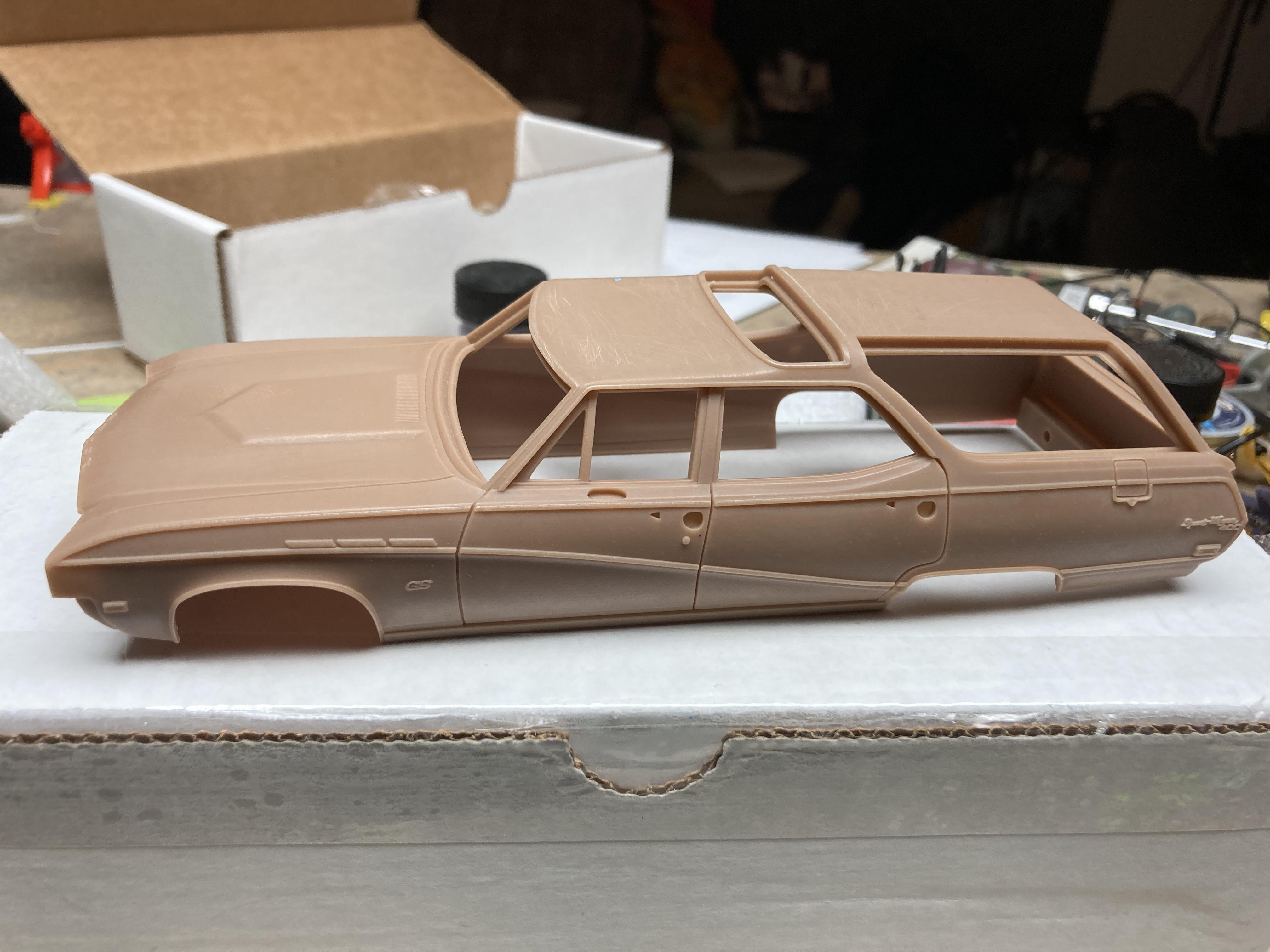

yellowsportwagon Posted February 19, 2022 Posted February 19, 2022 Here is the Sportwagon from Robert Burns 7
Bills72sj Posted February 19, 2022 Posted February 19, 2022 I grew up in the 60's as a car nut. I do not recall ever seeing a Buick wagon with a sunroof. Just Olds Vista Cruisers.
Rodent Posted February 19, 2022 Posted February 19, 2022 This body has taken some poetic license as a GS wagon, but there were Buick Sportwagons with the Vista Cruiser long wheelbase bodies. Neighbor across the street had a 68 sans woodgrain. All the bells and whistles, hubby's family owned a Buick dealership in SoCal.
yellowsportwagon Posted February 19, 2022 Author Posted February 19, 2022 7 hours ago, Rodent said: This body has taken some poetic license as a GS wagon, but there were Buick Sportwagons with the Vista Cruiser long wheelbase bodies. Neighbor across the street had a 68 sans woodgrain. All the bells and whistles, hubby's family owned a Buick dealership in SoCal. I know the car they scanned for this. It’s obviously not factory but there is a real one like it

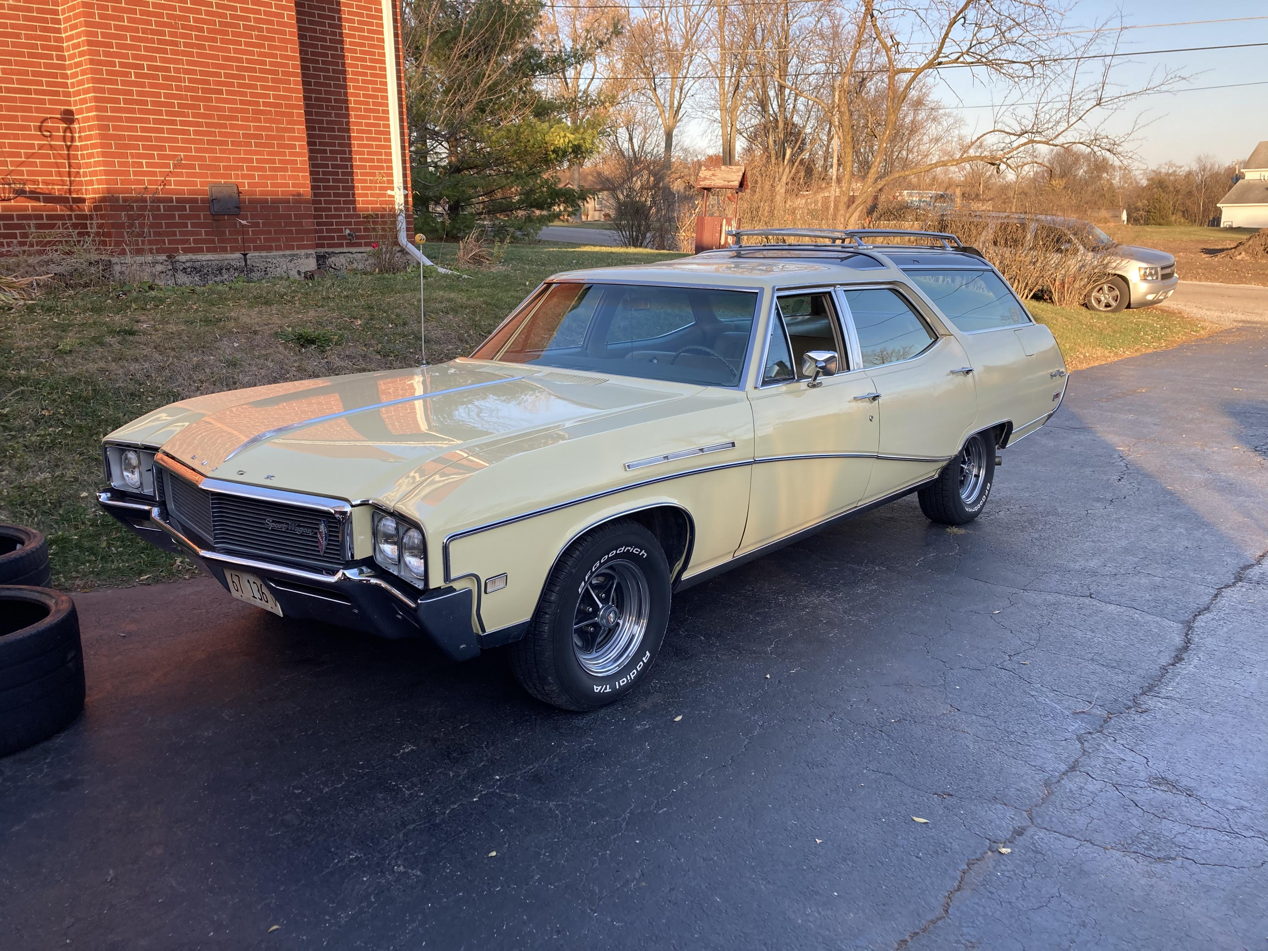

yellowsportwagon Posted February 19, 2022 Author Posted February 19, 2022 8 hours ago, Bills72sj said: I grew up in the 60's as a car nut. I do not recall ever seeing a Buick wagon with a sunroof. Just Olds Vista Cruisers. Here you go this is my 68 factory big block car. This model will become this car.Lots of changes too be made 4
Motor City Posted February 19, 2022 Posted February 19, 2022 13 hours ago, Bills72sj said: I grew up in the 60's as a car nut. I do not recall ever seeing a Buick wagon with a sunroof. Just Olds Vista Cruisers. The Sport Wagon (1964) and Sportwagon (1965-1969) had a fixed-glass roof instead of a sunroof. The resin model was made to add tinted "glass" plastic inserts. The 1964-1972 Vista Cruiser also used fixed glass. The later Vista Cruiser (1973-1977) had an optional flip-up glass roof panel.

yellowsportwagon Posted February 19, 2022 Author Posted February 19, 2022 3 hours ago, Motor City said: The Sport Wagon (1964) and Sportwagon (1965-1969) had a fixed-glass roof instead of a sunroof. The resin model was made to add tinted "glass" plastic inserts. The 1964-1972 Vista Cruiser also used fixed glass. The later Vista Cruiser (1973-1977) had an optional flip-up glass roof panel. I think he was referring to the sky glass in the Sportwagon. Not a sunroof per se

stavanzer Posted February 22, 2022 Posted February 22, 2022 What is the Donor Kit for this body? If I wanted just a curbside, does the interior come with it?
yellowsportwagon Posted February 22, 2022 Author Posted February 22, 2022 2 hours ago, alexis said: What is the Donor Kit for this body? If I wanted just a curbside, does the interior come with it? You gotta make the interior unfortunately. I have a 65 Pontiac Grand Prix chassis under it with a few mods to make it fit
sfhess Posted February 22, 2022 Posted February 22, 2022 3 hours ago, alexis said: What is the Donor Kit for this body? If I wanted just a curbside, does the interior come with it? Maybe Revell 72 Cutlass?
Rob Hall Posted February 22, 2022 Posted February 22, 2022 (edited) 3 hours ago, sfhess said: Maybe Revell 72 Cutlass? The AMT '68 El Camino or AMT '70 Monte Carlo might be good, as they have longer wheelbases and a separate frame. Anything would need the frame stretched a bit since the Vista Cruiser/Sport Wagon had a 121" wheelbase, while the '68-72 A-body coupes were 112"...and the '68-72 El Camino and '70-72 Monte Carlo were 116". Edited February 22, 2022 by Rob Hall
yellowsportwagon Posted February 22, 2022 Author Posted February 22, 2022 2 hours ago, Rob Hall said: The AMT '68 El Camino or AMT '70 Monte Carlo might be good, as they have longer wheelbases and a separate frame. Anything would need the frame stretched a bit since the Vista Cruiser/Sport Wagon had a 120" wheelbase, while the '68-72 A-body coupes were 112"...and the '68-72 El Camino and '70-72 Monte Carlo were 116". 121 wheelbase I own one
Rob Hall Posted February 22, 2022 Posted February 22, 2022 36 minutes ago, yellowsportwagon said: 121 wheelbase I own one Yeah, I read 120 for the '64-67... '68 got a 1 inch bump.... 0.04 inch in 1/25th..
bisc63 Posted February 23, 2022 Posted February 23, 2022 Readily available Impala kits from 1965, 66, and 67 have 119-inch wheelbase, might need to narrow floorpan just a little, but otherwise should fit easily.
