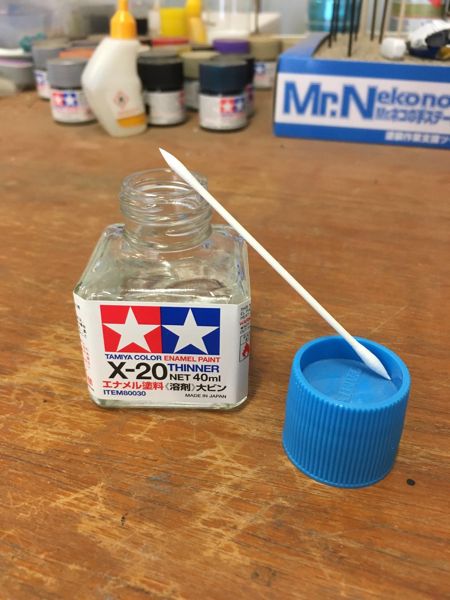

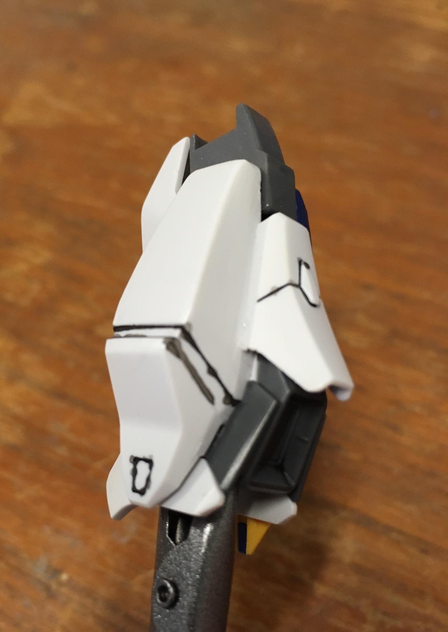

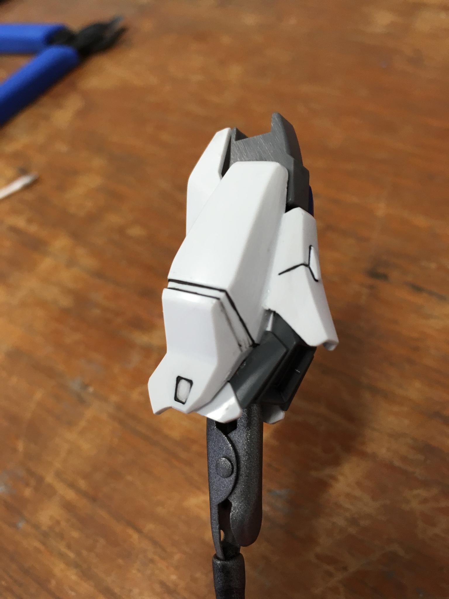

Sandboarder Posted March 17, 2022 Posted March 17, 2022 (edited) I have used it a lot. It works best over Lacquer or Acrylic paints and gloss finishes. Any clean up when using Enamel on Enamel will result in damaged paint. Especially seeing as that’s what is in the panel line bottle is basically thinned enamel paint, imagine 1:5 paint:thinner and putting that on your fresh Enamel paint job. For panel lining Enamel base paints use thinned down oil paint. Mr Hobby do the Mr Weathering range or just mix your own with craft store oil paint and odourless thinner. As oils take longer to dry you can clean up with a Q tip before they are dry. No extra thinner required. Edited March 18, 2022 by Sandboarder 1

Sandboarder Posted March 17, 2022 Posted March 17, 2022 On 3/17/2022 at 9:19 PM, Dpate said: So its safe on everything except anything enamel & chrome like alclad etc? Expand It would depend on what thinners are used. The Gunpla guys like to use cigarette light fuel. You could always seal your enamel paint with acrylic before using the panel line accent. I normally used Tayima rattle cans, so lacquer paint and have experimented with flat and gloss finishes. The capillary action you want to help it flow along the panel lines needs a smooth, gloss finish.
