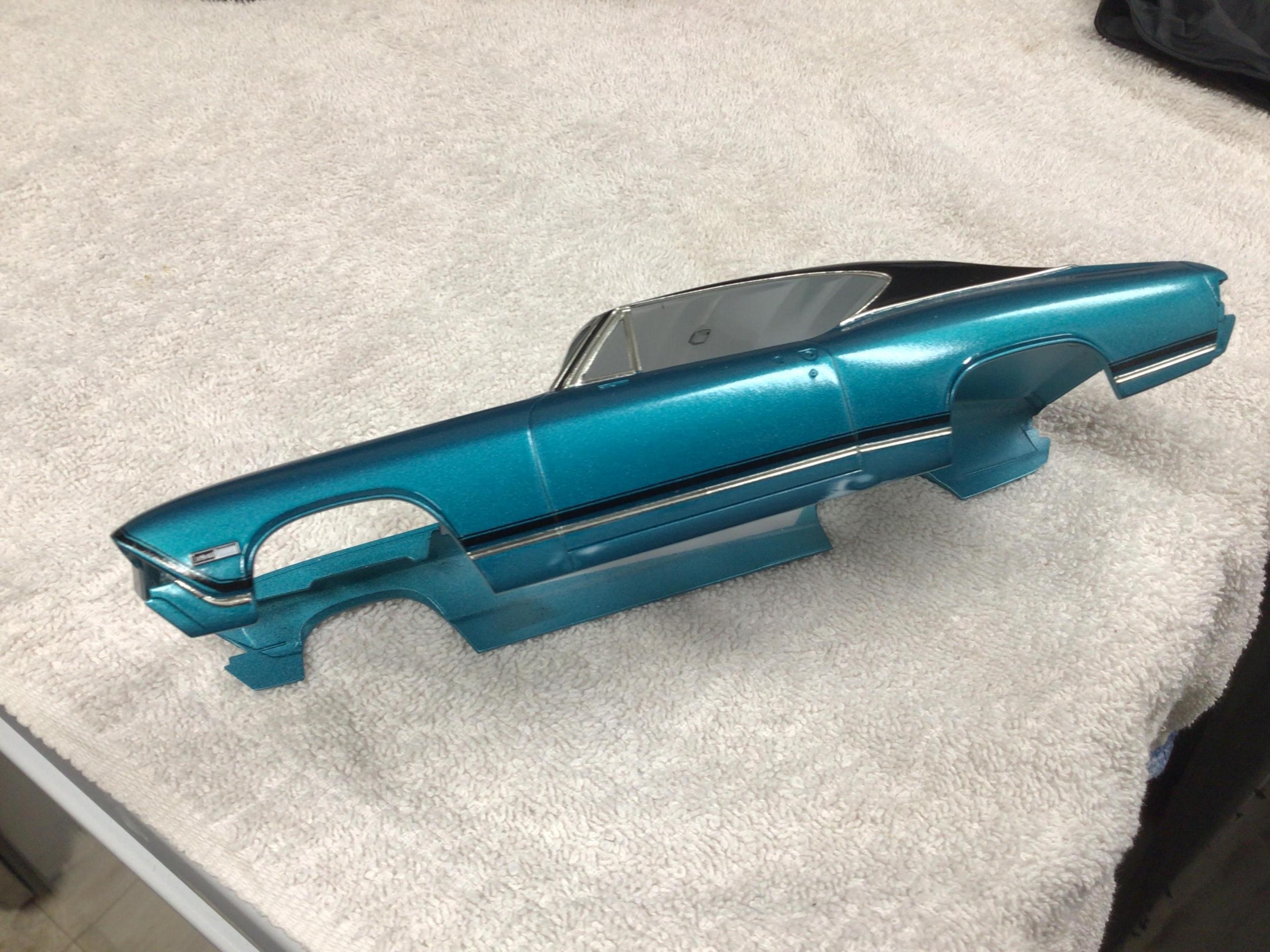

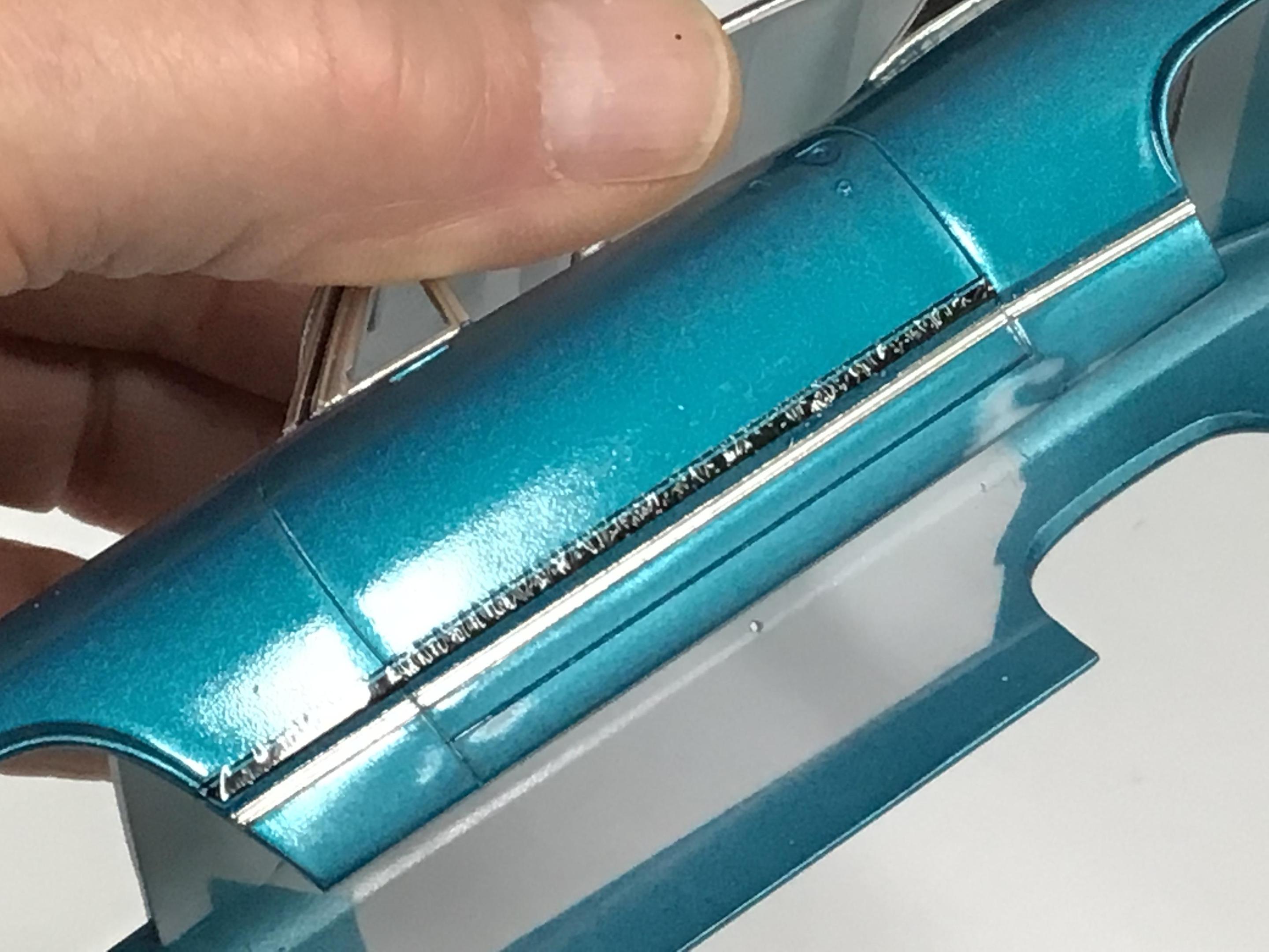

NOBLNG Posted April 11, 2022 Posted April 11, 2022 I too had trouble with the Revell ‘68 Chevelle decals. I may have had the water too warm?….but some of them floated right up off the paper and became horribly twisted. I managed to cut some replacements out of some un-needed decals in the kit. Others were wrinkled like crazy but smoothed themselves out once dried. I did cut some into smaller more manageable sections. It would be nice if they supplied a couple extras of the really delicate ones. It wouldn’t kill their profits.?

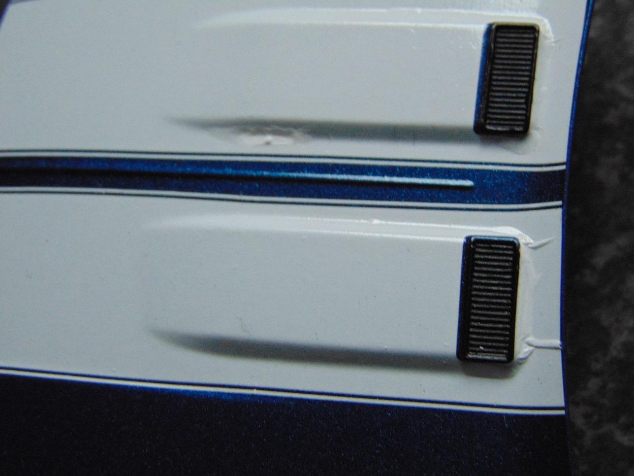

doorsovdoon Posted April 11, 2022 Author Posted April 11, 2022 This is the Revell '68 Chevelle I'm working on. Even using decal solvent the decals crack and fall apart. In this pic, you can see the decals cracking just from the curvature of the trunk near the rear light panel. The mess you see near the rear window trim is where I popped a bubble with a pin, tried to flatten it down with a cotton bud and just crumbled. I had to touch it up with some paint. Same thing with the hood after I popped a bubble. Also, decal solvent did nothing to get rid of the wrinkles around the hood vent. Note one of the hood decals are closer to the hood trim than the other. After I lay them down that's where they stay, otherwise they will tare if I try lifting or sliding them.

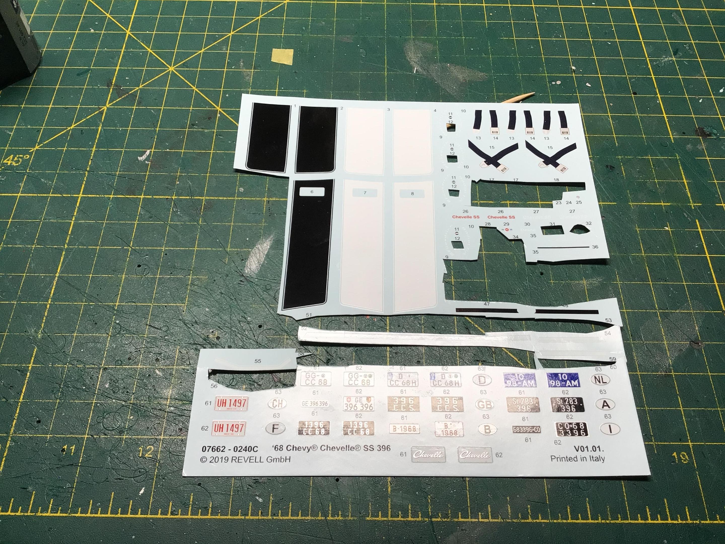

NOBLNG Posted April 12, 2022 Posted April 12, 2022 (edited) Mine are the ones from Italy. I’ll admit I don’t have a lot of experience with decals, so that may be a contributing factor. I am lucky that I didn’t try any further to smooth out the wrinkles or I may well have destroyed another one. The nose one curled up and became useless. That said, as they dried, the wrinkles shrank away and they look great…in my case anyways. No troubles with them lifting after they were dry, but I did clear coat them shortly after application. Edited April 12, 2022 by NOBLNG

peteski Posted April 13, 2022 Posted April 13, 2022 Does the decal sheet have any written identification (like Made in Italy)?
NOBLNG Posted April 13, 2022 Posted April 13, 2022 (edited) On 4/13/2022 at 9:01 PM, peteski said: Does the decal sheet have any written identification (like Made in Italy)? Expand It would very likely be the same as the one I posted above. My kit was also Revell of Germany in the flat box. Edited April 13, 2022 by NOBLNG
peteski Posted April 14, 2022 Posted April 14, 2022 On 4/13/2022 at 11:40 PM, NOBLNG said: It would very likely be the same as the one I posted above. My kit was also Revell of Germany in the flat box. Expand Ok, then those are printed in Italy (by Cartograf). Those are best quality decals in the world, and the are super thin (read: very fragile). Nothing like the old Revell decals which were almost as thick as peel-n-stick stickers. Cartograf decals also respond to setting solutions well. Because they are so thin and fragile, they have to be applied very, very carefully. But when they dry, they look like they are painted on.
doorsovdoon Posted April 14, 2022 Author Posted April 14, 2022 Yes, printed in Italy. Maybe they're too good?! Lol. They lay down ok, and yes, they do look like they are painted on, but you can't touch them because of how thin they are. Like I say in the title of this thread, there seems to be no margin for error with these decals. It's like "Get good at it, or go home" Lol
