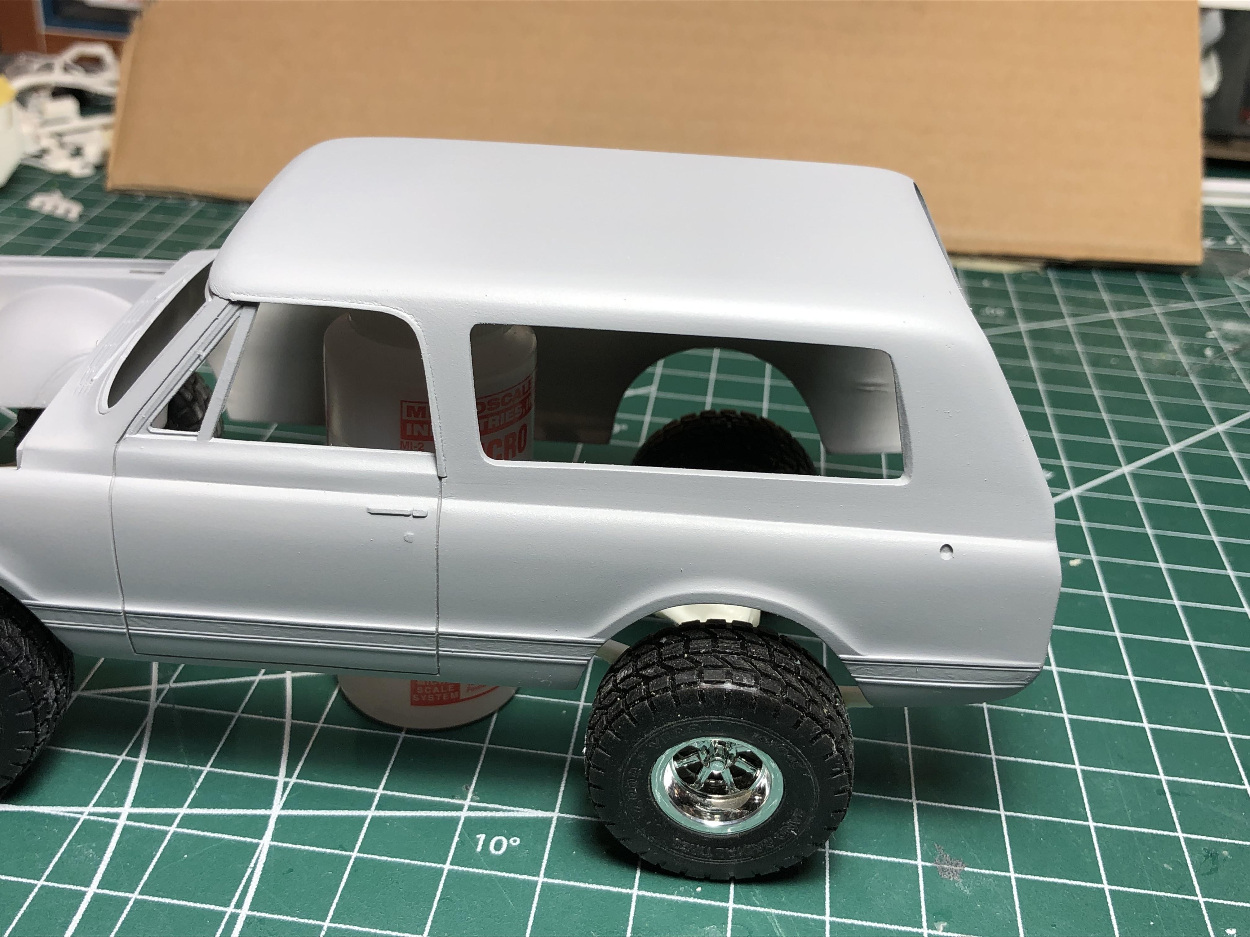

Here’s a mock up of where I’m heading with this one… (pardon all the tape)

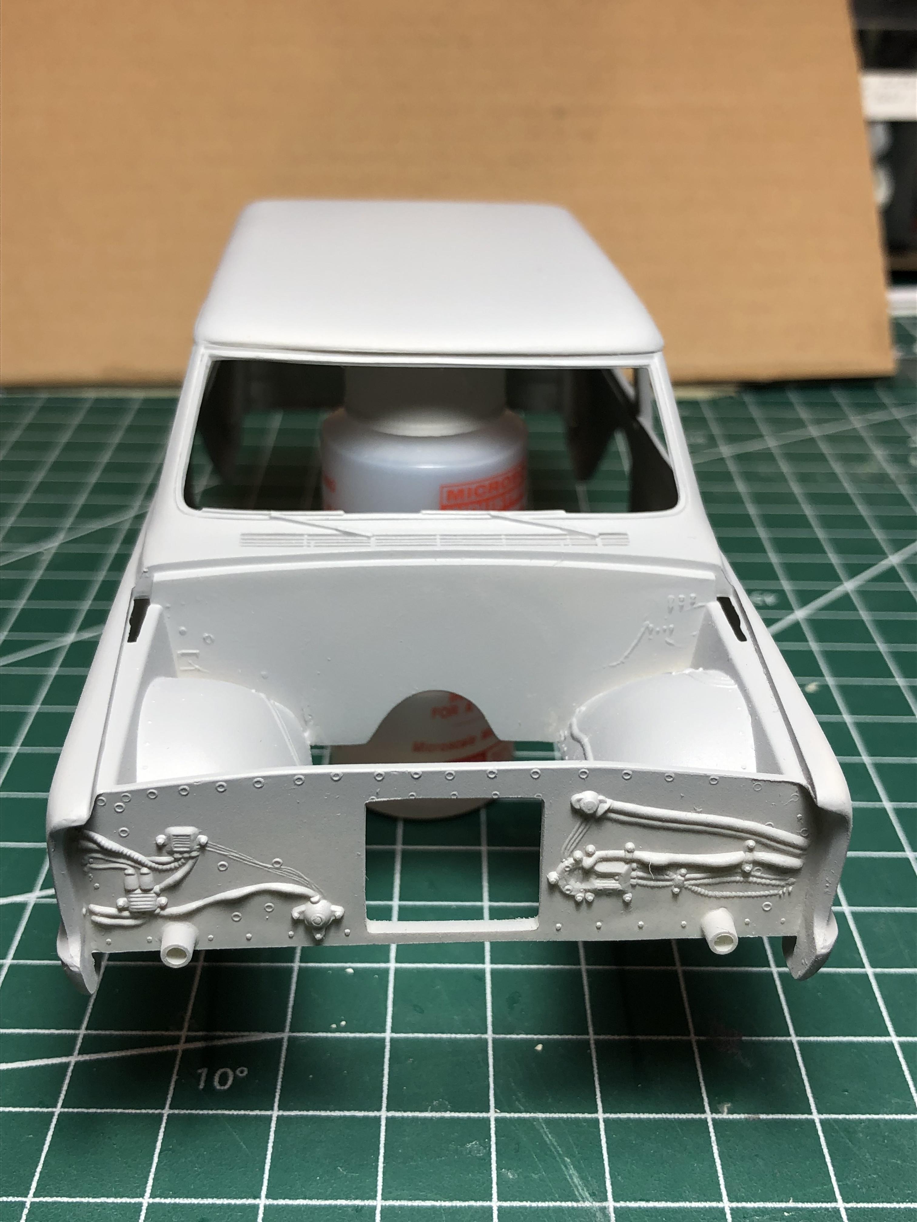

As mentioned in Mark’s thread, the tops on these kits are warped. I have a total of 5 of these, 3 already built, this one, and the recently released Jimmy. All had warped tops. For this build, I definitely want the top on, so it will get glued in place. The body will be Hugger orange, a colour that I think looks amazing on 1:1 versions of this truck. I’m tossing around two options for the top: blend it into the body, smooth it out and paint it body colour, or…. paint it flat white and leave the “fibreglass” texture on it. Final decision will come to me as things progress.
I’m open to opinions on that of course.
The wheels are parts box items that I believe were from a dually Chevy 4X4. I’m 95% decided on the wheels, but I do have another set I like. The tires are from Modelhaus. I bought them a few years back before they retired, I know they are doing tires again so they might be available again. Along with the Deserter parts, there will be some parts box items. I dug up this bush bar, which I believe is from the “Bandit” version of this kit from wayyyyyyy back. I’ll strip the paint and see if it cleans up ok.  That version had an awesome full roll cage too.

I'm also struggling with the roof issue and trying to decide if I should get it mounted and painted in the same body paint color or still try to keep it that fiberglass white which would be my first choice.

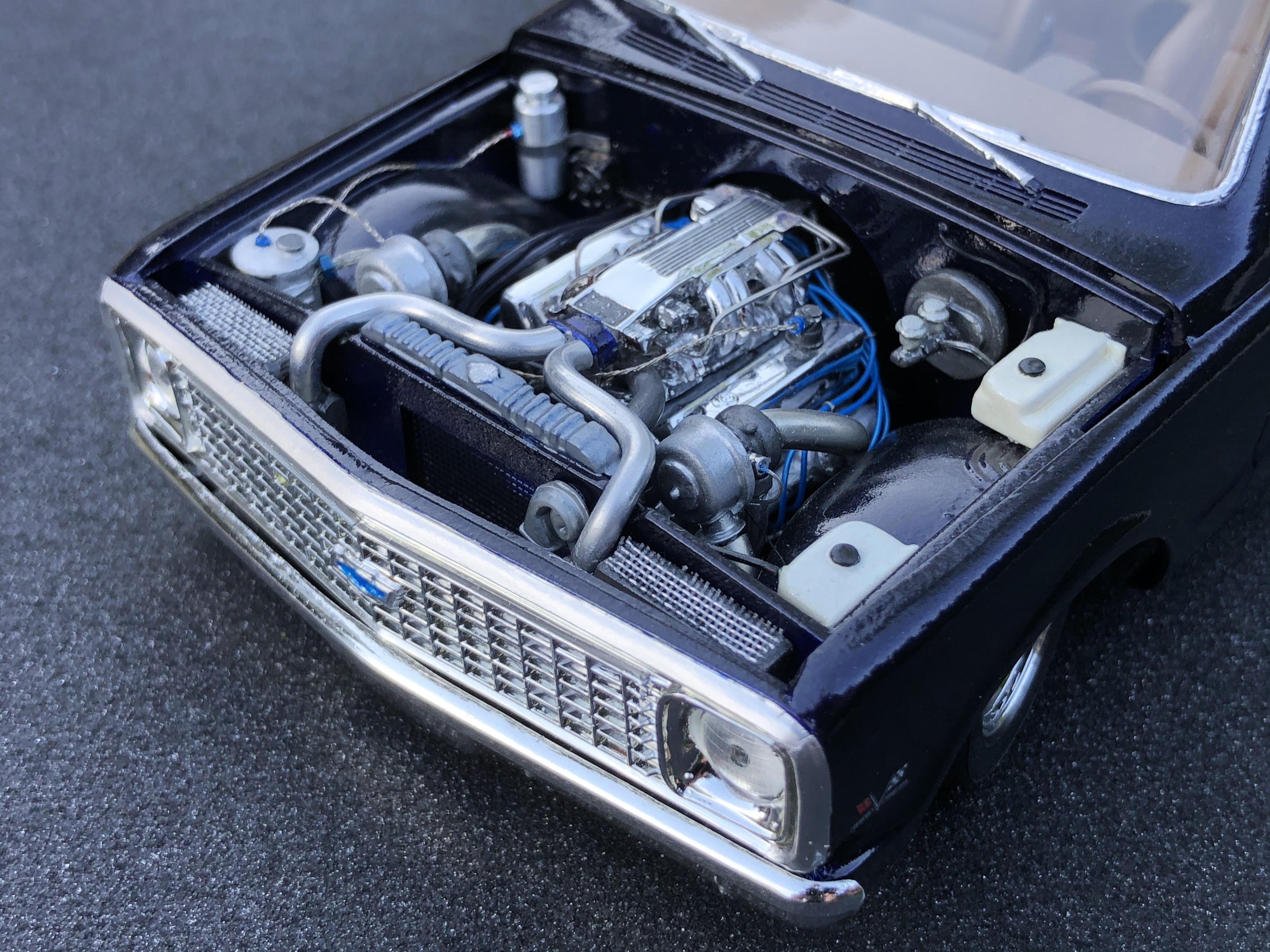

Hi Mark, this one will be so different than the PS version I did. I recall finishing the build and still having pretty much the whole kit minus the body and floor pan.
As for the roof, I’m still about 50/50. I think it would look cool and more custom if painted body colour and molded in, however the fibreglass white would give a nice two tone look. Hmmmmmm….. the good news is, in my mind, both options will look cool. I just want a top on this one!!

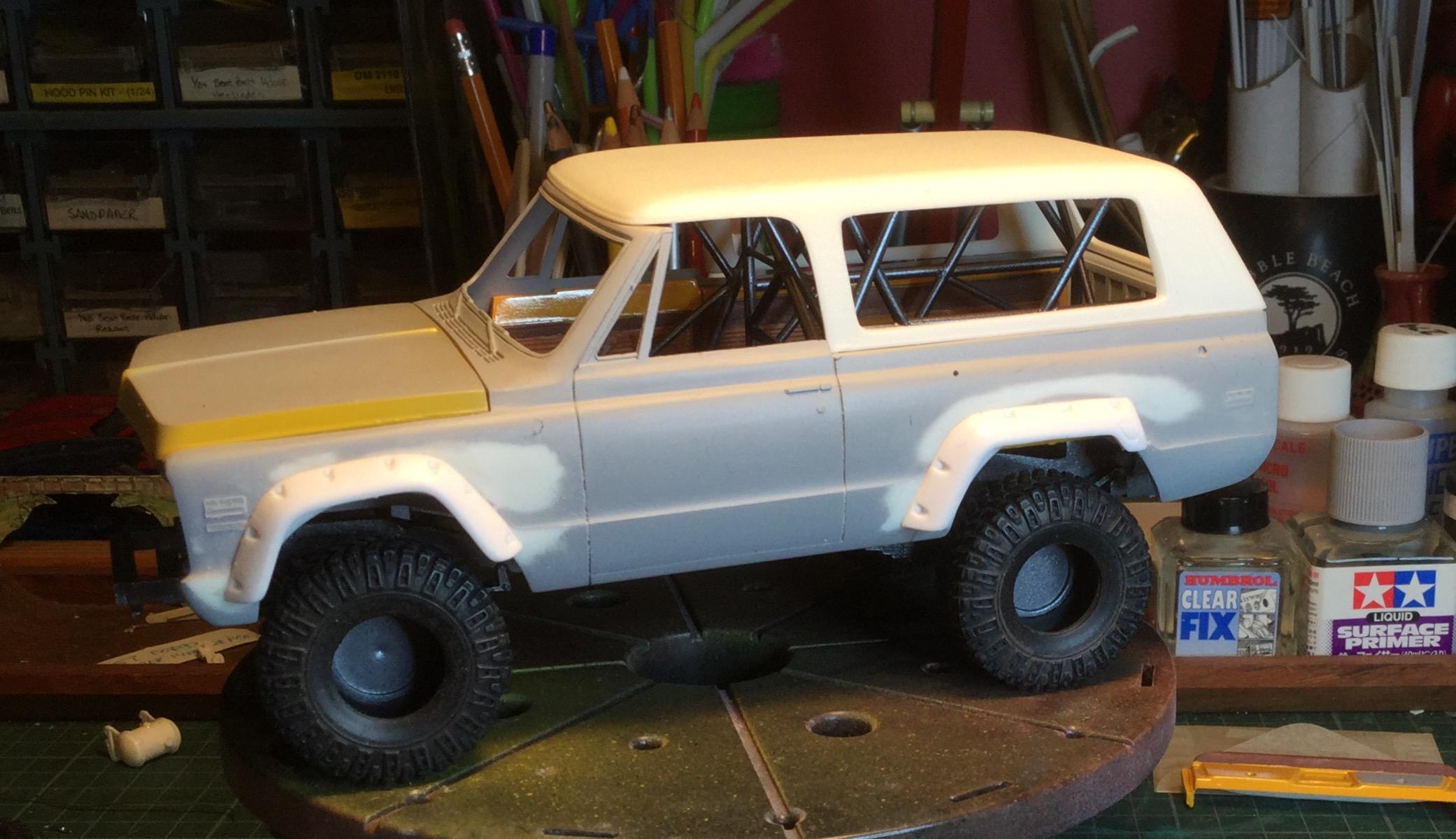

Hi Steve, I’m quite interested in your new build, a bit of a change from the usual low ones to mile high! I built one a few years ago for the Aussieball run of the CannonBall that involved a lot of scratchbuilding. The main change was to convert to right hand drive and building a skookum rollcage, along with the gear for a trek across the Outback. During the run the Blazer managed to tie for first and later score a third place at the DSC!
I have another kit in the stash which I wanting to build low rider style, a switheroo from your plans ?. I’ll be following your build closely, Cheers Misha
Hi Misha! Thanks for sharing this, I don’t recall seeing it before. That is a wicked looking beast. I’m not going to go that far with mine, but I see a few things I really. The light bar, ohhhhh, I really like that. Is that scratch built or…  VERY nice build Misha. Thanks for checking in, always appreciate your comments and input.

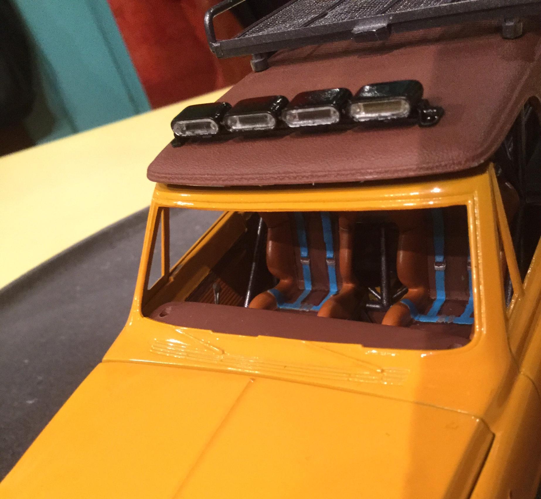

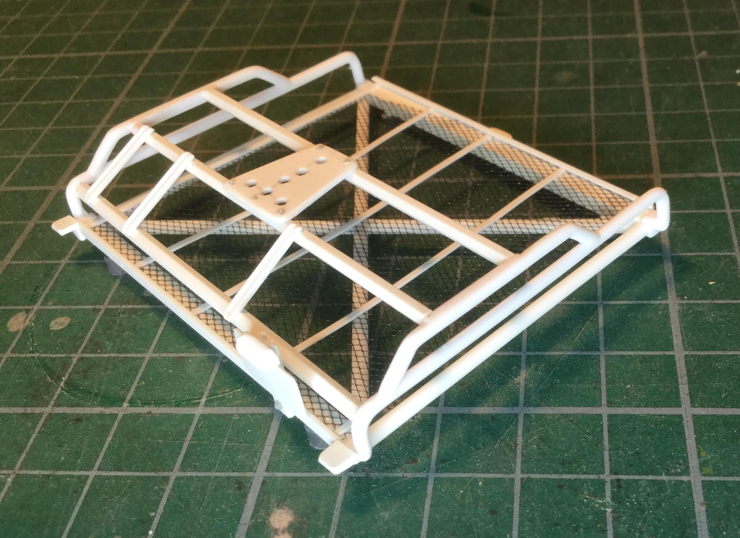

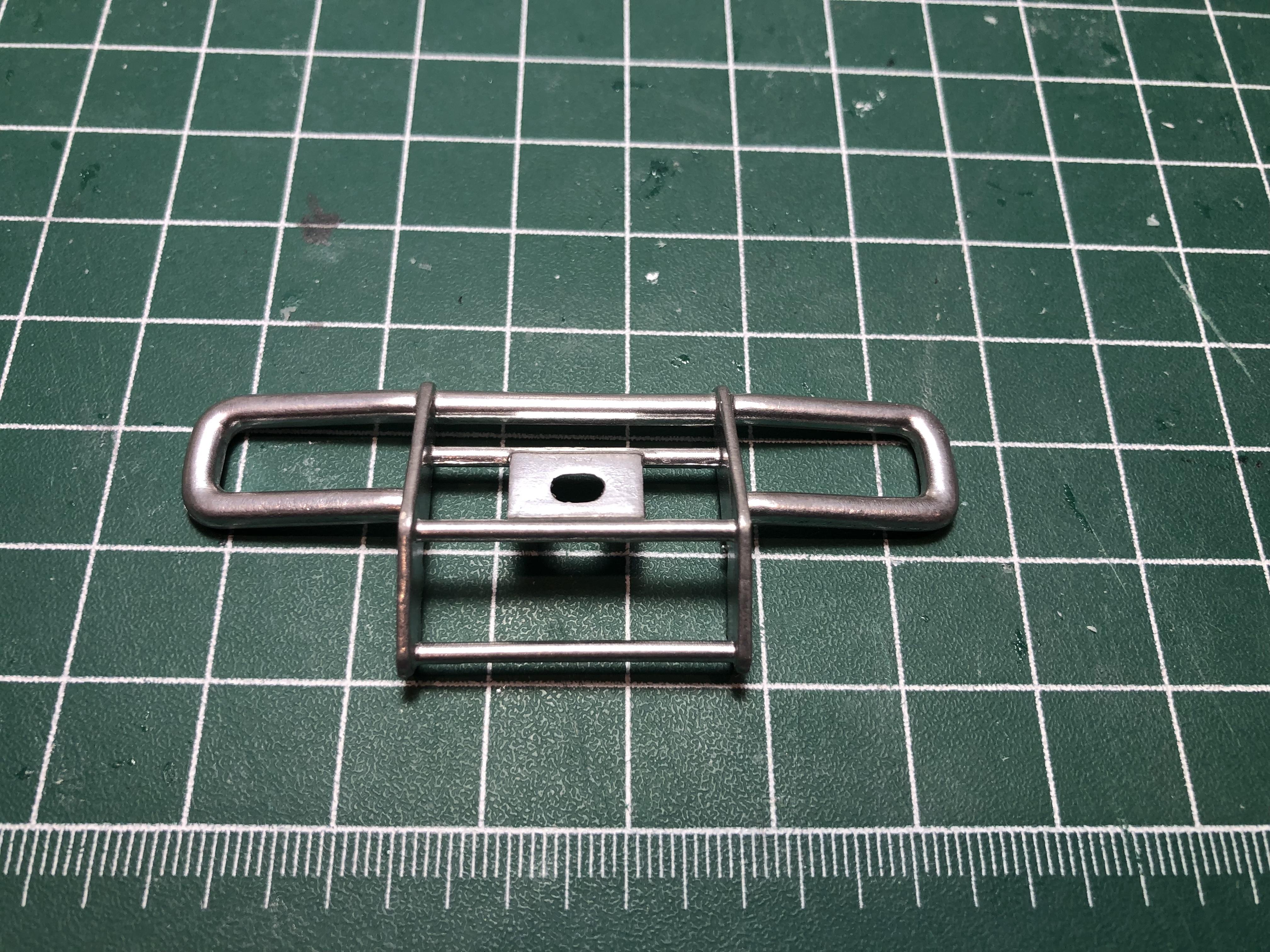

I used the Revell Wrangler Rubicon kit for a number of parts that I modified. The light bar from the kit fits onto the rollbar, yet for my use on the rooftop I built brackets out of angle iron Evergreen rod and Grandt Line bolts.
The Rubicon’s rock rails formed the basis for the scratchbuilt roof rack that would bolts to the roll cage. They were used to build the sides.
The fender flares were flipped front to back and modified to fit the Blazer.
The Westcoast mirrors were used straight from the AMT 53 Ford pickup with no mods.
Thanks guys for the interest and questions, cheers Misha

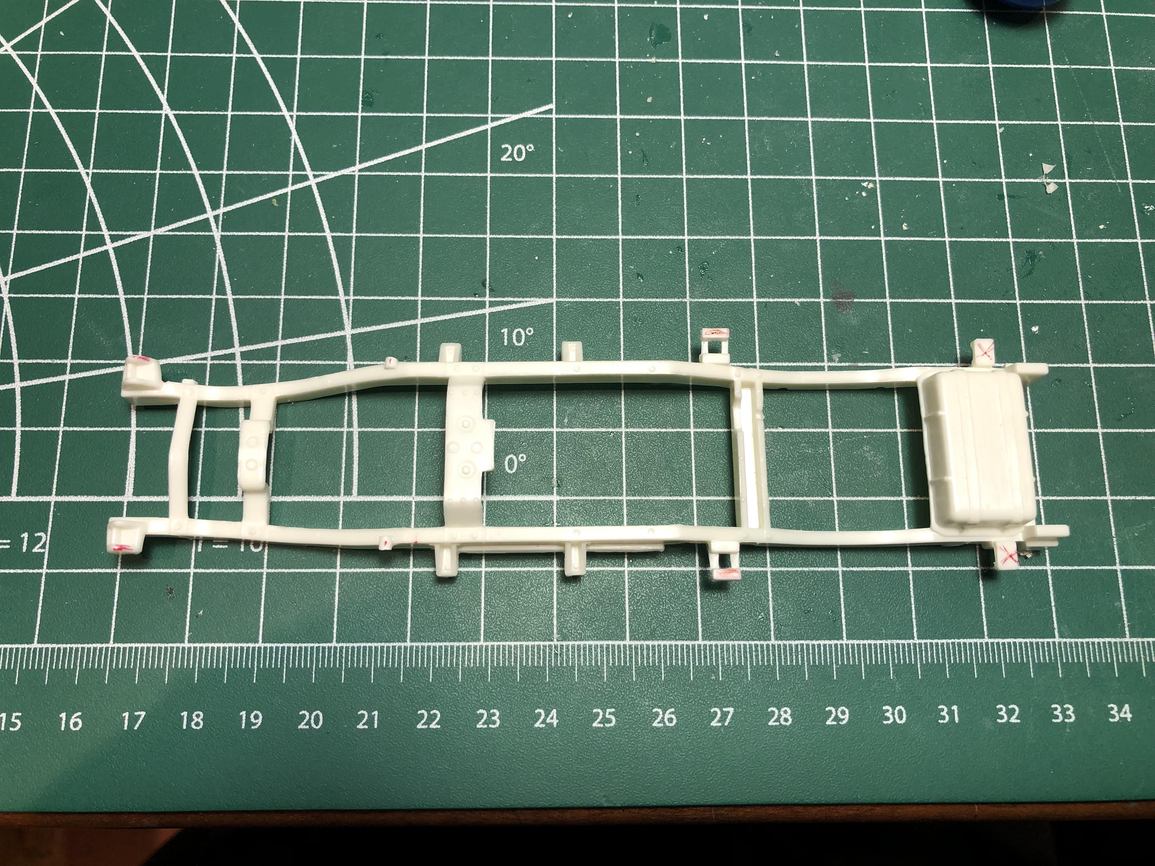

With the west coast rain falling, today was a good opportunity to get some desk time.

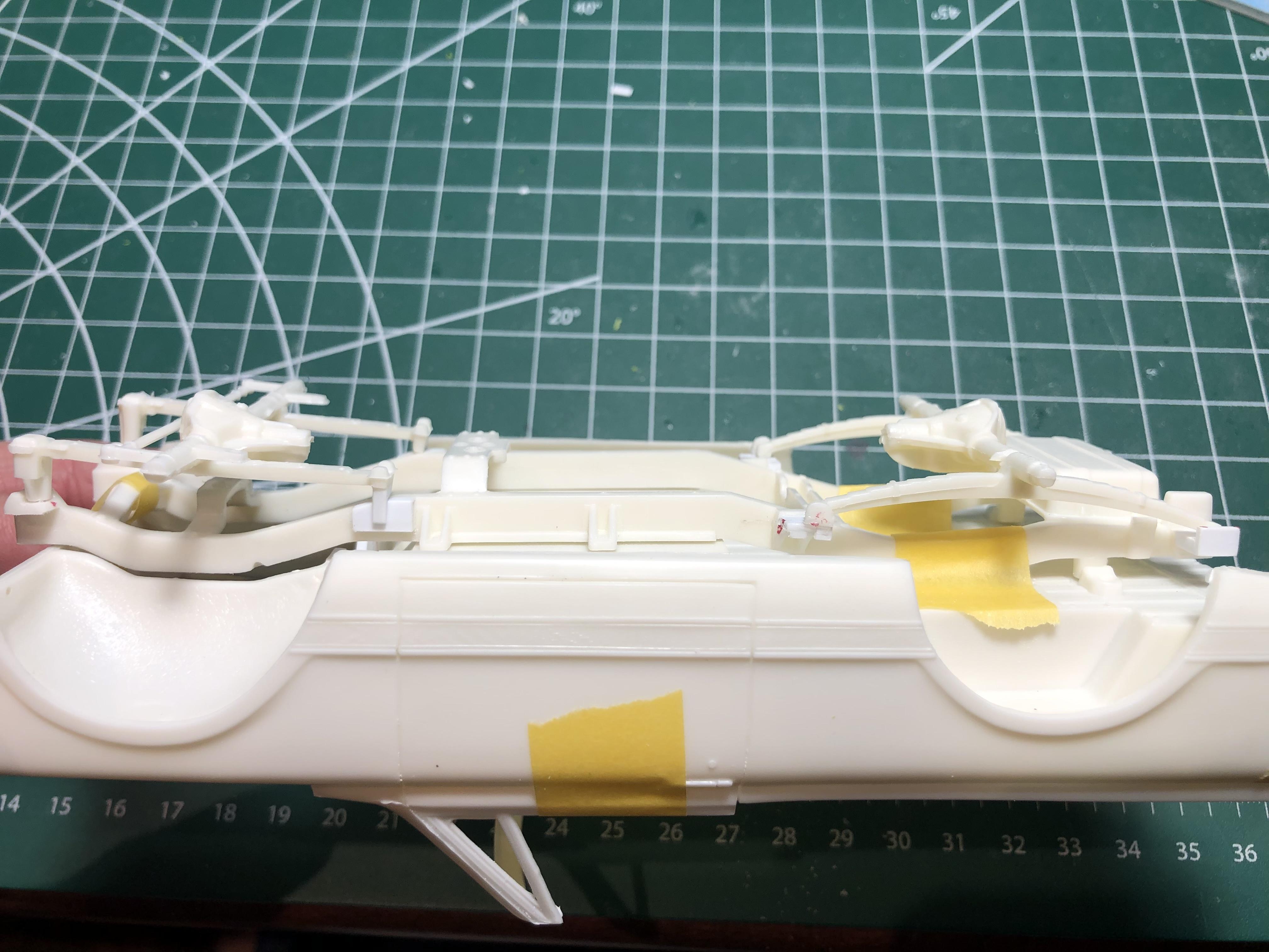

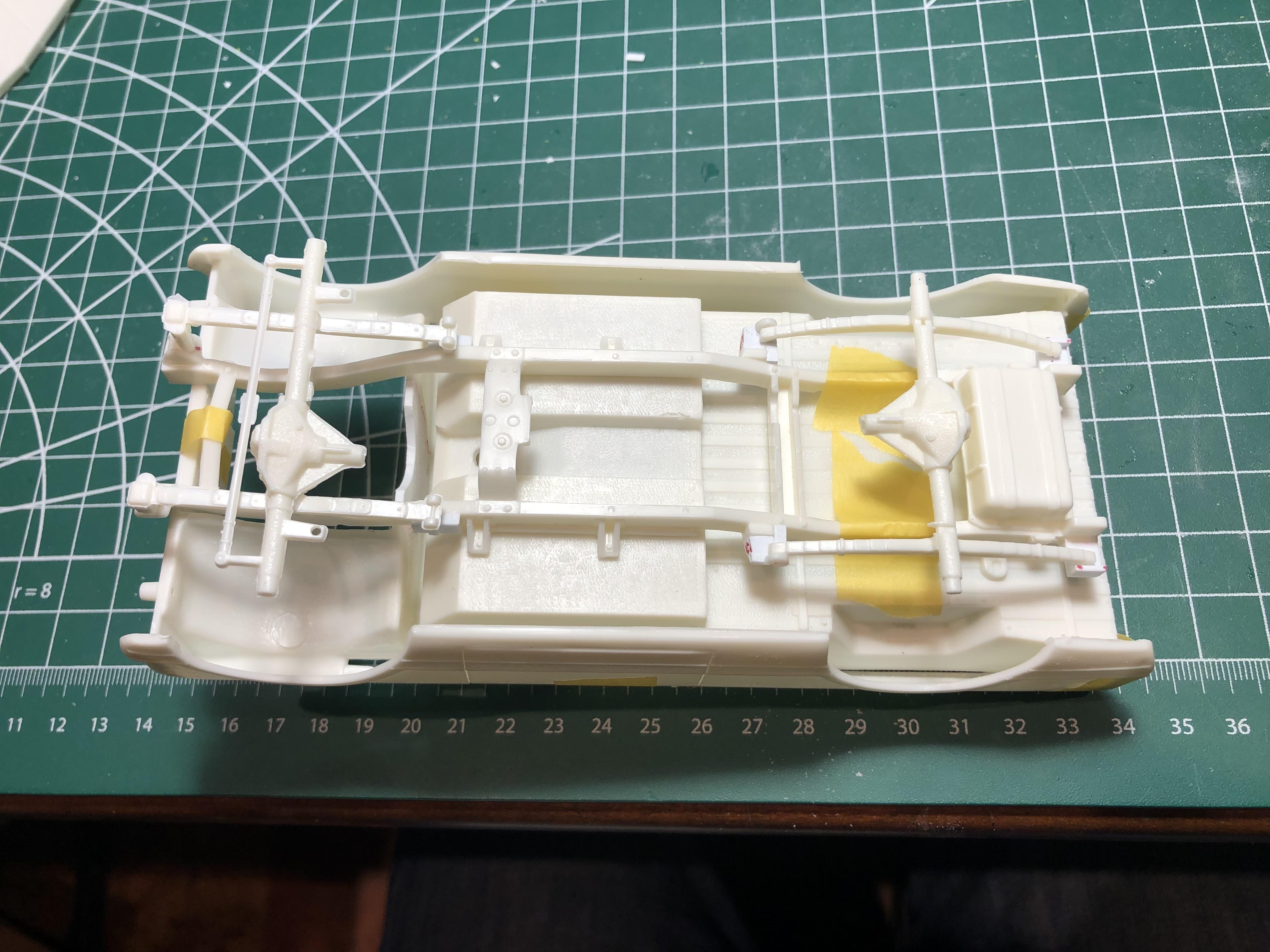

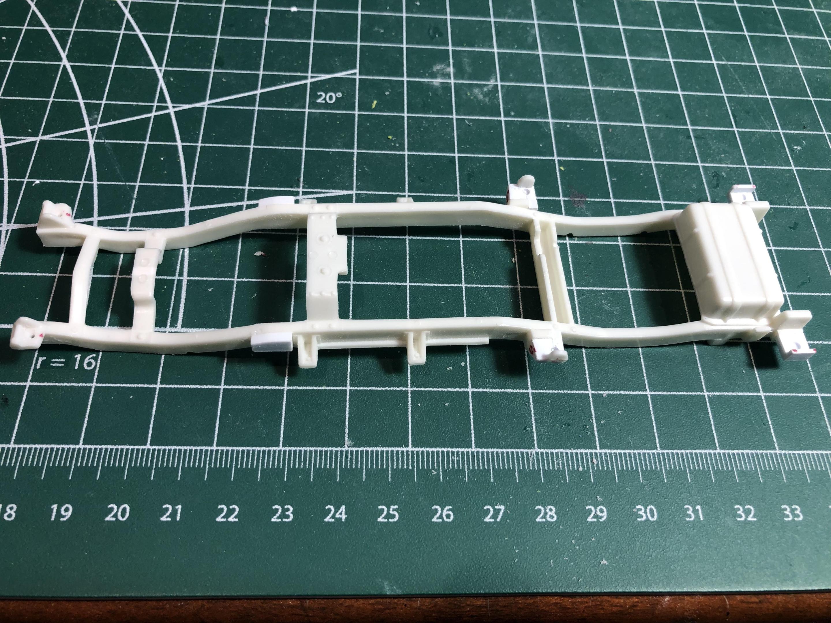

I mocked up the Deserter leaf springs/axles to the frame to establish mounting locations. After a bit of filing, cutting, gluing, and sanding it was a fairly simple swap. First pic is before any mods.
After adding and subtracting a few things…
To start, I didn’t worry too much about ride height as I figured it would be pretty easy to add a bit, or remove a bit. Very different from my usual builds where I’m trying to find every fraction of a millimeter I can to lower it! So with the wheelbase established, I drilled some mounting holes, added some pins, and…
I still have a bit of clean up to do, but as far as frame mods go for suspension, it’s close.

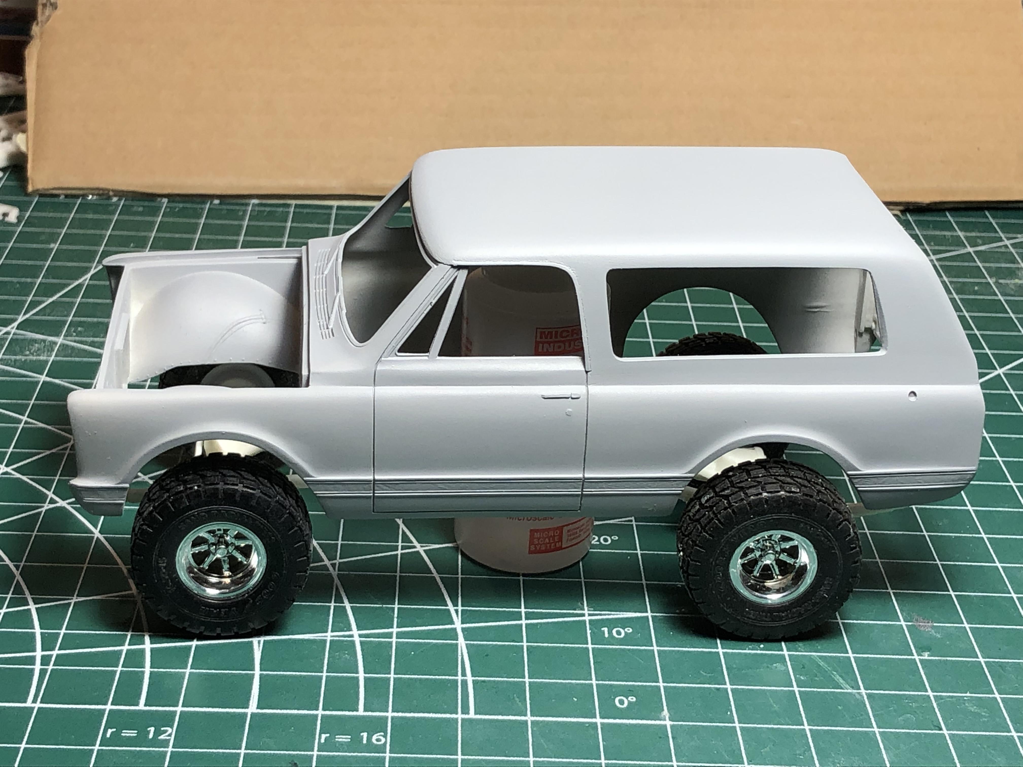

As mentioned above, I didn’t really pay attention to ride height at this stage, but… it’s almost perfect! Total fluke. I may need to tweak it  a scosh, but it’s really close as is!! That almost NEVER happens. Still need to figure driveshaft lengths, but I think that should be easy enough. The kits radiator is… well, small. I’m sure the stash will provide something more suitable.

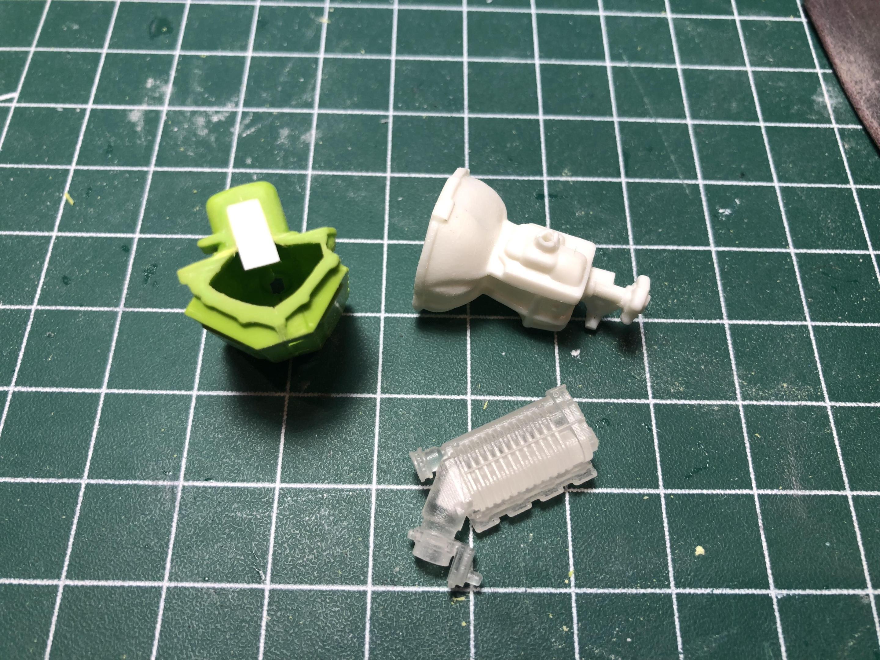

After playing with engine options, decided on the 396 from the ‘67 Chevelle pro street kit, which will get mated to the kit trans. After cutting, the oil pan needed some filling.
Still not decided on intake for the 396. I have a whipple blower that looks good on it (same as I used on my Anglia build), but I also have a single 4 bbl set up, and the injection set up from the Monogram sprint cars. Final decision on that later. I will definitely keep the engine under the hood, no scoop.

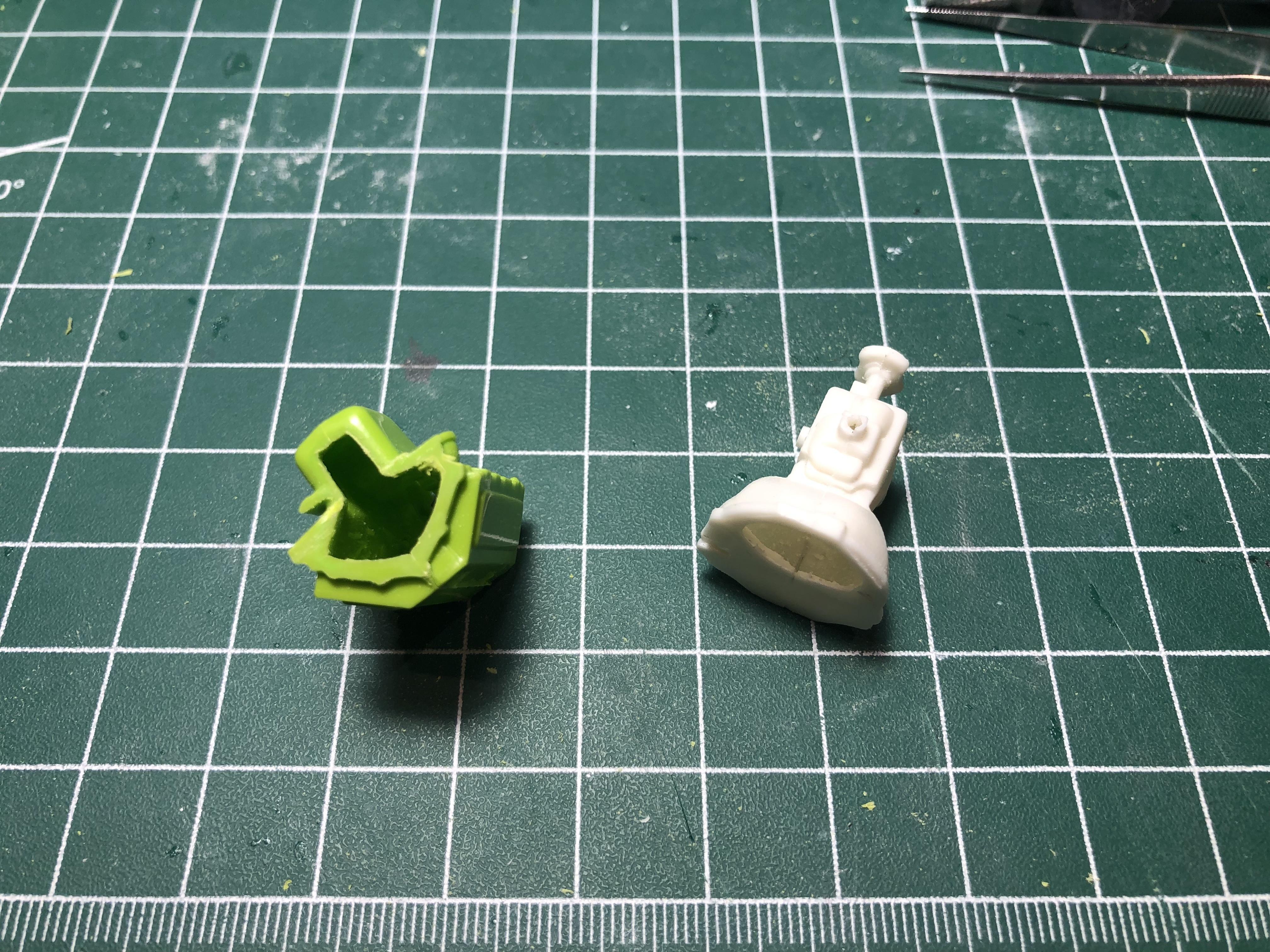

No photos of interior yet, but I have some bucket seats picked out, the Deserter console will fit with little effort. I plan on doing some wood grain on the dash, and door panels.

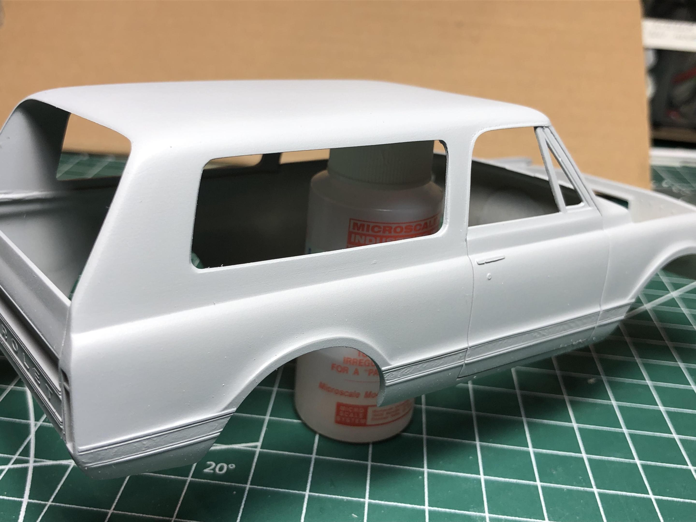

I made the executive decision to mold the top to the body, with the goal of it looking “different”, and hopefully good…? The idea (in my head) was to create a “modern style” SUV look with a non removable top. The “fibreglass” texture has been removed. Getting the warped cap glued on was a challenge, but working slowly from front to back got it on. I spent more time sanding than I care to admit on this. The body needed ALOT of cleanup, the texture on the cap was very stubborn, plus the bodywork. I sourced a new radiator from a 62 Impala kit to replace the ridiculous looking kit piece. The gaping hole in the firewall has been filled.
Still lots of fine tuning to do, but here it is after the second round of primer…
Pleased with how it looks so far, and still planning on hugger orange for body colour. Something like this, but all orange…

That is smooooth looking Steve! That definitely solves the problem of roof warpage and the lack of mounting points. Nice work!? Most of that stuff on the rad support doesn’t belong on a stock truck….perhaps it was a race truck in an earlier version? Hard to find a good pic, but here’s a screenshot I managed to capture. None of that is seen though unless you open up the grill.
