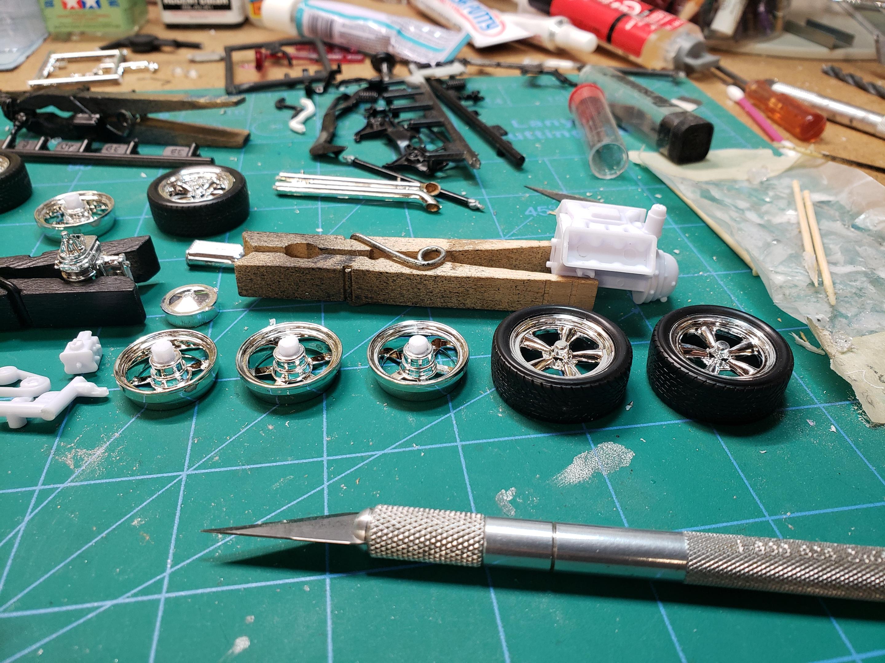

ksnow Posted May 4, 2022 Posted May 4, 2022 This will be first ever WIP thread. Hopefully I remember to take pictures along the way. I work on models in fits and spurts, so there may be a few days between updates. I am building the AMT 63 Chevy II wagon. I am working on using the custom wheels and tires from the Revell 65 stepside Chevy. I had to add pieces of sprue inside to make new "hubs" for the kit metal axles. This is my first go at anything other than an OOB build. Mocked up, I think I am happy with the stance. 3
ksnow Posted May 4, 2022 Author Posted May 4, 2022 30 minutes ago, bluestringer said: Good start. Thanks.
espo Posted May 4, 2022 Posted May 4, 2022 Good idea for adapting the wheels. Looks like you may have a V8 lurking on the bench.
ksnow Posted May 4, 2022 Author Posted May 4, 2022 Just now, espo said: Good idea for adapting the wheels. Looks like you may have a V8 lurking on the bench. That's the Hemi drag engine from the kit. I am building up the straight 6, but not set on engine choice yet. When I worked at a Cadillac dealer, we worked on a lot of cars that had more show than go, I may opt for that on this build.
espo Posted May 4, 2022 Posted May 4, 2022 2 minutes ago, ksnow said: That's the Hemi drag engine from the kit. I am building up the straight 6, but not set on engine choice yet. When I worked at a Cadillac dealer, we worked on a lot of cars that had more show than go, I may opt for that on this build. Depending on what you have in mind, think about a multi carb or even turbo charged in line.
