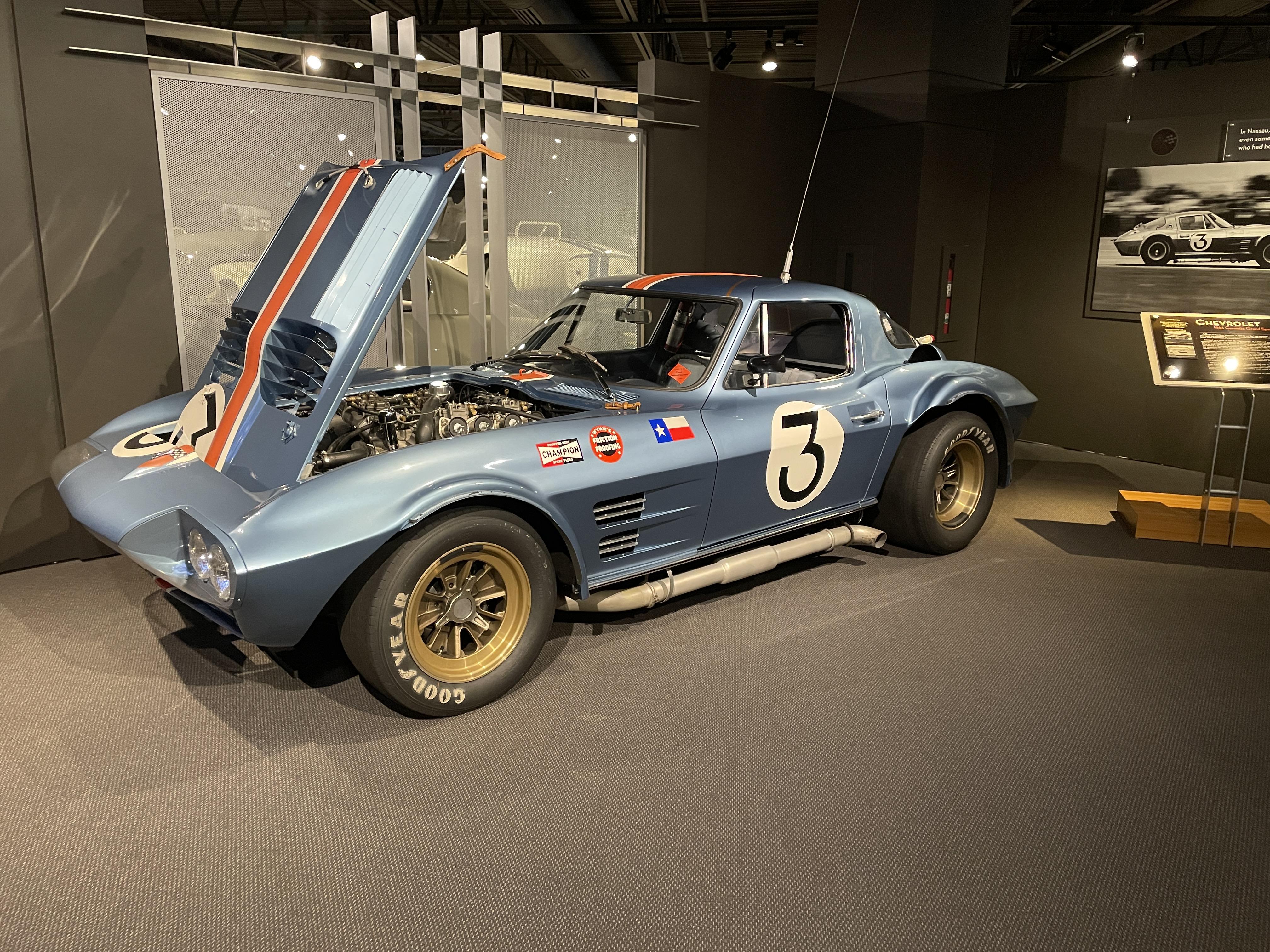

The actual car #004 is at the Revs Institute in Naples, Florida and I see it regularly. I have wondered about the color myself.
I'm sure that it was in Mecom's Pelham blue in Nassau 1963. It wouldn't make sense for it to be different at that time.
The big question then becomes - did Delmo Johnson repaint it Silver Blue before taking it to Sebring in 1964? It's likely the car was repainted since the new louvered hood had been added by then.  Also, the other two coupes wore new paint, too.
The Revs home page has a place where you can contact them. There is a button on the right edge that says "Ask Revs Now". It might be worth a shot! Their staff is very good at following up on questions.
Home page - https://revsinstitute.org/
Here is the Grand Sport page. Lots of great pictures there!
https://revsinstitute.org/the-collection/1963-chevrolet-corvette-grand-sport/
And, just to see if I can post a picture!

Great links. Thanks for those. The car you posted seems lighter in color then the photo of the car in the link. But you know it's the same car, so how does one choose what to use? Thats a great shot of the interior in the link.

That color seems to move quite a bit depending on lighting. Sometimes lighter/darker or ice blue to gray-blue in tone. I'll do what I can but using GM Silver Blue as my reference.

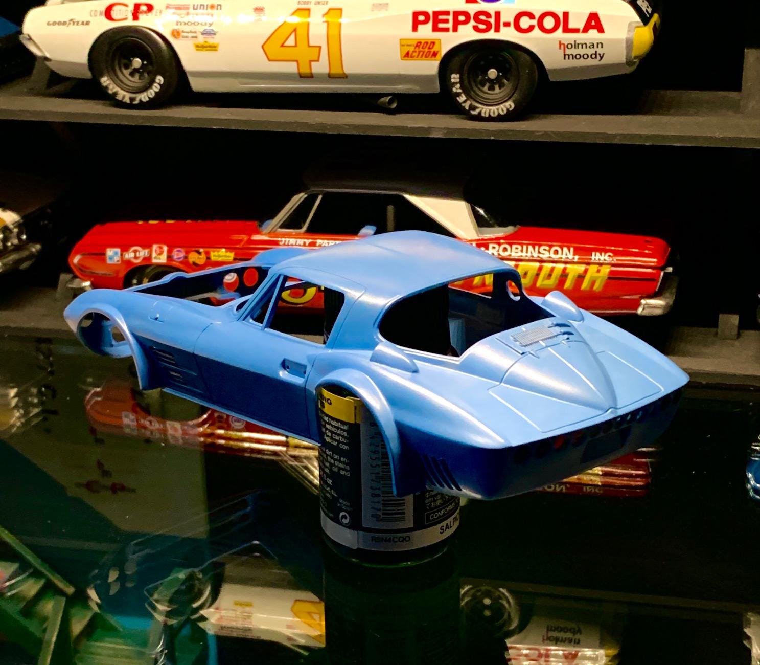

Body primed a few days ago. Some minimal wet sanding 4000 to 12000 grit, then 2 coats of color brushed on today. A bit early to see what the color will look like with clear and in good light but I am happy it went on smooth with not a trace of brush marks.
I'm gonna let her sit there in the cabinet for 2 or 3 days before moving on with the clear coats. Polishing that clear should be "fun" with all the surface changes and creases.
Wow, that color looks perfect and like you said no brush marks. Did you use more reducer?  Polishing will be tough with all those nooks and crannys. Have you thought about using one of the polishing compounds out there?

For this one I used 2 drops 930 dark blue, 4 drops 990 light grey, 6 drops 521 metal medium and 15 drops 524 thinner medium for each of the 2 very thin coats over a light grey primer. Here's a photo in natural lighting.
I plan to try polishing compound for the clear. I have Tamiya Fine and Finish to try. Any input would be helpful as this is a first for me. I was thinking I would do the usual 6000, 8000 & 12000 wet sand carefully staying away from all these edges and then Fine compound and finally Finish compound. Enough or too many steps? Input from other builders would be helpful.

Pierre, the fine and finish tamiya sounds like a good way to polish the clear after the sanding. The compound is much more forgiving then the sandpaper. Will you finish it up finally with some future after the polishing? That hood looks amazing like the body as far as no brush marks. I wish I could get those kinds of results with a brush.
Thanks Mark for info on polishing compounds.
Low viscosity and thin coats is what works best for me brush painting the color. I work it in with the brush barely touching the surface and the low viscounts allows time to work the paint in multiple times. Think opposite of how we need to handle Future.
As for Future. I plan to follow what I did on my Porsche 917K project. Polishing the acrylic clear, decals and only one coat of Future in the end to seal decals.
