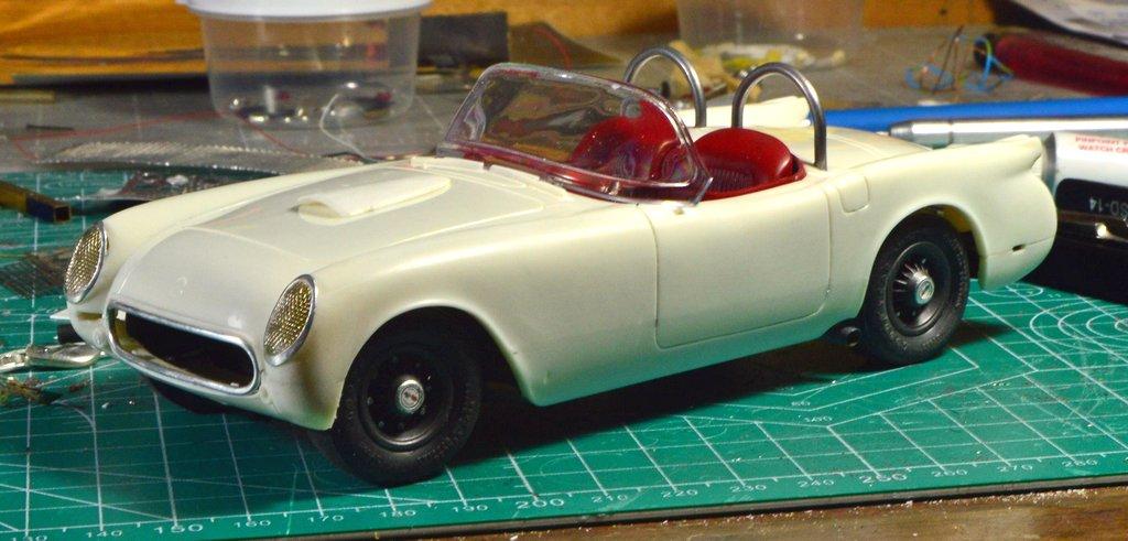

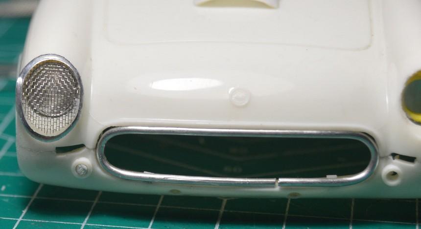

Straightliner59 Posted July 2, 2022 Author Posted July 2, 2022 I got these screens, today. I did some research, about how meshes are "defined". I think I ended up deciding to go with a "40 mesh". These were intended to be pipe screens. They're perfect for this application! The difference in appearance between these and the brass is immeasurable. I got the grille in better, too. As always, comments, critiques and questions are welcomed. Thanks for looking! 1 1
Straightliner59 Posted July 3, 2022 Author Posted July 3, 2022 10 hours ago, bisc63 said: Looks very good! Thanks, Rusty. It's a more open weave. And, it's more the correct color.

Bainford Posted July 7, 2022 Posted July 7, 2022 Bummer about the crazing. The new headlight screens are a huge improvement and look great.
Straightliner59 Posted July 8, 2022 Author Posted July 8, 2022 21 hours ago, Bainford said: Bummer about the crazing. The new headlight screens are a huge improvement and look great. Thanks, Trevor! They did come out, nicely. At least I learned enough, doing the first body, that the second one will be better! It's coming along...

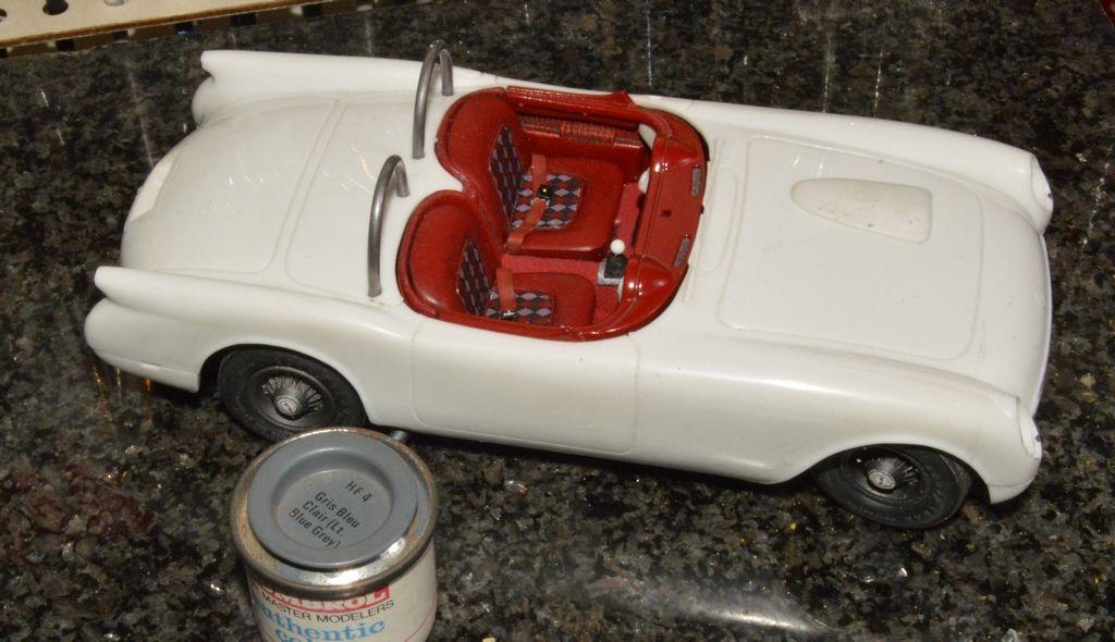

Straightliner59 Posted April 6 Author Posted April 6 I've been playing around with this, the last few days. I made some argyle inserts for the seats--I have no idea why--but, I kind of like it! I'm working on the lap belts, and beginning work on the dash. I'm not 100% this is what I'll finish, next, but, it's looking favorably, in that direction. I'll get some photos, after work, later.
Straightliner59 Posted April 8 Author Posted April 8 I think I'll finish this thing, next. It shouldn't take too long. 😂 I have the seats mostly done. I need to do some highlighting and shading, and some touchups. I didn't have any production-type belt hardware, so I cobbled some up, from aluminum strips and Evergreen. I made the release buttons from brass wire. I printed the argyle inset pattern--I wanted something, but, didn't want to use the tartan--it's been done! I used some .015" lead-free wire for fly-tying for the piping. That stuff is handy, and is available in .015"-.035" diameters. I have a lot of body work, left to do, and I want to try something new for the grille. I'm trying to decide on a color for it. I'm leaning toward something grey, but not 100% sold. As always is the case, your comments and questions are appreciated. Thanks for looking! 1

Bullybeef Posted April 14 Posted April 14 Well seeing as how you have resurrected this old build, I’m inclined to comment on it! The previous work done on the wheels and lights is outstanding, the interior is superb, really like the argyle l, you mentioned a grey colour as a possible for the exterior but imo( as humble as it may be) I think a white or off white would suit it more.
Straightliner59 Posted April 14 Author Posted April 14 22 hours ago, FoMoCo66 said: Looks amazing, your really doing this snapper justice! Thanks, Ace. I figure there's not a lot going on, so I want to add as much interest to it, as possible. I enjoy building curbsides! 23 minutes ago, Bullybeef said: Well seeing as how you have resurrected this old build, I’m inclined to comment on it! The previous work done on the wheels and lights is outstanding, the interior is superb, really like the argyle l, you mentioned a grey colour as a possible for the exterior but imo( as humble as it may be) I think a white or off white would suit it more. I appreciate your feedback, Bil. I do think either of those would be a good choice. I have been leaning toward either white(ish) or black, which was my original choice. That probably led me to consider grey. Thankfully, I still have enough body work to do, that I'll have time to think about it!
Ace-Garageguy Posted April 14 Posted April 14 Looking good. Really appreciate the info on the mesh for the headlights too. It's the best looking I've seen yet. 1
Straightliner59 Posted April 15 Author Posted April 15 12 hours ago, Ace-Garageguy said: Looking good. Really appreciate the info on the mesh for the headlights too. It's the best looking I've seen yet. Thanks, Bill. I had to figure something out, those molded, chromed headlights just weren't going to cut it!😃 1

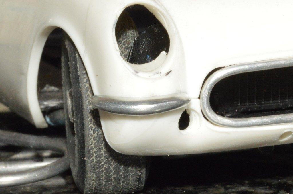

Straightliner59 Posted April 17 Author Posted April 17 One down, three to go. I decided to give some aluminum armature wire a go, for making the bumpers. They'll polish up, nicely! I'm pretty much decided on this grey. I was going to do white, but I already have three white cars in the display case, and another that's cream-colored. And...I don't have any grey ones, and I've always wanted to do one. I think I compared about fifteen different Humbrol greys, and a Pactra one, alongside the interior. This one looks best, to me. I'm also leaning toward putting the scoop, offset, to accommodate the implied Rochester FI powerplant. To expose the bumper that lies within the wire (thank you, Francis!), I began by clamping the section of wire in my vise, leaving a little less than half, exposed. I removed the exposed length with a 6" mill bastard. I then rotated the wire 90 degrees, and repeated the process. Finally, a 180-degree rotation, and repeat completes the roughing-in process. I should note that the brown phone wire was used to mark the length(s) for the bumpers. The black Sharpie marks denote the front and rear bumper lengths. Next, I superglued the roughly-shaped bumper to the edge of a craft stick, where it was easily shaped and buffed. Next, I'll bend this one, and once I'm satisfied the process is good, I'll move on to the next ones. Comments, questions, and etc. are always welcomed. Thanks for looking!
Straightliner59 Posted April 18 Author Posted April 18 One front bumper is bent, and white-glued in place. The other has gone from rough to ready-to-bend. For a lot of my modeling life, I would have considered this process drudgery. I've come to where it's somewhat Zen-like, for me. There's a certain calm that comes from watching something come from raw material, right in your hands. Anyway--enough of that! It probably only takes 45 minutes to an hour to make one of these. I'm considering doing one for a grille bar, to reflect the center section of the rear bumper. Once the rear one is done, I can use it, to see how it would look, up front, as well. Thanks for looking! 1 1
NOBLNG Posted April 18 Posted April 18 Nice work on the headlight screens. The interior looks very good and now the bumpers are shaping up nicely! 😎 1
Straightliner59 Posted April 18 Author Posted April 18 9 hours ago, NOBLNG said: Nice work on the headlight screens. The interior looks very good and now the bumpers are shaping up nicely! 😎 Thanks, Greg! I got the rear, center section done, before bed, this morning, but didn't have time to shoot photos. I noticed that one of my fronts is a tad heavy, so I will have to thin it out, a bit. 1
