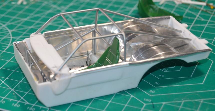

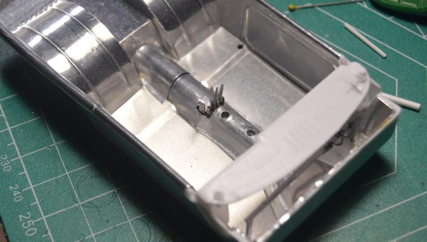

Straightliner59 Posted August 31, 2022 Author Share Posted August 31, 2022 I got a few photos of the roll cage and interior, sans body. I need to add the door bars and make the lower main bars, but, I'm pretty happy with what's there! Quote Link to comment Share on other sites More sharing options...

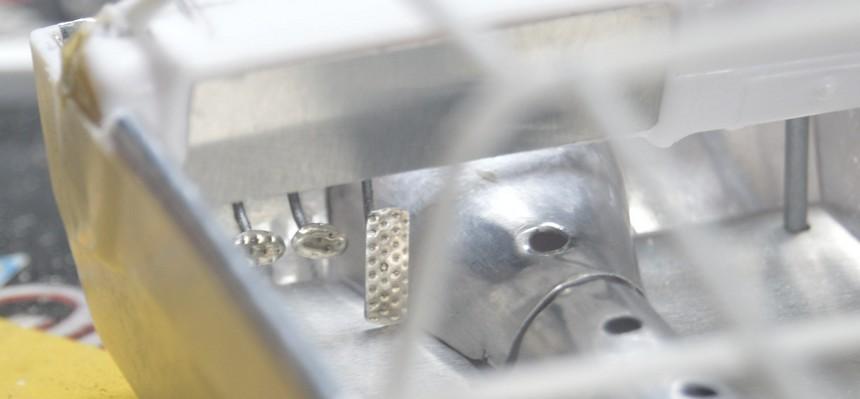

Straightliner59 Posted September 6, 2022 Author Share Posted September 6, 2022 I got a few more things done. I built the bottom tubes at the front of the cage, and mounted the pedals to the crossbar. I got the door bars cut, but they still need to be drilled, so they can be pinned to the cage. I finished the wheelie bars, but, now, I need to figure out what's cause them to be so low that they are holding (slightly) the rear of the car up. Other than that, I think they look pretty nice! I painted them with Testors Metalizer Titanium--which necessitated a moment of silence for my penultimate can of that fine substance. Your critiques, questions and comments are always welcome. Thanks for looking! 1 Quote Link to comment Share on other sites More sharing options...

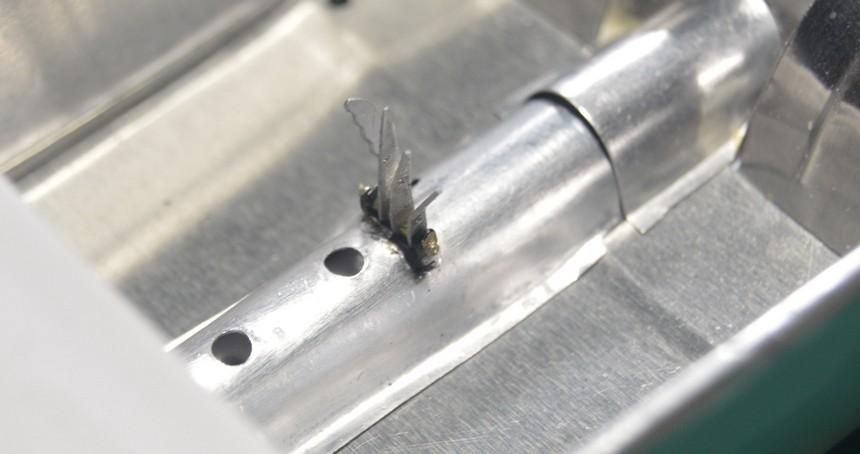

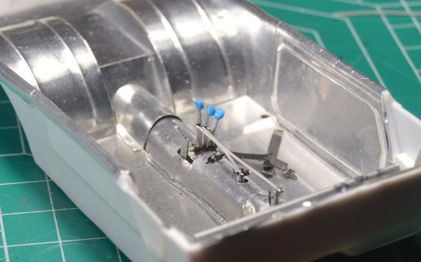

Straightliner59 Posted September 12, 2022 Author Share Posted September 12, 2022 On to the interior... Boy, that Lenco shifter cluster was fun! Now for the knobs. Next, I'll finish the shift towers. I'll wrap up the Lenco with the linkages from the towers to the shifters. Your comments, critiques and questions are always welcomed. Thanks for looking! 2 Quote Link to comment Share on other sites More sharing options...

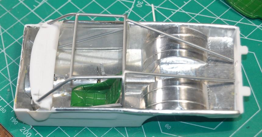

Straightliner59 Posted September 13, 2022 Author Share Posted September 13, 2022 More progress...I somehow managed to build a .063" styrene rod roll cage that was sturdy enough to go into out of the interior, for fitting, etc. I got the door bars made and installed to it, as well. Next, I'll finish up the Lenco. The dash will at least be partially painted the same Mulsanne Blue as the car's exterior. There's still a fair amount of work, to go, here, but I am very happy with today's progress! Thanks for looking! 1 Quote Link to comment Share on other sites More sharing options...

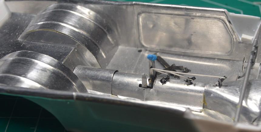

Straightliner59 Posted September 20, 2022 Author Share Posted September 20, 2022 The linkages for the Lenco are done! Since the photos, I've painted them (Tamiya Titanium Gold Acrylic). I'm happy with the way they worked out. I used some old MSC (I suppose that's redundant!) silver/grey 1/25 plug wire, to make them. Anyhoo... Quote Link to comment Share on other sites More sharing options...

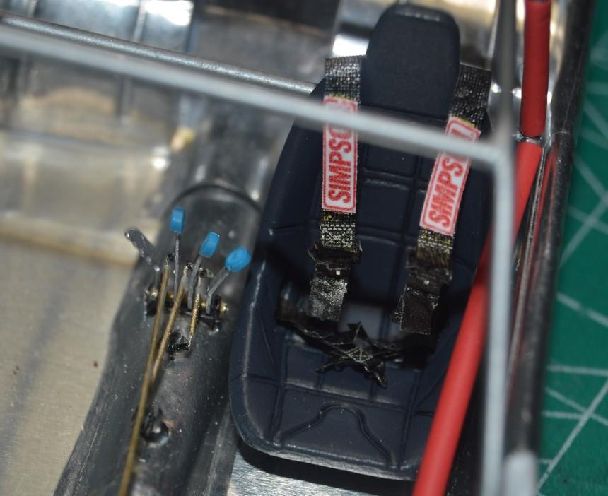

Straightliner59 Posted September 22, 2022 Author Share Posted September 22, 2022 I got the seat installed, along with the lap belts. The shoulder belts are attached to the cage, but the cage can't be installed, until the dash is completed and installed (I'm working on that, next--I think! 😄). One thing I like best about the Eduard belts is the printing of the stitching. One of the things I like the least about them, is the stiffness of the material that stitching is printed on. It's very difficult to get it posed, so that it doesn't look posed. I'll mess with the shoulder belts some more, next time I pull the cage out of the tub. The shoulder straps are "wrapped" around the shoulder bar, as nearly as I could do them, given this material's rigidity. They're secured in place by an apparatus (in 1:1) that bolts around the bar. I faked it with Contrails round styrene tube. The seat covering is painted Krylon Chalky Finish Charcoal(?). Once that dried, I drew (no pun intended) a Prismacolor black pencil through the patterns, to give them some depth. I think that's about it, for now. As always, questions, comments and critiques are welcome. Thanks for looking! Quote Link to comment Share on other sites More sharing options...
Ian McLaren Posted September 22, 2022 Share Posted September 22, 2022 The shifter, linkages, and seat look great and I understand what your saying about the belts. In the aircraft the belts hange fairly straight and flatter so the stiffness was less of a problem for me but visually they are hard to beat. Quote Link to comment Share on other sites More sharing options...
