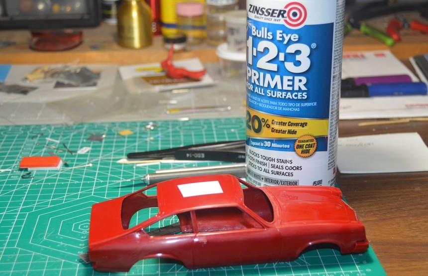

Straightliner59 Posted October 9, 2022 Author Posted October 9, 2022 Because I want nothing to do with a repeat of the paint on the '53 'Vette, I'm not about to just start shooting paint on this promo-body plastic, only to have the primer attack the plastic surface of the body...again! Also, I need to prevent the red plastic from leaching into the Mulsanne Blue paint. I have seen Bill Geary mention using Zinsser B-I-N to protect against bleed-through, and to protect plastic from too-hot paint. Since I was grocery shopping yesterday afternoon at Walmart, I decided to check the paint aisle, to see what was available. I found a spray can of another Zinsser product, and decided to try it out. In order to avoid any snafus, I taped off a square in the middle of the roof, where any damage that might be done would be easy to fix. It turned out that I didn't need to worry. It went on thinly enough and sands easily. It also blocks the red. Success! Next, I'll just shoot it on a scrap body, and shoot a bit of the blue over it, to make sure that's safe. I sanded the wipers off the cowl. I need to scribe in the vent lines, where the wipers were. I have a few more mold lines to clean up, too, before it's ready for a guide coat. It's coming along! Questions, comments and critiques are welcomed and appreciated. Thanks for looking!

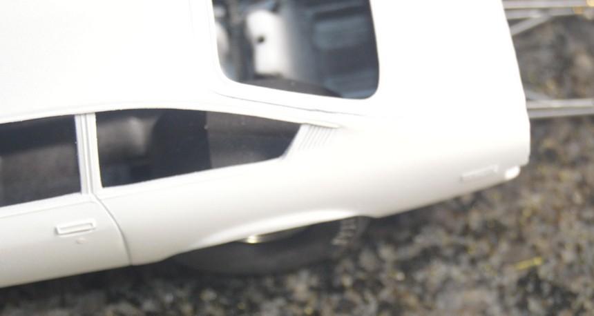

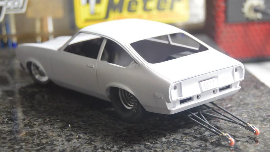

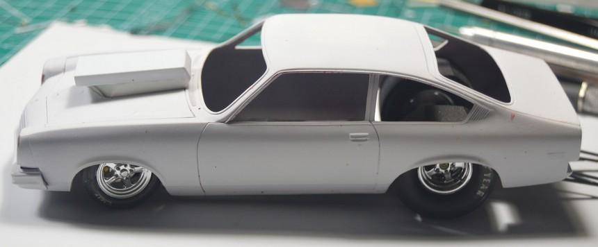

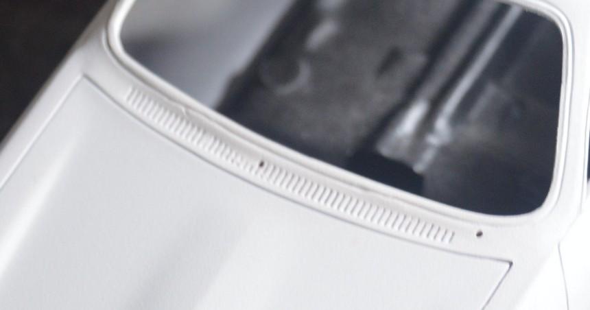

Straightliner59 Posted October 11, 2022 Author Posted October 11, 2022 I got some parting line removal taken care of, and an initial coat of primer on the body. The area along the hatch, on both sides was really sunken, and/or the molds were worn enough that I had to go looking for pictures to make sure GM hadn't changed the shape of that body line/contour. They hadn't, so I started sanding away, until I got it to this point. I removed the wipers. I still need to scribe in the vent lines, where the wipers were.. I also have a couple of other spots in panel lines that need to be addressed. Of course, there's the typical stuff you never notice until the first coat of primer's on the car. I tested the Mulsanne Blue over the Zinsser, on a set of red-molded window louvers I had in the parts box. No ill-effects, there! Anyway, here are a few shots of the car, in white primer. 1

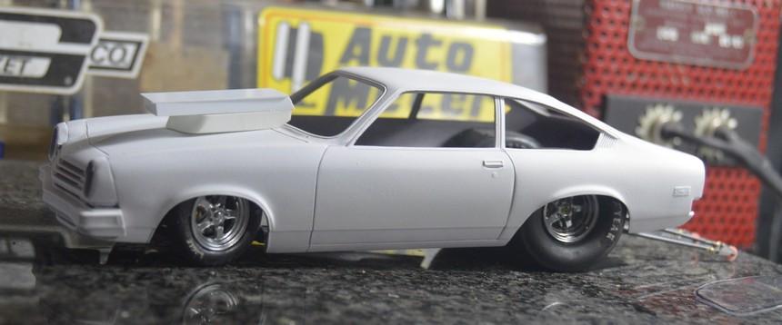

Straightliner59 Posted October 11, 2022 Author Posted October 11, 2022 4 hours ago, Ian McLaren said: The body is really starting to come together, well done Thank you, Ian. I think I finally have a hood scoop! I used a base from one of the Monogram Pro Stock kits. I cut 5/32" from its height. I then built the top section from .020" strip and sheet. It's been smoothed, and the "boxing in" has been done at the rear of the scoop. I think it looks pretty decent! Here's the blue, over the Zinsser, too. 1

Ian McLaren Posted October 12, 2022 Posted October 12, 2022 1 hour ago, sflam123 said: WOW!! Just WOW!! Beautiful work on this project! Both of the scoops you have made look very good but the second one is the more typical style found at the local track or points meets where we normally saw Super Gas run.
Straightliner59 Posted October 12, 2022 Author Posted October 12, 2022 19 hours ago, John B. said: WOW! The detail in the interior is incredible - I'm learning a lot just by following your build! Thank you, John Michael. I always hope that other modelers can find something useful in my projects! I'm glad you are. Thanks, again! 3 hours ago, sflam123 said: WOW!! Just WOW!! Beautiful work on this project! Thank you, Stephen. Appreciate that! 2 hours ago, Ian McLaren said: Both of the scoops you have made look very good but the second one is the more typical style found at the local track or points meets where we normally saw Super Gas run. I agree, and always did, but wasn't really finding the right pieces to put together. Then, I opened a box of partial kits, and, there were three or four of the old Monogram Pro Stockers! I just cut the scoop so it wasn't as tall, then pieced it together with some .020" strip and sheet. I am in the process of cutting a hole in the hood for the scoop. It will mount to a section of sheet, so that it will look like the hood fits around the bas of the scoop--just like it ought to! Thanks much for your input with this thing!

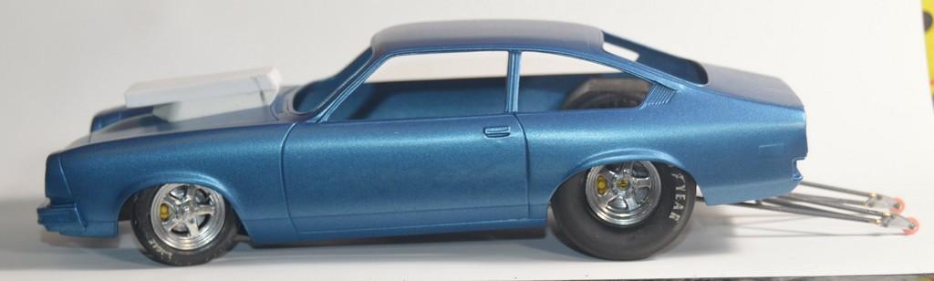

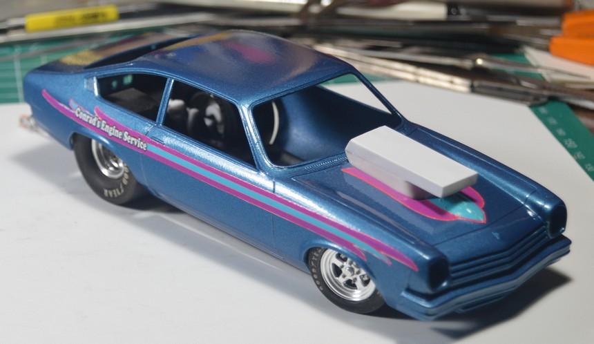

Straightliner59 Posted October 15, 2022 Author Posted October 15, 2022 It might be kind of a big deal: paint! I took the Vega and the can of automotive touch-up spray Mulsanne Blue outside with me, so I had more room than the paint booth, and better, more natural light to shoot under. Now, it can gas out a few days, while I decide what I want to do, graphically, beyond teal and purple--I need to figure how I want to lay out the stripes. It's getting closer. I have to admit, I am concerned, a bit, about getting the interior in--man, it's a tight squeeze, the way the body undercuts! Anybody got a shoehorn??

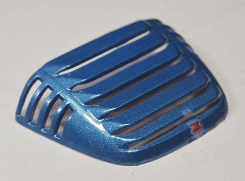

Straightliner59 Posted October 15, 2022 Author Posted October 15, 2022 Here's the test piece, with clear (Krylon Clear Glaze).

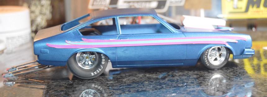

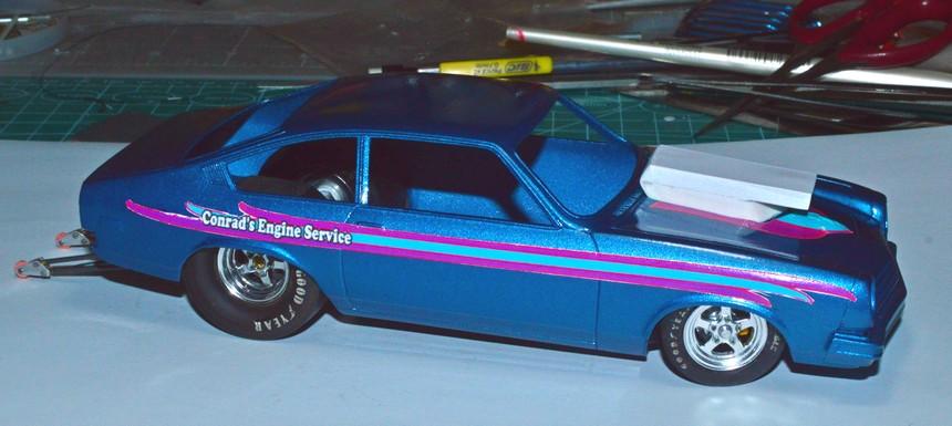

Straightliner59 Posted October 16, 2022 Author Posted October 16, 2022 (edited) I have designed the decals and printed them. This is a test print, pasted to the car with a couple of dabs of tacky glue. I revised the hood decal, for the final print. It will fit better than this test version. I still have more to design, but, the main graphics are done! Questions, comments, suggestions and critiques are always welcomed. Thanks for looking! Edited October 16, 2022 by Straightliner59 1

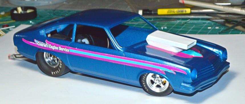

Straightliner59 Posted October 17, 2022 Author Posted October 17, 2022 On 10/16/2022 at 7:35 AM, Ian McLaren said: I like the graphics Thank you, sir. I applied some of the decals--the major components of the graphics, at least. I may have to remove the center section of the hood decal, and replace it (I printed spares), if it doesn't settle down. I made a small change in the stripes, adding the tribute to my Dad that is on all my race cars, save a couple of early ones. I have a couple of more local sponsors to put on it, and body trim, etc. Anyway...here's how it looks with the decals on. I am really happy with the scheme! I think it looks pretty "'80s"! 1
