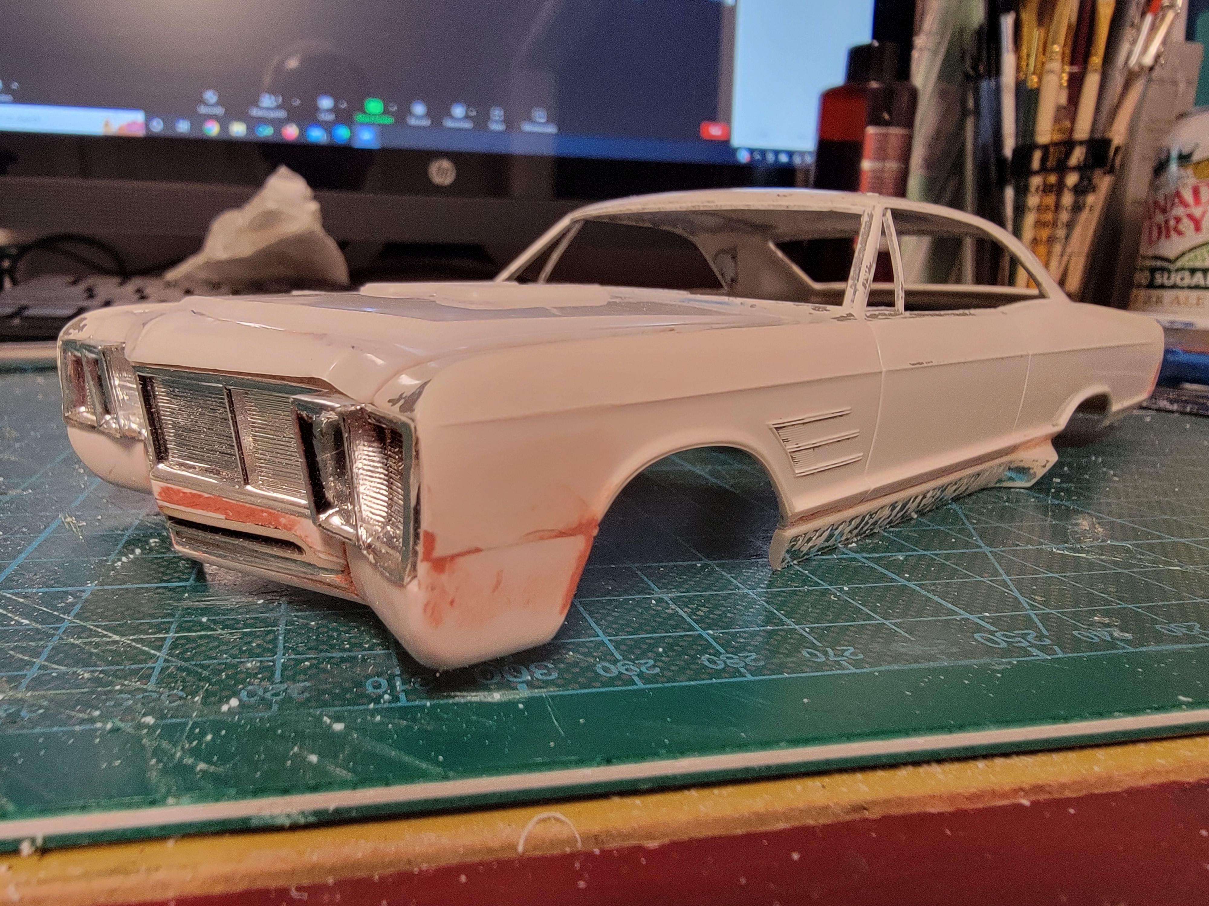

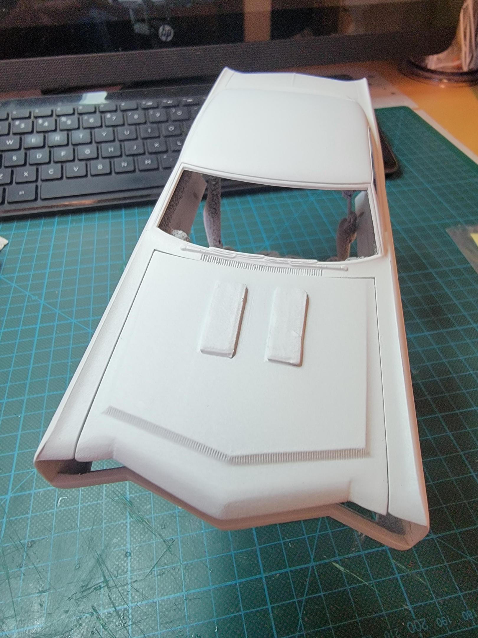

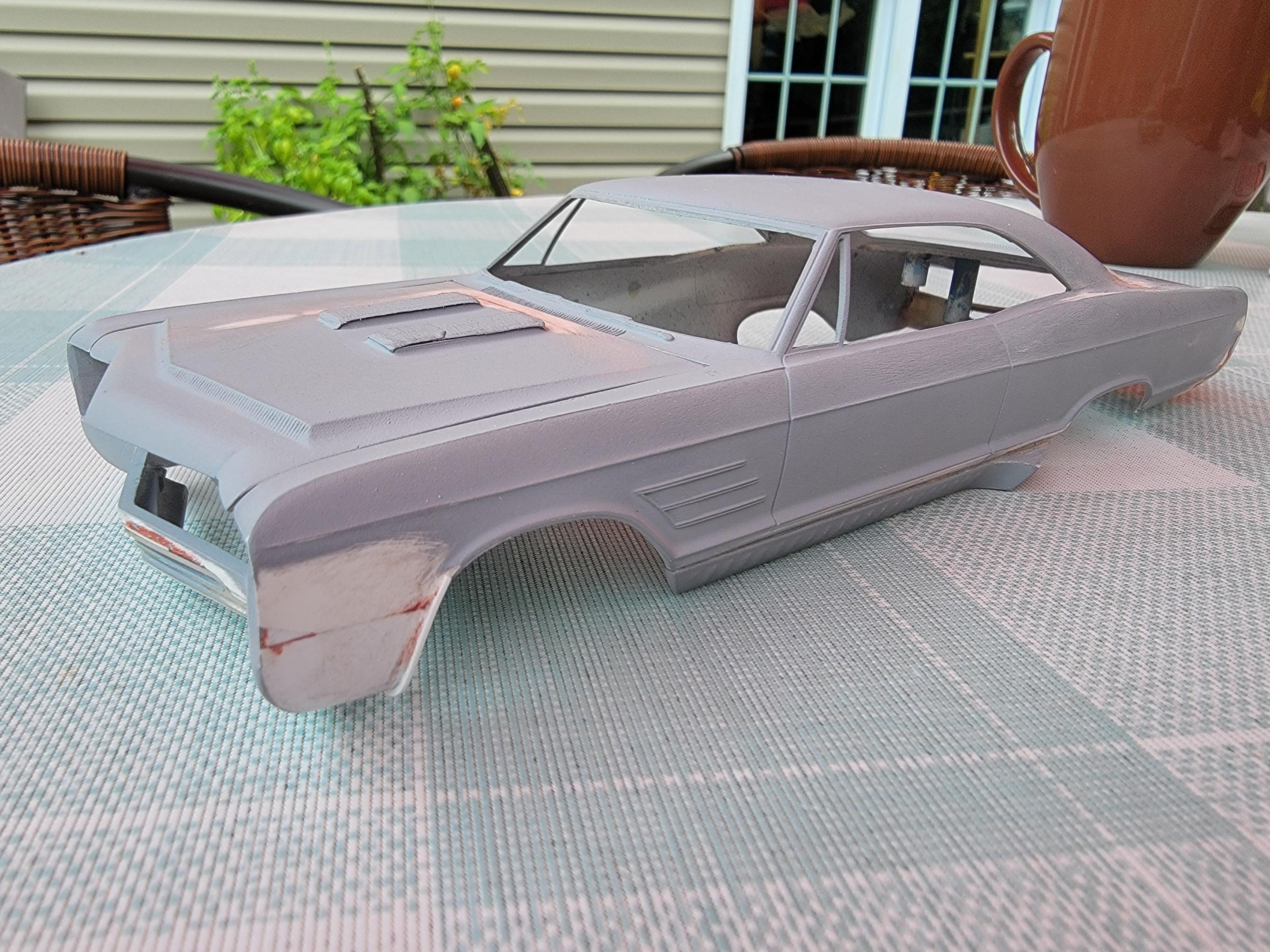

Just started this a couple of weeks ago in a "build-off" (term used loosely) with SamIAm. I am using a kit that someone had built and tore back down so there is a bit of "road rash" to fix along the way. The body was completely stock so all of the modifications done in poor taste are my own doing.
Rather than starting from the beginning and boring you with many details  I'll just start from where im at now. I wanted to build a wild custom but have no real plan and, at times, have been struggling with ideas.
None of the custom parts from this kit fit well at all. They all have needed significant adjusting. Some of what you see came from other kits or the parts stash.

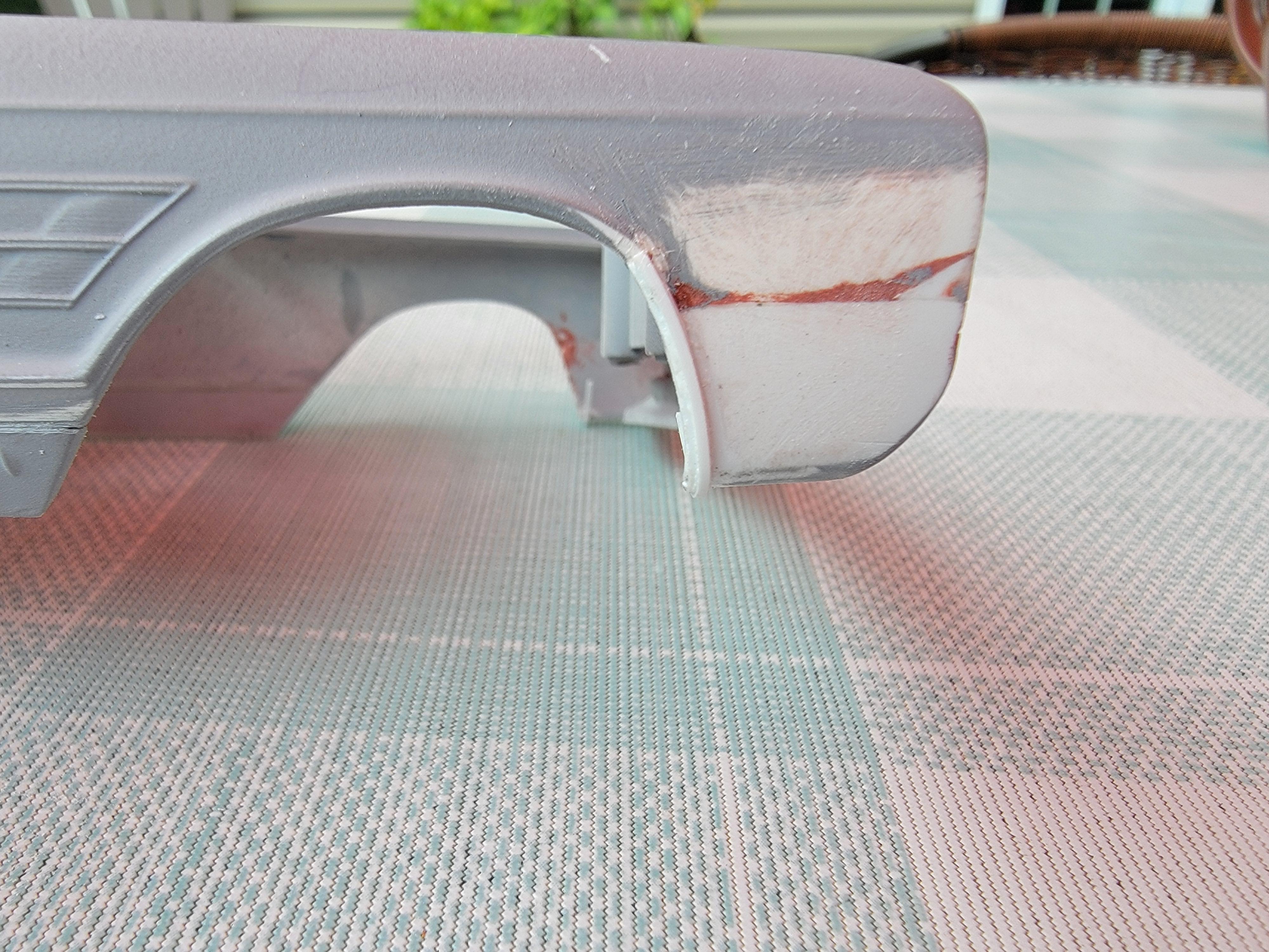

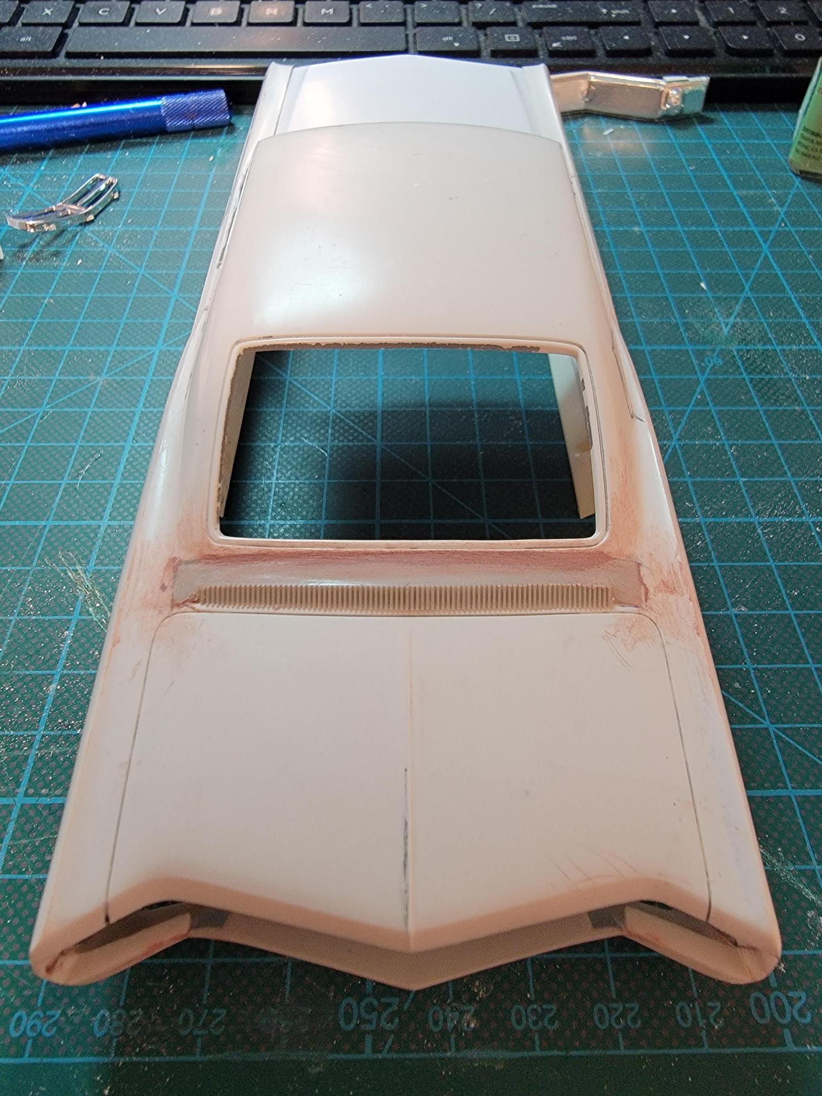

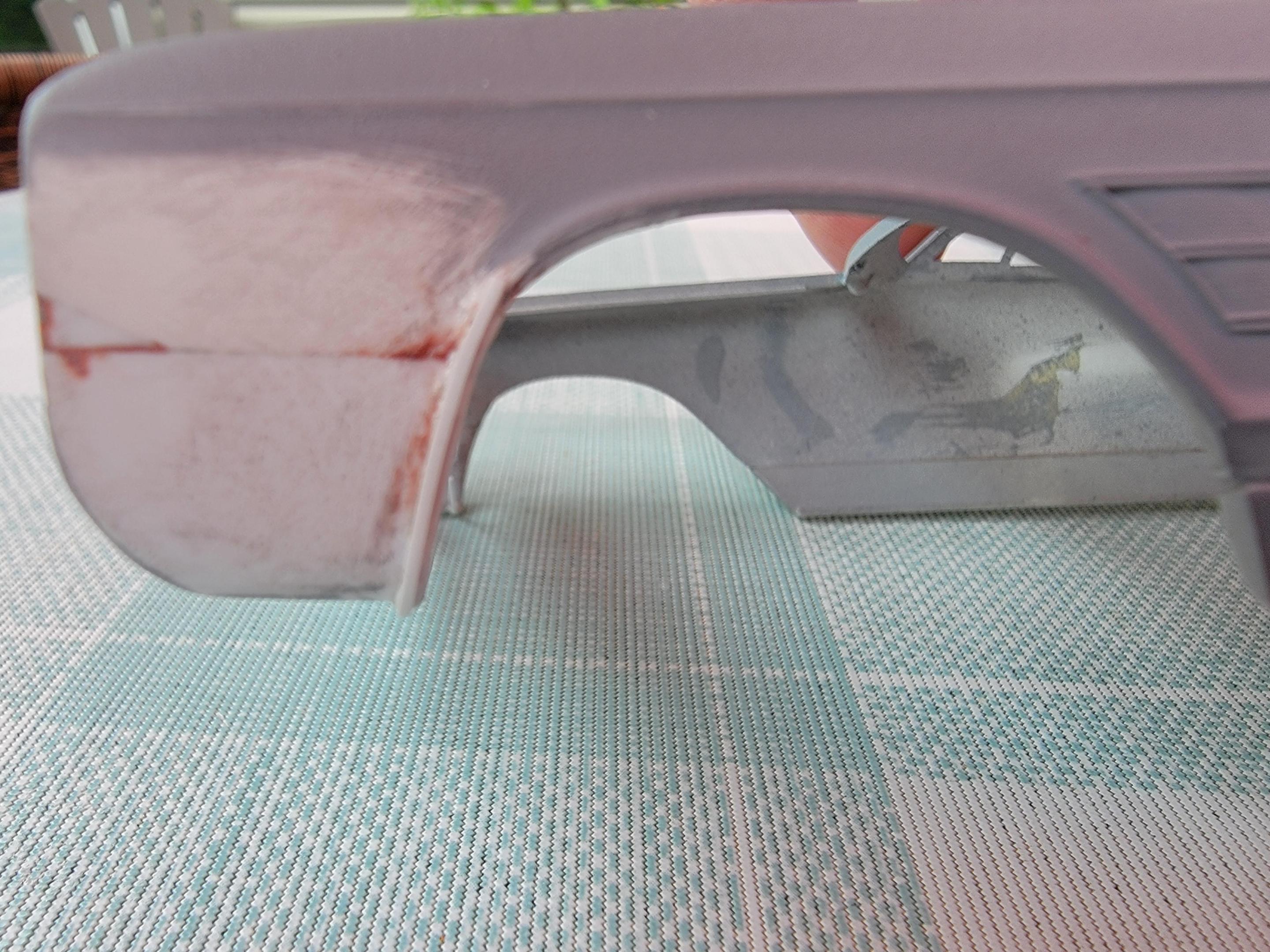

Been sitting out on the deck this morning working on the front wheel well edges. Glued some strips in place and have a bit of sanding and putty work to do on them to get them to shape.. The rest of the bodynis looking ready for a final coat of primer.
Later-

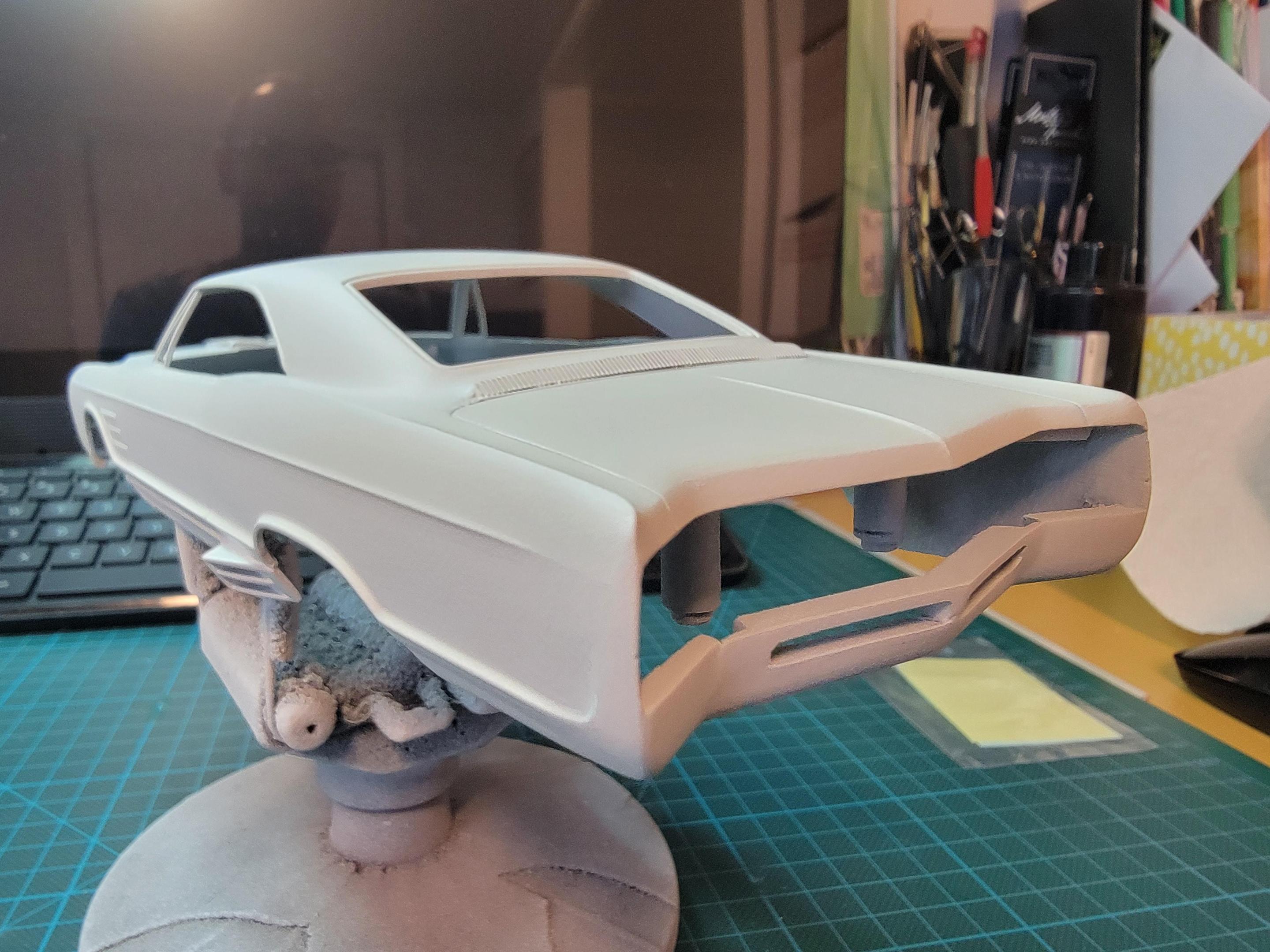

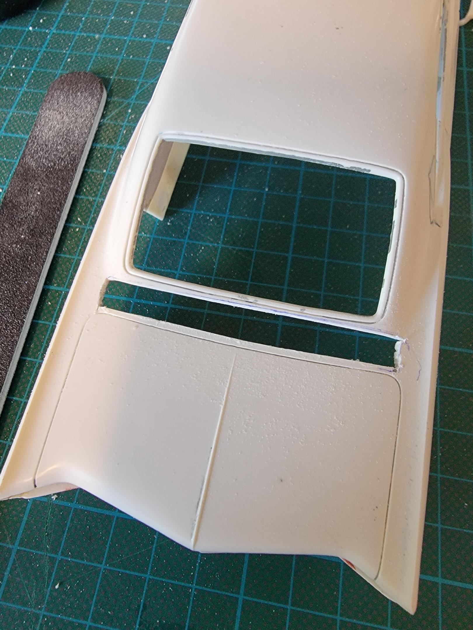

I find the grill work under the rear window interesting. Sort of a flow thru ventilation ?

Either way, I'm digging the custom idea. These are some of AMT's better custom touches, I think. I think the rear panel could make a fairly attractive front grille assembly; just dig out the lights for added depth, foil, and use clear lenses for headlights. Looking forward to your take on this one!

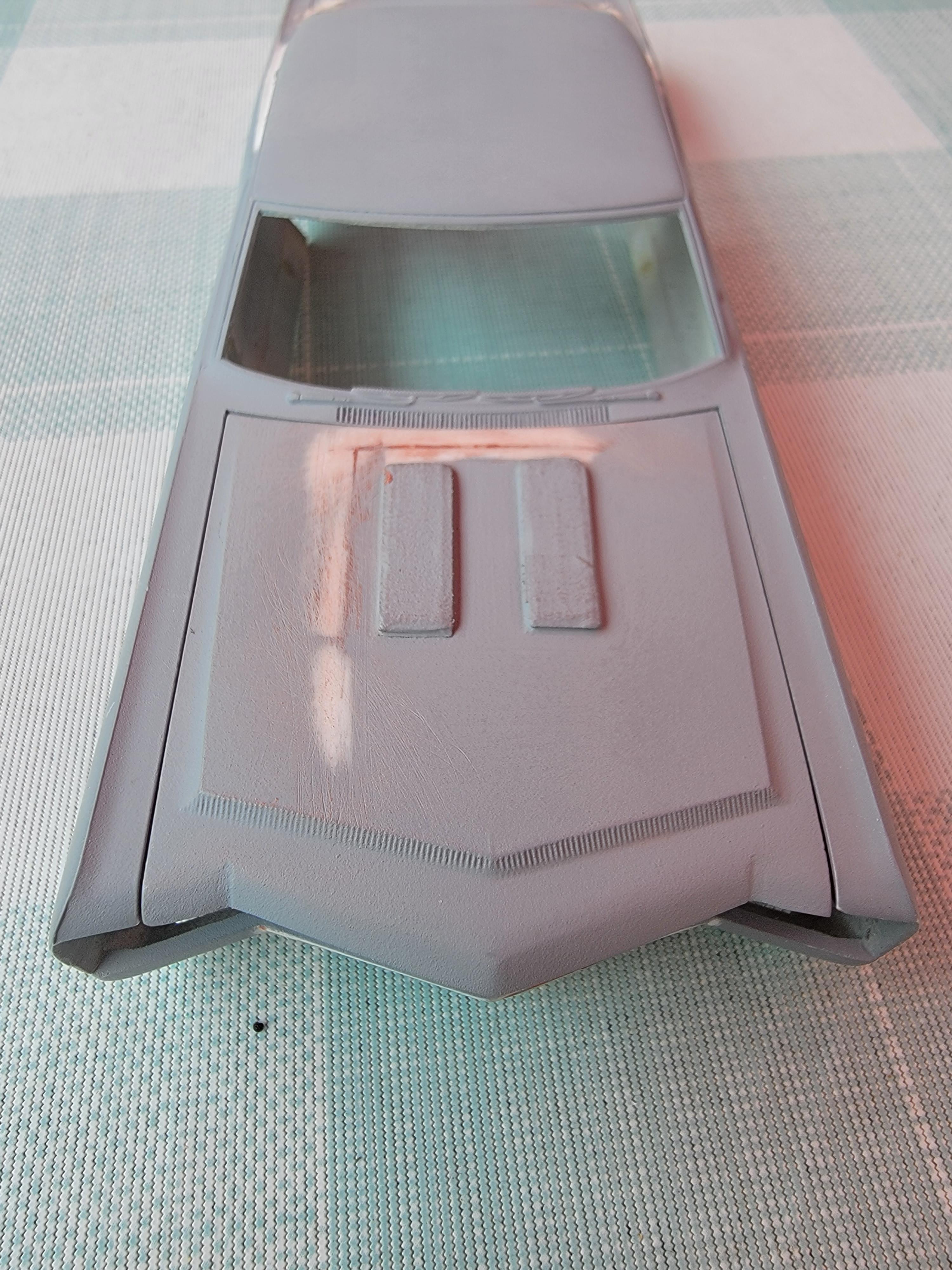

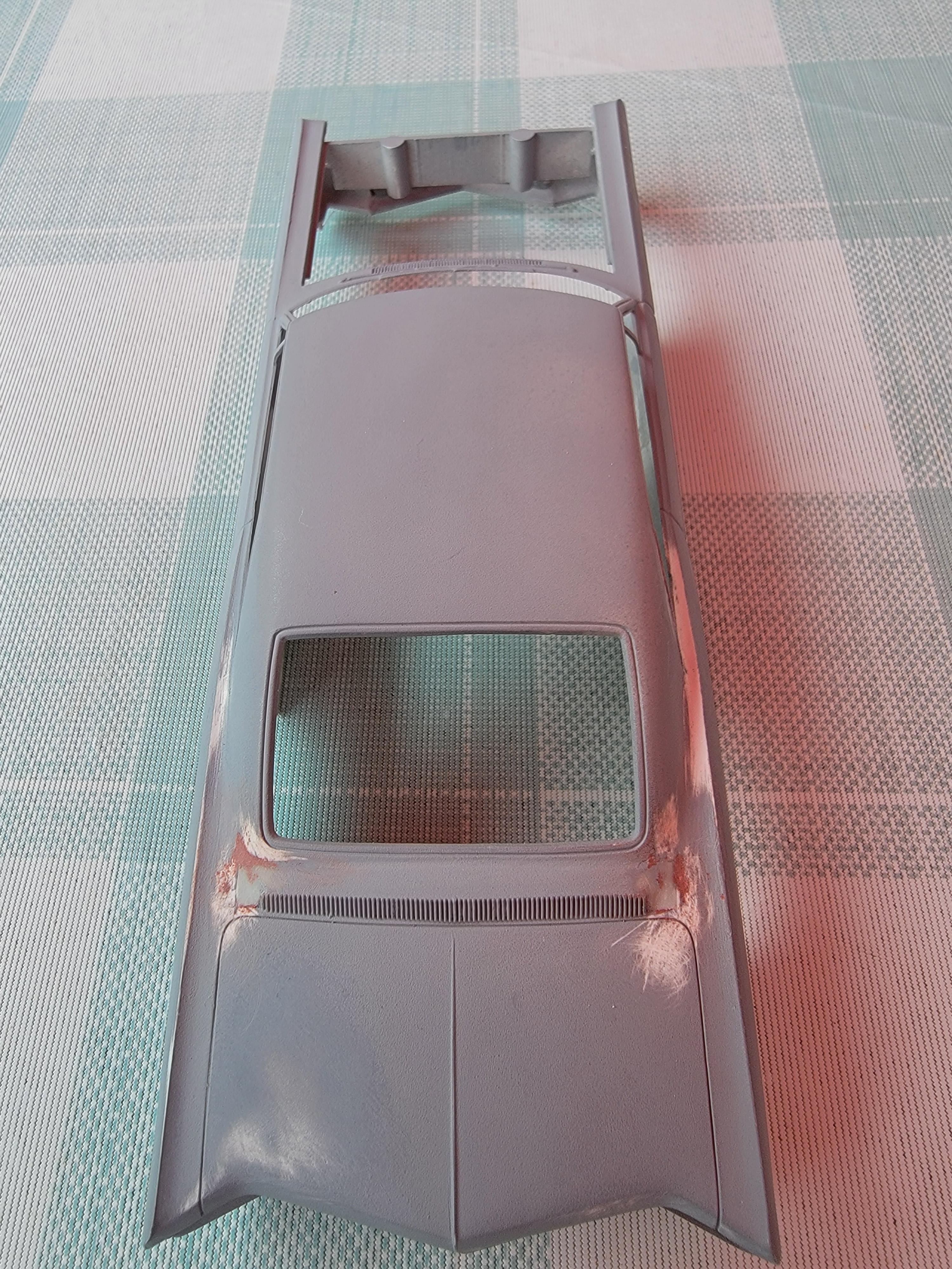

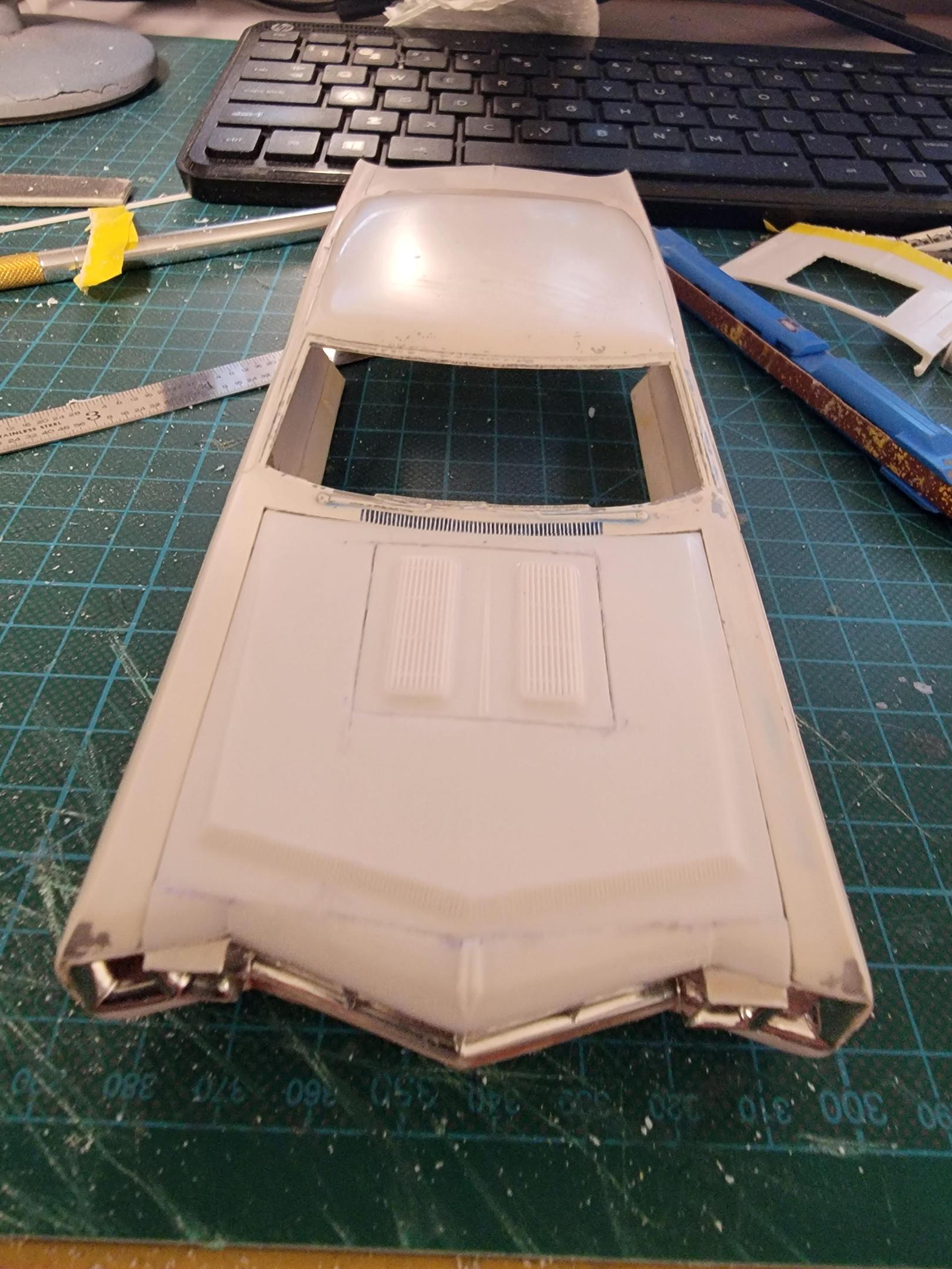

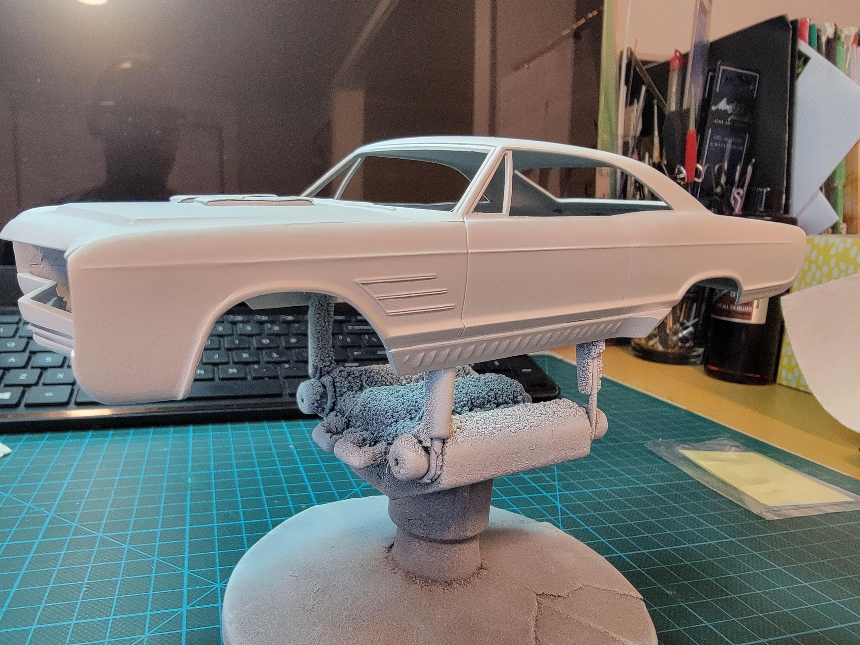

Got the final primer coat on this thing this morning and left it in the dehydrator all day while we went to visit some friends at their campsite. Just got home and pulled it out. Doesnt look too bad. Now to figure out a paint scheme for it. I almost had myself talked into doing a 4 place t-top on it. It may still be in the plans. That will surely lighten the roof.
Later-

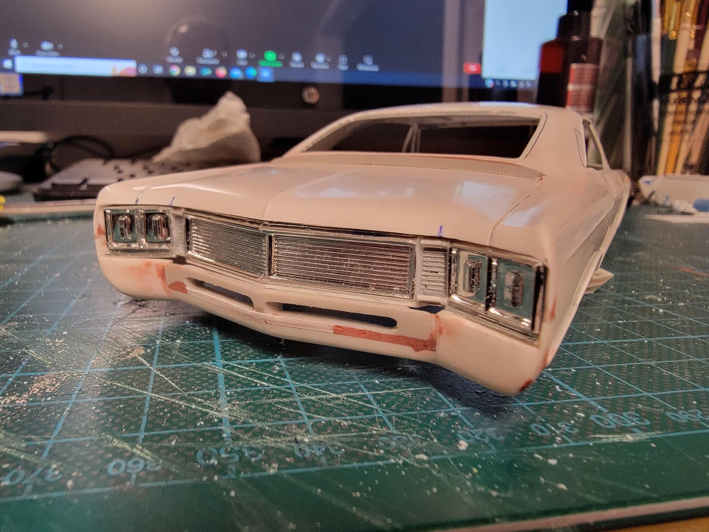

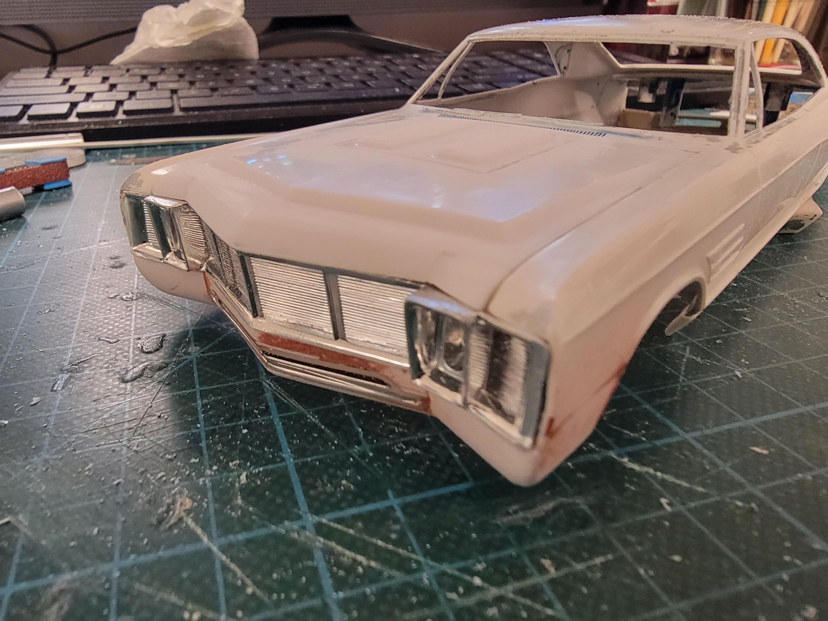

I removed about 1/8 inch off of the bottom of the rockers before adding the pipes so that they would not sit so low.
I have not even included the pictures of how much I had to alter the shape of the grill and the taillight panel to get them to fit. I had to change the angles of the taillight panel and add a couple of sections from a second panel to make it long enough. The added pieces will end up being back up lights set just inboard of the taillights.

Hi Tom!
I see. From my quick examination of the kit parts, I think the "stock" parts (hood, front and rear bumpers/grille) fit the body fairly well. The custom parts may have been rushed in production to meet the requirements, back then, of the "3 in 1" mantra... Just another day at the office for some designer?
CT

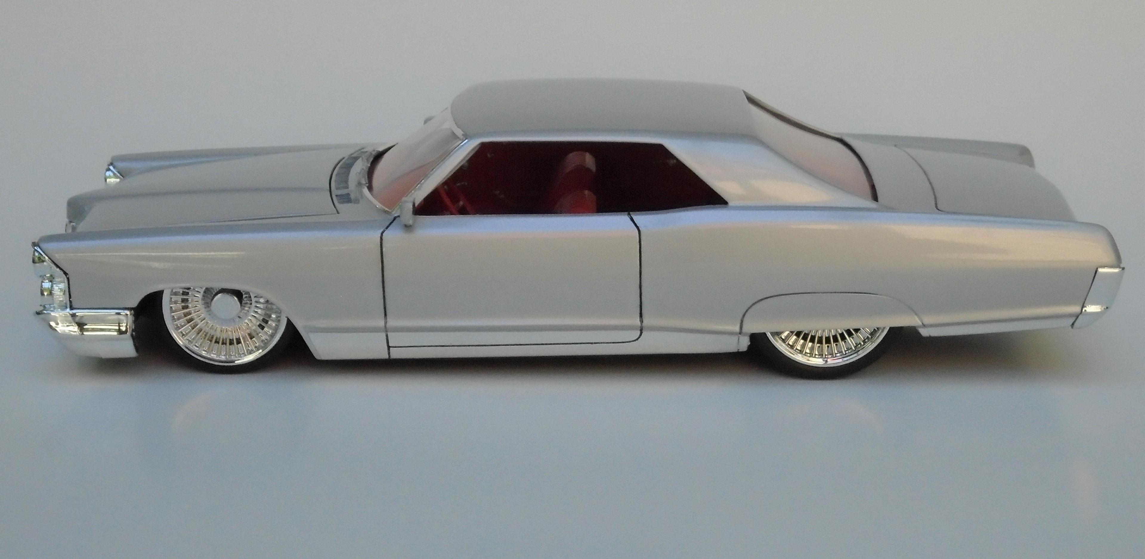

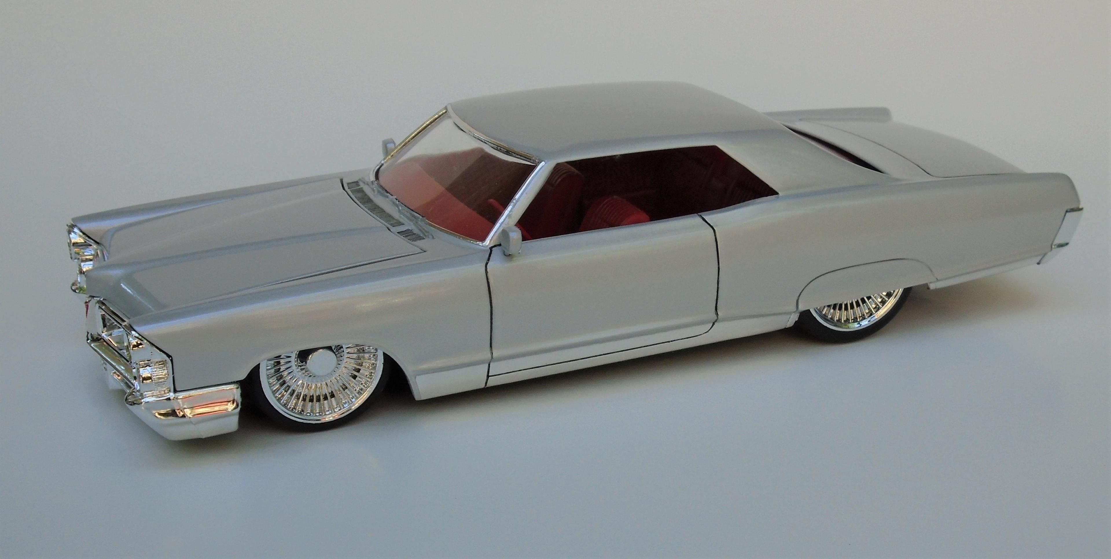

Hi Tom!
Those big GM cars are usuallly advantaged by lighter colors, that make them seem even longer and wider. I made a very minimalist 65 Grand Prix, which is mostly the same car structure, in pearl silver (see pic below). Tamya's grey primer + Testor's White lightning pearl white lacquer (just 2 coats). The silver hue is provided by the primer underneath. Of course, Watson candy shades could be added at will.
Just my two cents...
CT

Wow! Gorgeous car and great color. I like the White lightning over a plain color. I've done it on a couple of cars. I did this 57 Wagon using a Tamiya Flat Japanese aircraft color. Turned out to be a nice pearl blue. Also did the same for the 41 Plymouth with another Tamiya Japanese Flat aircraft color and it made a nice pearl green.
You may have given me a thought to do just a two tone with flats and White lightning. Thanks!
