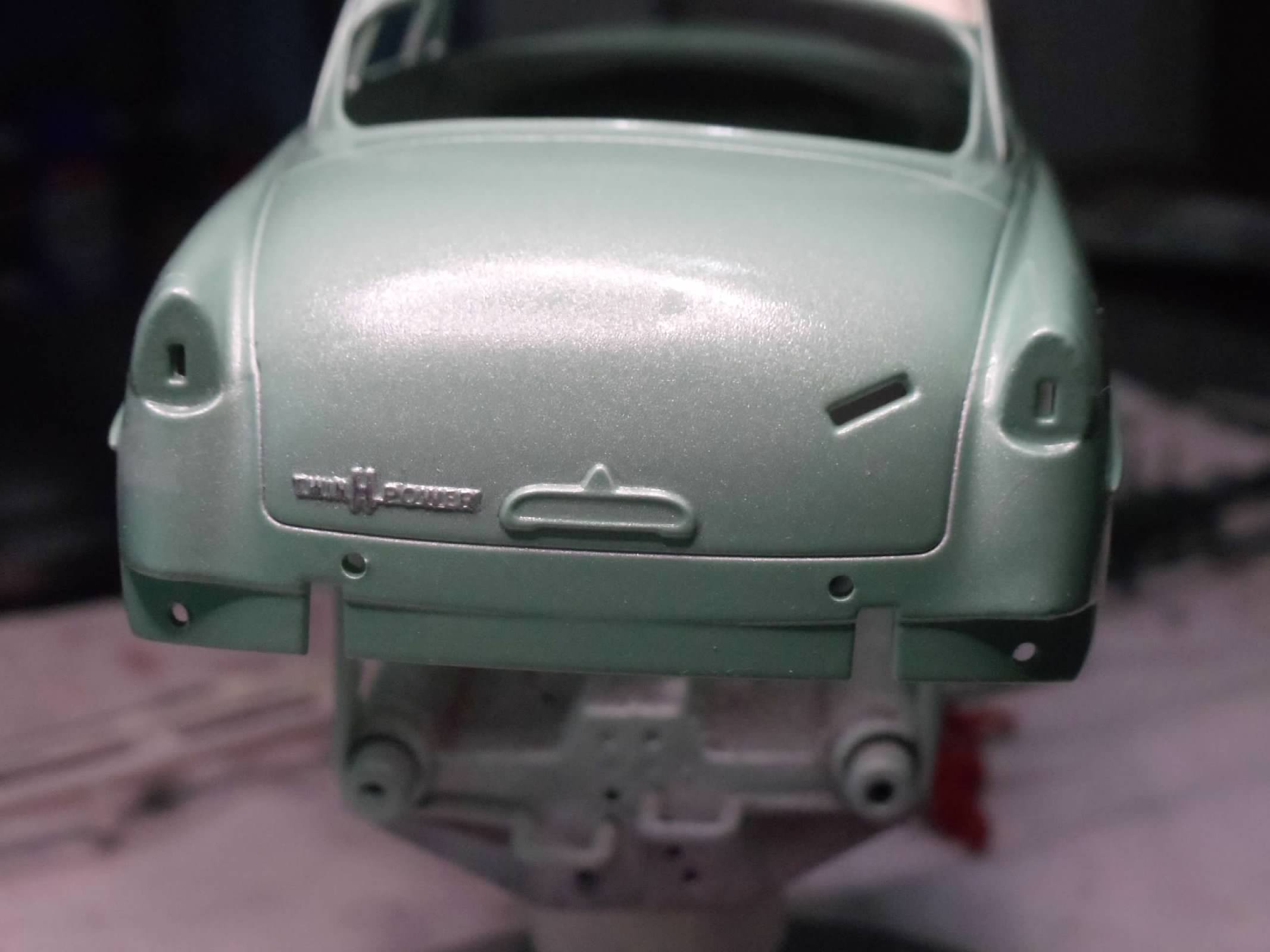

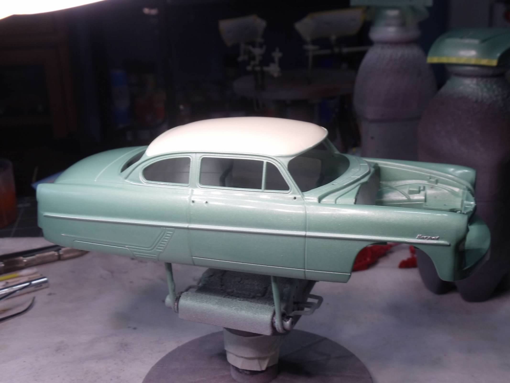

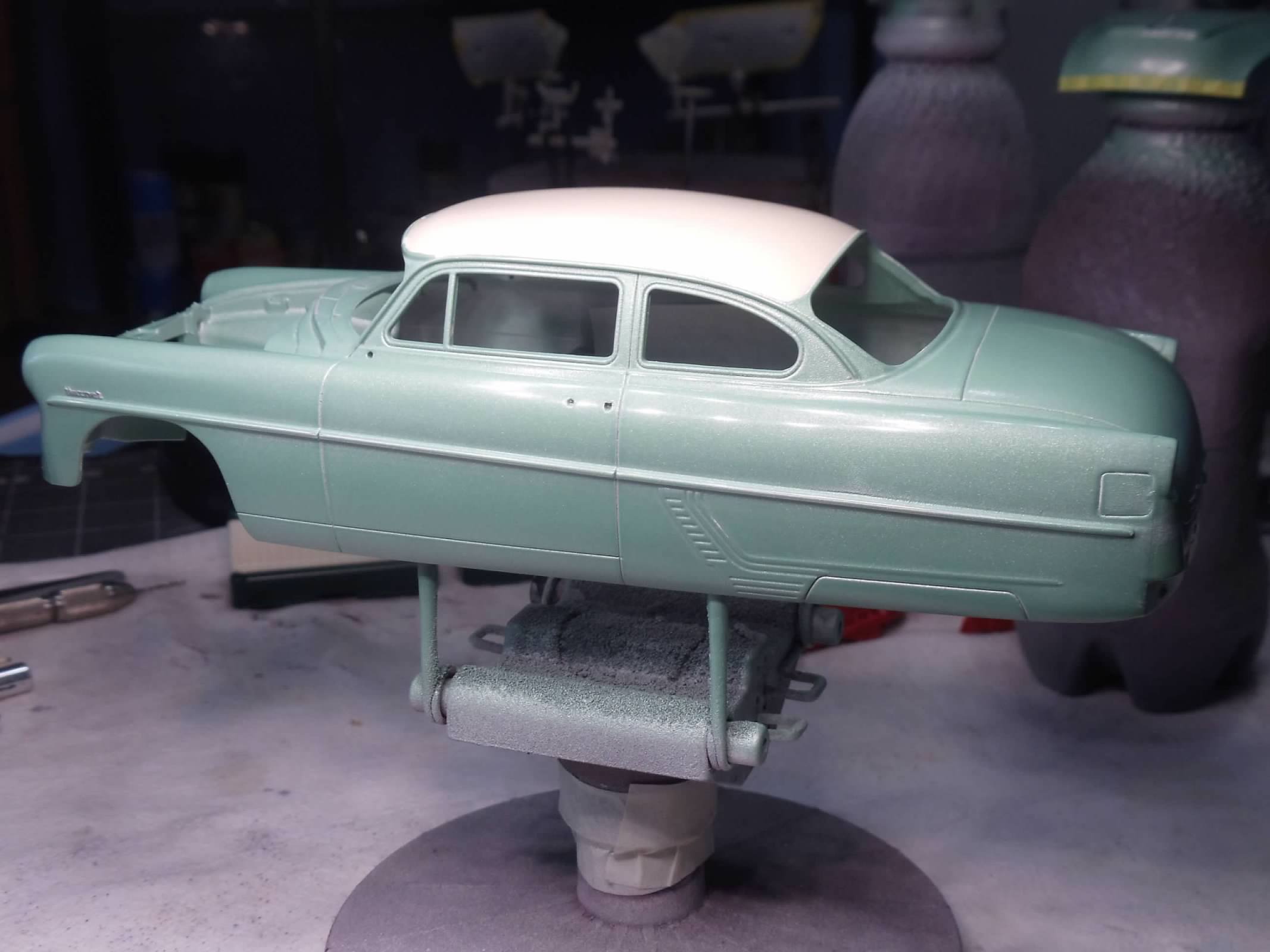

ModelcarJR Posted August 17, 2022 Author Posted August 17, 2022 Thanks, Gary, Dirk, and Carl! I appreciate your comments! Gary, I learned how to drive in a car similar to this one, a 50 Ford. A six cylinder with three on the tree. I drove it forward and backward in the short driveway at our house. Just about the time I got it in gear it was time to stop. In reverse, I often killed it by abruptly letting off the clutch before I went into the street! My actual driver for High School shortly after that was a 58 Chevy which was a tank. I am a Grandpa so you are right! I got paint on it and am in the process of rubbing it out. Also painting other parts. The pictures are a bit washed out in the light. I foiled the body scripts before paint and revealed them with some lacquer thinner and a small Tamiya cotton swab. Hoping to touch it up a bit once the humidity permits. Thanks for looking! ?

TransAmMike Posted August 17, 2022 Posted August 17, 2022 Looking good so far John and when completed I know it will look great. Question for ya...how did you do the emblems, I'm thinking you foiled before painting and rubbed the paint off??

Chevy II Posted August 19, 2022 Posted August 19, 2022 I have the '52 & '53 Hudson Moebius kits. They look to be very detailed. I like how you did the body script. How close did you trim the foil before painting over it?
ModelcarJR Posted August 19, 2022 Author Posted August 19, 2022 (edited) Yes, I foiled the letters after white fine surface primer and removed the paint with a small Tamiya cotton swab sold at Hobby Lobby (I think they are carrying another brand now) after the color coat of paint and before I applied the clear coats. When I applied the foil I first cut in strips, and used a cotton swab and a round toothpick to press down the foil and crimp it into every niche of each letter so that it would stay in place. The I trimmed the foil on top, bottom and sides of the script. For the hood, I cut a strip, crimped down the foil on the letters and then removed the piece in between each letter and cut around each letter. You can actually read the letters even though they are very small. I thought about using a chrome pen but they would turn silver every time I touched them. Even a clear coat over the chrome pen will dull the finish. So I think foil is the best approach. Once I had rubbed out the paint, I added some paint in a few areas (the cowl area and the lower rear left side) where I had rubbed out too much paint. Once that was done, I added another coat of clear to the entire body and rubbed it out with some Scratch-X and added some wax. It has better color now in photos. I am in the process of foiling and would like an opinion from any of you. Does the lower chrome trim look better on the left side or the right side? I used some blackwash on the left to give it a little more depth in this thin trim. Let me know what you think. Thanks for looking! ? Edited August 21, 2022 by ModelcarJR grammar 2
