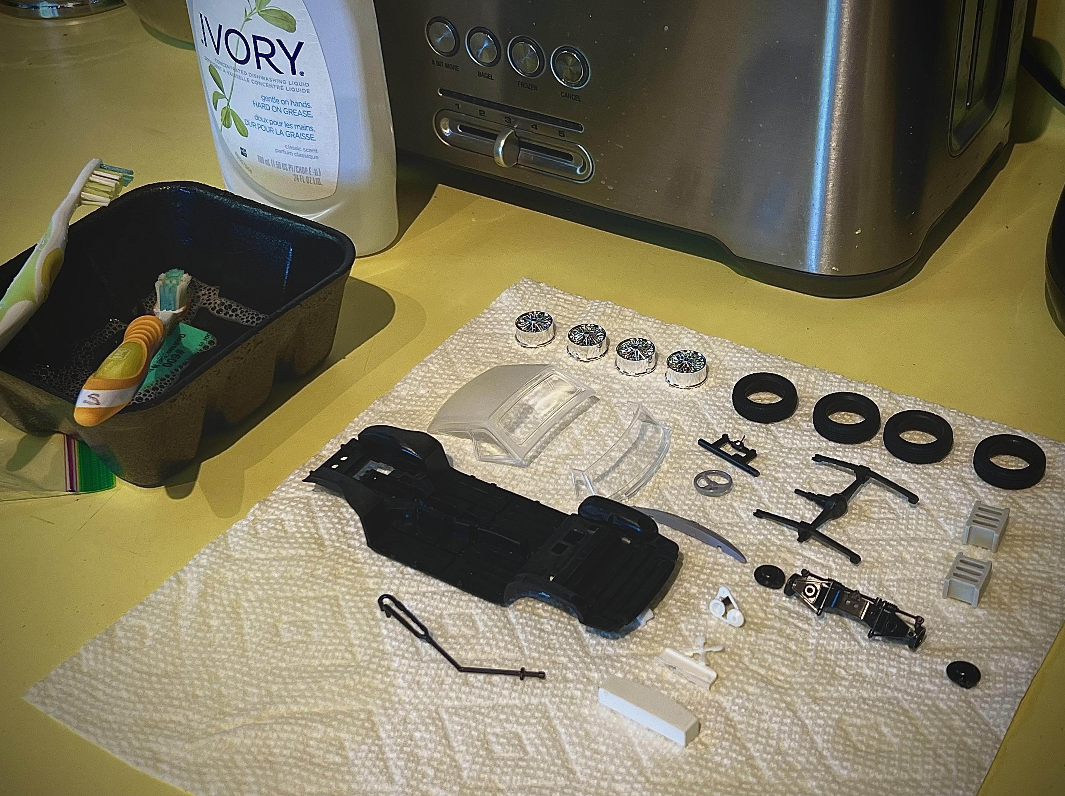

Over the past week I’ve been able to move along on the build, main objective is getting parts primed, then paint and assembly. Prep remains key to a better result, so most of today has been spent in the kitchen! My usual routine is to wash the parts with Ivory soap, rinse and dry. Many dish soaps contain a silicone-like additive to make dishes shine, yet Ivory remains pure; you can tell by the squeaky clean feel of the plastic.
Avoid drying by using a rubbing action, gentle soaking up wet spots with a paper towel prevents static build up. After air drying the first step will be to give the parts a blast with the airbrush followed by a sweep with an anti-static brush just before applying paint.

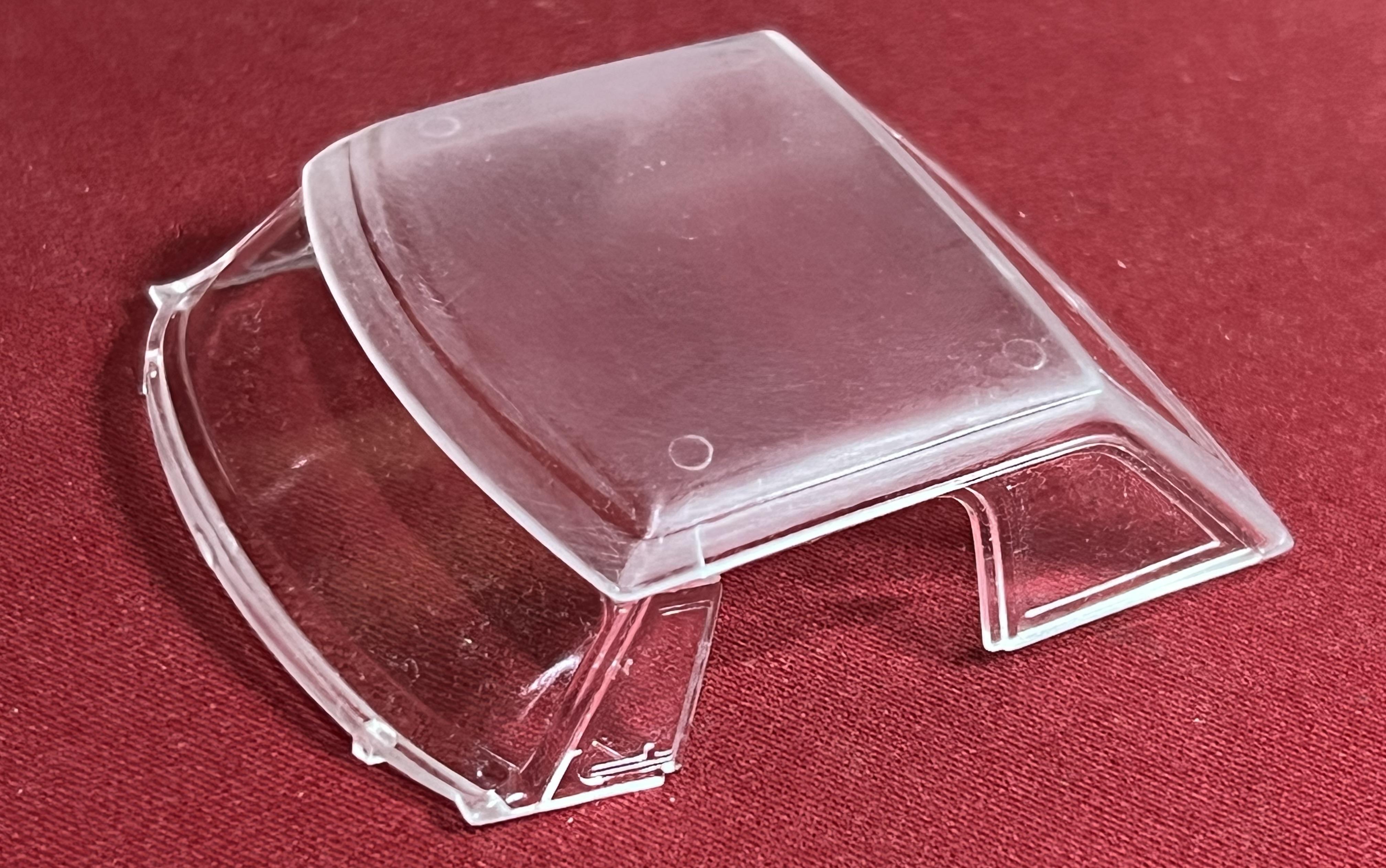

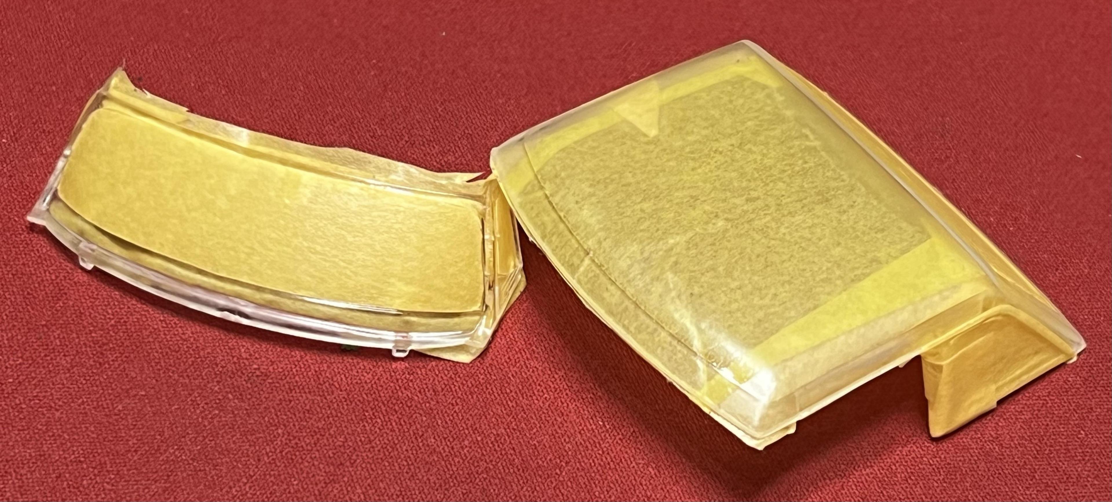

Prep began with the clear molded pieces for the windscreen and fibreglass hardtop. Being careful of the clear portions, a wet sand with 600 gave a tooth for the primer.

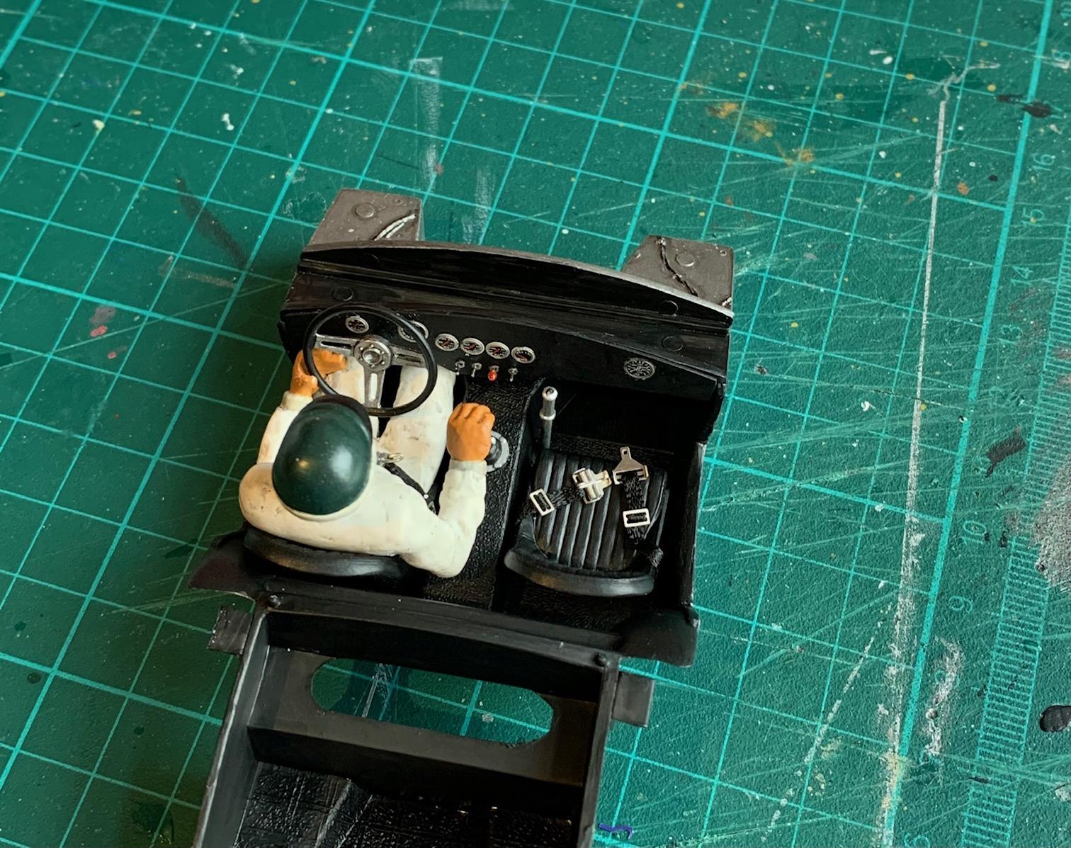

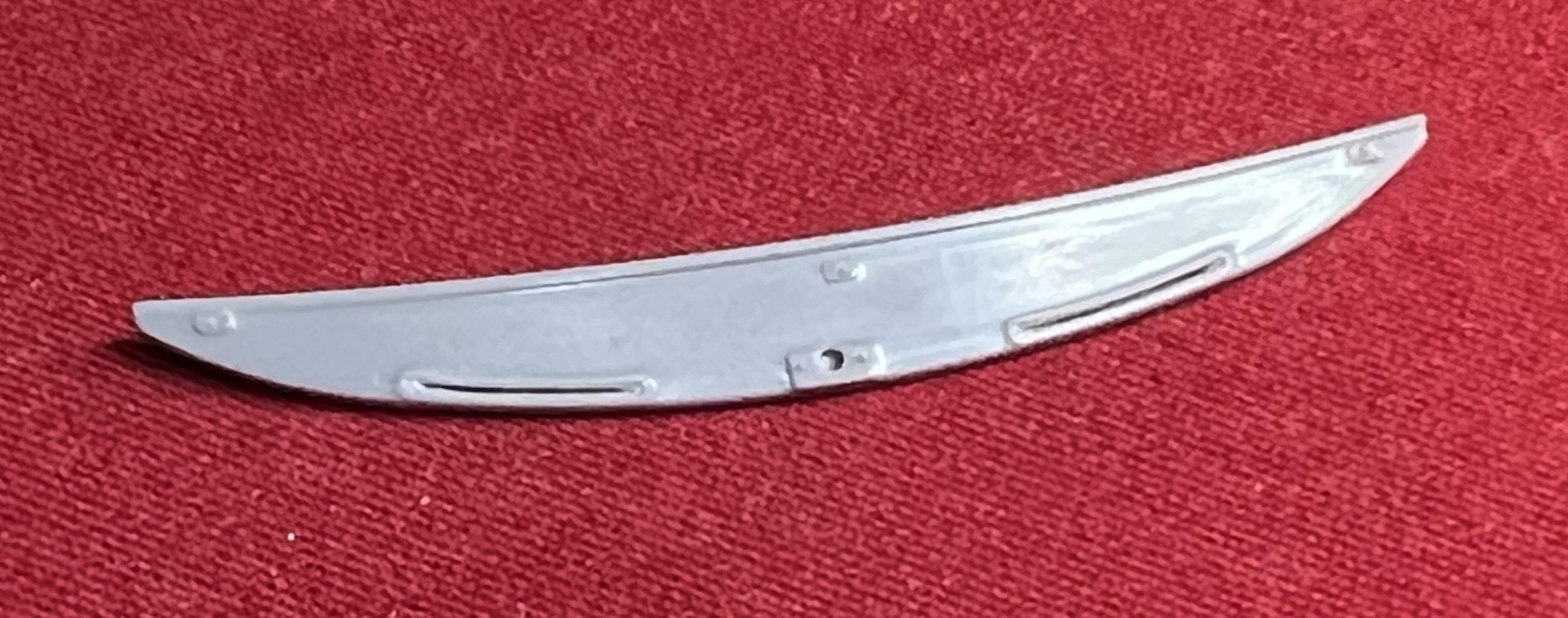

Using my new Tamiya scriber that I picked up at the DSC I deepened the de-misting vents on the dash top to add greater depth to the final look.
IMG_7554.jpeg.d91950f1066ba494012d4f21afe5b9d9.jpegIMG_7558.thumb.jpeg.0b18a465ad0f447d2fe41155a20355ad.jpeg

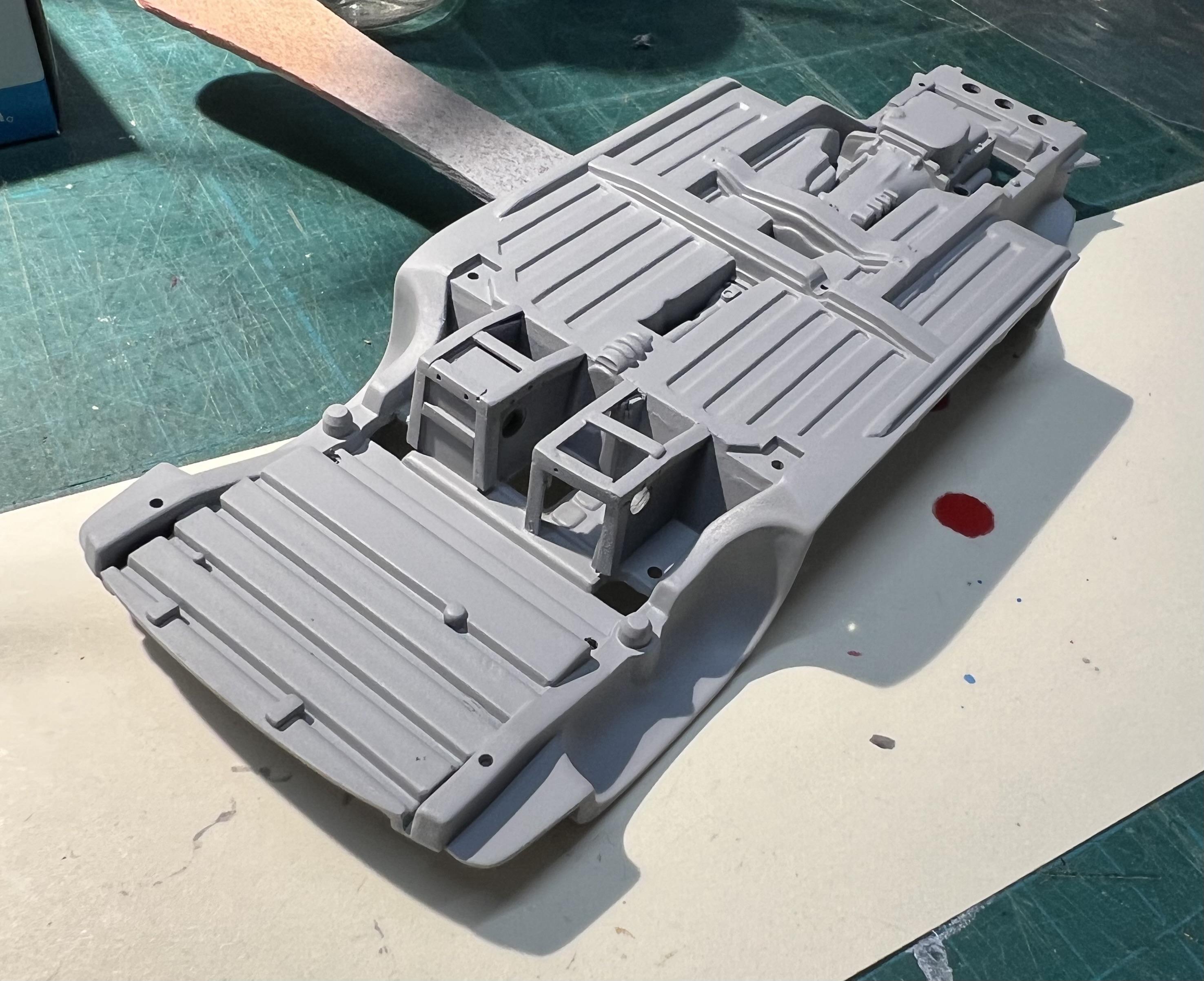

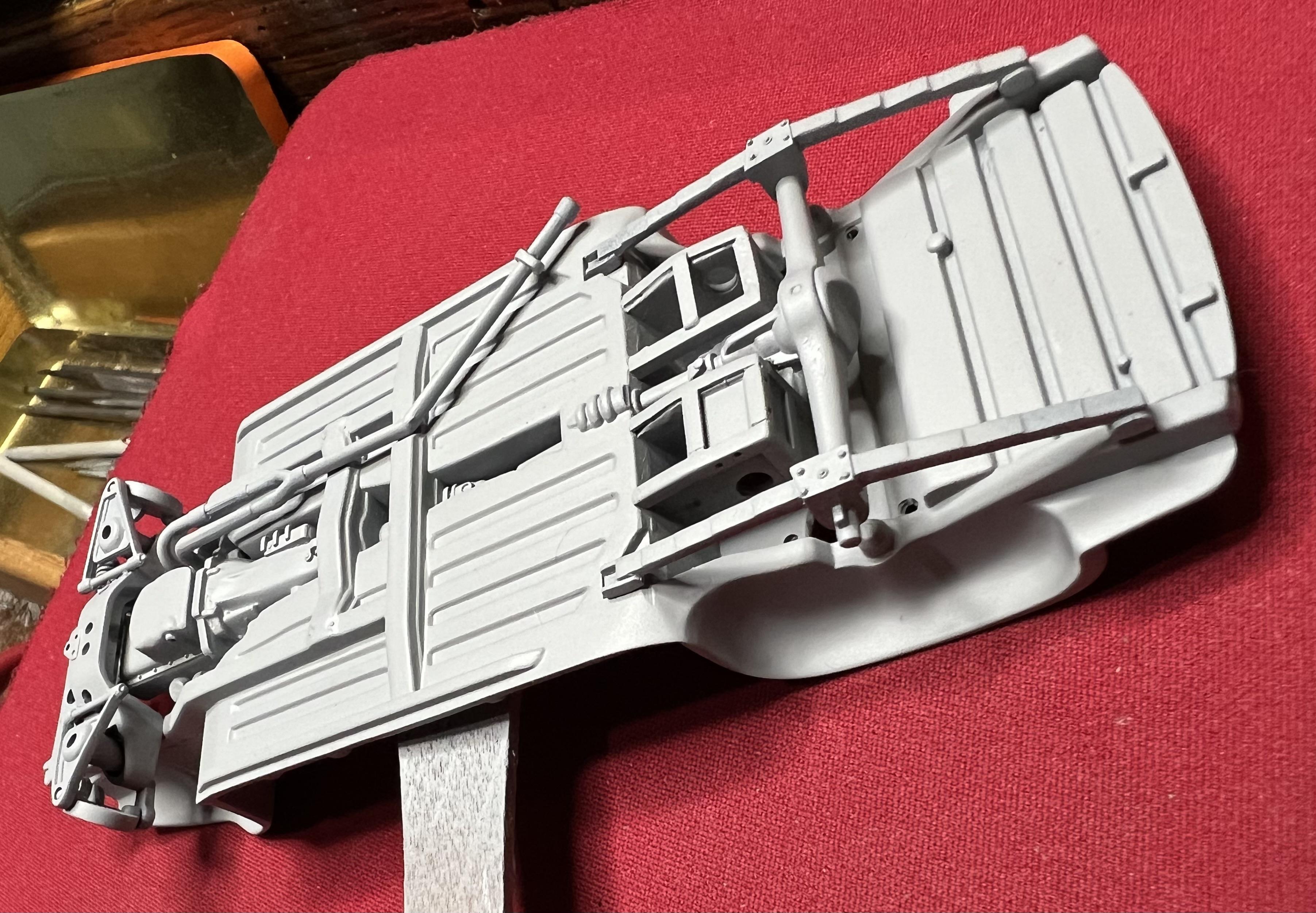

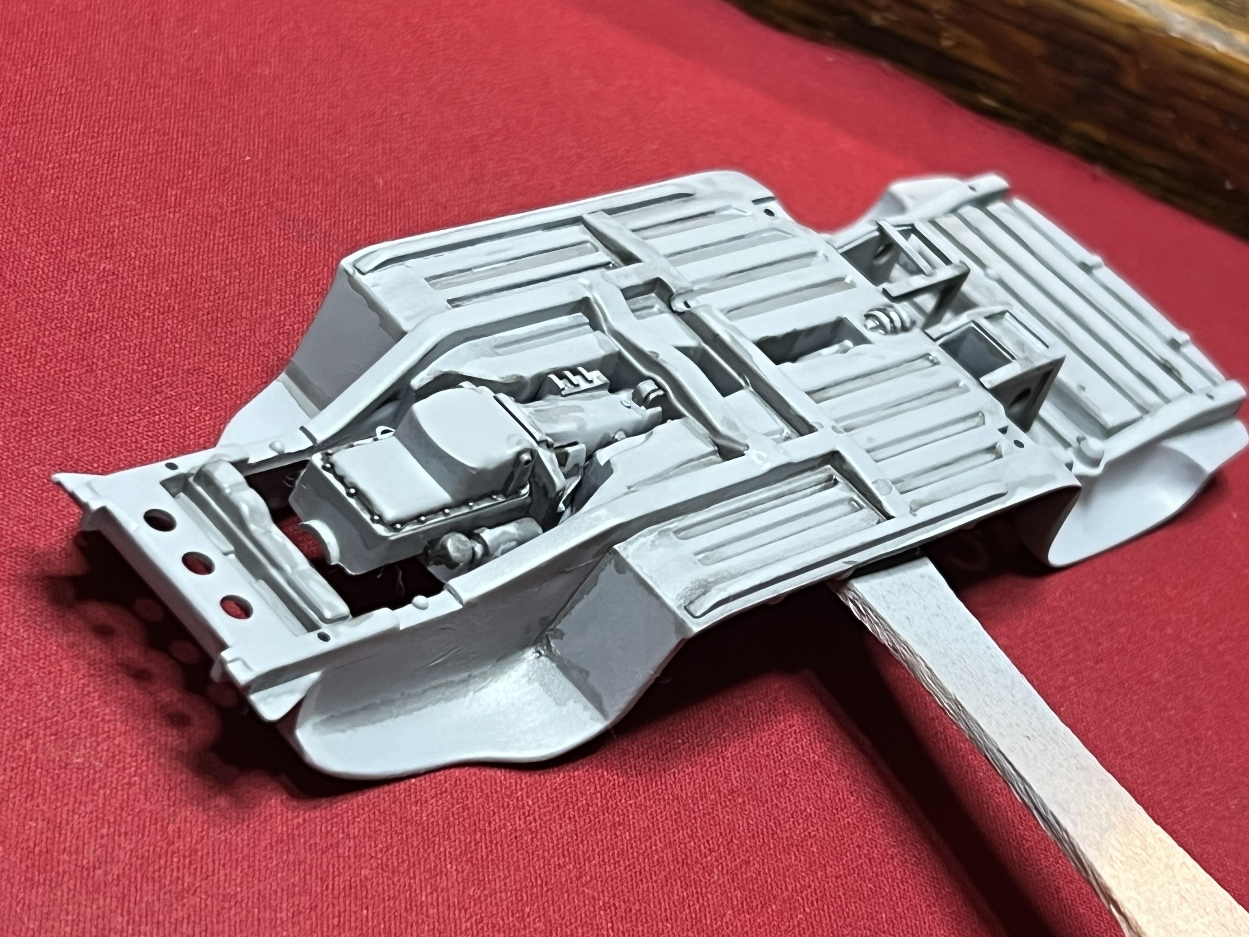

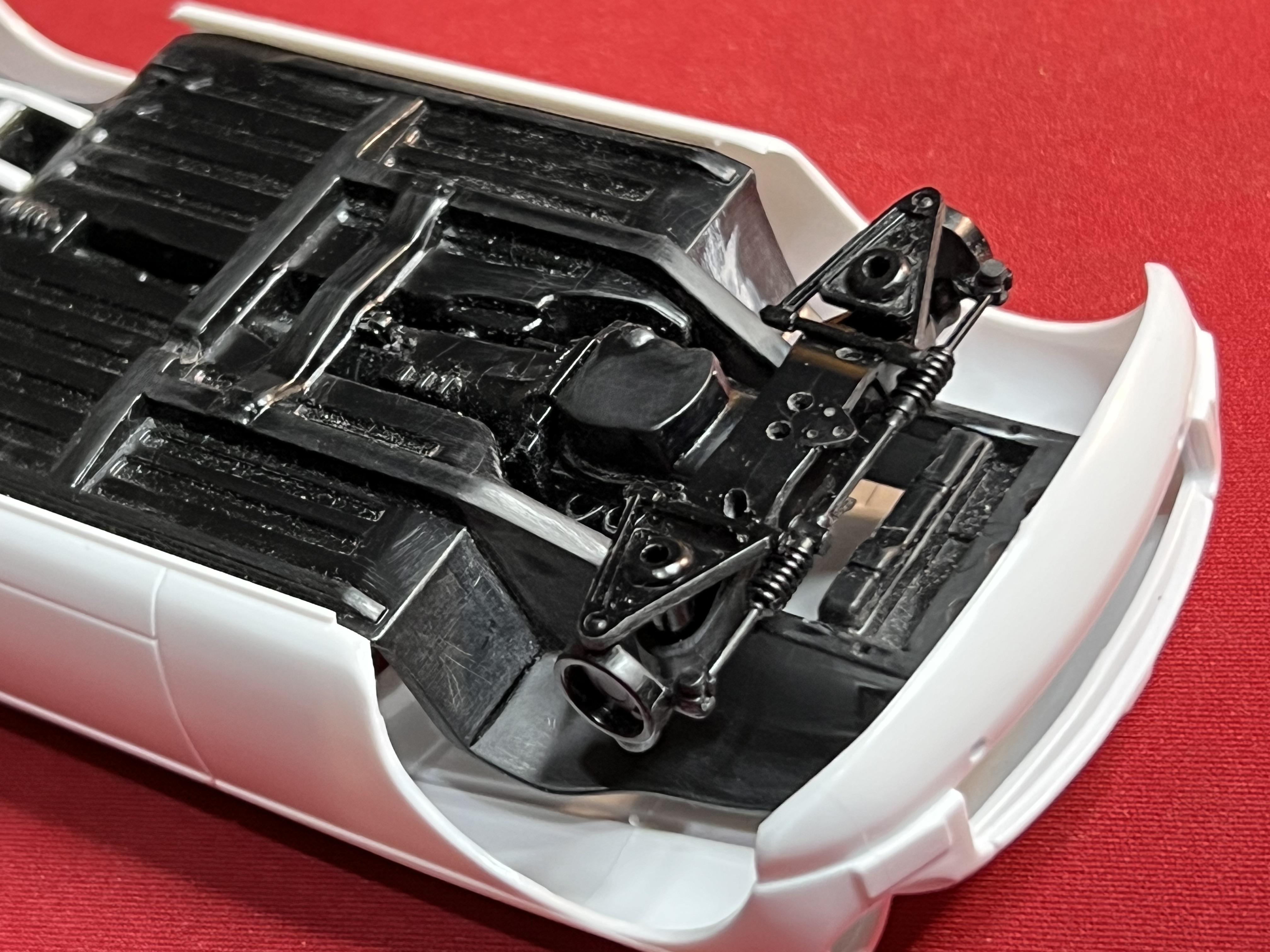

The front suspension builds up into a single assembly to attach to the frame of the unibody chassis. Using my spare body with the chassis I mocked it up to determine if it needed to be lowered. Comparing the photo to the model the front required a slight adjustment, roughly a scale one inch drop to place the wheels higher up in the body. This was easily done by sanding the suspension’s attachment points to the chassis.
IMG_7711.thumb.jpeg.5cf896368924a37c25e7e22620bd8b7a.jpegIMG_7712.thumb.jpeg.ddb980b046c8c25d205e04273a04941b.jpeg

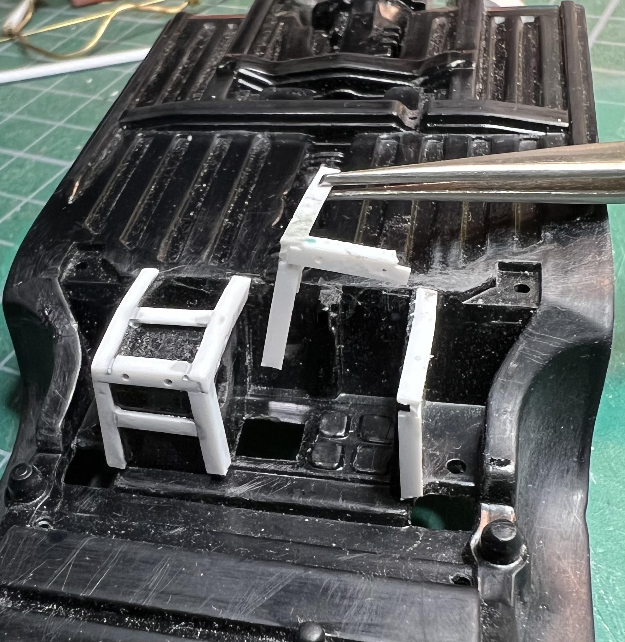

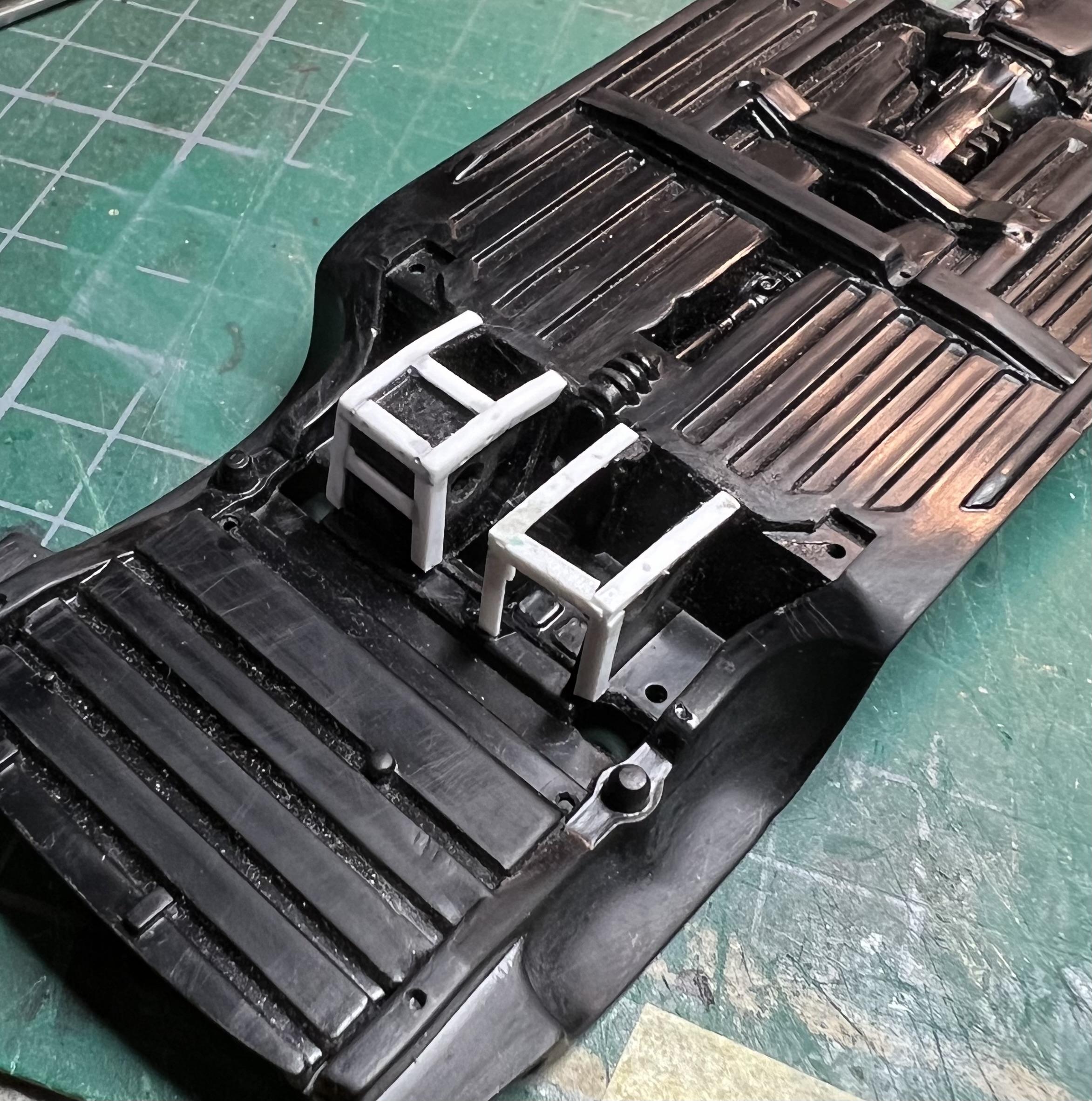

I decided to complete the chassis detail by adding the empty cage opposite the battery. This required careful measuring and assembly with Plastruct lengths.
IMG_7639.thumb.jpeg.104d33004d5886b0a35e2e722f046e66.jpegIMG_7709.jpeg.4a29b6e56bf30a7183b592dae63f67cd.jpeg
As the driving position has changed to LHD the steering column needed to be flipped due to the signal light control. An injection mark needed attention as did the bulbous, out of scale control stalk. Using a section of brass rod with the end tipped in white glue to represent the end of the control stalk a much improved look was achieved.

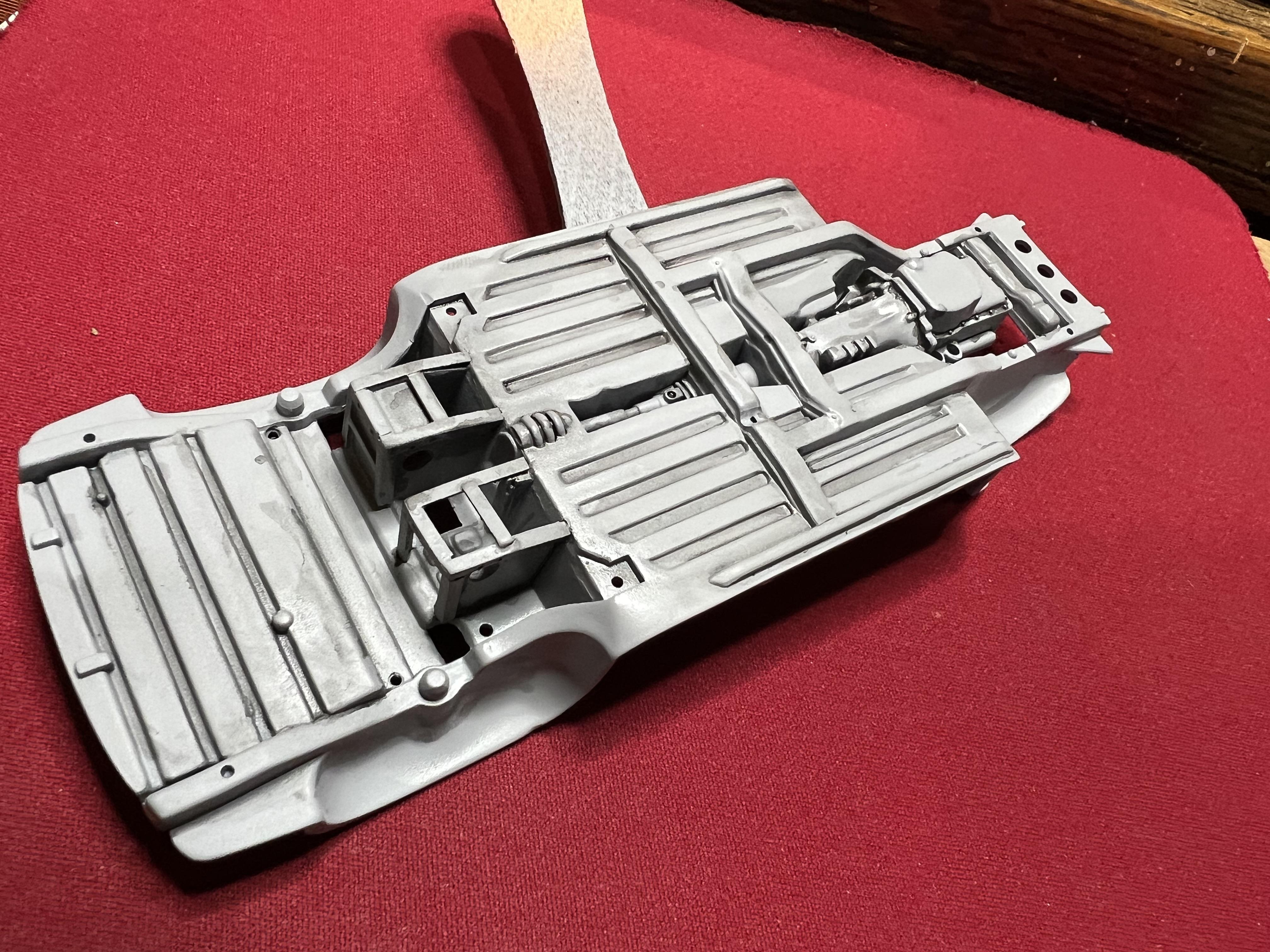

With chassis detail completed at this point it received the first primer coat as did a number of other parts.

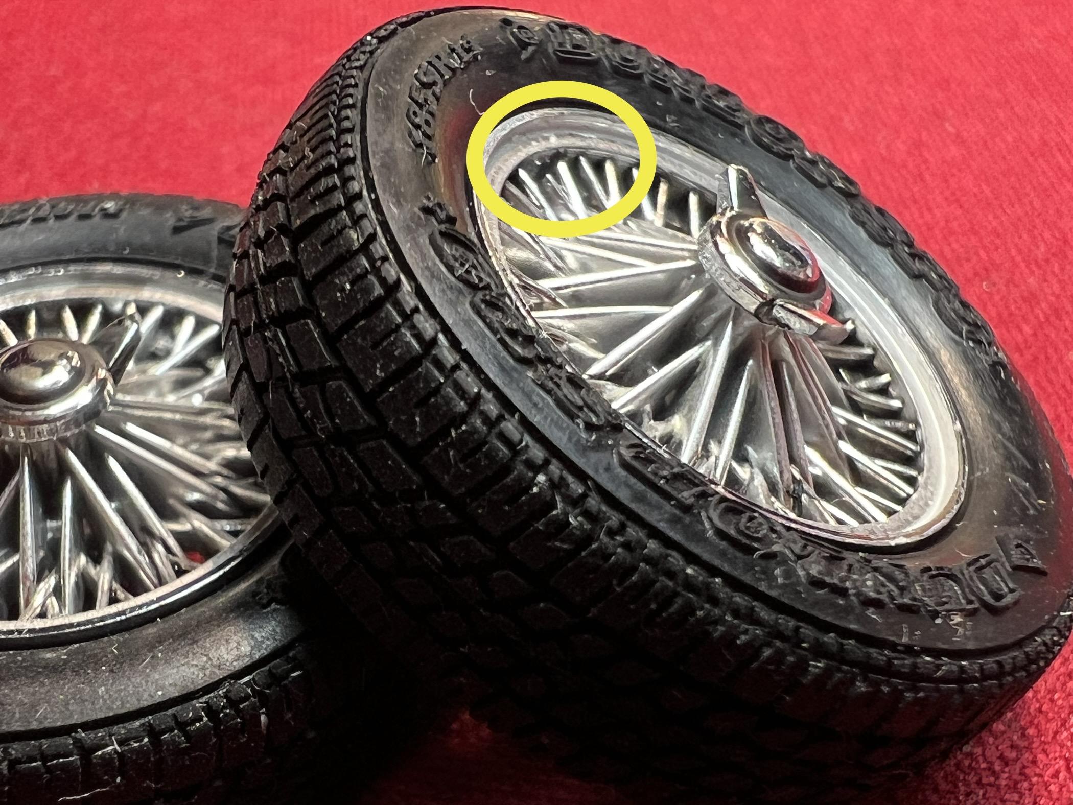

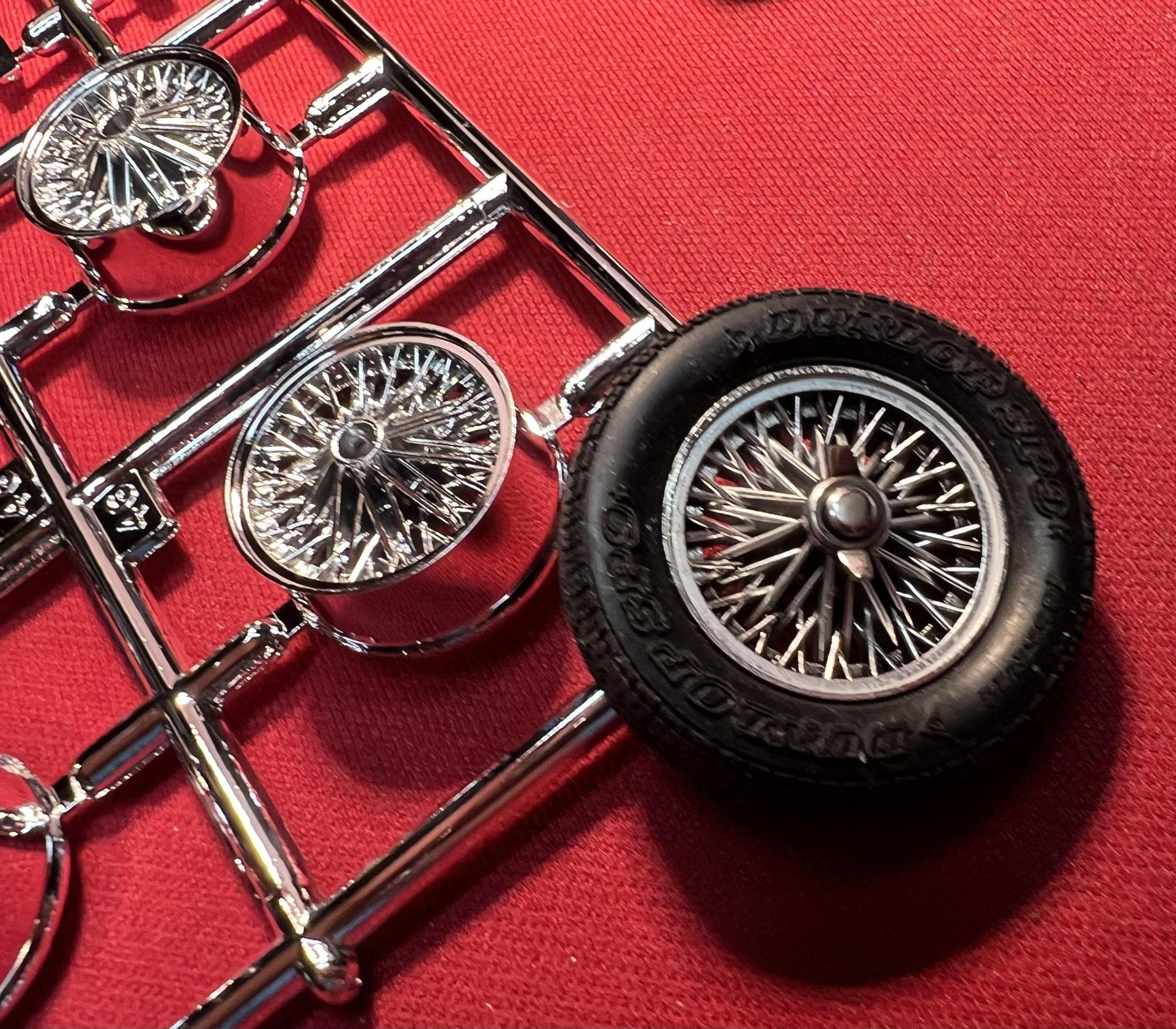

Thankfully Norm Veber included instructions to use a #77 drill bit for the install. Originally I dreaded attempting to achieve a decent job because of the tiny parts, yet I found it to be very slick. Drill at the appropriate spot, cut the valve off its sprue and using quality fine point tweezers dip the stem in white glue and install!
The tire valve is circled above. One needs a magnifier to spot it, yet I know it’s there.

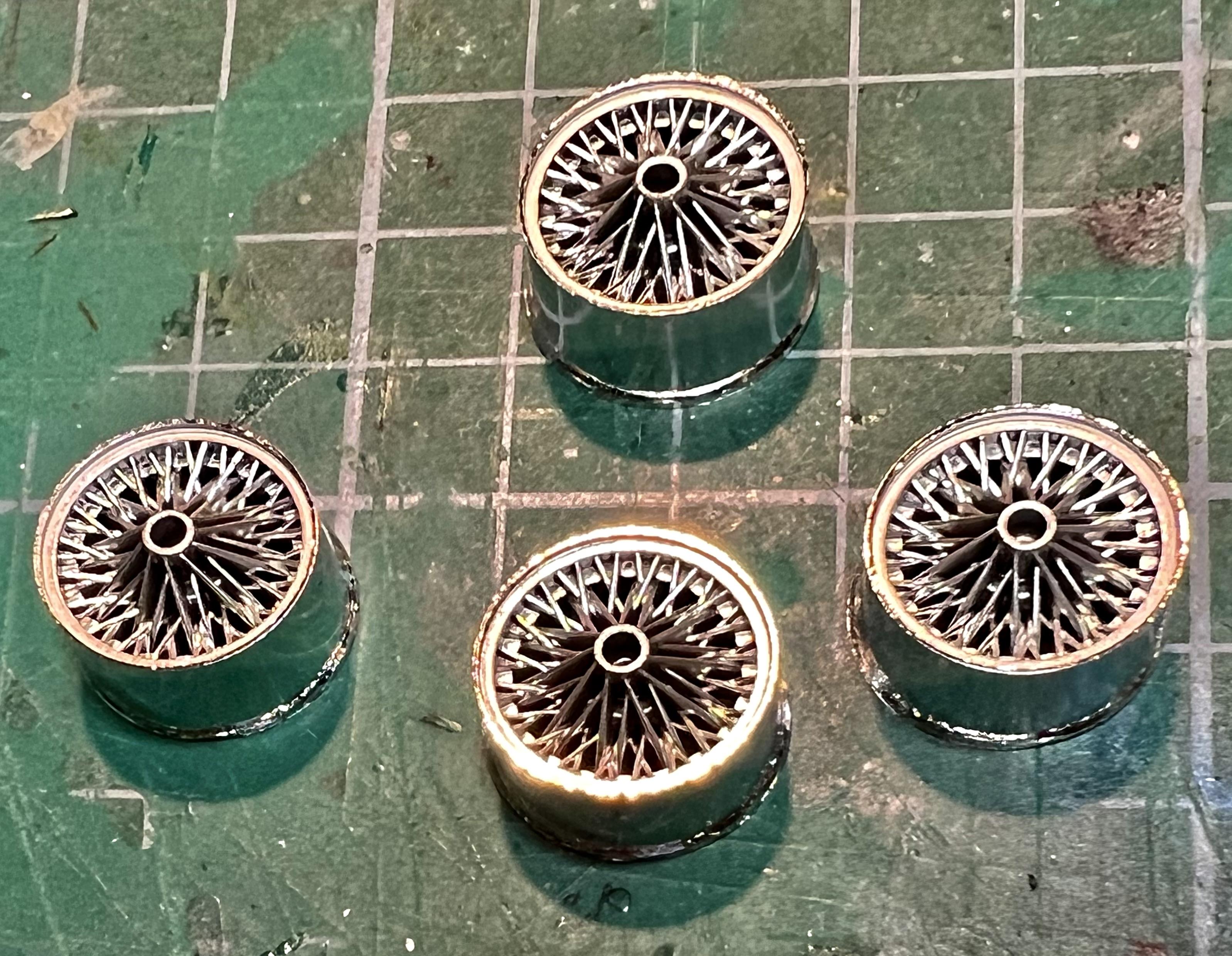

Above is a comparison between the finished wheel to the original on the sprue part.
This shot shows the excellent rendition of wire spokes for an injected piece. Now 3D modelling offers much greater fidelity. Below is the actual wheel on the original car.

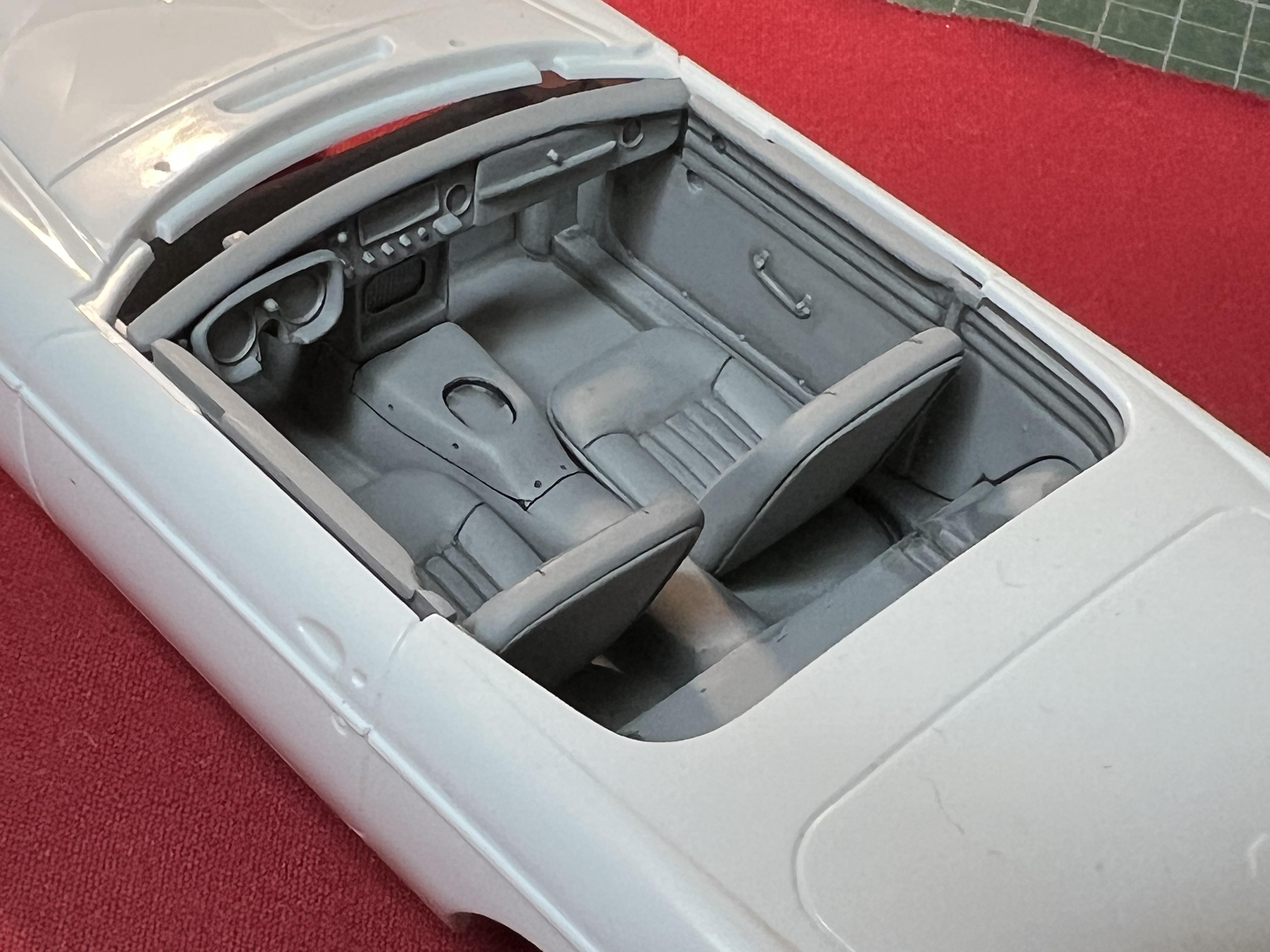

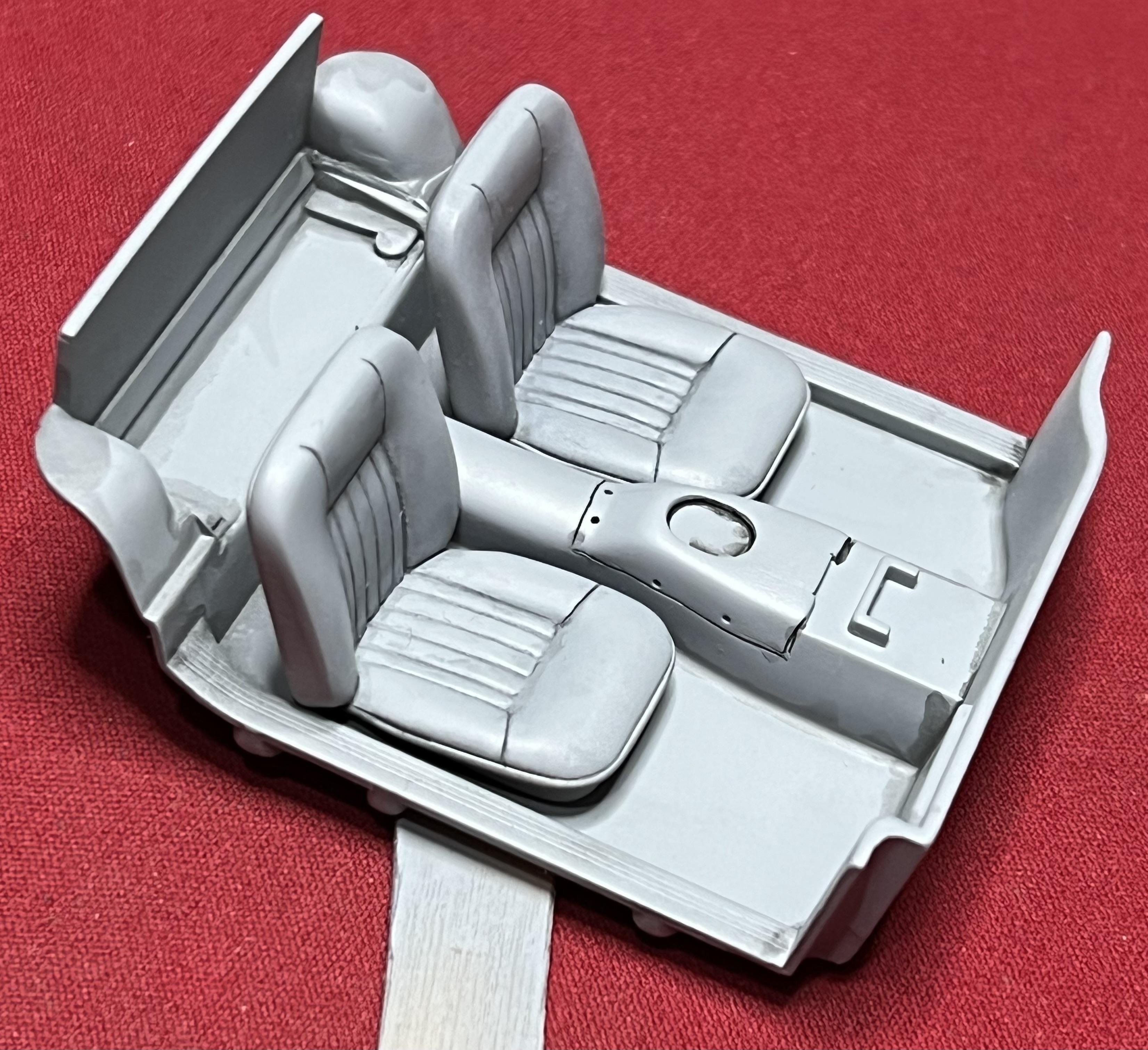

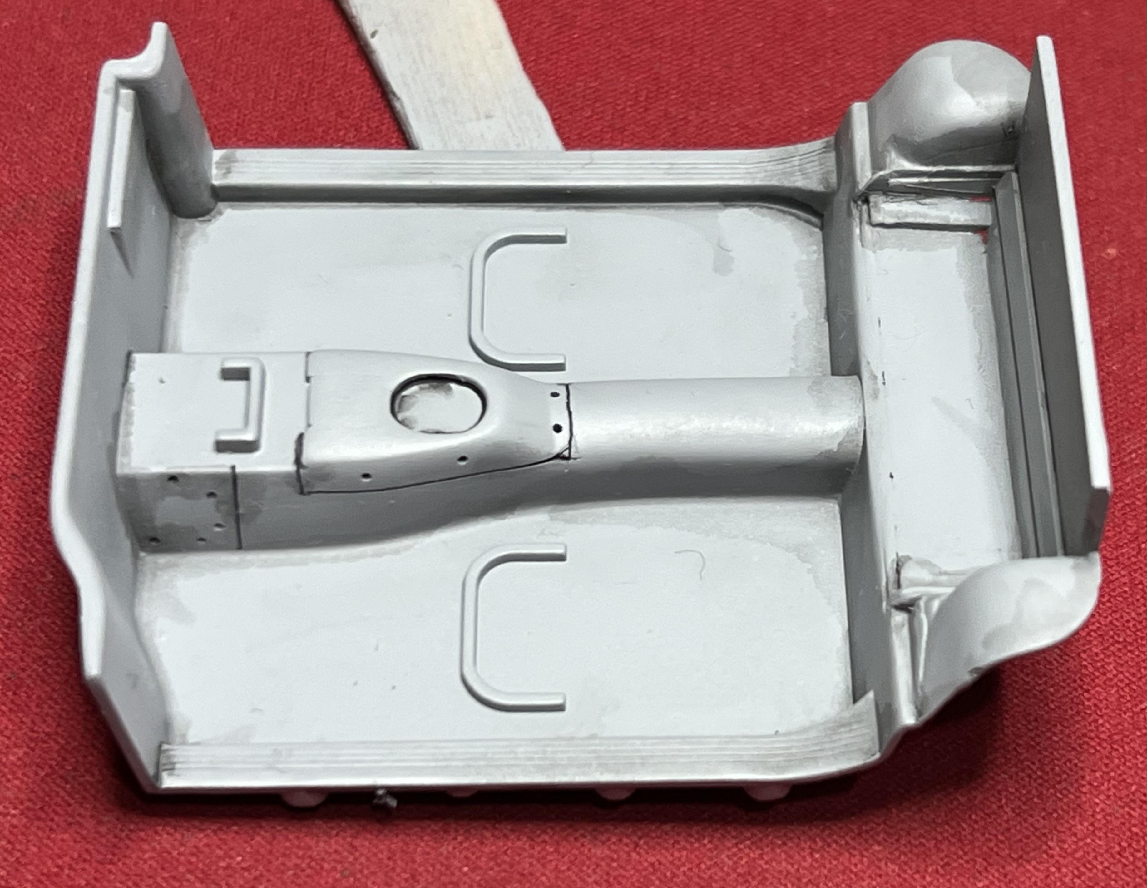

With the interior a more liberal wash was applied, then cleaned up with mineral spirits. The aim is to create shadows to achieve greater depth perception for realism.
IMG_7919.thumb.jpeg.f08cb2a34b557abad7099b790561546b.jpegIMG_7918.thumb.jpeg.033fe83ec7d3f320406c5c6a7278e29a.jpeg

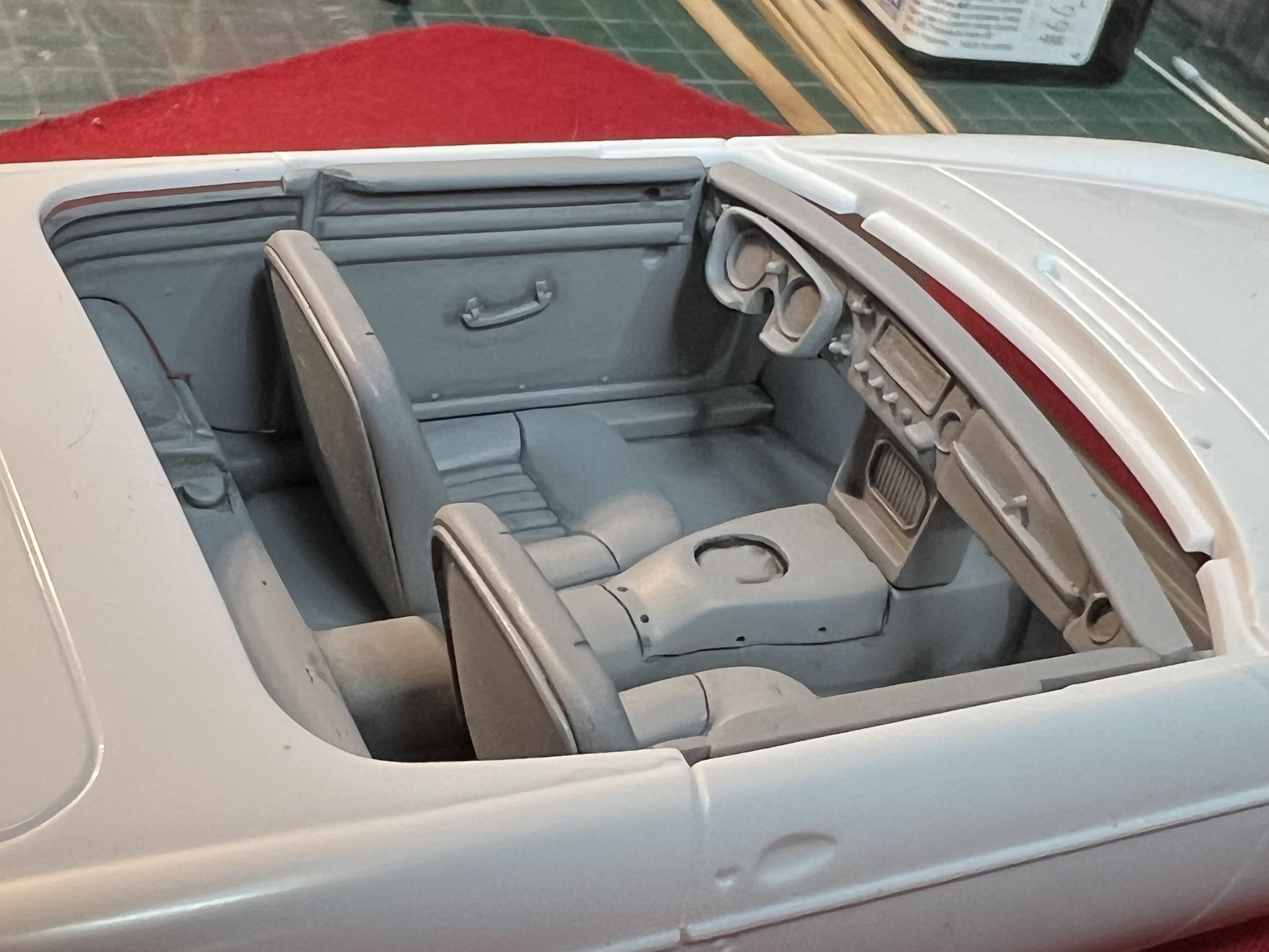

The seats show the effect the wash produces by creating a deeper depth perception, giving volume to them.
IMG_7910.thumb.jpeg.a98361db3e9b3b61a4b4c9ba8d5e3652.jpegIMG_7915.thumb.jpeg.a572a4e460215acf0f98258d019f46b1.jpeg

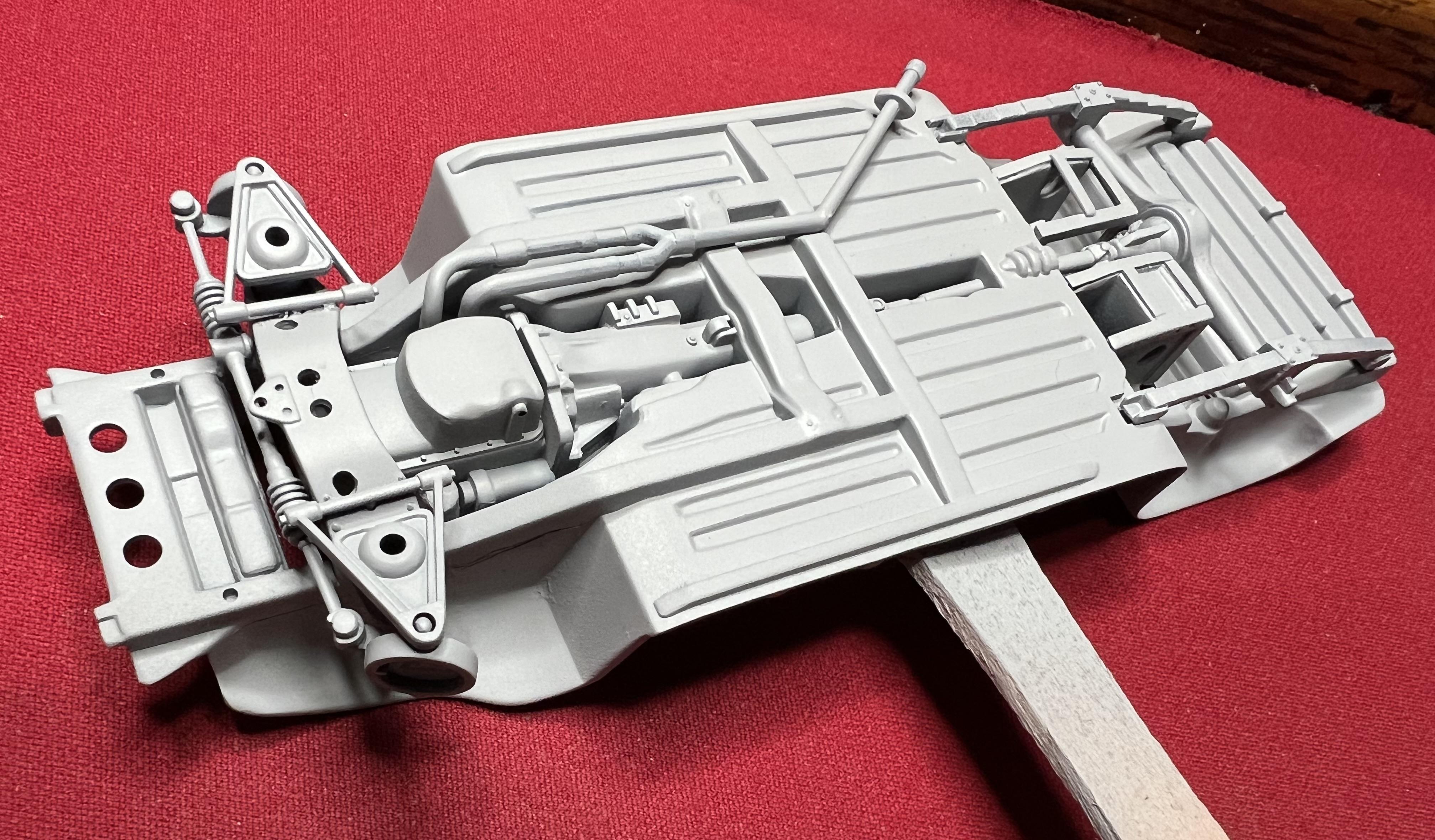

Top photos show primered chassis and bottom has had the was applied.

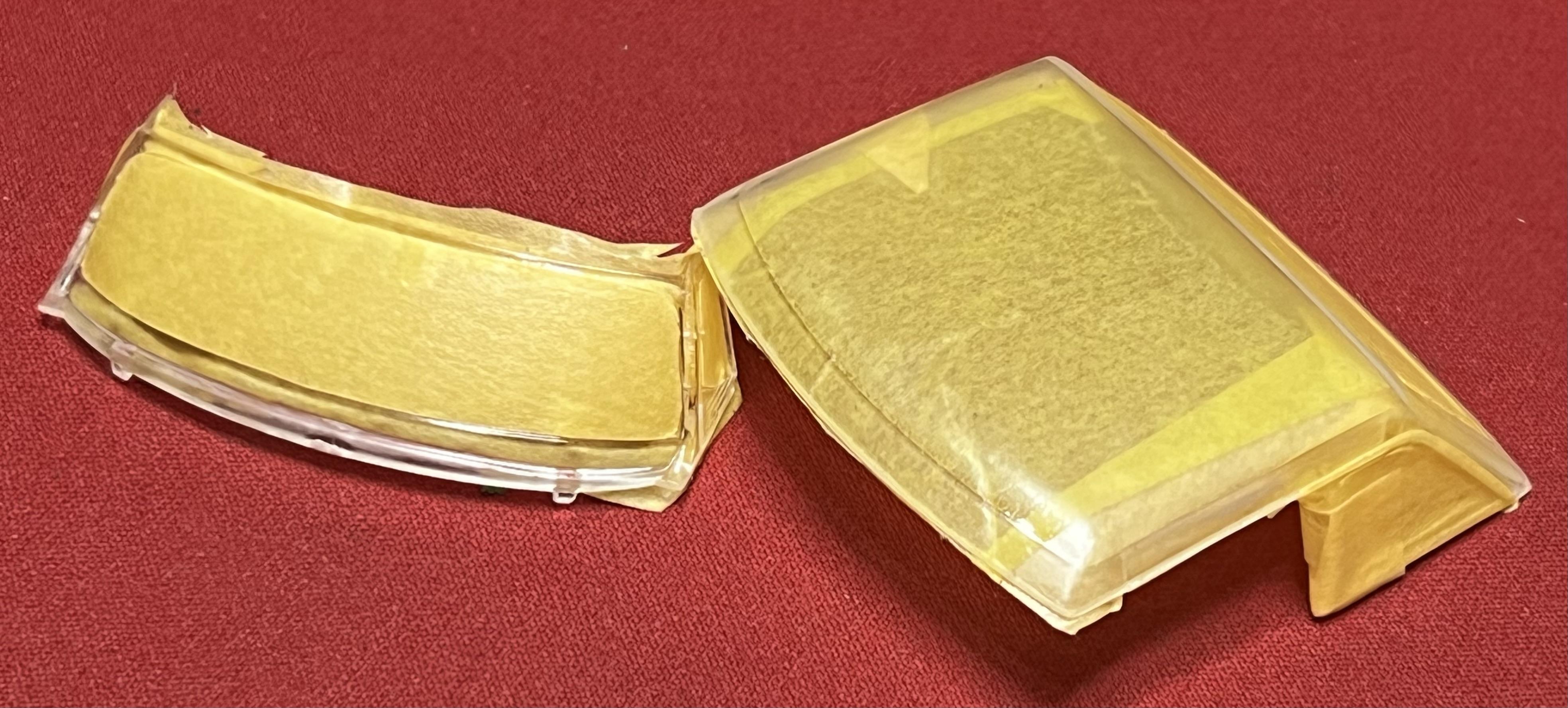

Masked the windows and frames on the clear windscreen and fibreglass hardtop in preparation for primer, white for the hardtop for it to be visible on the inside followed on top by the blue body. The windscreen, after priming, will be painted black in prep for chrome and rubber sealing. The side frames on the top will done in a similar manner with aluminum trim.

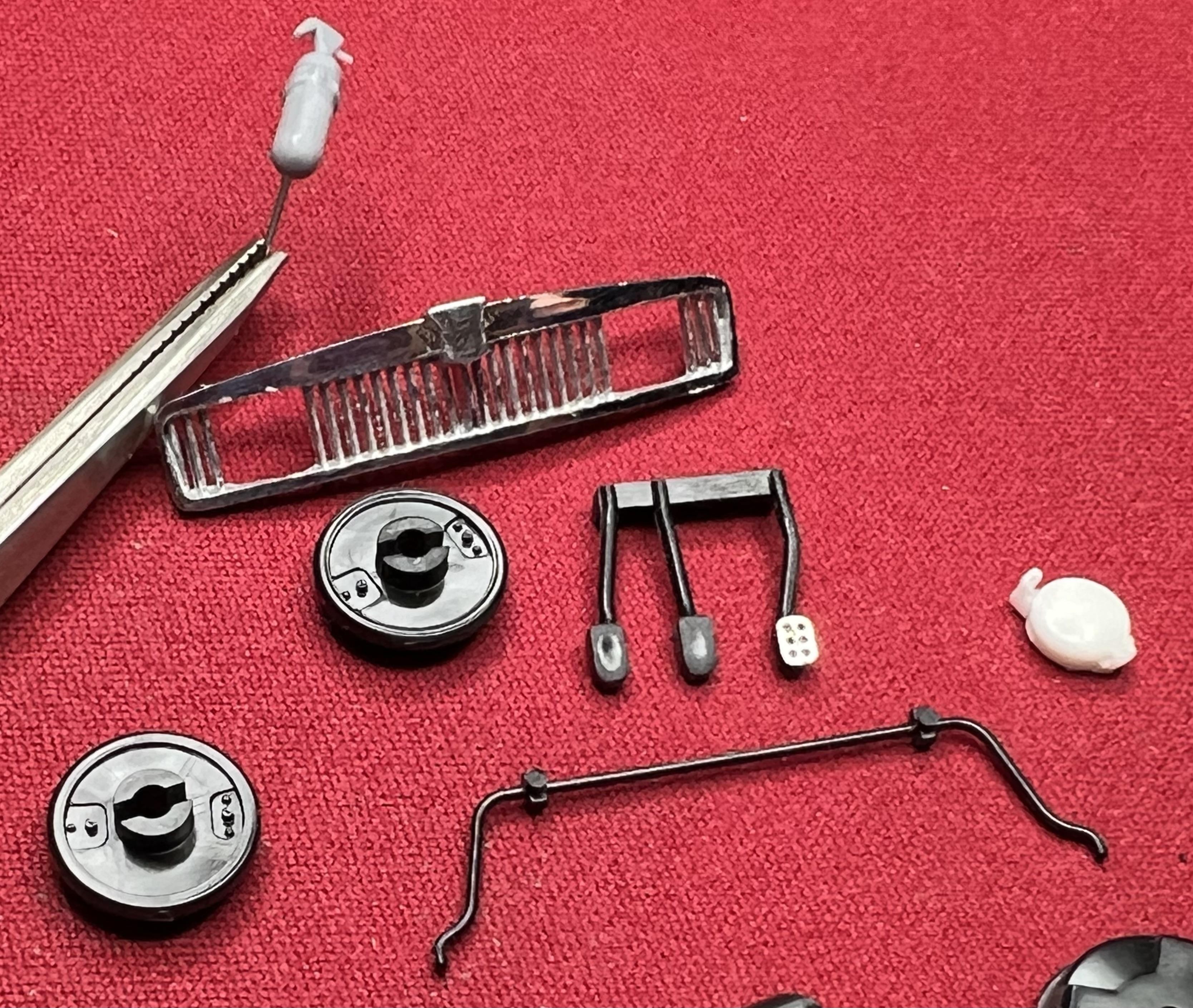

There are still a number of parts to be primed, mostly smaller detailed ones. I prepped them by eliminating mould lines, adding mounting pins and installing photo etch parts. I rarely leave parts attached to sprues for painting with the exception of finely moulded ones such as the shift lever and the clutch slave cylinder mounted on the bell housing.
Above are the modified grill, rear brake backing plates, pedals with a P/E gas pedal, the resin gas cap from R&D of M, and a finely rendered kit sway bar.

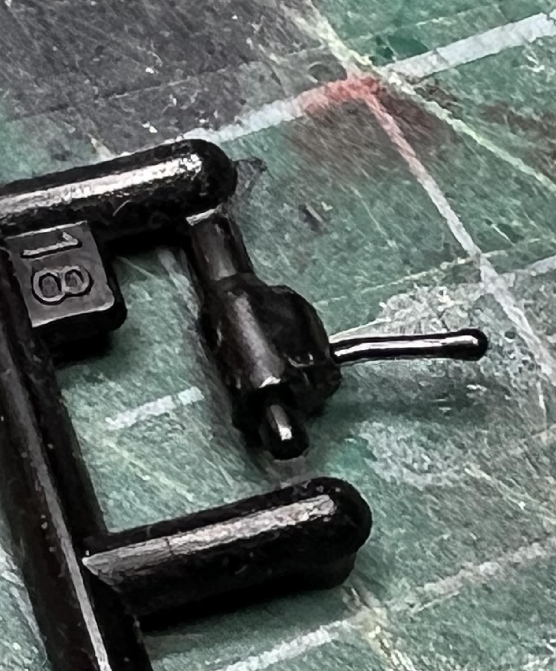

The shift lever has been gently sanded while on the sprue. One of my wheel hubs executed an escape! Luckely I have the stock version from which I pirated another hub.

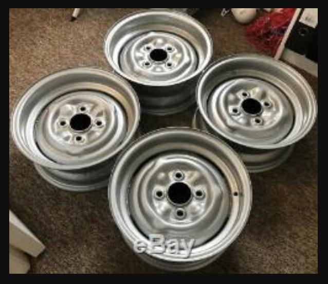

I've finally started work on the #59 Jim Clark Lotus Cortina.  Being this is my first resin kit I'm finding it's going to take a LOT of prep work to get this thing assembled.  The basis for the build is the 1963 Cortina Mk1 kit from The Motor Museum in Miniature.  No doubt I'll be leaning on this forum for assistance and ideas.
The first problem I'm in need of help with is finding some 1/24 scale, 13 inch, 4 lug, steel rims.  The kit wheels are wrong for the #59 as it raced at Sebring in 1964.
Here is a picture of the wheels I need.
Here is a picture of one of the kit wheels overlaid on a photo of the #59.IMG_3320.thumb.JPG.9b09799b4d758731158dfd4b78e0c158.JPG
As you can see, that spoked kit front wheel is wrong for the vehicle I'm trying to replicate.
I've done some internet searching and haven't found an appropriate wheel.  The closest I've come is the 14", 4 lug, steelies on my Tamiya Lotus Super Seven.  Close but no cigar!  Does anybody have any idea where I might find an appropriate wheel and tire?

The Mini Exotic Lotus Cortina resin kit I got from Gerry Chevalier a couple of years ago comes with steel wheels that I assume are the correct size. Gerry is on Facebook and might sell you a set of wheels and tires.
All comments and ideas appreciated.
Expand
The Lotus 7 wheels are probably as close as you're going to get to the correct centers. Turning them down to 13" isn't difficult if you have a lathe or electric drill, but they're nowhere near as deep as your reference shot.
Aoshima has a set of 14-inchers that have a deeper rim. Aoshima 53232 Tuned Parts 30 1/24 Kakou Tecchin Type 1 14 inch Tire & Wheel  Set
You could turn the rims off the Lotus wheels, turn the centers out of the Aoshimas, and swap in the Lotus centers. Lot of work, but it would get you there.
Fat little 13" tires are another problem entirely.
Only kit source that comes to mind is the AMT '69 Corvair...though they'd most likely need some modification to get the right look (again, not too hard, as sidewall details can be removed, and tread details softened, by progressively wet-sanding with 180 up to 600).

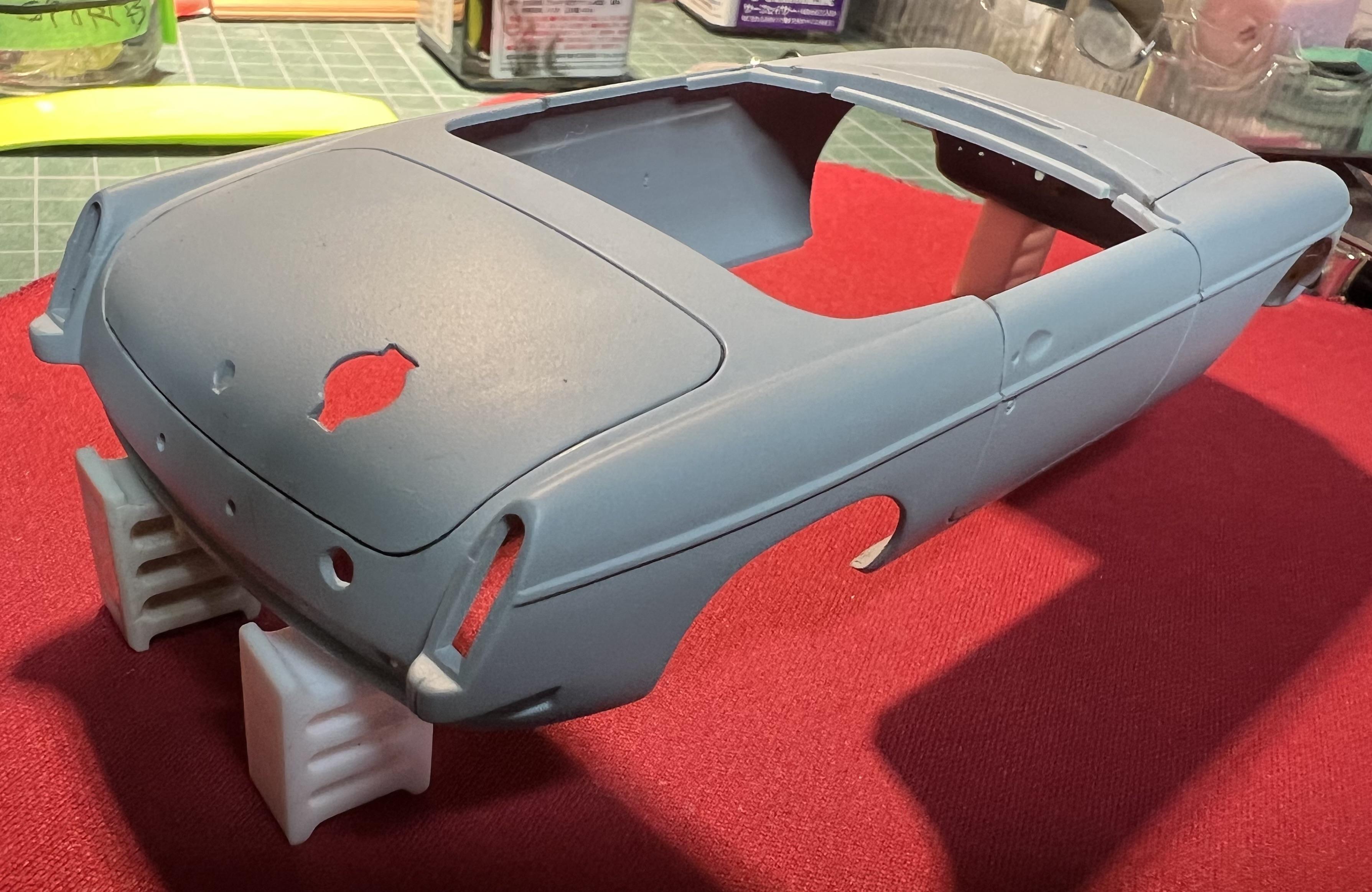

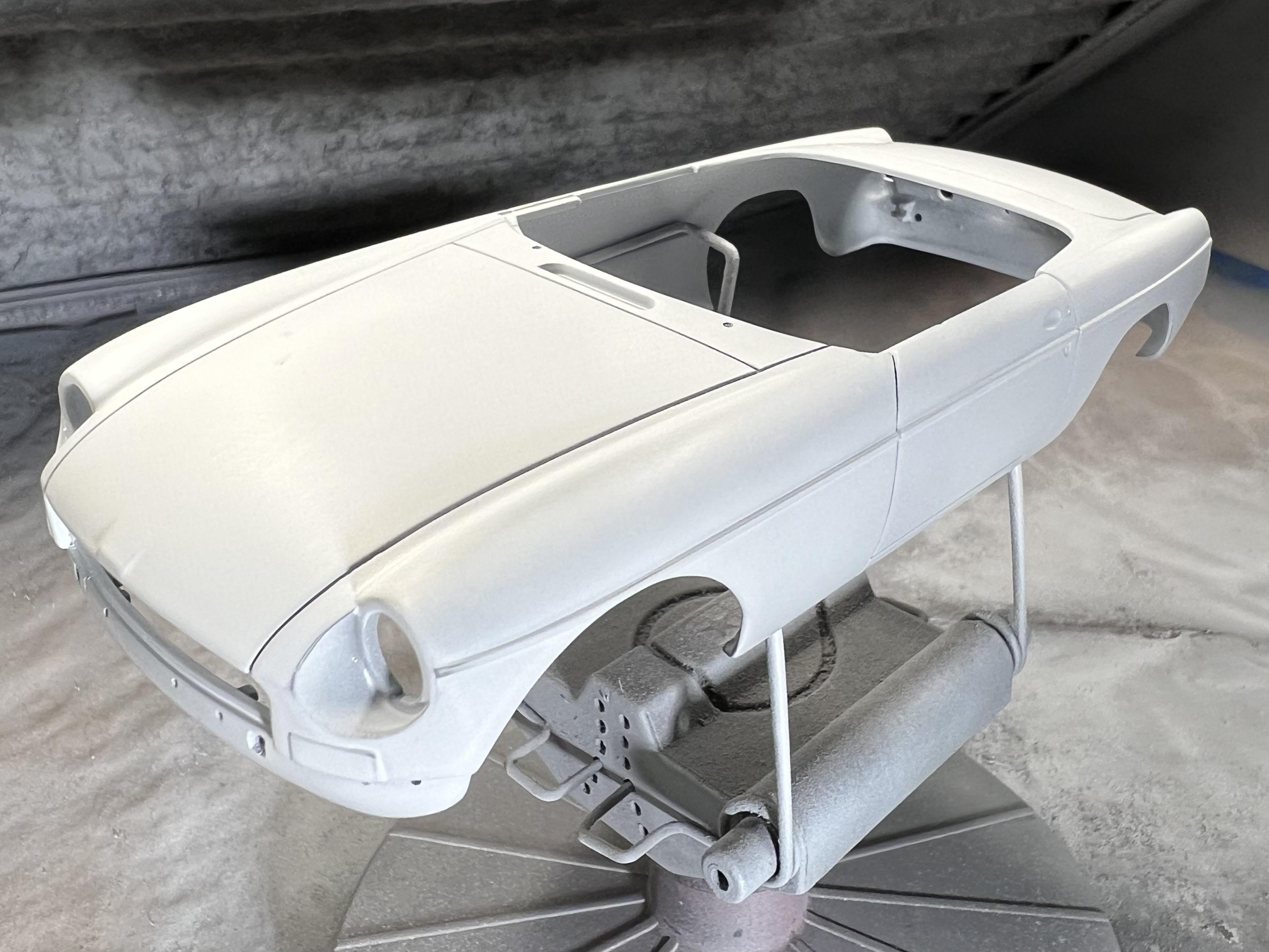

The primer coat is ready to go having had two applications each of grey, to prep the body and white, for the stripe and meat balls. It is now ready for the blue body colour to be followed by a red decal stripe for the alternate red MG. All three MGB entries alternated their stripes accordingly to their body colour.

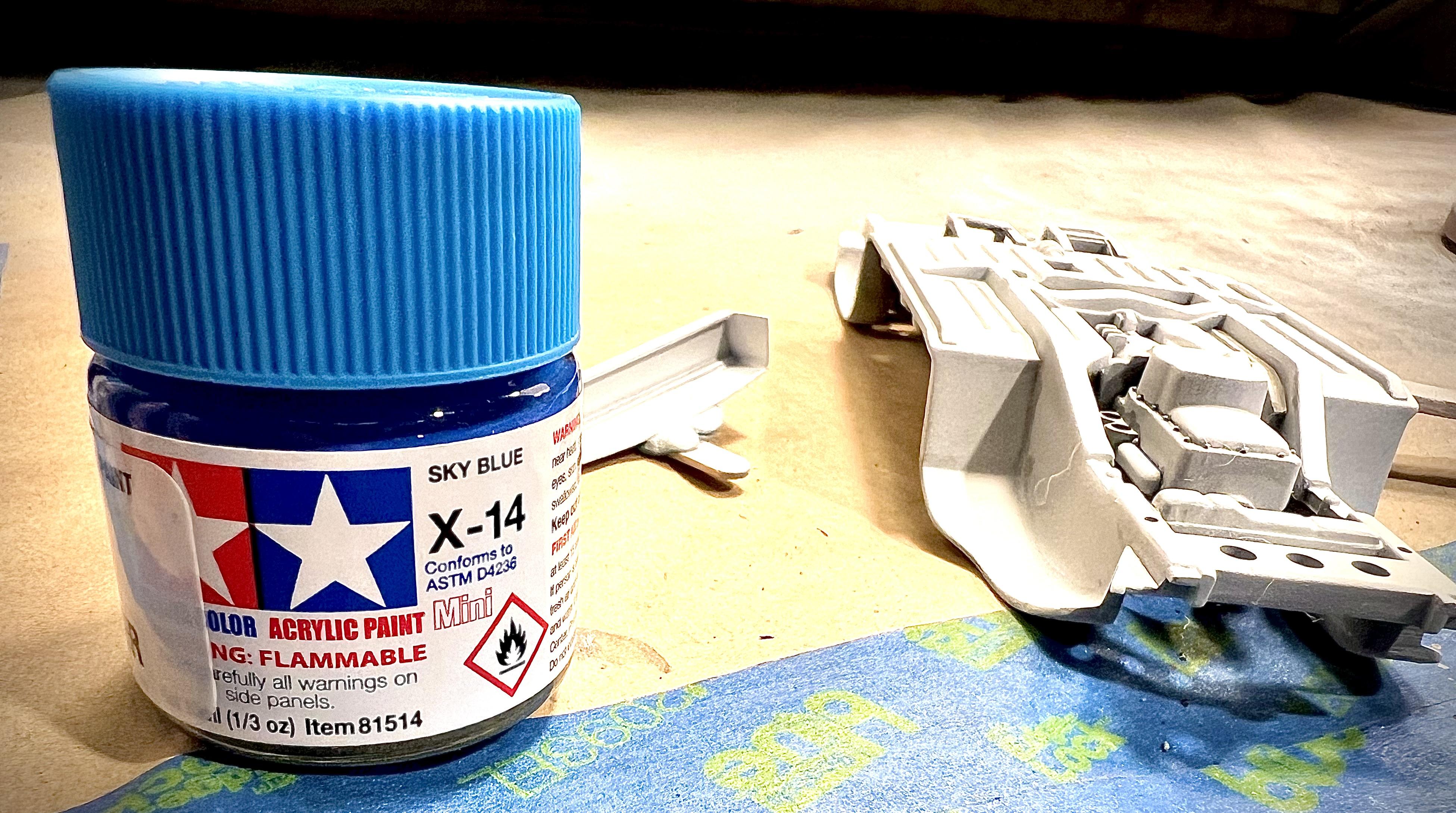

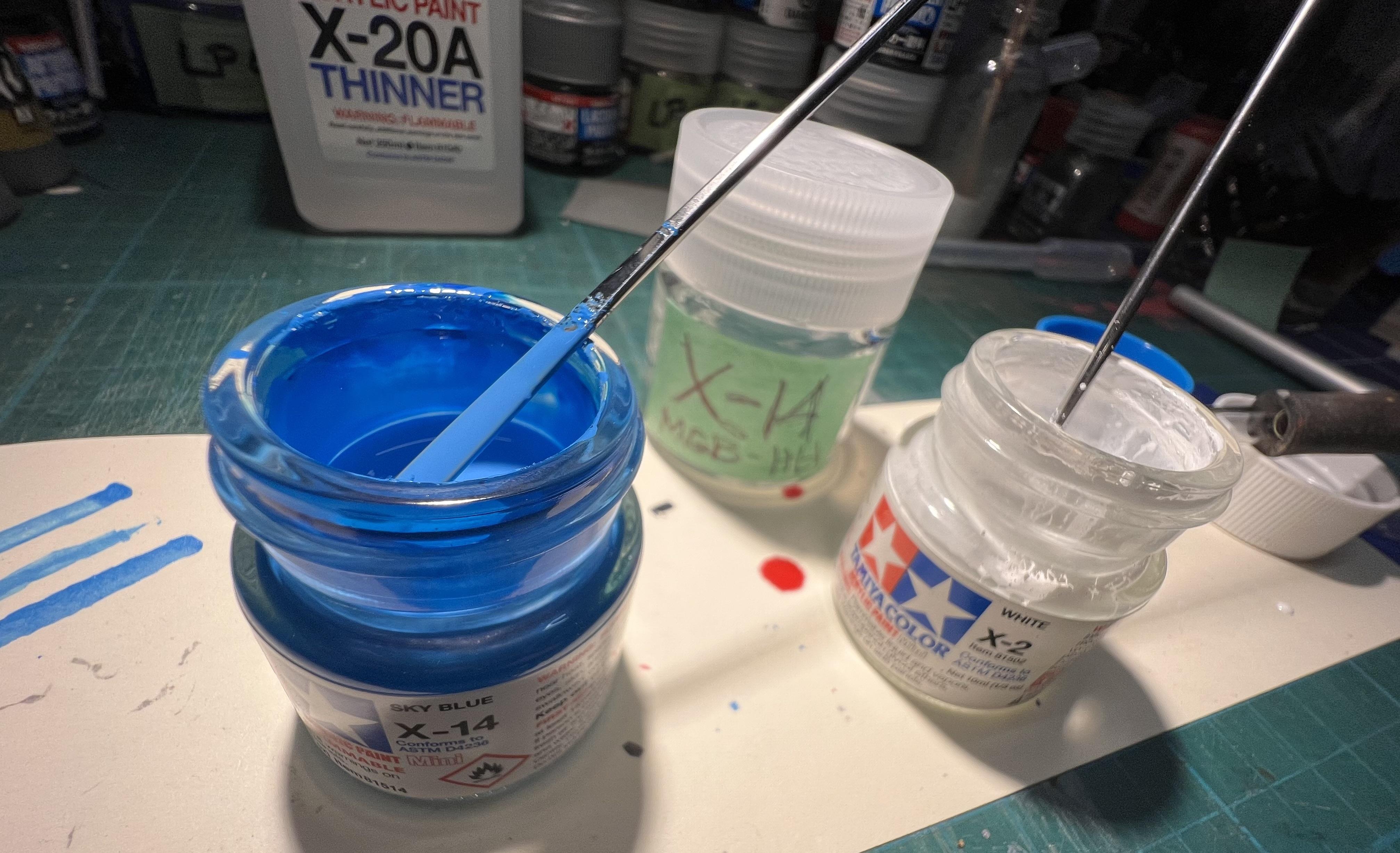

Originally I had planned on mixing up the light blue, nearly Sky Blue in a lacquer base colour, using Tamiya’s LP range, as it doesn’t appear as a stand alone colour. Poking thru my paint stores I came upon Tamiya X-14, in their acrylic line.  Having been disappointed by the early water based paints offered I have shied away from using them. The Vellejo range has changed my opinion, using them predominantly for interiors.
By choosing the acrylic X-14 for the body colour affects subsequent paint applications. Since the MGB was the first  unibody replacing the MGA the Sky Blue was applied to the underside and interior. The curbside plate chassis and the interior will require planning to avoid applying a lacquer (my preferred medium),  over the body colour.
A question regarding thinning the Tamiya for air brushing , using X-20A would I use a 1:1 ratio, equal parts of each? Thanks!

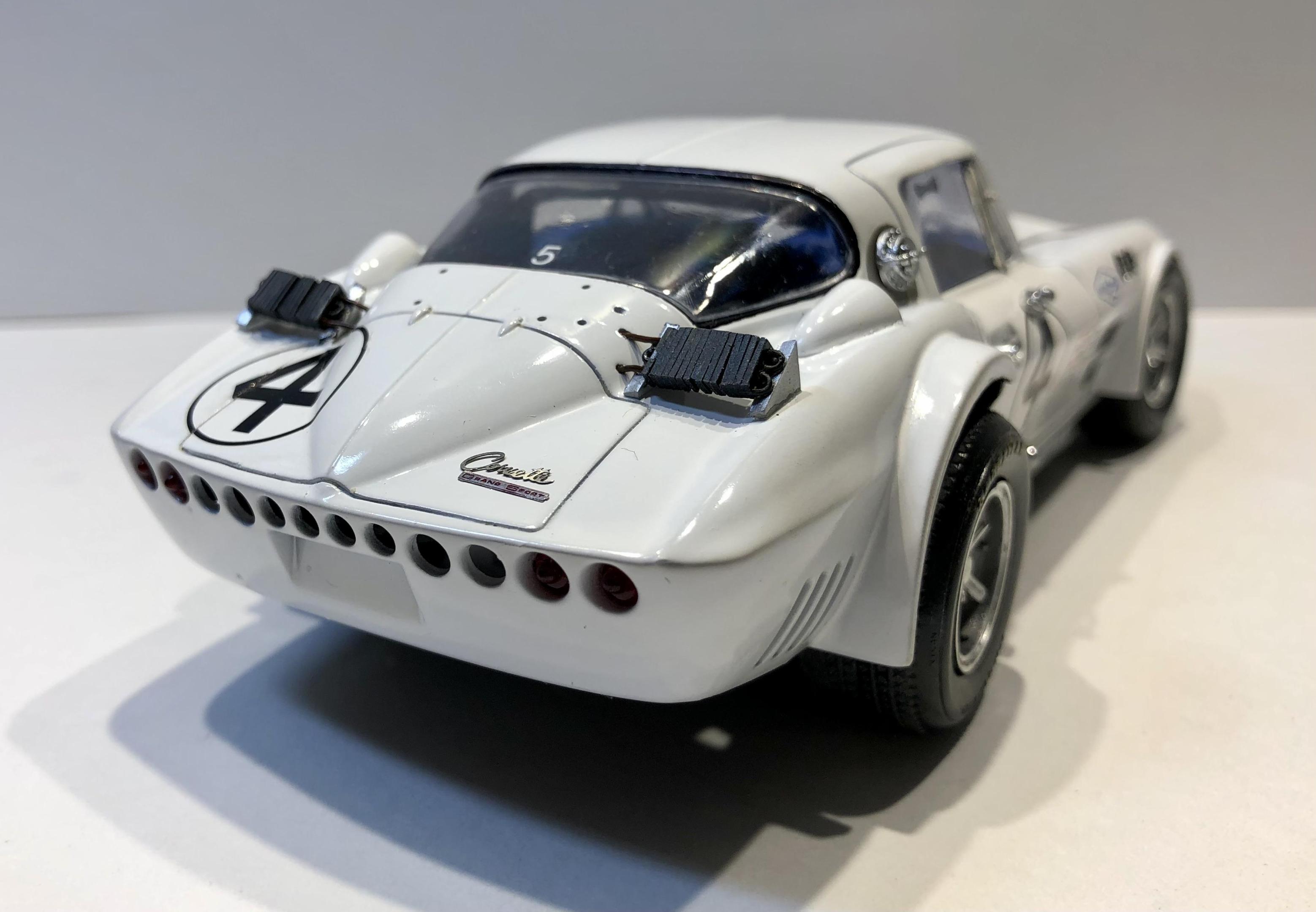

Race preparation of the #4 Hall-Penske Corvette Grand Sport 005 was completed today and it is now ready for the Sebring 1964/2024 grid. These are the first photos taken with my phone. I plan to do a proper photo shot and an Under Glass post in the near future. I still have not heard the full story on why the Hall-Penske Team taped over the hood louvers and left them that way for the Road America race in September 1964 and Nassau December 1964. Maybe the original reason was to prevent rain getting into the engine compartment but the team must have found it advantageous for other reasons because Road America was a dry race. - ???
IMG_0837.jpg.2386df3674d2f921c026181a853b7ced.jpgIMG_0836.thumb.jpg.058a621d4c40f47a440dbf672392a7e1.jpg
