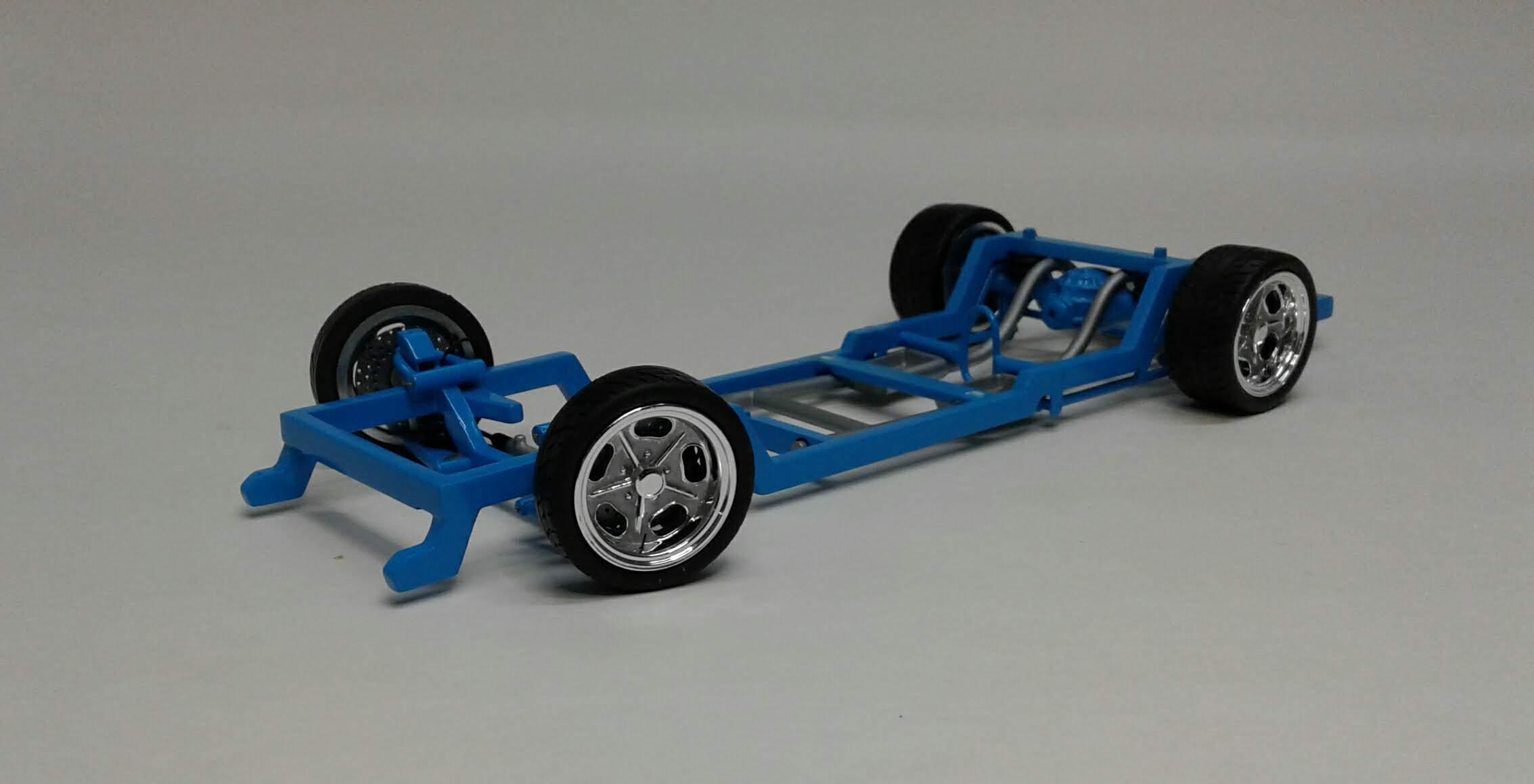

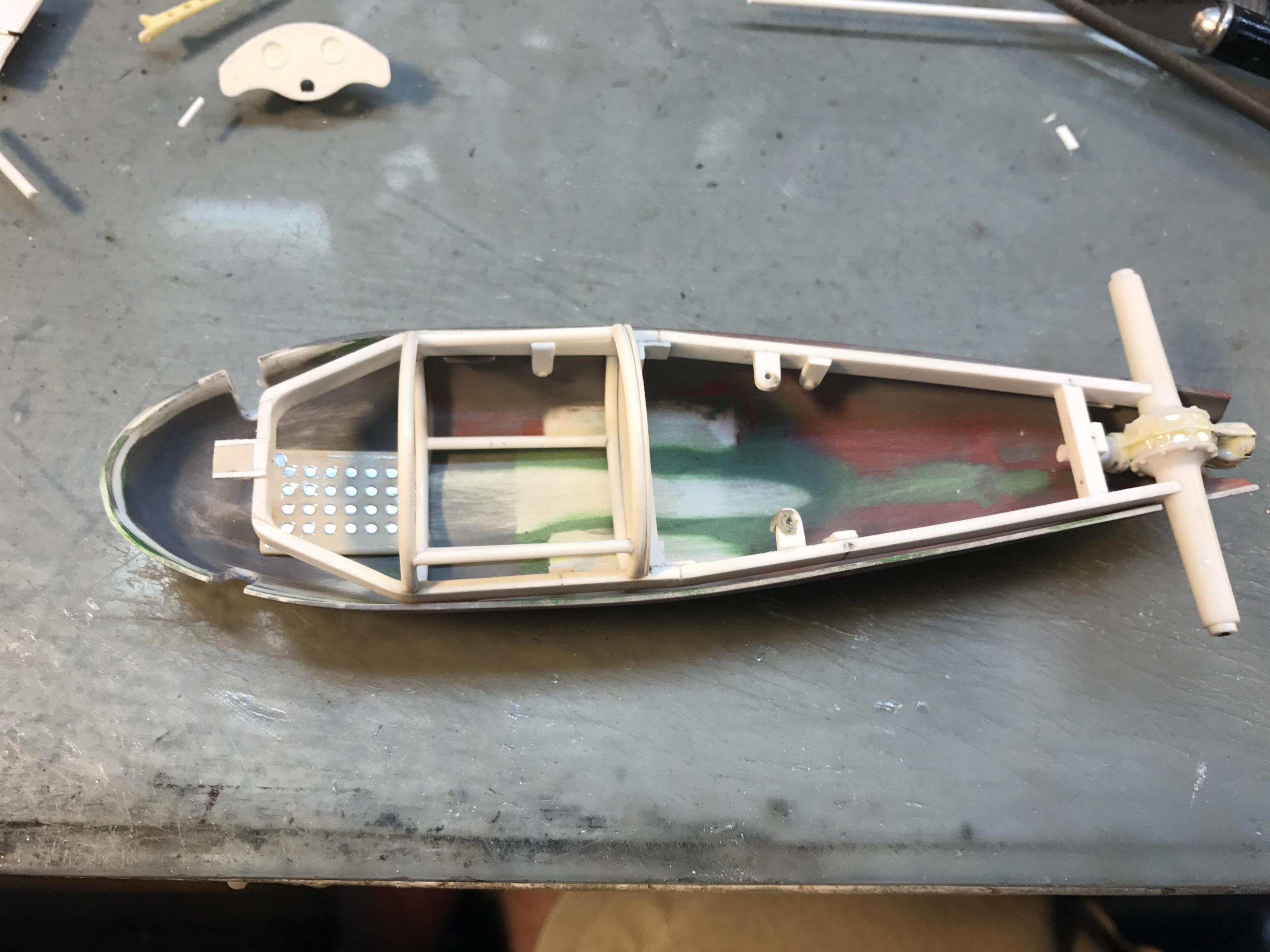

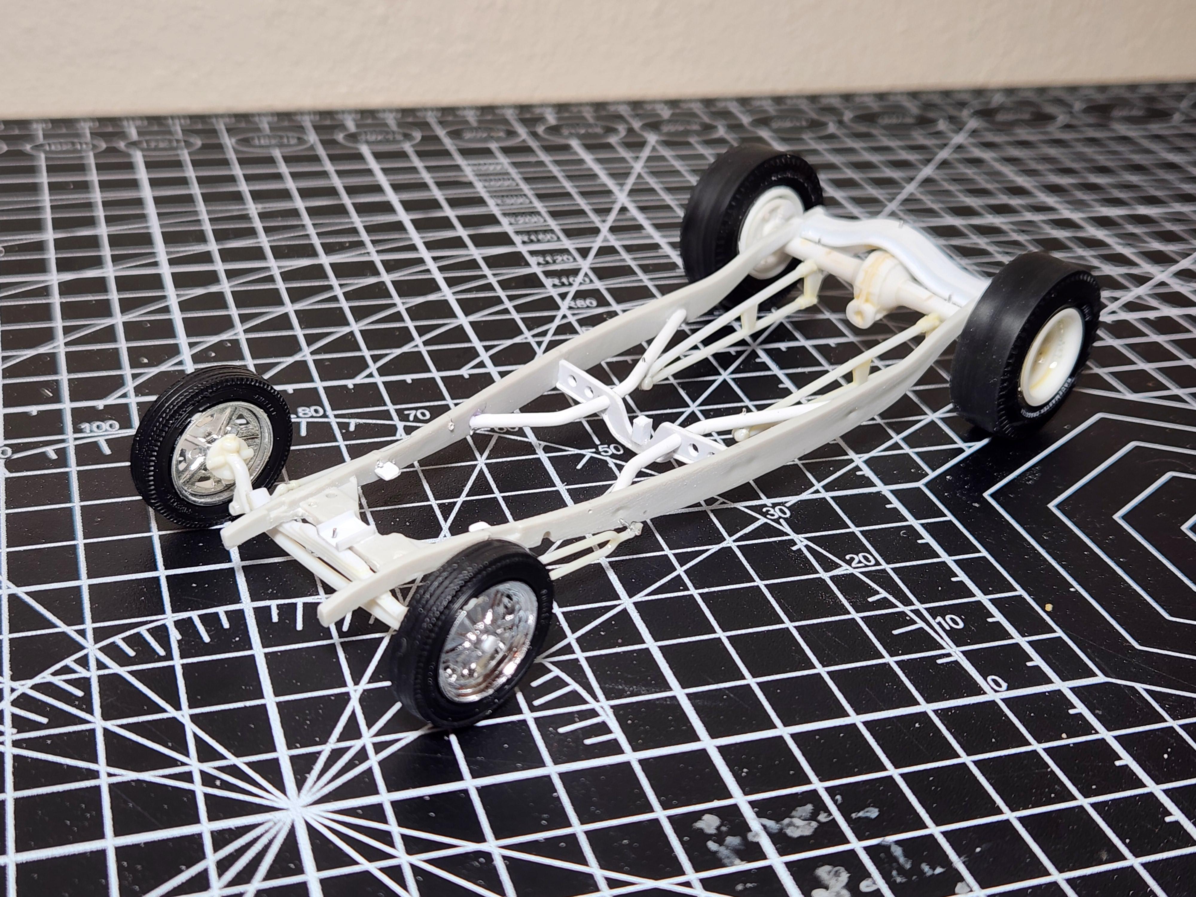

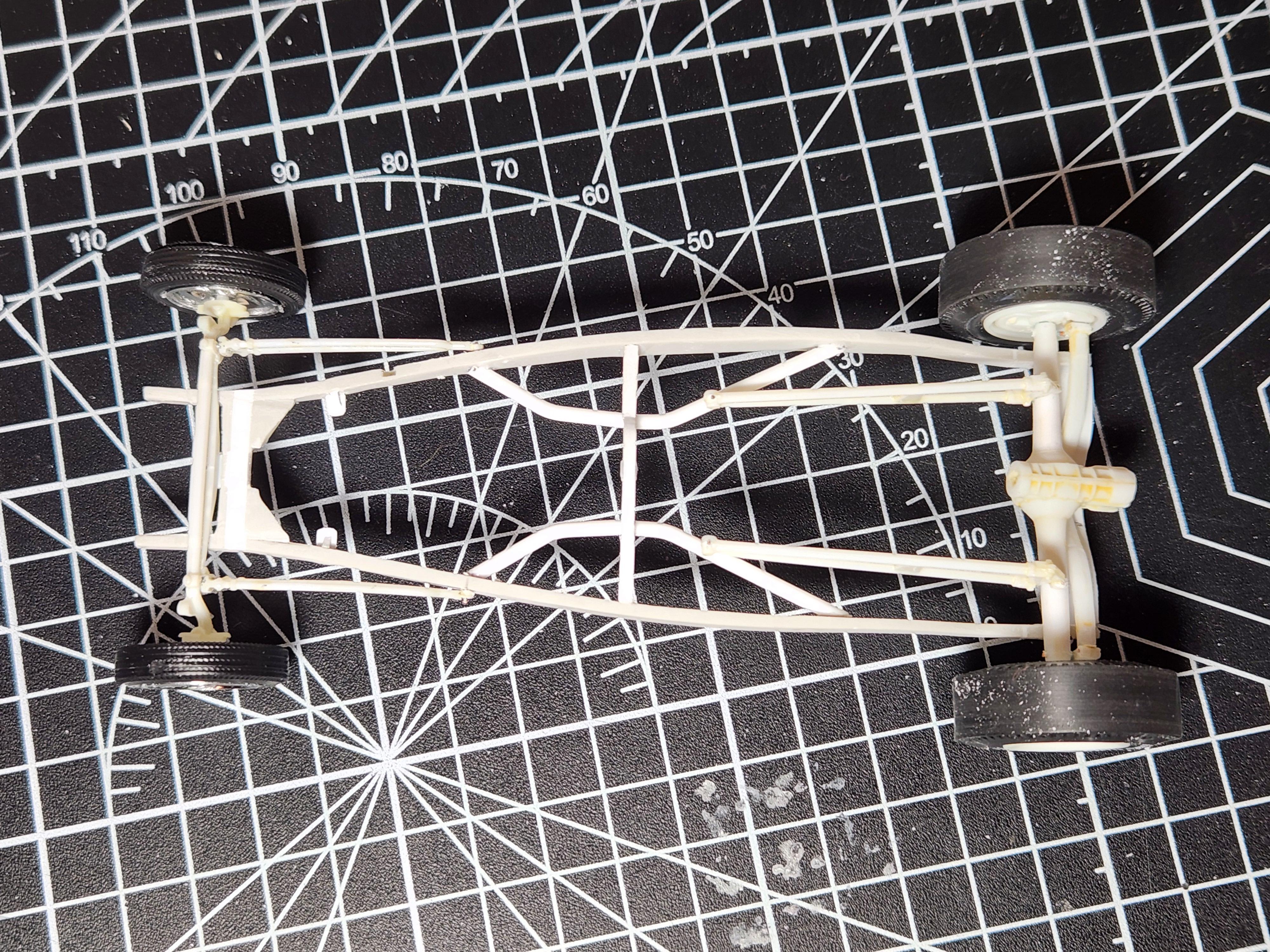

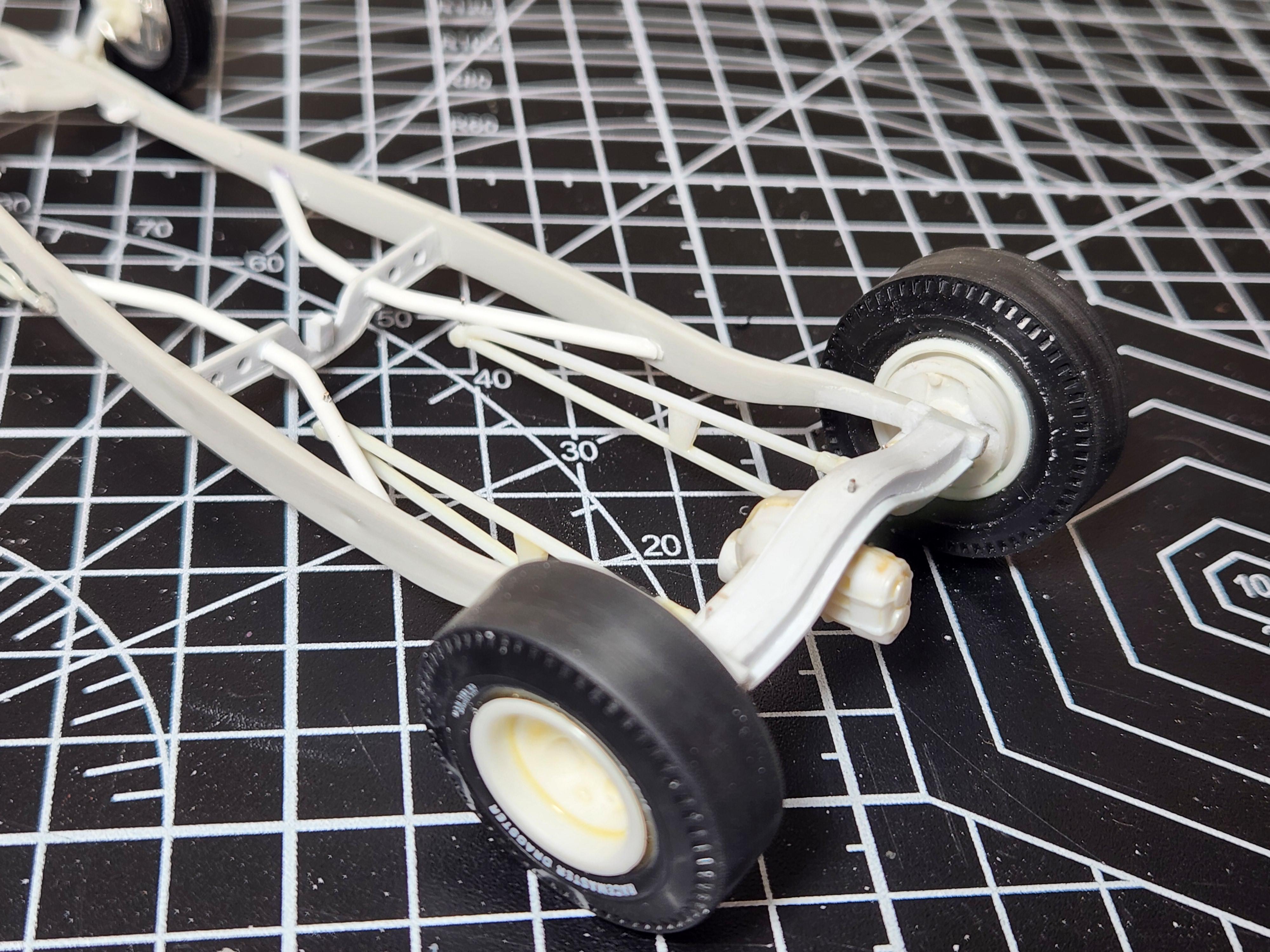

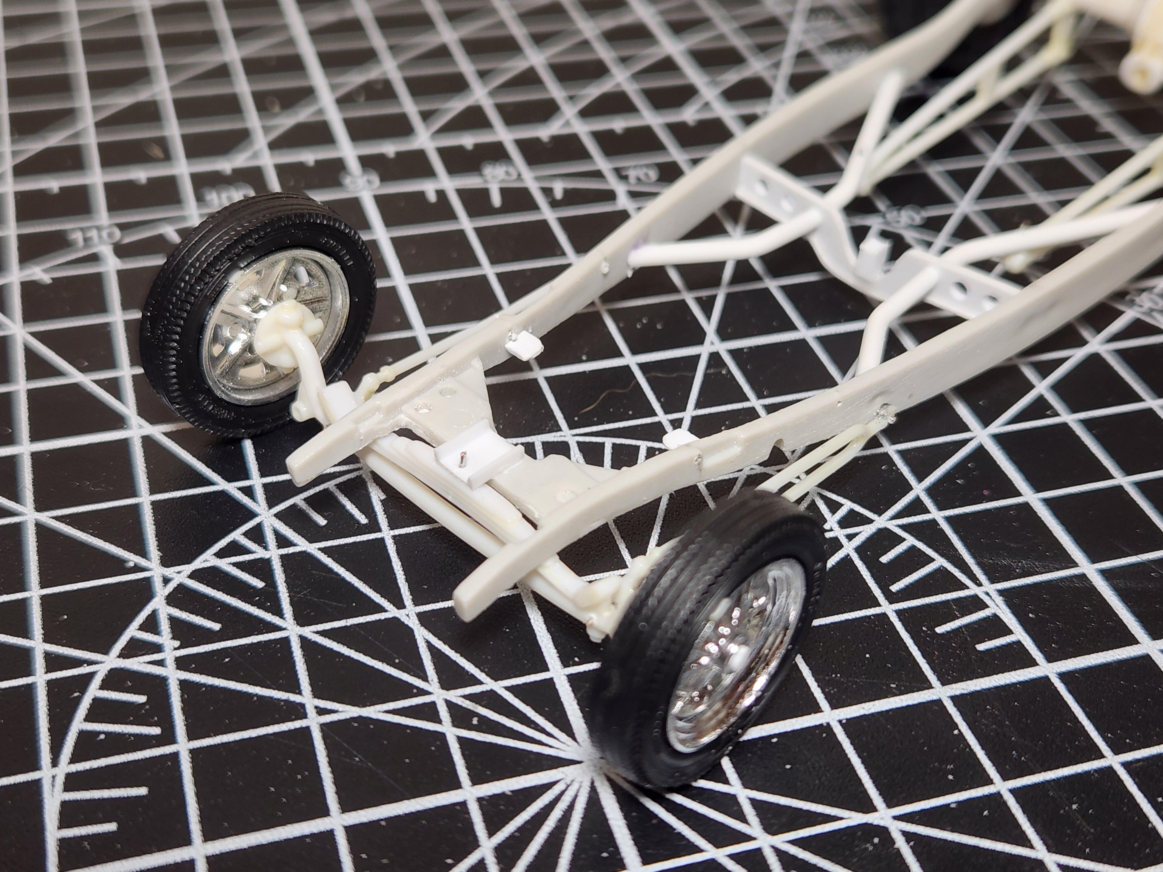

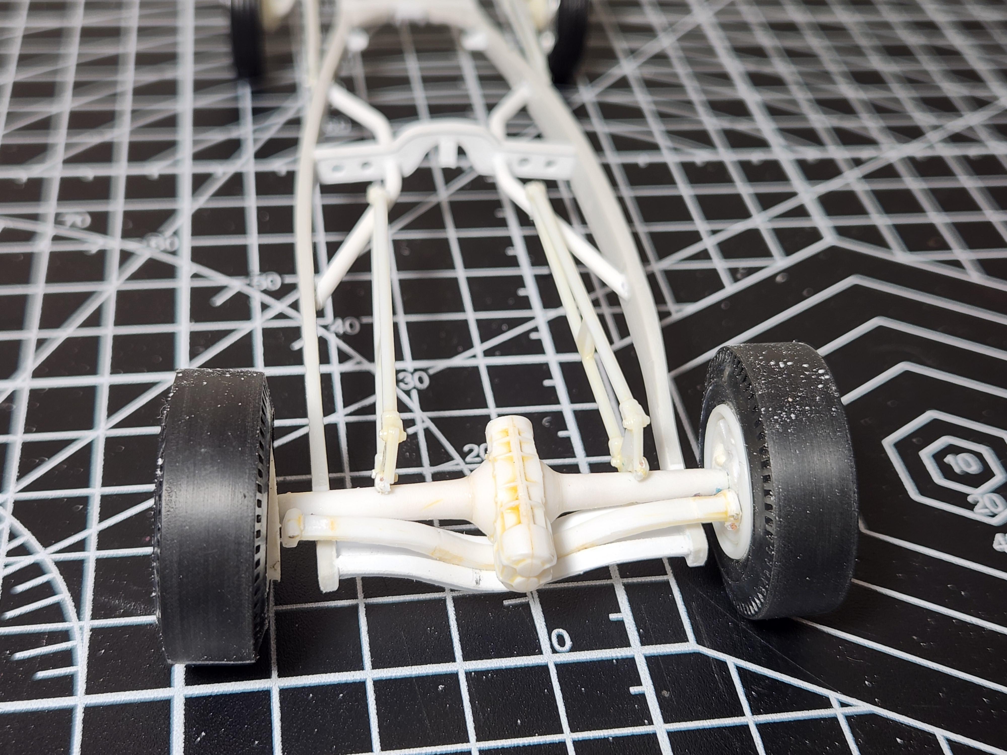

Rocking Rodney Rat Posted October 14, 2022 Posted October 14, 2022 I just finished this one for an in-progress Fad T. --------- not totally scratch built, rails form the Revell '32 series... ------- perimeter frame for a belly tanker... --------- another simple T style frame for a single seater runabout... ------ started with a set of '32 style frame rails, front quarter ellipticals with a 4-bar rear... ------------------- I guess you get the idea, basic hot rod frames, nothing too exotic. Lots of biuldup pix here: https://public.fotki.com/jferren/ -RRR 5
Calb56 Posted October 14, 2022 Posted October 14, 2022 All of those are great. Love the suicide front end, the "T" chassis and the one with the quarter elliptical front end. Have done some research and seen elliptical rear ends (rarely) on 32's but never a front end like that. Cool.

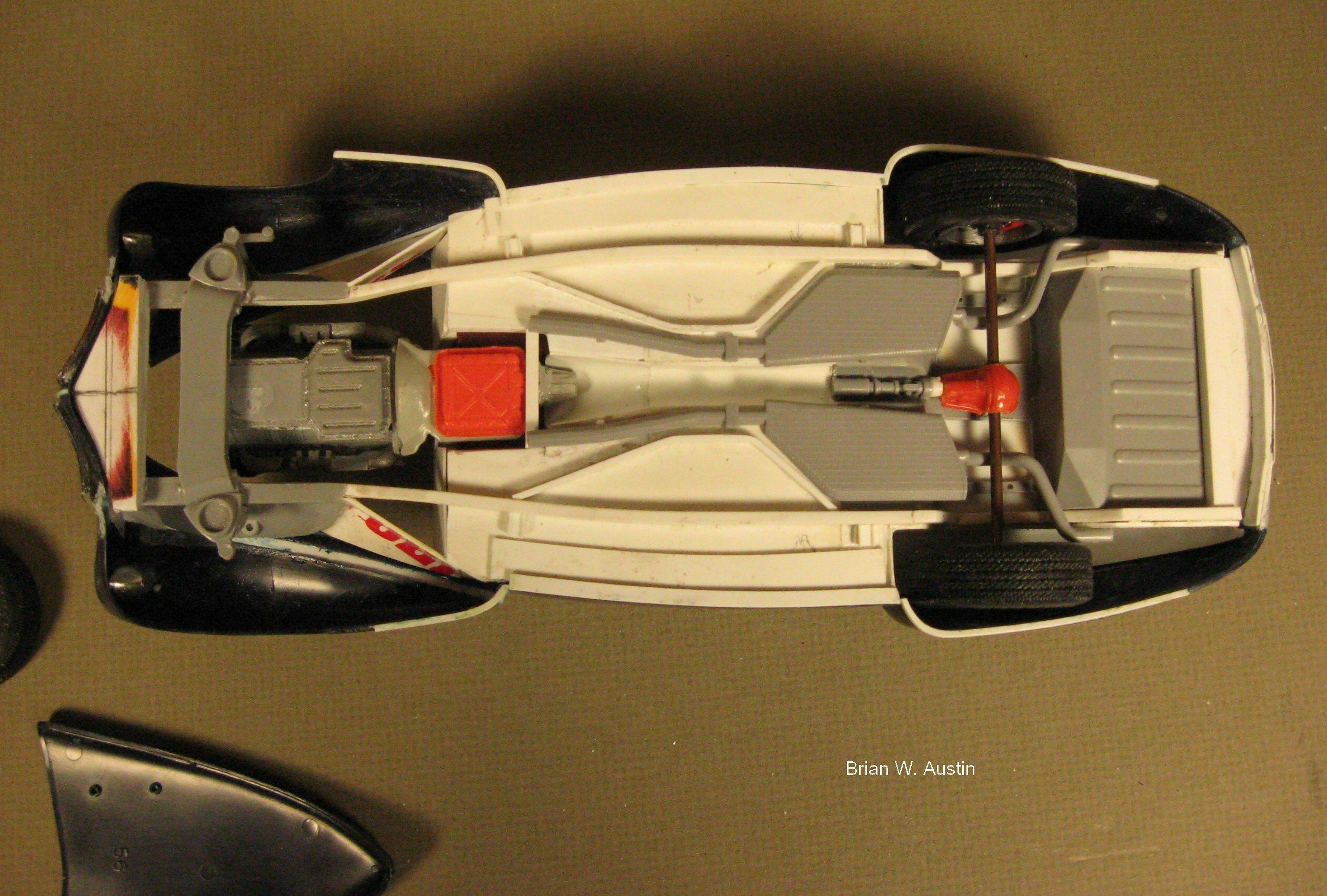

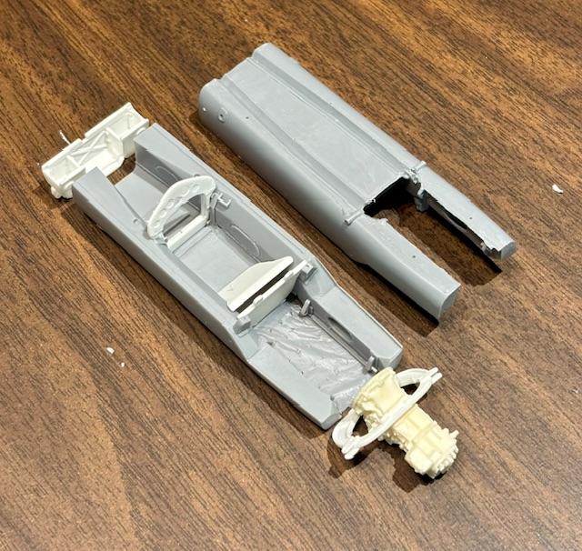

Brian Austin Posted October 15, 2022 Posted October 15, 2022 Customized Monogram Lincoln Continental. Bent styrene strip glued to the floorpan. 1

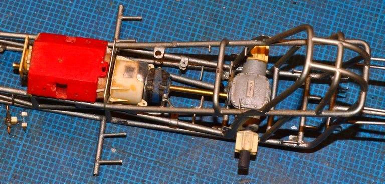

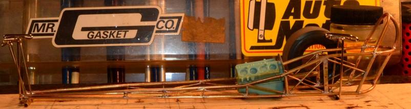

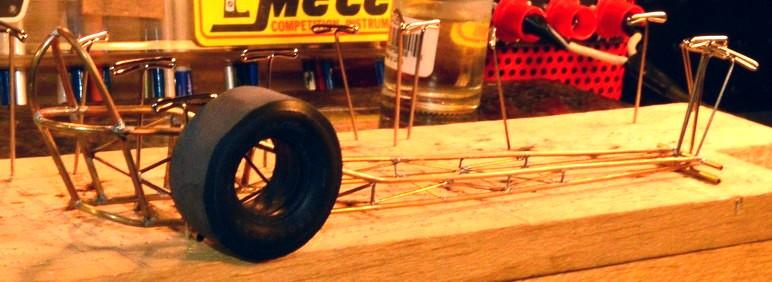

Straightliner59 Posted October 15, 2022 Posted October 15, 2022 Here are a few of mine. The first five are a nostalgia fuel dragster chassis, built from brass rod and tube. The next three are for a replica of The Surfers dragster. Obviously, it's brass. Next is a chassis for a speedster I was messing around with. I wanted to try my hand at making "c"-channel frame rails. 3 1

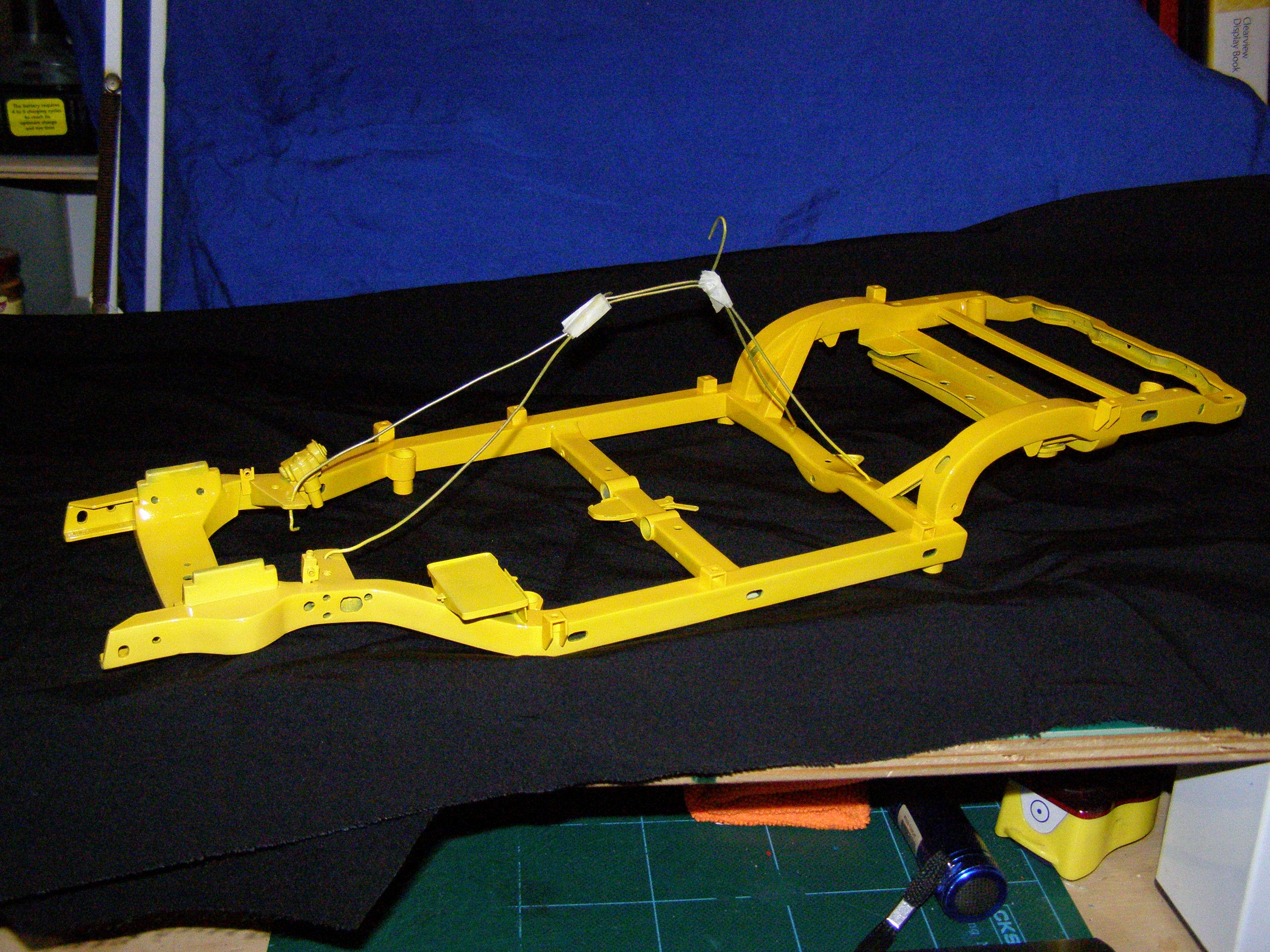

ModWrench Posted October 19, 2022 Posted October 19, 2022 Have a few pics of some scratch-built short track race cars. First is an asphalt modified. Started with the main frame rails from an MPC kit, scratched the rest from evergreen rod. 2

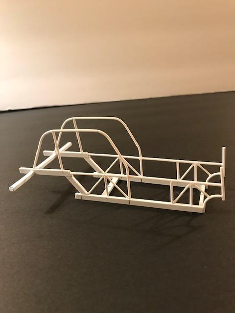

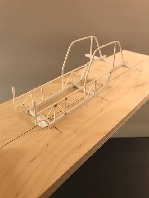

ModWrench Posted October 19, 2022 Posted October 19, 2022 This is a replica of the first car I helped build when I was a teenager. Late 1970's center-steer modified that ran on dirt tracks in Upstate New York. I have a copy of the blue prints for this frame that I found buried in my parents basement. Made a jig to try and get the dimensions dialed in and make accurate sides that I could then stand up and tie together with appropriate cross members. Working on finishing up the roll cage bars on this one, then start hanging the suspension mounts. We ran a 'Cuda body, but that will need a lot of massaging before it's ready to mount to this frame. The plan is to build replicas of the six cars I helped build and worked on during the mid-70's to late 1980's. 4
