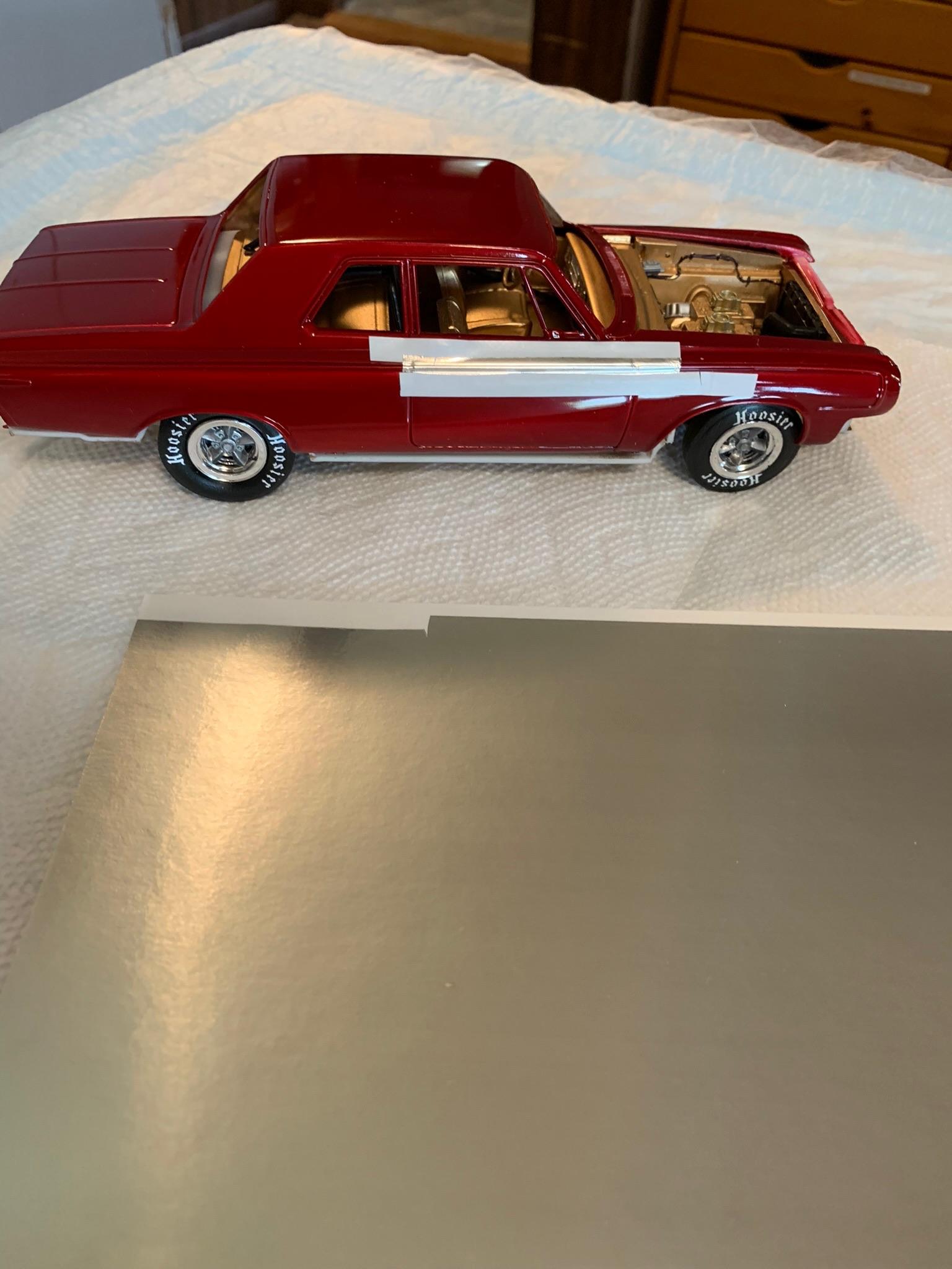

R. Thorne Posted October 28, 2022 Posted October 28, 2022 With the ubiquitous cell phone most of us have and the extraordinary quality of pictures they provide, there is really no reason not to take pictures of procedures, tools, etc., that work out well and, well, not so well. It is convenient to look back at pictures and created albums rather than trying to remember everything (though I doubt I will forget this tape experiment). The only catch is you may have to increase the memory capabilities of your device(s). 2
NOBLNG Posted October 28, 2022 Posted October 28, 2022 Ouch! I bet that hurt more than ripping off a bandaid.? Yes, a picture is worth a thousand words.
Dpate Posted October 29, 2022 Posted October 29, 2022 What was the point of the tape? To try and get no residue of the BMF on the body? That's very easy to clean off if you were to get residue on the body, and also why not tamiya tape? Doubt that would of happened with tamiya tape.

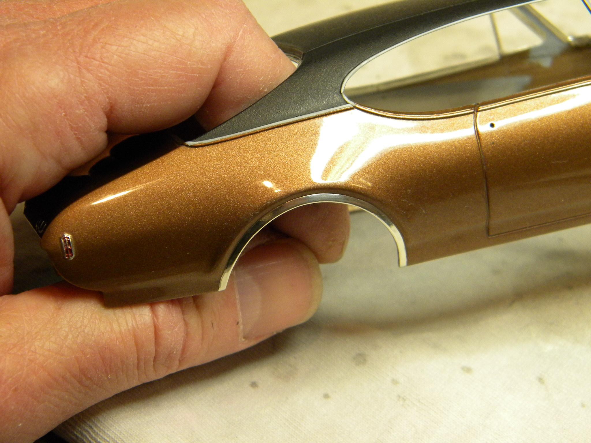

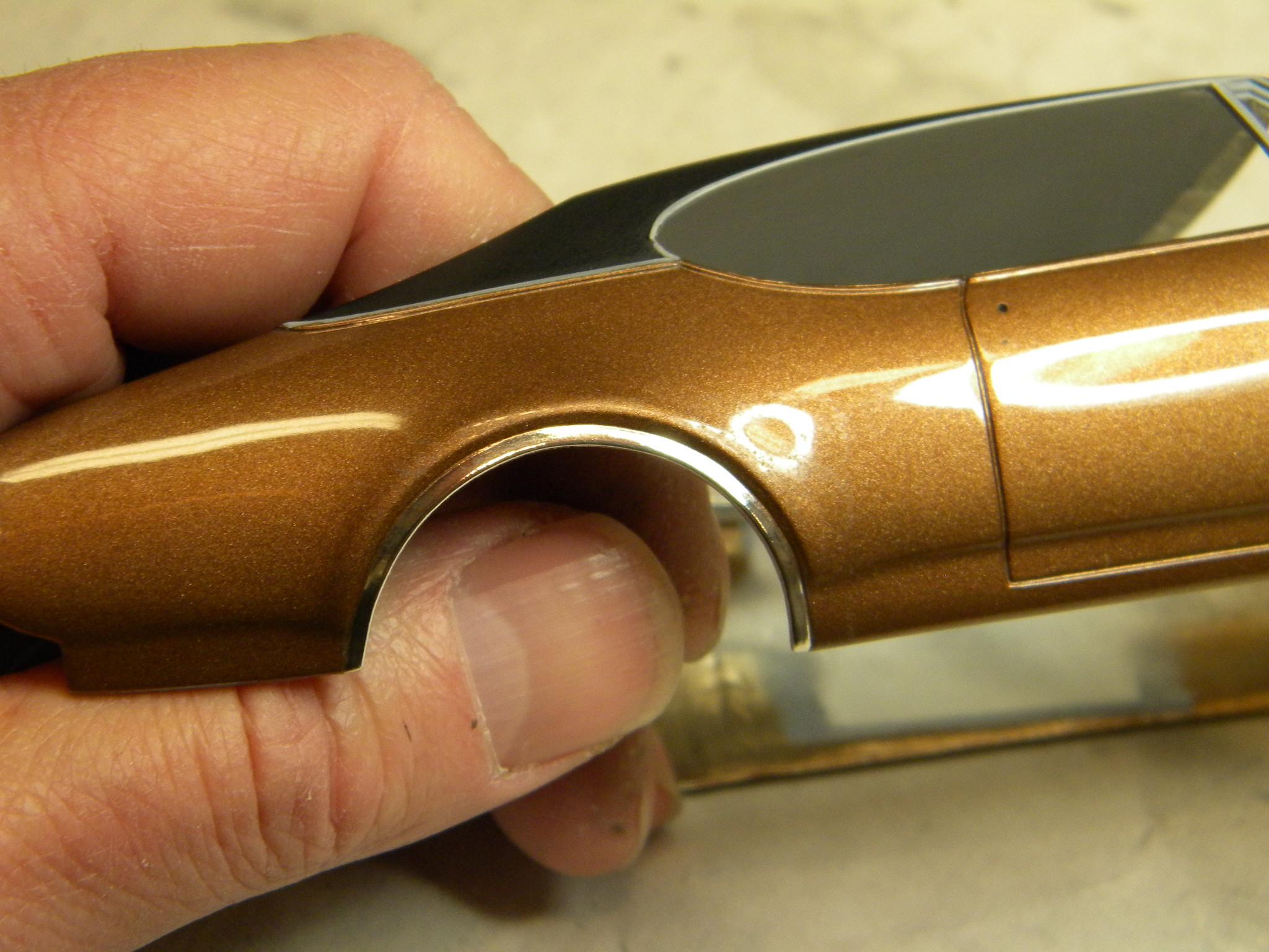

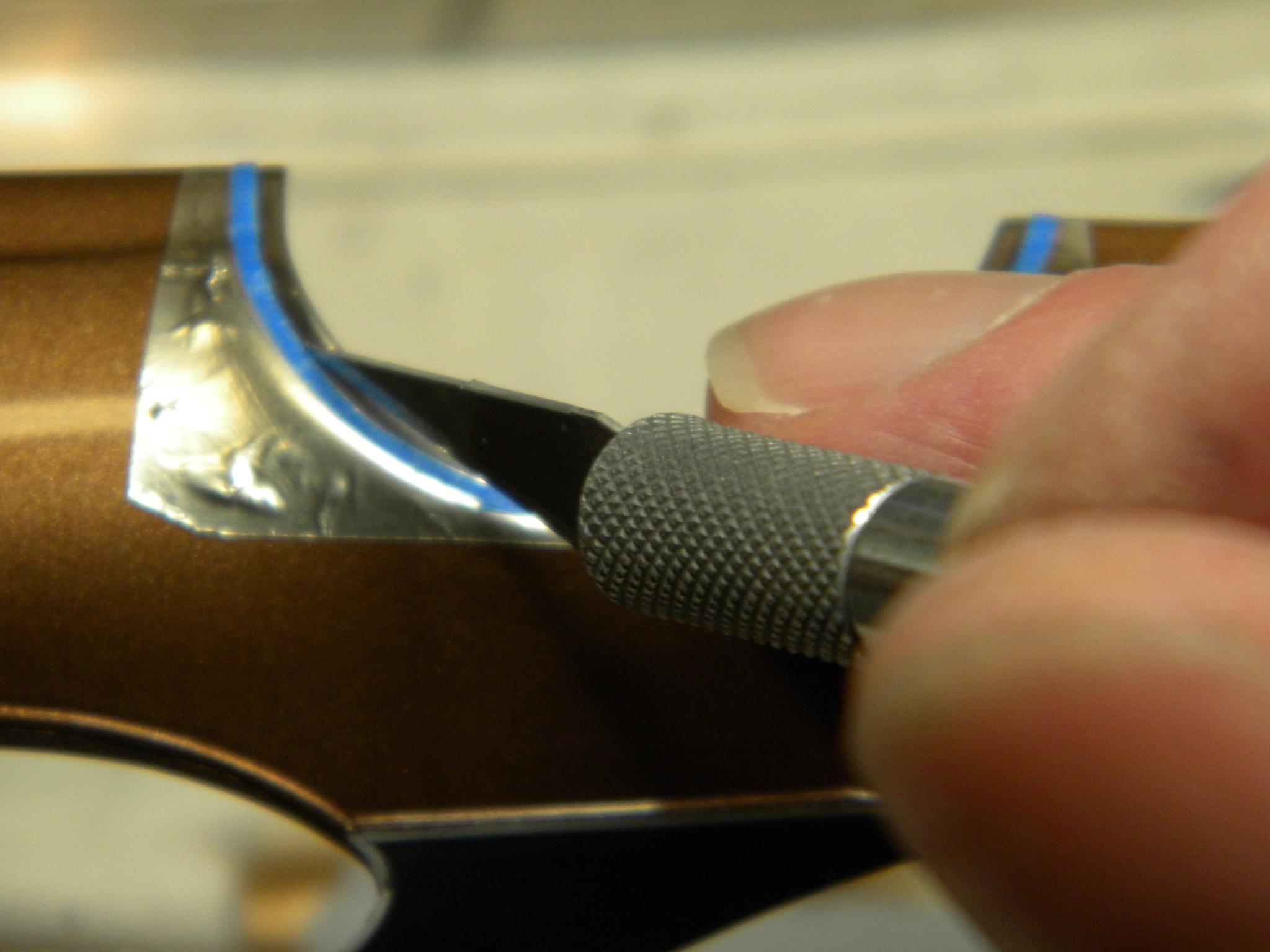

StevenGuthmiller Posted October 29, 2022 Posted October 29, 2022 (edited) 14 minutes ago, Dpate said: What was the point of the tape? To try and get no residue of the BMF on the body? That's very easy to clean off if you were to get residue on the body, and also why not tamiya tape? Doubt that would of happened with tamiya tape. Utilizing tape for applying foil is a terrific technique, but you have to be careful of the type of tape that you're using depending on your painting regimen. I use thin strips of blue painters tape to get a perfectly straight foil edge, but I apply the foil first, and then lay the tape along the edge of the trim to be foiled. This guards against the type of issues exhibited by Ron's above photos because the tape is contacting the foil, and not the paint. The blue tape not only gives a color contrast between the foil and the blade to make it easier to see what you're doing, but the tape gives you an edge for the blade to ride up against as you cut, making it much easier to get a perfectly straight and clean edge on the trim. Steve Edited October 29, 2022 by StevenGuthmiller 2

Dpate Posted October 29, 2022 Posted October 29, 2022 5 minutes ago, StevenGuthmiller said: Utilizing tape for applying foil is a terrific technique, but you have to be careful of the type of tape that you're using depending on your painting regimen. I use thin strips of blue painters tape to get a perfectly straight foil edge, but I apply the foil first, and then lay the tape along the edge of the trim to be foiled. This guards against the type of issues exhibited by Ron's above photos because the tape is contacting the foil, and not the paint. The blue tape not only gives a color contrast between the foil and the blade to make it easier to see what you're doing, but the tape gives you an edge for the blade to ride up against as you cut, making it much easier to get a perfectly straight and clean edge on the trim. Steve I know this method from you because I've seen your post before and it's a great technique. But i simply said what i said because I've seen other folks use the method he did to avoid getting residue on the body from the BMF but with tamiya not sure what kind of tape he used lol.

R. Thorne Posted October 29, 2022 Author Posted October 29, 2022 Well, gentlemen, thanks for the replies. This was an experiment to cut out the bmf adhesive mess that didn’t work, so I don’t feel too bad, but was a mysterious outcome, nonetheless. The white tape was Tamiya tape for curves and ,perhaps, I may have stretched it too much and, hence, put too much pressure on it. I don’t know. I had put foil alone (cut real thin) on other trim and I was taking it off today it pulled the red paint off, also. The paint was Tamiya silverleaf (ts30) over a non sanded out of the box body, cleaned with alcohol wipes. The top coat was Ts74 clear red. For some reason, the red did not adhere well to the silver base, but the silver bonded quite well to the bare smooth body (I tried to pull the silver base coat with some aggressive tape to no avail). Oh, btw, this was new bmf just received a month ago direct from the manufacturer.
StevenGuthmiller Posted October 29, 2022 Posted October 29, 2022 (edited) 59 minutes ago, Plowboy said: I also don't see the point of using tape. As I said, It just makes it easier to see what you're doing, and has the added benefit of giving the blade a straight edge to ride against, helping to prevent slips or wandering. Nothing more than another tool to help with issues that I see people having with applying foil all of the time. I can tell you that it has made applying foil to trim, especially fine trim, a lot easier and much more enjoyable for me. I foiled trim without using this method for decades, and I won't go back. By the way, I don't worry about adhesive residue on the paint either. Whether burnished down or not, it will still often leave residue behind, but a little WD-40 on a Q-tip will take it off instantly. Steve Edited October 29, 2022 by StevenGuthmiller

R. Thorne Posted October 29, 2022 Author Posted October 29, 2022 During my forensic examination and racking my brain for what might have went wrong with the color coat not adhering properly, I can only come up with 1 possible explanation: I may have used alcohol wipes to clean the body before painting the color coat and that softened the paint (only in spots where there was a thicker coat of paint such as builds up around the trim and high points). This kept the color coat from adhering properly in certain spots. Anyway, it is soaking in 91% alcohol and I will try again, but this time using detergent to clean with.
